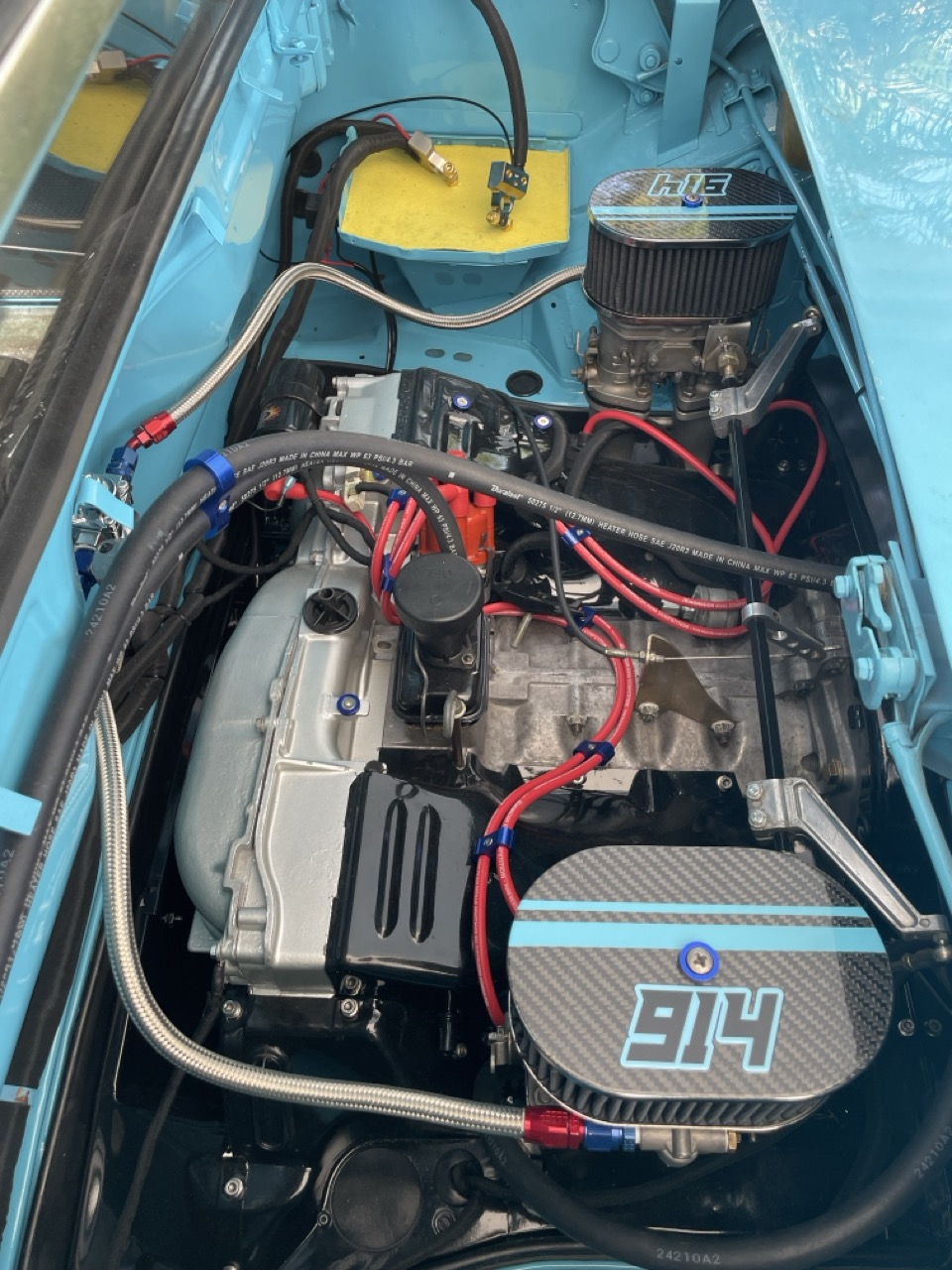

So after 5 long months of work, I finally have the 2056 built and installed. (IMG:style_emoticons/default/piratenanner.gif)

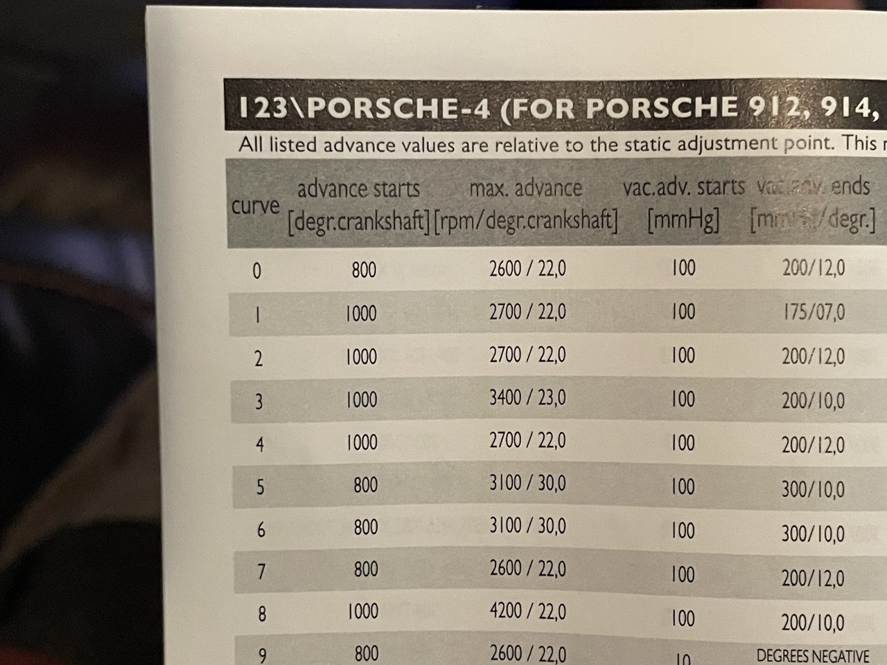

1) Since our motors go in a CW direction, the first movement of the distributor goes clockwise until the light turns off? Then CCW until the green light comes on? Correct?
2) The engine has dual carb Webber 40’s/Web cam 86a/Mild port and polished stock valve heads. My question is what setting should I use on the distributor? From what I see it looks like curve #3. Does this sound right?
3) Do I use the vacuum port on the distributor body to the base of one of my carbs, or do I plug it off, or do I leave it open?
Thanks in advance for any info!

Front yard mechanic   I was told to use 5 seems to run great   Apr 25 2025, 07:03 PM
Cairo94507   Wow! That looks amazing. :beer2:   Apr 26 2025, 06:30 AM

technicalninja   Curve 3 looks fine for an initial setting to me. ...   Apr 27 2025, 08:54 AM
emerygt350   Curve 3 looks fine for an initial setting to me. ...   Apr 27 2025, 09:49 AM

Chad911sc   Yeah 3 is what I read on a couple other sites as w...   Apr 27 2025, 07:48 PM
Chad911sc   Oh yeah…and is there any thought on the vacuum a...   Apr 27 2025, 07:52 PM
emerygt350   I have run it with and without. Many with the 123...   Apr 28 2025, 04:35 AM

technicalninja   Vacuum advance is helpful for street. Will improve...   Apr 28 2025, 12:44 PM

Chad911sc   Ok….im just going to plug it off for now and onc...   Apr 28 2025, 09:33 PM

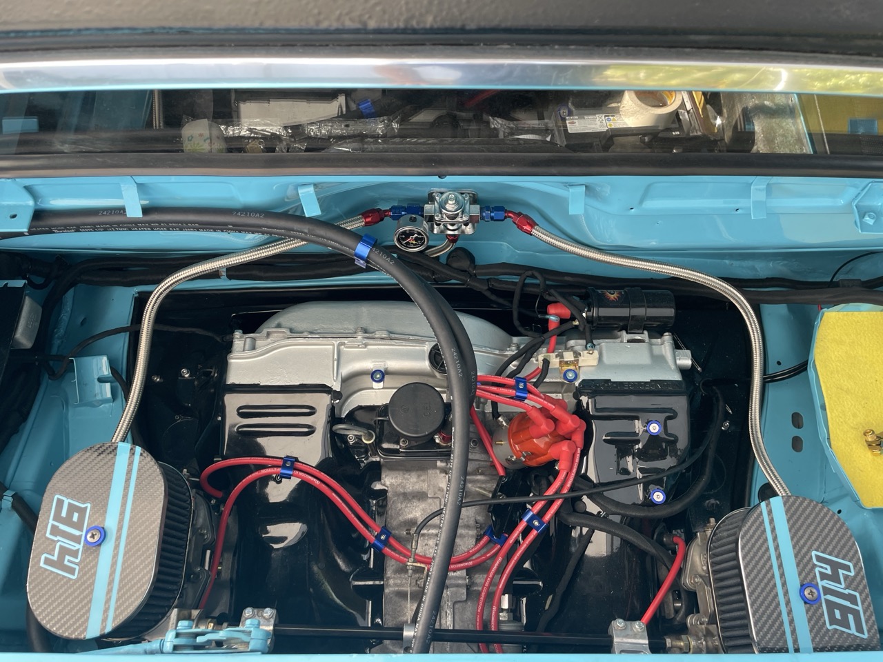

Chad911sc   Working on the Stainless Exhaust today, still need...   Apr 30 2025, 05:22 AM
worn   Working on the Stainless Exhaust today, still nee...   Apr 30 2025, 05:33 PM

Chad911sc   Pics of the exhaust…it being mated up to the MSD...   May 1 2025, 06:35 AM
bajafreaks   Pics of the exhaust…it being mated up to the MS...   May 1 2025, 08:36 AM
Chad911sc   Yes the Pertronix coil already has 3.0 ohms of res...   May 1 2025, 07:39 AM
Chad911sc   The header is super beefy and very well built for ...   May 1 2025, 09:29 AM
bajafreaks   The header is super beefy and very well built for...   May 1 2025, 09:54 AM
Chad911sc   Yes I built it custom for my application. It take...   May 1 2025, 08:14 PM
bajafreaks   Yes I built it custom for my application. It tak...   May 2 2025, 07:39 AM
