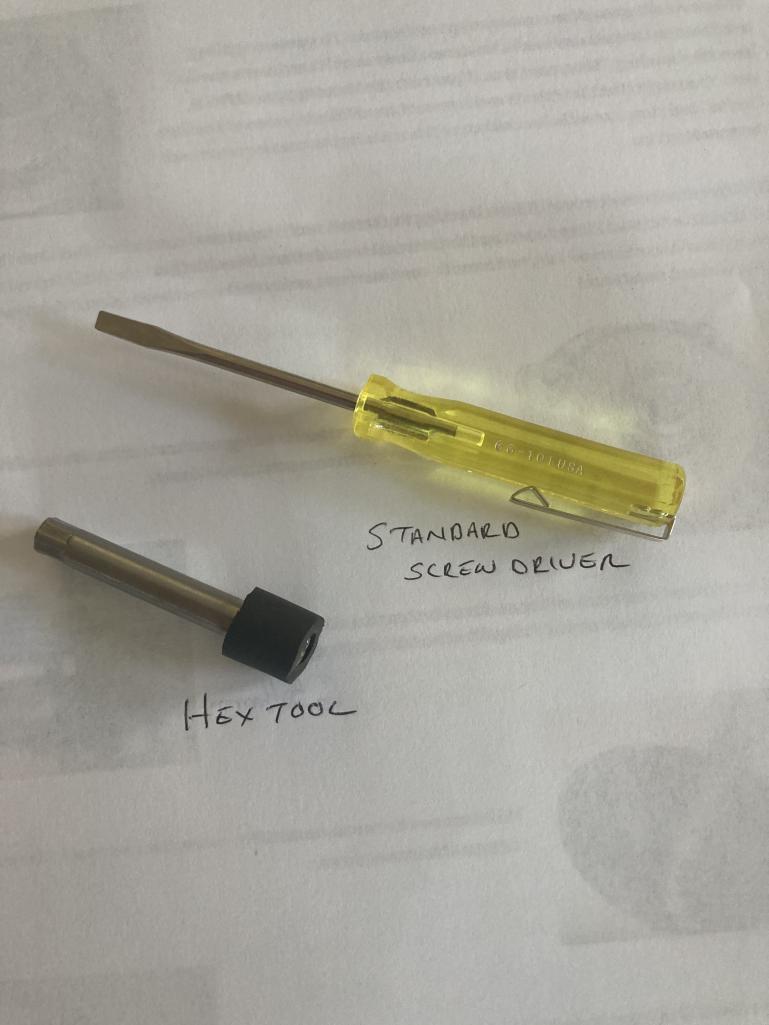

For the tools I have with the kit pictured here . This just looks like a standard screwdriver (nothing special ) and the other is the hex tool , is this only a tool or is it also installed as a replacement part ?
