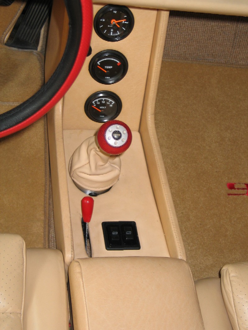

Mike,
Installed the switches today, found some really nice holders at West Marine. Pic..

jim_hoyland   Mike, Installed the switches today, found some re...   May 6 2006, 06:25 PM
