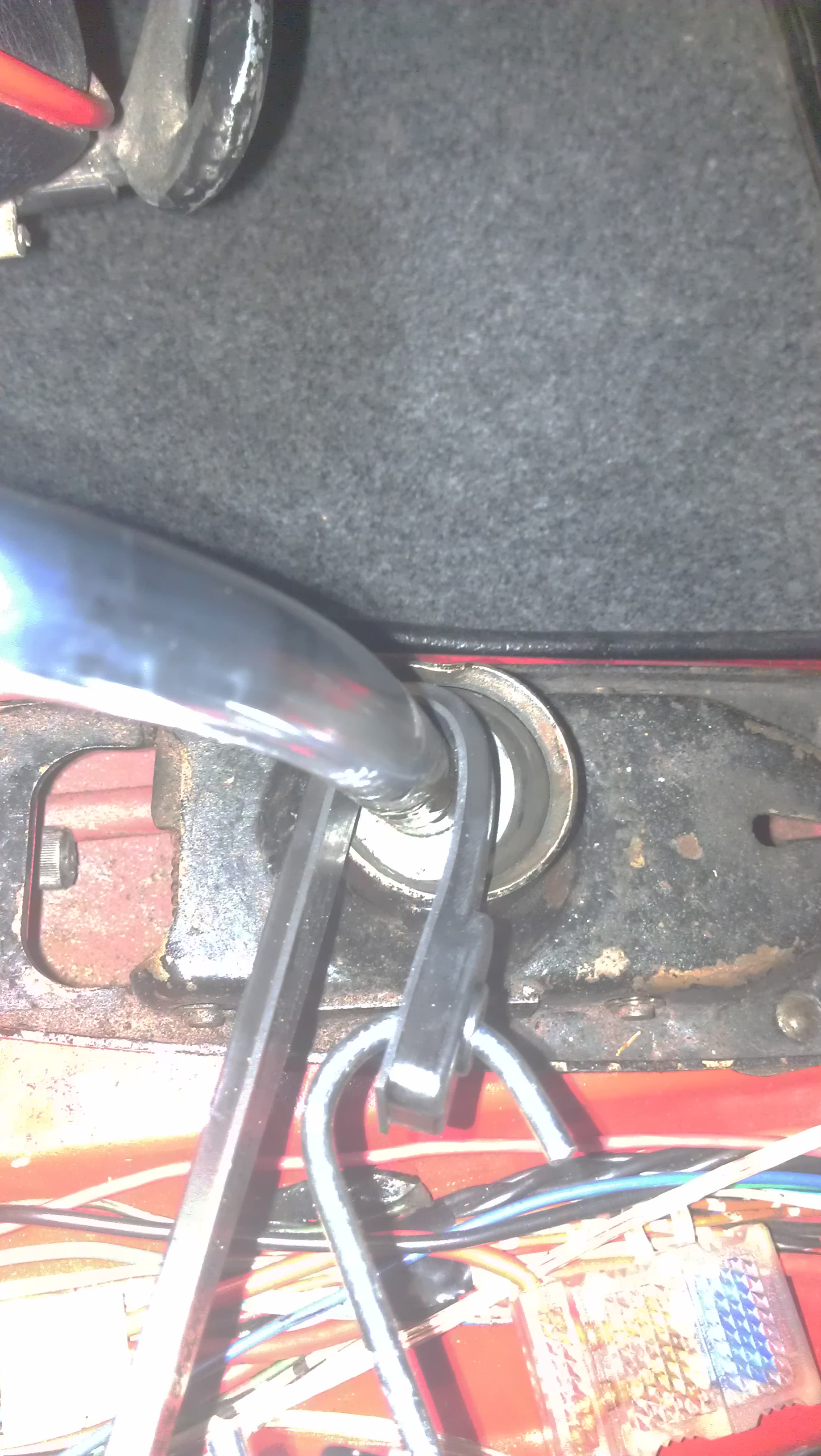

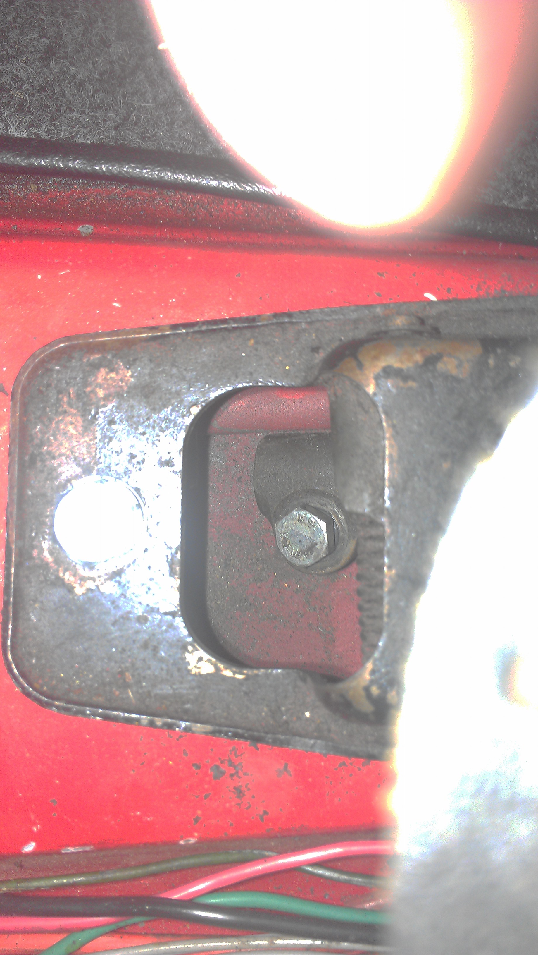

3. Put the shifter in neutral, and loosen the pinch bolt on the shift rod. This is accessible behind the shifter.
4. Completely disconnect the shift rod by pulling the shifter back into the third gear position. You should see the coupler laying against the floorboard (like in the picture below).

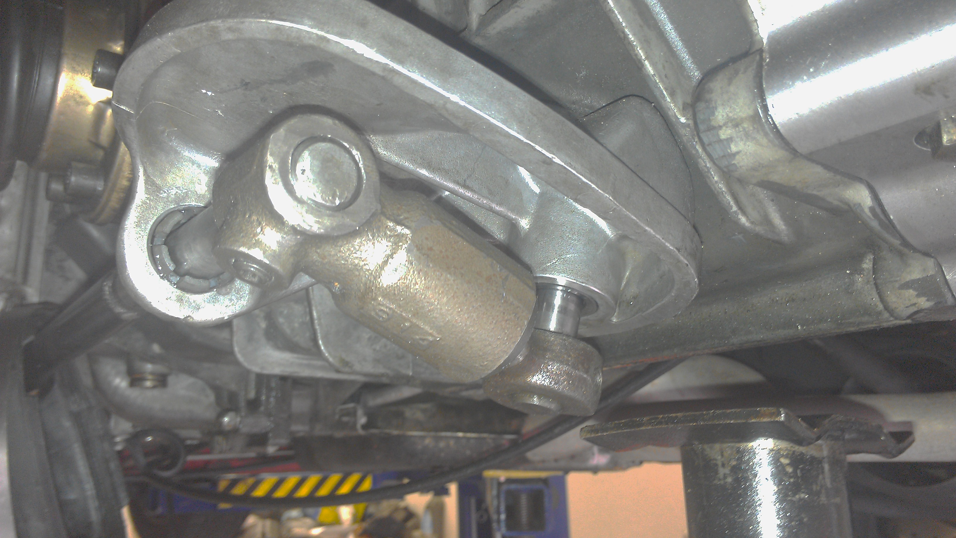

5. From under the car, put the side shift console on the transmission into 4th gear. This is done by pulling down on the shift rod and pulling it rearward.

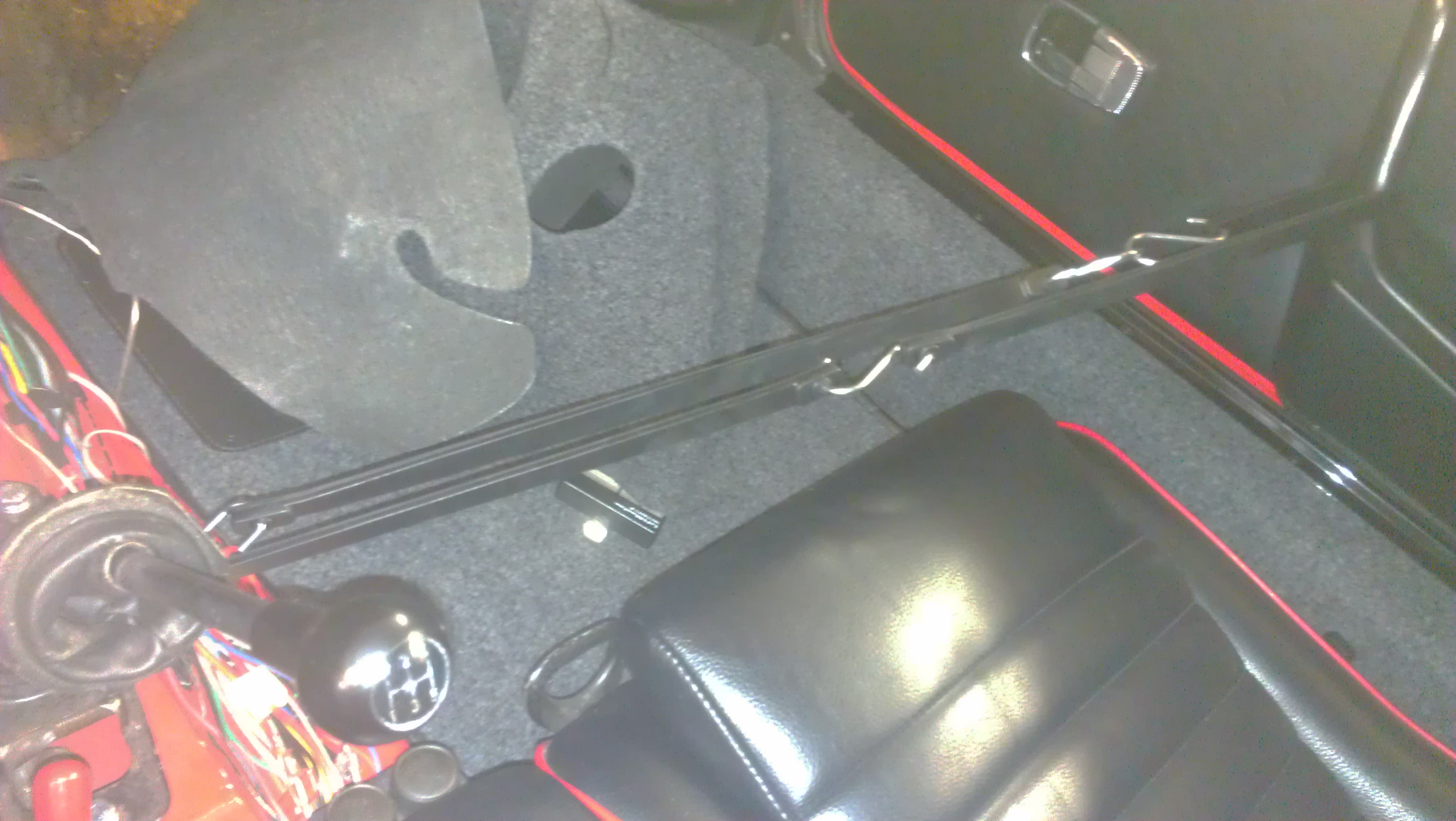

6. Back inside the car, put a rubber bungee cord around the base of the shifter, and loop the other end over the right hand door handle.
7. Make sure that the bungee stays at the base of the shifter.

11. Remove the bungee cord from the shifter, then move the shifter until the part below the curve is vertical. Tighten the pinch bolt.
