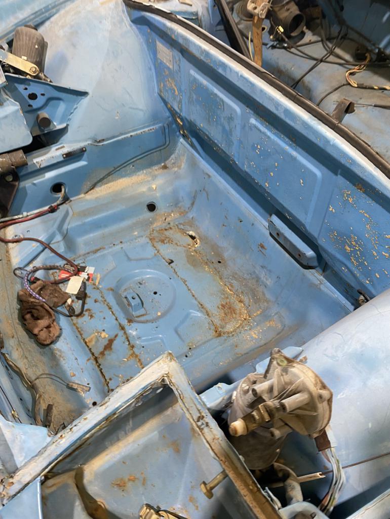

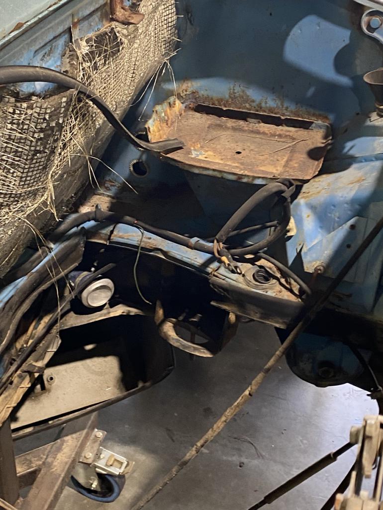

One thing that struck me about the 914 on that first visit, was that the car was extremely dry. Here's the ....ahem... heck hole.
Though the car was taken apart, the previous owner seemed to have all the original parts (though many of them were in his storage facility and not with the car.) Another cool factoid was that the car was actually purchased in a nearby Audi/VW dealership right here in Las Vegas. Vegas in '74 was very, very small, so to have a survivor 914 in the same town that it was 46 years ago is pretty cool in my opinion.

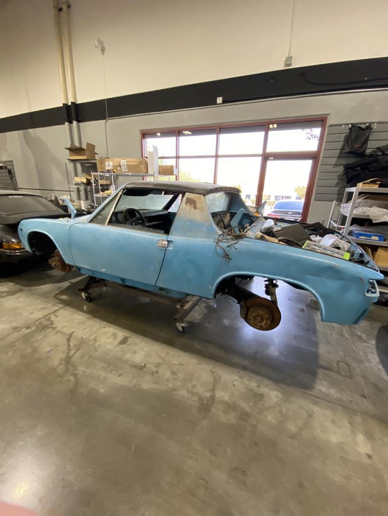

The car was more or less stripped in preparation for a GT conversion. I remarked in my mind about how solid the car was and went home that day thinking it was a good deal but that I'm a snobby 911 guy who doesn't buy anything but 911s :-P The car was definitely marinating in the back of my mind...

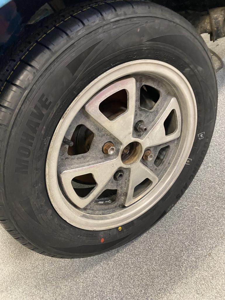

PO had the original Fuchs 4 lug wheels, but no tires. the 914 was also on a pretty sweet dolly, but unfortunately that wasn't part of the sale.

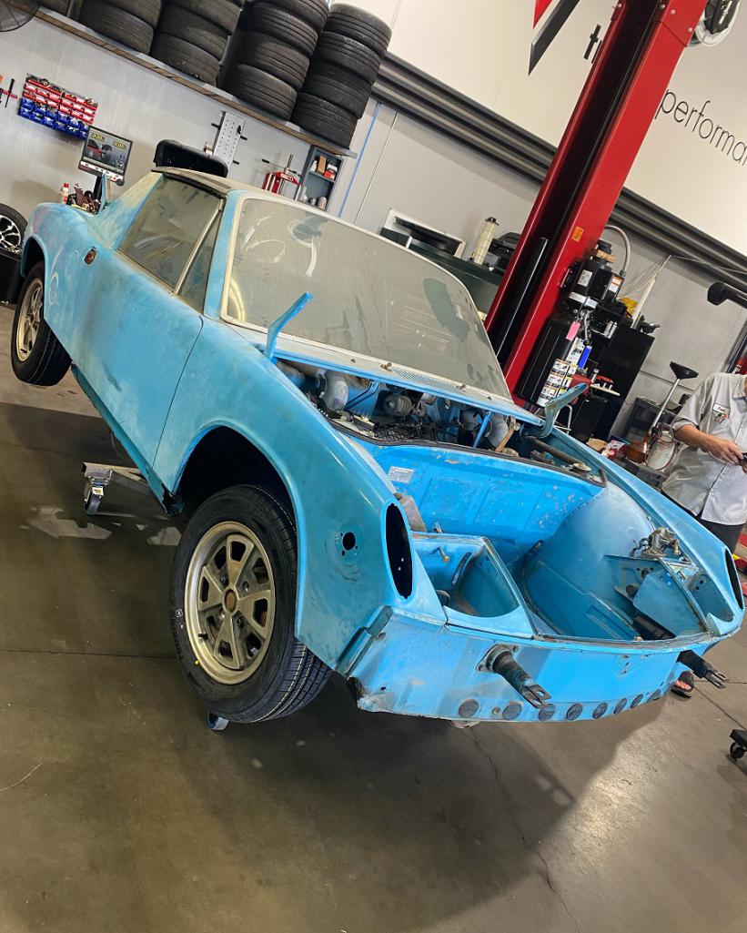

I took the wheels to a discount tire and got the cheapest tires I could buy, just so I could make it a roller for the impending flatbed trailer pickup appointment.
I had to scrounge around and find some lugs to mount them. Luckily I had some open 911 lugs as well as some 996 studs to complete the temporary fix.

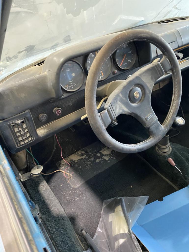

After getting it back to the shop I thought: "I've got a complete project build going already, wouldn't it be fun to try to build a total survivor driver with original paint, dings, dents, damage and all, but have a bit of a sleeper engine and nice interior. So mostly original, but everything works and is nice in terms of get in, turn the key, take it to the grocery and not worry about parking it. "
