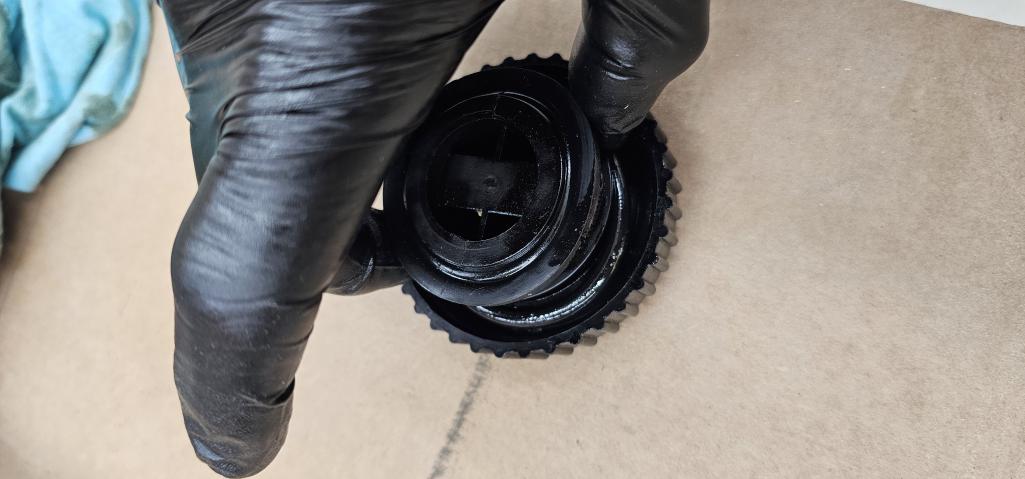

Has anyone had issues with the oil cap gaskets swelling and making it difficult to unscrew the oil cap?
Are there better sources for the gaskets and O-ring? The O-ring was so expanded it wasn't really seated in the groove. And the flat gasket was so swelled that after i got it out I can't get the cap to go back on. |

Superhawk996 EPDM rubber swells when exposed to oil and gas
N... Apr 7 2025, 07:02 PM

wonkipop you want viton. :beer2: Apr 7 2025, 08:05 PM
