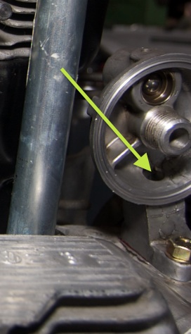

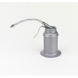

Mark, as mentioned in other posts, you can decrease the oil pump-up time by removing the oil filter and using a oil squirter thingy (see below) with a bit of hose on the nozzle to get some oil directly into the pump via the outer hole in the oil filter console. You need those gaps between the pump gears to be sealed by oil before they'll really start to pump. Sometimes it can take while, especially if your battery or starter are slow.
(IMG:http://www.914world.com/bbs2/uploads_offsite/www.alltradetools.com-419-1325021713.1.jpg)
