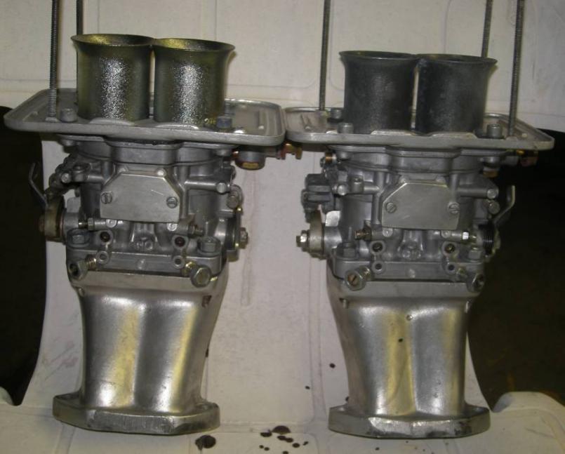

more pics of fresh pine carbs

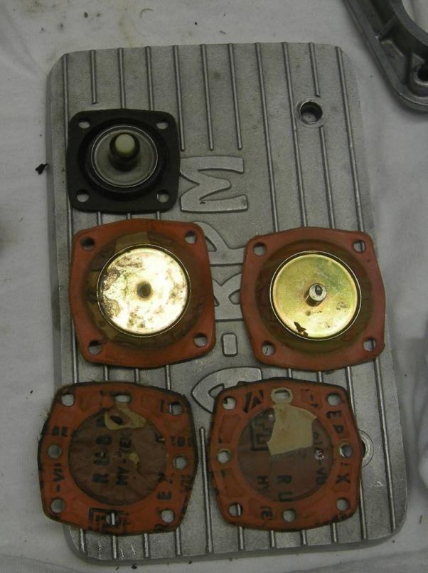

The diaphragms on the 40IDA disintegrated, at first I blamed the Pine-Sol, but taking the other carb apart dry I found they were trashed already . I also don't think they were OE weber anyways. Guess I need new carb kits.
Top is the diaphragm from the DCNF, it was left in Pine-Sol overnight and it's in great shape.
Mark Henry
post Aug 2 2010, 10:37 PM
Post #23
that's what I do!
Posts: 20,065
Joined: 27-December 02
From: Port Hope, Ontario
Member No.: 26
Hard to believe these carbs have been in service for 18 years. (IMG:style_emoticons/default/biggrin.gif)

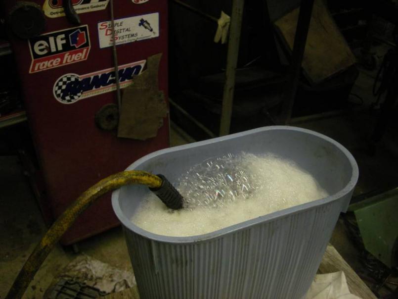

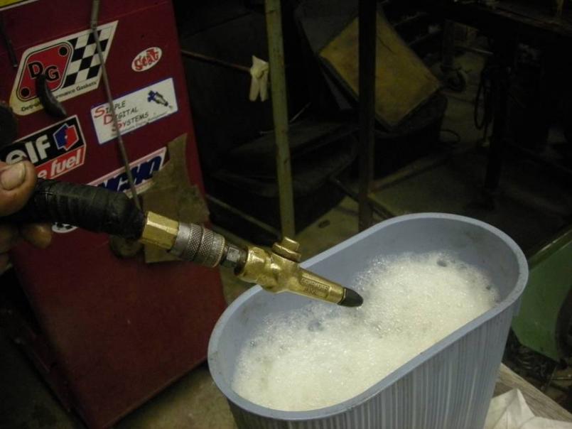

Being the cheap ass that I am...I think I figured out how to get an extra day out of the solution. This blower has a leak, I turned the regulator down to just a trickle and I have bubbles agian. Seems to be working and I wanted to drain the compressor anyways.

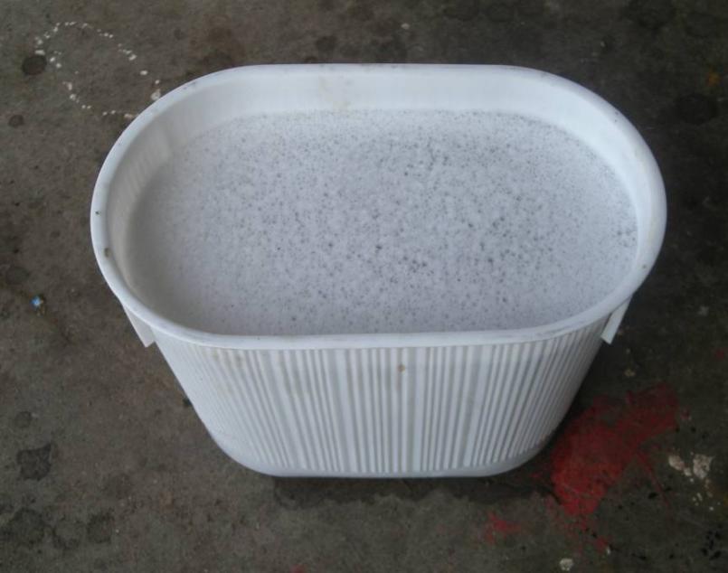

Mark Henry
post Aug 3 2010, 08:36 AM
Post #30
that's what I do!
Posts: 20,065
Member No.: 26
This is my rinse bucket, just clear water. I already had blasted it with water and then dunked the 40IDA body and top. You can get a good idea how much soap is still left on them.

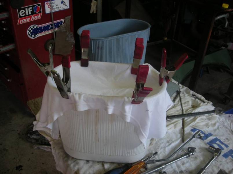

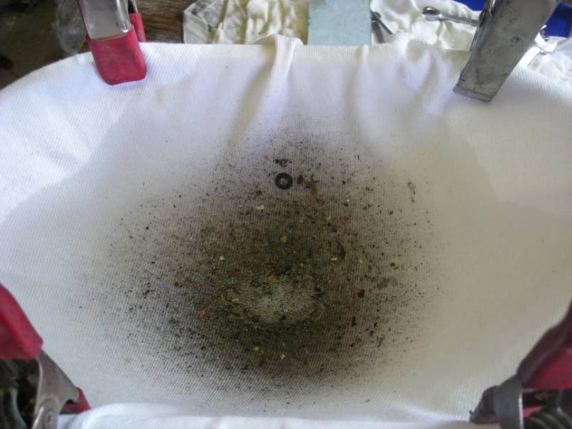

This shows how I filtered the Pine-Sol. A real good idea, not only to keep it clean, but as you can see catch any little parts you may have missed.

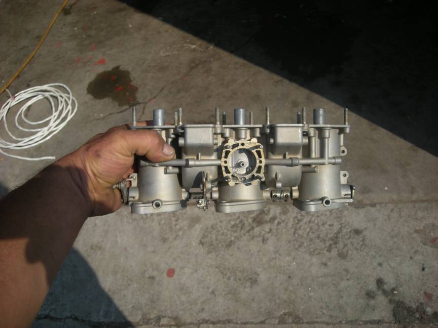

Member No.: 26

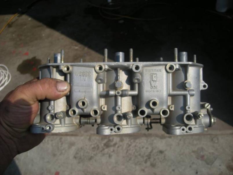

Here is my second 40IDA, the bubbler trick worked, but I think not quite as well as the fresh Pine-Sol. Good enough for me and still better than any carb cleaner I've ever used before.
The amazing part is how well it works in all the nooks and crannies. (IMG:style_emoticons/default/aktion035.gif)

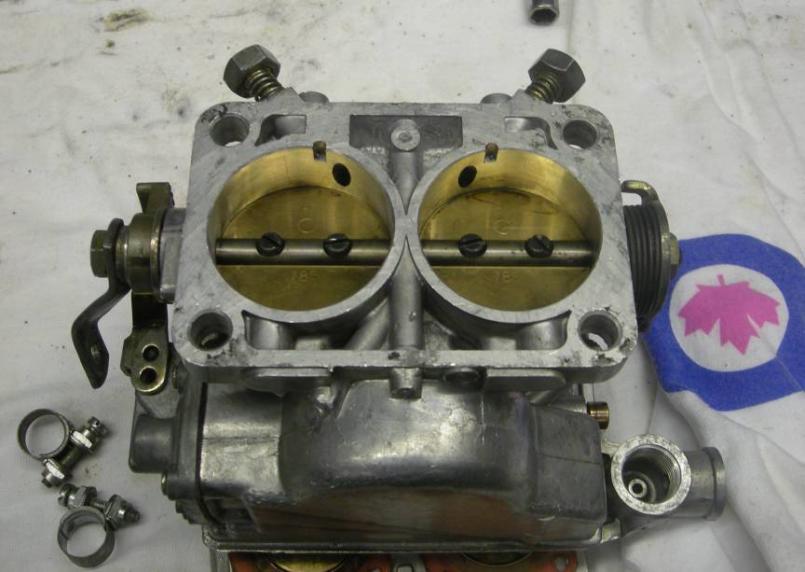

Just an up-date, the 42 DCNF`s are back in my bus and are working like a champ (IMG:style_emoticons/default/smilie_pokal.gif)
BUT
It does leave a film on brass parts for sure, most likely only a few microns thick, but it's enough to make my float valves leak like a SOB!
I didn't notice it right away so it's a huge fire hazzard!
I know it wasn't dirt as they both were leaking, 3/4 was leaking big time, 1/2 was leaking just a bit. No big deal as a couple minutes polishing with a rag and Q-tips cured the problem, but I just want peeps to be aware of this. Remove as much of the brass jets, etc as you can or you need to polish them after cleaning.
