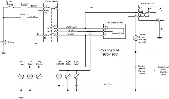

MrHyde   this is the diagram I'm going off of http://w...   Nov 9 2010, 08:13 AM
pcar916   That drawing screwed me up one time. It may be for...   Nov 9 2010, 08:29 AM
MrHyde   It says right on it 1970-1973, Mines a '73... ...   Nov 9 2010, 08:46 AM

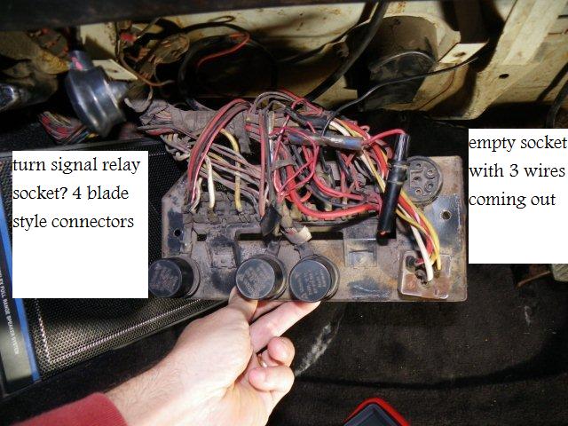

MrHyde   here's teh pic.. dont mind the cheezy speake ...   Nov 9 2010, 09:50 AM
type47   so you can see the socket for the flasher relay (...   Nov 9 2010, 10:37 AM

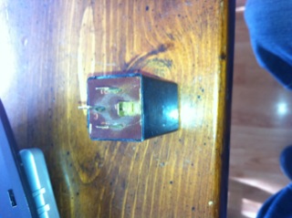

MrHyde   here is s pic of the relay the PO gave me, he said...   Nov 9 2010, 09:59 AM

jt914-6   In Ron's drawing 4-5 is left....5-6 is right.....   Nov 10 2010, 02:24 PM

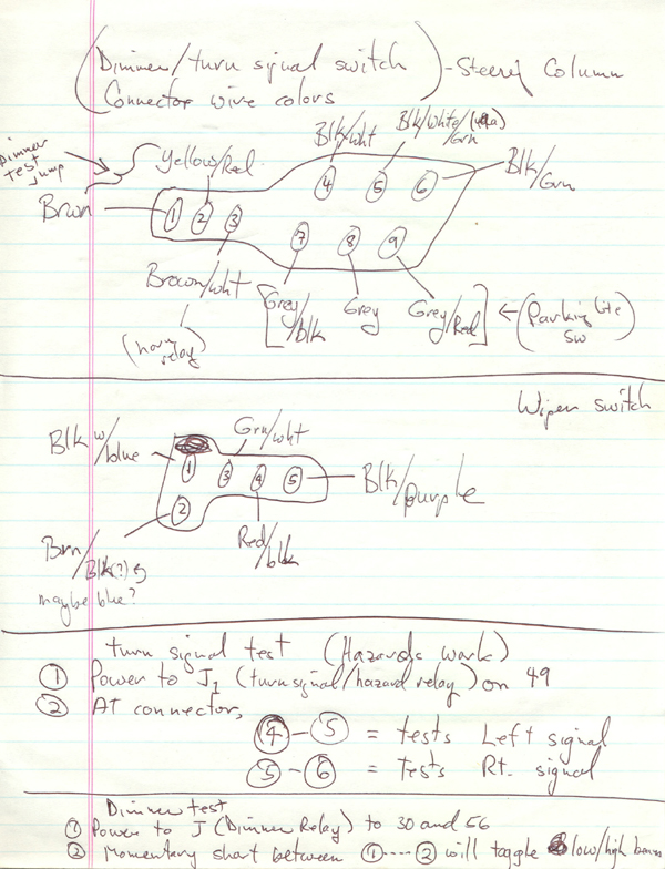

jk76.914   I figured this out a while back. I wrote up how i...   Nov 24 2010, 07:58 PM

MrHyde   Its a Wittrin relay part # 013309. 4 prong and ...   Nov 25 2010, 06:39 AM
jk76.914   Its a Wittrin relay part # 013309. 4 prong and...   Nov 26 2010, 08:08 AM
