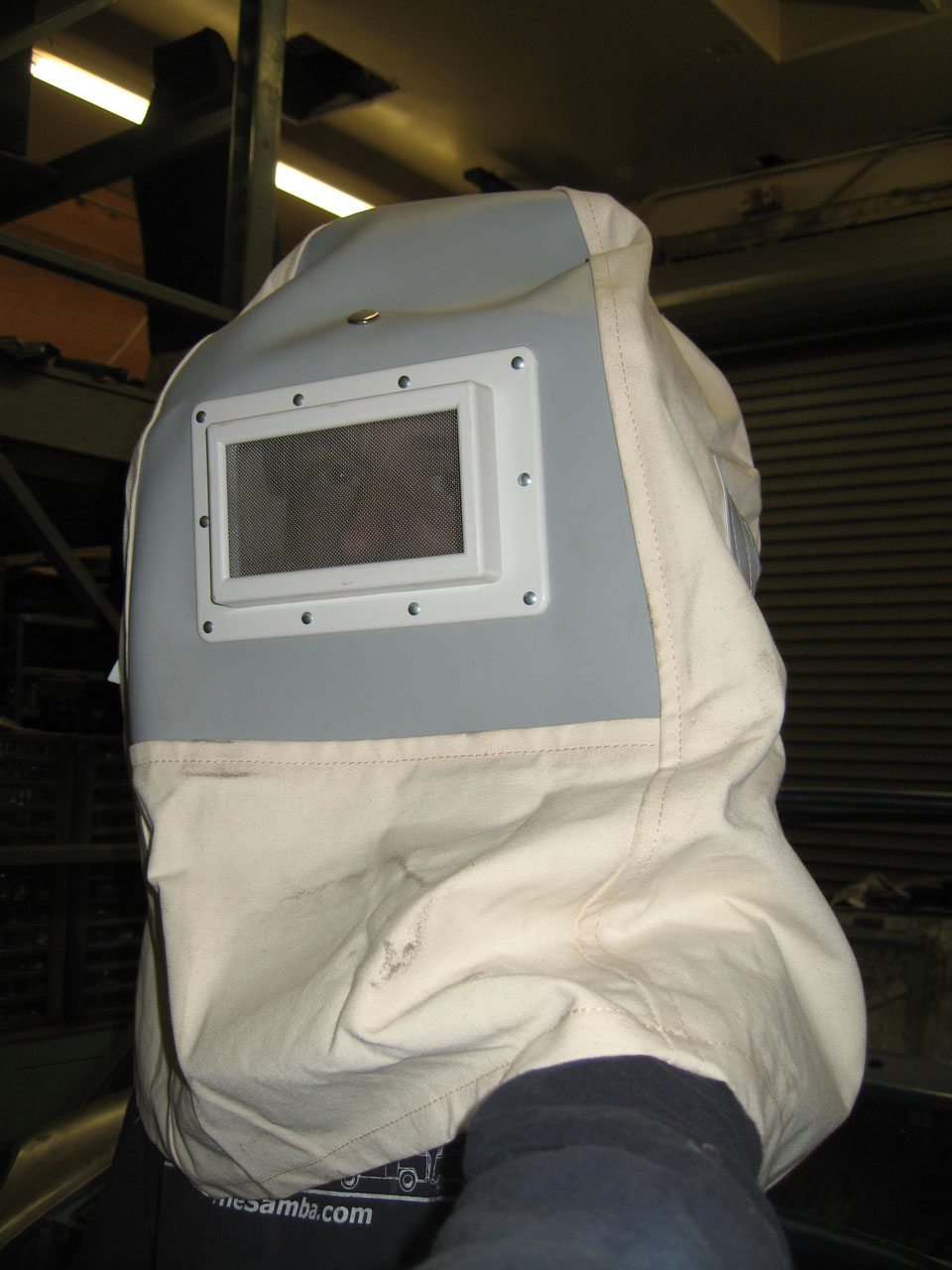

Anyway, this new compressor is a beast. I regulate it down to 90psi for the sandblast cabinet, and I can say that it does not EVER get below that. I can blast continuously and it will meet the demand. If I give it half a chance it will actually catch up and turn off.
I'd thought that the shortcomings of my cabinet were a lot due to it being not the recirculating type, but it is working a lot better with this bad boy, like it puts out a stronger 90psi than the other though I'm using the same gauge!. (IMG:style_emoticons/default/biggrin.gif)

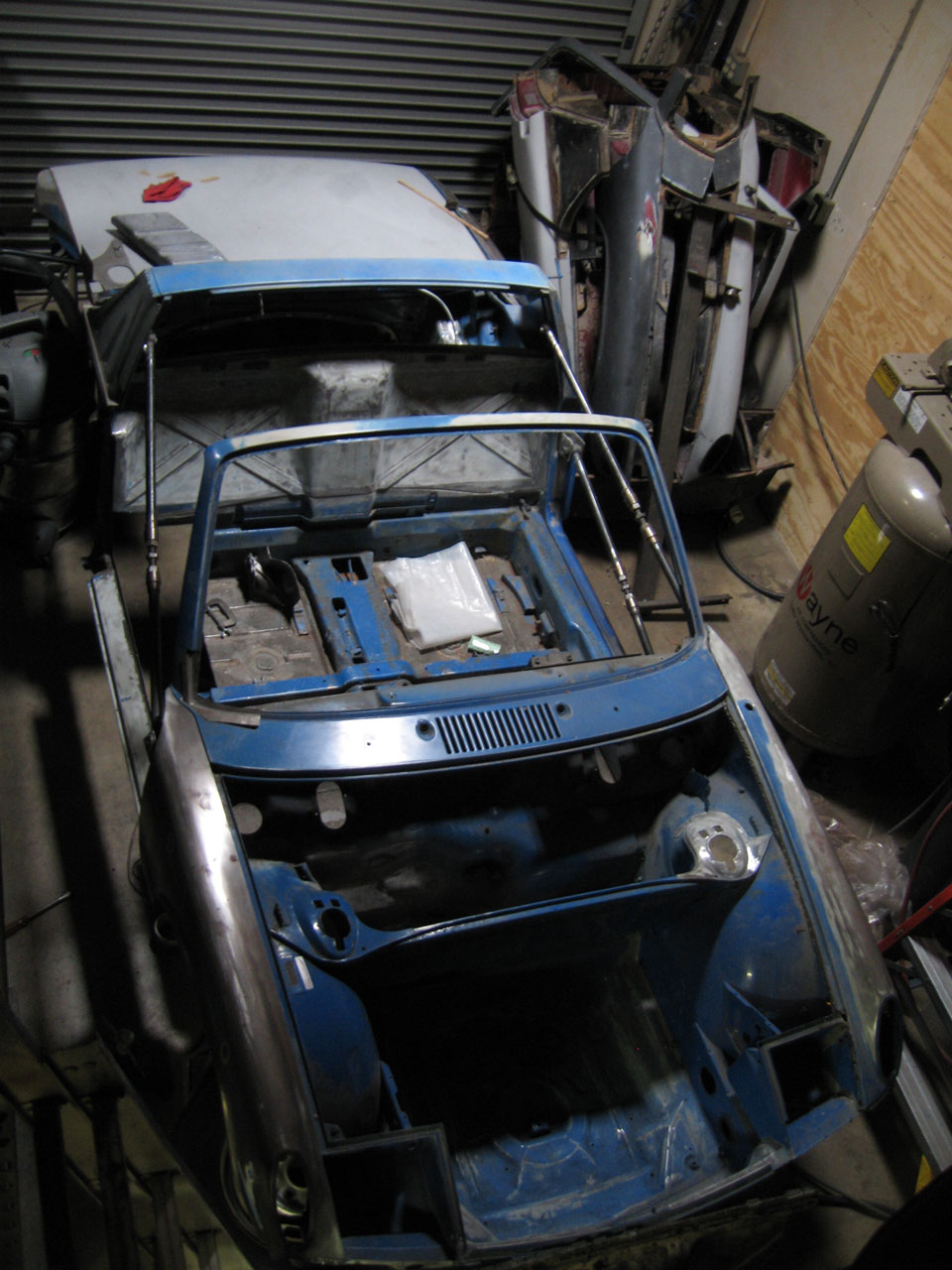

Back a step to show there has actually been progress.
(IMG:http://www.914world.com/bbs2/uploads_offsite/www.smileyvault.com-11782-1317530913.1.gif)
It did get brutal when I removed the old suspension console, was more than a year ago.

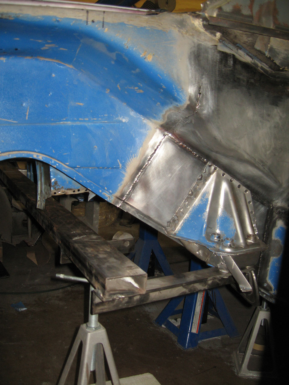

(IMG:style_emoticons/default/welder.gif) Bit of work to get both sides looking solid

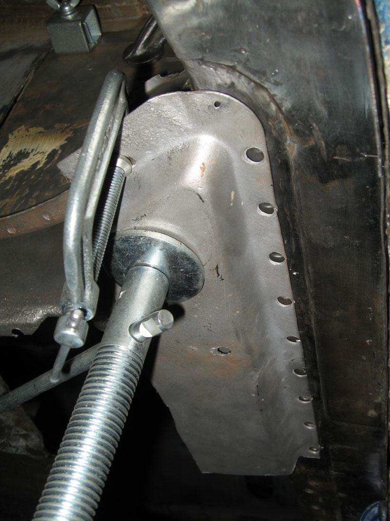

bit lumpy, but passable. They don't sell this as a replacement piece afaik. 3M weld thru primer.
I've got some more plug welding to do; waiting on a big ass c-clamp to hold it together way in. A bit of a fit up of the outer suspension console.

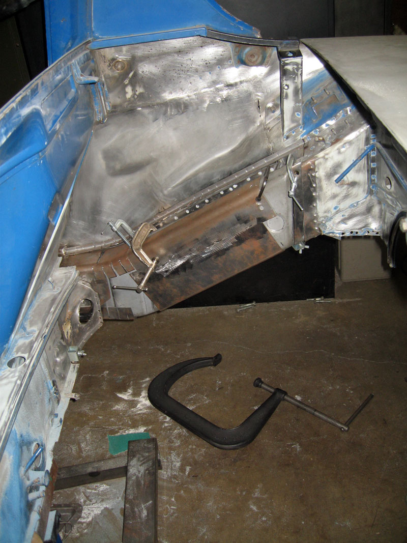

The inside, fitting
I've cut out pieces of the long from the donor car to get the curvature without having to make tooling for the bender.

Working toward completing the inner long, those corrugations at the bottom, I can use parts of the driver-side long of the donor for the outer layer, I've got to make the inner, Richard Castro-style, as his thread is the only one I've seen really address the intricacies of the lower long.

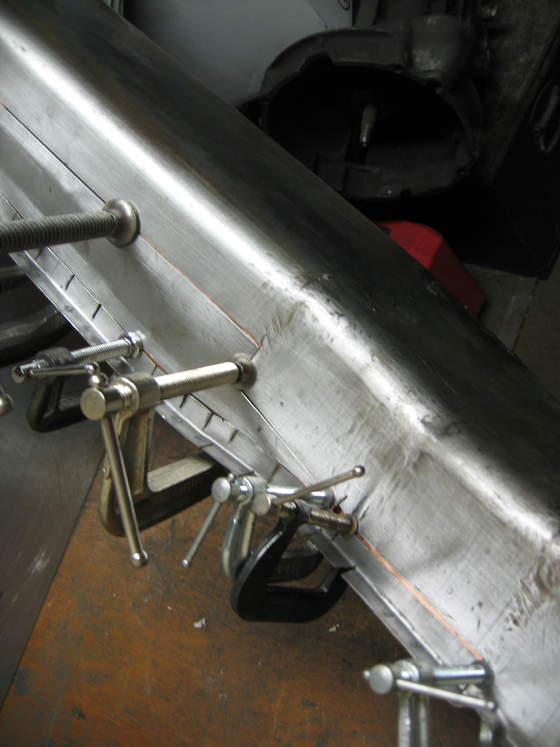

A bit of fitting up, a few pieces put together, some tricky bit to do at the bottom.
Welding is coming along, could be prettier. I will grind the butt welds though.

The plan for the air vent is to cut the old one out entirely, just behind the tube where it becomes double-layered. The new piece will have part of the door jam where it comes through and include the recess just behind the door pull, so that whole "corner".
First the long, then the engine mount, the firewall, the outer suspension console, then the inner console, the inter-ties, maybe the engine shelf, and then the fresh air duct. (IMG:style_emoticons/default/biggrin.gif) The rear fender I'll be fitting at the same time.

The long is made up of like 15 different pieces.
must ... conquer ... rust ...
and the corner of the floor...
