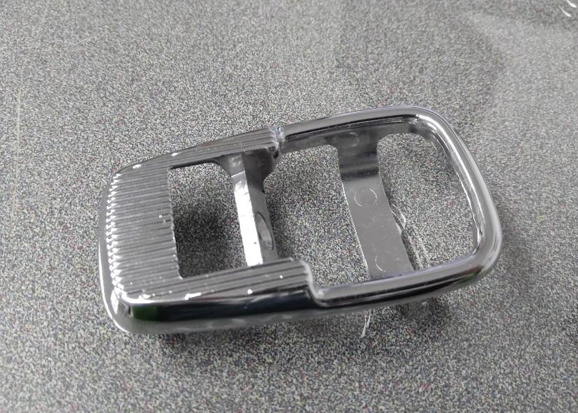

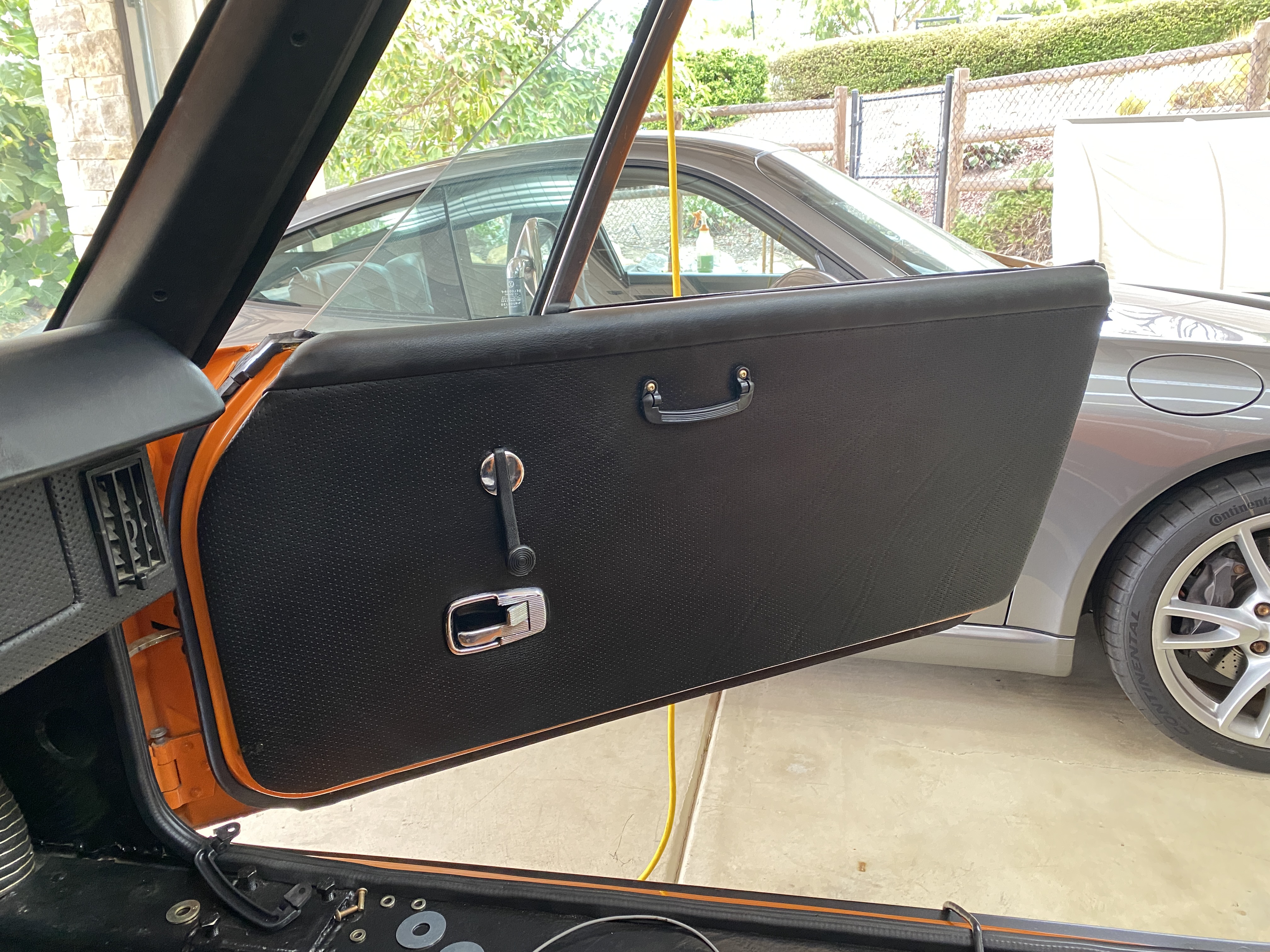

is there a difference between the chrome and all black interior door handle cup things?
im 99% sure i had these early/chrome door handle cups on this car but…. the interior door handle does not work with these installed. weird. i just wont open all the way. without them it works fine. hmmmm.

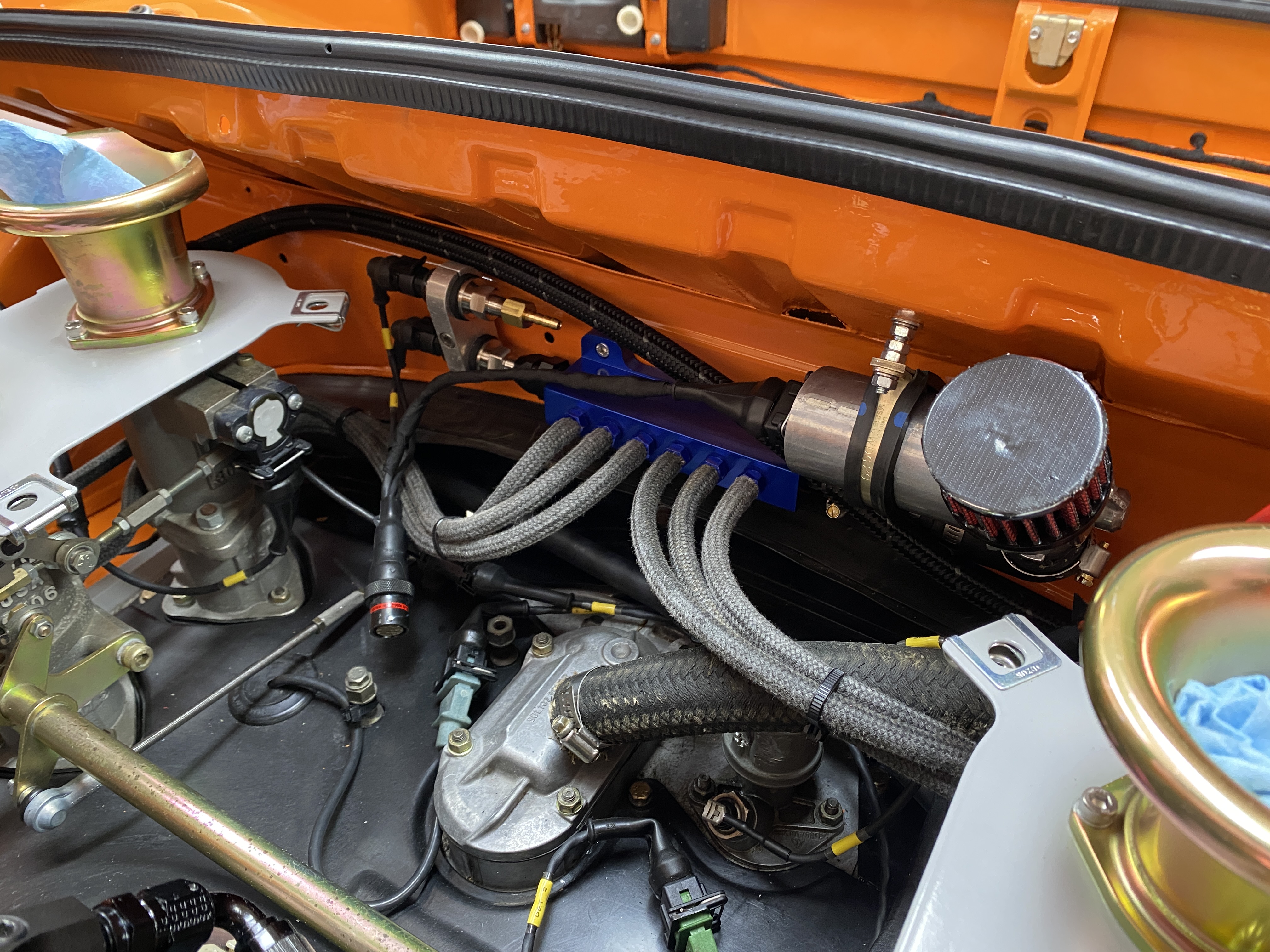

and a ton of work on the new fi ecu. nearly all the sensors are hooked up now.

QUOTE(siverson @ Sep 29 2021, 07:31 AM) *
Those are early, but I have them in our 73 because we like the look. The only issue we found was that the screw length matters… should be very short as to not catch or it binds like you are reporting. These screws are unexpectedly short.

There is also a "glider" difference. On late its a disc that mounts tween the winder & the door card vinyl. On early its more of a ring.

The door looks great. The chrome surround and handle base 'pops'.
Love your build since it showed up at PMS way back when in the late 90's? I was there when you were trying to figure out a fuel leak?
Curious who's ITB kit is that? Also when you get it running, you will have to let us know the pro's and con's versus the stock DME injection.

QUOTE(Jett @ Sep 29 2021, 07:40 AM) *
hmmm… thats a hood suggestion but i tried even without a screw and it interferes. ill have to make a video…
really? did you work there or something? because if not thats a really strange coincidence because ive only been there for about 2 hours ever. and yes now that you mention it it was to get an adapter for the 964 fuel pump to AN fittings. they just welded something up.

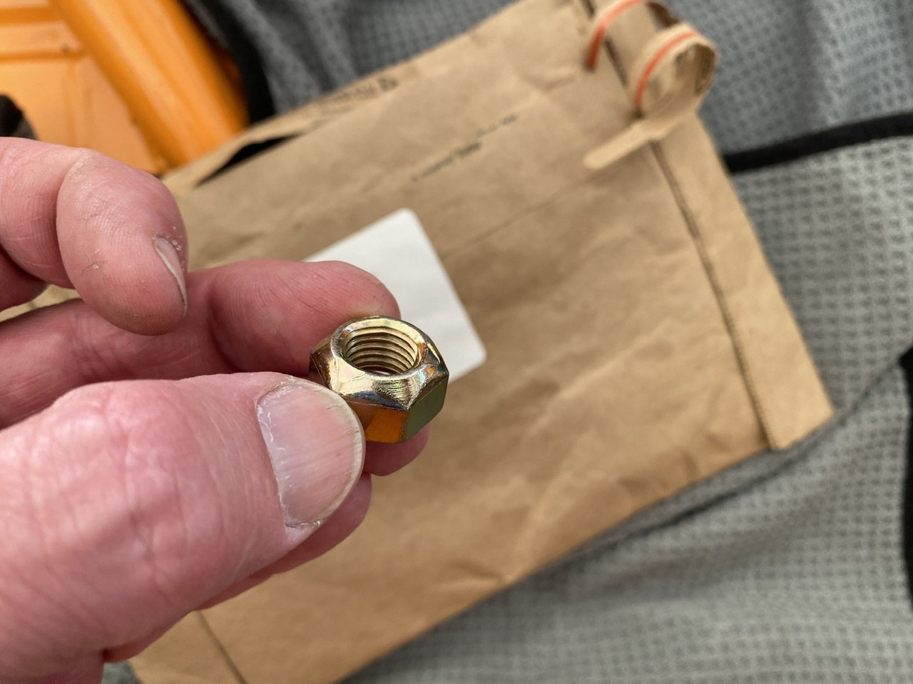

A - isnt it great when the right hardware arrives?
B - I think this is the only m12 x 1.5 nut i have ever needed (weird threads). what is up with that?!?!?

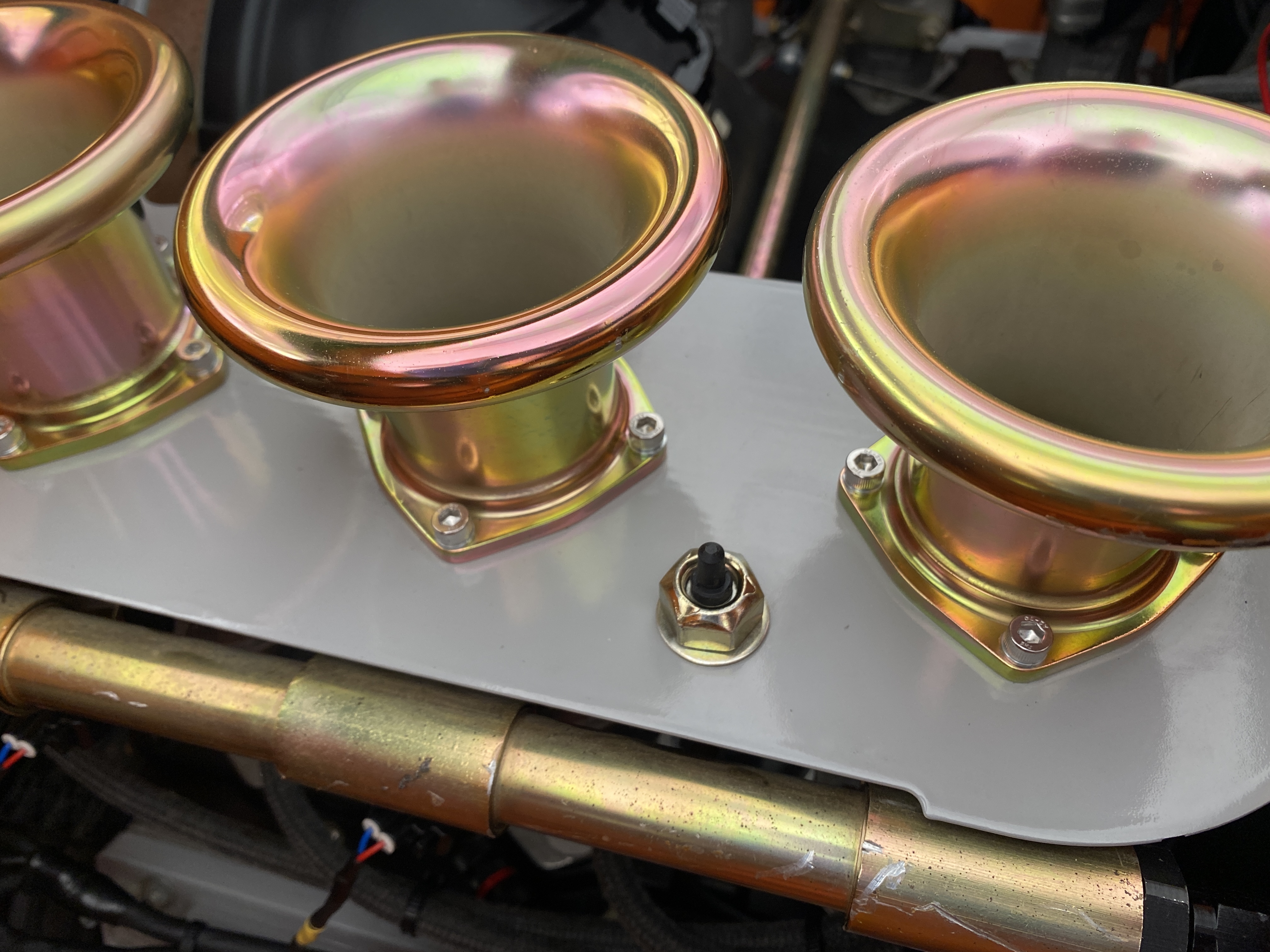

thats a bosch intake air temp sensor.

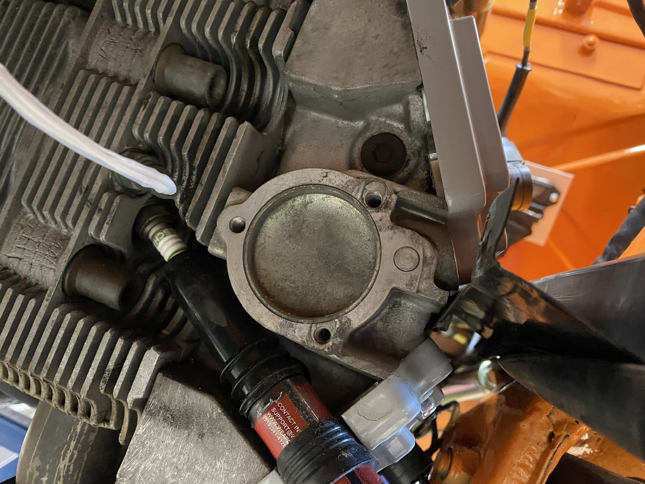

hi. whats the best way to remove this seemingly pressed in round cam cover? im adding the cam position sensor here.

and here is my interior door latch problem in all its glory.
its a 1974 car, but with early 73 doors (late window mechanism but no safety bracing).
https://youtu.be/F7BavNNqkHA

try removing the cover of the passenger side latch, my experienced before I have a longer screw to hold the cover, and it won’t open all the way.
Your driver side does not have the cover yet and that is why it opens.

Hi - correct. It is the cover that is interfering as I mentioned in a previous post. And it interferes even if I just hold it there (no screw). Very strange...
