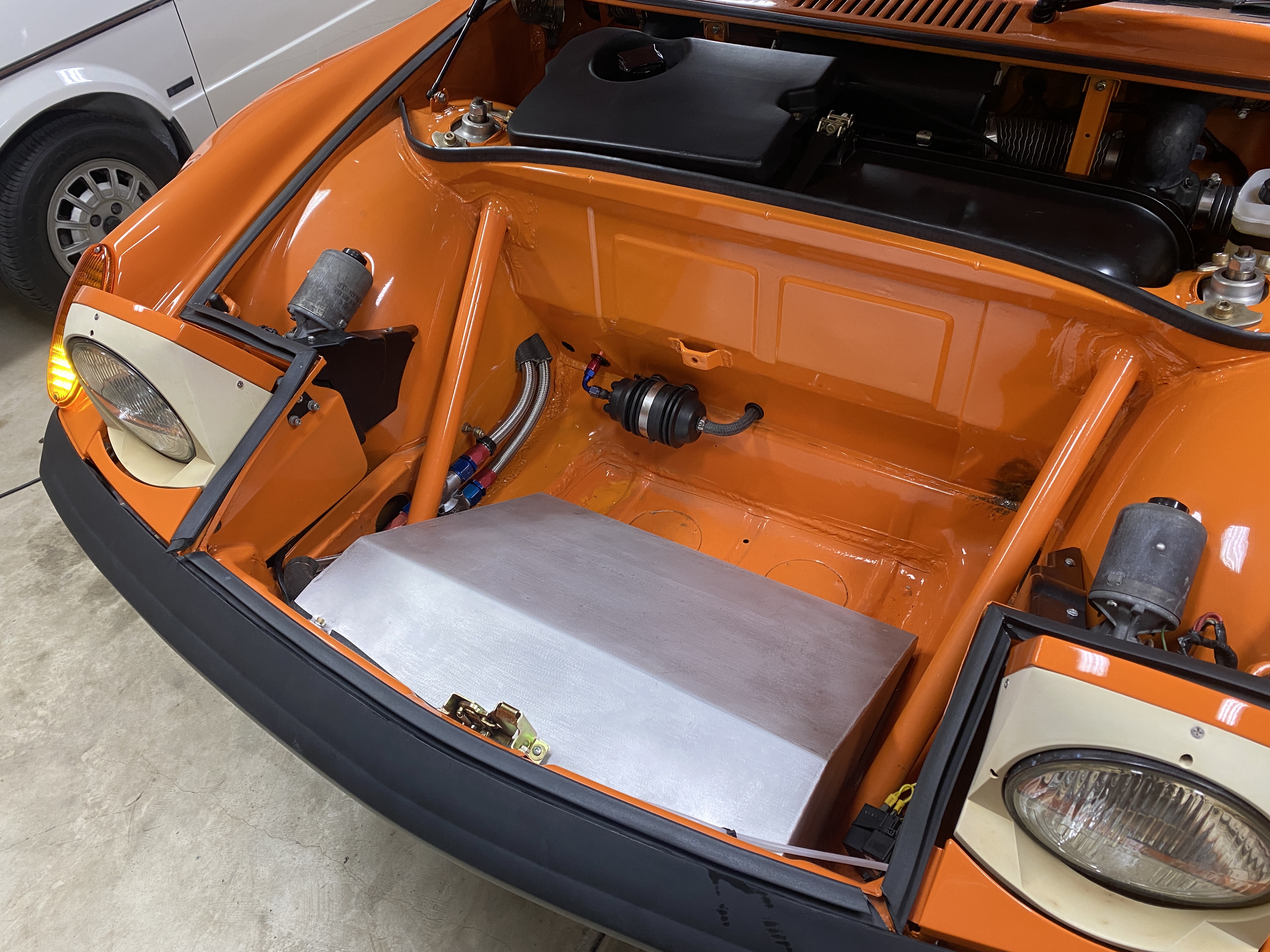

that worked.
siverson
post Oct 4 2021, 03:19 PM
Post #362
Posts: 2,458
Joined: 5-May 03
From: San Diego, CA
Member No.: 654
914

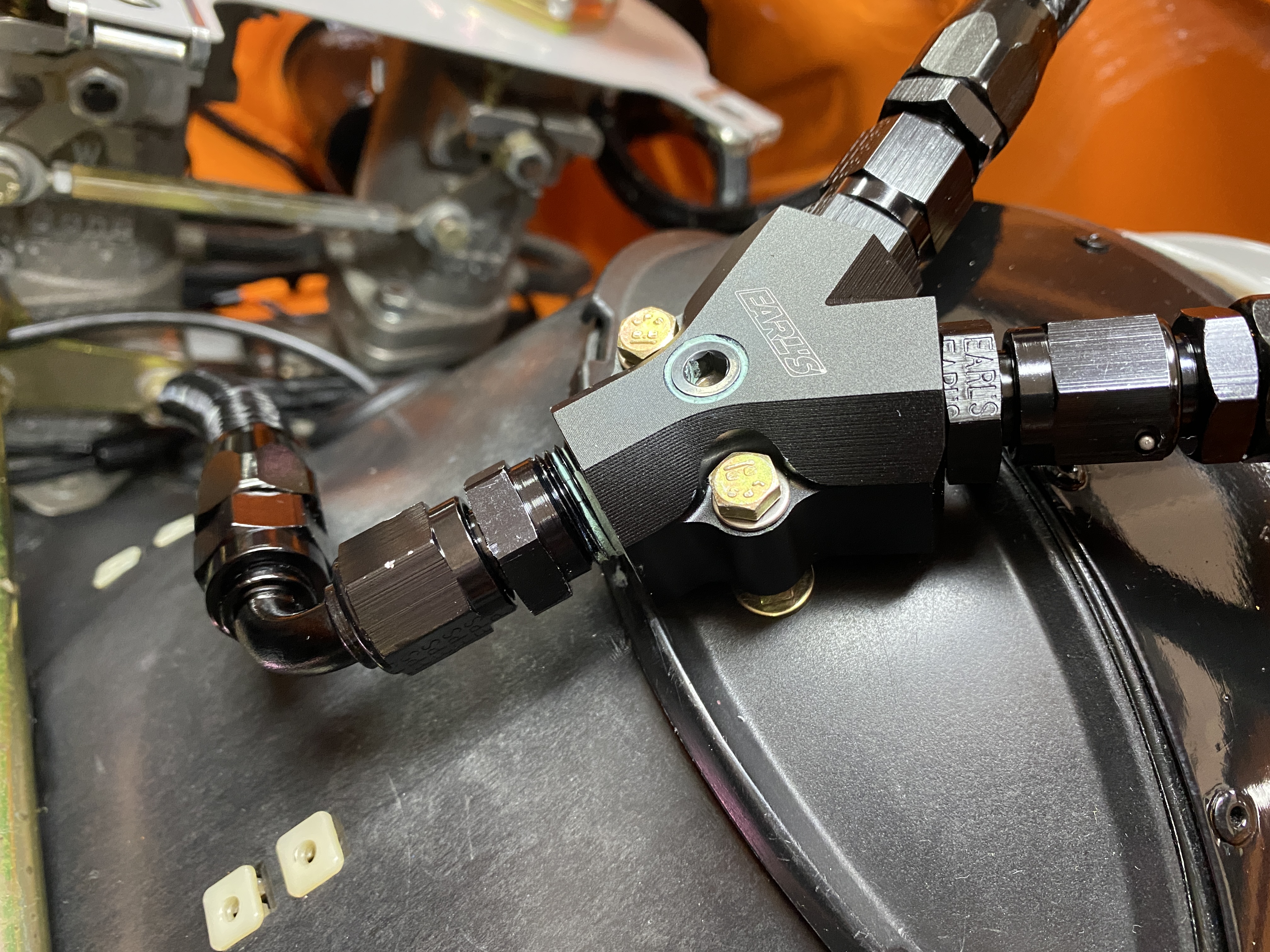

this y was seeping at the bottom but i added some gasoila thread sealant and that worked. but honestly not sure if its the right fitting - maybe i need an o-ring there?
-steve

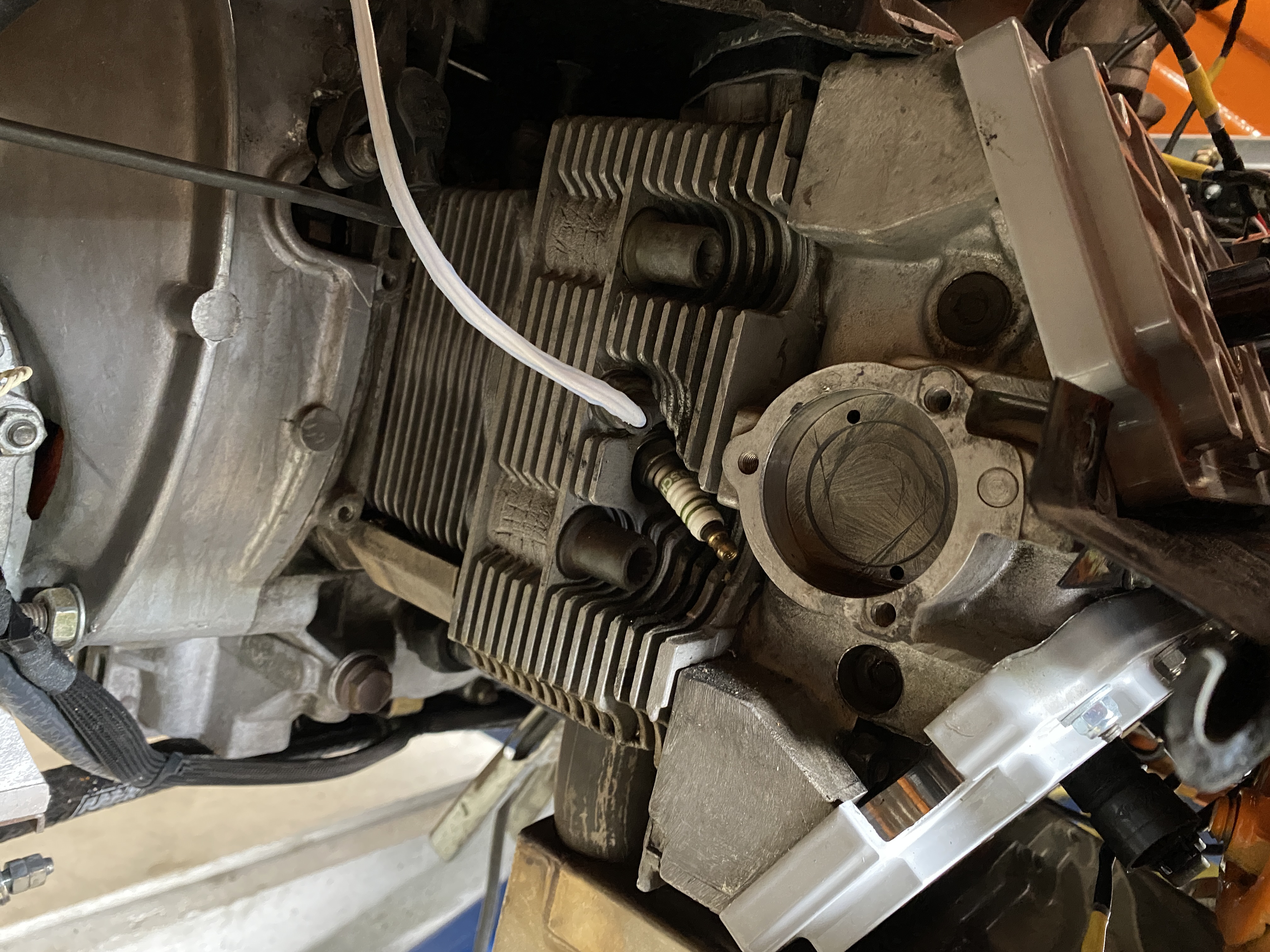

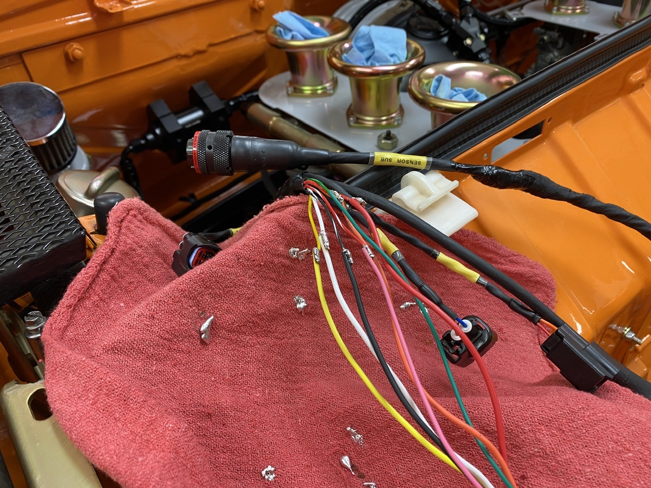

had to hack into the harness again to extend some sensors.
-steve

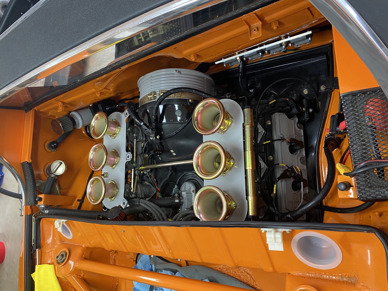

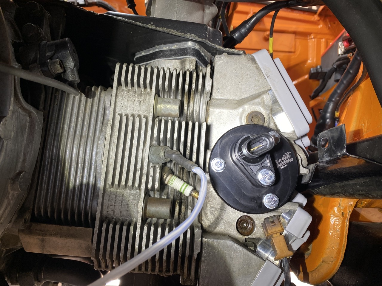

got the clewett cam sensor installed. why didnt i do
this with the engine out of the car?!?!?
-steve

and… it idles! (sort of)
https://youtu.be/D30ioB0K5wk
-steve

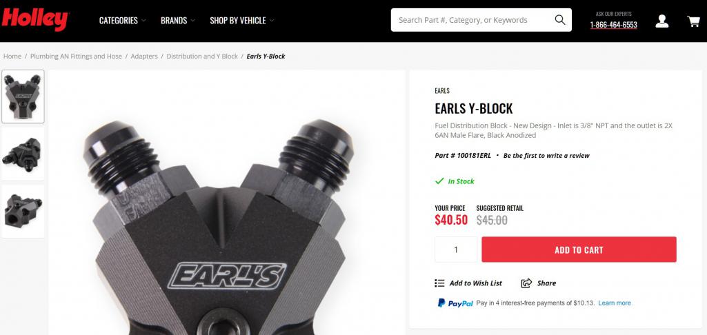

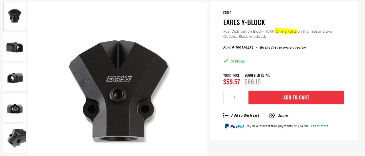

QUOTE(siverson @ Oct 8 2021, 06:05 PM) *
-steve
From the looks of the fitting, the 2 outputs of the "Y" have adaptors threaded all the way to the body which lets us assume there is an o-ring in there. That being said, at the inlet your fitting doesn't go all the way. Is the Earl's fitting really a female NPT thread at that end? Seems to me it probably is the same setup as the 2 outlets. Also, your male NPT doesn't seem to be threaded very deep in for an NPT, another sign that these might not be matching.
Actually, just found this. O-ring is your answer!
https://www.holley.com/products/plumbing_an...parts/100176ERL

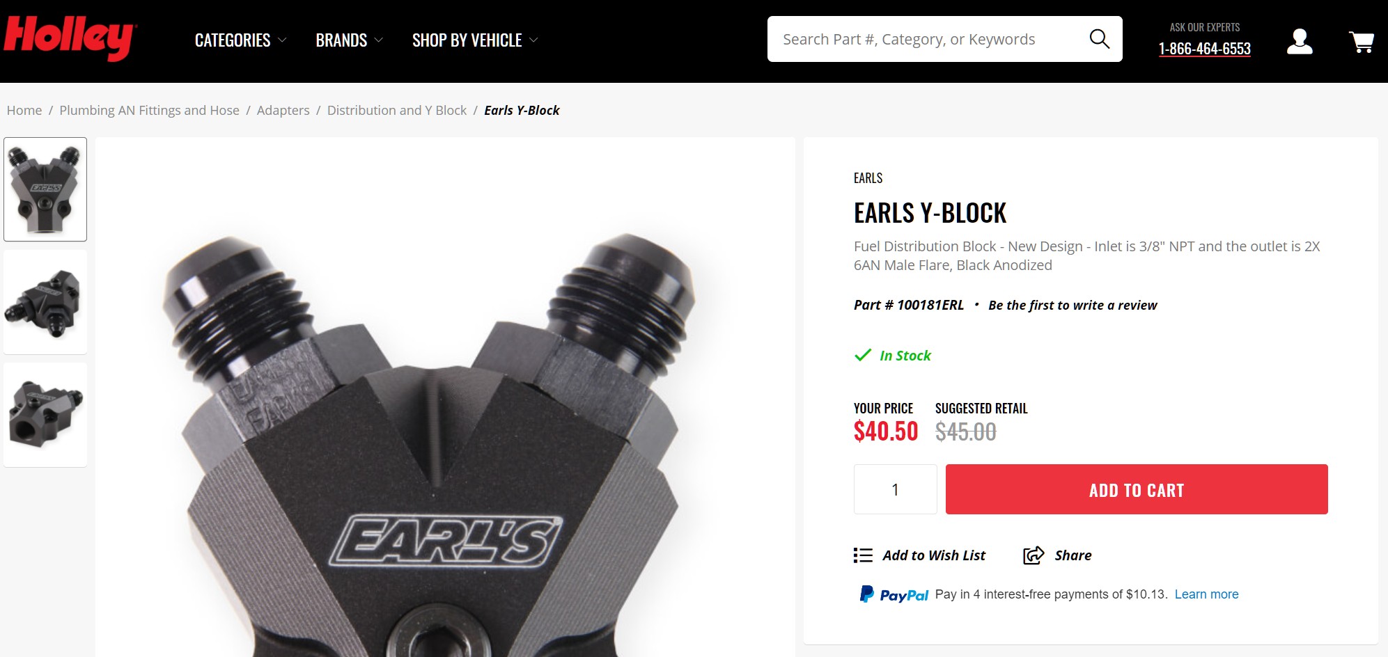

This is the one I have:
https://www.holley.com/products/plumbing_an...parts/100181ERL
So it is an NPT fitting on the bottom. And I guess they never use orings then... ? I really was just looking for AN -6 all around and this is as close as I could get. Hmmm.
-Steve

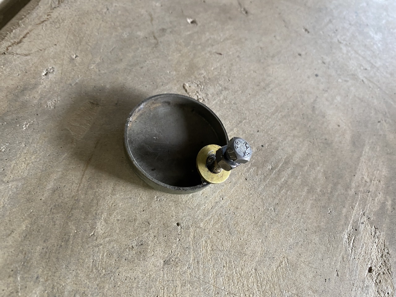

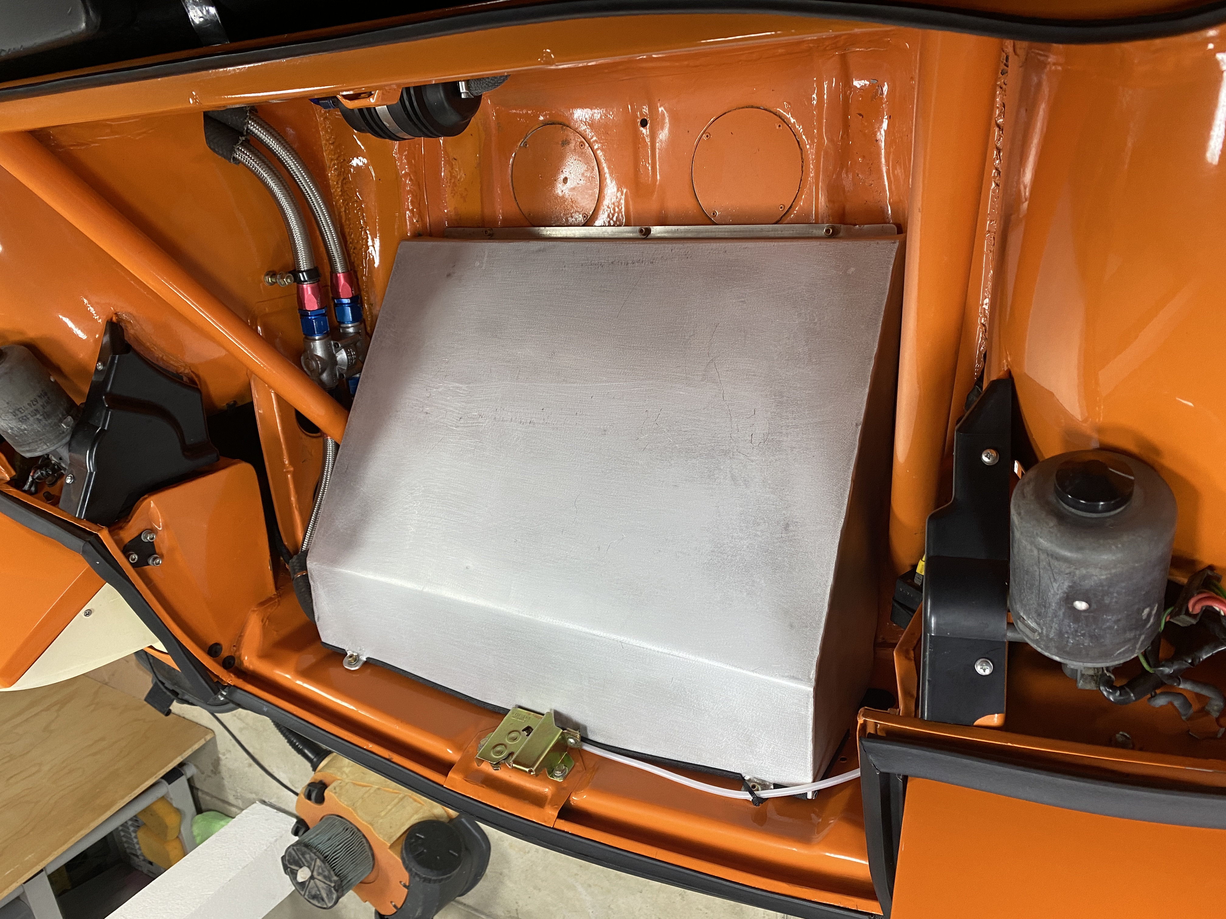

no leaks up here so i put the shroud back on.
i didnt even realize it, but this was bent too from the accident. fortunately was fairly easy just to bend back…
-steve
