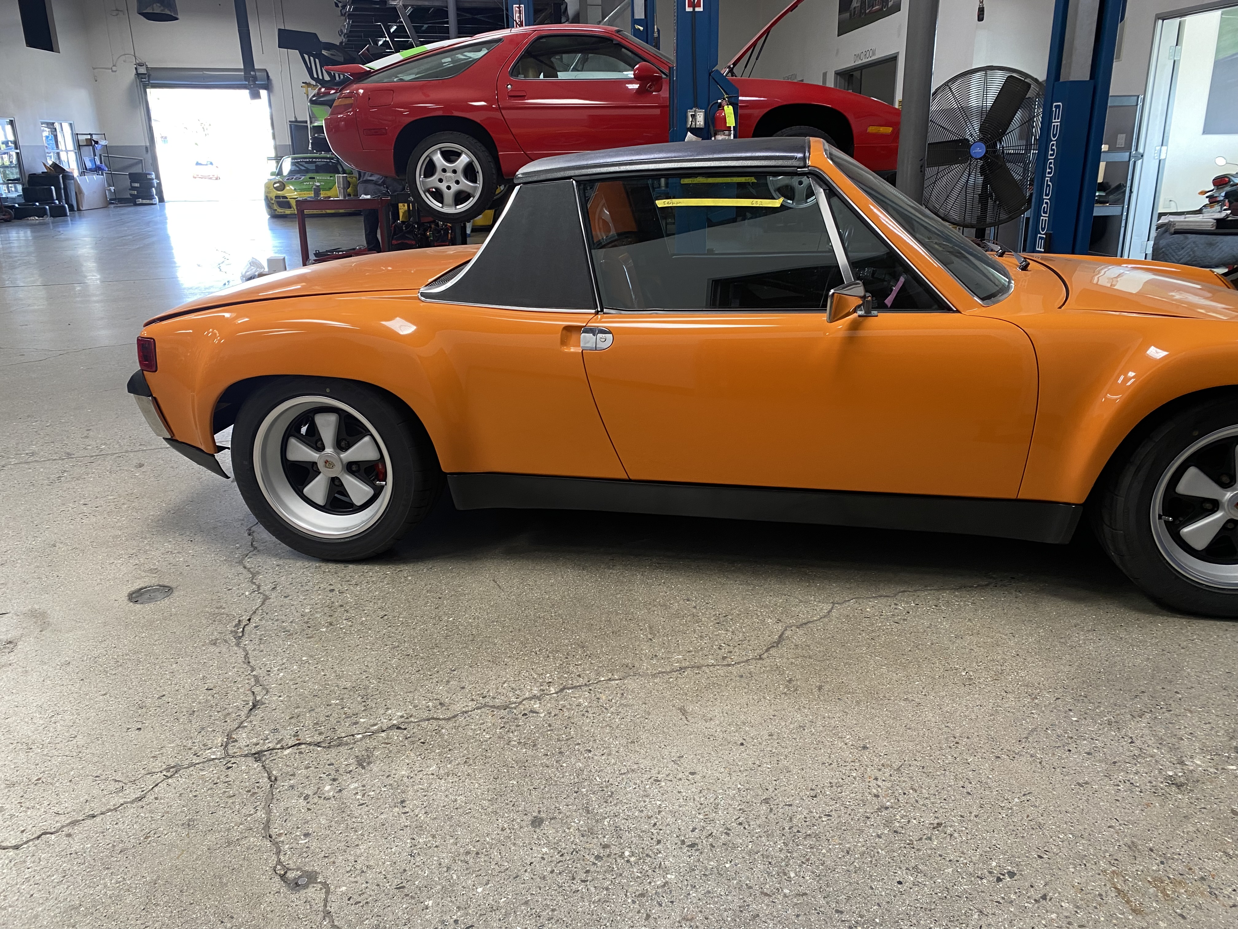

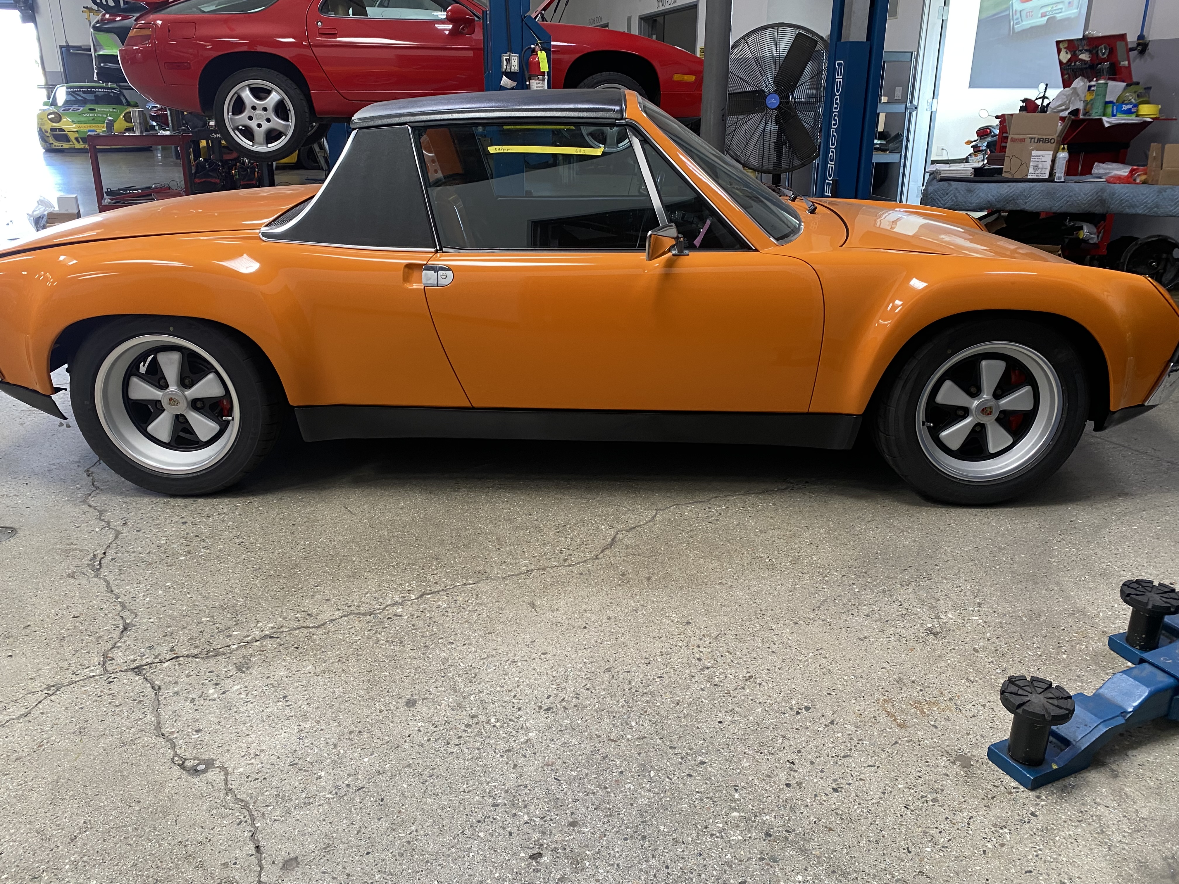

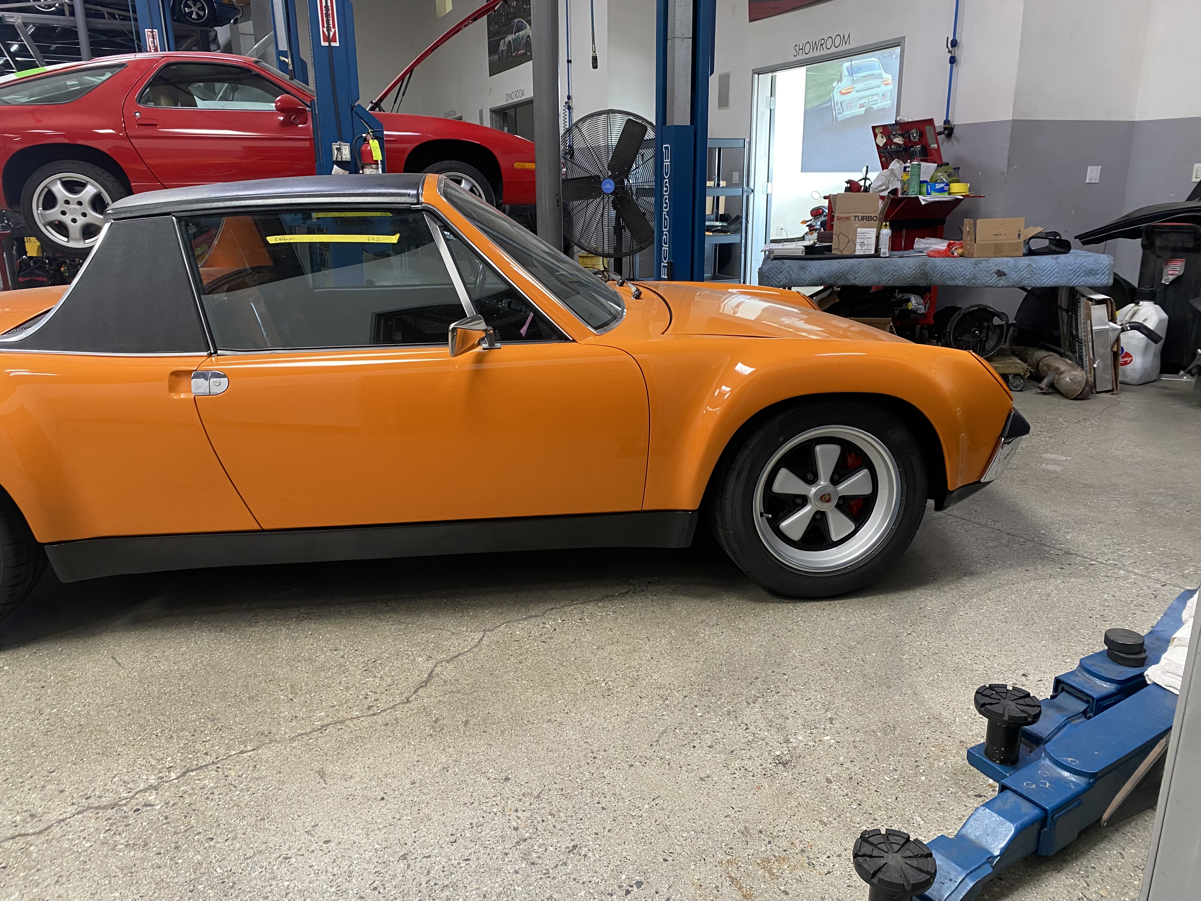

Getting aligned and sorting out the ride height and rake. As is, front is 11mm lower than front. What do you think... ?
-Steve

Is the rear 11mm lower than the front? Looks high in front. Love the car though. (IMG:style_emoticons/default/beerchug.gif)
siverson
post Nov 29 2021, 09:57 AM
Post #388
Posts: 2,458
Joined: 5-May 03
From: San Diego, CA
Member No.: 654
Yes - front is 11mm lower as-is...
-Steve

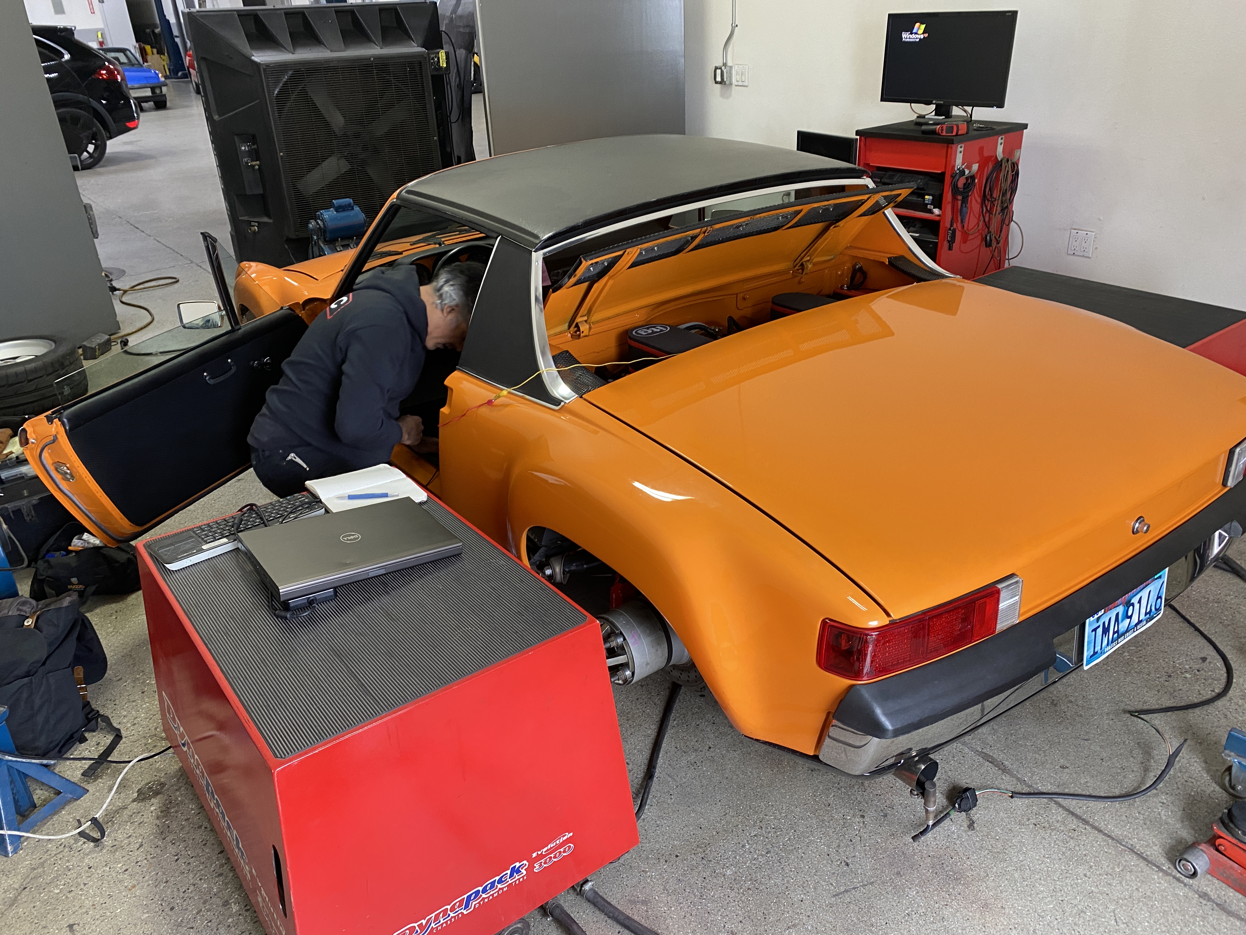

An update, still not done... Car was aligned and after a bit of fiddling it came out great.
Next up was a dyno day to get the new ECU (Vipec/Link) fully tuned and sorted. To make a long story short, leak down was bad on all cylinders. Upon further inspection, the cylinders are way out of round.
So... I took about 20 steps forward but now 3 big steps back. So the engine is out and I'm having it fully rebuilt by 911 Design in Montclair (outside LA). It was rebuilt in 2002 by Andial, but now I'm at it again I suppose.
"While I'm in there" (argh, again?!?!?) I'm going to upgrade from 3.6 to 3.8 (only about $2500 more in parts and machine work needed) and probably going to upgrade the Vipec/Link ECU to the latest model since now the one I've purchased is about 7 years old.
So... stay tuned... Aiming to be all done April 1, but we know how that goes. The biggest lead time is machine shop has a massive backlog due to employees out with Covid or something.
-Steve

Dyno day...
-Steve

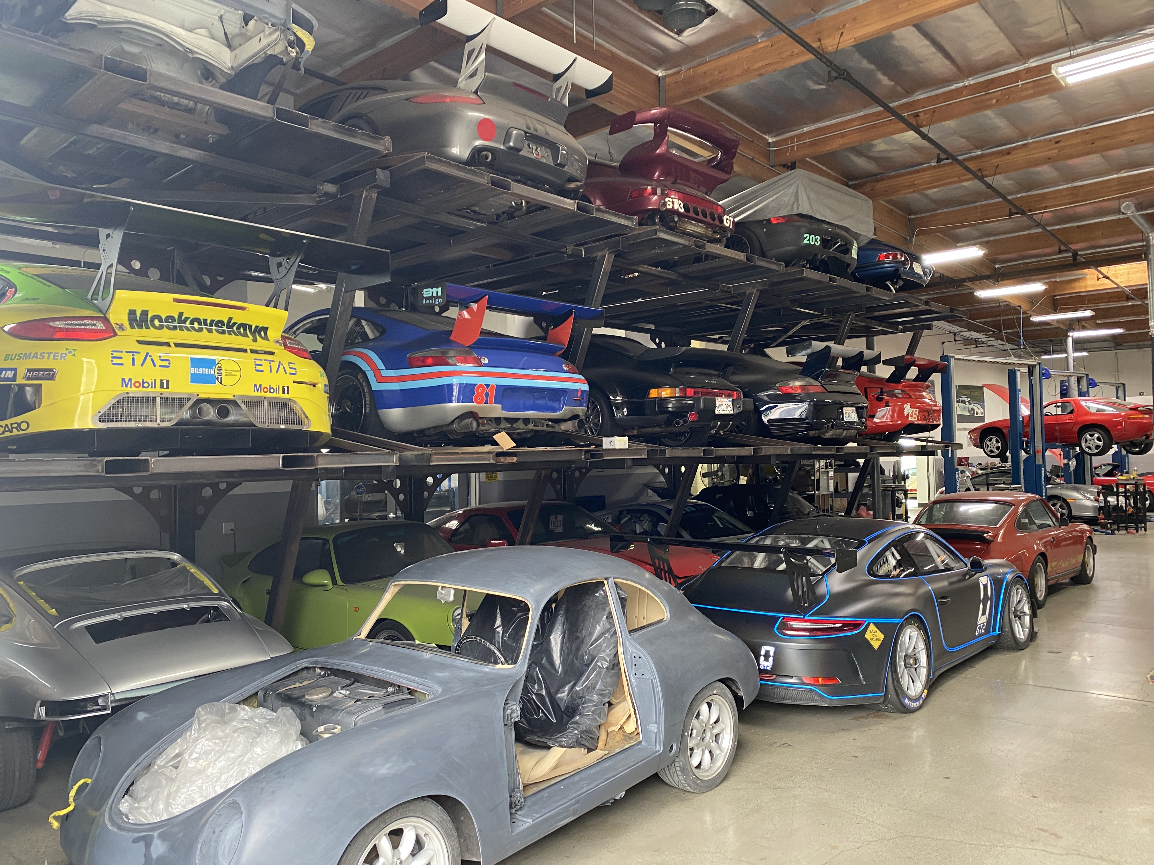

Shop photos...

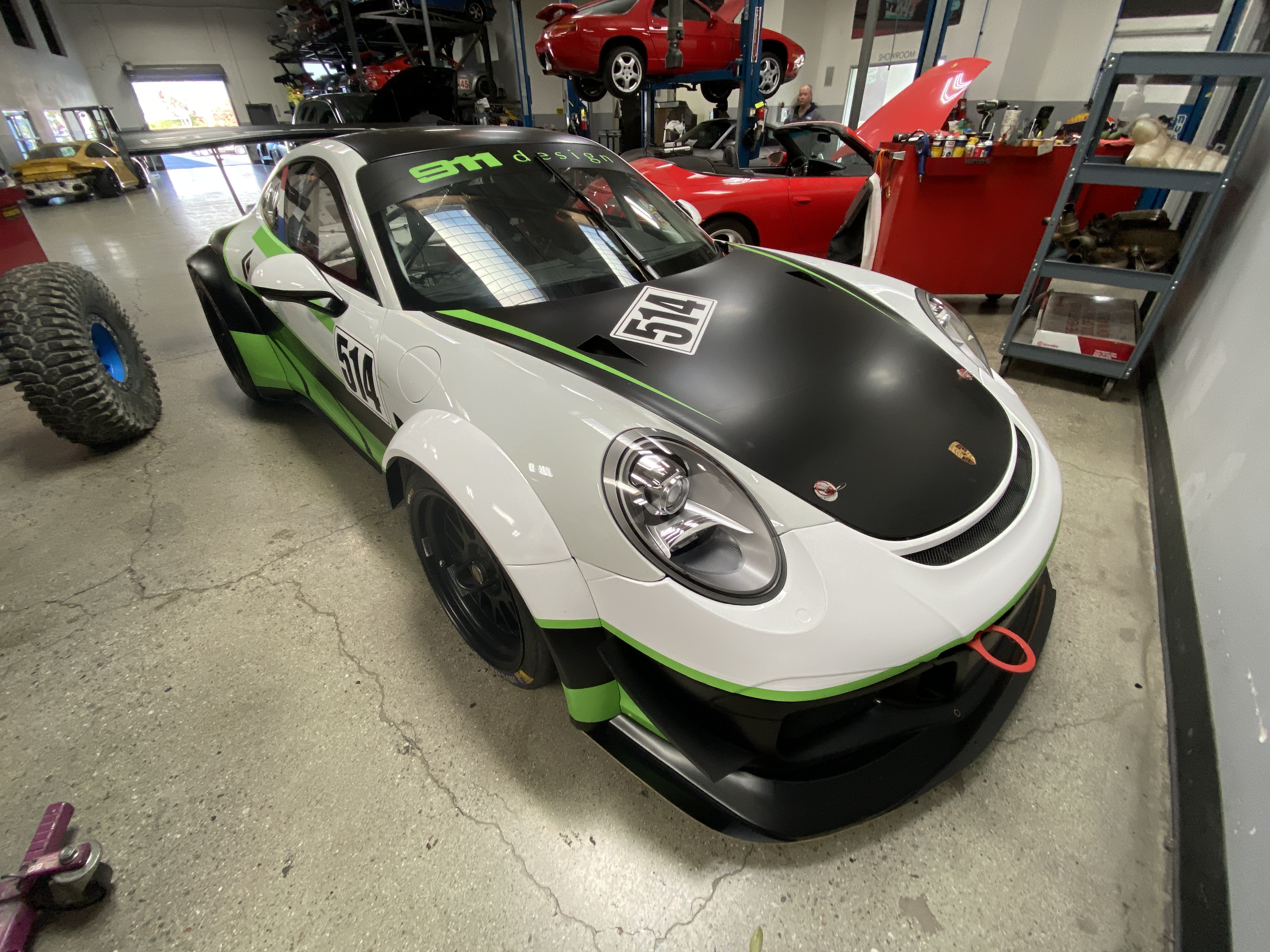

This one looks fast.

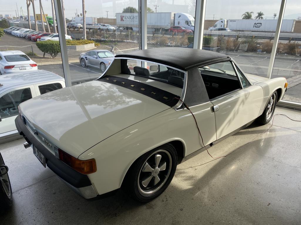

One of the owner's cars.

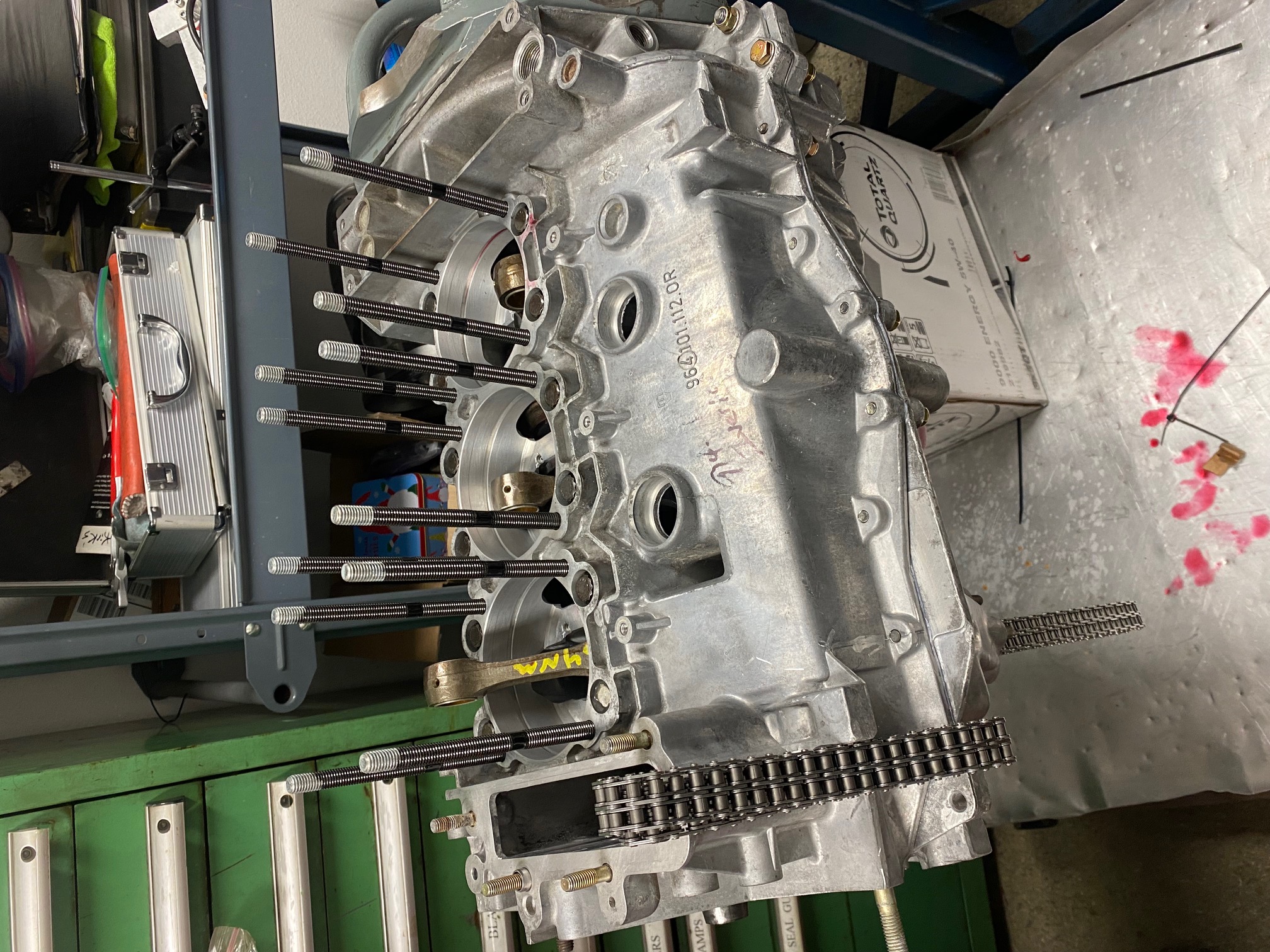

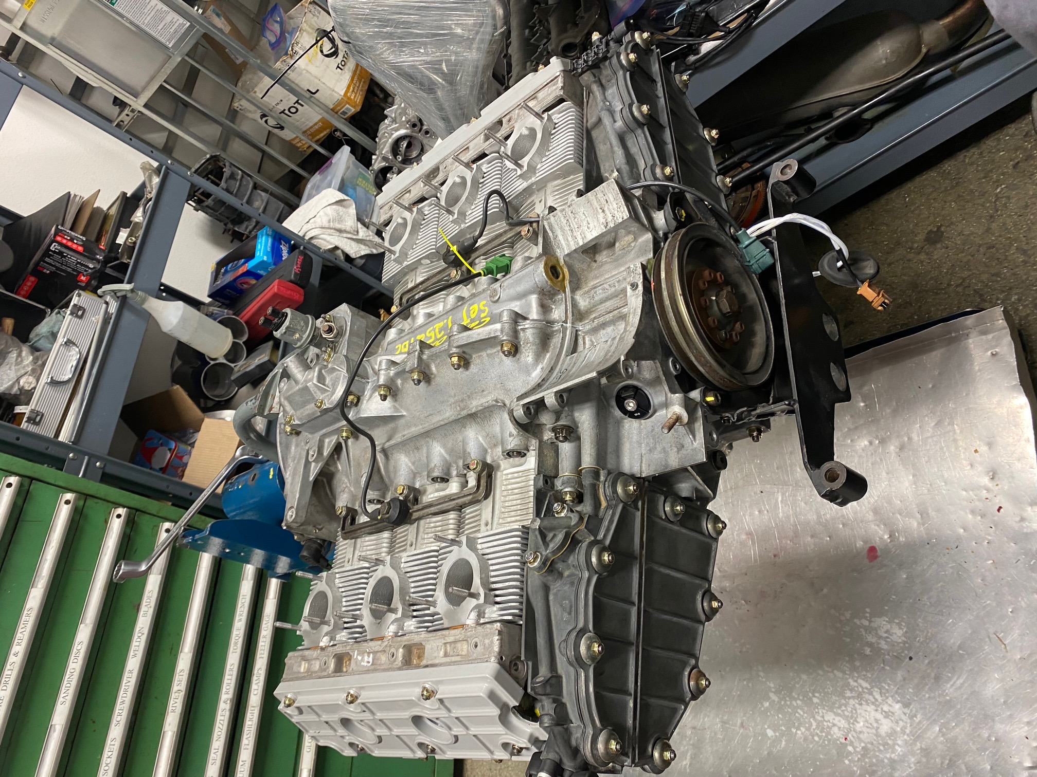

Machine shop was backlogged, but making some progress again now. Bottom end is assembled.
-Steve

Curious did you look at the cost of going to 4.0? Pro's and cons? I asked PMS about the 3.8 and they said its not that much of a power difference over a 3.6.
Right. It's not much more power but it's "only" a $1,500 difference on an expensive rebuild. And at the time 3.8 was available and 3.6 was who knows when.
I think going to 4.0 was a lot more because a lot more machining was required.
-Steve

QUOTE(siverson @ Apr 11 2022, 10:38 PM) *
-Steve
Going 4.0 requires machining the spigots to get the cylinders to fit. So there is that extra cost.
