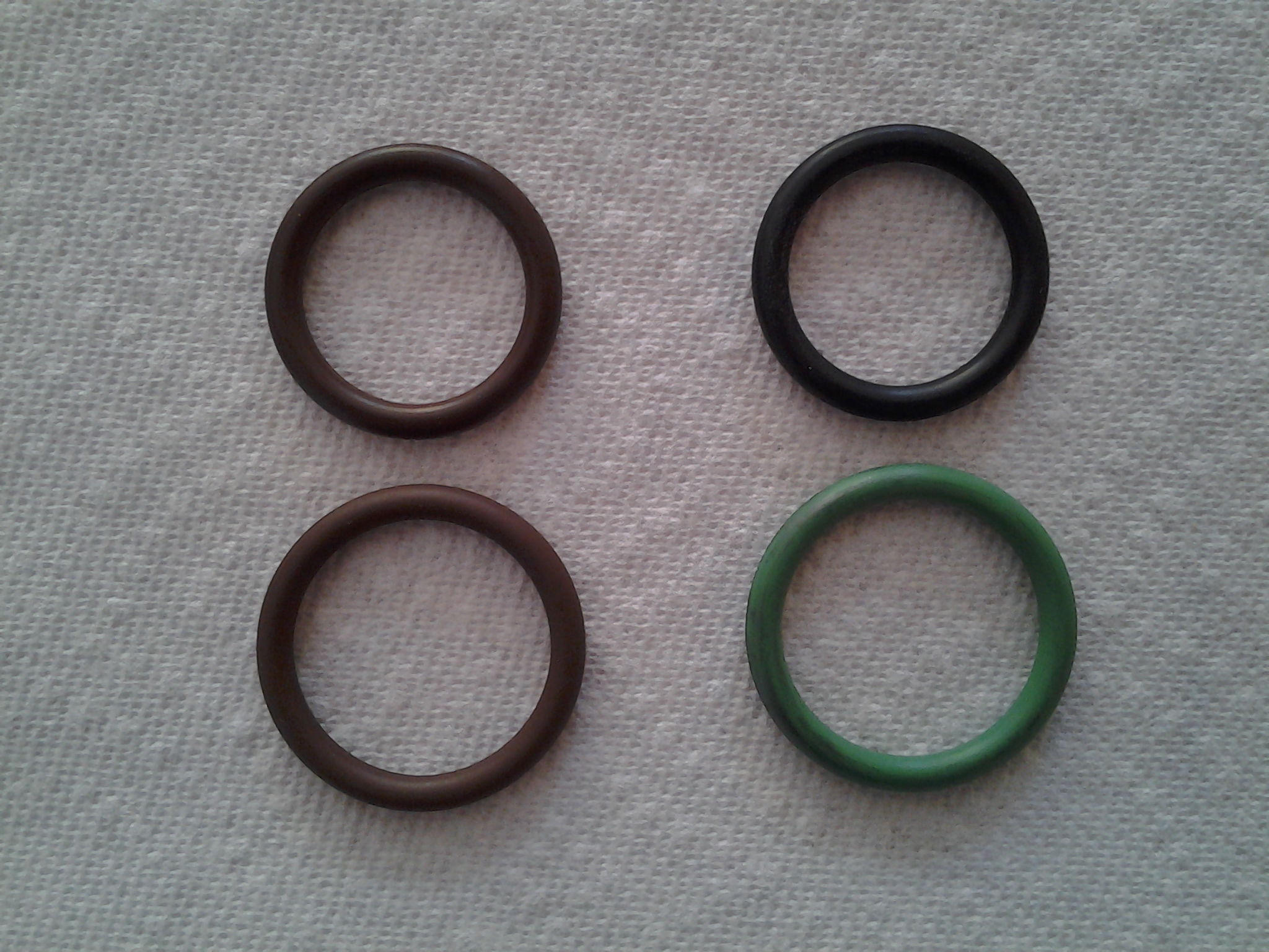

I have new pushrod tubes seals that are black and green.
The ones from my donor engine are almost new but brown.
Any difference in quality between the old and new? Someone said that the one in the buy gaskets kit are junk and I should use viton ones. Are those the brown ones?

Green

I remember most of the Viton o-rings that we used to get were brown. The green and red and black were silicone (different sizes I think?) and weren't as durable.
Things might be different now, though. That was from ten years ago or so.
