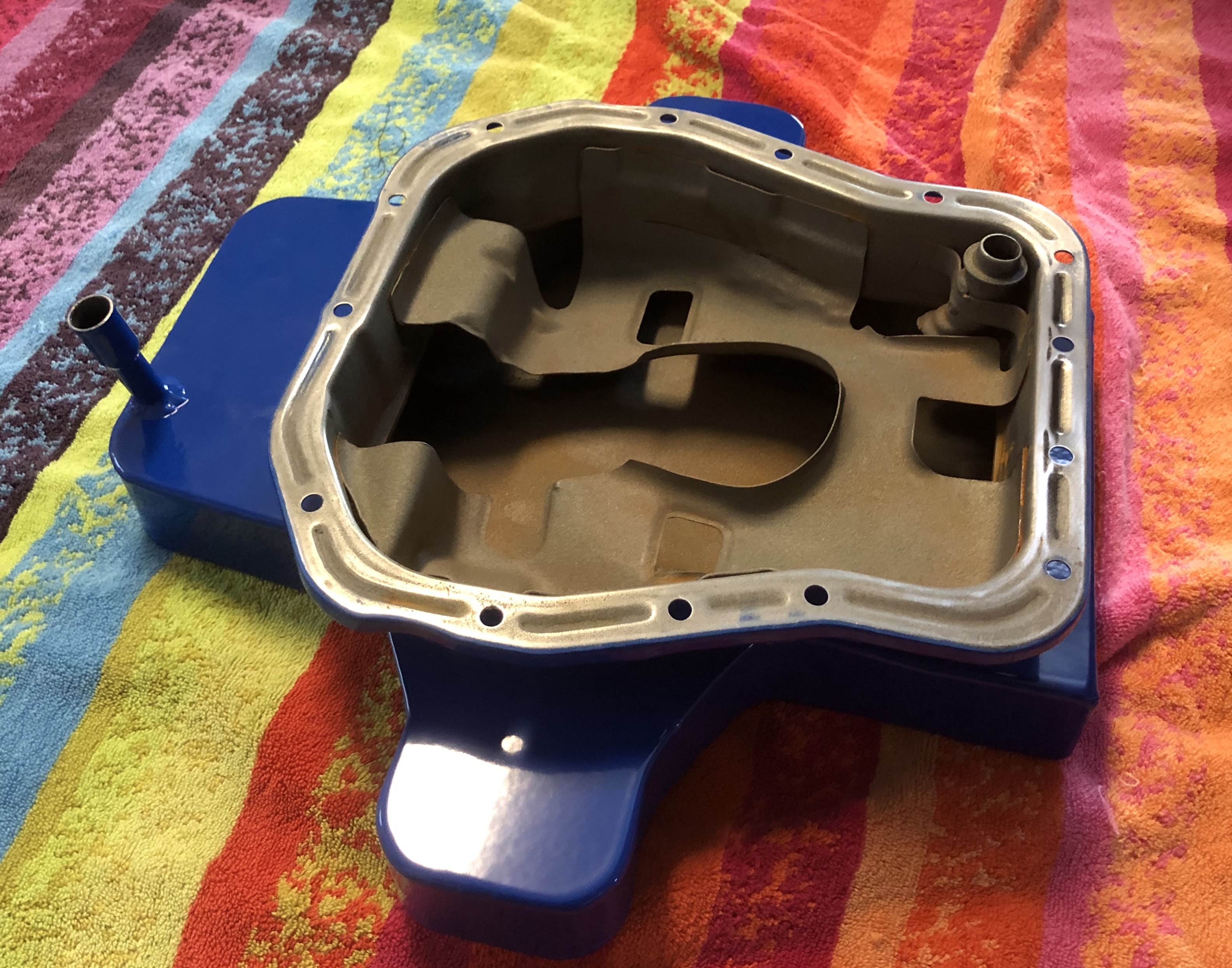

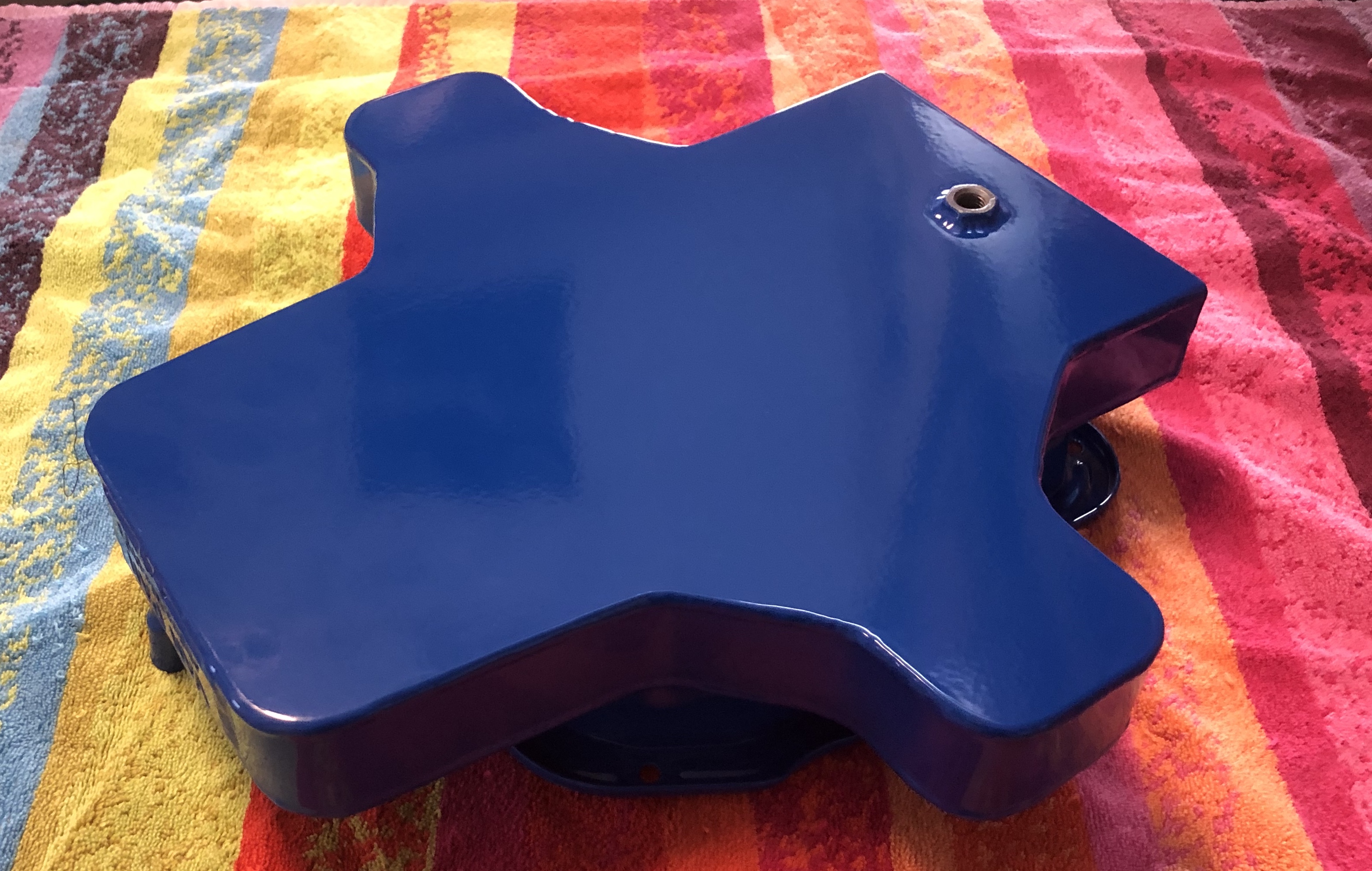

New pan back from powder coating!
New Wireing harness and computer being sorted out by Jeff R.
The EMS stinger was top binary and fought with altitudes.
Out with V1 shortened pan and in with V2!

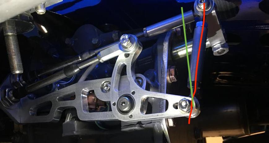

I think you've got a problem with your linkage.
I mention it because your photo shows exactly the kind of mounting that I did with the ZeroDB linkage that was incorrect.
The little arm that mounts to the transmission output shaft should *not* be attached at the existing hole in the linkage. It needs to be mounted as close to the taper as possible, with the goal (and heres the important part) of the linkage being as squared up (i.e. 90-degree angles everywhere) as possible when the transmission is in neutral.
If the arm is mounted at the stock hole in the transmission output shaft, the angles are not 90, and the shift pattern at the shifter will feel not like an |-|-|, but much more like: |-\-/ because of the bad geometry.
On my race-car, the bad geo at the shifter resulted in 2 (!!!) mis-shifts at the track. I ultimately found the bad geometry, drilled a new hole in the output shaft, and sternly suggested to ZeroDB to send instructions with their kit.

Thank you Matt!
I was told after the fact what needed to be done. I will be correcting this when I pull the transmission (probably next week). Need better gearing for the race track that is so cal.

Transmission geometry fixed.
Transmission back on motor and unit back in car.

Had some clearance issues with this pan due to the cradle. Had to go with a shortened pan (but 1/2 inch deeper than my previous pan).
