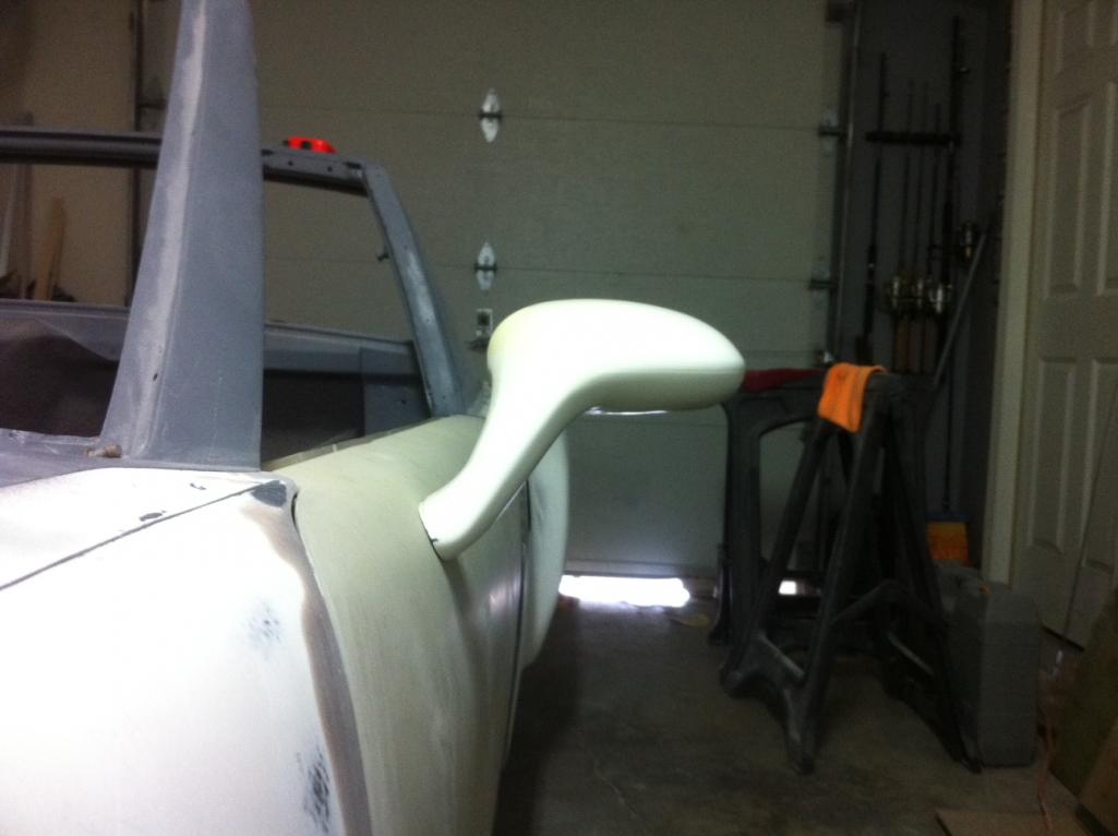

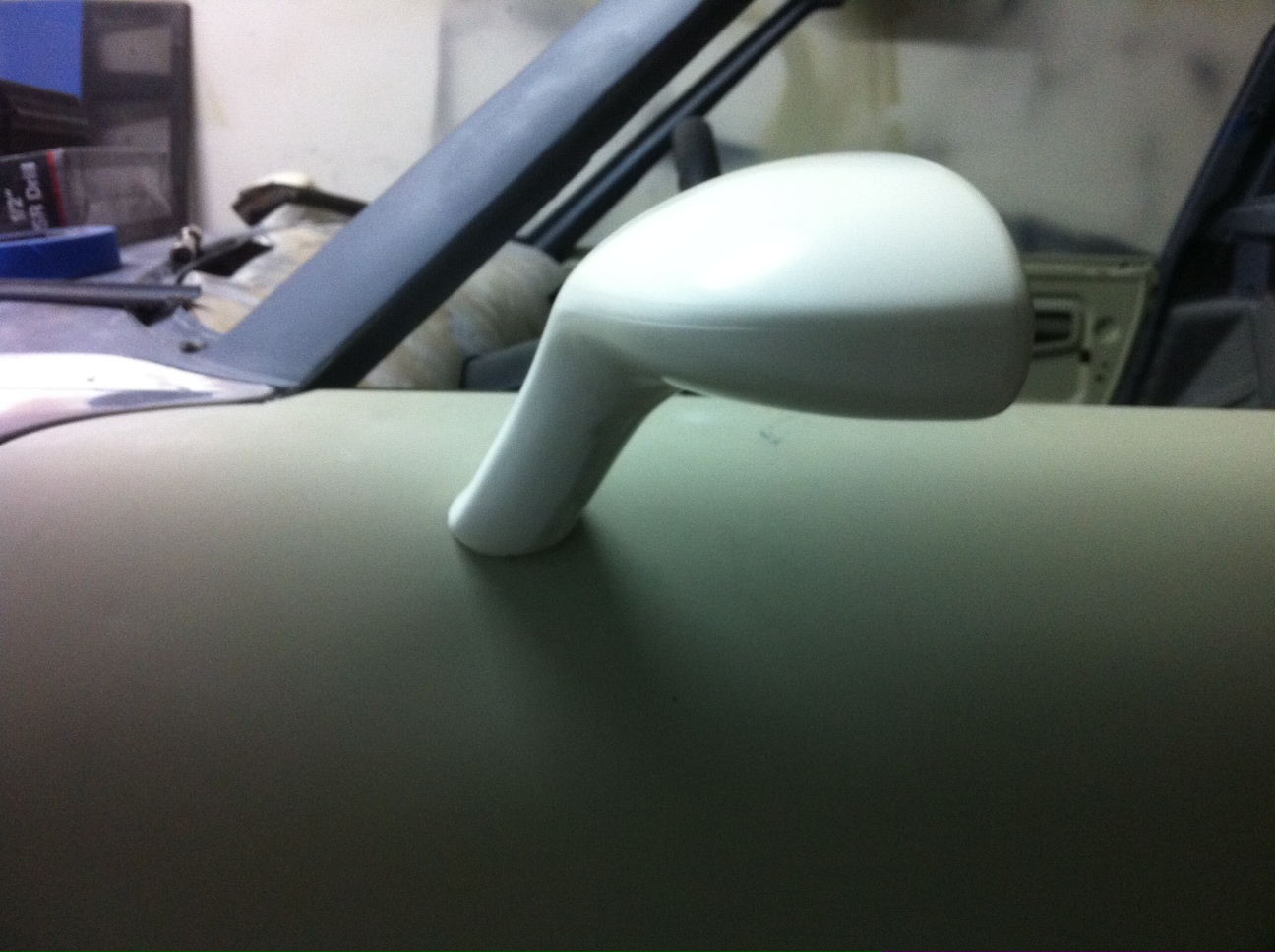

start mirrors
effutuo101
post Apr 9 2012, 04:35 PM
Post #92
Posts: 2,735
Joined: 10-April 05
From: Lemon Grove
Member No.: 3,914
lunch time work... (IMG:style_emoticons/default/stirthepot.gif)
