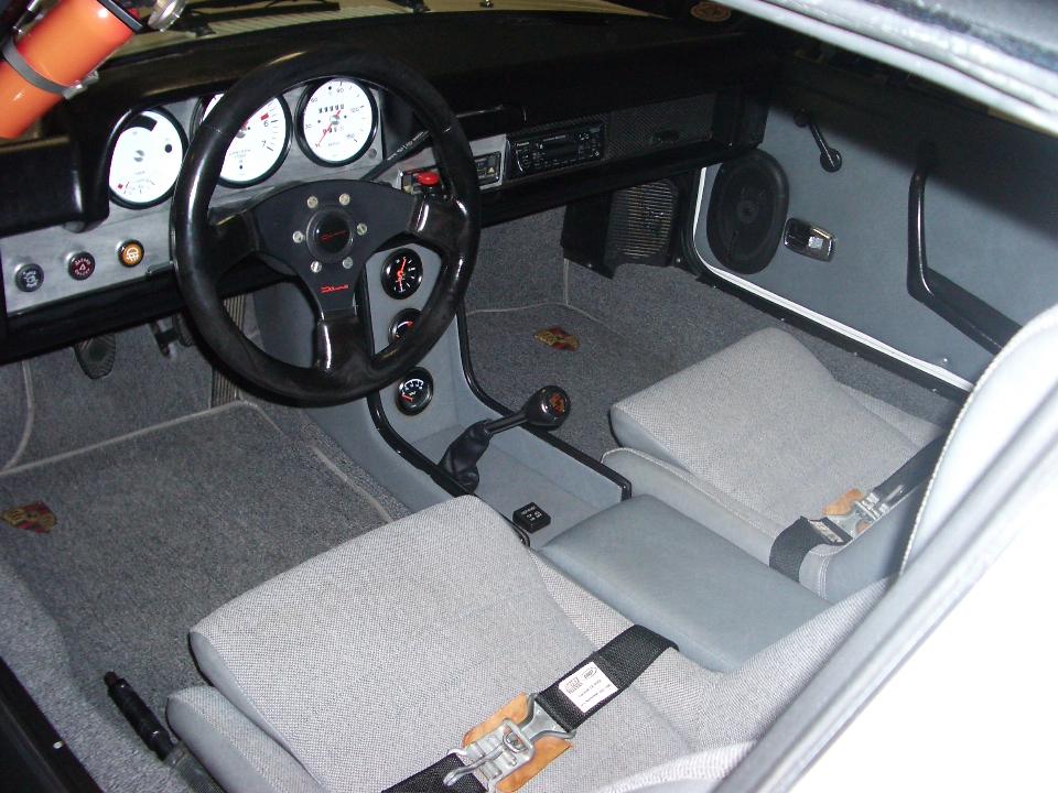

Yes.... got 2.. probably should upgrade though. Steve

Some people suck... you suck lots...
DAMN THAT IS A NICE INTERIOR!

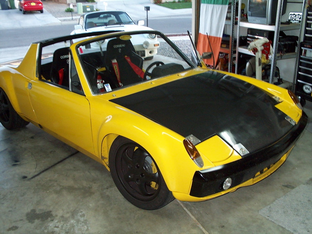

In between the seats:
