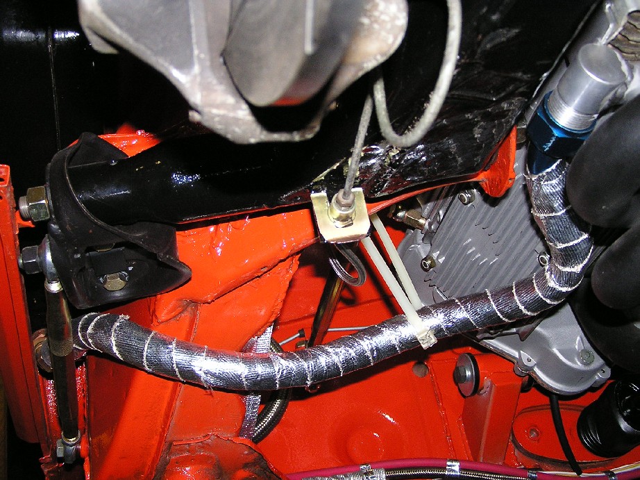

Installed some heat wrap on the oil line from the tank to motor... Intention is to keep some of the header heat out of the oil:

Here's another thing to think about. I wrapped all my lines on the race car but found that when I washed the engine off after a race weekend such as at Phoenix where it rained, they became a soggy mess and would generate tons of steam when they got hot. I finally took that off and made some removable blanket types for the lines.

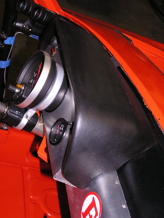

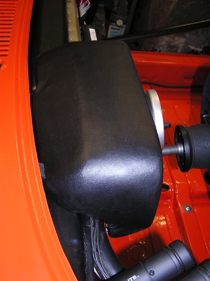

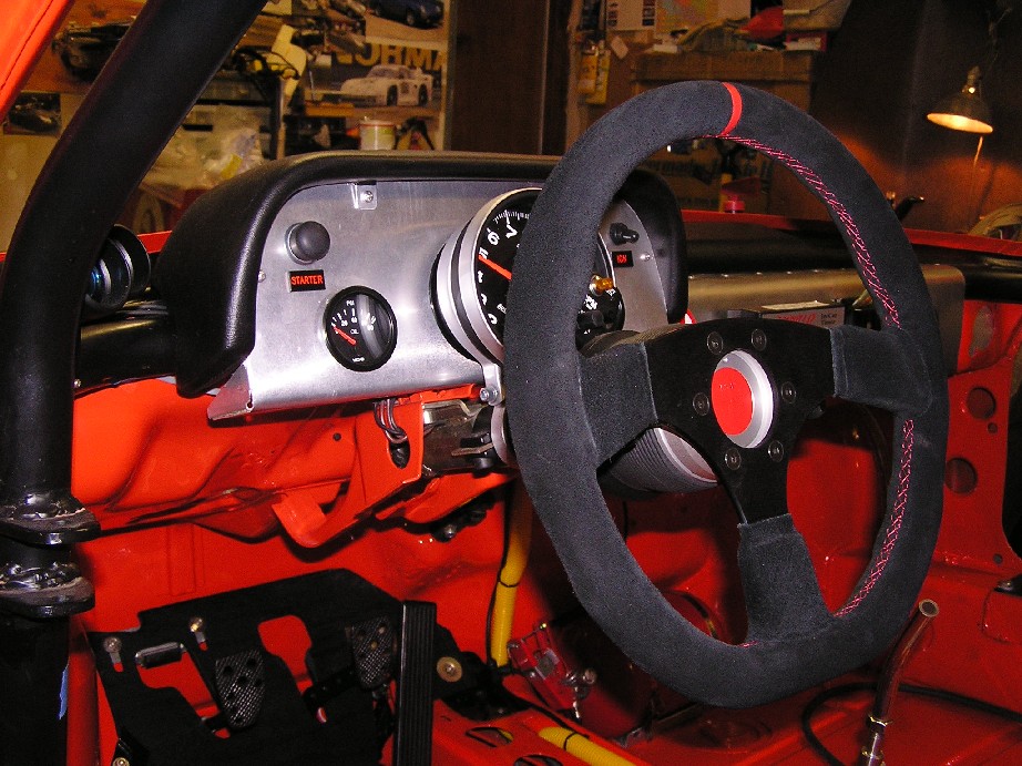

Well, the dash top or pod over the gauges is finally installed and complete. I've got to throw out a HUGE thankyou to Dr. Evil on this one. Mike did such a nice job getting it smoothed out and covered. It was really in bad shape and cracked. Since the dash is moved forward about 6inches from stock, we had to custom shape all of the edges to fit the non-stock dash contours:
more good advice.
I know the orange heat cover and the silver heat cover on all the fuel lines are the blanket type, but the one on that pictured oil line is a wrap... Its and adhesive style that may or may not give me problems. I'll definitely mull that over and watch it. Thanks again John.

Hope people aren't sick of the dash pictures yet.
It was such a ton of work and I'm really happy with the way it came out. Probably explains the shutter happy picture count:

Last dash shot. You can more clearly see some of the custom contouring that went into making the pod fit the remaining dash:

(IMG:http://www.914world.com/bbs2/html/emoticons/drooley.gif) Clean parts!
I love the dash! Race bread, but still 914, great work! I love pic's, so snap away and post my friend! (IMG:http://www.914world.com/bbs2/html/emoticons/boldblue.gif)

Thanks Dan. Regarding the dash that was exactly what I was shooting for. 914 - looking.

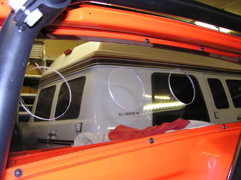

Last of the pics from this work weekend. We installed the lexan rear windown. On the passenger side it has venting for interior air comfort, that we cut out. Here is the view from the inside.
The big white beast (through the window) is my new to me tow vehicle:

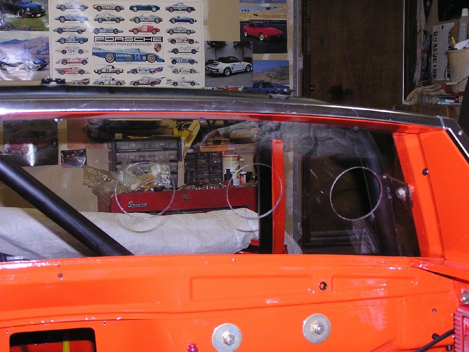

The view from the rear:
