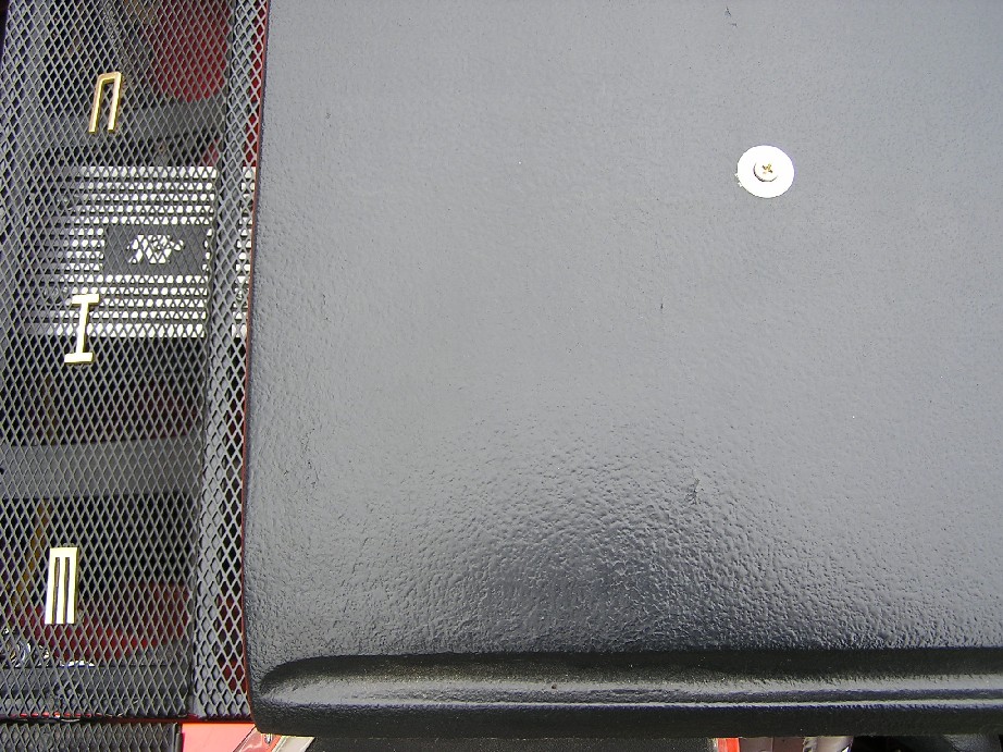

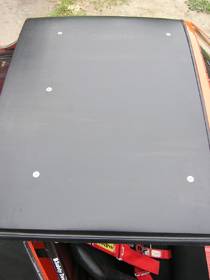

I have a few pics of additional build items. Here are the fasteners for the roof:

and a more close up shot:

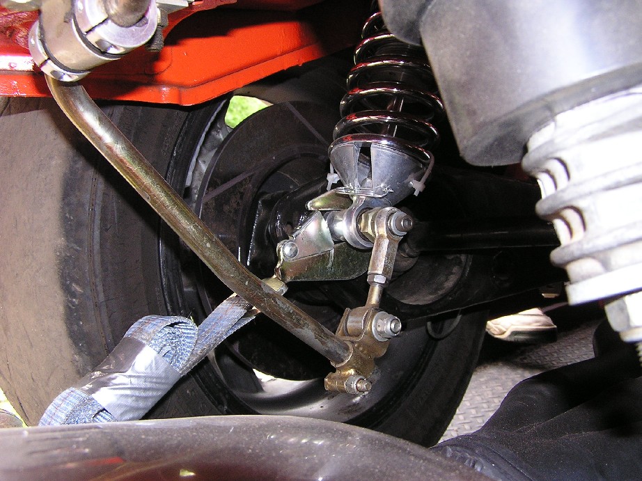

Here is the rear drop links that dad "shortened"
you can also see that the car is strapped down in this picture and we are using those rear shock spacers/bolts as a tie down point:

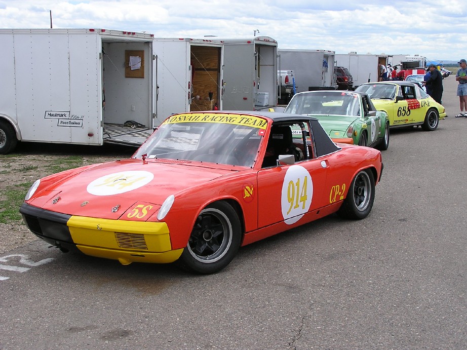

got all the decals on.
they came out nice.
I would of rather had one of our club members do it, but just couldn't get the timing to work out:

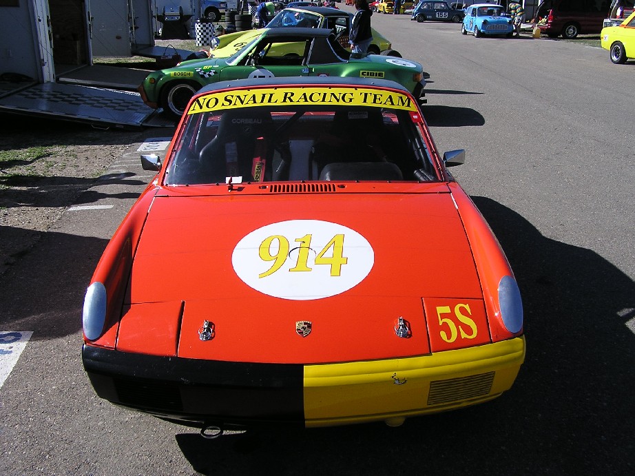

repeat front view of the windshield banner:
brant

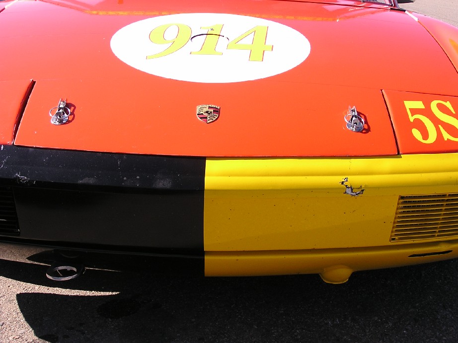

As mentioned above... car got its first scratch.
very repairable.
the bumper got cracked and is pushed back a little bit (under the hood)
I think a little glass work and a reshoot of the bumper and it will be fine.
you can see the damage on the yellow side more than on the black side:

Hummm, I stopped using metal to metal at the car for the tie down points as there was a lot of rubbing going on which can easily create stress raisers. I use some loop type straps instead now at the same place you do. I still use the metal hook at the trailer though.

John, good point... and you have given me a ton of good advice. The aluminum is just a spacer and doesn't carry the strength of the mount, but still worth keeping an eye on it.
