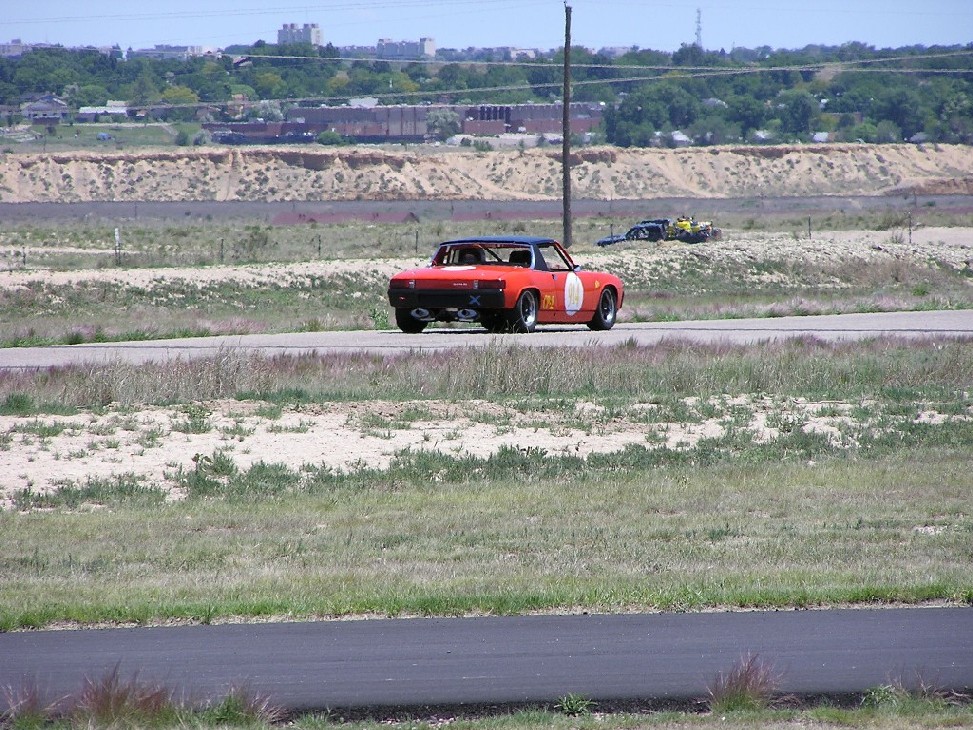

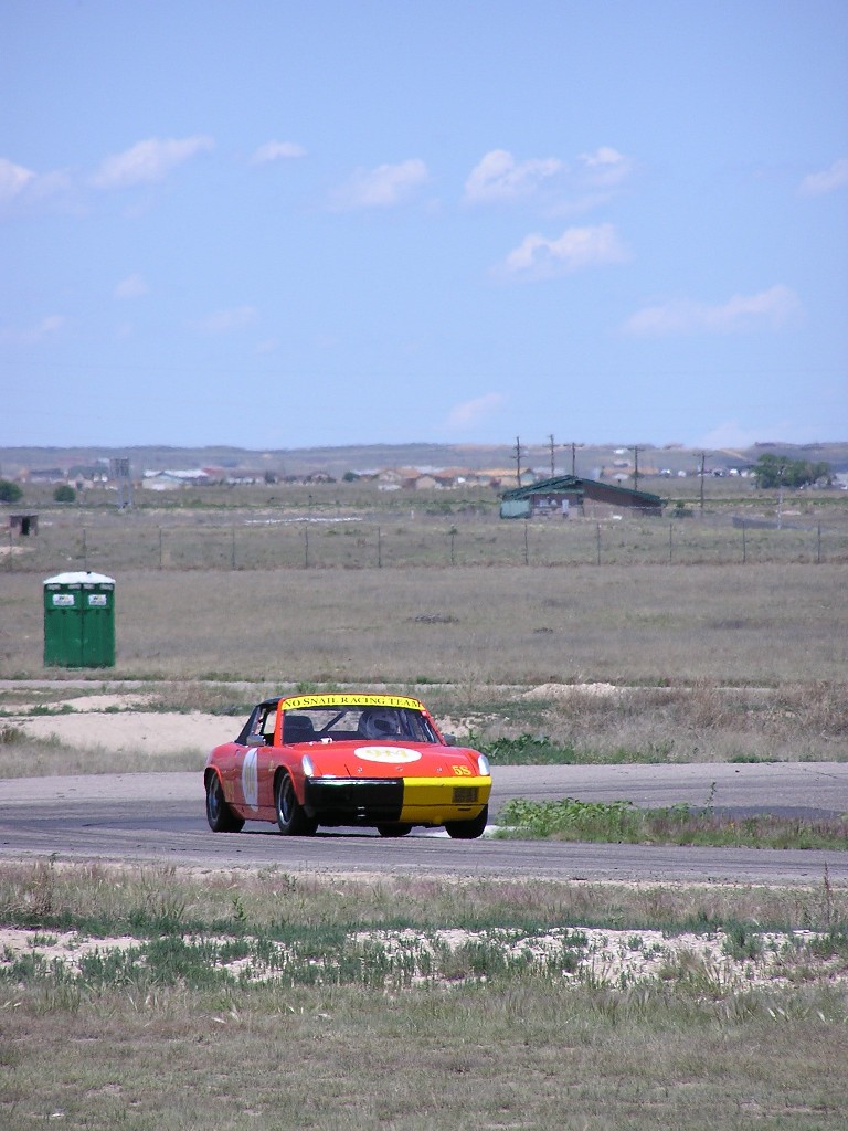

Laura took a coupld of action shots for me at the race.
Here I am coming out of a hair pin corner:

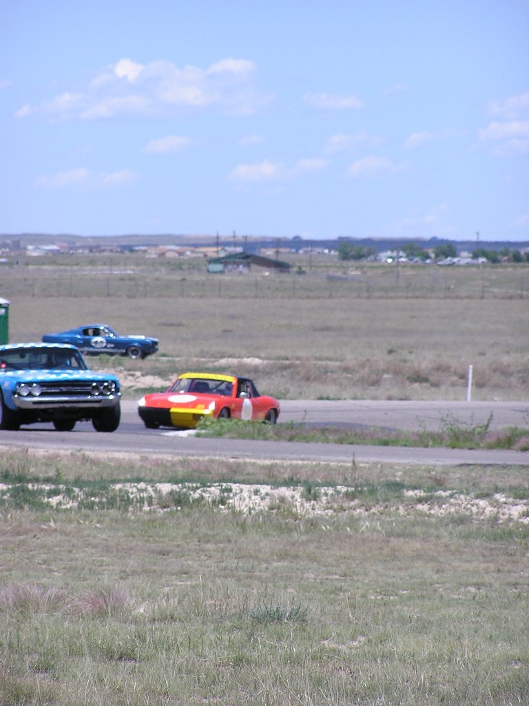

Here I'm actually passing someone..
whoo... hooo...

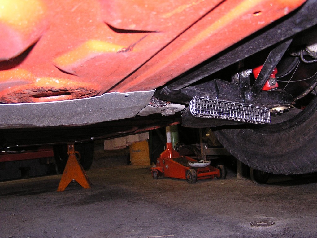

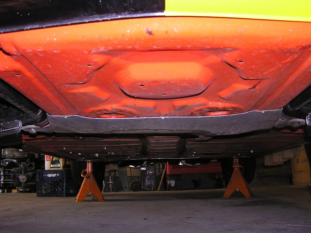

This one is the underpan for the front MC and fuel pumps.
Its aluminum of course:

Here is a shot of the stainless grill over the brake ducts...
Its amazing how much rubber gets inside the vented rotor without the screen:

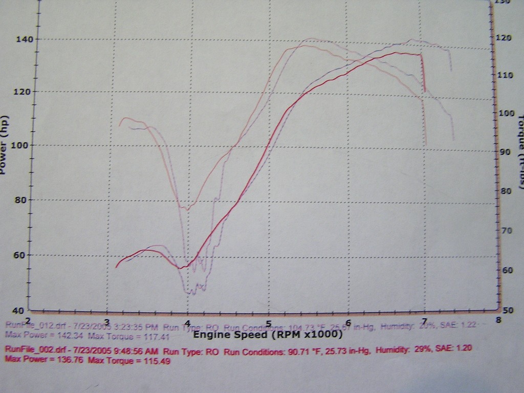

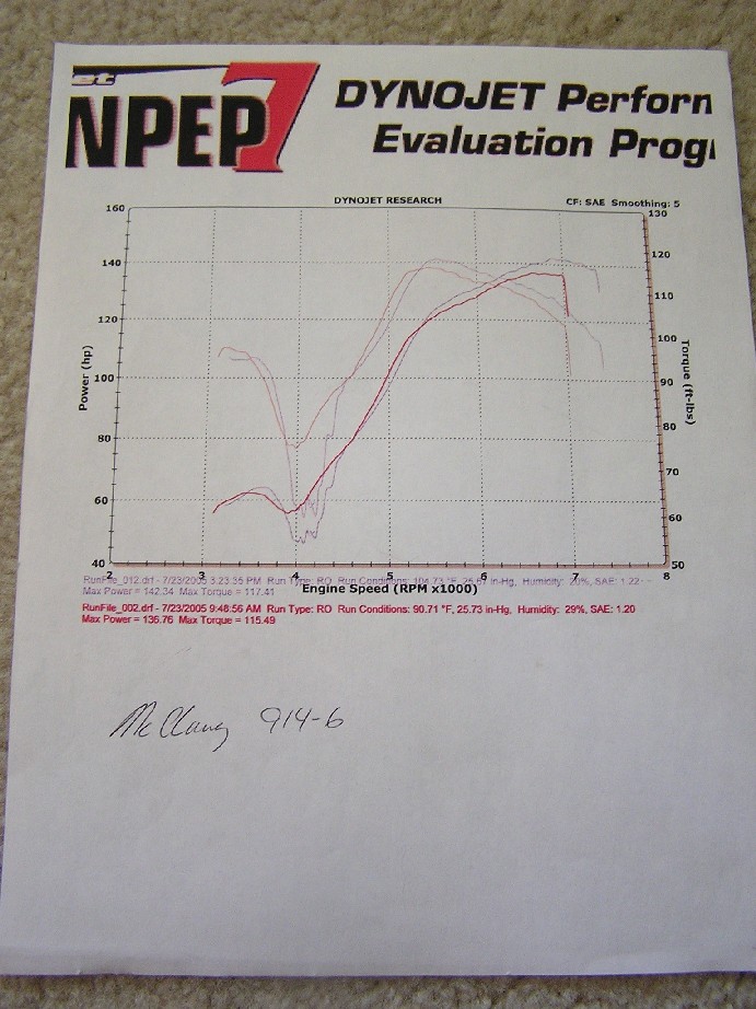

About a month ago we trailered to Grand Junction and got onto a chassis dyno to tune the carbs. We were there from 8am until 5:30 and got 12 pulls in during the day with lots and lots of tuning inbetween. The temp grew significantly from 90degrees to 104F.....
very happy with the results.
I picked up a stutter for sure, but I'm going to customize/modify a set of emulsion tubes to try and cure that. Over all still very happy with the dyno work and the motor for just being such a stock 2.0S
brant
post Aug 29 2005, 05:01 PM
Post #409
Posts: 12,112
From: Colorado
Member No.: 47
a tiny bit more legible. This was at the wheels, at altitude, and at 104F

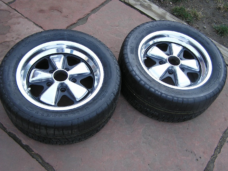

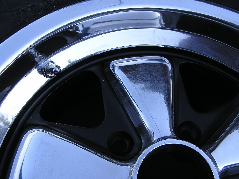

We started refinishing wheels.
Dad did all the work.
only the first 2 are done so far but they came out great!
they were a bit curb scratched when he started. He hand polished them and then we masked and shot with a wheel paint:
brant
post Sep 15 2005, 10:38 AM
Post #411
Posts: 12,112
From: Colorado
Member No.: 47

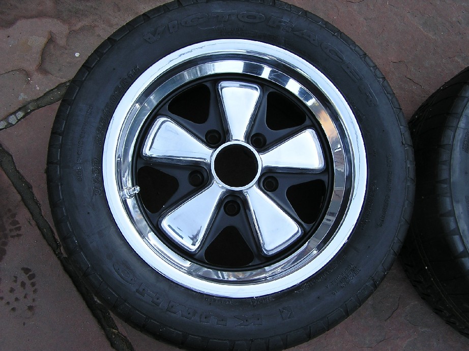

7 inchers to replace our cookies:
brant
Post #412
Posts: 12,112
From: Colorado
Member No.: 47
new tires will be fun too:

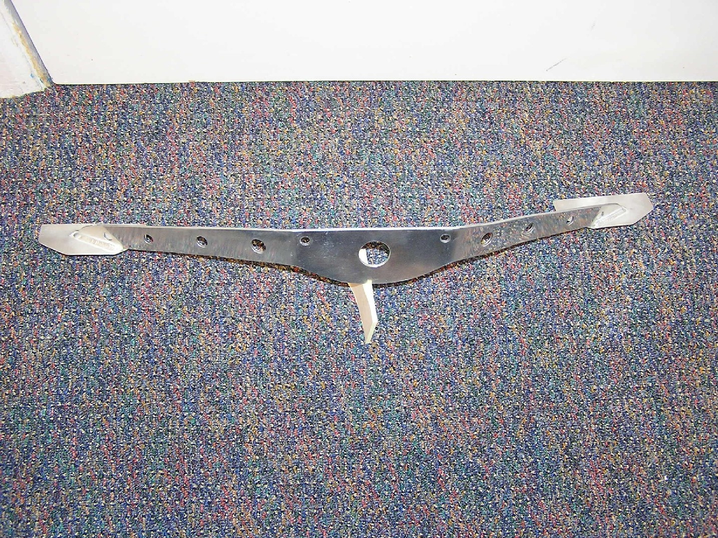

Here is the new muffler bracket.
smaller, and lighter than the old one.
about 50% weight reduction in just the bracket:
