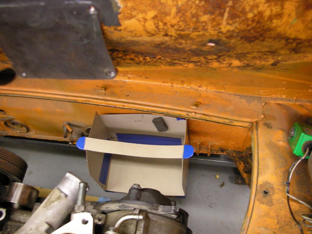

Oh and I did have to cut a hole in my rear trunk today, so the first cut is done. Glad I am past that!!!! I had to make clearance for the clutch line. Might elongate it a little and pickup the fork, that would allow me to bring the engine up a little. But then we will see.

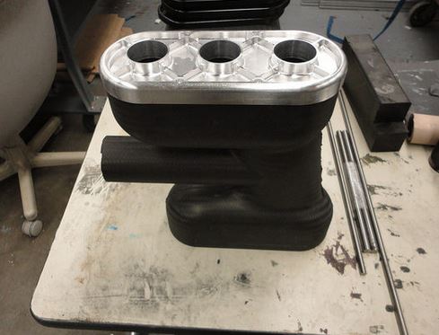

Intake Manifold build for EG3.3

Wow...I definitely don't have the skills for something like that. Cool though. The two hole-d throttle body is definitely a pain. Not an insurmountable problem but a pain nonetheless. Would be easier to pipe if it was one like the EZ series. Rocky Mountain Westy makes an intake for the Vanagon but it's $400 and doesn't do much more for the 914 setup than stock. Unless you flip the intake or use something like I did (3000GT intake) you have to use the stock setup and do a lot more cutting of the firewall.

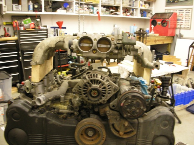

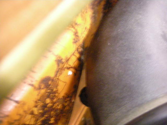

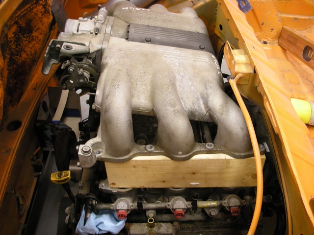

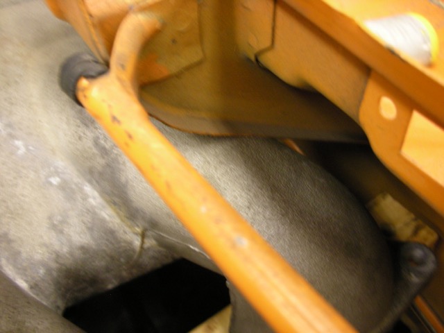

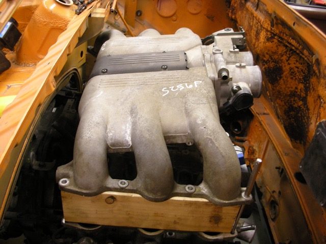

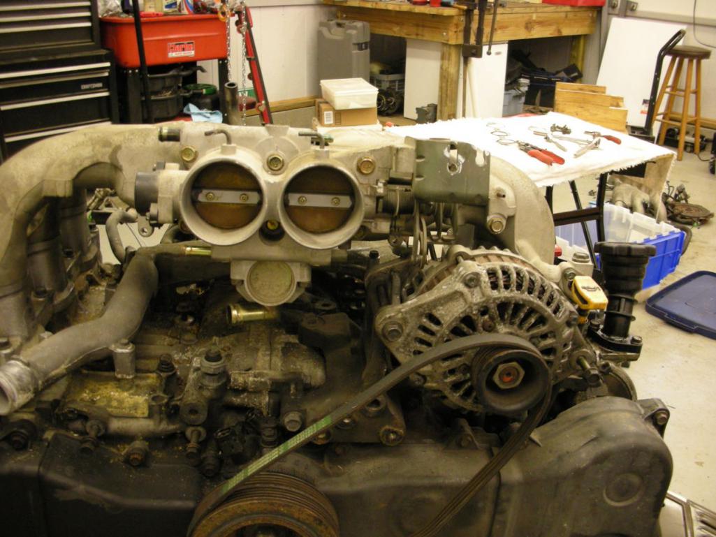

Okay I did a little experiment today with the flipped manifold. It will work, sort of (IMG:style_emoticons/default/screwy.gif)
You will need to raise the intake up 3.75 inches, if you leave the alternator in its stockfish position. And yes it still clears the engine lid with out a rain tray. Now for the but!!
I took the PVC vent piece off the TB, made it that much easier to fit stuff up. That thing is huge!!!!
Now if you use the stock snorkel, you run into an issue. It needs to move back 1.5 inches rearward. It would just clear the firewall, but you might like to add a dent just to give you a little extra space. And you will have to clearance the latch brake for the engine lid. But no more cutting in the rear trunk, except for the slave cylinder banjo fitting.
Heres the pictures!

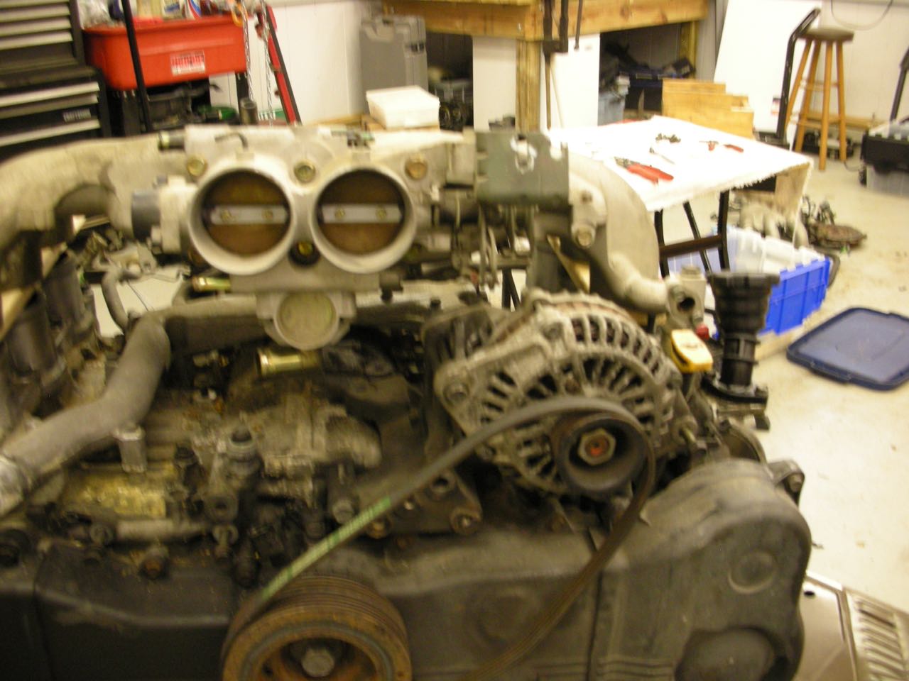

Here it is with out the snorkel, might still be able to make it work!

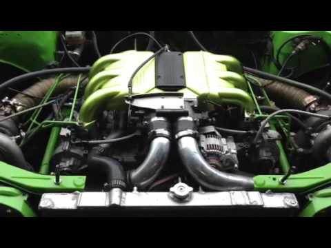

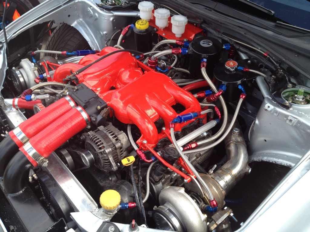

Wouldn't it be easier to relocate the alternator? Need that A/C compressor? I think SmallCar or someone even sells a new bracket to do that. You might want to check, if nothing else than to see how they do it.
(IMG:http://www.914world.com/bbs2/uploads_offsite/i.ytimg.com-2618-1422761896.1.jpg)
(IMG:http://www.914world.com/bbs2/uploads_offsite/i.imgur.com-2618-1422762111.1.jpg)

Now there's an idea- twin turbo your EG33!! What trans would you use that wouldn't blow up?? (IMG:style_emoticons/default/w00t.gif)

I have one with the flipped stock alternator if you don't want/need A/C.
Ditch cruise control also and you don't need to raise the manifolds at all. If you want cruise, then you will need 3/4" blocks. Might not be a bad idea anyway. Get some heat transfer out of the all aluminum heat mass.
With out blocks cruise control piece hits alternator, use smaller alternator, or.....
Much better (IMG:style_emoticons/default/aktion035.gif) Sorry for the blurriness of the picture, I have Sir Andyitist! And I don't have a picture of that setup in the car. I did it and it does work with out a single cut.

Oh nice twin turbo SVXs, very nice (IMG:style_emoticons/default/shades.gif) (IMG:style_emoticons/default/idea.gif) No No No, get the ideas out of my head!!!!!!
BTW, I think most of them go with a Subaru 4.44 autos, though the SVX autos are know to be pretty sought also. hmm I know where theres one of those right now, in PA in another 914 conversion donor pile! (IMG:style_emoticons/default/poke.gif) (IMG:style_emoticons/default/happy11.gif)

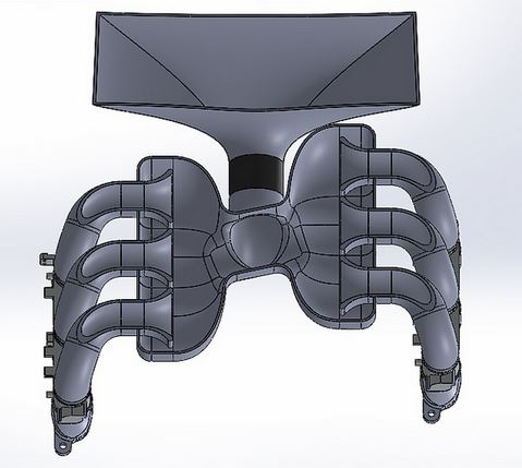

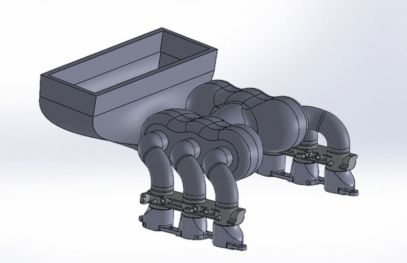

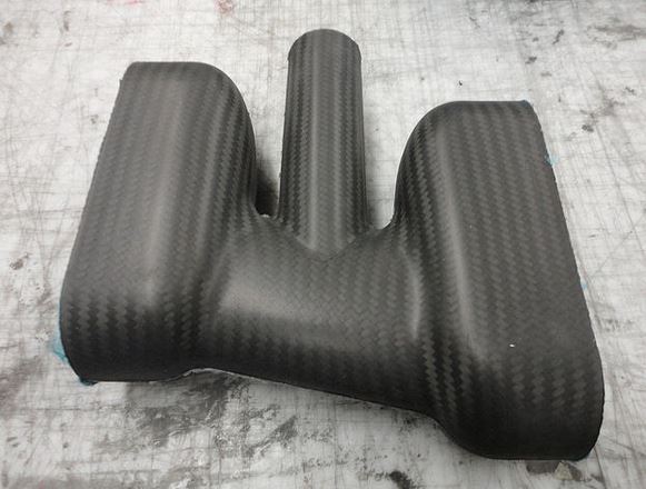

Here is a pretty cool custom intake for the EZ30:
http://forums.nasioc.com/forums/showthread...9743&page=7

AWESOME intake Ross.
