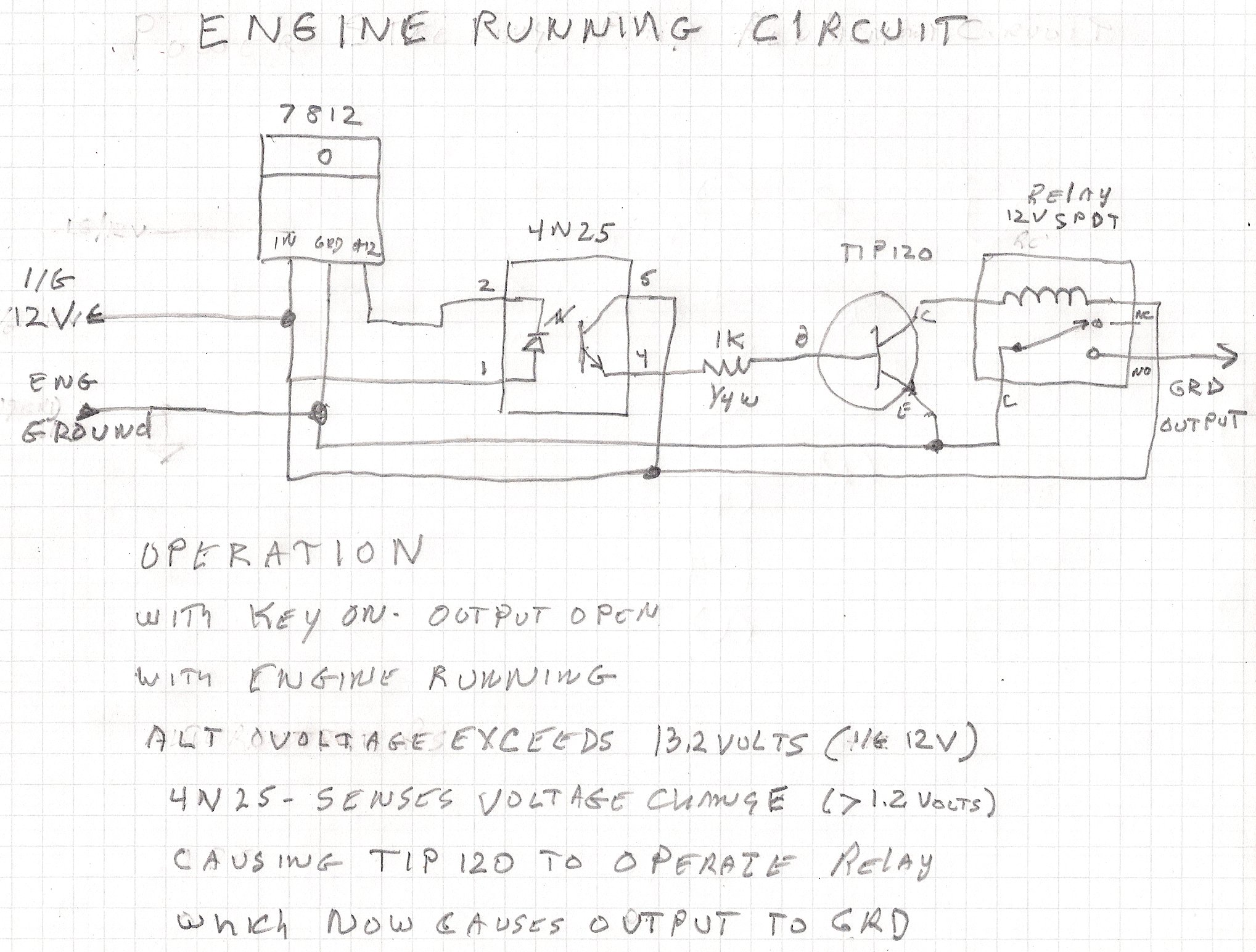

904svo
post Apr 13 2015, 08:26 AM
Post #434
904SVO
Posts: 1,124
Joined: 17-November 05
From: Woodstock,Georgia
Member No.: 5,146
Here the circuit I used.
This circuit can control other power circuits only when the engine is running.
Chris H.
post Apr 13 2015, 08:34 AM
Post #435
Posts: 4,054
Joined: 2-January 03
From: Chicago 'burbs
Member No.: 73
Very interesting stuff! Any thoughts on how to solve the dreaded SVX stall issue that is (allegedly, according to the SVX guys) caused by the fact that all SVX's are automatics and the ECU expects a load of some kind at all times? I've had it happen. Engine idled perfectly in the SVX. Now it will sometimes stall when you put the clutch in, especially when coming from high rpms. Seems to happen after warmup. When cold it's fine. Even with the power steering pump wire grounded it wasn't 100% cured. I know smallcar had a chip you can install for ~$260, but it's not on their website any more.
