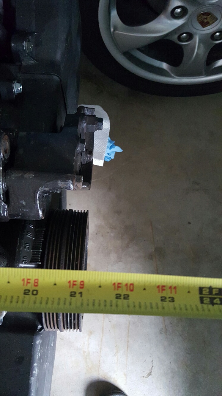

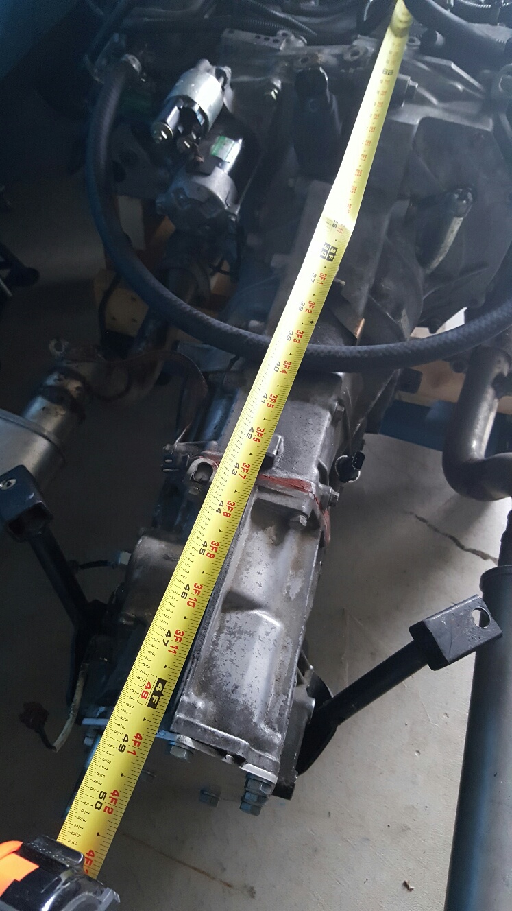

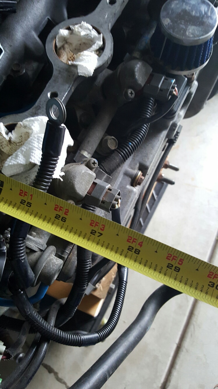

Measurements for you Christopher...these are approximate.
About 28" wide
The engine itself is just under 22" deep, then you have to add the snorkel for the stock intake manifold, which would add about 4" or so
The engine and trans are about 48.5 front to back, again, add 4" or so for intake.
The height of the engine is tough because I pulled the manifold off but I would guesstimate it at about 26" from oil pan to the top of the manifold.

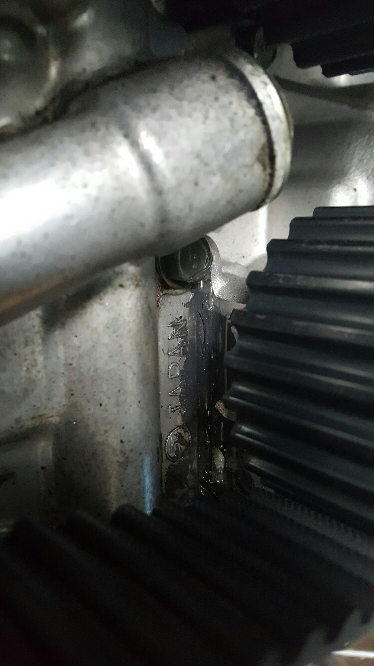

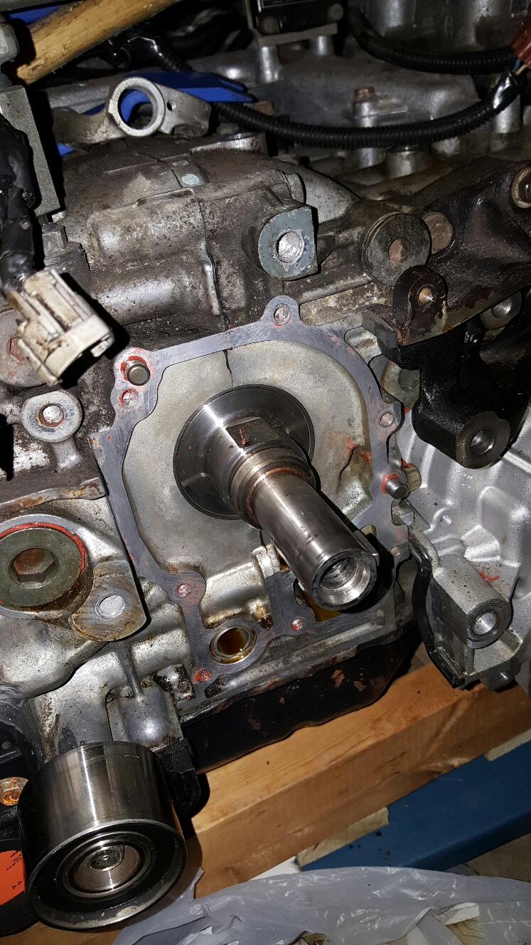

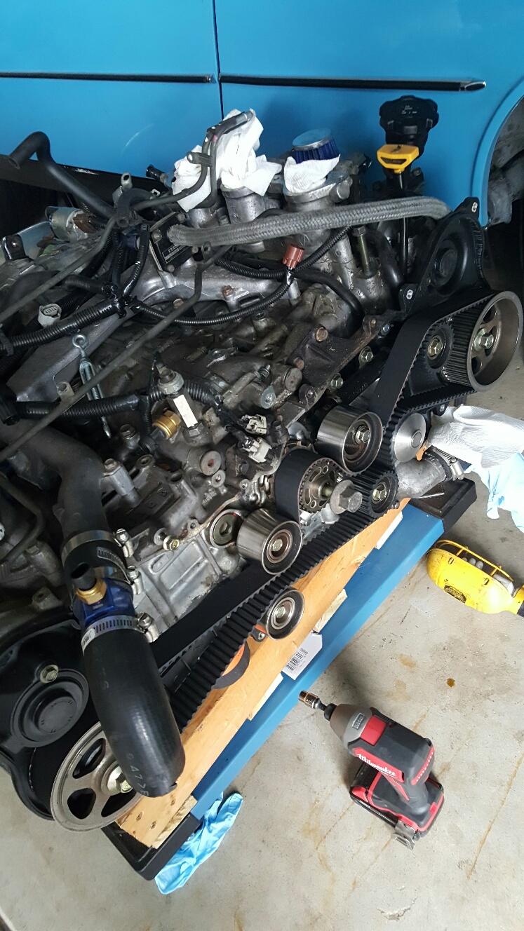

And then I did a tiny amount of work (IMG:style_emoticons/default/biggrin.gif) .
Got the timing belt cover off, pulley, etc:
The leak is right here...VERY small one but I hate oil leaks.
At first I was a little panicked because that black stuff looked like JB Weld....which would mean something bad. But it's not. It's black RTV. Scraped right off and is pliable. Someone tried to stop the leak temporarily with it. Any idea how much work that was in an SVX? Brings lazy to a new level.

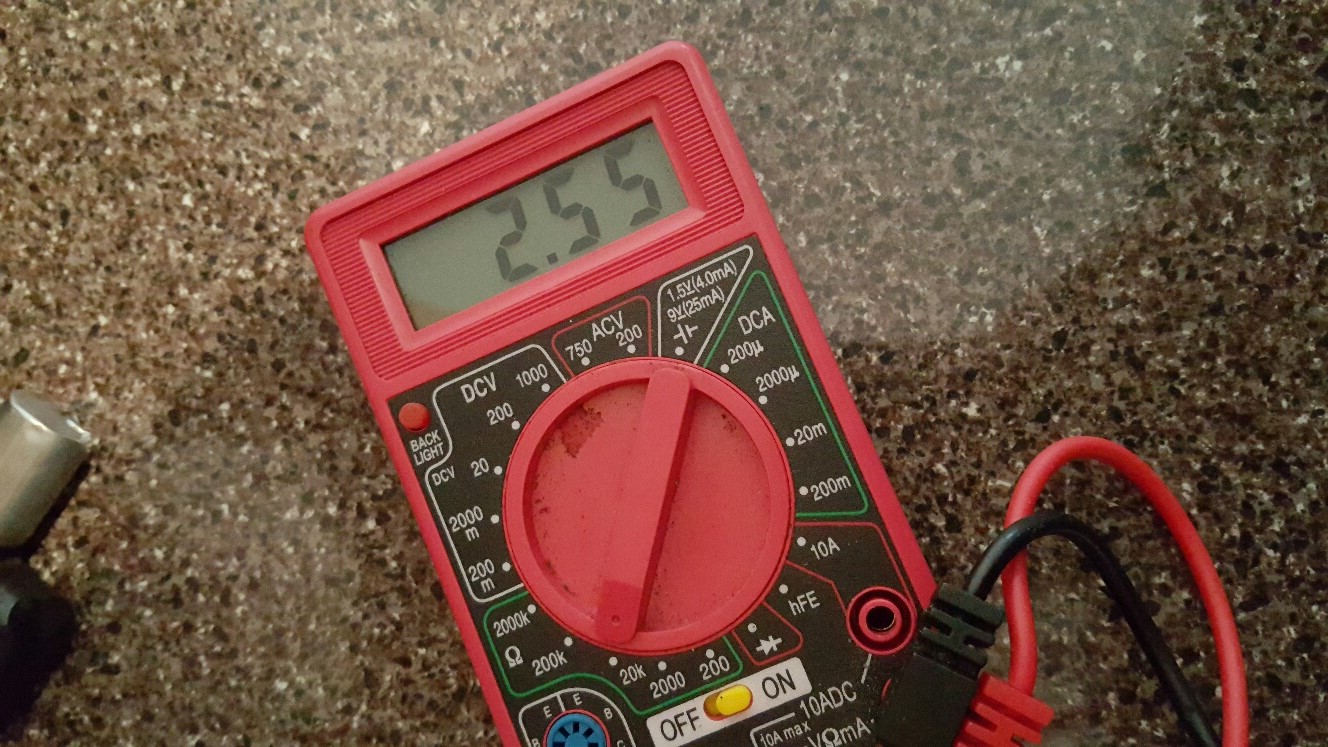

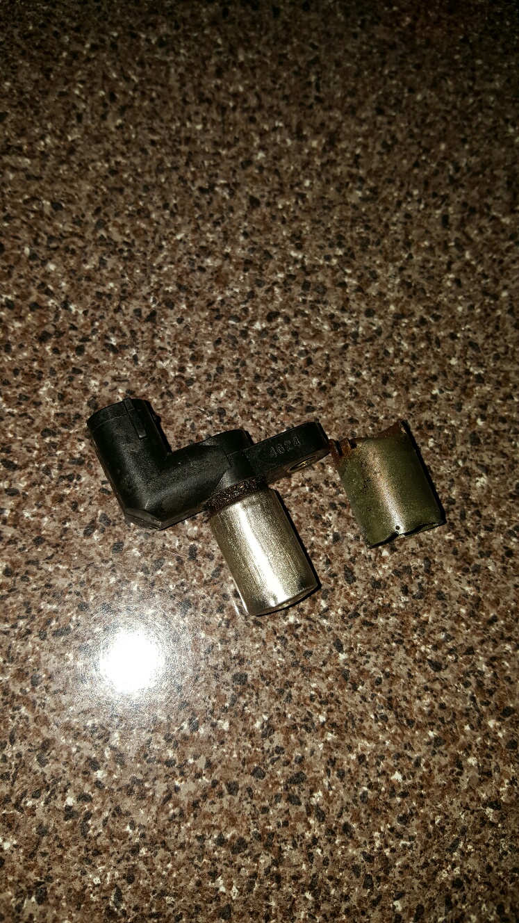

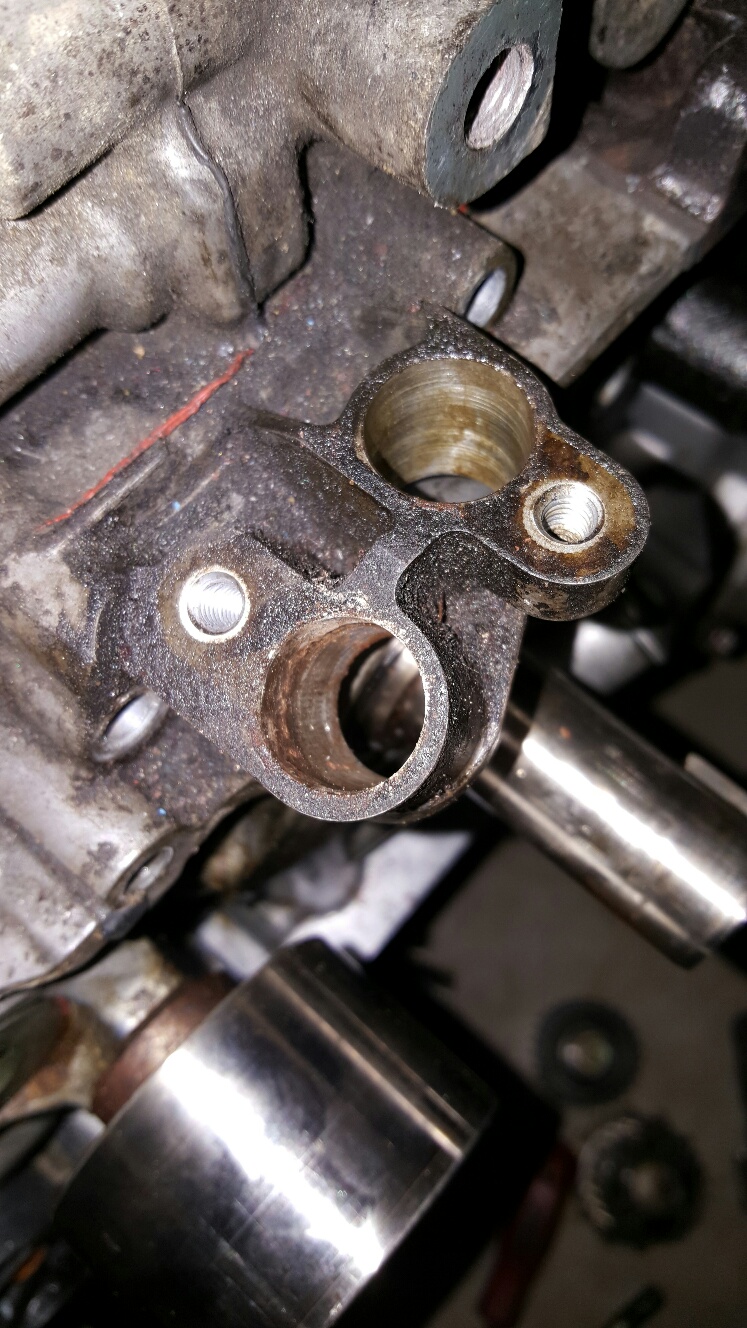

Totally stumbled on this one but it's a good lesson. Check the crank and cam angle sensors! The car ran fine so I ASSUMED they were OK.
There are two Crank Angle Sensors that are located on top of the oil pump right under the alternator next to each other. I was removing them to take the oil pump out and one of them just didn't want to budge. The outer metal sleeve had come loose and was stuck inside the hole. I tested it and found the sensor was bad so I manhandled it out.
Looks like a small amount of water must have gotten between the sensor and the pump housing:
That's the one area I didn't mess with when I resealed the engine (of course).

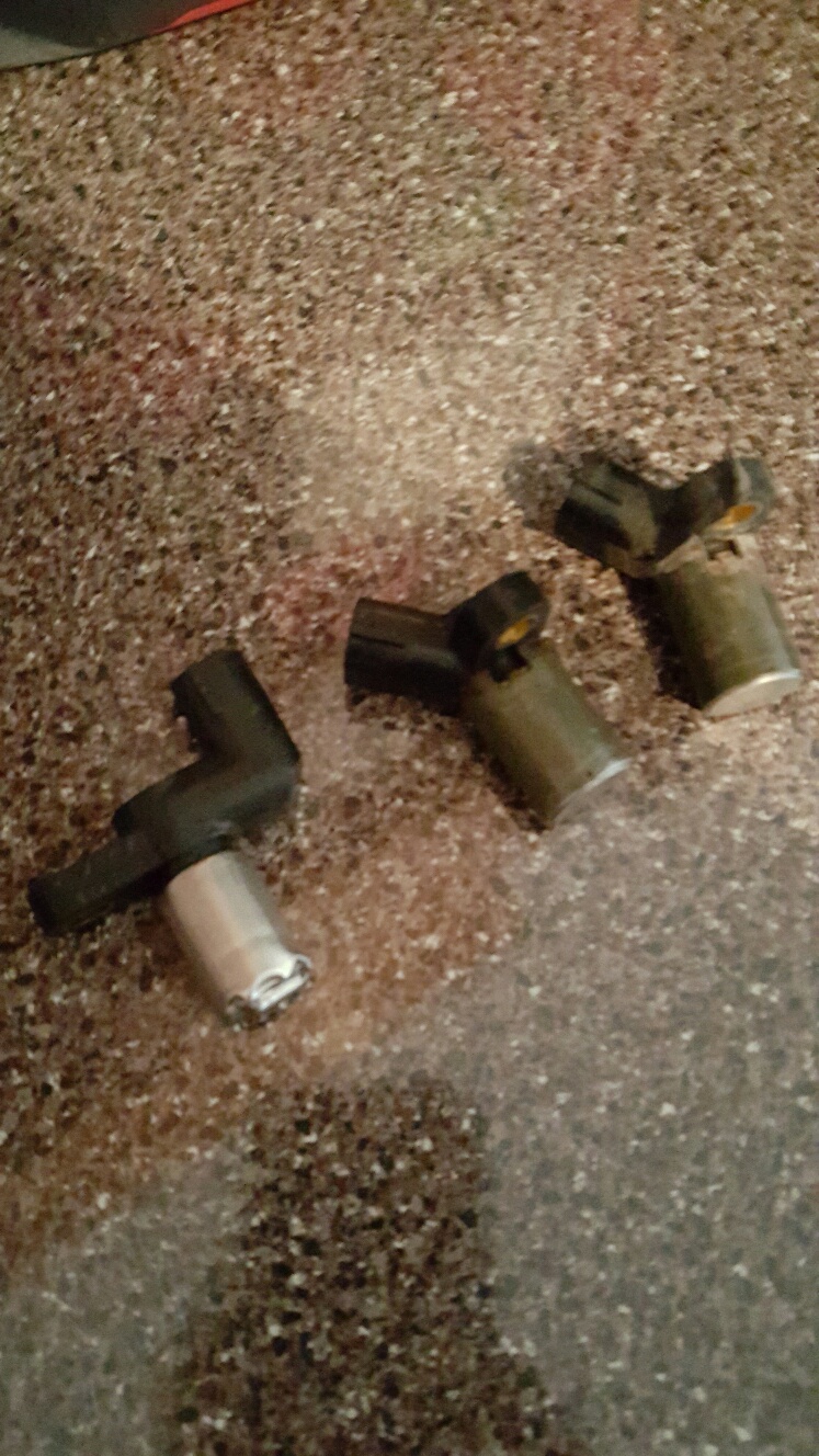

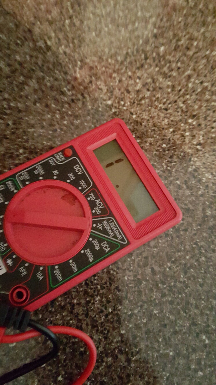

When you test these using an Ohm meter it should read ~2600. The other two are very close...
The bad one...nothing...
These are very simple magnetic sensors, they are technically all interchangeable. The only difference is the angle of the plug.
Of course the one I need is #1, and the plug end is pretty unique. Just need to do some searches to see what other Subaru sensor is close enough. You can find these for $20 -$30 each. Tempting to replace all 3. Definitely not spending ~$250 for the SVX one.

Chris I have 1 complete set, and the two on the engine, the cam sensor was trashed on my mockup engine. If you don't find one I can pull them next weekend. I am traveling this week for work, will be back in town next Friday.

I have heard rumours the Nissan crank sensor plugs in from the top or 45 deg like the svx. I have not confirmed that but I will have a look next time I'm pocking around the wrecking yard.

Interesting. Thanks Jeff. I ordered a couple of Legacy ones for a whopping $16 each. They are the OEM replacement on Rockauto so not the el-cheapo ones.

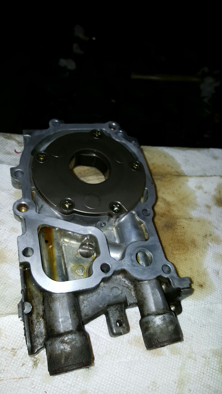

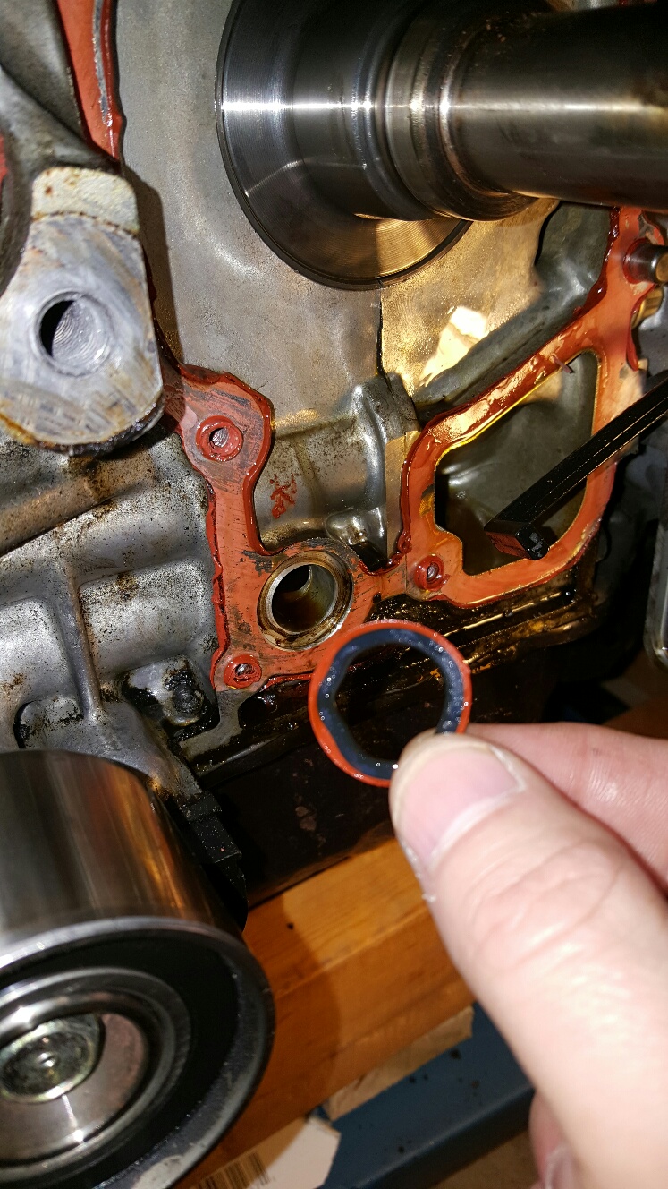

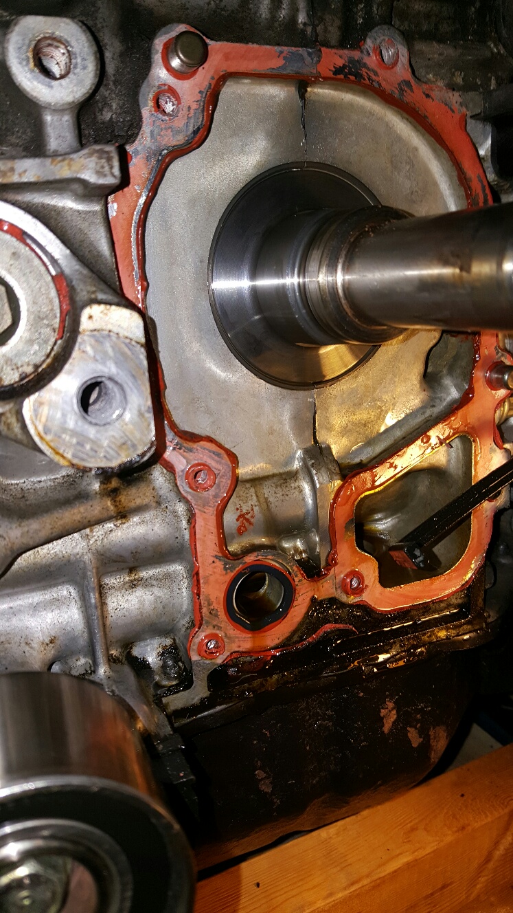

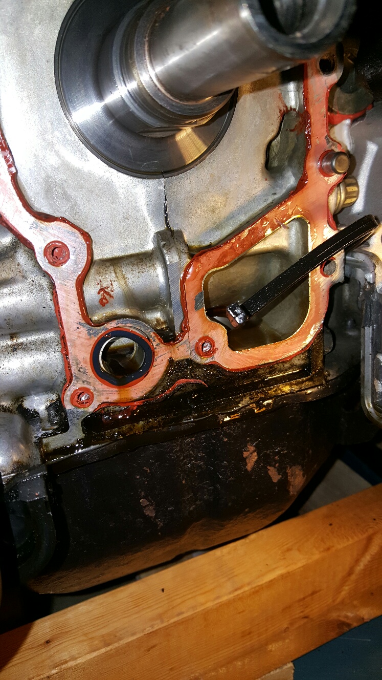

Slight progress while we wait...
Oil pump is off. Never resealed in 21 years. Seems like it might have been leaking slightly from both the seal around the pump housing and the front seal around the crank ( I think referred to as the front main seal). I got the seals I need in the Subaru reseal kit, just never used them.
Look at the crap behind that thing.
O-Ring is not very pliable. It broke later.
Got the RTV removed from both surfaces. RTV is the OEM way to seal the oil pump. Same with the oil pan.
Tomorrow we clean the gunk off from on and behind the oil pump, re-seal it, get the timing belt back on. I'll detail the procedure for doing the timing belt when I reinstall it. Easiest one I've ever done (3 times now (IMG:style_emoticons/default/biggrin.gif) ). Non-interference too. It's gonna be flying down the road in no time (IMG:style_emoticons/default/beerchug.gif) .
