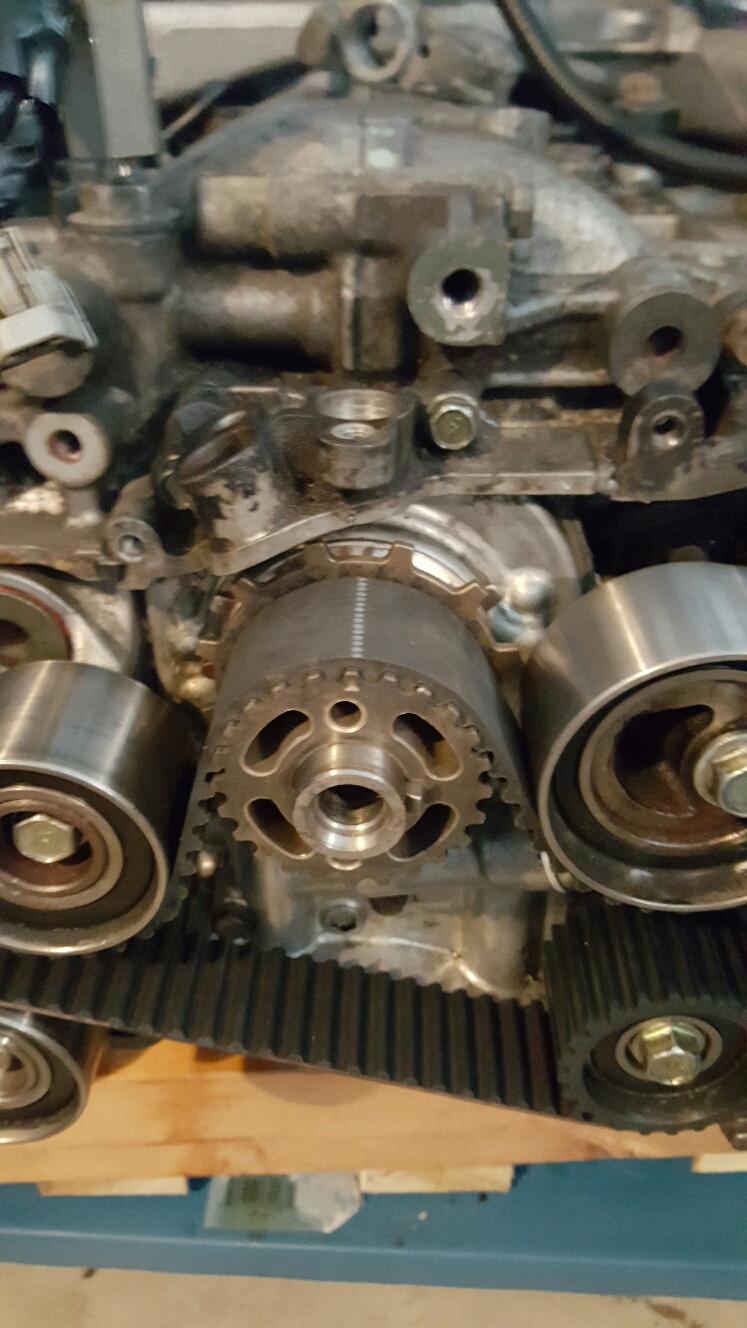

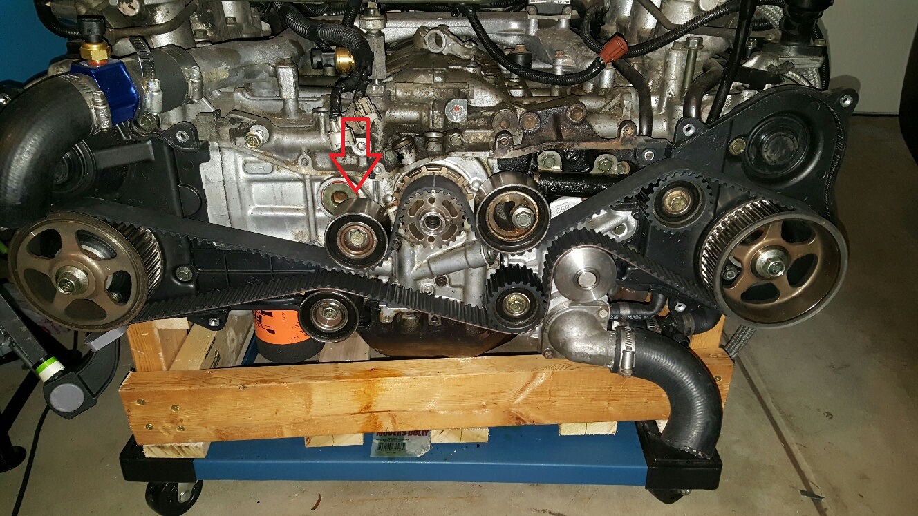

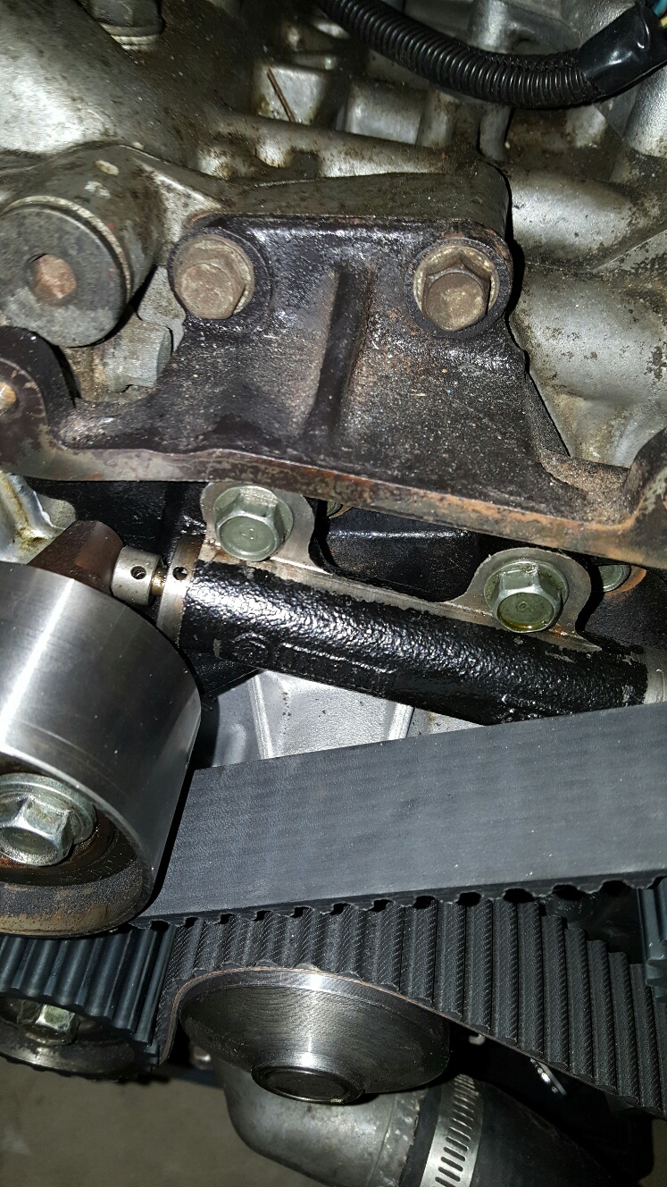

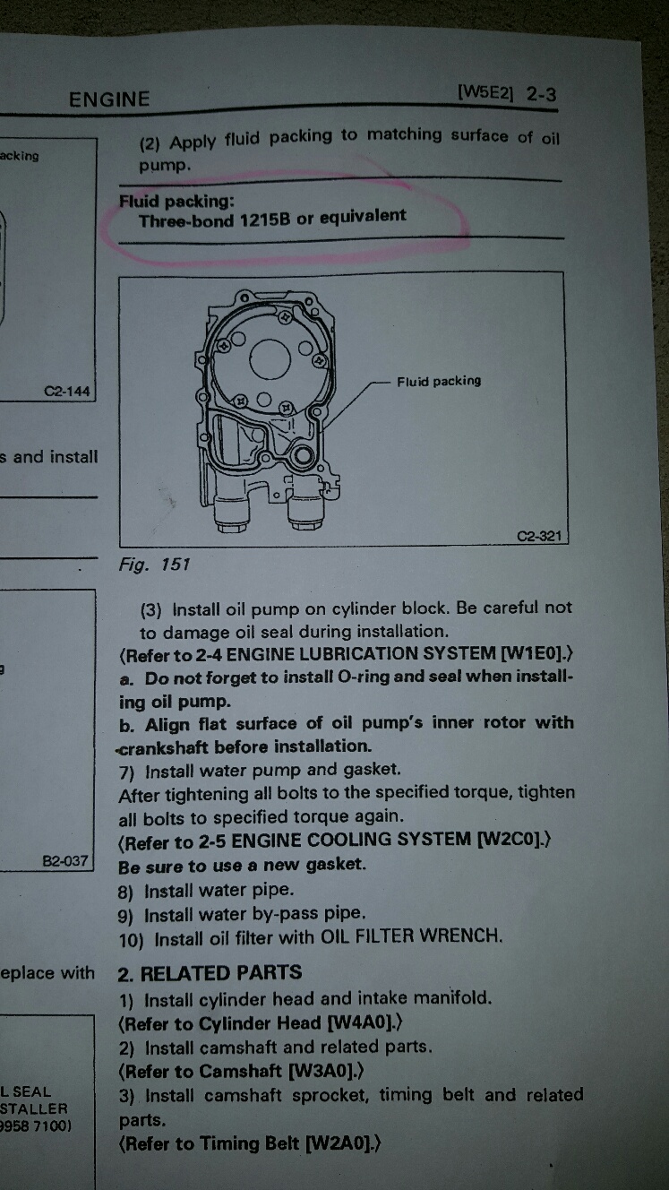

Yes sir. I got the oil pump resealed. Don't think it was really leaking as much. It was the front main seal primarily but hey...you can't leave 20 year old RTV on there when it requires removal of the timing belt to redo.
No pics of that since it's a messy job that requires both hands, but here is the diagram from the manual.
Just follow that line with the RTV and you're good.

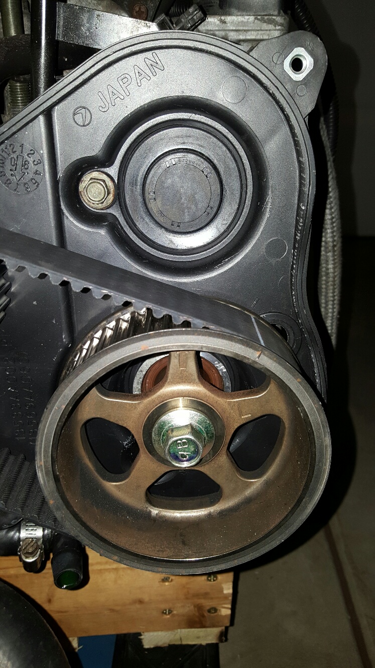

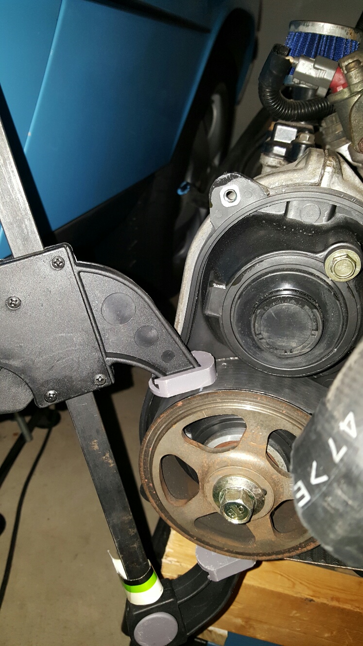

And then the timing belt reinstall. This is one of the easiest TB to reinstall...The most important thing to remember is to line up the marks before you remove it.
There is an arrow on each cam sprocket. They both must be pointing UP. There is a notch on the outside edge that lines up with one on the black plastic piece behind it.
At the same time the lines on the crank sprocket and the notch above it must line up.
If you take it off that way it most likely won't move.

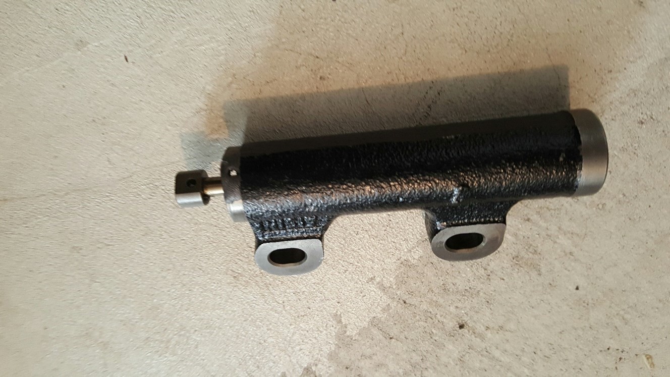

For reinstalling, first take the belt tensioner off, compress the tensioner and stick a small allen key in the holes keeping the pin in the middle from moving forward. Unfortunately I had to redo mine several times last time and the back side snapped off, so I added some JB Weld to the end.
It worked just long enough to reinstall the belt then crumbled off. I could drill new holes but it seemed to hold OK with just one and the JB Weld subsitute. Go ahead and bolt the tensioner back on but don't tighten it down.
Putting the belt on can be fiddly, so get a Harbor Freight $5 wood clamp and clamp the left side JUST ENOUGH to hold it in place, lining the white line up with the marks on the cam and plastic piece.
That keeps it from repeatedly flopping off, skipping notches, and keeps you from swearing a lot.
You most likely won't be able to get the belt stretched over both cam sprockets, so remove one of the non-geared idlers and line up the belt.
The dotted line goes on the crank sprocket marks, and there is another solid white line for the right bank. Reinstall the idler pulley, double check your work, un-clamp the left side, triple check your work, make sure the belt is on all the teeth with no skips, then push the tensioner to the left and tighten it to spec (I think 35-40 lbs). Check the belt again...do a drum roll....and pull the pin out.
You are done. Put the covers back on. Say "Yeah". High five yourself.

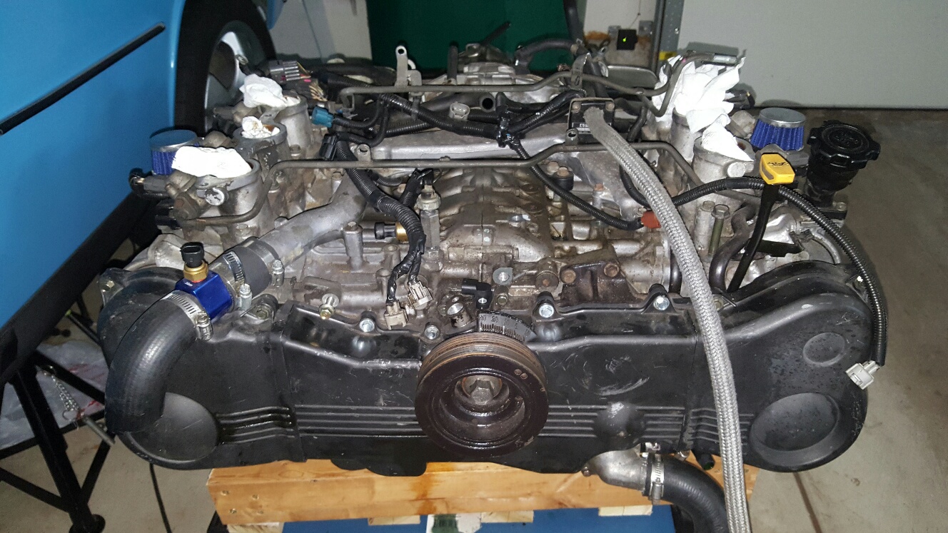

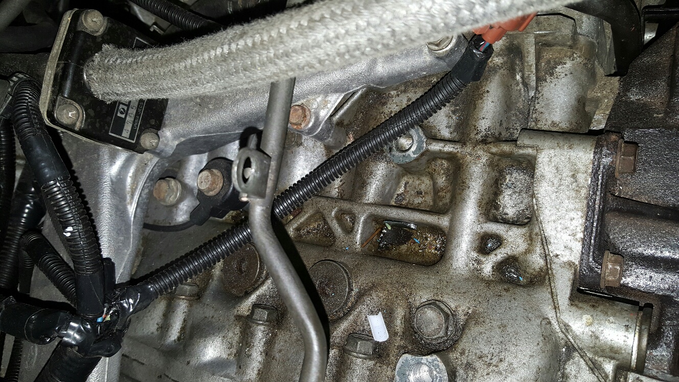

Member No.: 73
Question for the engine cleaning gurus...is there something I can get to attach to a drill to clean the crevices of this engine? There are a lot of little pockets that need to be scrubbed out a little better.
Looks worse than it is in this pic but you get the idea.

Wow, you got a lot done. Have you ever counted the number of times you've dropped the drive train. (IMG:style_emoticons/default/lol-2.gif) A 1/2 or 3/4 wire cup brush will do 98% of those areas but not the corners. Gunk engine cleaner in the corners?
