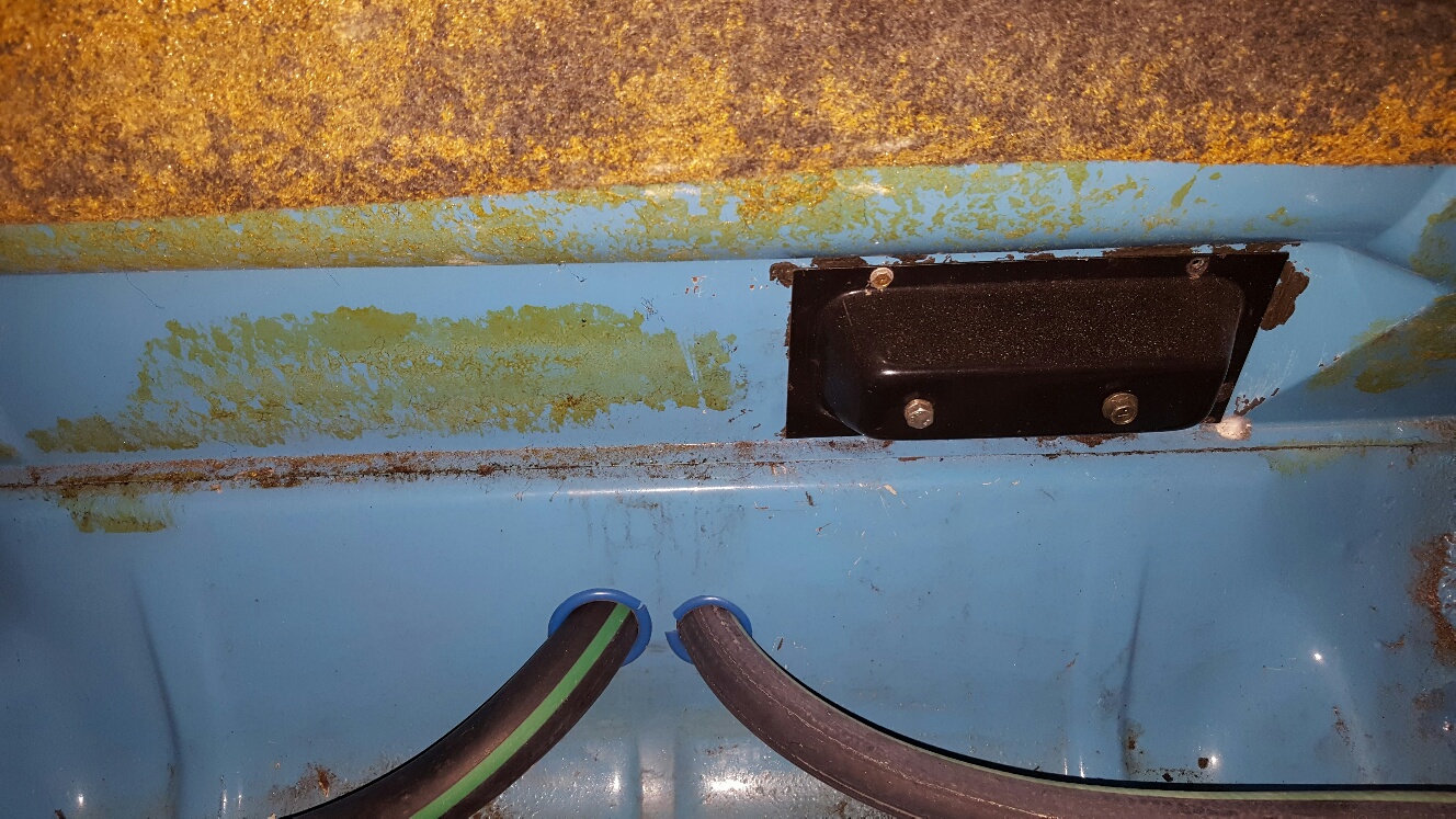

Here is a pic of where my lines come through the front trunk. I have them following the indentations in the floor underneath.
Someone was asking about fuel pump relocation in another thread...well...there is the fuel pump behind that black plate. Walbro pump fits in the stock location. BTW it is running much quieter now.

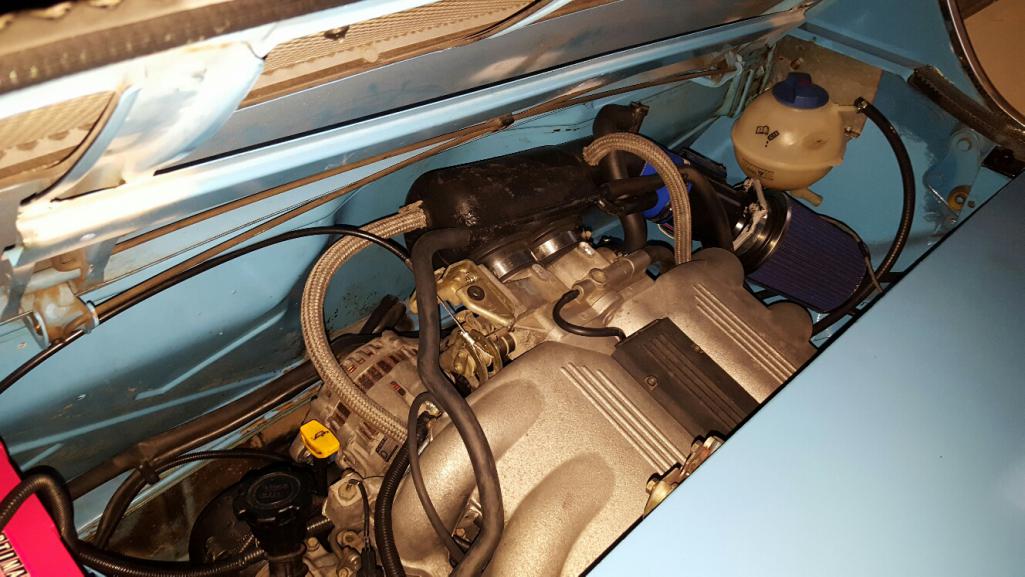

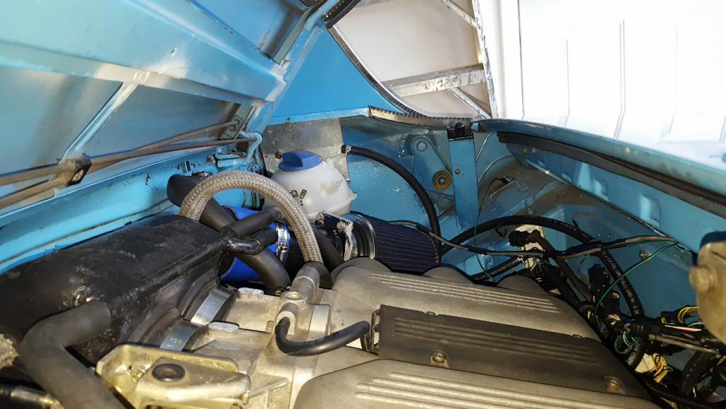

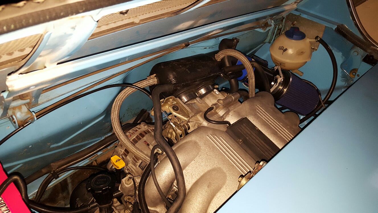

Here is the engine with the intake flipped.
The stock plastic intake piece is actually flipped as well because it would not fit the other way (battery). You can see it is slightly tipped up and higher on the right side because it is hitting the firewall on that side. The intake is very thick so I think I can shave a little off of it and get it to fit. I had to shorten it quite a bit. Luckily I have another one. If my Optima ever dies on me I will use the battery tray as a support for the stock air cleaner and put a small battery on the other side.

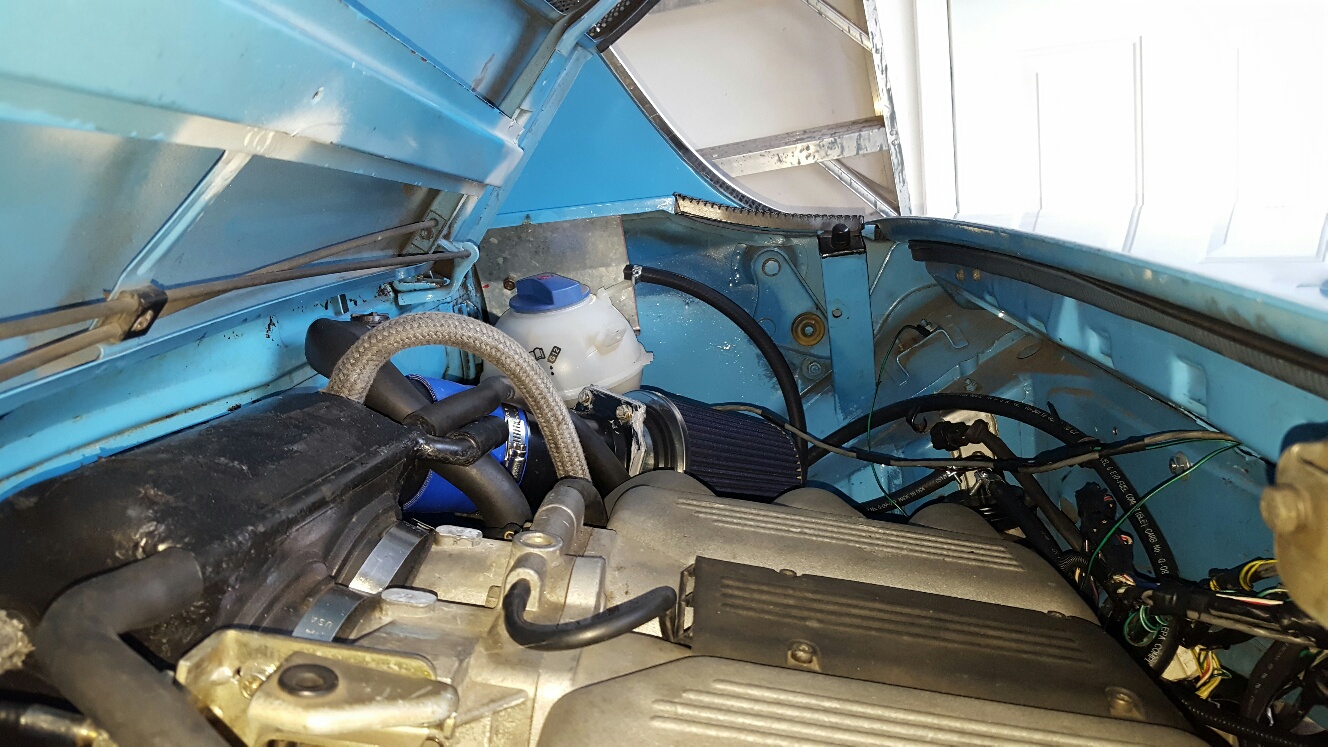

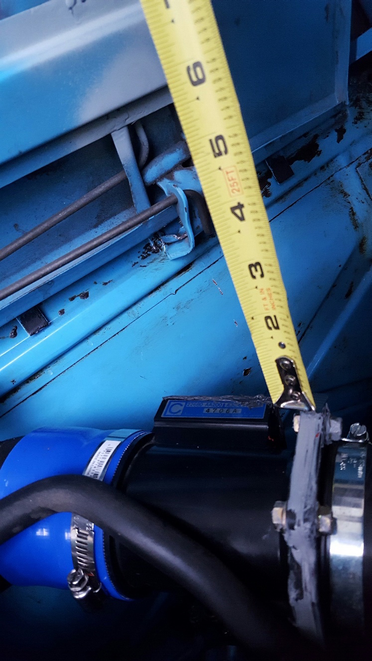

Here's an idea of how high the intake is in relation to the engine lid.
The intake itself clears easily, with about 3.5 to 4 inches of room. Here I used the MAF because its is the same height but easier to show measurement to the lid hinge.
Could put the rain tray back in I guess. The plastic snorkel piece is close to the lid but that is mainly because it is upside down so the IAC valve hose is on top. It would be behind the rain tray anyway.

Chris
Thanks that's perfect. I have had a brain storm on the flipped intake. Based on that pic I'm going forward with it. I will pm you pics when I'm done with the machining.
