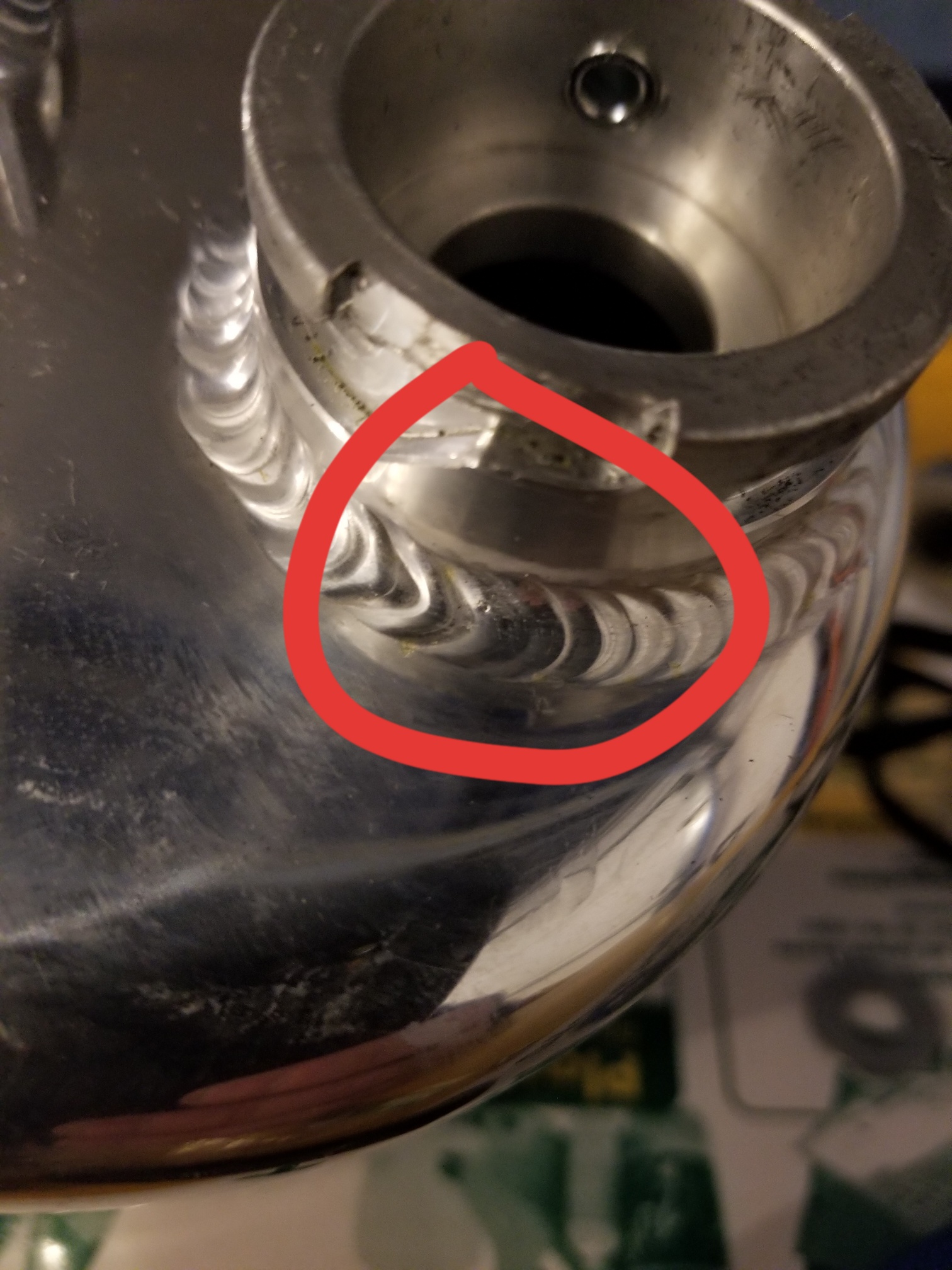

Well it's finally been warm enough to test out the new aluminum coolant tank I was so dang proud of. And...it leaks. At first I though the cap was the problem, but after looking closely at it while running it's definitely got at least one pin hole in the weld around the coolant neck. It just weeps a drip or two once in a while after it pressurizes. I'm not a good enough welder to fix it, and I don't HAVE a good enough welder to either. Just thought you should know in case anyone is thinking about buying one.
Might go back to the globe if I can't get this fixed. There is a version with no puke valve in the back.

That's a bummer! I bought my expansion tank from Canton racing. It has worked out perfectly. https://www.cantonracingproducts.com/cgi-bi...&key=80-202
I purchased it from the garage sale section and paid around 80 bucks because it was scratched. To be honest I still haven't found the scratch? Great product and good service.

Send that tank down here and I'll welder it up (IMG:style_emoticons/default/welder.gif)

Thanks Bob! I THINK I fixed it but we’ll see. If not I’ll send it right down. I brazed the holes with aluminum brazing rod. Now I just need to drive it around a while and see if it holds.
