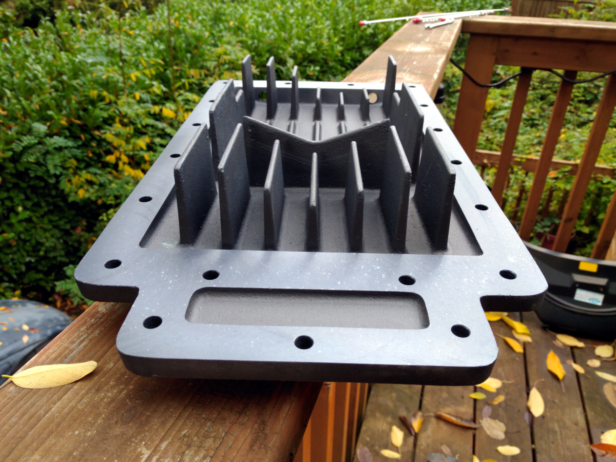

Hey gang.

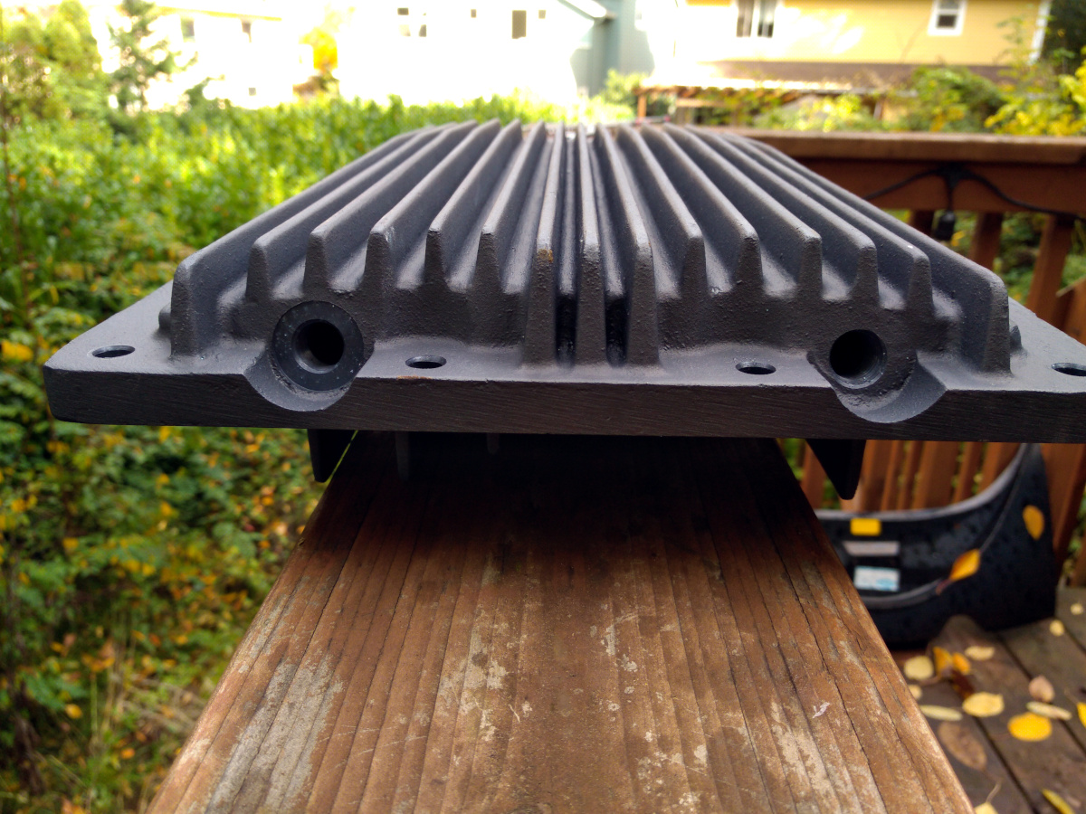

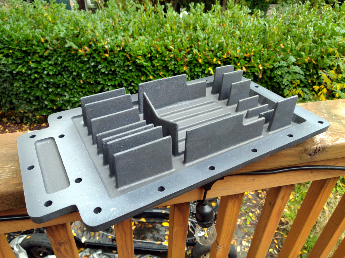

I don't think the oil pan is coming back any time soon. So I finally broke down and bought a third oil pan. This time it's the Clark's brand. Like the Otto it's also made from cast alumin(i)um. Thankfully this is one is dead nuts flat so it doesn't need any modifications. So I suggest that if you ever build your own Corvair engine just cough up the $300 for the Clark's plan. Maybe one day my other Otto oil pan will return. If it does I'll pass it on to another adventurer.
The boasting points for the Clark's pan are:
* tall internal baffles to reduce slop and increase thermal absorption (that's a fun word)
* actual flat mating surface
* two rear-facing pipe threaded holes -> one for the drain bolt to get really good drainage, and another for an oil temp sensor. That's a nice touch.
The main caveat is that the finish isn't nearly as good as the Otto, but I don't care any more. The cost smarts though.
In the next few days I'll have a friend come over and help me flip the engine so I can install the pan. Once installed, it's a straight path to completion. Finally.

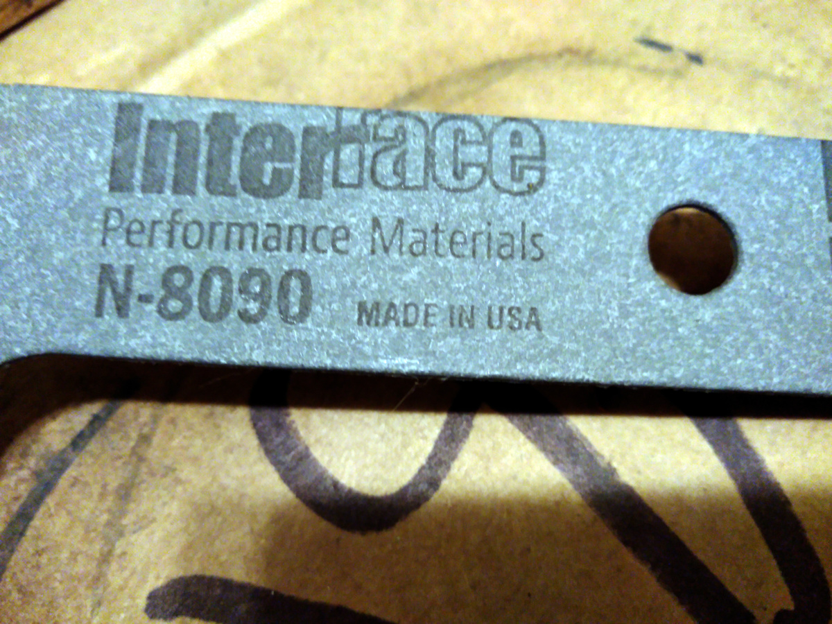

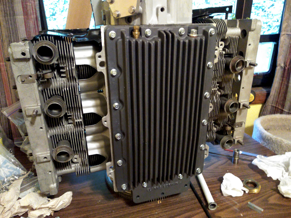

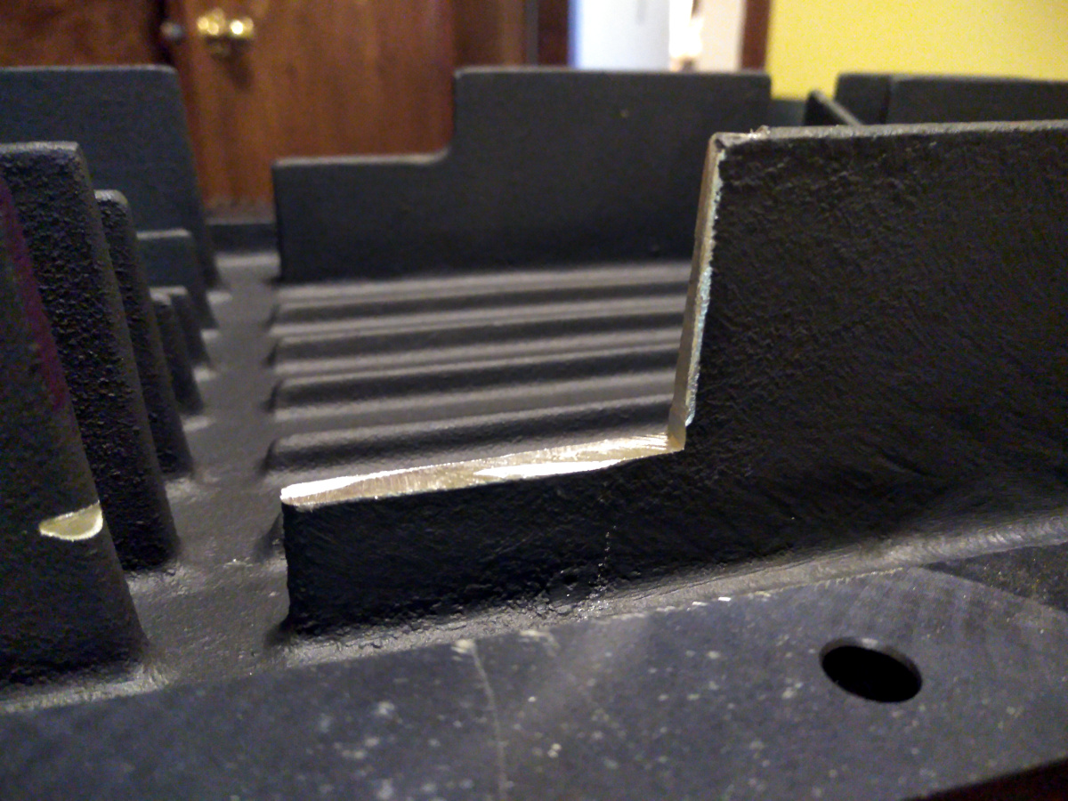

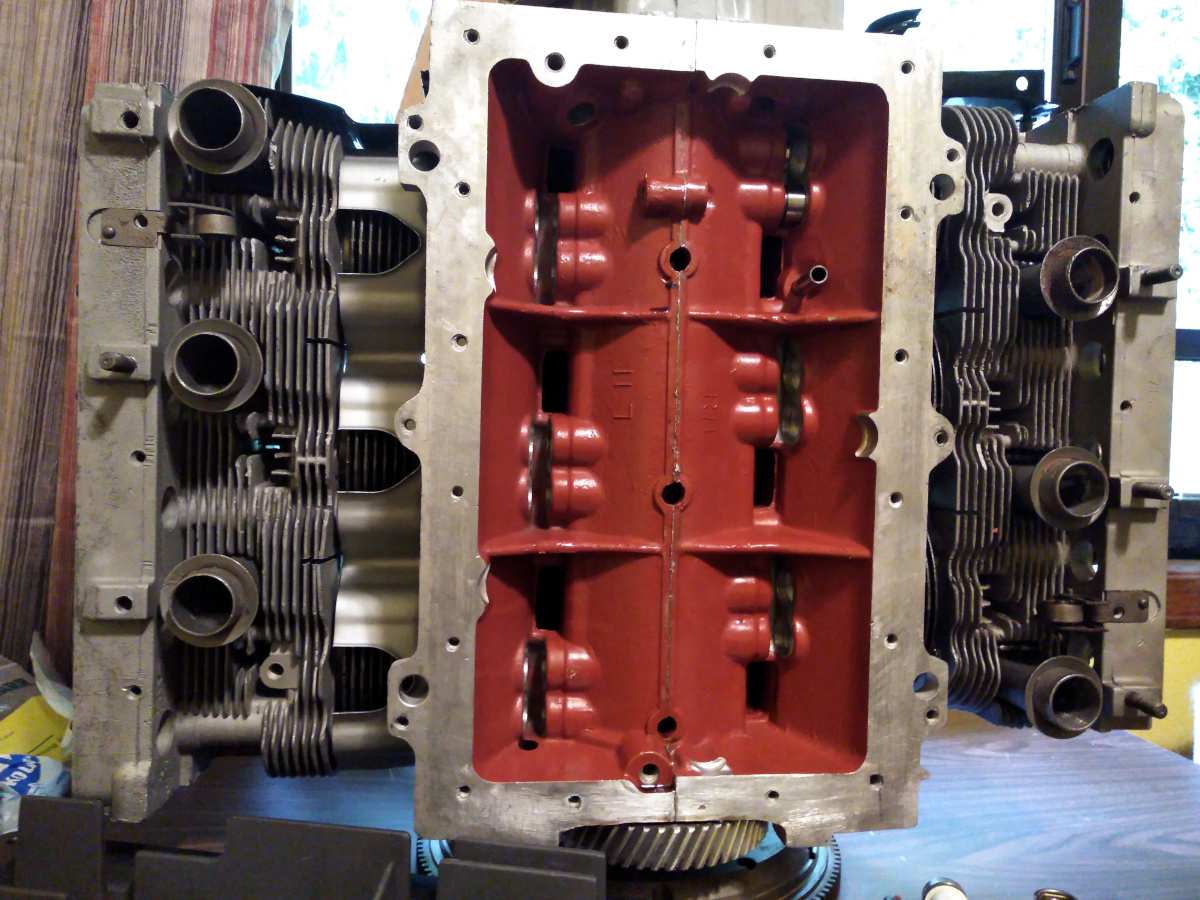

Okay. Finally the simple task of installing the oil pan is finished. My friend Ben dropped by and we tilted the engine onto another work table. The table is unhappy about the load.
Any oil pan for the Corvair is not ideal In order to gain ground clearance, the pan is really more of a lid. Most of the oil sits above the gasket line so it can leak just sitting there. That is, it could leak out most the oil in total if given the chance. That's why I'm extra particular about the mating surfaces and sealing. I'm trying to avoid a hypothetical situation where it leaks a parking lot, then someone will point and laugh at me because of the Corvair engine. Then I'd pee my pants to complete the spectacle.
Dry fitting the pan showed another problem. One of the baffles inside the pan butted against one the casting ribs on the bottom of the engine case. It could be a universal application fit, I'm not sure. Anyway a little quick work with the grinder and a file and I removed a little square. It only wanted a 1/4" removed, but the grinder fit easier this way.

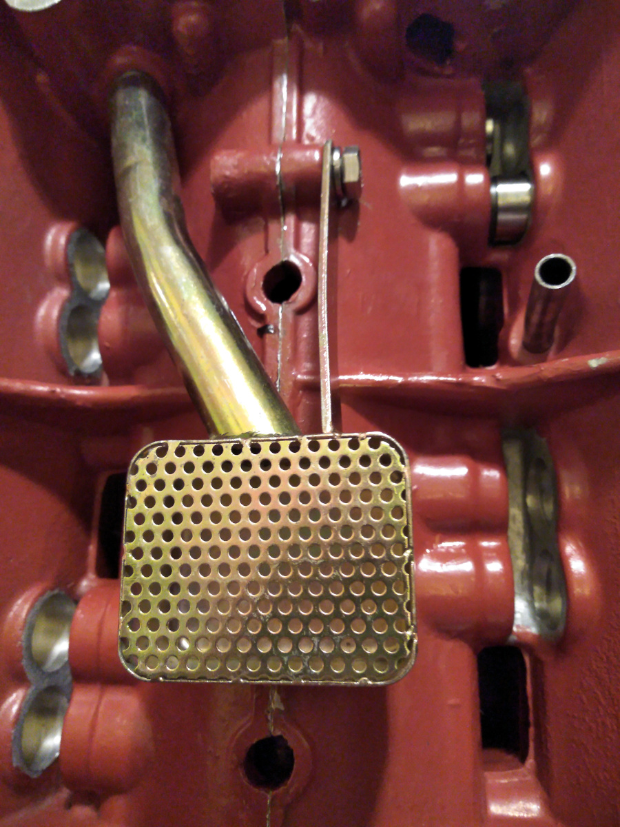

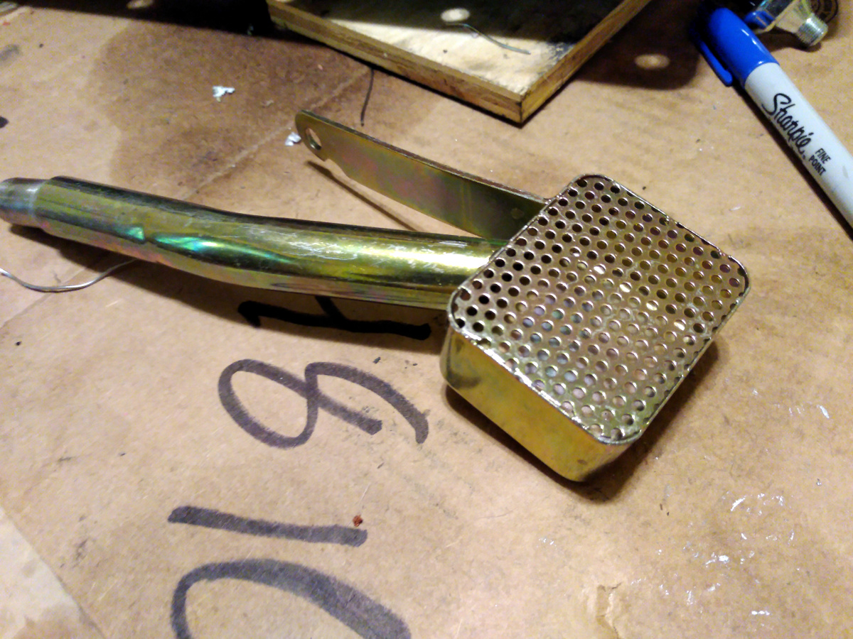

And here's the Otto oil pickup. It's a decent improvement over stock and it fits this oil pan perfectly. I've mentioned it before but here it is again anyway.
Installed:

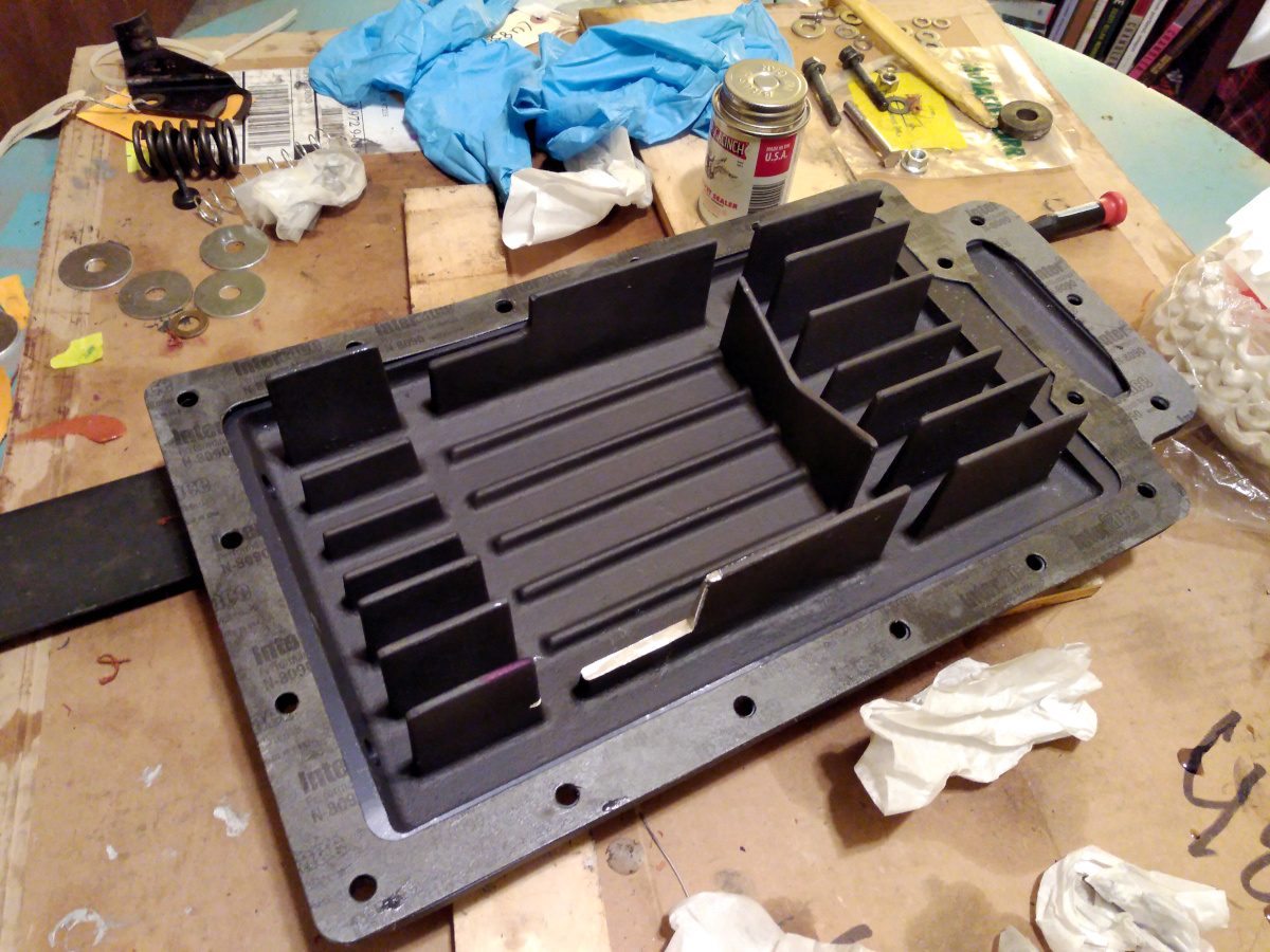

Now it's finally time to clean the surfaces and install the pan. As per usual I cleaned both mating surfaces with white coffee filters. First with mineral spirits, and then with alcohol. The gasket I'm using is a thin felt-rubber gasket. I'm not sure if this is the best choice but if it doesn't work I have other, thicker gaskets.
I doubt I really needed to use any gasket dressing given that the surfaces are flat, but they're not perfectly flat. So I used a bit of Gasgacinch, let it dry, and slapped it onto the pan. Then it's right back onto the engine.
After letting it sit overnight I realized that I forgot to apply anti-seize. So I popped each off one at a time and torqued them to 70 INCH pounds in a criss-cross pattern. The manual says 100 inch pounds, but that's a mistake. The actual value is 60-84.
Anyway, done. Next up are the lifters, pushrods, rockers.
