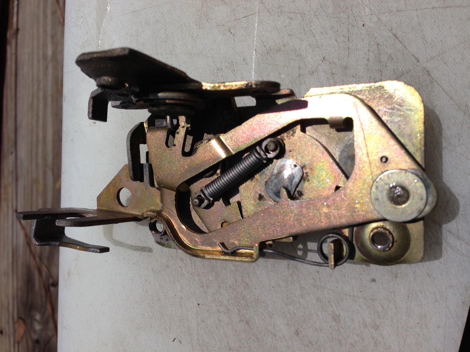

The first door I tackled (inoperative outside latch on passenger door) had a broken cam as suspected. The cam was black. Isn't that a replacement unit? The latch mechanism inside the door was very grungy. Experimentation between purple power, simply green , gunk engine degreaser and brake cleaner showed that the best results were obtained by spraying the mechanism with gunk engine degreaser (gel) and letting it sit for 15-20 minutes. Rinse off and follow up with brake cleaner. YMMV. I sprayed the moving pieces with white lihium grease before reassembly. I cannot explain how nicely the door operates now. Just a slight pull on the door handle and the door pops open.
The second door was the "good" drivers door. The cam looks to be original (white plastic) and in perfect shape. The door mechanism was very dirty and operated sluggishly. A good cleaning and the door now pops open with a light pull.

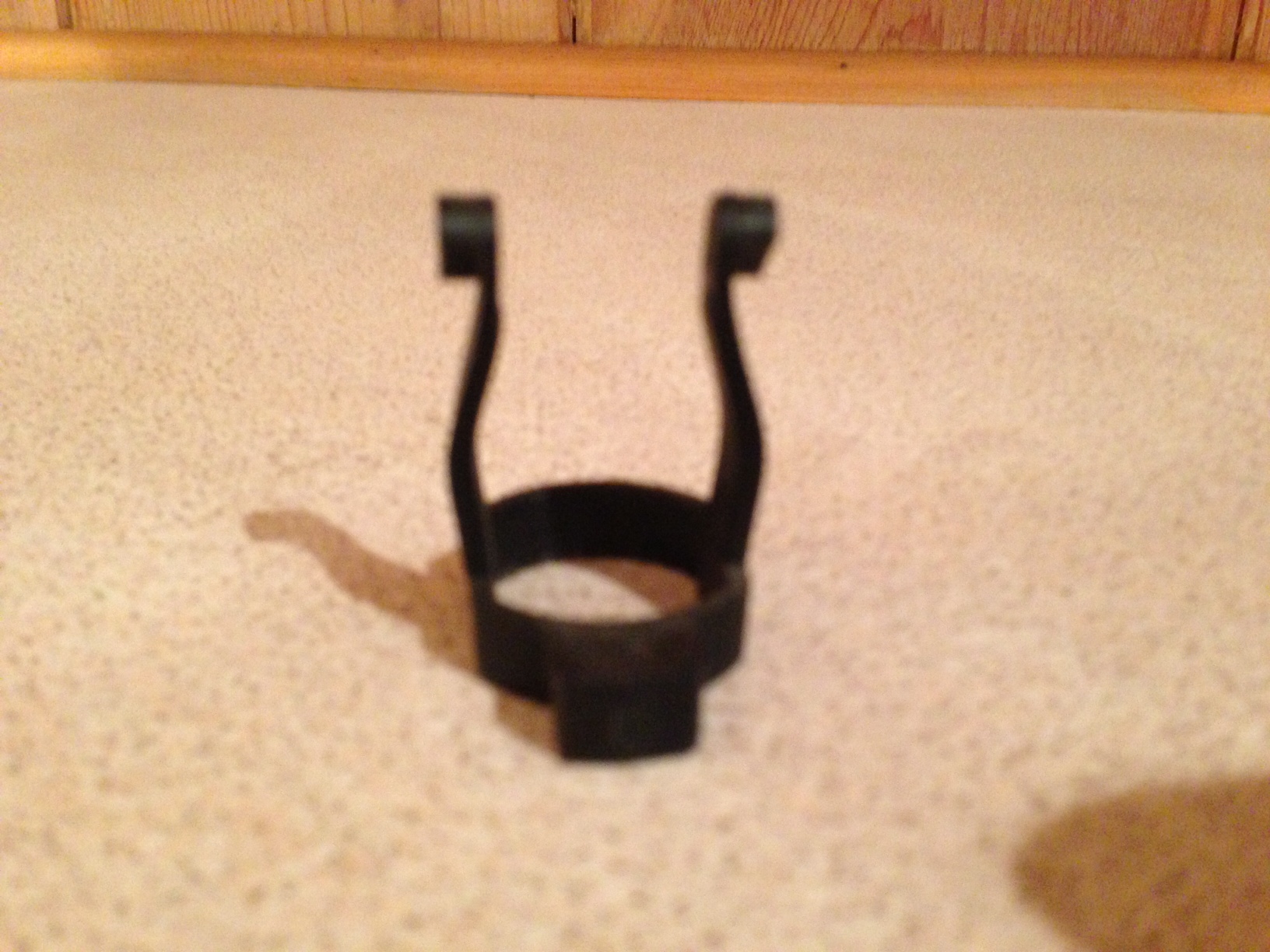

The main purpose of this post is a warning on what was found on the other car. On that car the passenger door was not opening with the outside handle and it took a lot of effort to open the drivers door with the outside handle. On both doors, the cam had deformed from all the pressure exerted trying to activate the sticking latch mechanism. The picture below is the drivers door. The passenger door cam was deformed even further and would not push the latch. If I had waited much longer I would have been "locked" out of the car!

The one I posted a picture of did not have a lot of strength in the "two legs". From a compression perspective (I guess compression is the right term) the "legs" will need to be pretty stiff or they will deform like the one I have shown in the picture. How stiff are the "legs" on the ones you sell?
Bronze may be overkill; however, at least you won't have many worries about the "legs" deforming under pressure. You may break the tabs off the door handle but your cam won't break! (IMG:style_emoticons/default/smile.gif)
