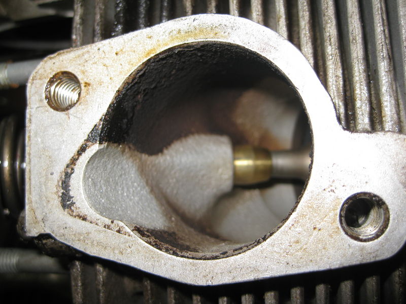

[quote name='gms' post='2521345' date='Aug 27 2017, 01:10 PM']
Yup those manifold will leak air because they don't cover the CIS injector cut out on the intake of the head.
Head
Recommended intake
PMO Manifolds received!
The original Porsche manifolds will not just bolt on CIS heads as there just isn’t the sealing surface on the manifold flange because they do not have the bump out on the flange to cover the CIS intake port scallop in the heads as gms pointed out. And they will likely crack, I’m told.

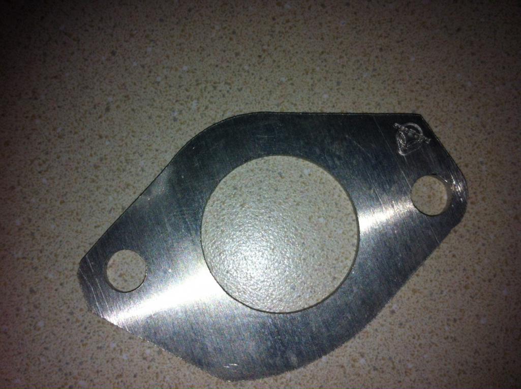

QUOTE(sixnotfour @ Aug 27 2017, 01:20 PM) *
rick 918-S, made some plates he was selling to solve that coverage, or PMO has plastic spacers that would work also..
http://www.914world.com/bbs2/index.php?sho...=263516&hl=
Thanks for the info on the Alien plates. Sent him a PM but that post was from 2015 and I already ordered manifolds. (IMG:style_emoticons/default/sad.gif) Guess I should have done more checking around.
However Rick 918-S is sending some of his Alien Plates for me to check out and they will look like this. So the jury is out for now awaiting their arrival. Thanks again sixnotfour for the tip on the Alien plates!

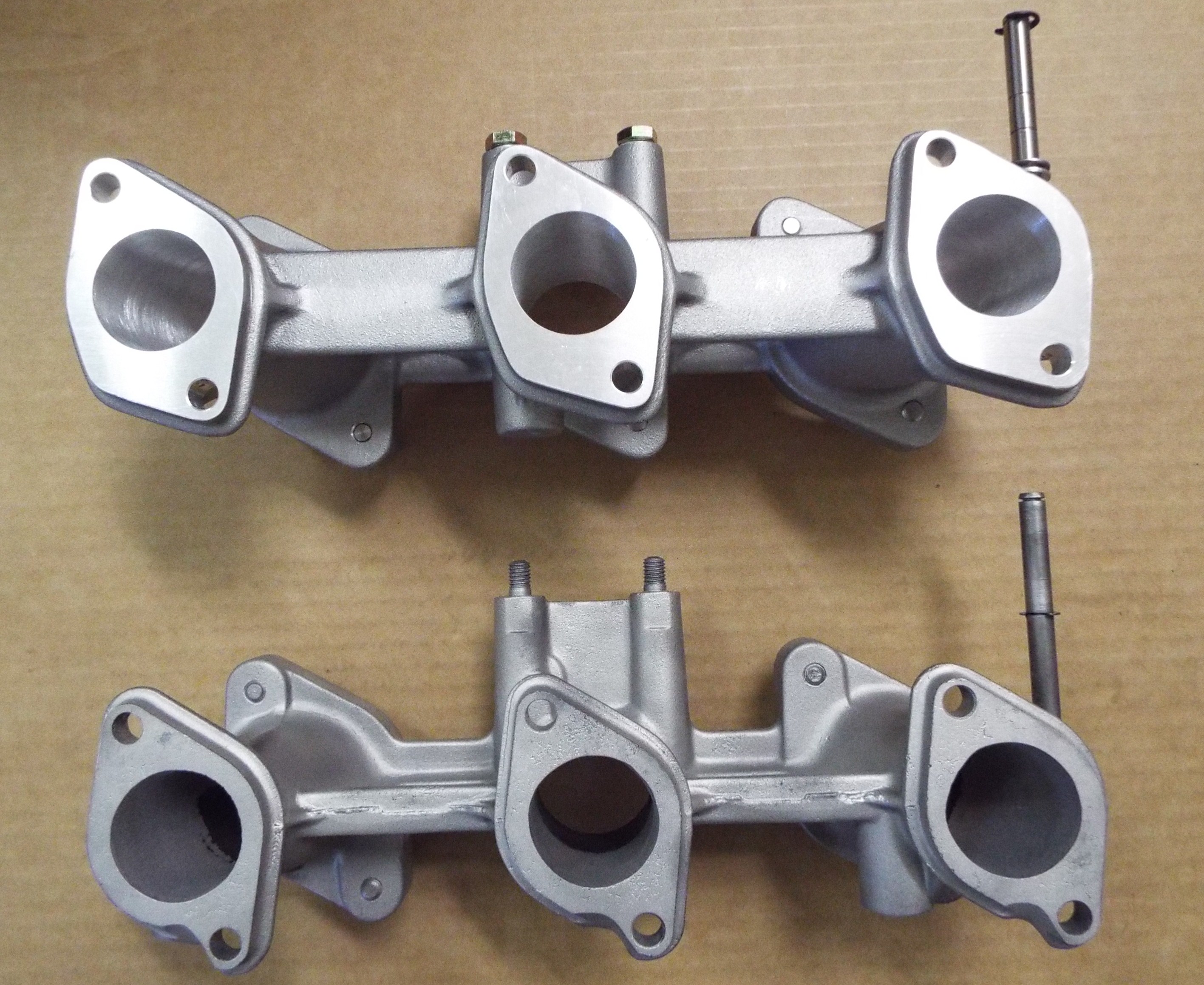

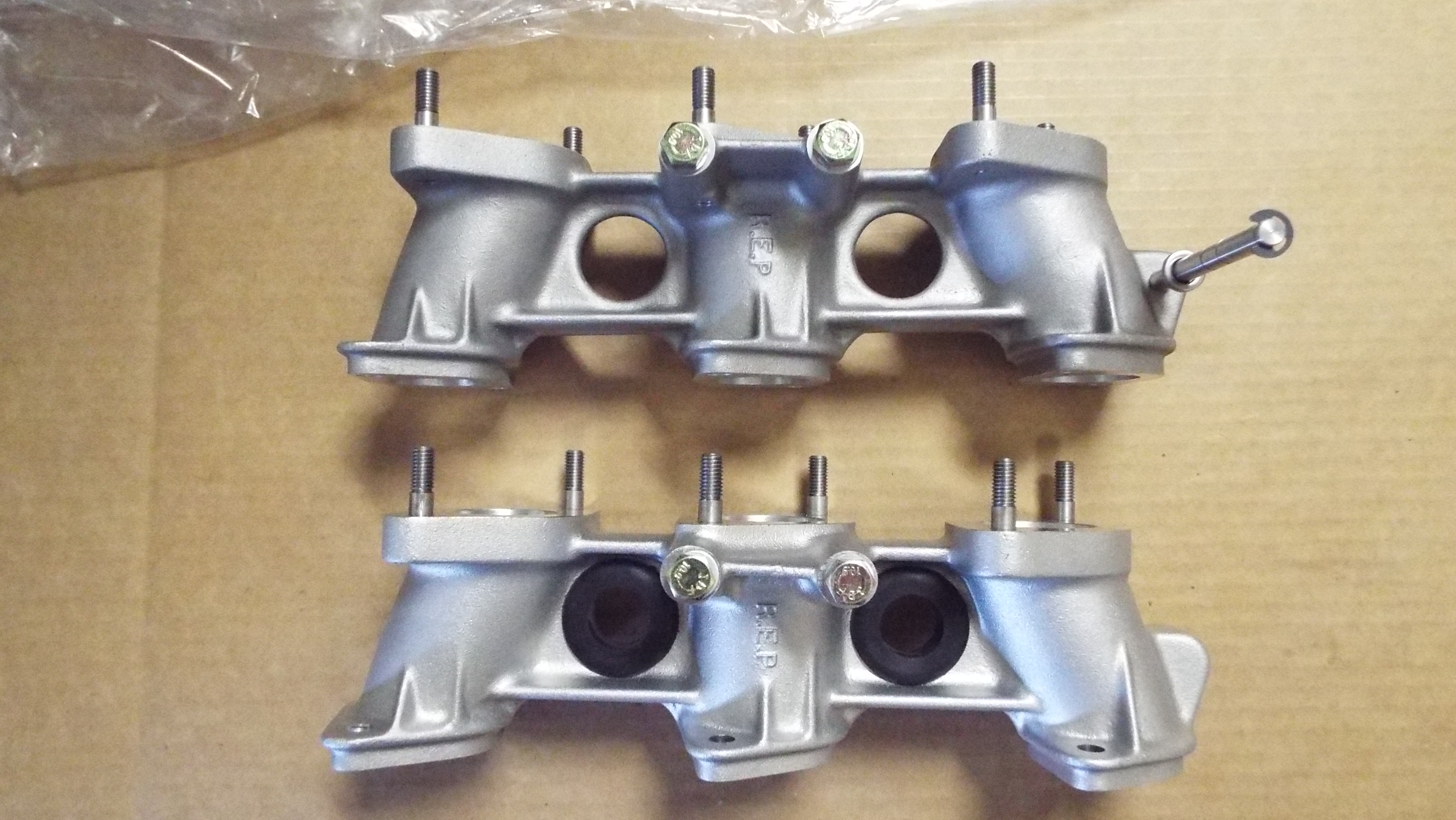

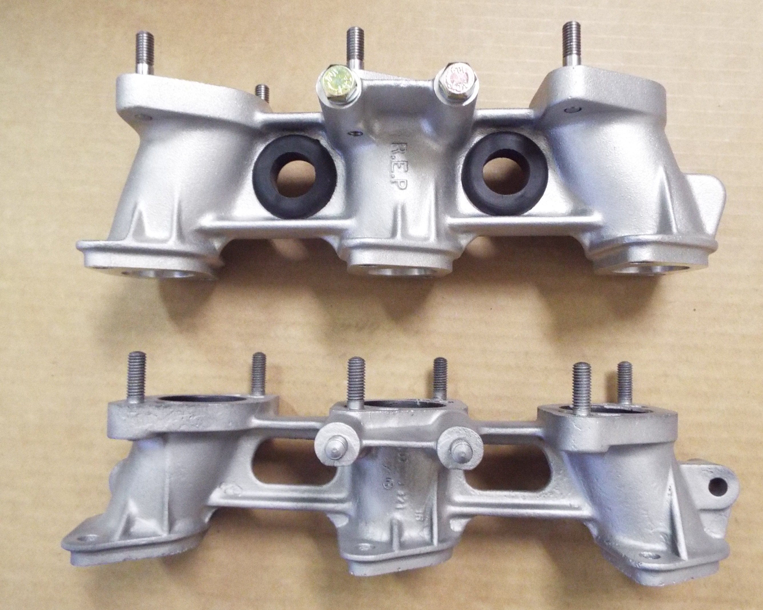

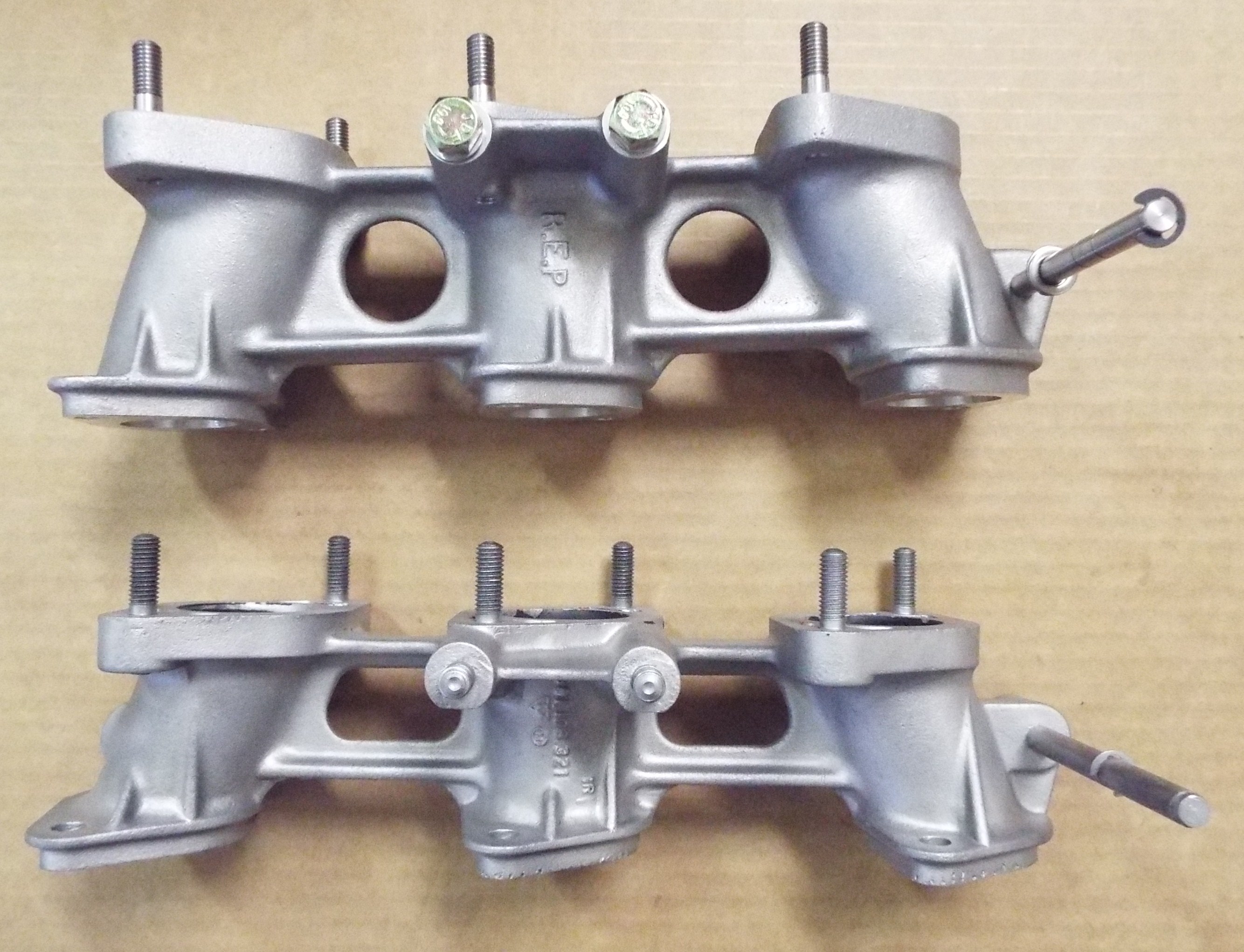

Richard at PMO recommended the 40/38 “tall” manifolds. But the height concerned me at 3.9 inches as I wanted to leave myself the option to use a 914-6 air cleaner should I want to. I have heard from many that you just might get tired of the sound right behind your head or for longer drives and maybe to get my wife to ride in the car. (IMG:style_emoticons/default/smile.gif) So I elected to go with the 40/36 “short” manifolds at 3.25 inches. Sounds like I am necking it down I know, but Paul at Performance Oriented said that with the 36mm venturi’s in the carbs it should be fine.
The pictures are distorted a bit, because I was so close taking them, but you can see the height differences. Note the original manifolds are about 2.75 inches high.
Nice how the PMO have the rubber grommets in the manifold that the spark plug wires go through.
And you can clearly see the differences in flanges.
defianty

I'm in a similar position at the moment Lucky 9146.
I think I have the 'tall' manifolds and am concerned they're too tall to fit correctly with the rain hats I have.
http://www.914world.com/bbs2/index.php?showtopic=315580

Heard from Rick 918-S that he does not have any 39mm Alien Plates at this time and he would have to make them. Plates are shown above and made for adapting original intake manifolds to cover the CIS scallops in the heads. Rick had offered to let me try them. Don’t want Rick to spend the time to make up something that I may not ultimately use, so I am going to proceed with the PMO CIS Standard Manifolds (often referred to as short, see previous postings) since I already have them. “Nothing like a high cost solution for a low cost problem” as Rick puts it. (IMG:style_emoticons/default/biggrin.gif)
It’s not like I can’t wait for the plates, because my progress is so darn slow, but I really was leaning toward the PMO manifolds anyway and it didn’t seem fair to Rick. Thanks again Rick for the offer!

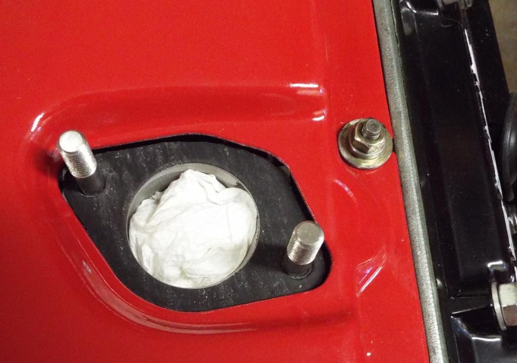

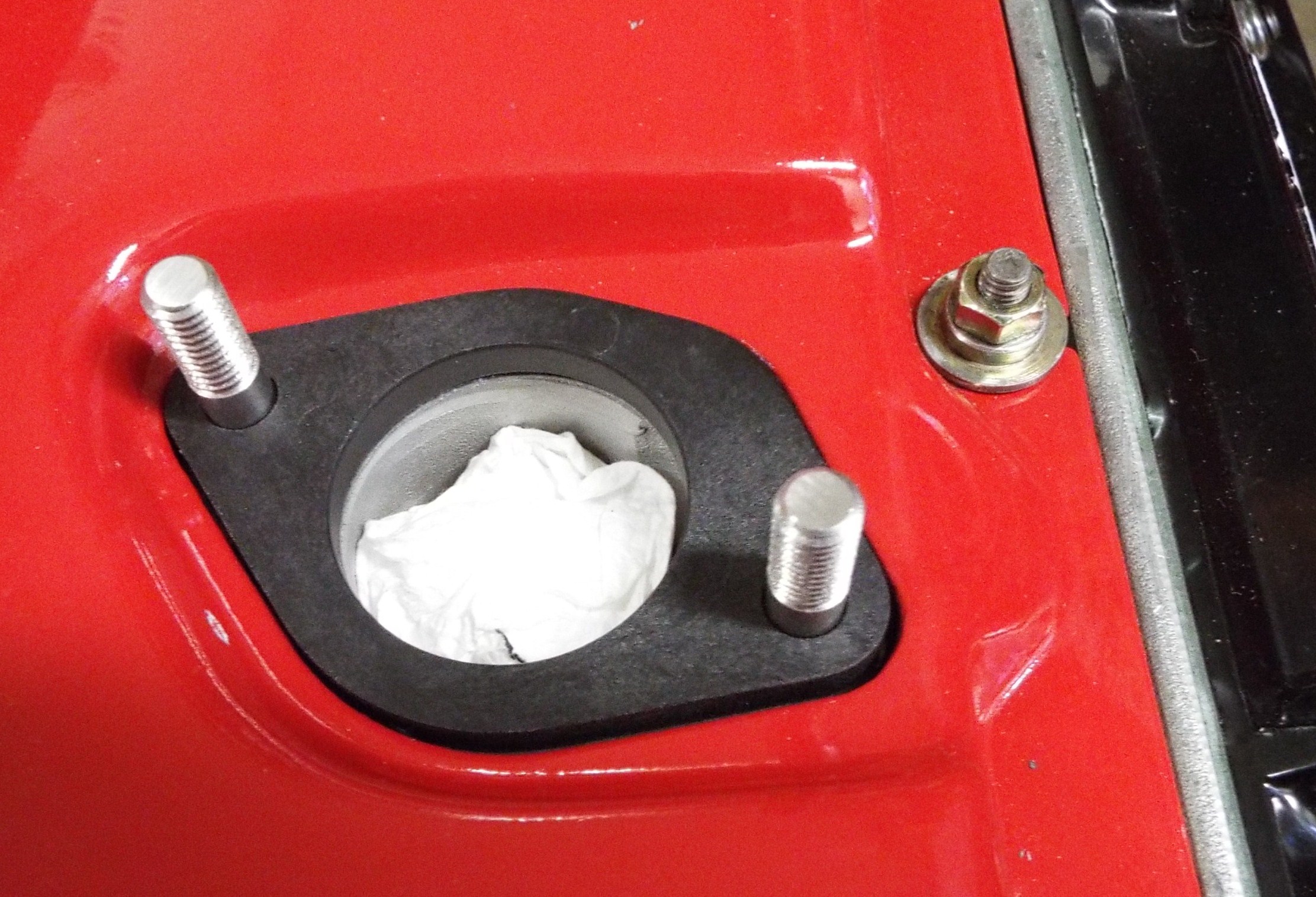

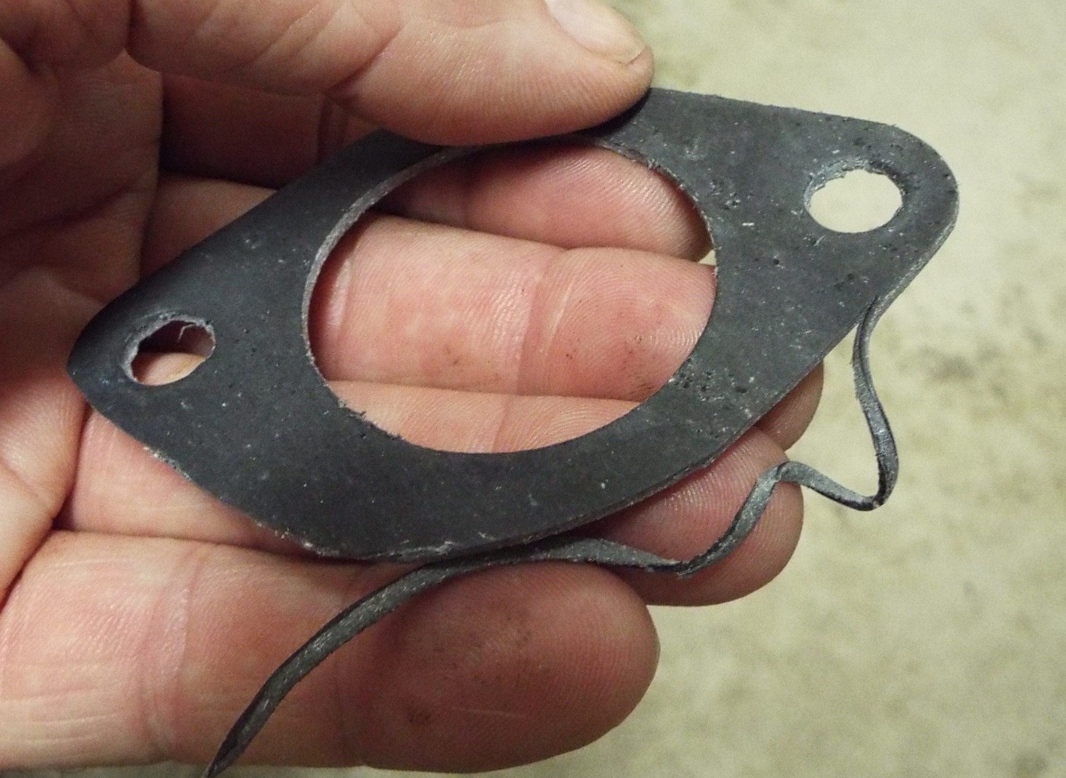

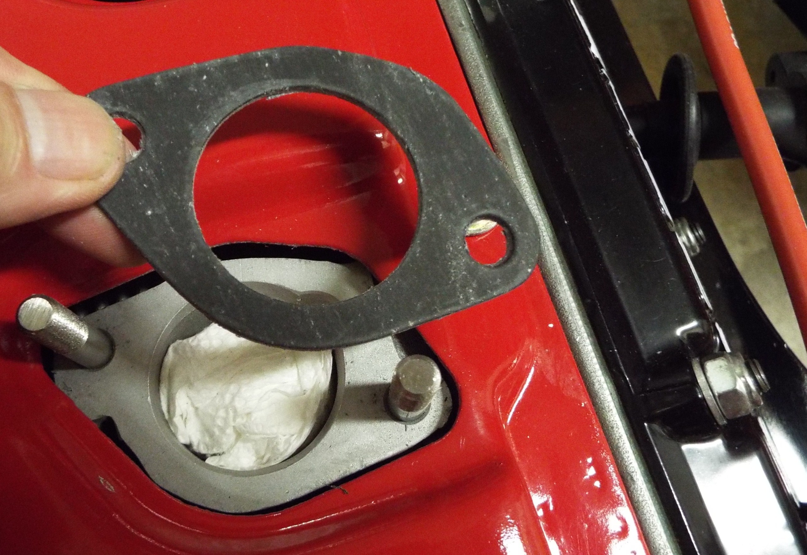

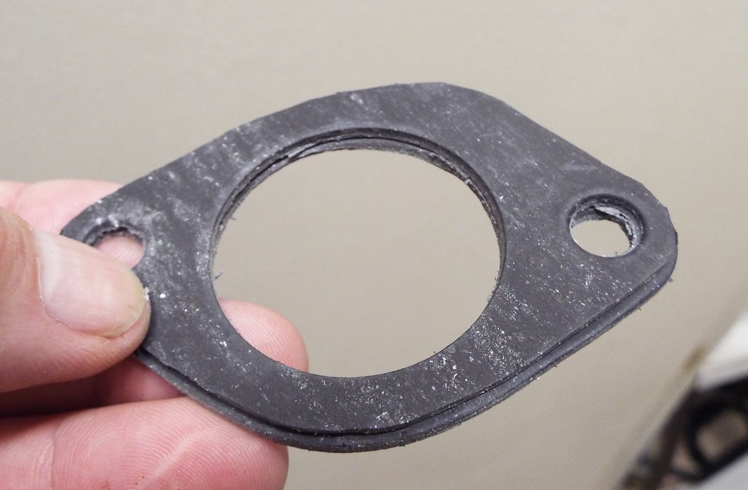

Now on to another time gobbler (at least in my case) is the gaskets supplied by PMO with the insulators for the intake manifolds. The good news is for the most part the insulators fit down through the engine shroud with only minor exceptions but the gaskets are far larger and require trimming.
And I thought I was just going to slap them on there! Ha! (IMG:style_emoticons/default/headbang.gif)
This may seem like such a minor thing to bring up and cover but luckily for me my engine is not installed yet for performing this operation and right now I can easily see how to trim the gaskets with the engine right in front of me. I did this with a nice sharp pair of scissors.
But for someone doing this after the engine is in, man I feel for ya.
Additionally, these gaskets seem to have a lot (and I mean a lot) of loose flaky material in the bore of the gasket that unless removed and cleaned up could easily fall into the head. I also recommend running something like an old stud through the gasket stud holes prior to installing it as there is also a lot of flaky crap in those holes that goes everywhere when you slide the gasket down the intake studs. PIA
Does Not fit through the shroud at all, and this is my original shroud.
Trimmed about this much
Comparison and all the flaky loose crap
Just the gasket in place
Insulators fit pretty well and yes that's another damn flake in the hole..... I'll get it...
Another gasket goes on top the insulator and really does not need to be trimmed but might as well as it looks kinda stupid if you don't with a big ole gasket hanging over the insulator. (IMG:style_emoticons/default/WTF.gif)

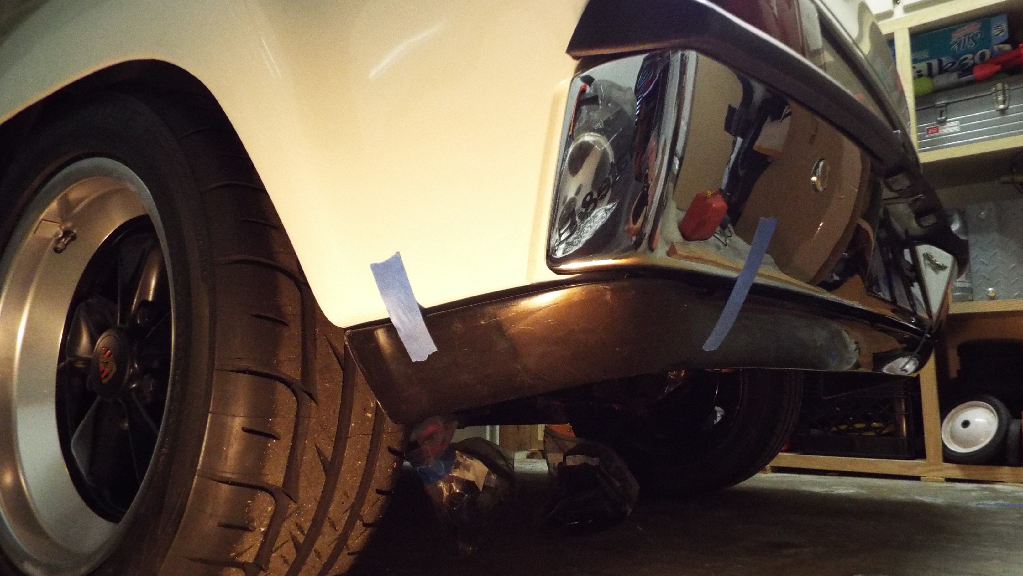

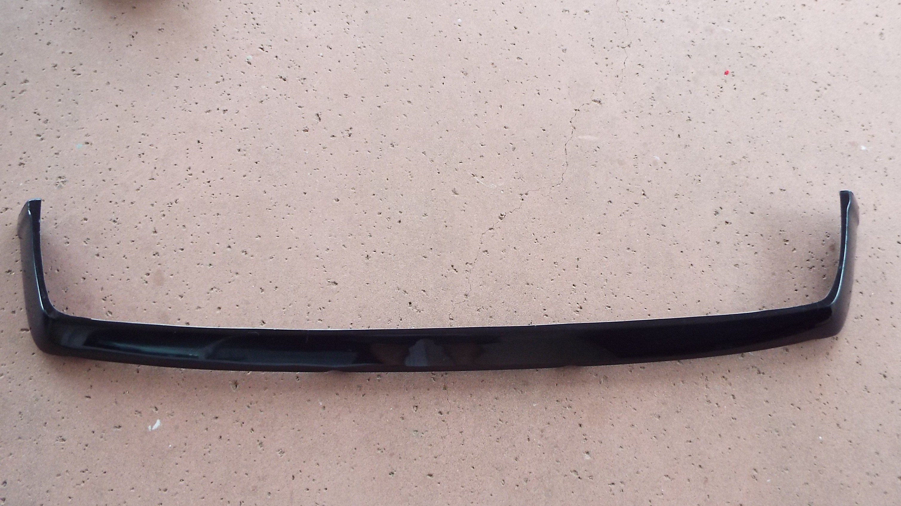

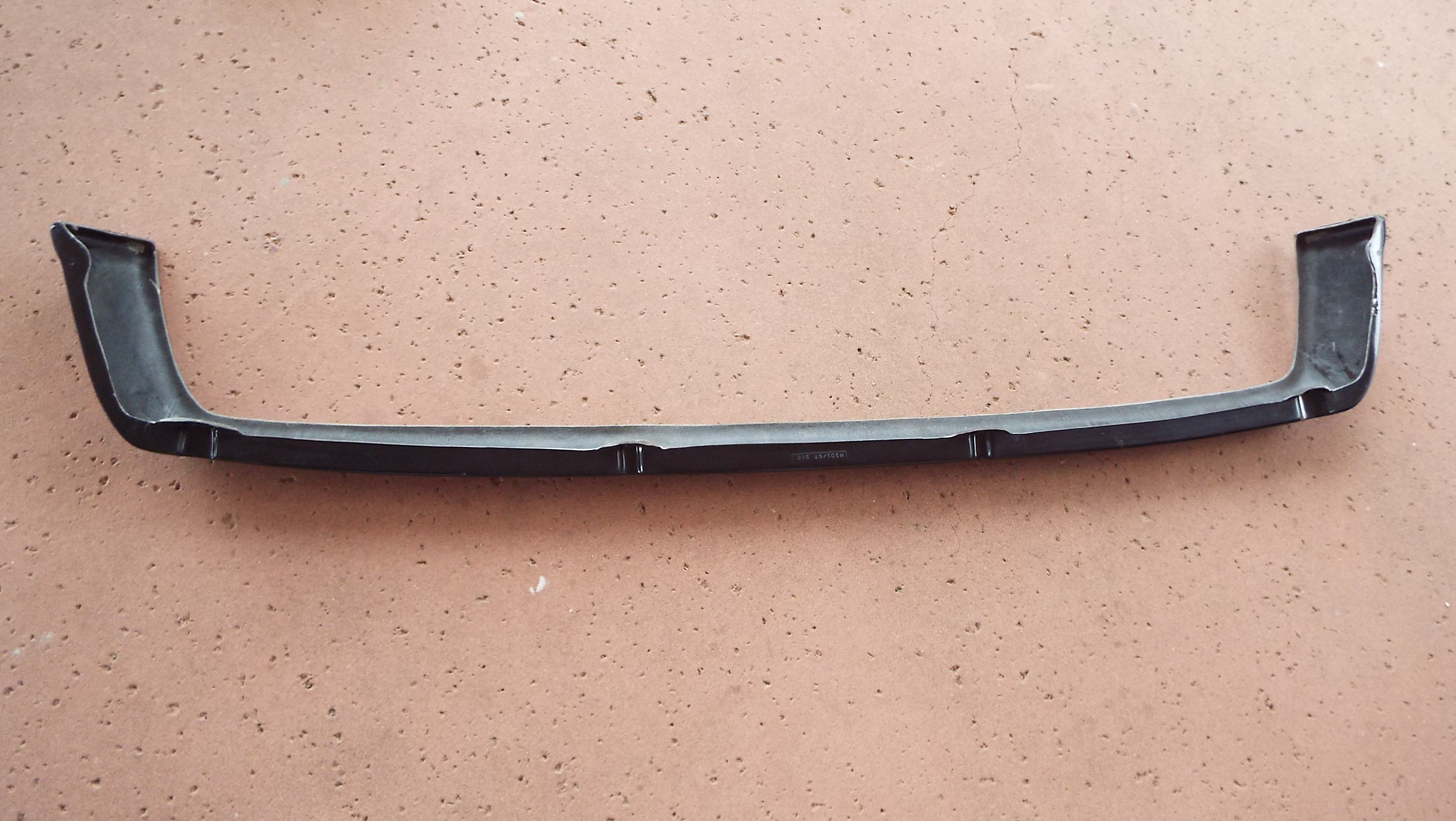

Yesterday…….Off subject of the engine for a minute.
If you have not yet met Marty Schneider of MSDS you are missing out! What a great guy! I had heard a long time ago from mepstein that Marty had fabricated a fiberglass GT rear valance for 914-6 GT flared cars.
I was heading up to the LA area early Saturday morning for a different reason and decided on a Friday night to contact Marty and see, on a long shot, if he would meet me and sell me one of these GT flare valances. To my pleasant surprise he said he would! So I present myself to his shop at the prescribed time and there he was. Great to talk with, easy going with a wealth of information and experience, and lots of good stories. Not hurried to beet feet out of there on a very warm Saturday morning plus holiday weekend, he took the time to educate me on the nuances of the valance and make sure I understood what needed to be done for fit and finish. He even offered a 100% refund. How can you beat that! Maybe I shouldn’t have said that but I get the feeling the he treats everyone well. Sorry if I spilled the beans there Marty!
I learned from Marty that he had one of these valances molded for his own car, which had factory PN GT metal flares, and then he had some valances made to sell. Keep in mind this is NOT a tall valance but rather deals with the flared fenders instead and looks to be about the same height as a regular valance.
I know, I know, a “real GT’ has no rear valance but I kind of like the idea of a clean look and it could be removed so no harm done. So, why not?
Oh, and one last thing I got the last one he had but he said he will be making another batch of 25 sometime in the future. What a great experience (well except for LA traffic). Picture below of the valance taped in place this morning. Another future project to paint and fit. Looks like a winner! Thanks Marty
P.S. It was cool to see where my headers were made.

That's awesome Jim. I had the same experience when I met him at his shop and picked up the headers. He is truly an ambassador of these cars and a great guy to know and converse with. Will you need to clearance the lower edge for the exhaust tip?

I like the rear valance. I have a similar one made by a guy in Germany to go on my GT. For a road car I personally think they look better with the valance than the raw GT look.
Hey Rob, thanks, yes it is "some assembly required" (IMG:style_emoticons/default/sawzall-smiley.gif) and you have to make the cut out for the exhaust but I don't think it will be a big deal. I hope.
