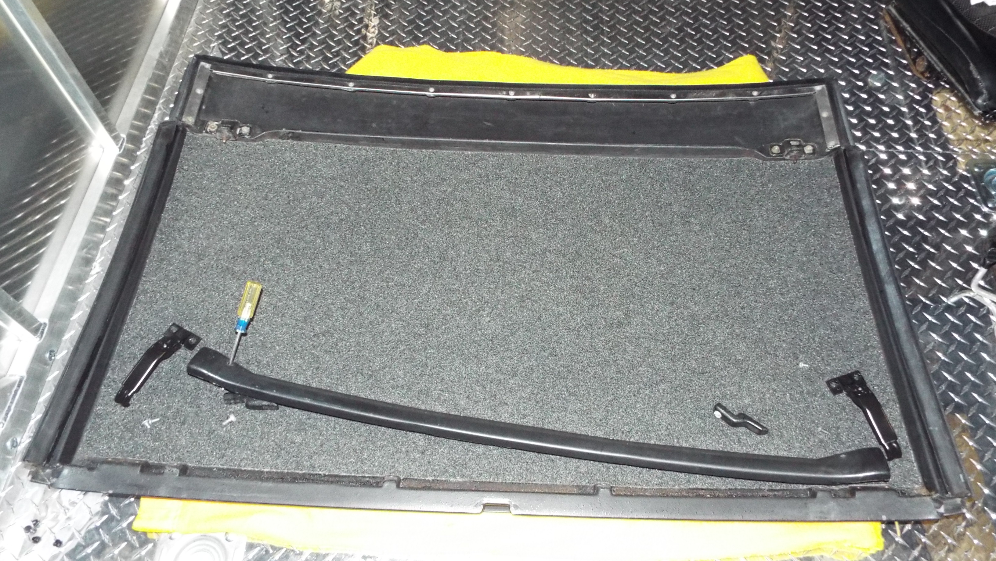

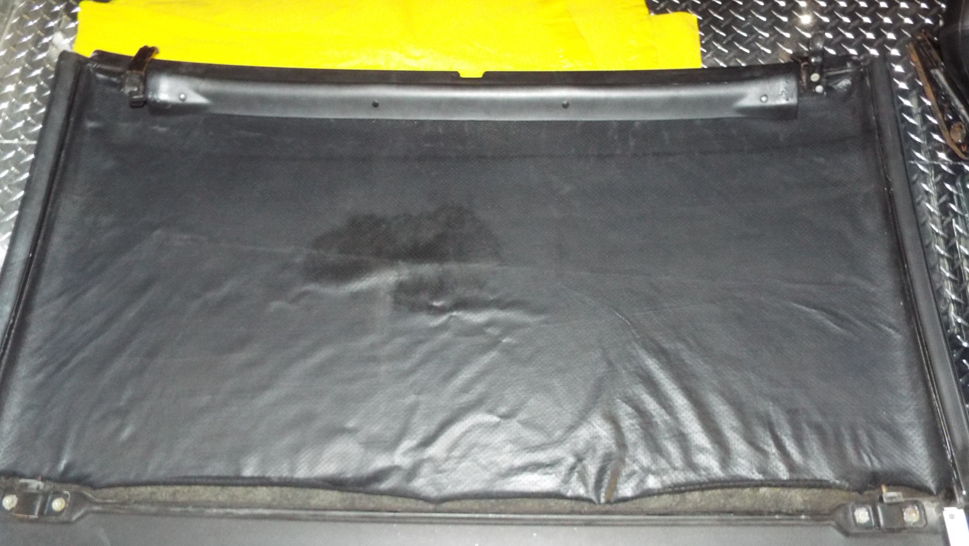

In addition to my partial list of things yet to be done in my last big post, my Targa top needs the headliner changed and maybe, an exterior repaint. Made a little progress on the headliner replacement the other day. Perlon from 914 Rubber. Another plug (IMG:style_emoticons/default/smile.gif)
Here is a prime example of chain of events leading to extra time and therefore not really knowing when the car will be done. That forward cover piece between the latches has 4 screws under those little plastic caps. Three screws came out perfectly but the 4th well, not so much. I won't say how long it took. (IMG:style_emoticons/default/mad.gif)
Then I discovered a lot of glue where it wasn’t supposed to be, so I have got to get that off of course! Then I realized the latches looked pretty shabby and probably should be stripped and repainted, so now I’m disassembling latches and on we go!
Could this have all waited? I suppose, but it’s hard for me to do things half assed I guess. (IMG:style_emoticons/default/biggrin.gif)

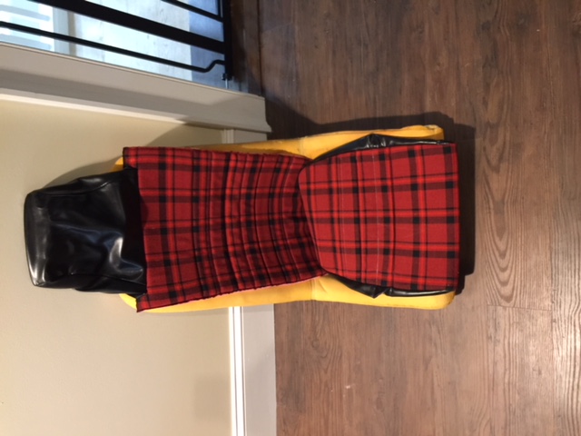

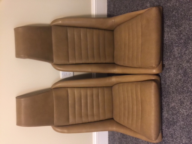

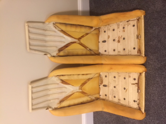

Just this morning I pulled out these seats to clean them off. Then things got away from me.

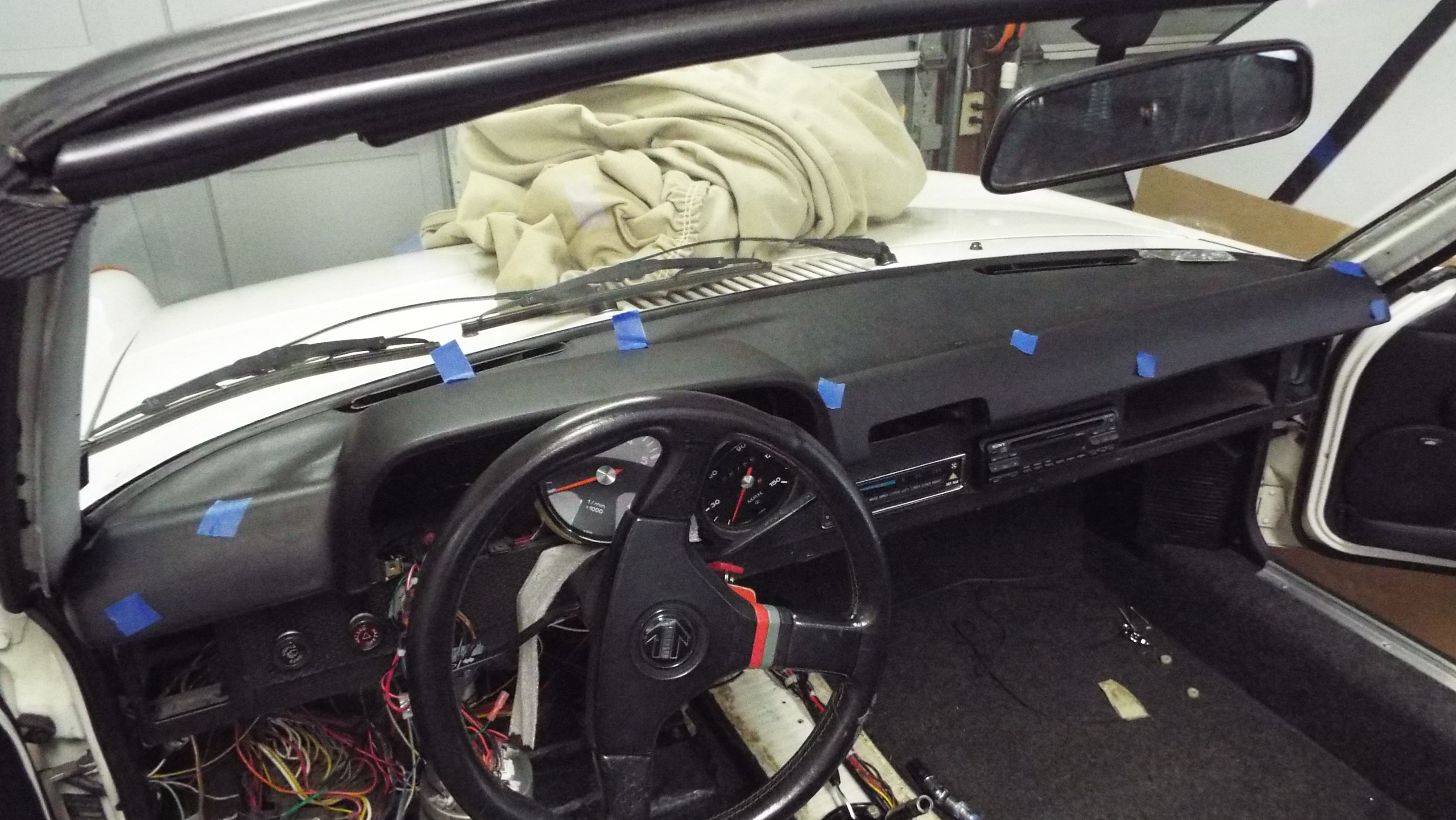

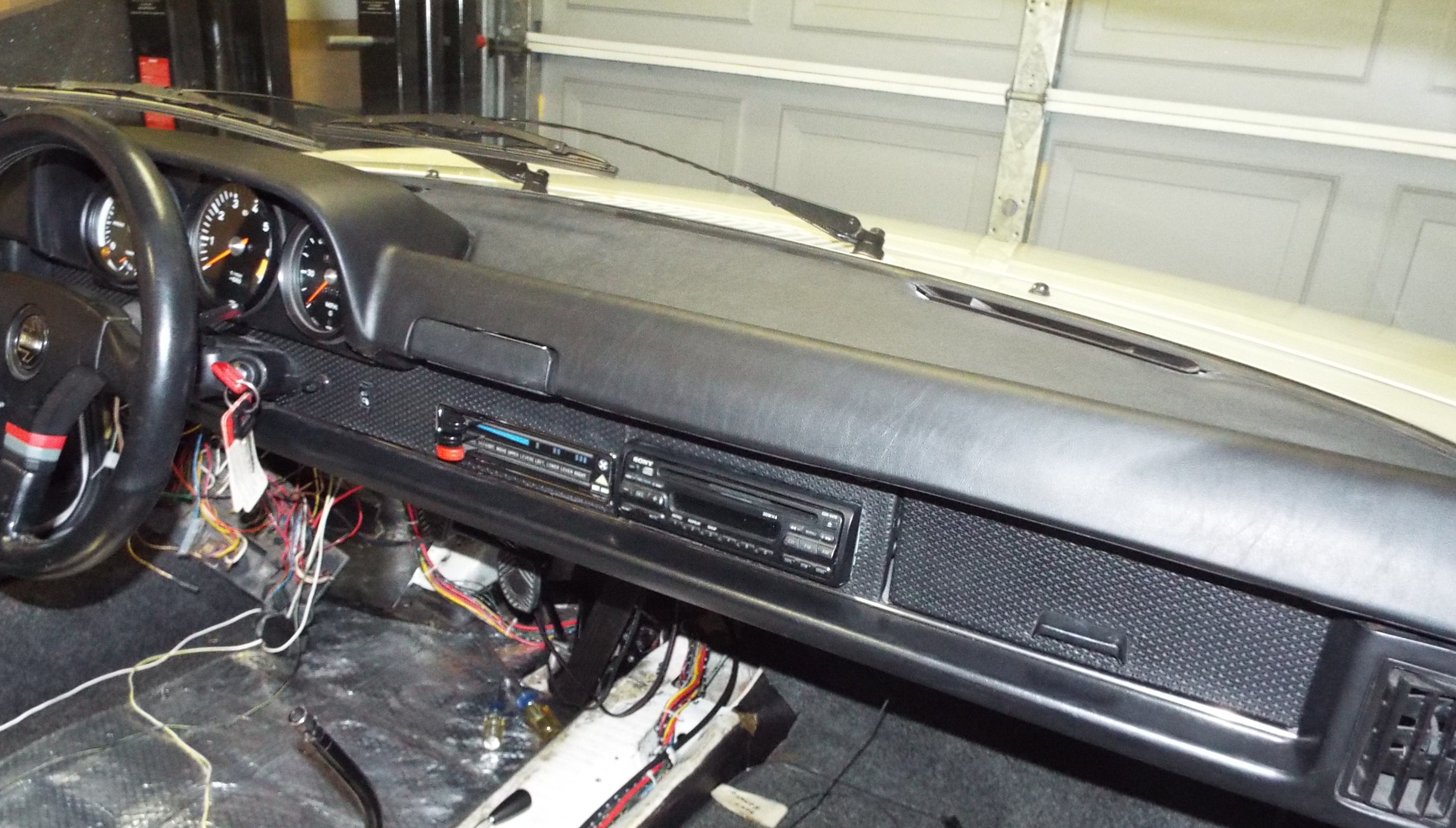

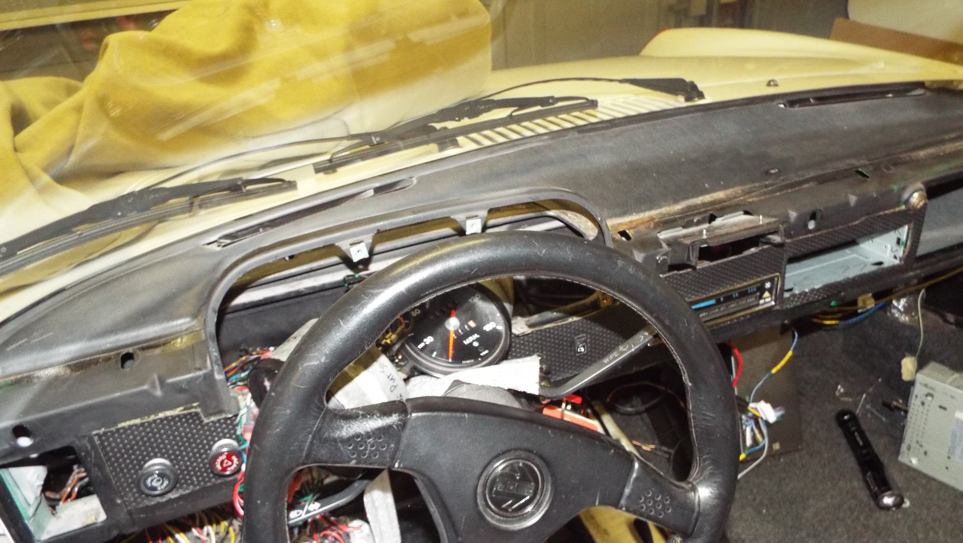

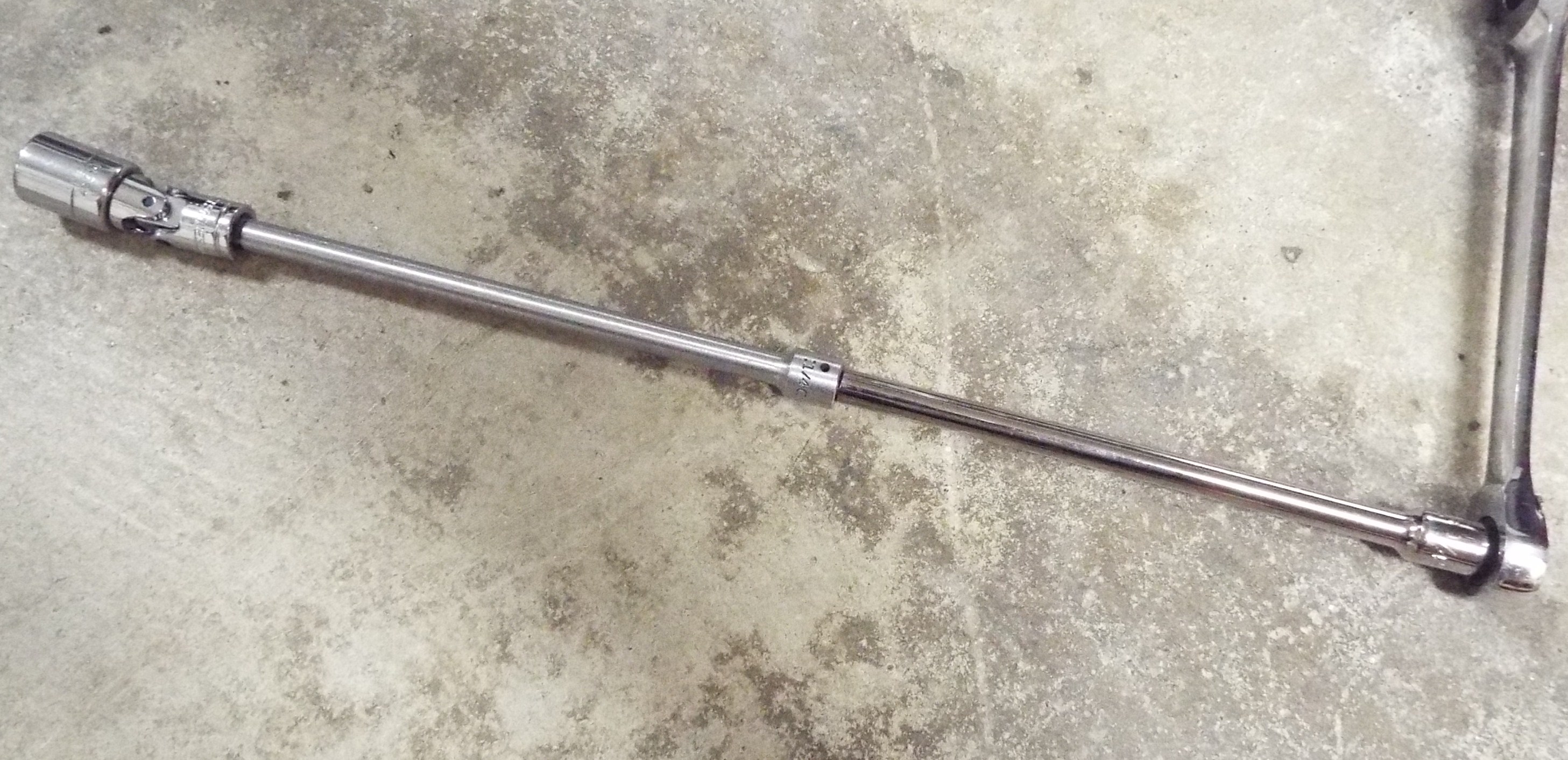

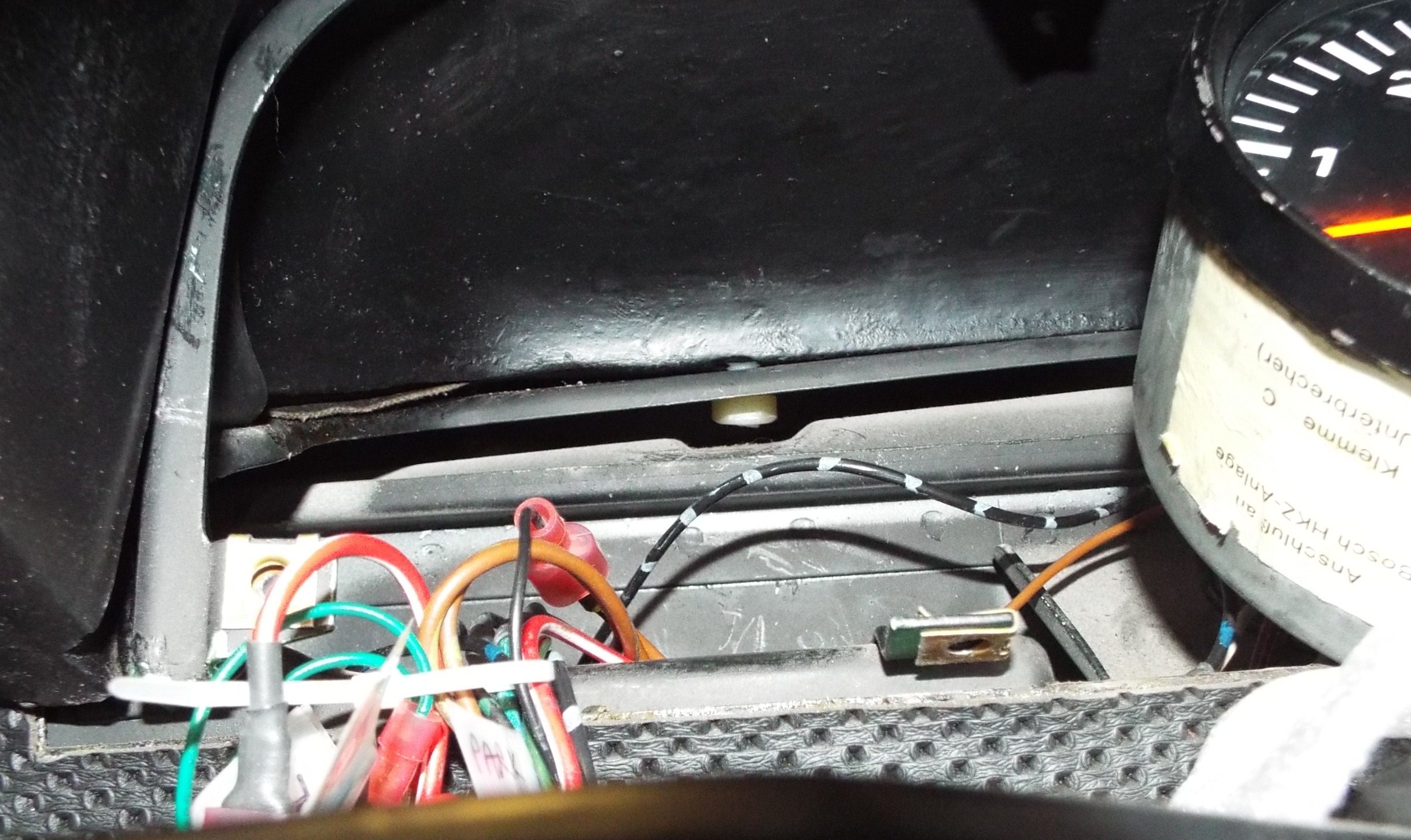

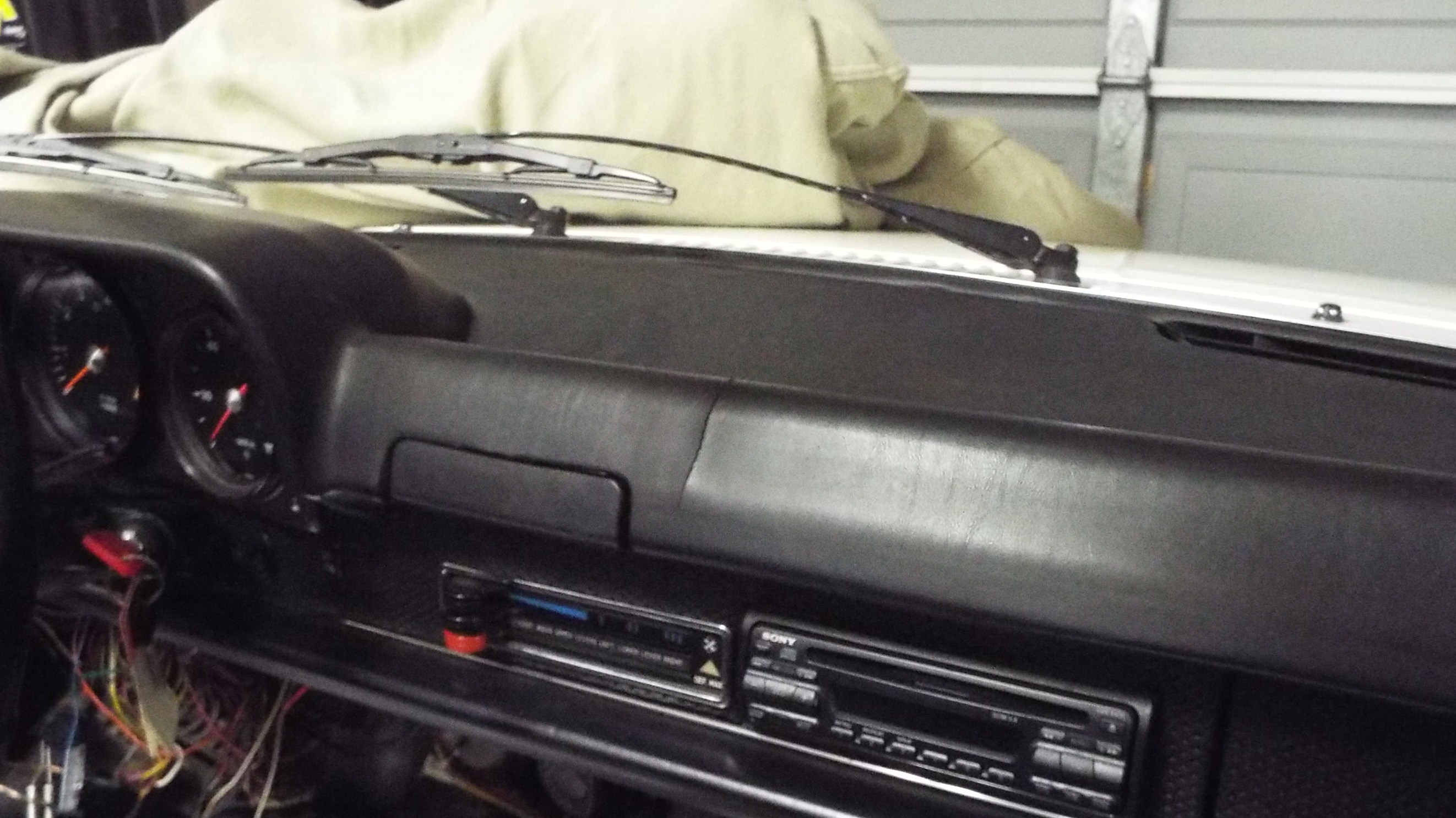

Finished the Dash Pad Install (IMG:style_emoticons/default/sunglasses.gif)
I would have to say it was not as bad as I expected but perhaps more involved than I thought it would be. There is a You Tube video out there where Brad Mayeur from 914 Ltd. installs a 914 Rubber dash. Watch it. (IMG:style_emoticons/default/type.gif) One of the key things out of the video is you really don’t have to remove your gages by unplugging all the wires.
There IS another couple of good tips in there and that stubby wrench he uses. Get one. I happened to have a stubby set so that was a good thing. But you do not have to use the stubby as much as he does, I found you can access 6 of the 9 nuts with this set up or a combination of it, all ¼ inch drive with 13mm socket. This really is your best friend!
Before, obviously a big crack but there were several smaller ones I had not noticed as much until removed.
Go ahead and remove the visors it just makes removing the interior windshield side trim easier. The hardest nut I found to remove was the left one over the gage panel, just real tight space.
Disassembly. You HAVE TO remove the radio. Further complicating my remeoval was the PPO had installed a amp under the radio.
You DO NOT have to remove the glove box. I didn’t realize that until after I had removed the glove box door. (IMG:style_emoticons/default/headbang.gif)
(IMG:style_emoticons/default/white914.jpg)

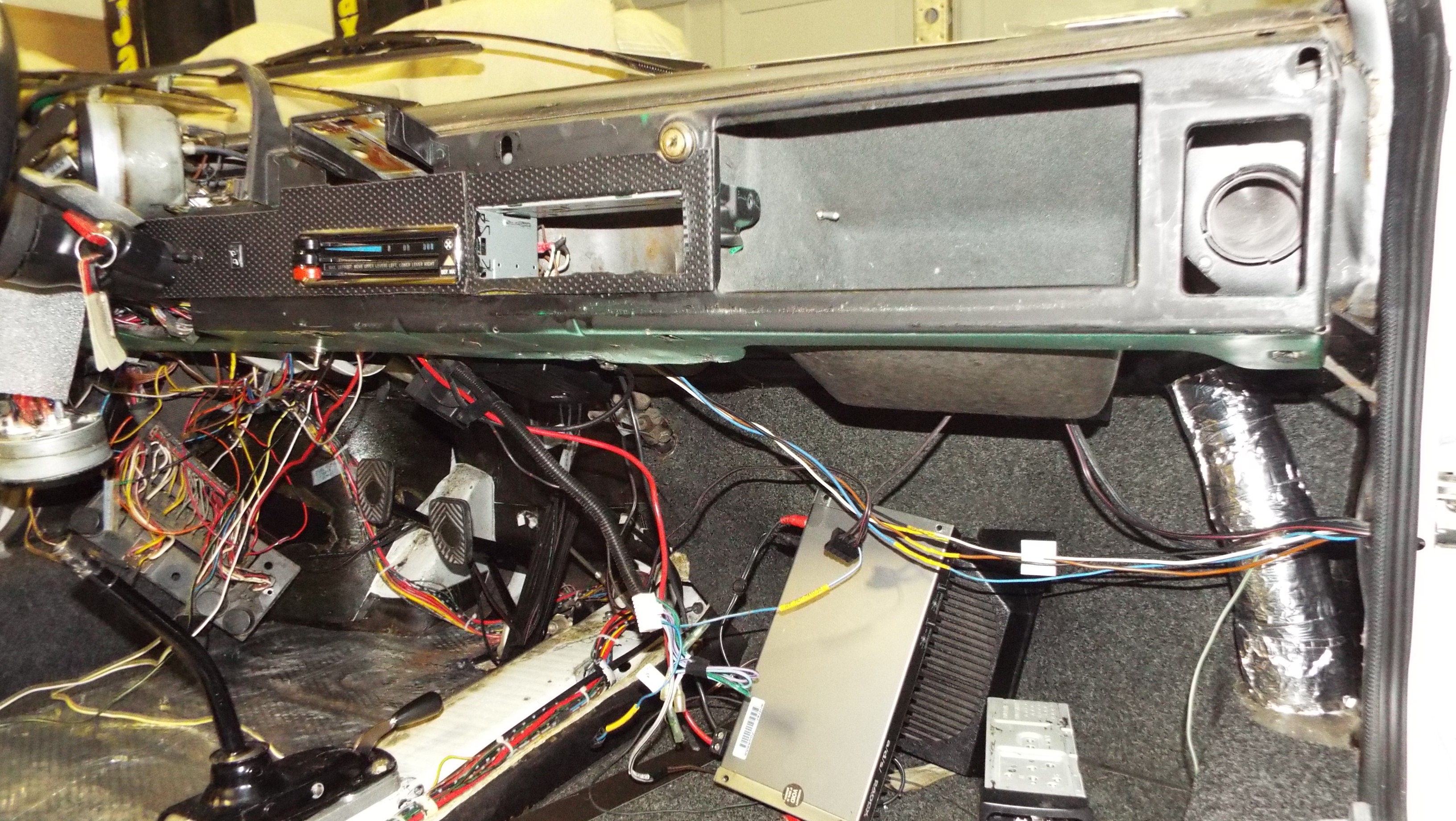

My disassembly looks worse because I still have my fuse panel dropped and don’t ask I don’t want to talk about. (IMG:style_emoticons/default/sad.gif)
Picture has blue tape roughly marking the location of the 9 nuts. Radio out Yes, glove box out No.
Done. Love it! Glad that one is now behind me! On to the next. Started on my frunk board thanks to Defianty inspiration.
