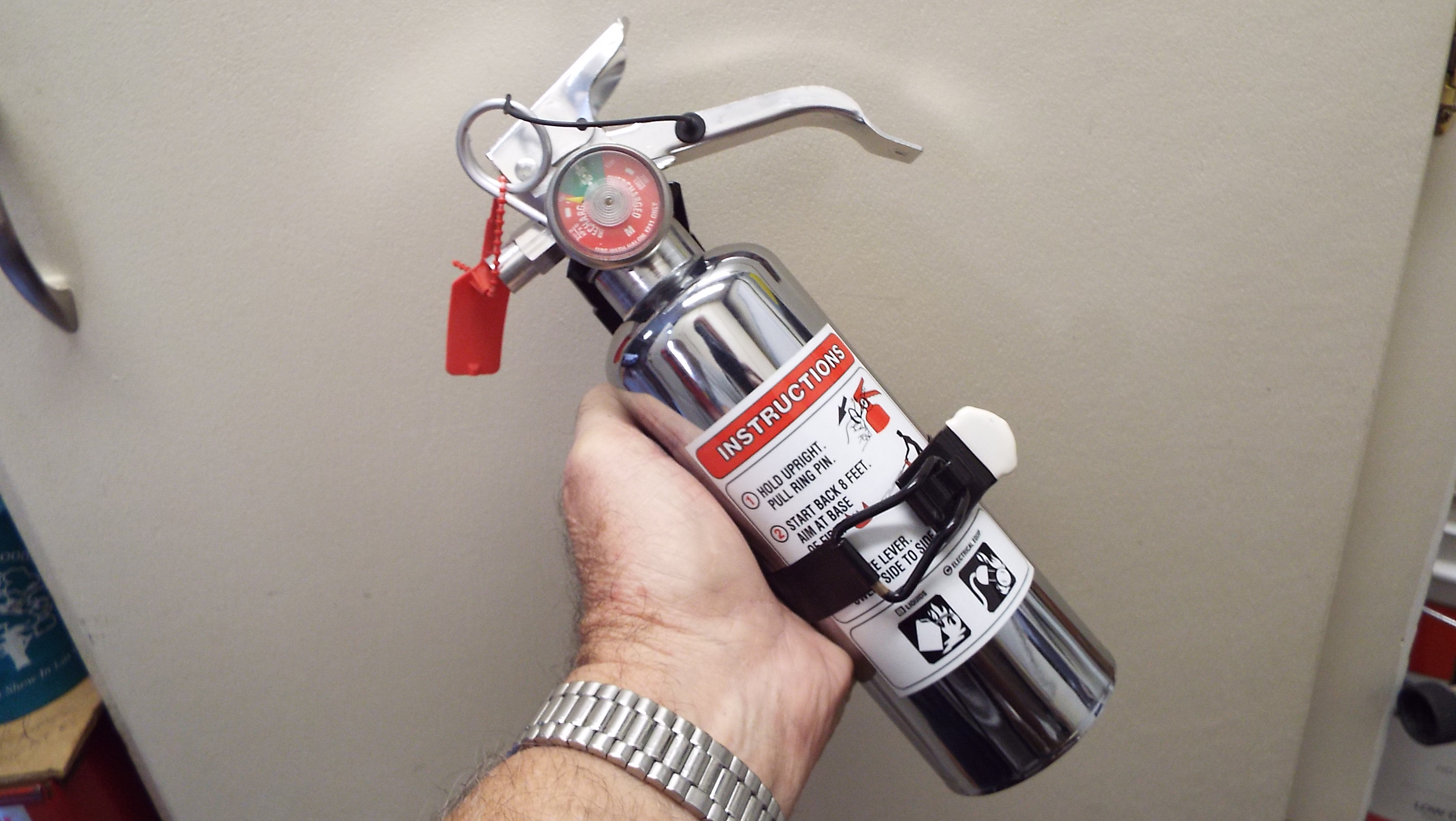

Going to give it a go on converting this old empty fire extinguisher into an oil breather catch can (IMG:style_emoticons/default/sawzall-smiley.gif) (IMG:style_emoticons/default/welder.gif) t Collins here on World provided detailed and helpful information that he painstakingly and thoroughly sent me. (IMG:style_emoticons/default/beerchug.gif)

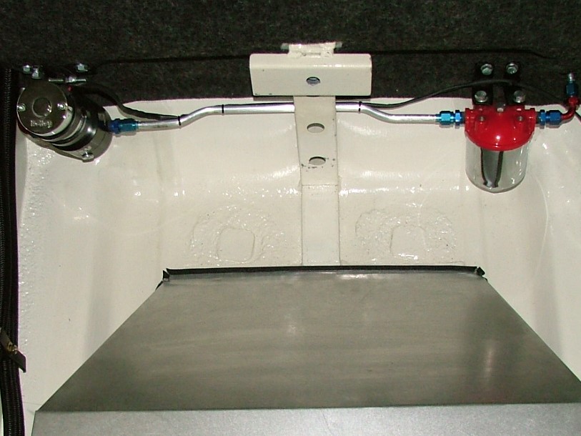

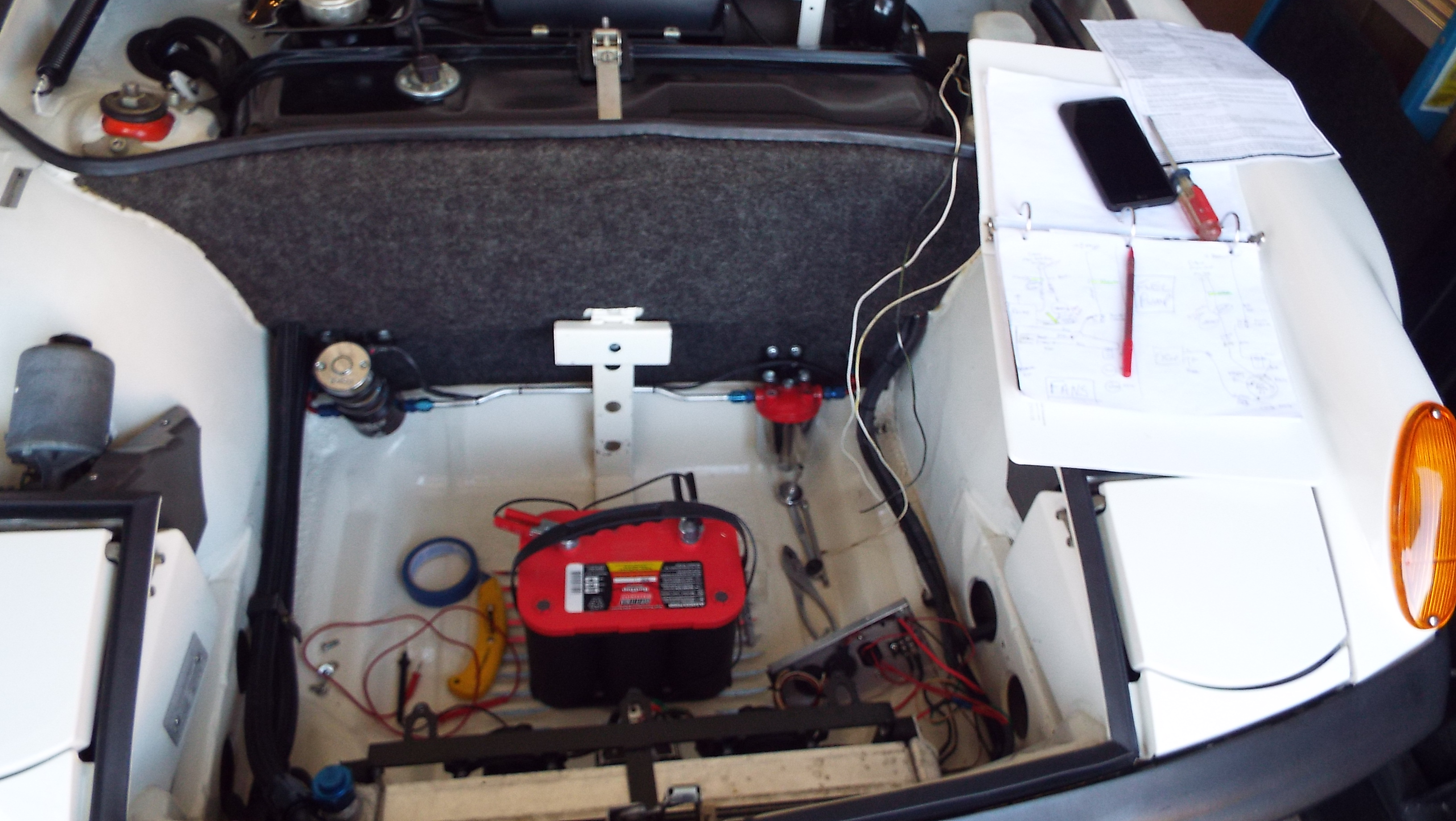

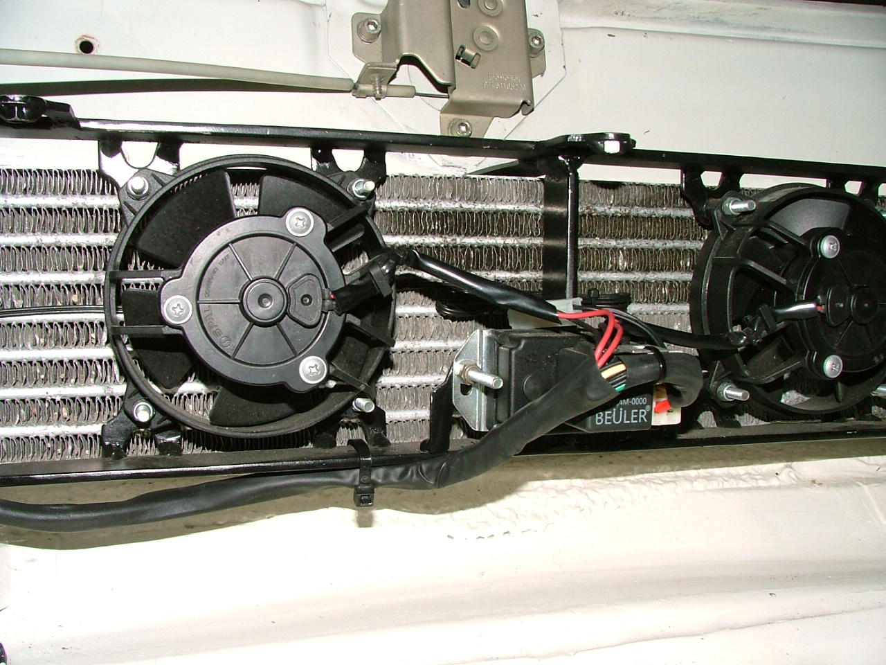

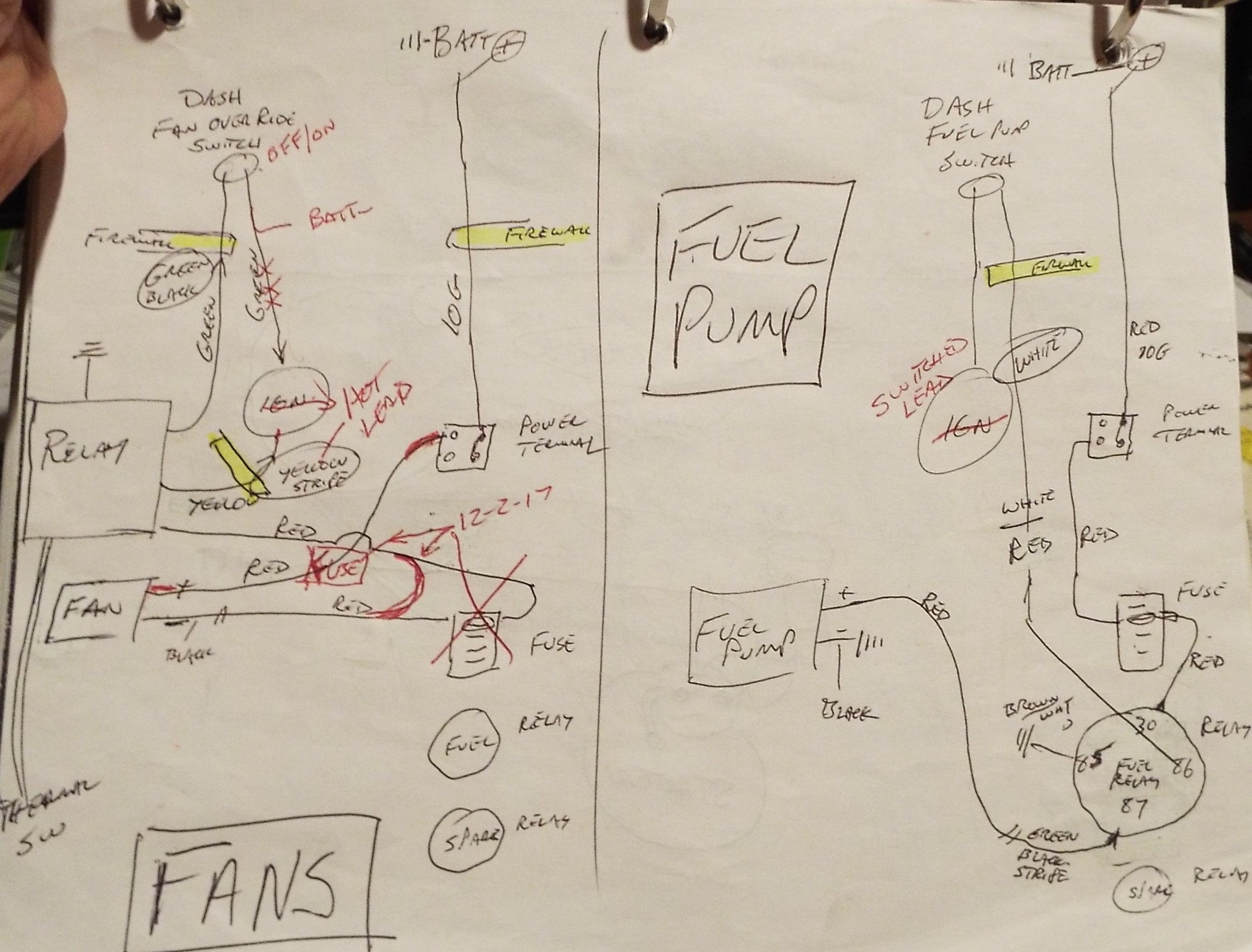

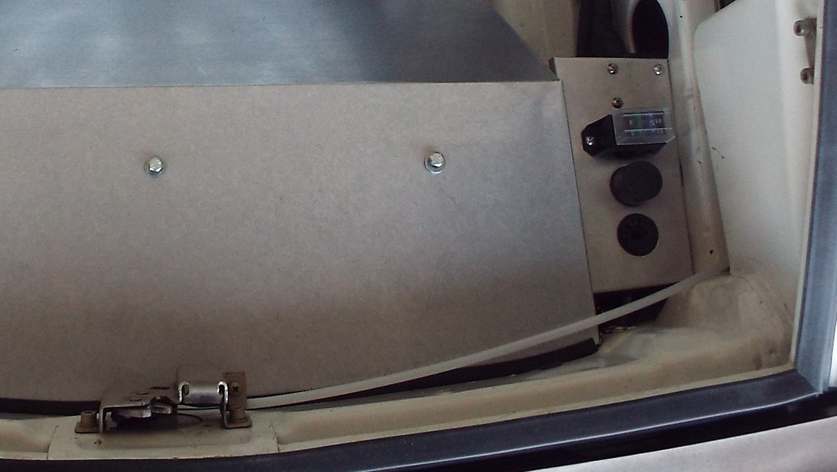

Friday was a good day because my buddy Toolguy came by to help me sort out some electrical “challenges”. Thanks (IMG:style_emoticons/default/beerchug.gif)
Back in Dec 2015 when I stopped working on the car some of the last things I did was wiring the relays and fuses on the Holly electric fuel pump and oil cooler fans in the frunk. Short story is I got all done wiring and neither one worked. Very frustrating! (IMG:style_emoticons/default/confused24.gif)
Fuel pump and Filter
Fuse and relay sub panel
We trouble shot the crap out of both circuits to find out 4 things:
First is the good news that I basically had the fuel pump and fans wired correctly.
Second, it turns out I wasn’t powering the relay correctly on the fuel pump.
Third we ended up calling the fan manufacturer to understand how the integral relay on the fans actually worked and proper powering for over ride switch.
Forth, I really did not have a good plan on the switches and connections under the dash.
So, with proper connections the fans work now too. But the fan fuse could have been better placed in the circuit and I took care of that this morning.
We looked at some other minor things and fixed a few and it was a good non-stop 4 hours work on stuff I could not figure out.
I would love to report I can now read a wiring schematic better but I can’t. (IMG:style_emoticons/default/lol-2.gif)
Still more wiring to do! (IMG:style_emoticons/default/wacko.gif)

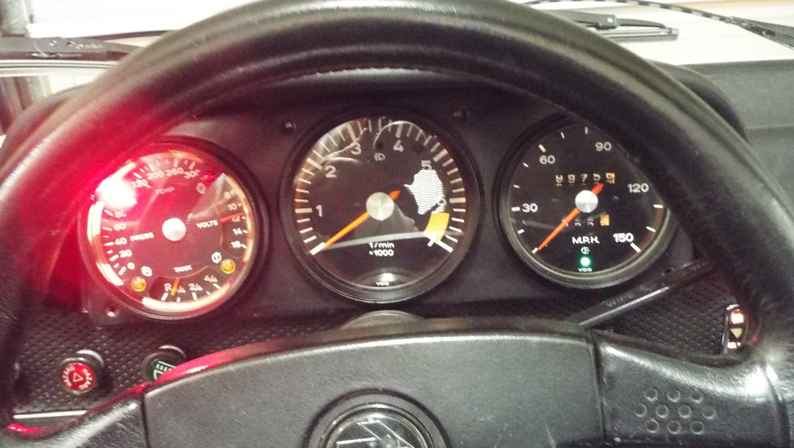

Ok so maybe I can figure out some of this electrical stuff after all. (IMG:style_emoticons/default/smile.gif)
Studying the wiring diagram last night trying to figure out how to stop my dash brake light from blinking when the key is on (normal function by the way on a ‘74 with the seat belt interconnect system in tack but long since MIA from my car) and also getting said brake light to work with the hand brake when pulled. It Did Not!
I actually figured out the solution and ran it by my electrical savvy friend toolguy and with his concurrence I tried it and PROBLEM SOLVED! I really wanted that behind me cuz it sure bugged me and I am very happy to see that light function properly now. This is me celebrating this small success (IMG:style_emoticons/default/cheer.gif) I can finally push the gages in and attach the gage panel.

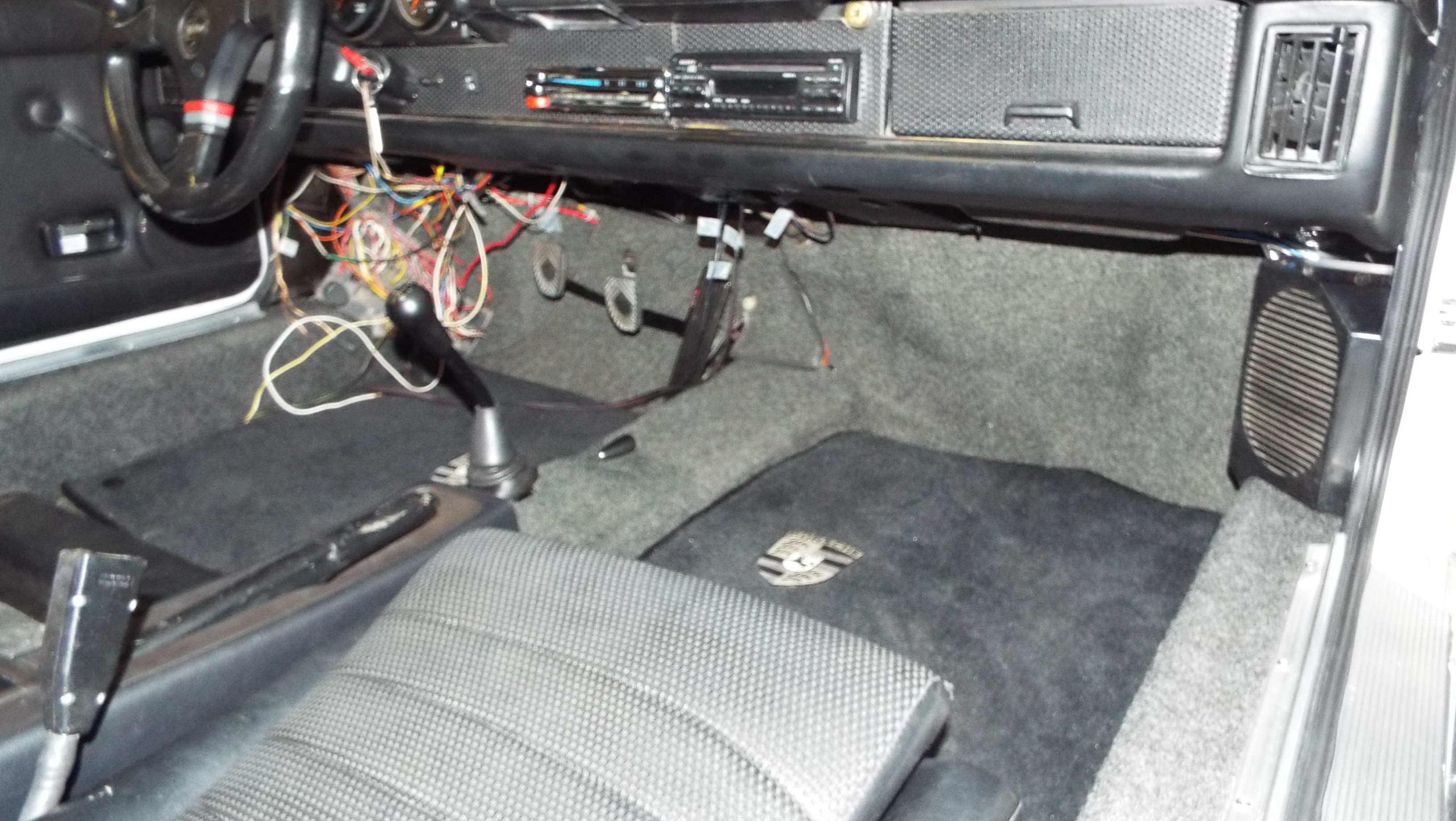

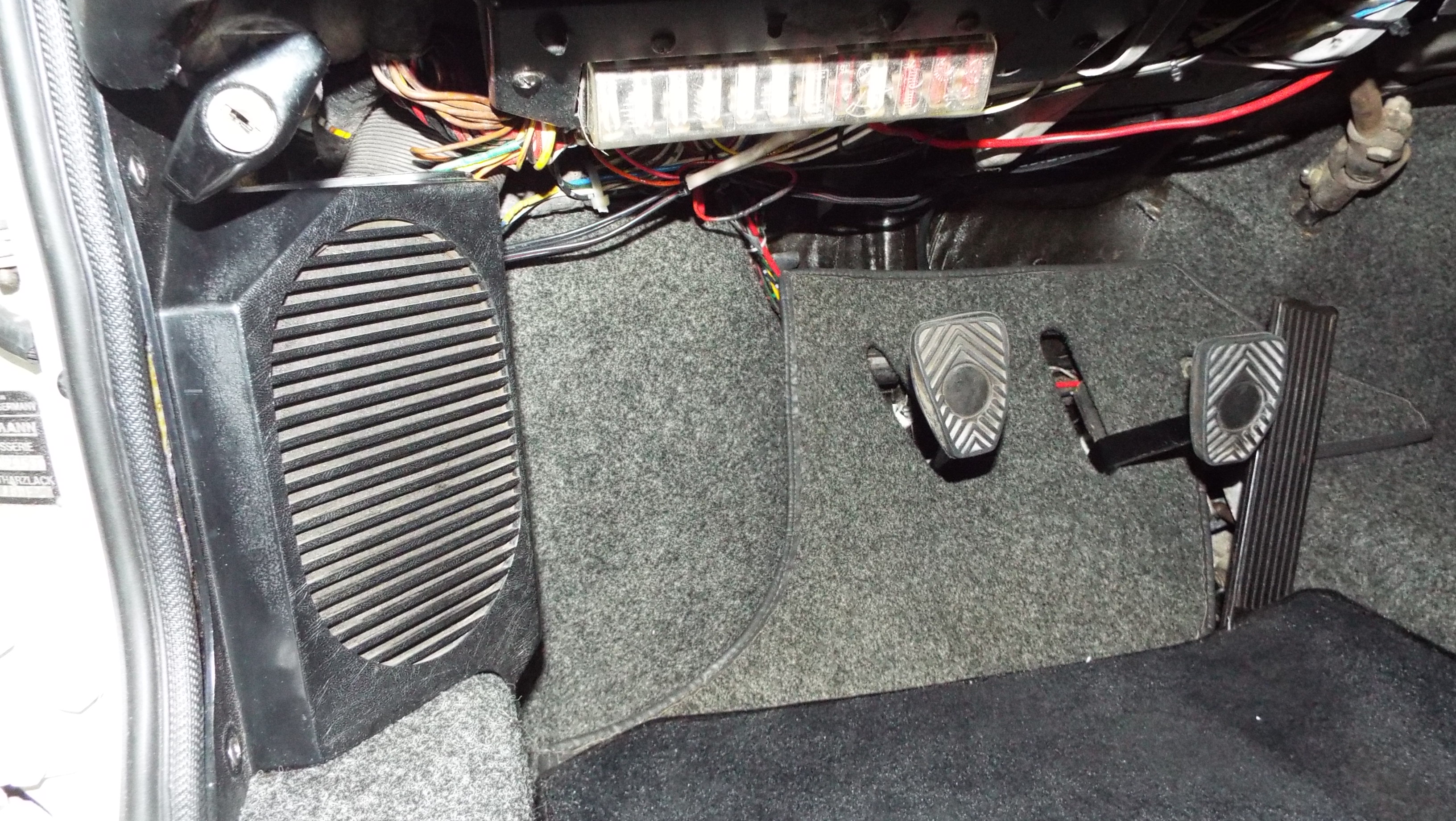

Interior assembly continues!

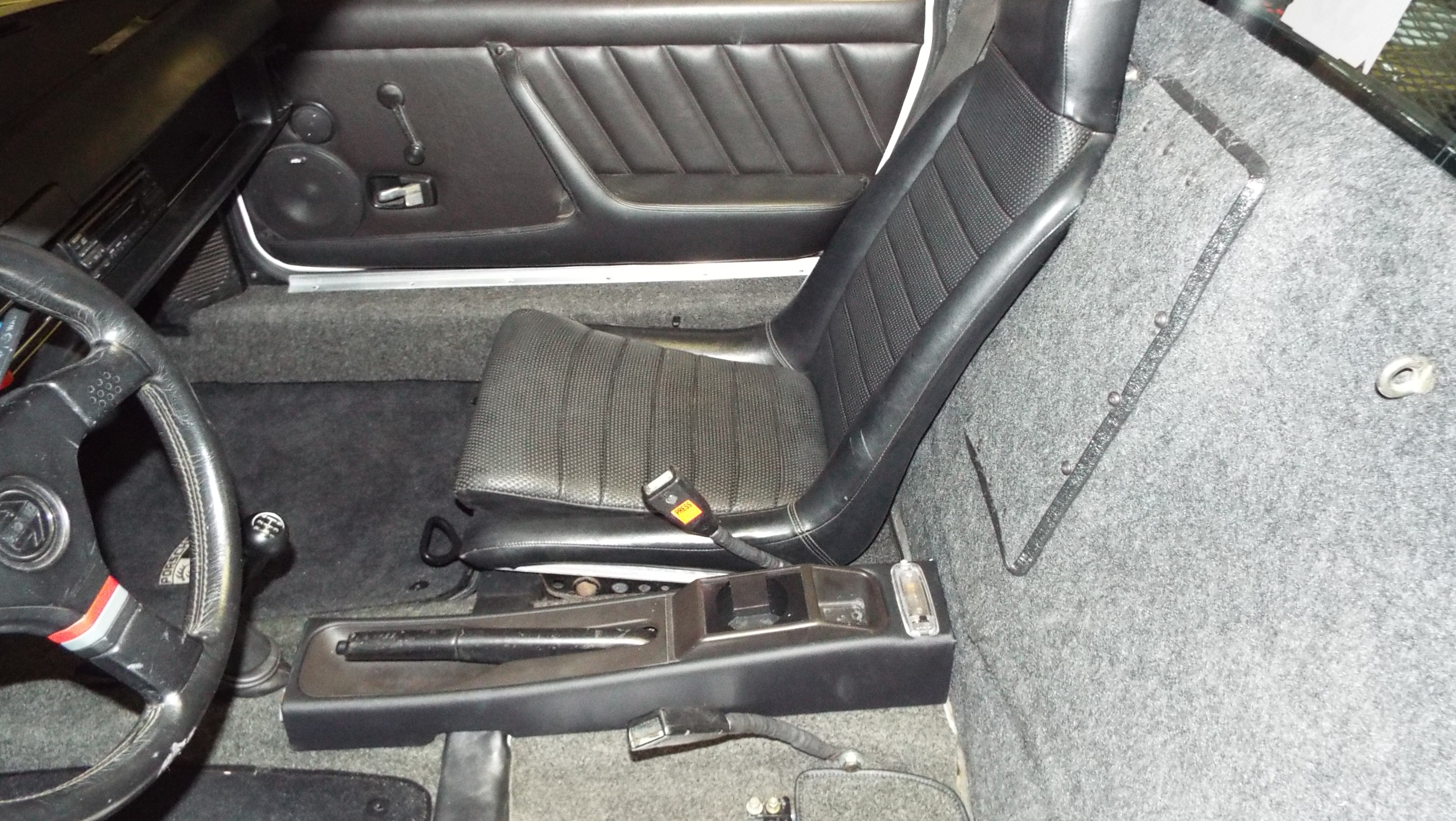

Today I finished the FINAL install of the forward tunnel carpet, center console attachment, and passenger seat.
Followed by the driver side upper forward kick panel carpet, pedal board and floor carpets and floor mats. Baby steps but progress and a full day!
Dang A little blurry

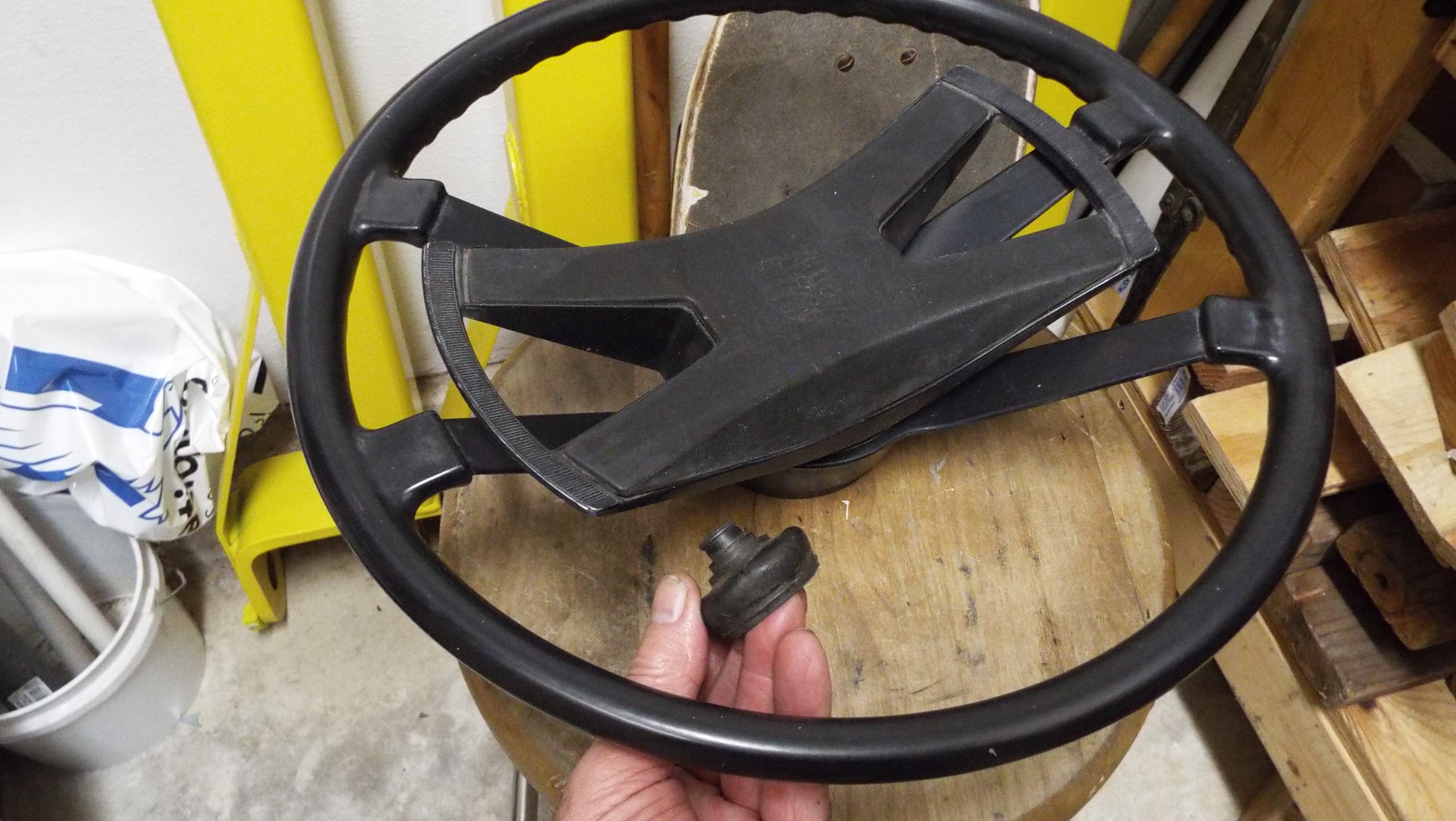

Dropped off my stock 914 steering wheel for leather wrap today. Decided not to go with the MOMO. Great guy does awesome work! Expensive to me, but likely chump change, small project to him. Here is why. He showed me around the shop and he had some early 911R seats and said the owner had paid 5k for the cores and was paying him 5k to cover them. Bit out of my league but here they are just absolutely exquisite work. Learned he also did an interior and saw pictures for a car that was at SEMA.
So, all that said, I feel a bit lucky he is even doing my piddley wheel. (IMG:style_emoticons/default/pray.gif) Even got to Pick the leather! I think my wheel is in good hands. (IMG:style_emoticons/default/smile.gif)

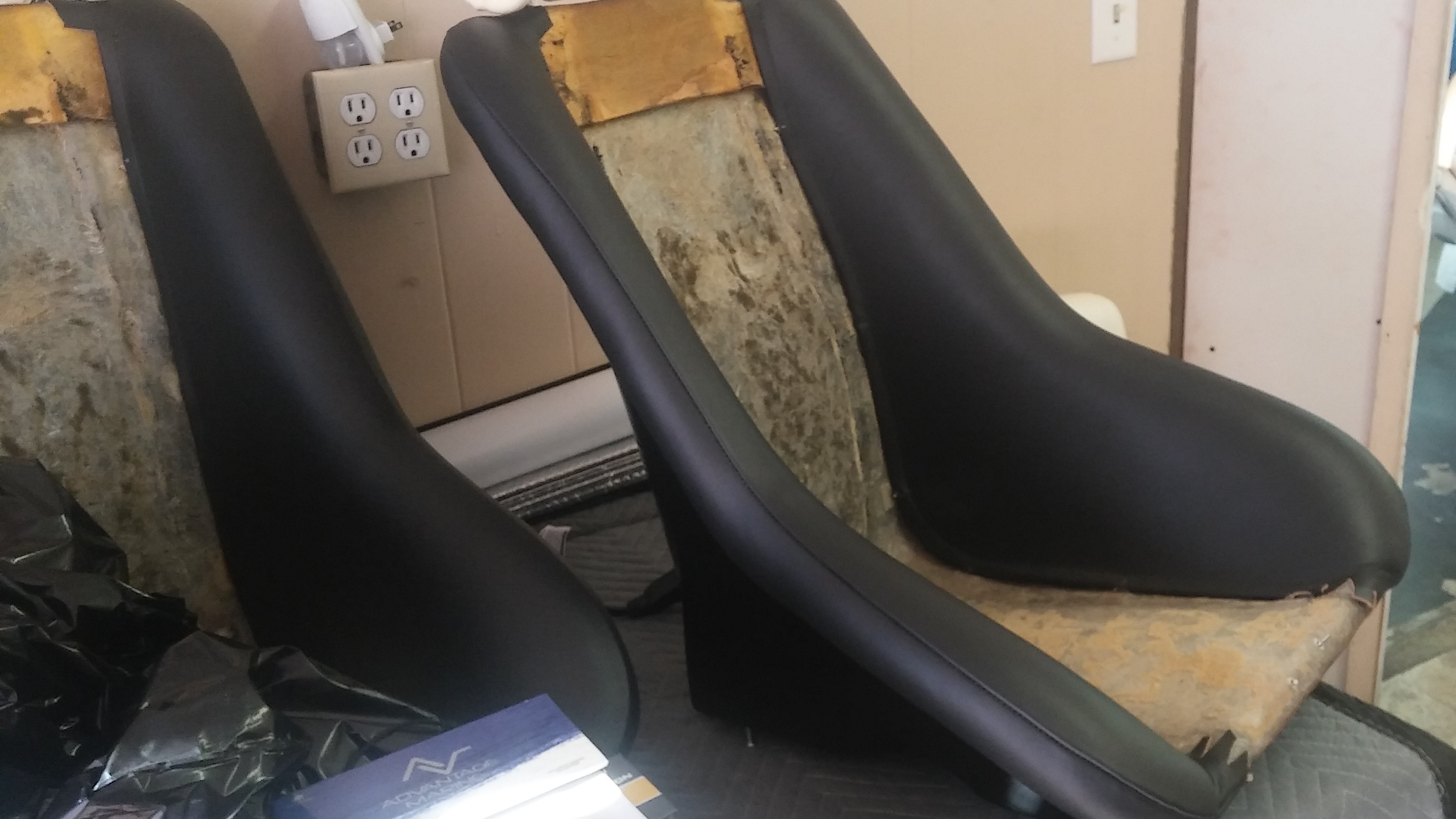

Here are the 10k seats, wouldn’t those be nice. (IMG:style_emoticons/default/wub.gif) (IMG:style_emoticons/default/idea.gif)

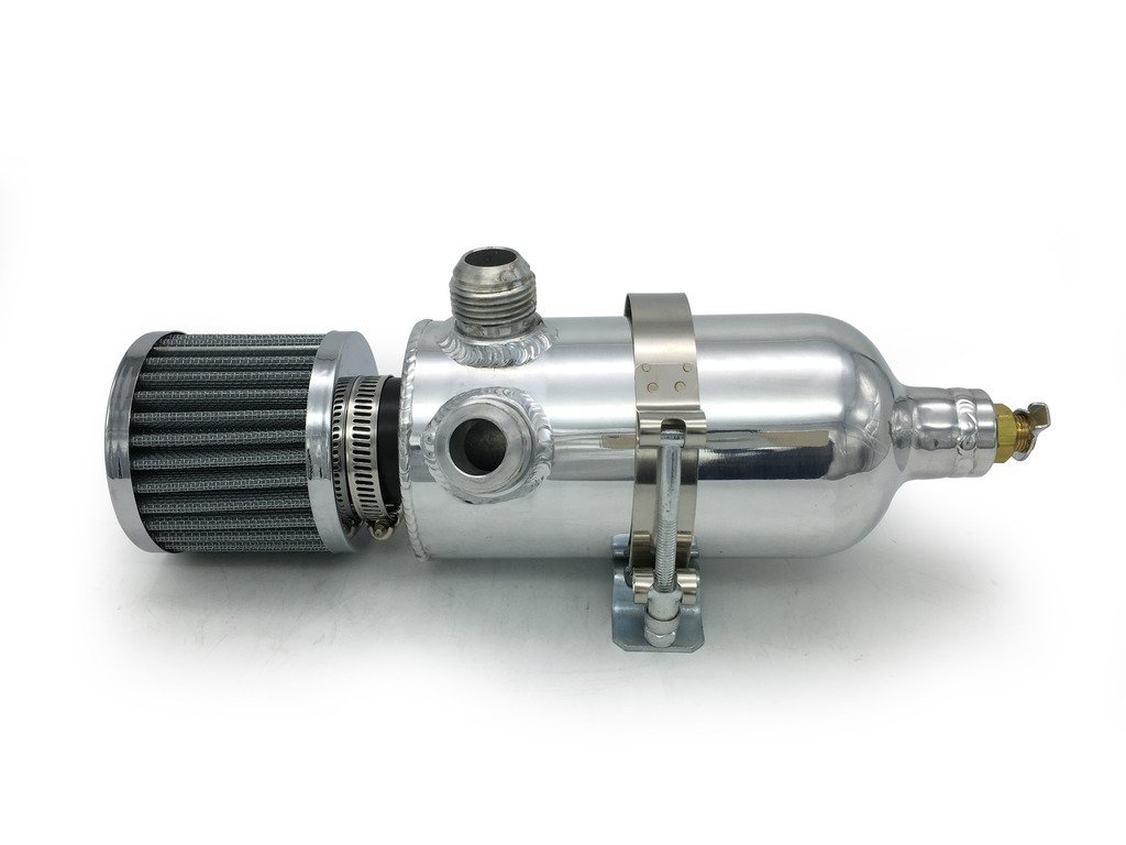

Gave up on fabricating my oil breather catch can myself. Just started to not make sense. I had started on that old fire extinguisher, cutting off the top, and putting a pet cock drain in the bottom. Then priced out a filter, a fitting, and then would still need to spend the time to weld and find a clamp it was already over $25 and I don’t think it would have looked that great all cobbled together anyway. (IMG:style_emoticons/default/sawzall-smiley.gif) (IMG:style_emoticons/default/welder.gif) (IMG:style_emoticons/default/barf.gif)
So, I went with this today for $55.00 Done! Thank you, Amazon!

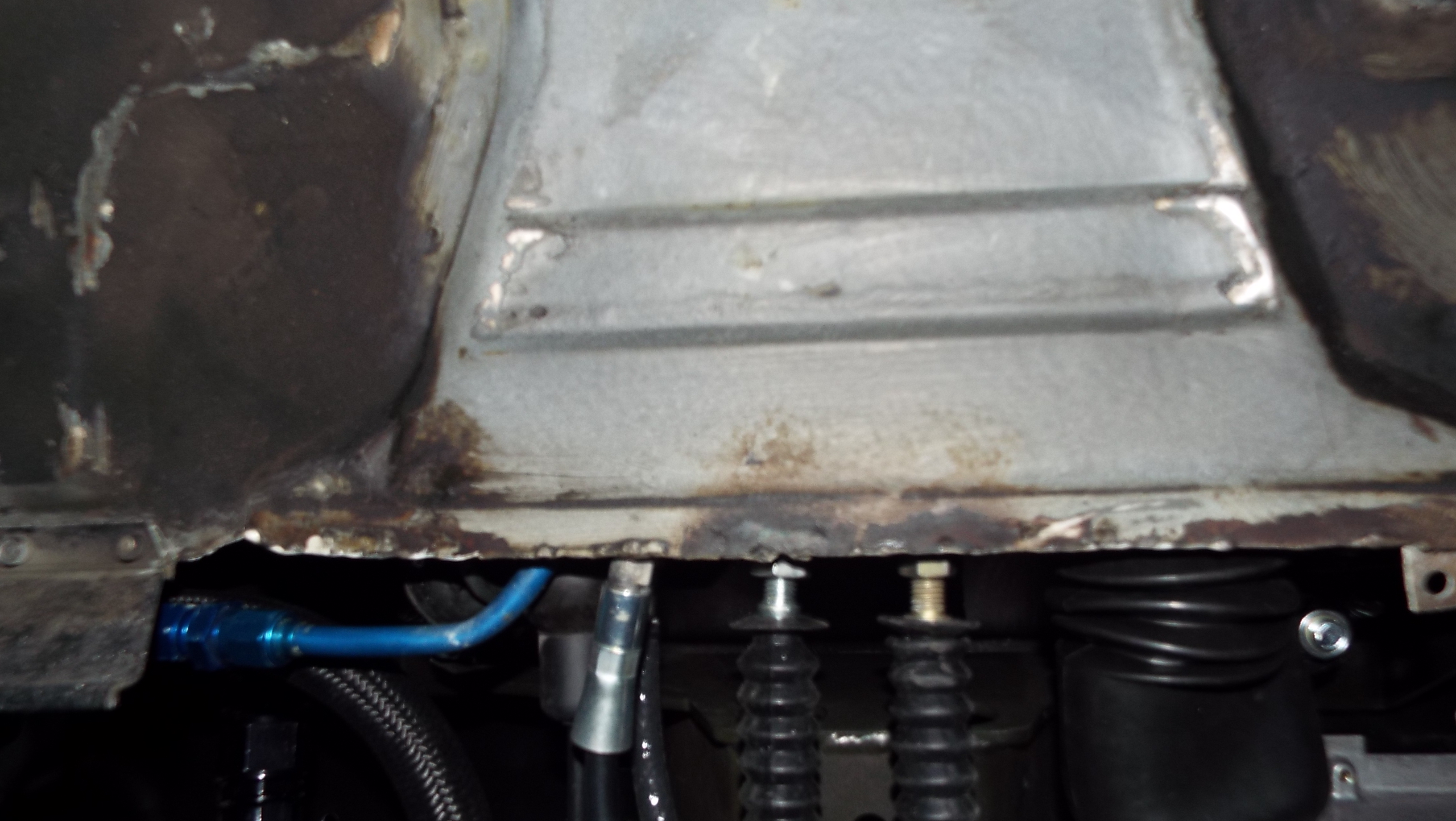

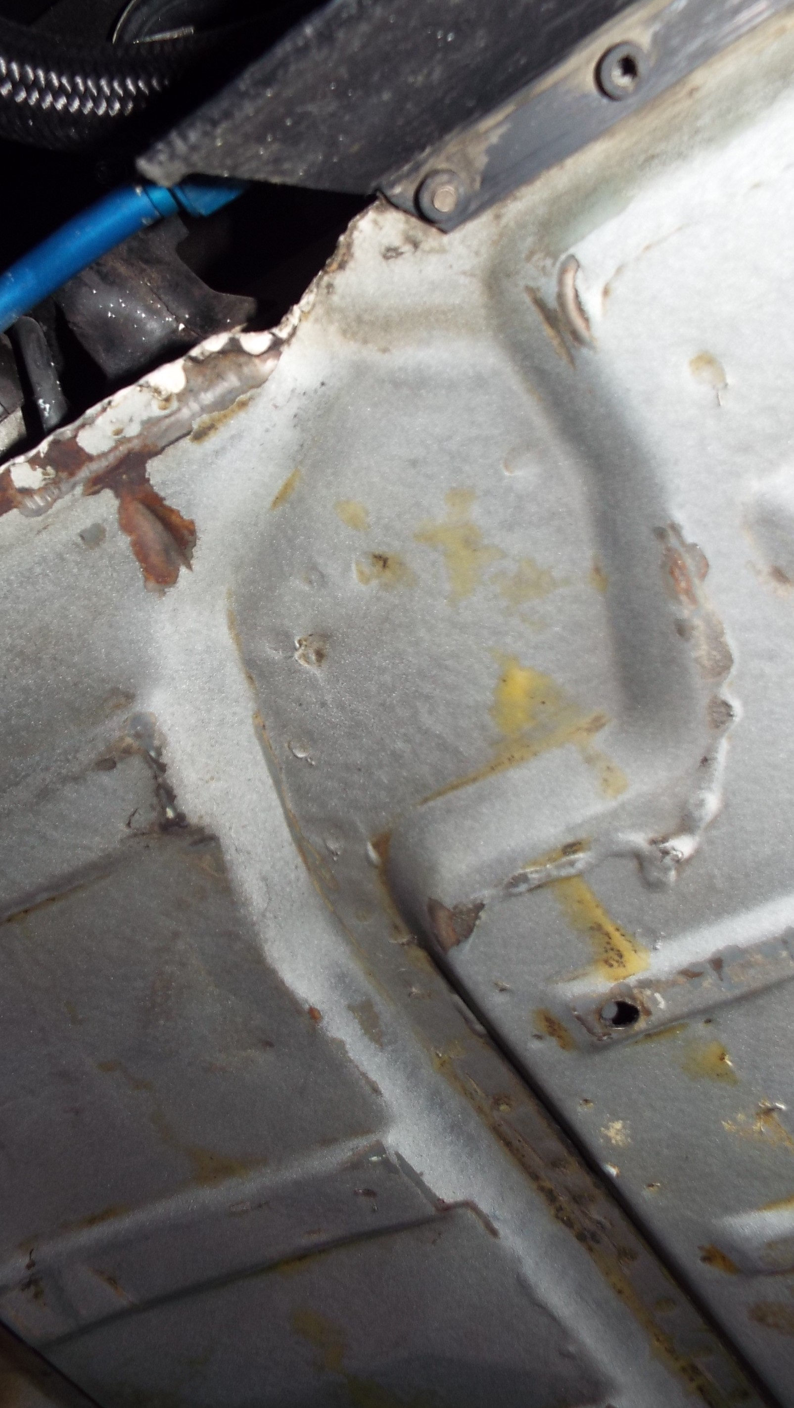

Surprise! And a good one at that! (IMG:style_emoticons/default/smile.gif)
Went out to check to see if I needed to get in on the group buy for Mikey’s “vortex generators” and finally started address the underside of the floor pan. Been dreading it because I thought I was going to be scraping like Defianty with his “special tool” (IMG:style_emoticons/default/sunglasses.gif). I hope he knows I'm teasing. (IMG:style_emoticons/default/beerchug.gif)
To my surprise when I rubbed on it pretty good with some Prep Sol it seemed to just cut right through all the, whatever it is, road grime/ crud/ maybe light under coating? I couldn’t say for sure. But it looked like nice painted surface under all that crud. (IMG:style_emoticons/default/mueba.gif)
Well I couldn't stop there, and yes it took some rubbing and several applications, but this sure looks to be the original painted bottom to me. It looks like it is a light grey paint and I came to realize that the yellow stuff in the pictures is the factory cosmoline. The cosmoline will come off completely if desired it is like a wax. I mean I knew this car had very little rust in its history and I know the car was repainted 20 some years ago, but this floor bottom is crazy cool. Sure, it has a few extra holes that shouldn’t be there and of course there are some dents and scrapes to fix.
I bet when Moparrob sees this he is going to want it back even more. (IMG:style_emoticons/default/biggrin.gif)
Oh, and my “vortex generators” look to be OK, maybe I have ADD? (IMG:style_emoticons/default/idea.gif) Maybe it was the fumes? (IMG:style_emoticons/default/huh.gif) That's why I went out in the garage?
Made it all the way to the front on right side! Hope to finish tomorrow!

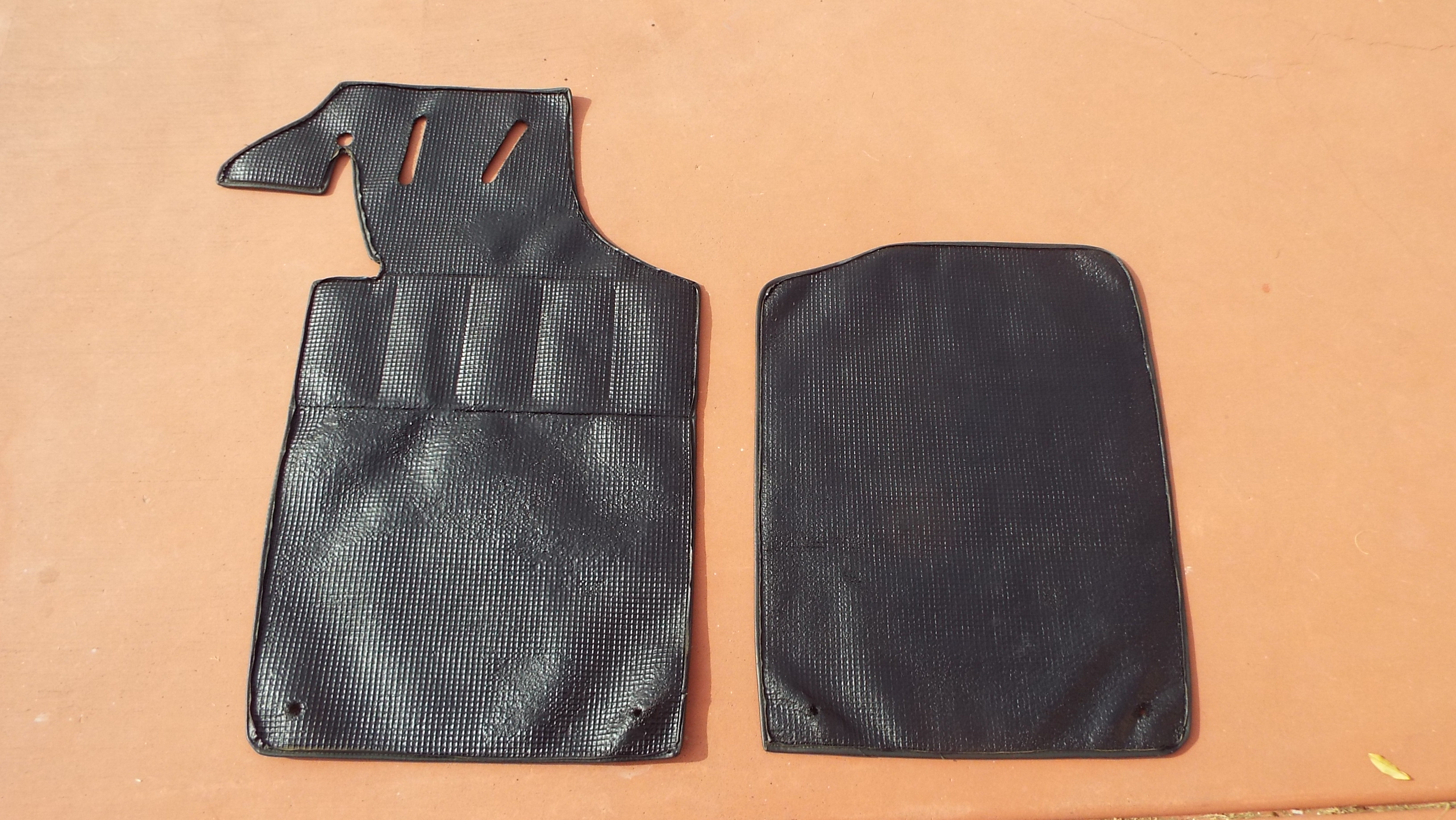

Just a quick one here

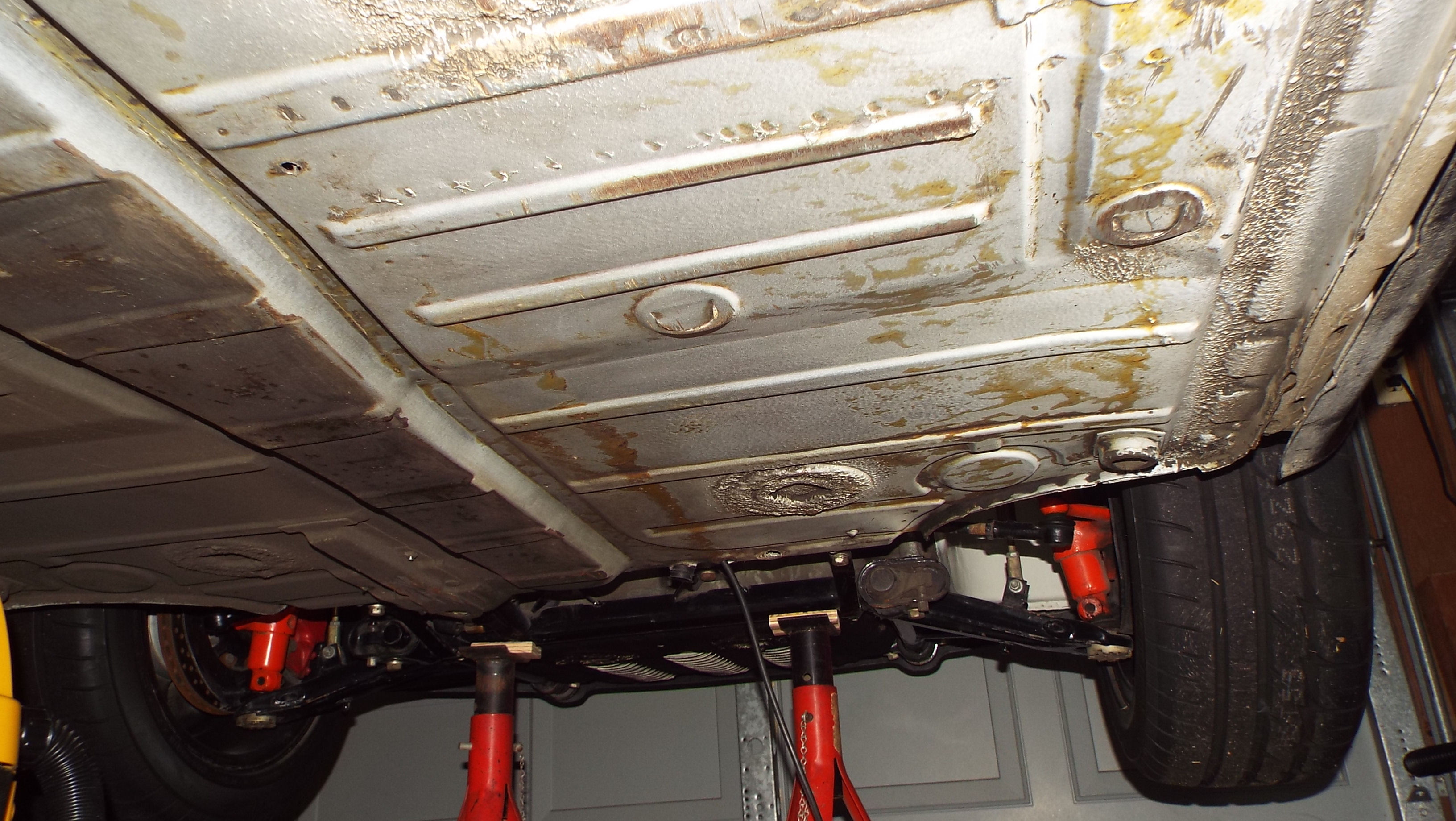

My floor mats were in pretty good shape on the carpet side but the back sides were deteriorating and crumbling. They are original 914 floor mats I picked up at a swap meet. They have a couple of holes on the one end by the seats from some previous carpet attachment thingy that I may actually use. I was trying think of something I could do to the back to keep it intact and my wife (IMG:style_emoticons/default/idea.gif) suggested Flex Seal.
You know that commercial where the guy sprays a screen on the bottom of a boat with Flex Seal and then shows him driving the boat? Well I would have never thought of that stuff but it sure worked great on the floor mats! Sorry forgot before pics.
Downside is the coverage is pretty limited and it actually took almost 2 cans just for the two mats at $12.99 a can. That boat bottom at that rate would be like $1,000.00 I figure. (IMG:style_emoticons/default/tongue.gif)
Pluggin away.
6868
post Dec 10 2017, 02:24 PM
Post #391
Posts: 19,843
QUOTE(Lucky9146 @ Dec 10 2017, 03:20 PM) *
Pluggin away.
6868
Nice save. Smart wife.
Lucky9146
post Dec 10 2017, 09:46 PM
Post #392
Posts: 1,676
Joined: 22-September 14
From: Poway California
Member No.: 17,942
QUOTE(mepstein @ Dec 10 2017, 12:24 PM) *
Thanks Mark! She's a keeper (IMG:style_emoticons/default/smlove2.gif)

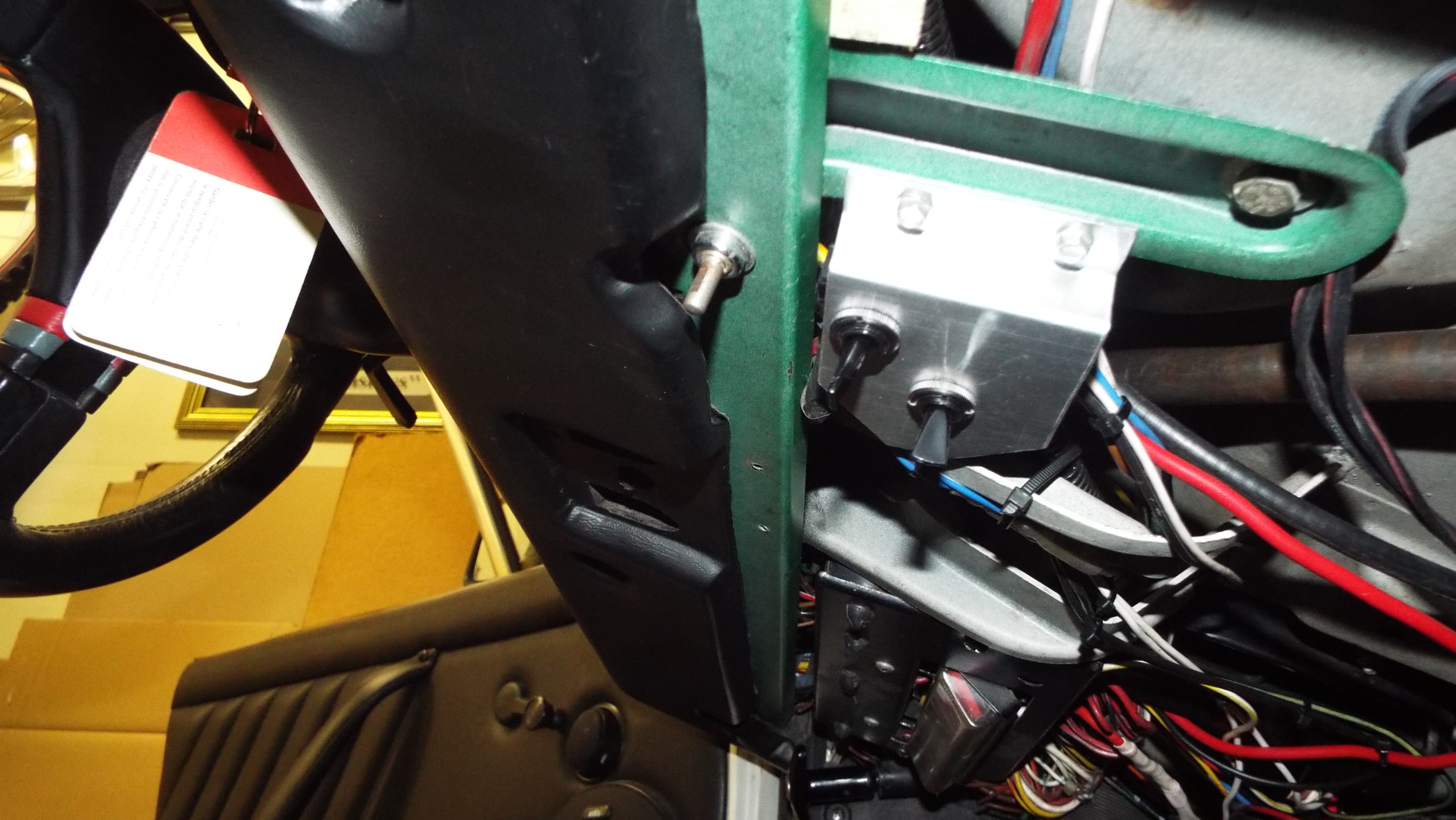

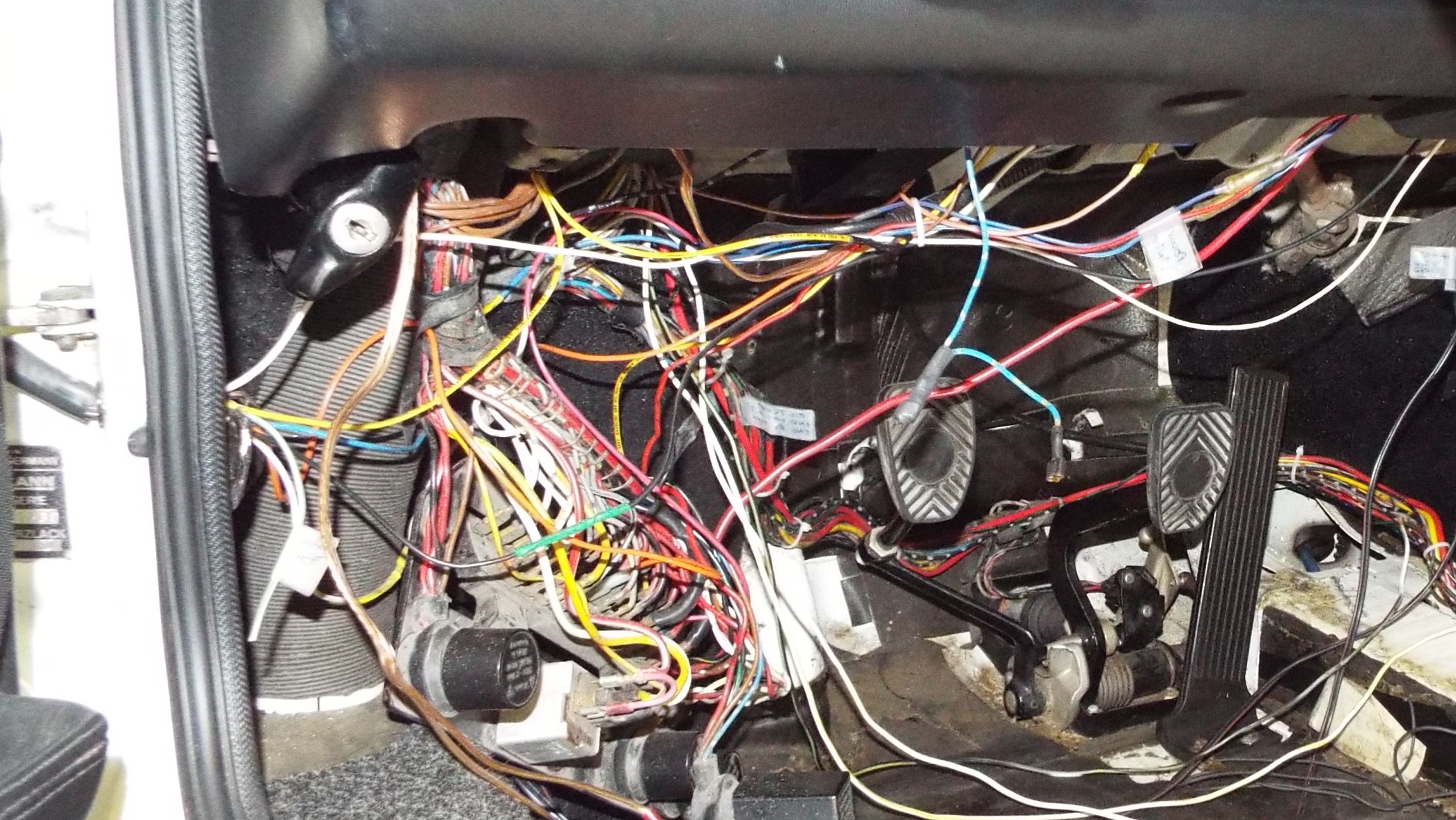

Well there is three days that I’ll never get back!
But the infamous under dash wiring went from this (IMG:style_emoticons/default/sad.gif)
To this (IMG:style_emoticons/default/smile.gif) and I sure learned a lot! Some we-wiring was needed and some new with a lot of identifying and tagging in the process.
I may have maxed out my quota of dumb electrical questions to toolguy, what a trooper, and he would still answer the phone. (IMG:style_emoticons/default/beerchug.gif) Thanks!
Fuel pump switch and oil cooler fans over ride switch are located under the dash on my alum panel. Going to try it under here and may end up moving them. Fuel pump switch functions forward /aft and fan override works side to side.

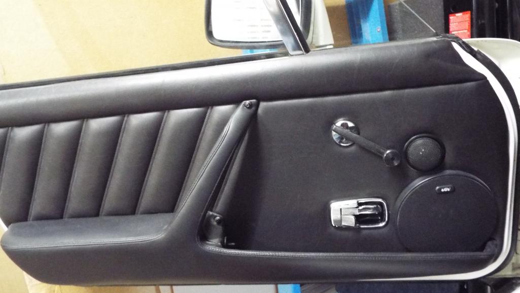

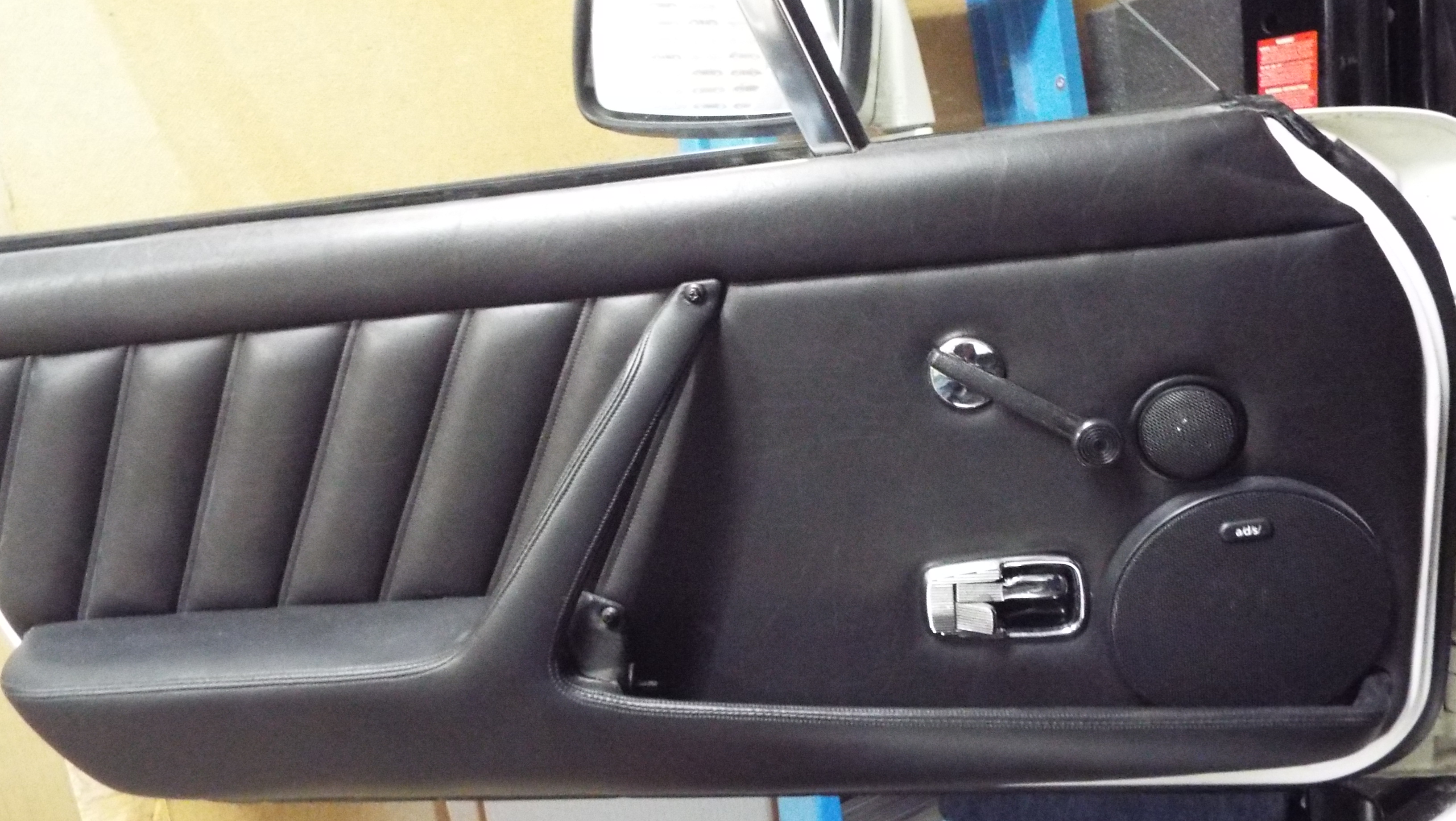

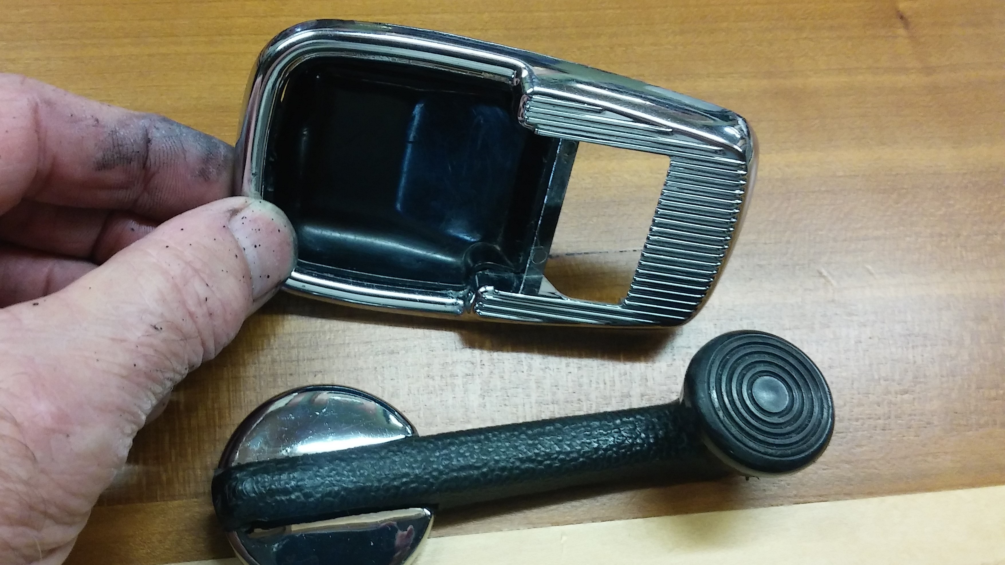

l.a.brooks posted this thread about door panels this morning http://www.914world.com/bbs2/index.php?showtopic=321152
And I happened to take pictures of my door panels last night because I just received the matching early chrome window crank and door pull base from Garold yesterday. I had enough for one door and installed them last night.
Anyway thought I would post the door panel thread here because there seemed to be some interest and information to share. Check it out. (IMG:style_emoticons/default/type.gif)
I love these door panels and that both sides are completely the same. My panels came with my project and I didn't know where they came from, so I learned from the thread too.
My panel with early chrome window crank and door handle base
