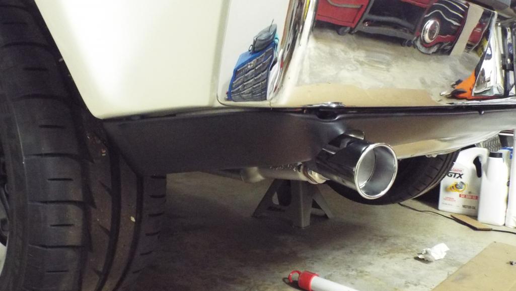

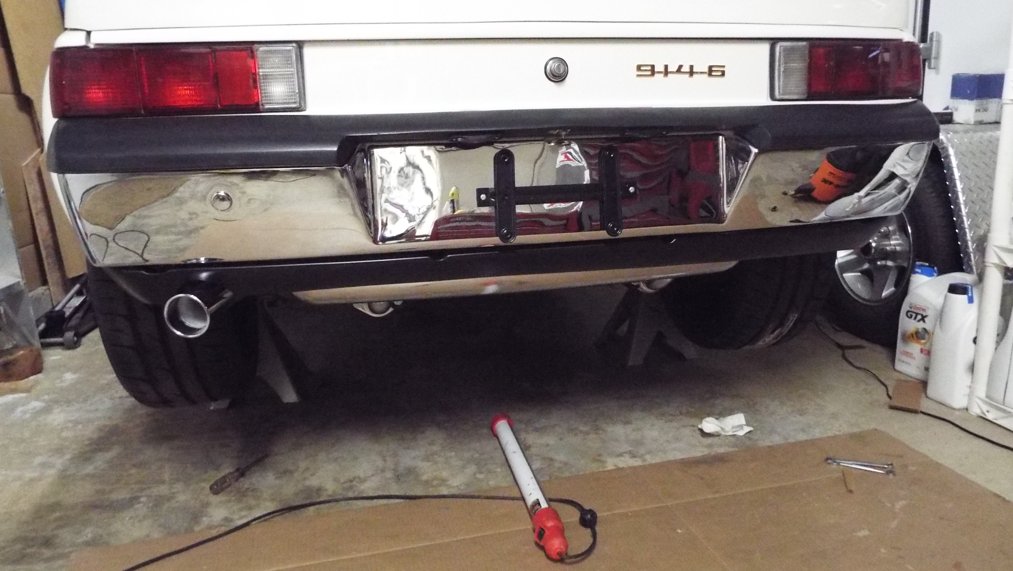

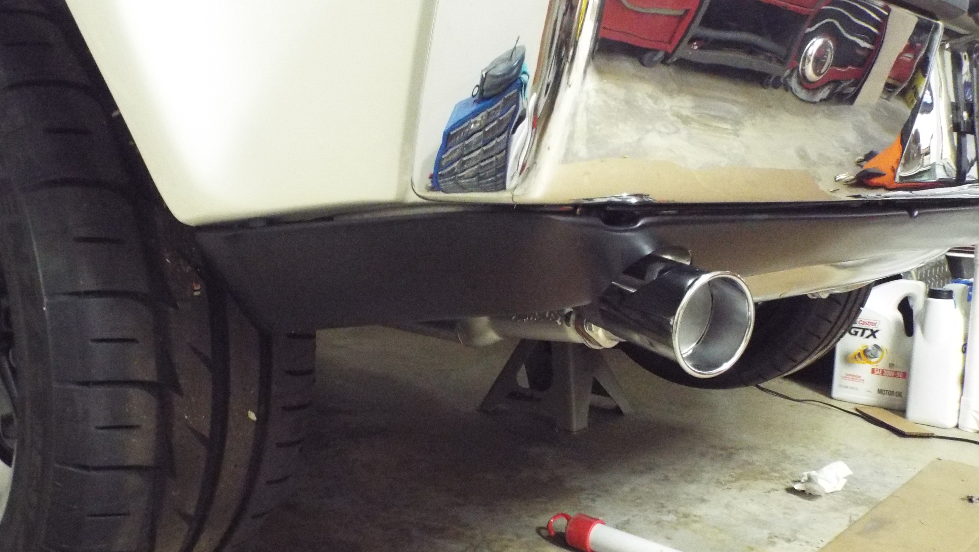

Finished the Rear Valance install late last night! (IMG:style_emoticons/default/smile.gif)
Gas going in now
(IMG:style_emoticons/default/white914.jpg)

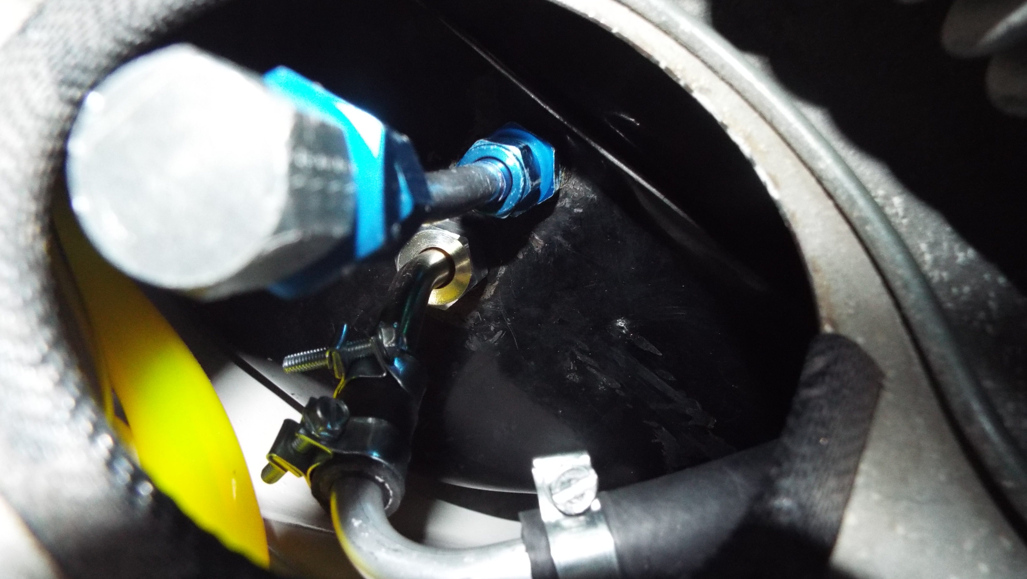

QUOTE(Lucky9146 @ Feb 7 2018, 10:05 PM) *
The fuel line nipple arrived today from Bruce Stone and it looks great!
Now to install it is another story. I did not have a stock fuel line set up coming out of the tank. There was no screen and I wanted one. There was just been an AN adapter and an AN elbow going to a hose but now the stock nipple tube coming out of the tank is more angled down making my hose too short. Either remove the gas tank again to add longer hose or get creative. I chose the latter which involved making and adding a different elbow on the end of the stock nipple from Bruce. Lots of fun up in that hole. But thinking now, it turned out better than removing the tank anyway, and the clamps are very accessible. Finally fuel line done back to the engine.
See, I knew you could do it without removing the tank! I'm sure you have some skinned knuckles but still better than tank removal.
I like the elbow idea since it is very easy to kink the hose without an elbow.
Jeff B
Thanks Jeff it looks a bit "clampy" but so far no leaks and I like the way it turned out.
Wanted to keep it up on jack stands so I could actually see all the fittings with gas in the tank. The other line coming down is a length of AN tube for a drain that comes to the edge of the hole for easy access should I ever need to drain the tank it will be a nice clean shot.
Coming off jack stands today! (IMG:style_emoticons/default/piratenanner.gif)

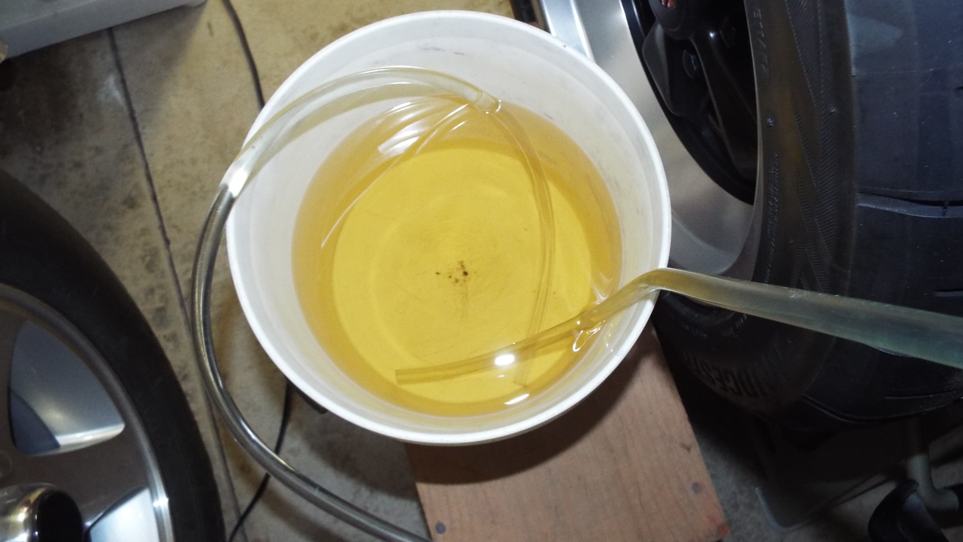

Been a super frustrating weekend of fighting fuel line leaks and fuel contamination. (IMG:style_emoticons/default/headbang.gif) Not entirely sure the leaks are totally behind me.
Glad I had the car back up on jack stands (never thought I would say that) for draining and filling the tank, it sure helped. Did a flush of the fuel line back to just before carbs and found debris in the fuel coming out, twice! Keep in mind I have a good size Holly fuel filter after the tank located in the front trunk and just before the Holly 125 fuel pump, also in the frunk.
The good news is the pinkish hue to the gas is now completely gone but where all the little shit in the fuel line is coming from beats me. I've decided, as extra protection, I am going to install 2 additional "pre-filters" after my splitter and just before the carbs. Probably look stupid, I don't care, should be temporary. Too much invested in these carbs and engine to take any chances. I remember Forrest dealing with carb contamination issues.
Maybe off the jack stands tomorrow, but is is suppose to rain, maybe not. (IMG:style_emoticons/default/mad.gif)

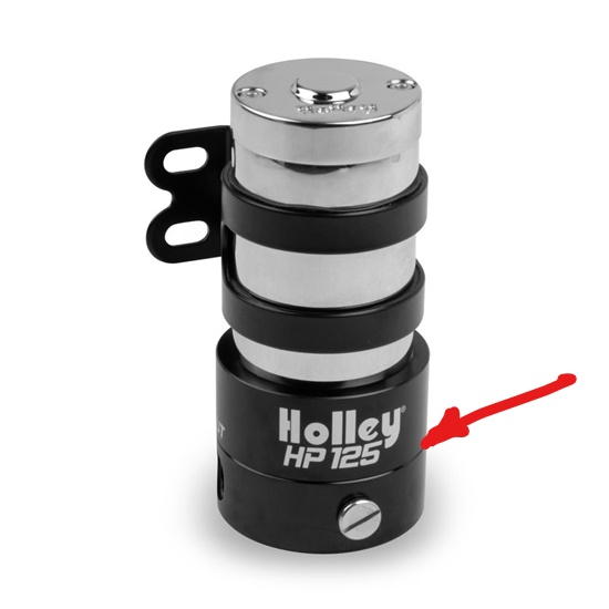

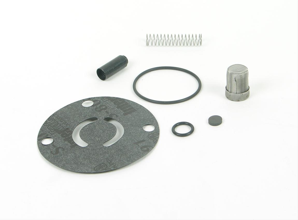

That said there has been a small weeping that I thought was the fitting on the inlet side of the fuel pump. Drained the fuel tank changed the fitting, still weeping yesterday morning. Appears to be from this split line.
So I tried to tighten the 3 allen head screws underneath for that cap yesterday and they were tight. Still weeping this morning. (IMG:style_emoticons/default/mad.gif)
Called Holly technical this morning and explained the fuel pump has been mounted in position for 5 to 6 years and just saw fuel for the first time mid Jan of this year. He did not offer much other than to say it had dried out. Hmmmm seems to me pumps when new without fuel could sit on the shelf for years and be ok? (IMG:style_emoticons/default/idea.gif) He agreed! (IMG:style_emoticons/default/confused24.gif)
Without proof of purchase all he could do was recommend a rebuild kit. Can't just get the gasket. (IMG:style_emoticons/default/sad.gif)
Tried to find one locally but after 9 calls, ordered from Summit. (IMG:style_emoticons/default/popcorn[1].gif)

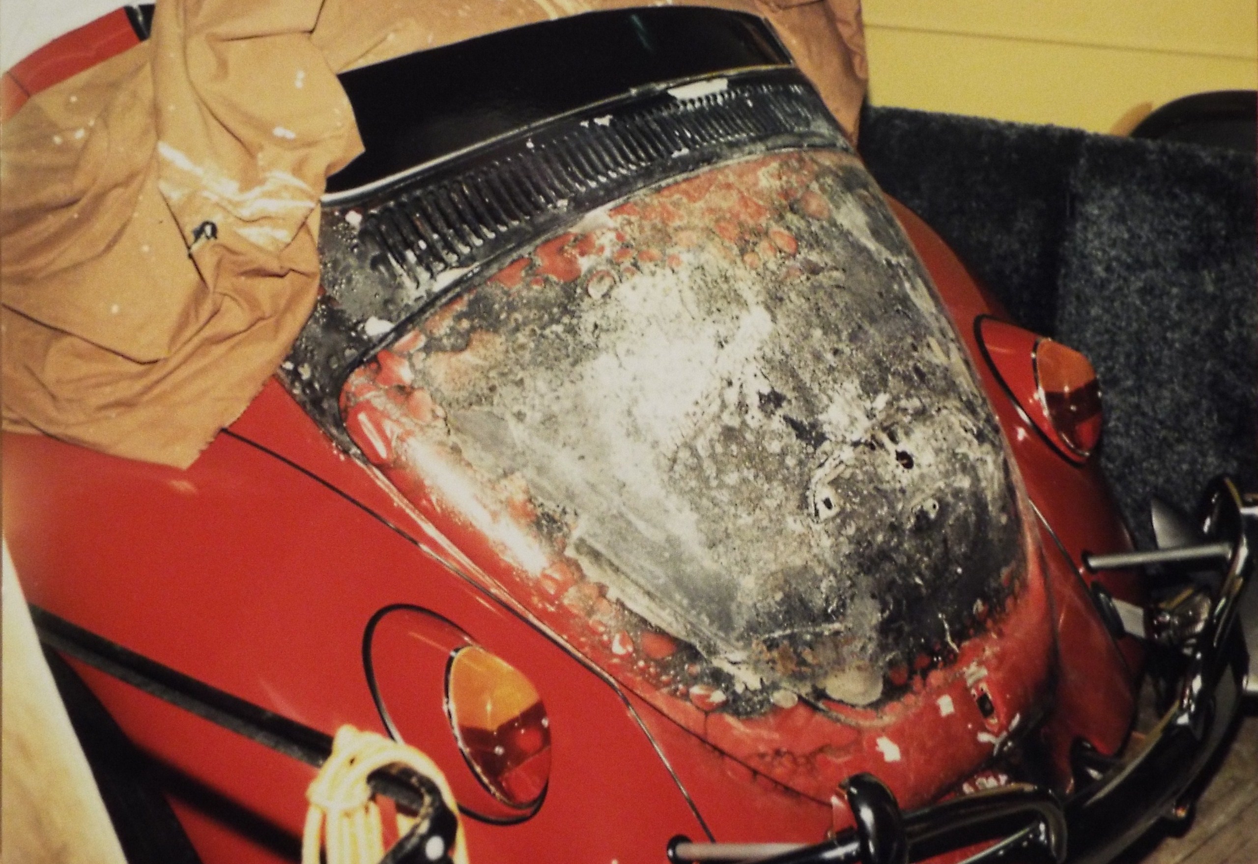

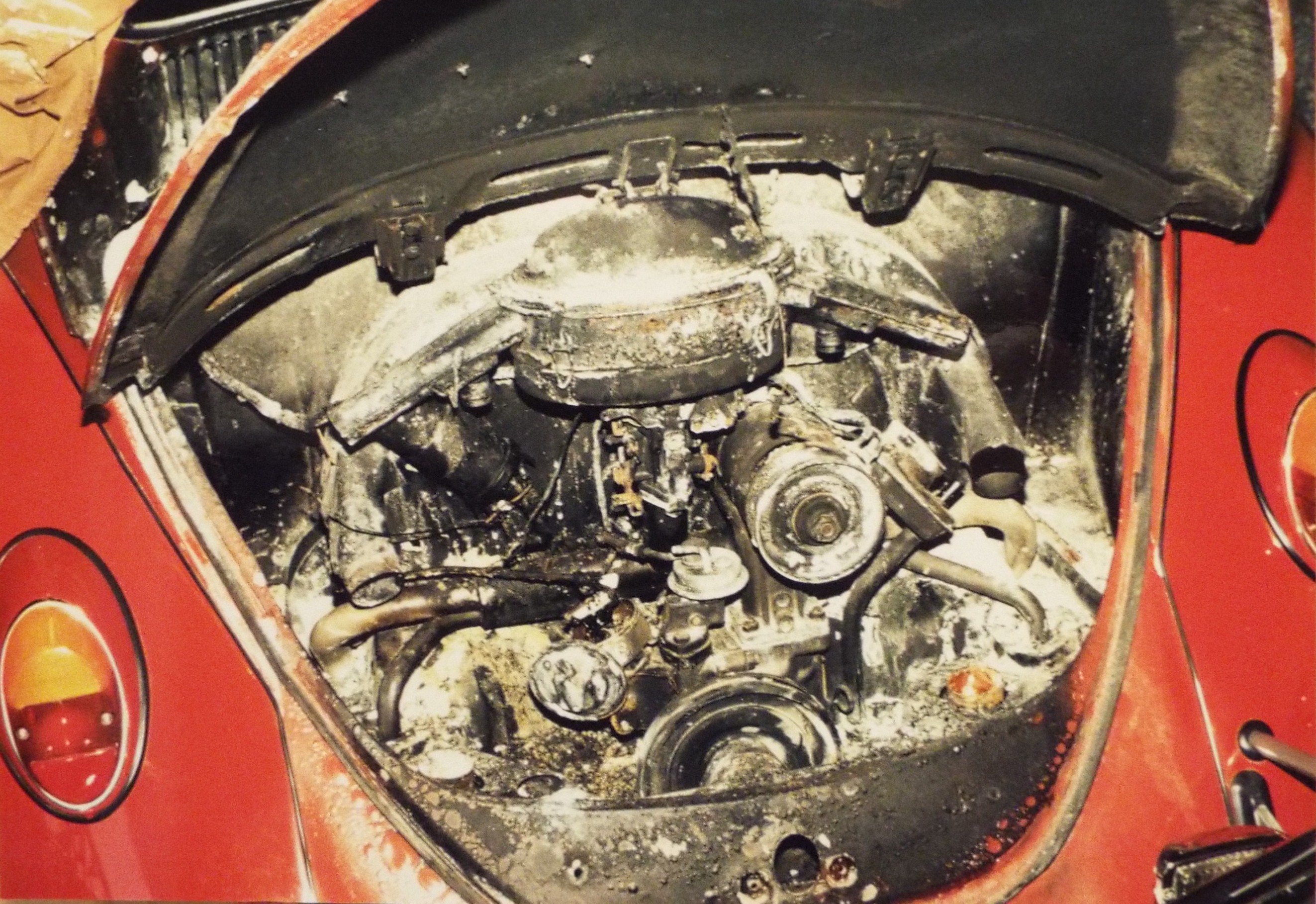

It was actually quite surprising how much you could smell the fumes in the trunk from such a slow seepage, there was no dripping. You could see the bottom of the pump moist at times and wipe it away and it would take hours to look like that again so that tells me that a good part of it was evaporating. The groove around that split line I discovered, would stay wet, and wiping it dry it would fill up again relatively quickly. Down low in the trunk made diagnosing difficult. The hood has been mostly open allowing air circulation in the trunk but when it was closed for a while days or hours you could really smell fumes when opened again.
It is a shame there is no real estate to install a manual tank shut off at the fuel line tank outlet before the Holly filter and pump. Believe me I have looked and a major re-plumb would be needed.
I had my 67 bug burn in 1995. Probably why I may be a bit more cautious than most. Gas sure screwed this one up at an inopportune time! Still have that car, restored it again.
