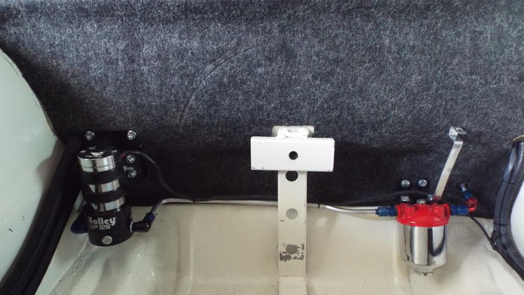

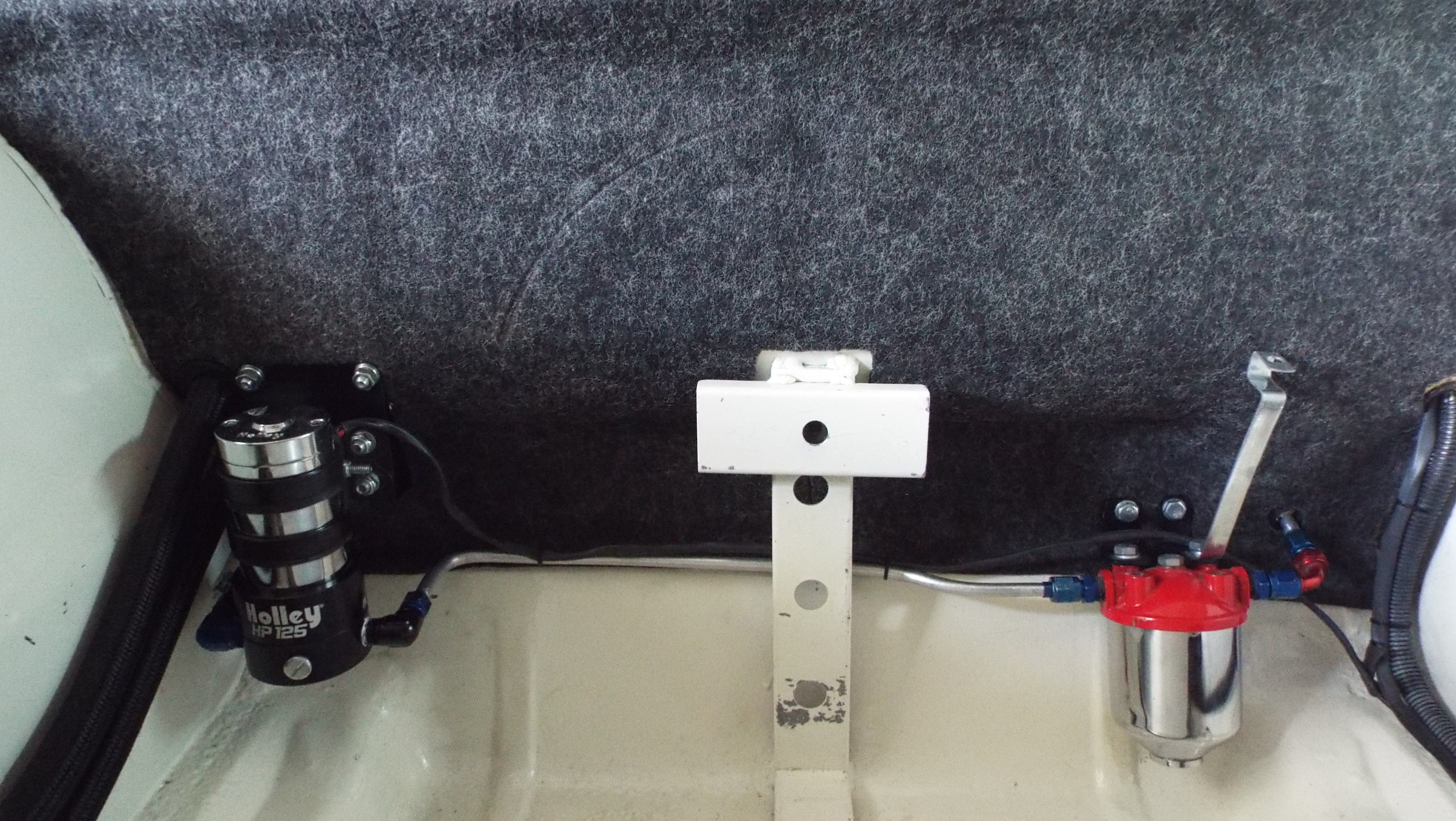

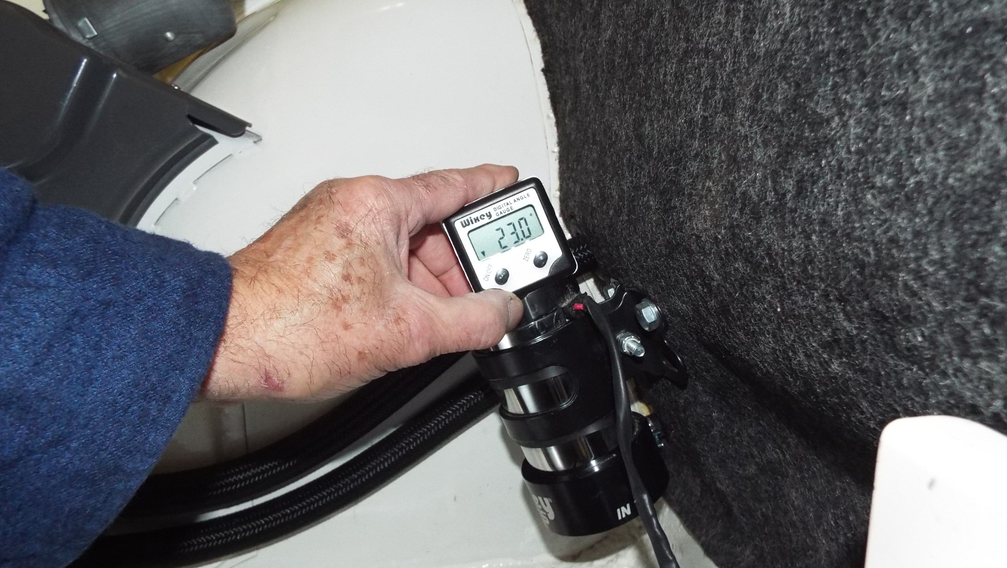

Learning more than I want to about this Holly 125 fuel pump. (IMG:style_emoticons/default/sad.gif)
Just got off the phone again with Holly technical and learned the fuel pump MUST be mounted vertically or it will wear the main shaft (non-replaceable) and could actually have been the cause of this leaking I am experiencing and trying to fix. A few degrees OK but this is at 23 degrees and he says that is too much and should be corrected.
Sounds simple enough.
This shot below shows there are 3 bolts holding the pump bracket, 2 on the left and one on the right.
The nuts to these bolts are on the other side of the bulkhead and inaccessible so this means the gas tank comes out once again.
Then need figure out how to mount it vertically and re-make 2 AN6 fuel lines.
Fun
(IMG:style_emoticons/default/white914.jpg)

Tank is out again (IMG:style_emoticons/default/headbang.gif)
I sure get what the PO Moparrob was trying to do and the limitations he had of locating the fuel filter and pump either side of the vertical spare and keep it gravity fed. Going to take me a bit of time to get this to work now.
On the bright side Holly people are really responsive and willing to take the time to help you with whatever you are dealing with regarding their products. Inner workings of the pump are kinda cool

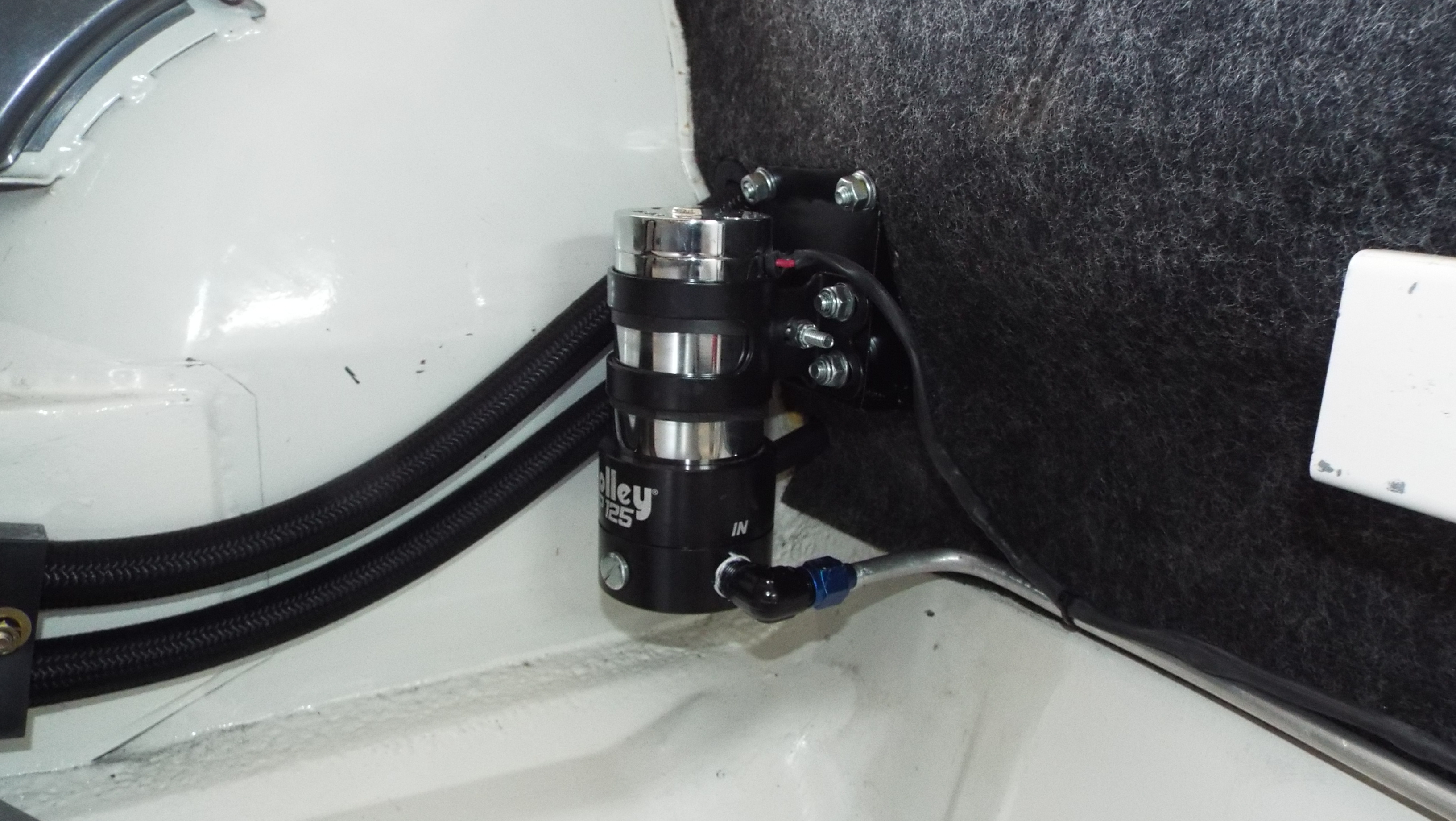

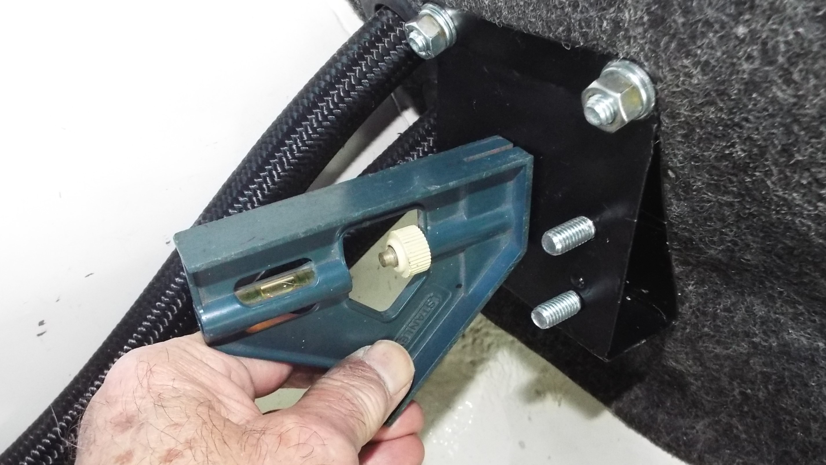

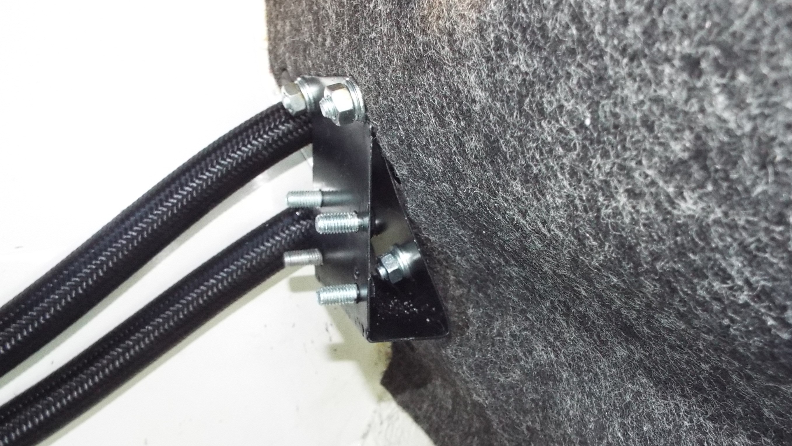

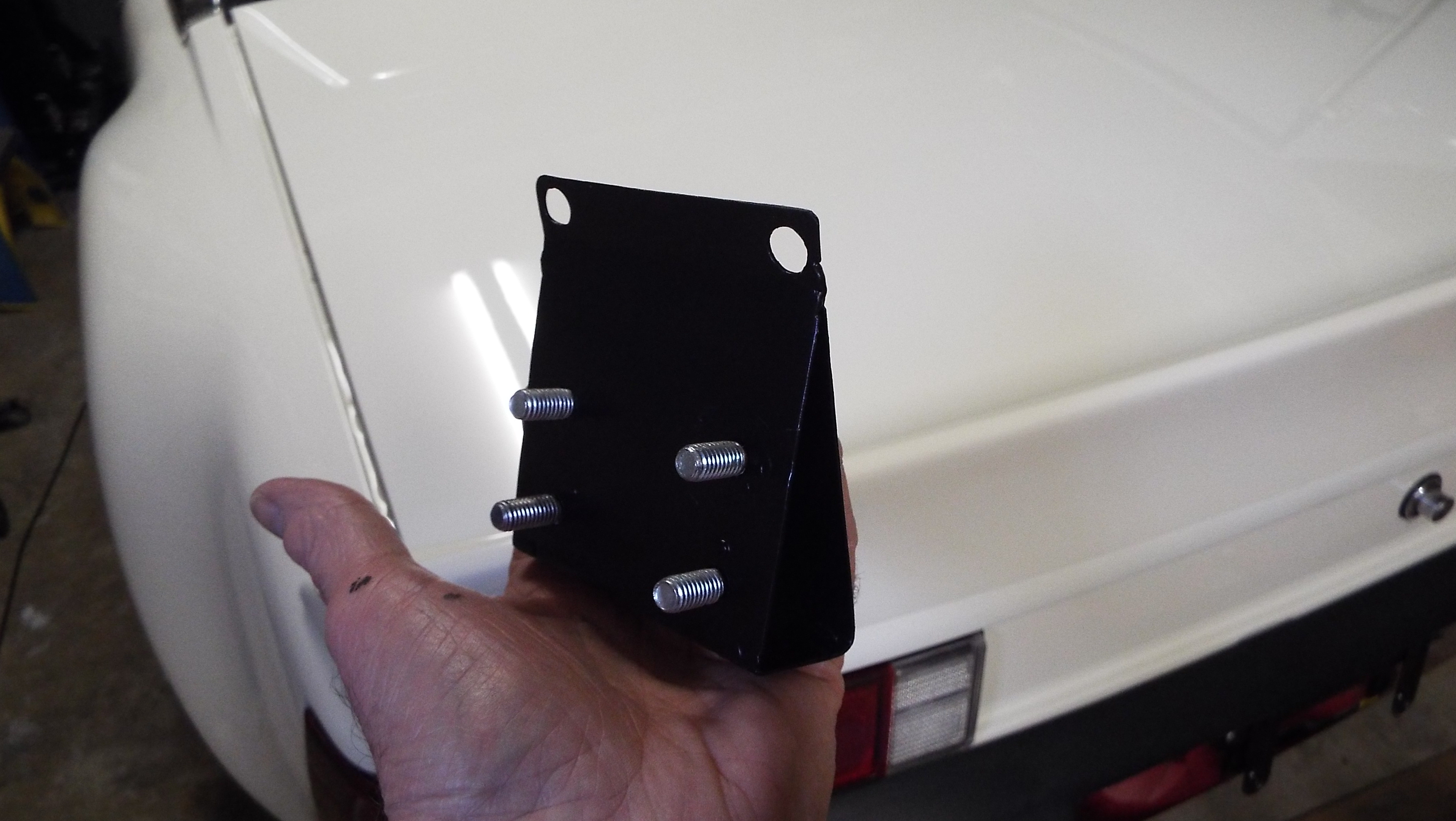

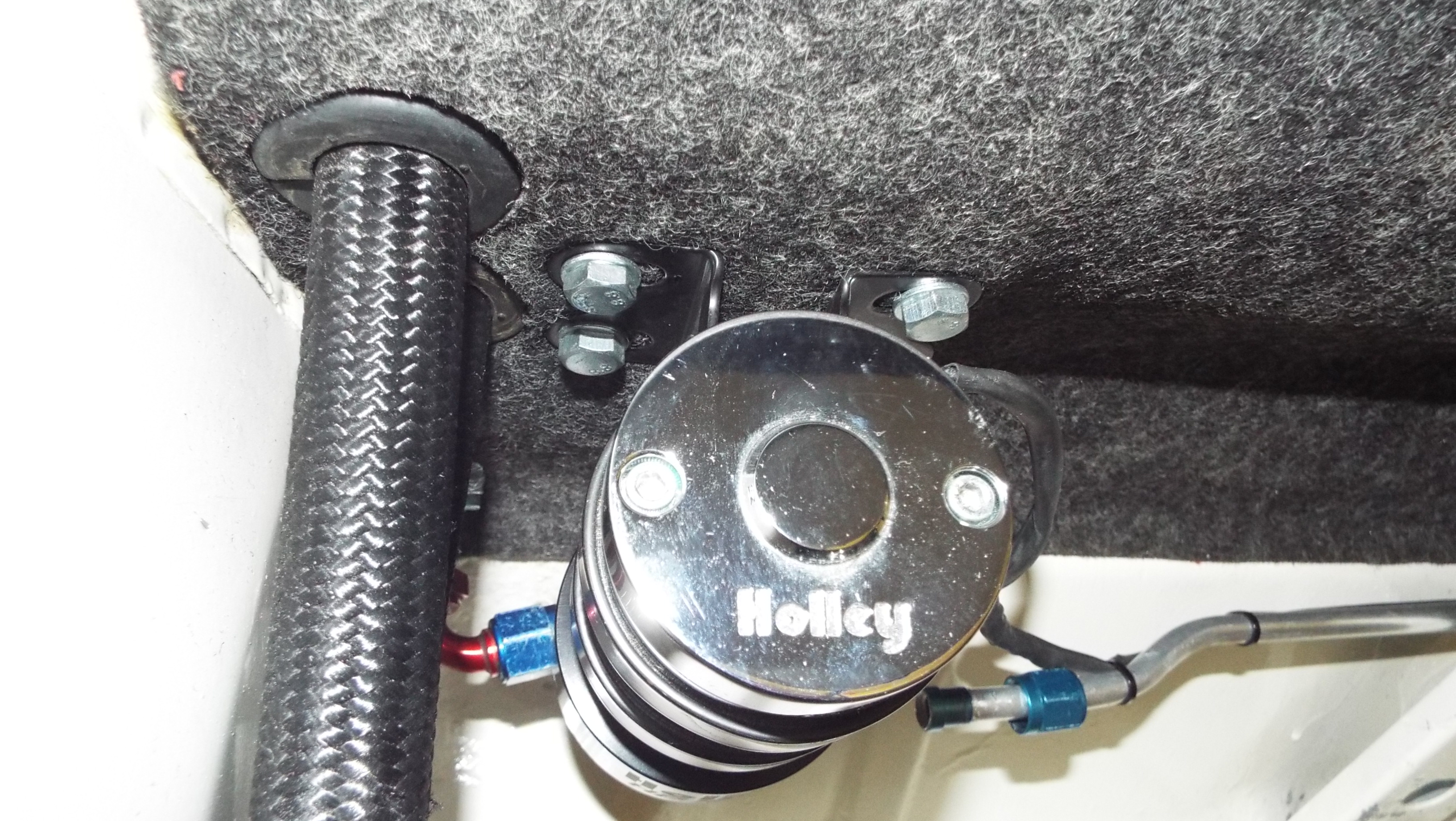

Fabricated this bracket and it will do the trick. (IMG:style_emoticons/default/welder.gif)
Provides minimal clearance on both sides when installed, swings the bottom of the pump out at almost the same height it was, pump will still be securely attached, enables removal of the pump without removing the gas tank, and with new tighter AN fittings still allows room for the spare tire to be vertical mounted! Win, win, win, win, win.
Mounting and plumbing in progress! Pictures to follow.

Finished up the fuel pump re-install with new seals. Tank and fuel back in.
No Leaks. Pump works!
Onward! (IMG:style_emoticons/default/smile.gif)

You are a stud! Great job on the fuel lines also.

Nice work on that fuel pump bracket Jim. Very tidy.

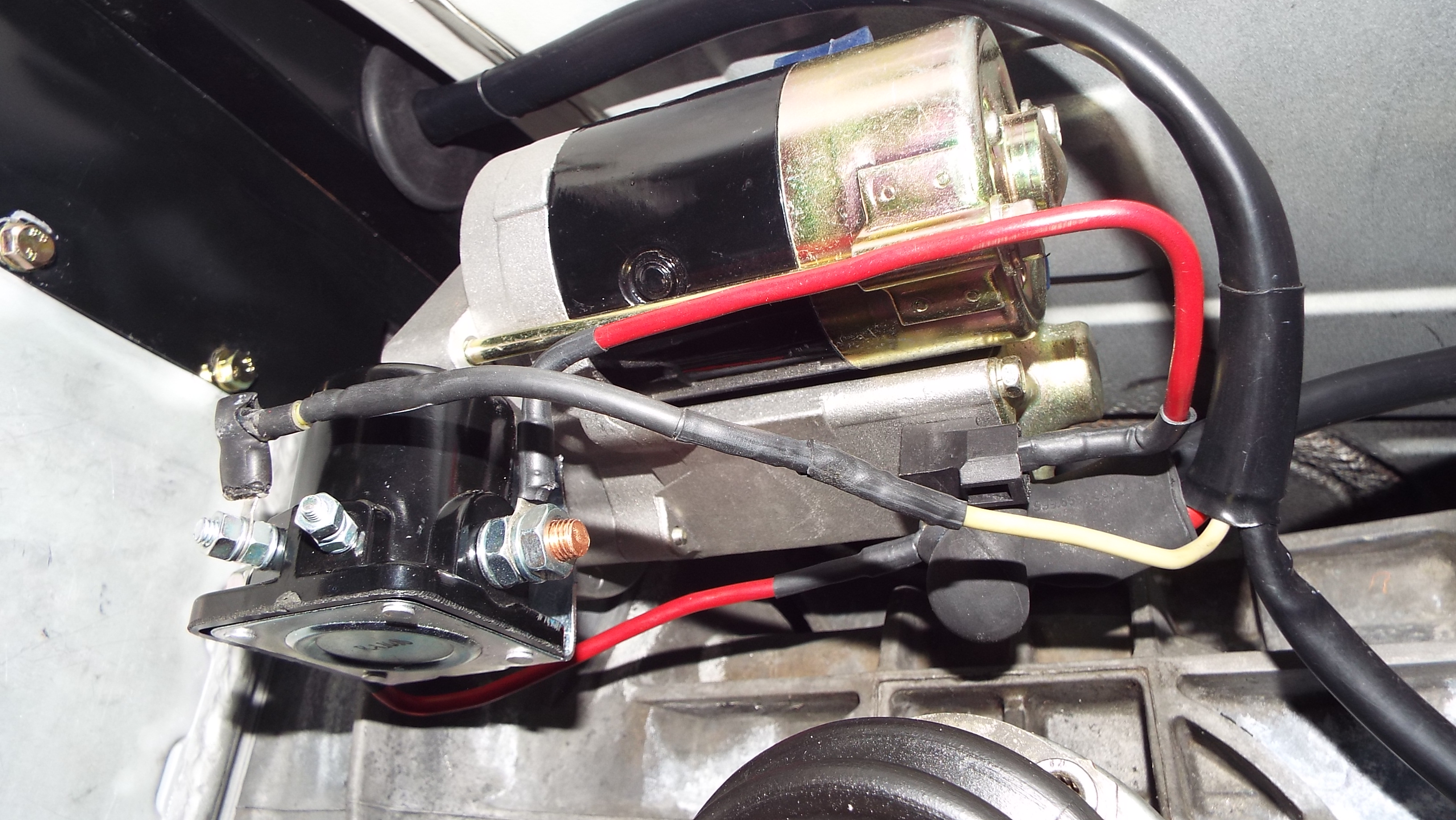

Sunday finished trouble shooting and then fabricated a new battery cable and fit. I even incorporated the battery terminal from 914 Rubber to top it off. Much better set up! (IMG:style_emoticons/default/beerchug.gif)

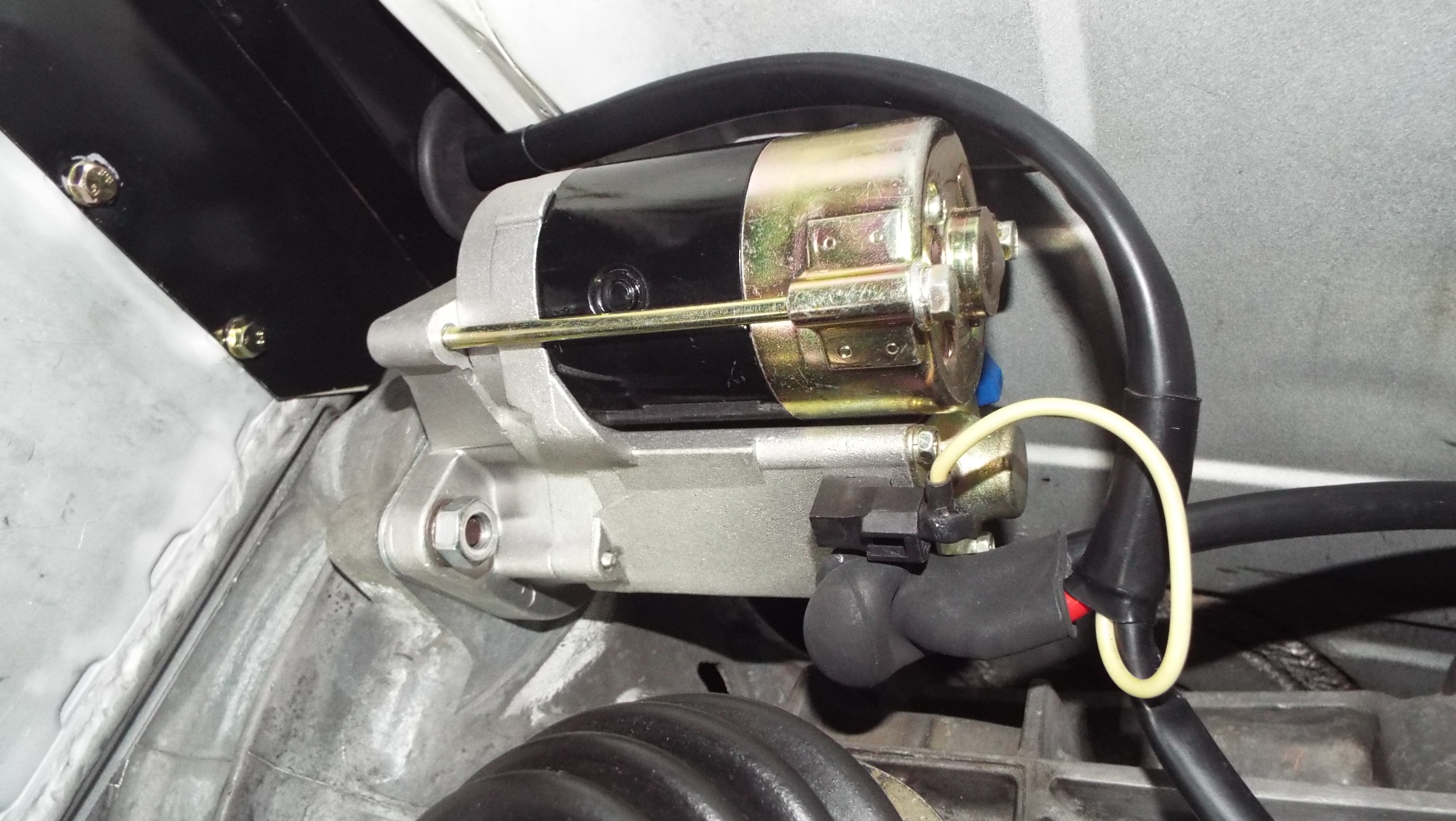

Finished up the Mark Henry starter solenoid install and it looks and works great! Check!

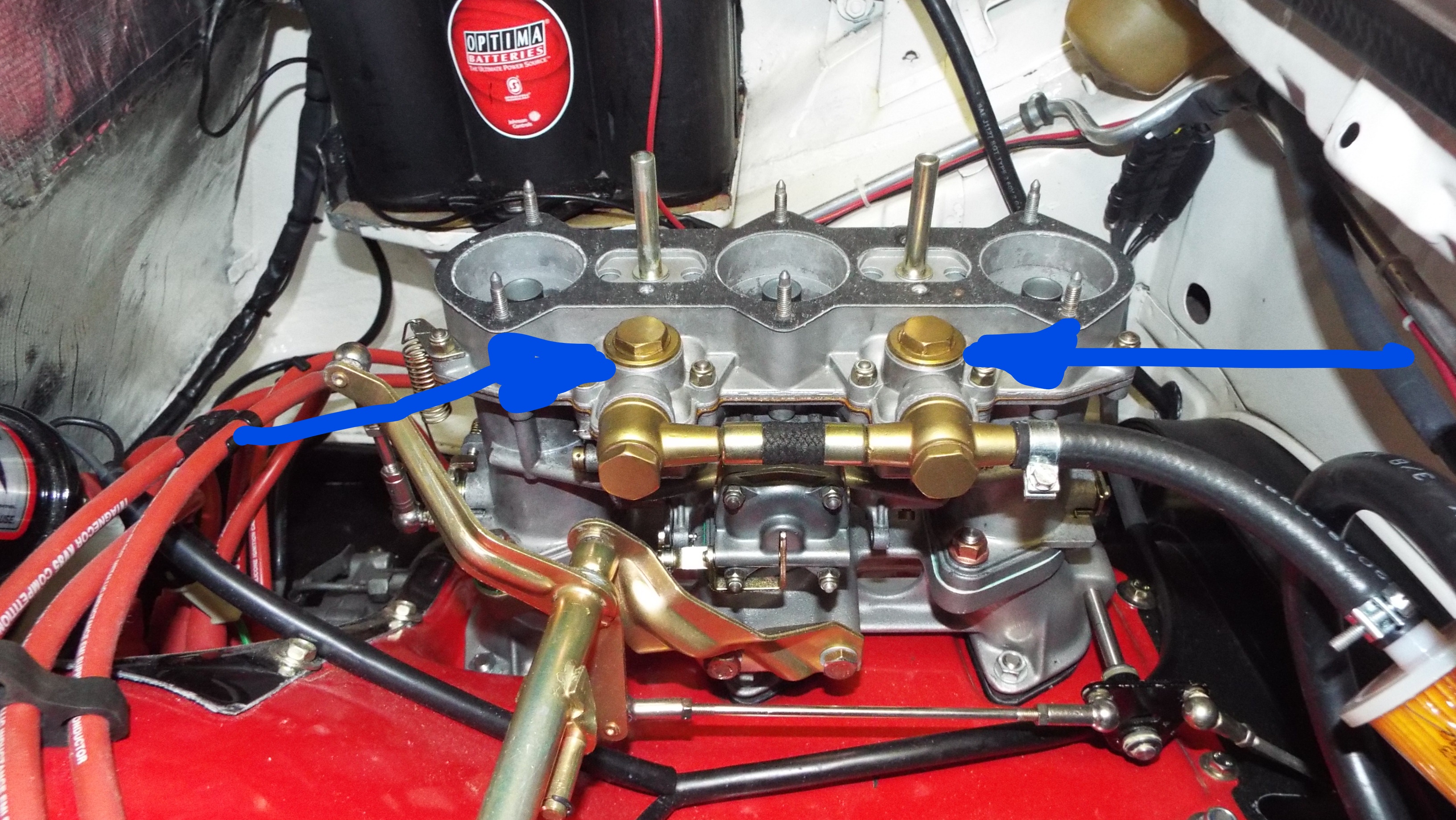

One more setback! Kind of a biggie this time.
Man, this is getting old.

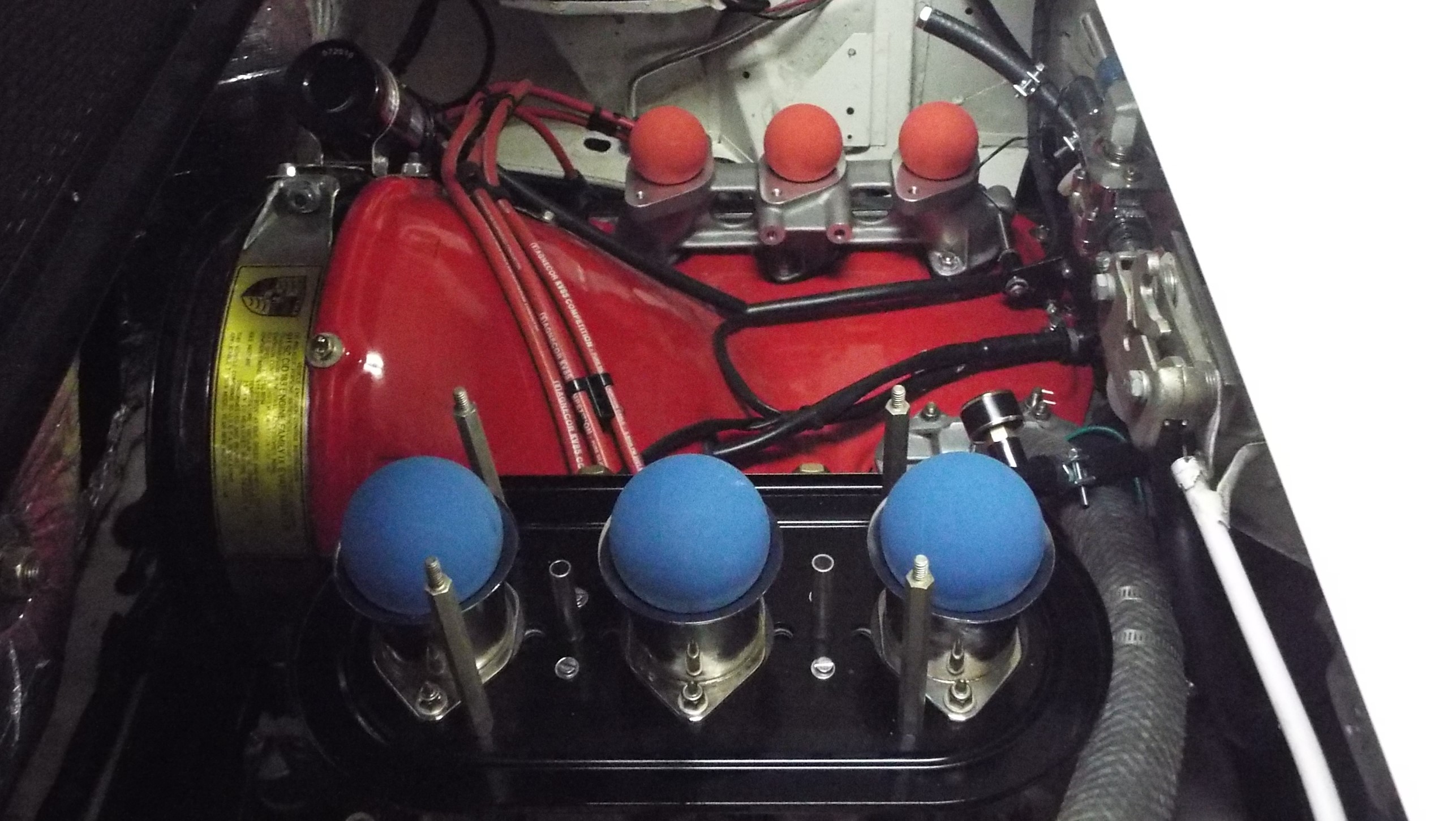

Was about to take it off the jack stands to fire it up and decided it might be smart, since I can run the fuel pump from a switch as I was doing to flush the system, to run the fuel pump now that they are hooked to the carbs and will have back pressure. I would then see what kind of fuel pressure I have and check all around and underneath the car for fuel leaks.
Right away there is a problem with the right carb, it seems to be leaking on the inboard side up high under the rain hat base. Weird. I can’t see where or why? Called my carb guy a couple times as we troubleshot the problem Further trouble shoot disassembly and removal of the rain hat and it is leaking past the seals and he wants the carb back, says its a bugger to fix, so off it came. Sucks. (IMG:style_emoticons/default/sad.gif)
Kinda like that Seinfeld episode “no soup for you!” No start for me!
Fuel was seeping past the seals here, blue arrows, getting the whole inboard side of the carb wet, and it would saturate pretty quickly.

Damn! That old girl is fighting you every inch of the way. (IMG:style_emoticons/default/chair.gif)
Perhaps Roland put a hex on it or it is possessed?(IMG:style_emoticons/default/devil.gif)
How long before the carb comes home?
I may need to whip up a new batch of ale since I drank the old batch while waiting for you... (IMG:style_emoticons/default/busted.gif)
Ya ya like there really was a "batch" in the first place. (IMG:style_emoticons/default/idea.gif) (IMG:style_emoticons/default/beer3.gif)
Yup every inch of the way.
On the bright side I have good fuel pressure and no leaks in the lines.
Carb ships out tomorrow to Salem OR, said he would turn it right around.
Great guy takes his work very seriously probably as frustrated or more than me. Pulling that carb was absolutely no fun! (IMG:style_emoticons/default/barf.gif)

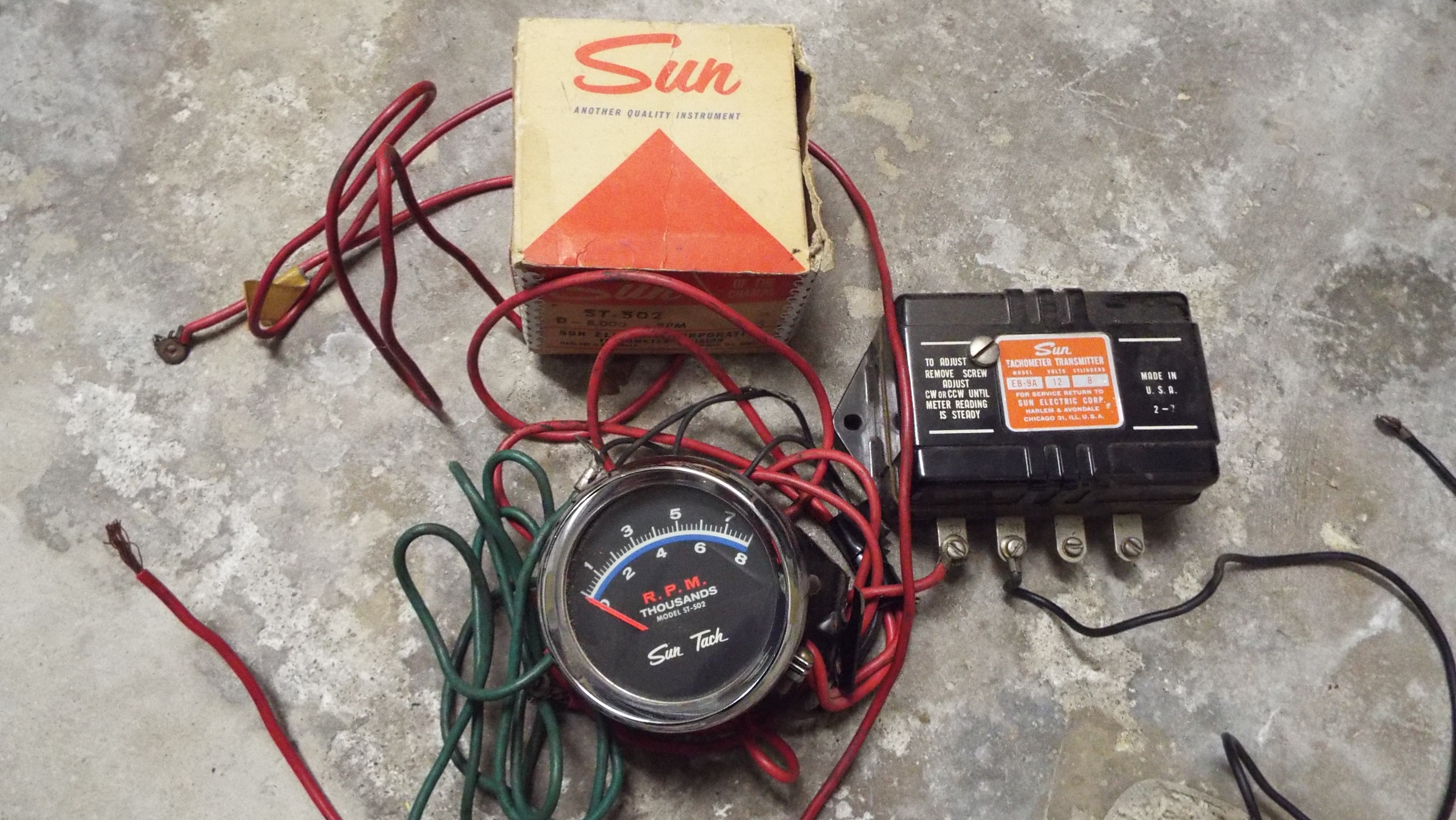

Since there will be a bit of down time now, well there is always something I can do on the car, thought I would share this story regarding what I like to call the "Mark Henry Ford starter solenoid".
As I was rounding you the bits to do the install I quickly realized I did not have any 10 guage wire that Mark prescribes.
Funny how your mind works because right then I remembered (IMG:style_emoticons/default/idea.gif) I still have in a box, on the top shelf, all the way in the back, the Sun Tach from my first car, a 68 Camaro RS. Yup and there it was 10 guage red wire. Never had another car I needed it for. (IMG:style_emoticons/default/sad.gif) yet! (IMG:style_emoticons/default/av-943.gif)

That is an easy fix if it is leaking under the brass hex cap. The cap has a shoulder under the head that centers the copper washer. Sometimes the shoulder is “thicker” than the washer and the shoulder bottoms in the threads before closing on the washer. Simple fix to file the shoulder down a bit so it does not bottom before the washer seals.
BTDT
sixnotfour
post Feb 21 2018, 02:38 PM
Post #539
Posts: 10,791
Joined: 12-September 04
Member No.: 2,744
The last one I fixed it was the carb body itself had a few dings from over the years,, made a round flat piece with some 220 and lapped it flat.. and this was after total rebuild rebush re dip..
always use a new al. sealing washer
