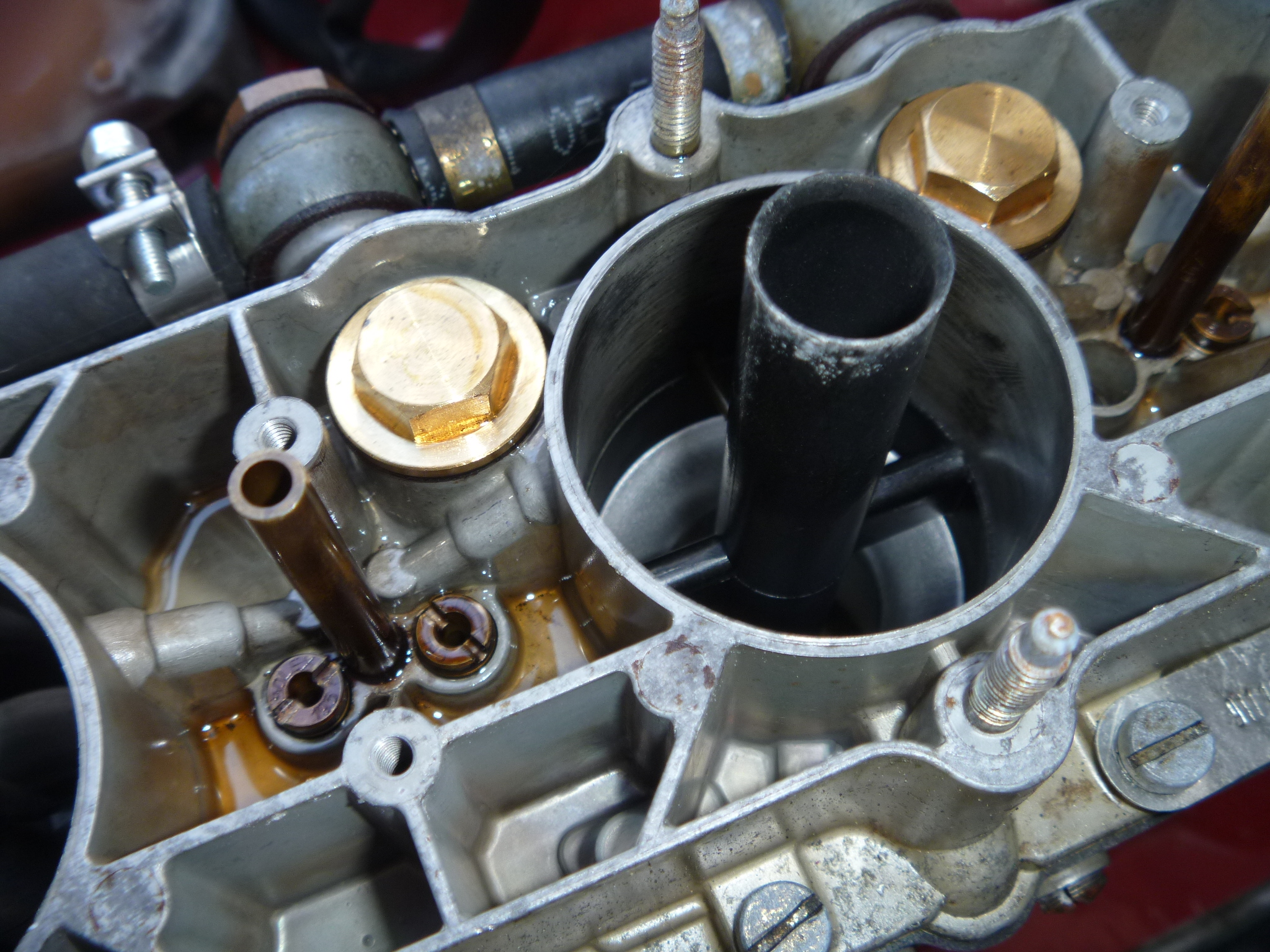

QUOTE(Lucky9146 @ Feb 22 2018, 10:36 AM) *
QUOTE(gereed75 @ Feb 21 2018, 12:27 PM) *
That is an easy fix if it is leaking under the brass hex cap. The cap has a shoulder under the head that centers the copper washer. Sometimes the shoulder is “thicker” than the washer and the shoulder bottoms in the threads before closing on the washer. Simple fix to file the shoulder down a bit so it does not bottom before the washer seals.
BTDT
I suggested trying to fix it here to my carb guy and he really wants to see it because he bench tests each one and is truly puzzled that it leaks. He has quite the machine shop from what I gather and he talked specifically about the machining he does in that area.
Apparently he has had very few problems with his work and really stands behind it. For what I paid him to completely go through them they should be right so I agreed it is best he do it. Thanks and I appreciate your input.
(IMG:style_emoticons/default/white914.jpg)
Had the same issue Jim but left carb leaked ,right hand side was fine,removed and checked caps and sealing rings,the new gasket seals were a tight fit and hadn't seated properly.
The leaked stopped after refitting,I do remember them being very tight when I rebuilt my carbs so think they just needed more torque as the left ones tightened a little more.
This is an issue with the webers as there are on the outside where my Zeniths have them on the inside of the carb top.

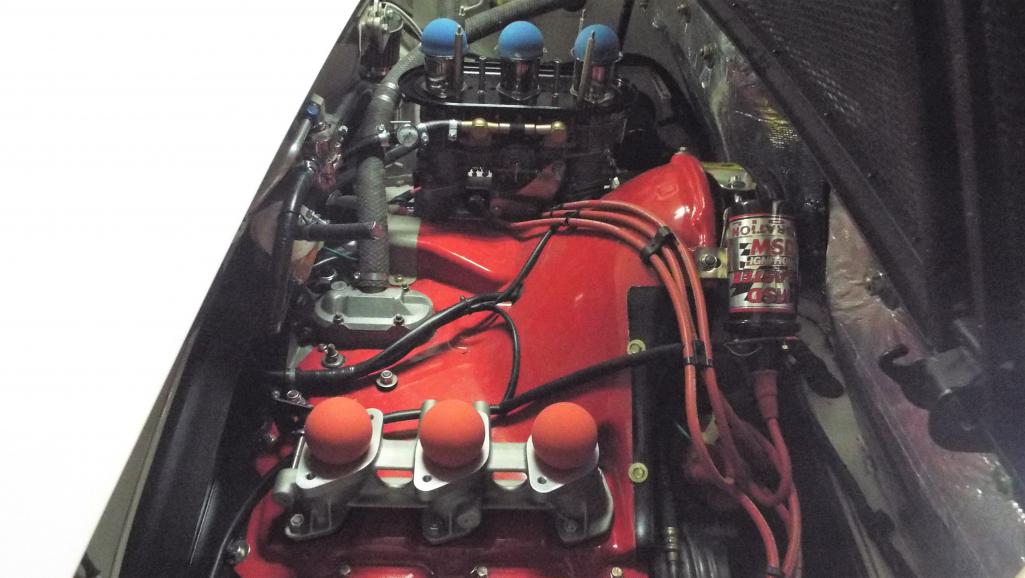

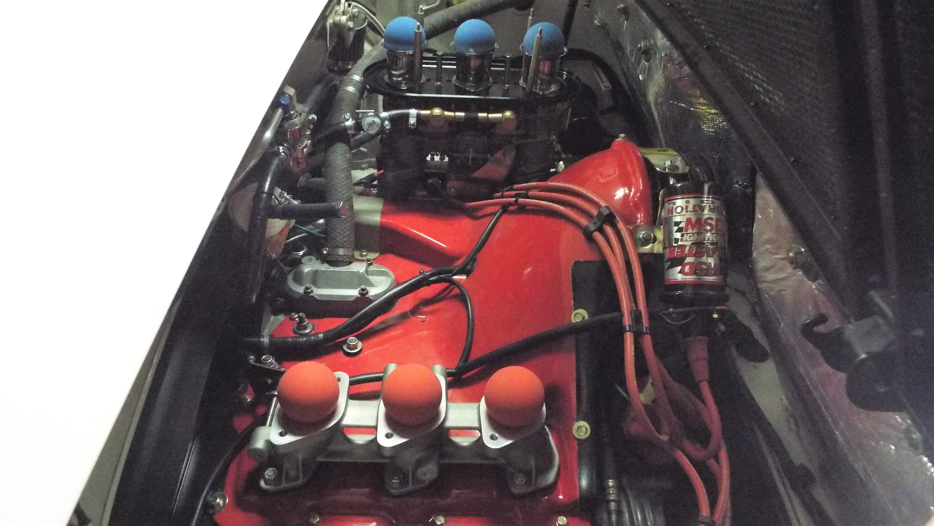

The engine bay quietly awaits the return of the Weber. Yes, I suppose I could have tried to correct the leak but at this point I wanted to take no chances. If you have been following the thread you will recall the many unexpected challenges that have reared their ugly head along the way. (IMG:style_emoticons/default/sad.gif)
I was close to the first start (hopefully no other issues), in the middle of the carb leak, and on the phone with my carb guy who really wanted to see where the problem was, so I agreed to send the carb back. Slow me down, yup, for sure, but the way things have been going, maybe another surprise awaited me under that leaking cap. Maybe not. He stands behind his work, something that seems rare these days. Should be back mid next week so I'll pick it up from there. (IMG:style_emoticons/default/driving.gif)
Gives me time now to replace that fuel pressure guage I was not totally comfortable with to a higher quality Marshal guage. I said good enough for the short term start up but I want to feel more confident in the desired 3.5 PSI pressure to the carbs.

The seal under the brass covers should be a red fiber material not copper or aluminum.
In my experience new ones will leak when first installed.
If you soak them in gas before install they will swell and seal better.

QUOTE(rgalla9146 @ Feb 24 2018, 08:48 AM) *
My understanding is that it is an aluminum crush seal. Could be wrong.
I think it is these two shown here:
sixnotfour
post Feb 24 2018, 12:34 PM
Post #555
Posts: 10,791
Joined: 12-September 04
Member No.: 2,744
aluminum......

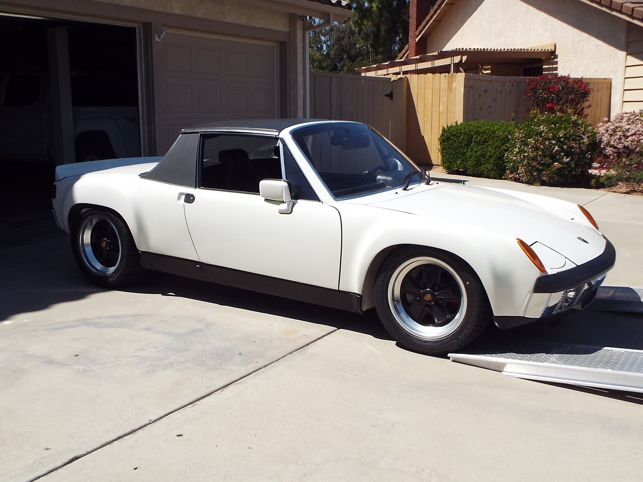

Today was the big day! I finally fired up my 6 for the first time! (IMG:style_emoticons/default/piratenanner.gif)
Because I had cranked it before it was lubricated, and because I had pressure checked the fuel system, fuel was in the carbs, and the pressure regulator was set.
I tuned the key and it sputtered. (IMG:style_emoticons/default/smile.gif)
Like it wanted to start, so I turned the dizzy just a bit and tried again and it fired right up, it was almost surreal. (IMG:style_emoticons/default/piratenanner.gif)
It started right up to a very nice high idle. After a little over 4 years it runs and sounds fantastic!
I have tried to the best of my ability to post videos but they are just too big, even at only 19 seconds long, and I have tried everything I know to shrink them with no success. (IMG:style_emoticons/default/mad.gif)
Maybe later I can. This was the good news post.........
