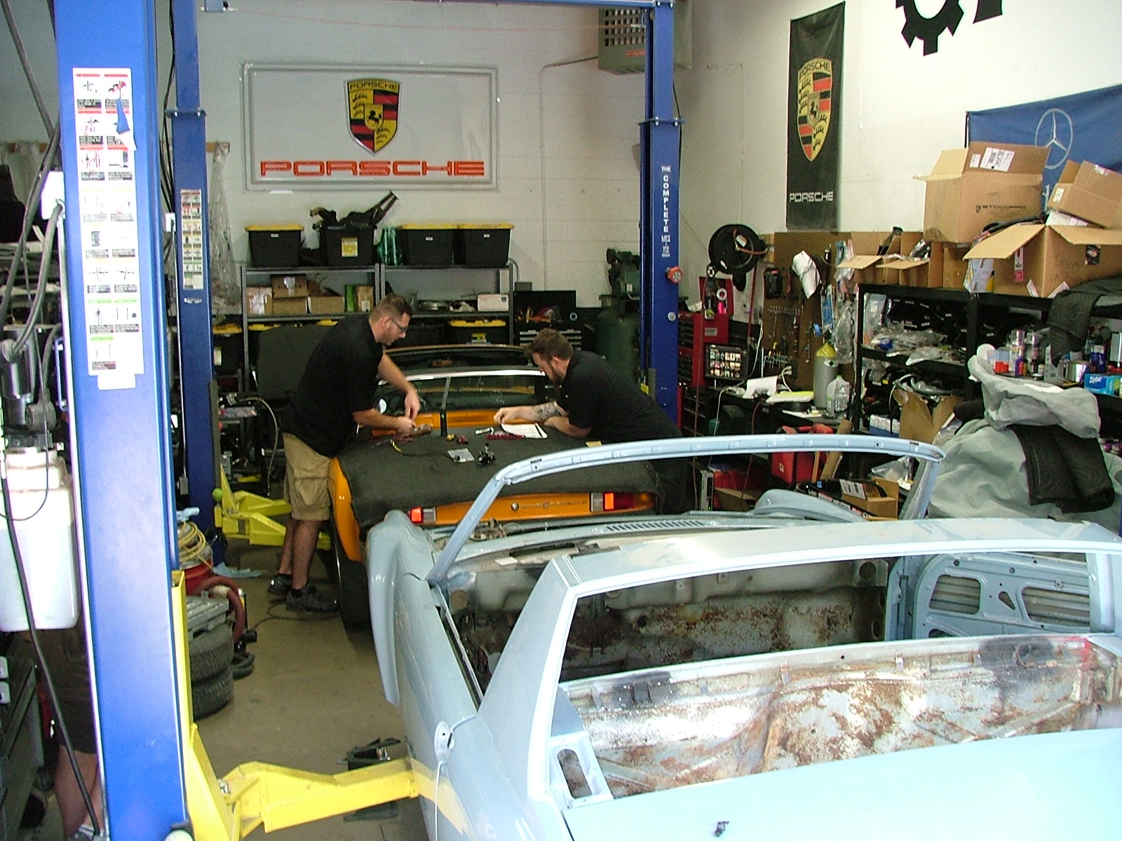

Visited Eric Shea at PMB Performance today in SLC. Great guy!
I just paid a visit to my older brother who has lived in SLC for over 30 years. I have always said "next time I make it up the SLC I have to stop in and see Eric Shea". My brother, who is not a car guy, agreed to go to Eric's shop which as it turns out is only 3.4 miles from my brothers house! In the end he really enjoyed going and meeting Eric who as it turns out had worked with my brothers son for many years. Small world!
When we arrived, Eric was in the process packaging up a set of brake lines. It looked like 8 sets of calipers were also ready to go. Eric took the time to tell us all about his business, how it all got started, show us around, while being very gracious with his time.
With my next project being 915/916 trans, it looks like the timing was perfect and Eric and I will be talking more about the axles I will need.
Eric is out growing his shop and has a 5 year back log for restorations with two 914's in process. I really loved his current shop though, cramped yes, but a real shop that work is actually getting done in, functional looking, and he has a great bunch of guys there as well. Thanks Eric (IMG:style_emoticons/default/beerchug.gif)

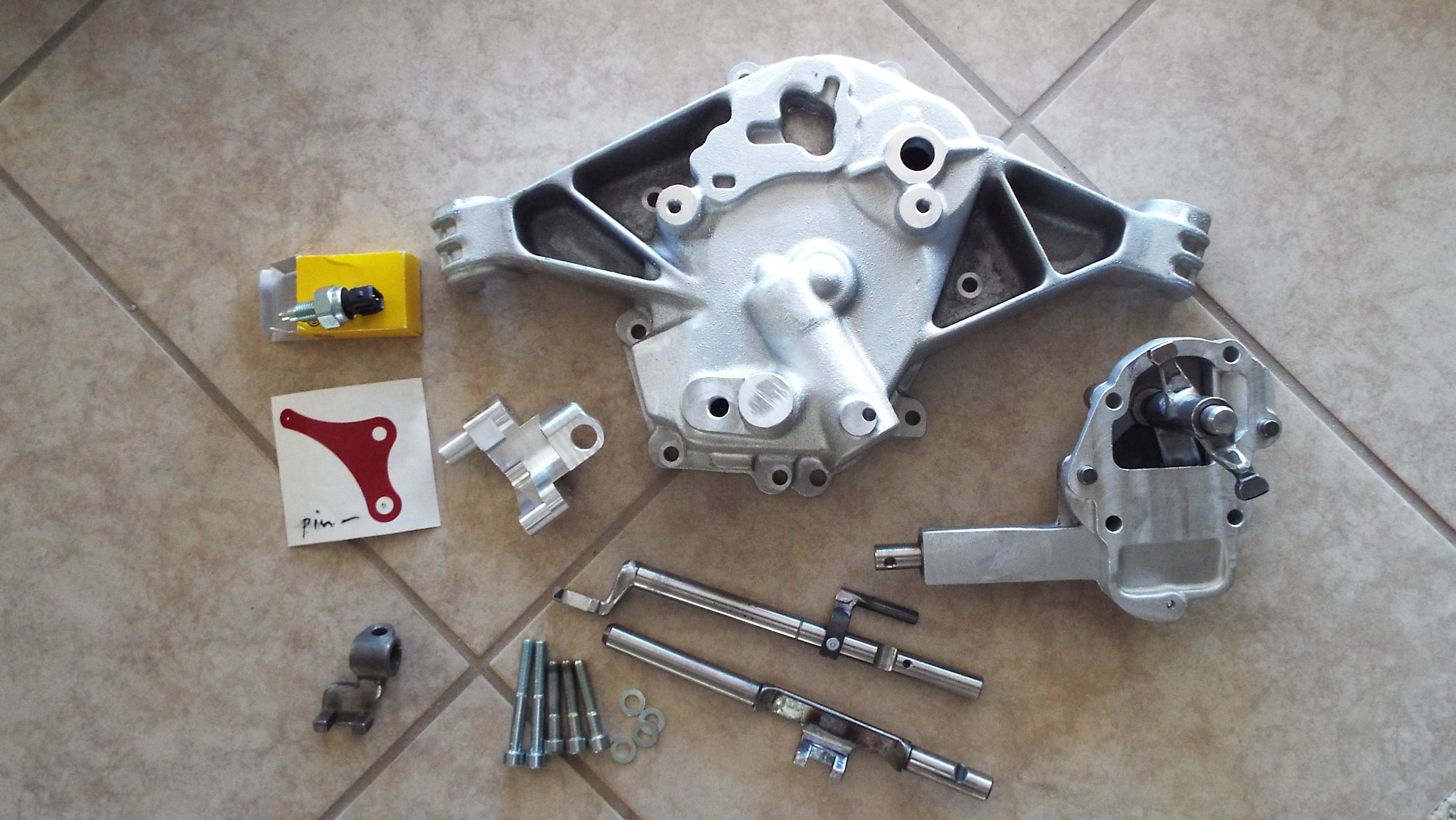

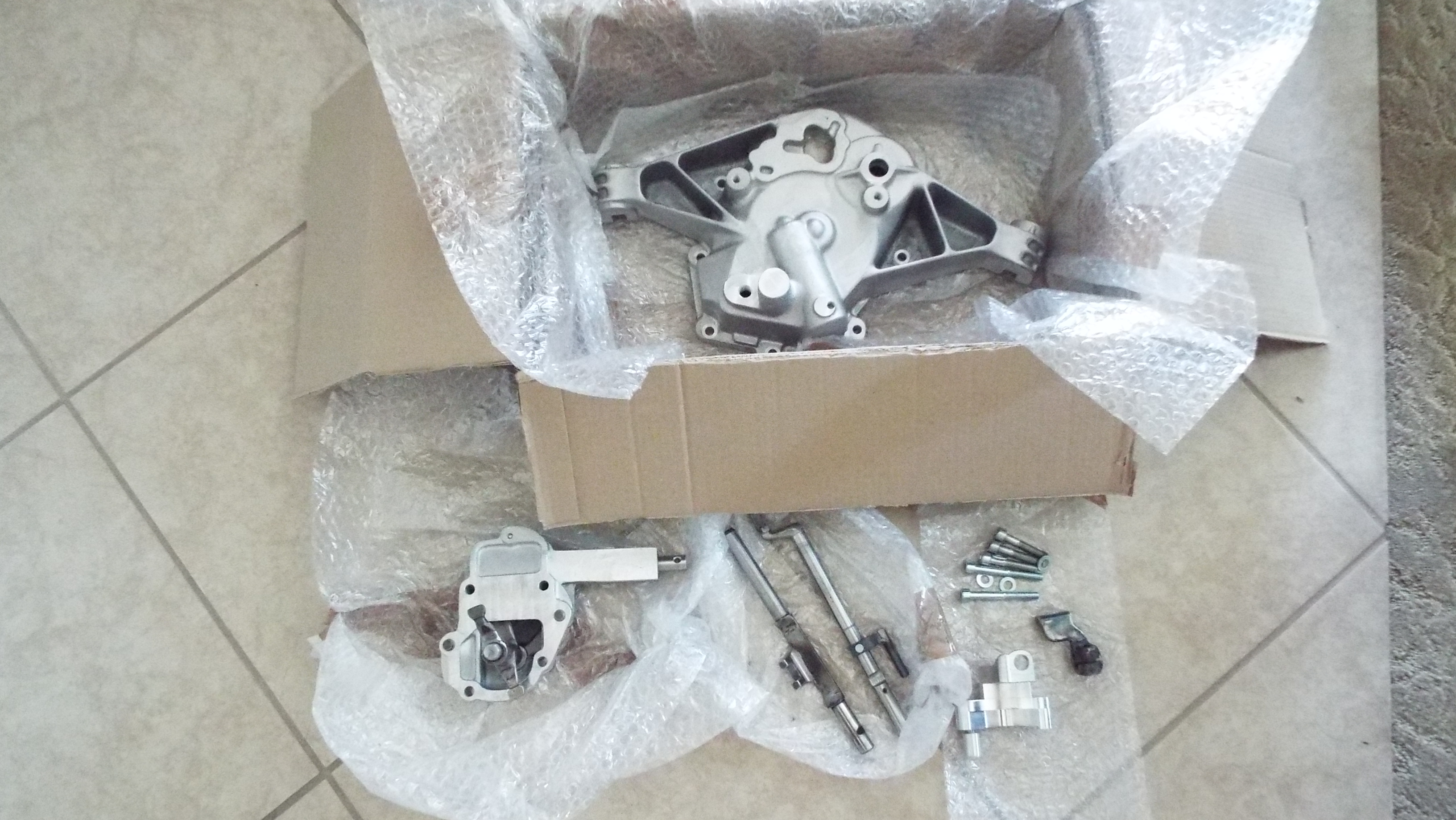

Look what showed up yesterday from Germany! (IMG:style_emoticons/default/cheer.gif)
Martin Bott came through with his beautiful 916 kit! (IMG:style_emoticons/default/beerchug.gif)

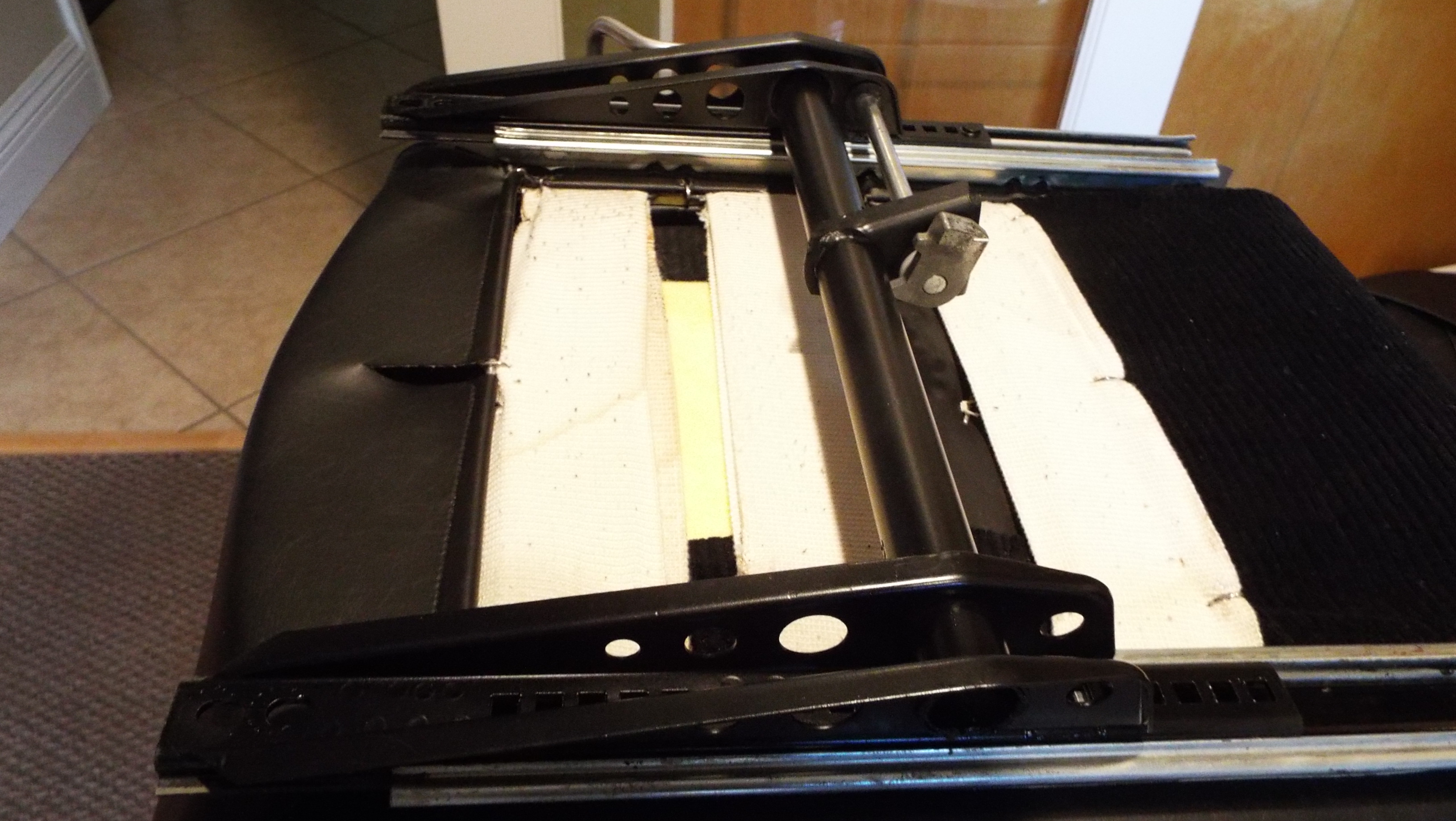

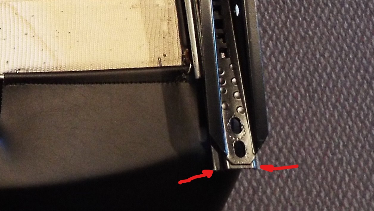

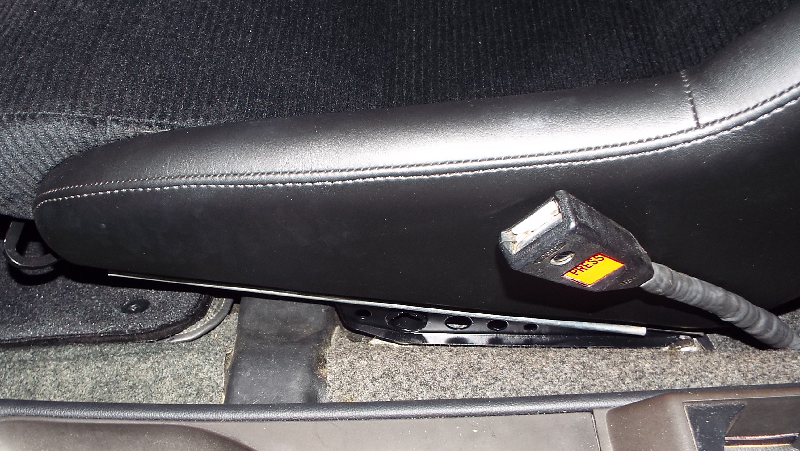

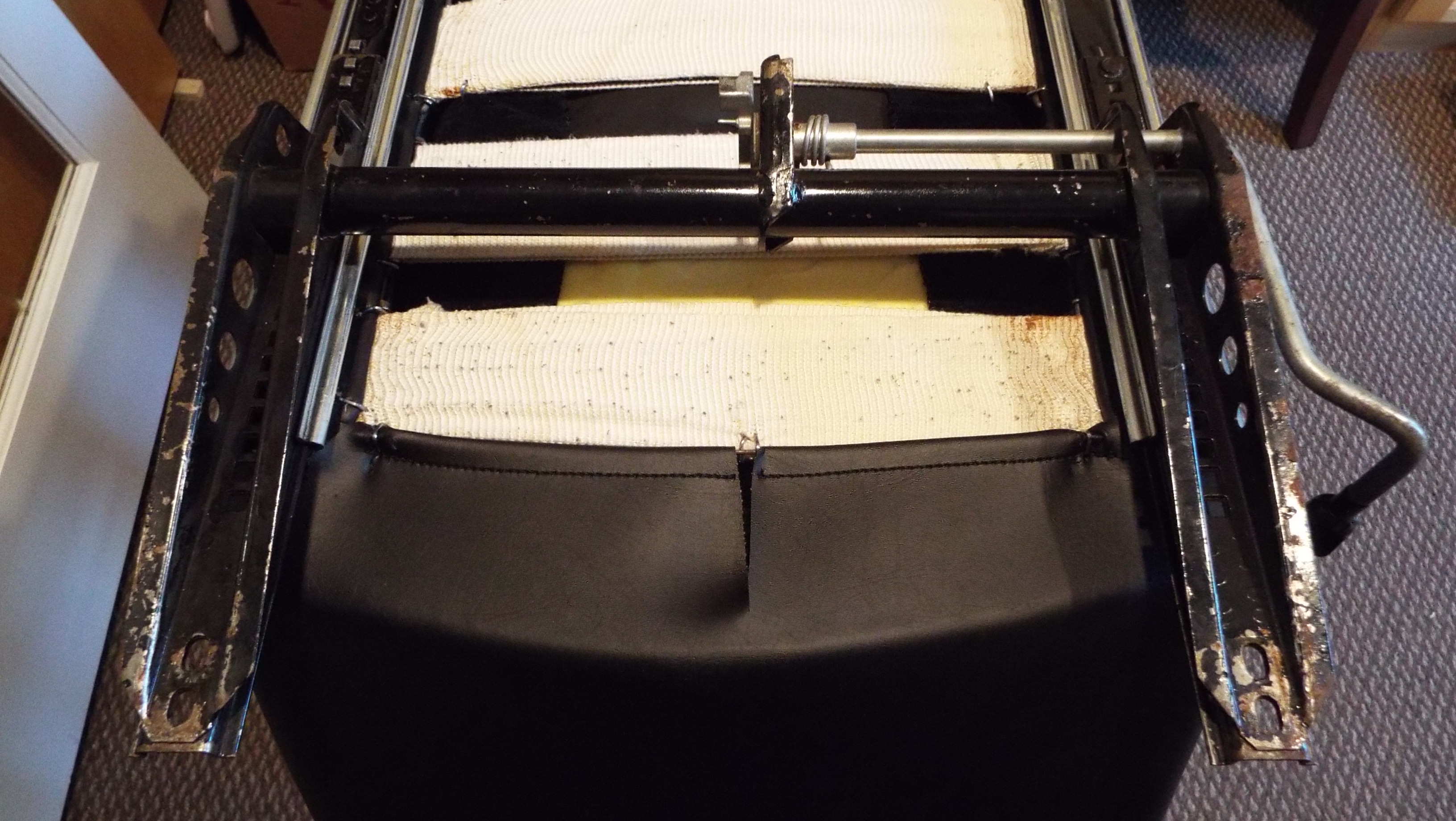

A lesson in NOT getting in a hurry. Well, I finally got around to restoring those seat sliders.
When my Scheel seats were done, I guess I just couldn't wait to see what they looked like in the car. Taking the stock seats out I transferred the seat base mechanisms over to the Scheels and in they went. The seats looked fantastic and I Just started driving it. (IMG:style_emoticons/default/driving.gif)
Most I am sure did not notice my crappy looking sliders because there is really not much visible, but it sure bugged the hell out of me!
And the after pic. I realize this is a small deal but still, details are important, and I also wanted to point out that I ordered and installed the 914Rubber bushing kit. (IMG:style_emoticons/default/beerchug.gif)
(IMG:style_emoticons/default/driving.gif) (IMG:style_emoticons/default/white914.jpg)

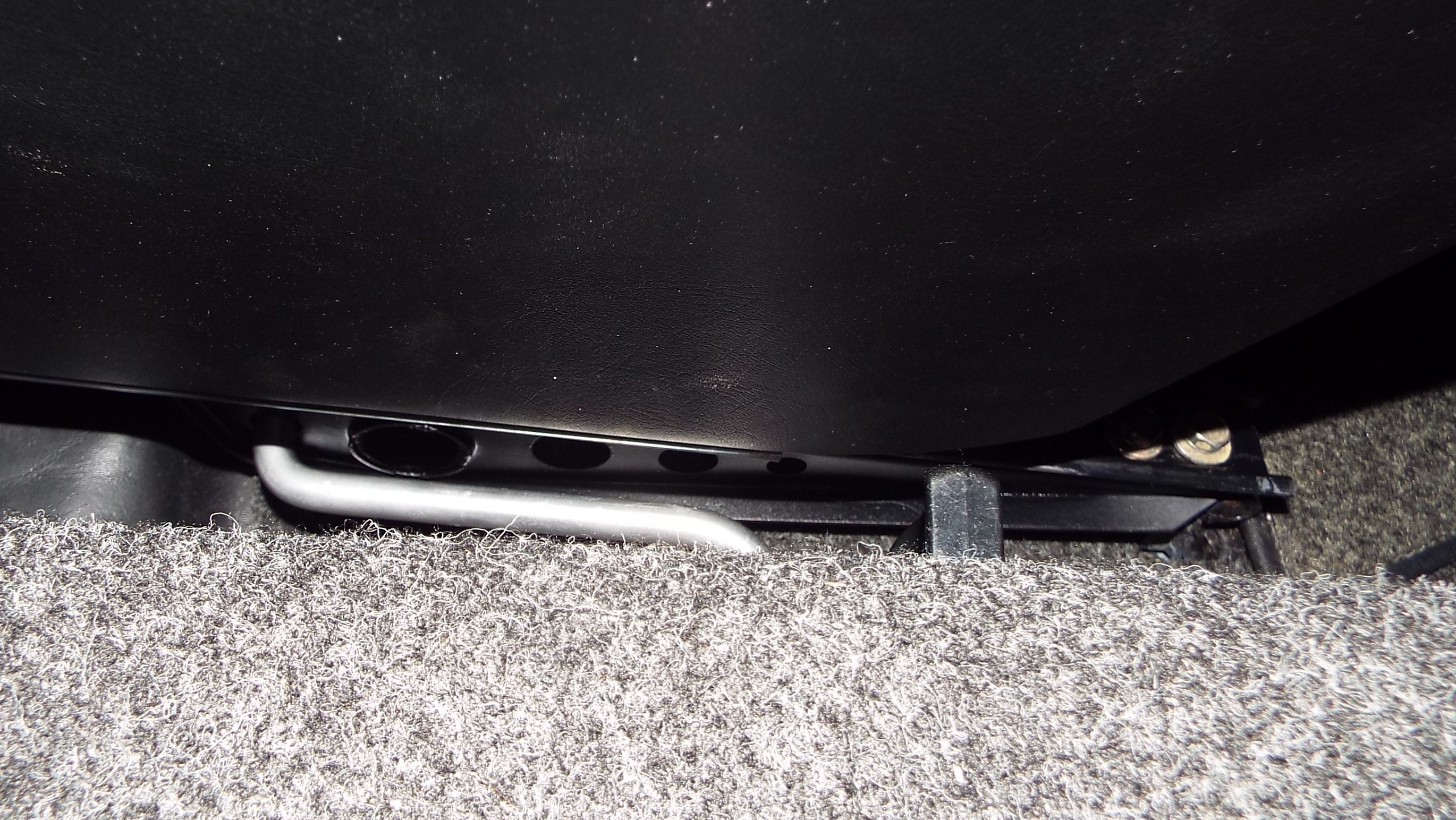

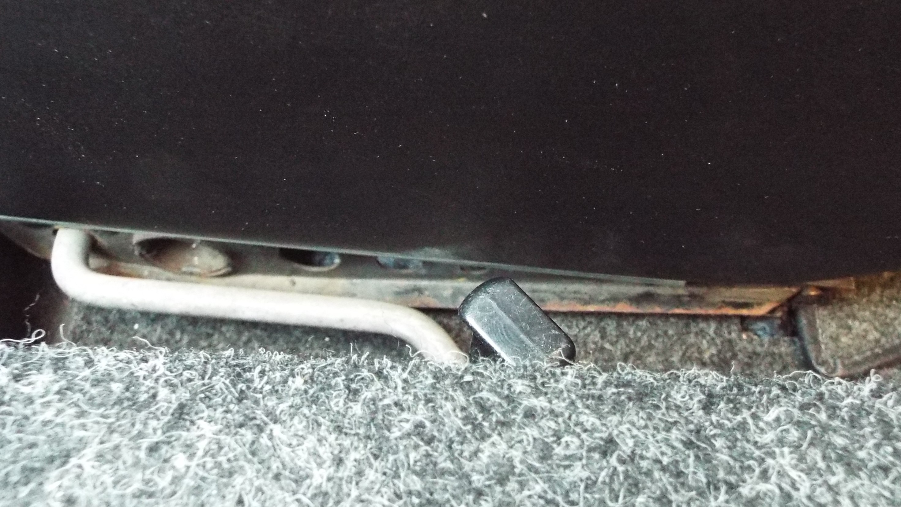

And I get to look at this view of the passenger seat slider now. Amazingly there still are a few things left to do. Is this car ever finished?

post Nov 4 2018, 03:01 PM

What paint did you use? I was thinking of using cerikote since it has a lot of abrasion resistance but doesn’t have any thickness like powder coat or epoxy.
Lucky9146
post Nov 4 2018, 04:24 PM
Post #855
Posts: 1,676
Joined: 22-September 14
From: Poway California
Member No.: 17,942
QUOTE(mepstein @ Nov 4 2018, 01:01 PM) *
Hey Mark,
After I blasted my frames, I taped off the edges of the runners (red arrows) that end up inside the two side rails as you never see them, except the last 4 inches on the top side were painted because you do see that. This avoids clogging up the rails with paint. Now I wish I'd taken in process pics.
I used Krylon MAXX Gray primer #9183 and Krylon MAXX Satin Black #9158
Gave me very good results. Thanks for asking. Hope this helps. (IMG:style_emoticons/default/beerchug.gif)
