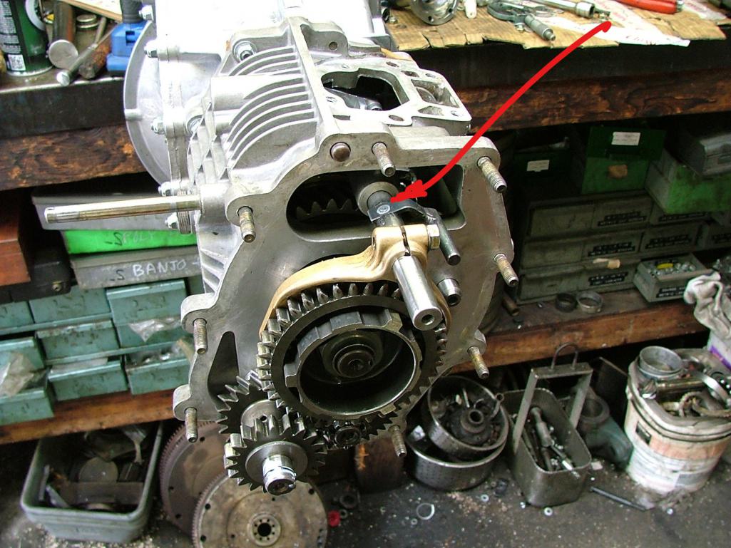

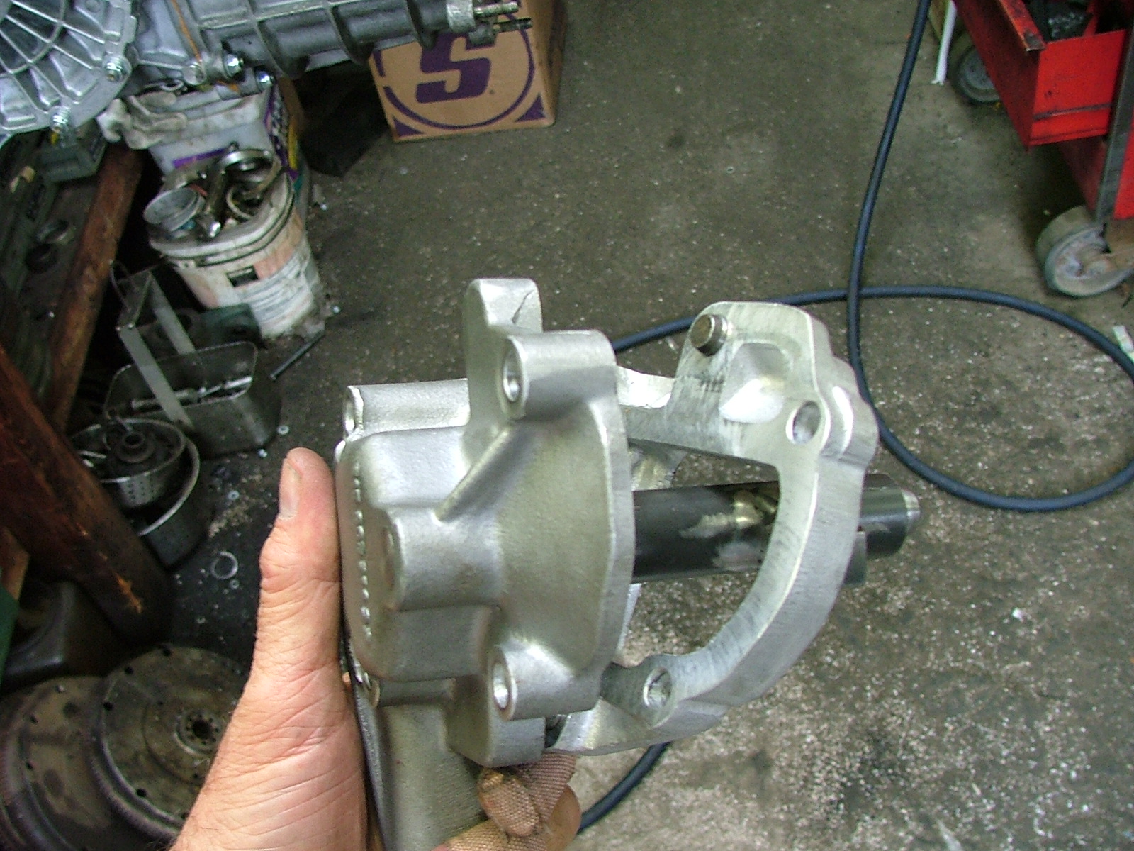

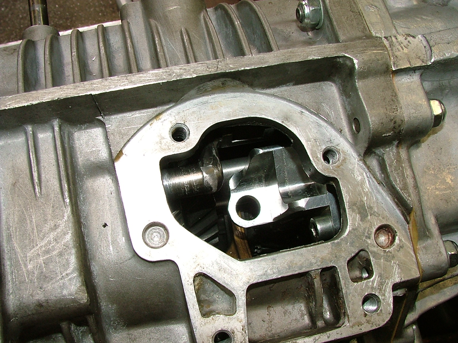

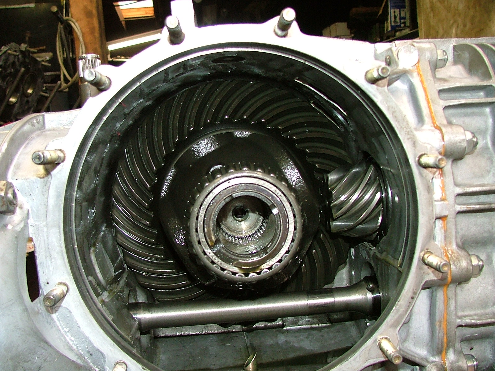

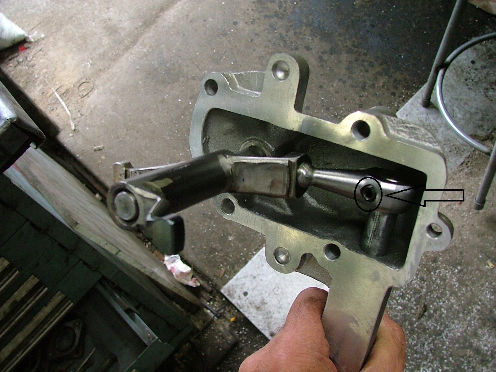

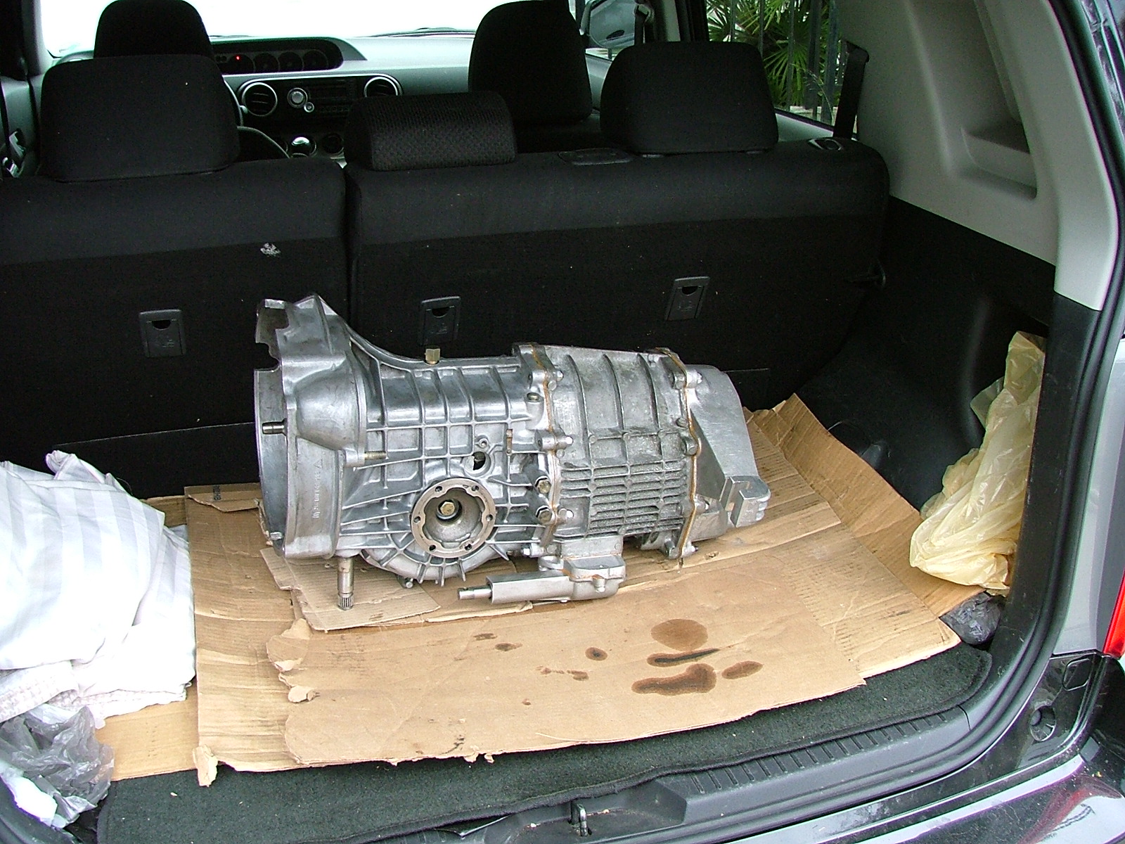

I need to finish up on the transmission that was completed almost a week ago.
Last Monday 9 am sharp I was back to the shop to finish things up.

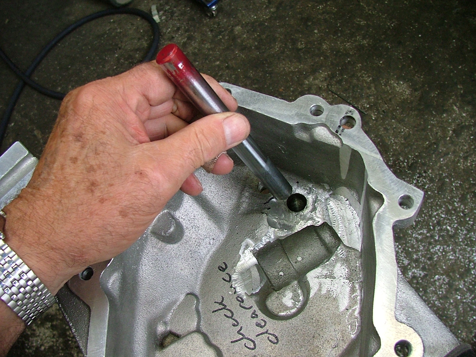

This is a picture of the inner support block the shift console mates to.
The hole for the reverse rod needed to be opened up and my guy came up with this cool approach by taking a shaft and putting a sharp corner on it making it a shaver. If you try to push it into the side of the hole while pushing in and out. Very cool idea and worked well!
Ring gear now on the proper side for a 914. (IMG:style_emoticons/default/smile.gif)
Since trans is pictured upside down, that vent tube at the bottom needs to be rotated 180 deg since the trans will now be the opposite direction from a 911.
And this is correctly positioned now, failure to do this will result in oil coming out of the top of the box.

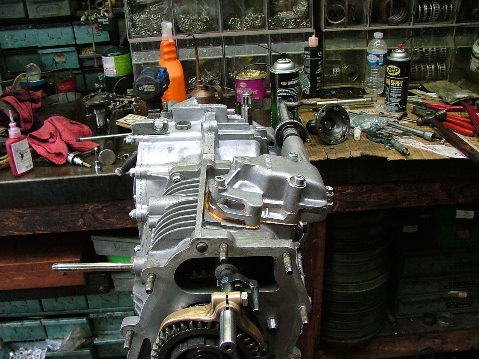

I had read that Lock-tite should be applied to the reverse rod screw. Done and hope it works.
(IMG:style_emoticons/default/driving.gif) (IMG:style_emoticons/default/white914.jpg)

No gasket is supplied with the shift console so we used Lock-tite 574
Nose cone on and home we go
Step 1 find transmission
Step 2 buy Martin Bott 916 kit
Step 3 find a shop to do the work
Step 4 actually install the kit
Step 5 look at how cool it is!
Step 6 figure it out from here with the help of Steve and others (IMG:style_emoticons/default/smile.gif)

I hope they used loctite on this screw. It backed out on me and another person mentioned the same thing in another thread.
Pro or con I swapped it out with a 914 shift rod tapered screw.

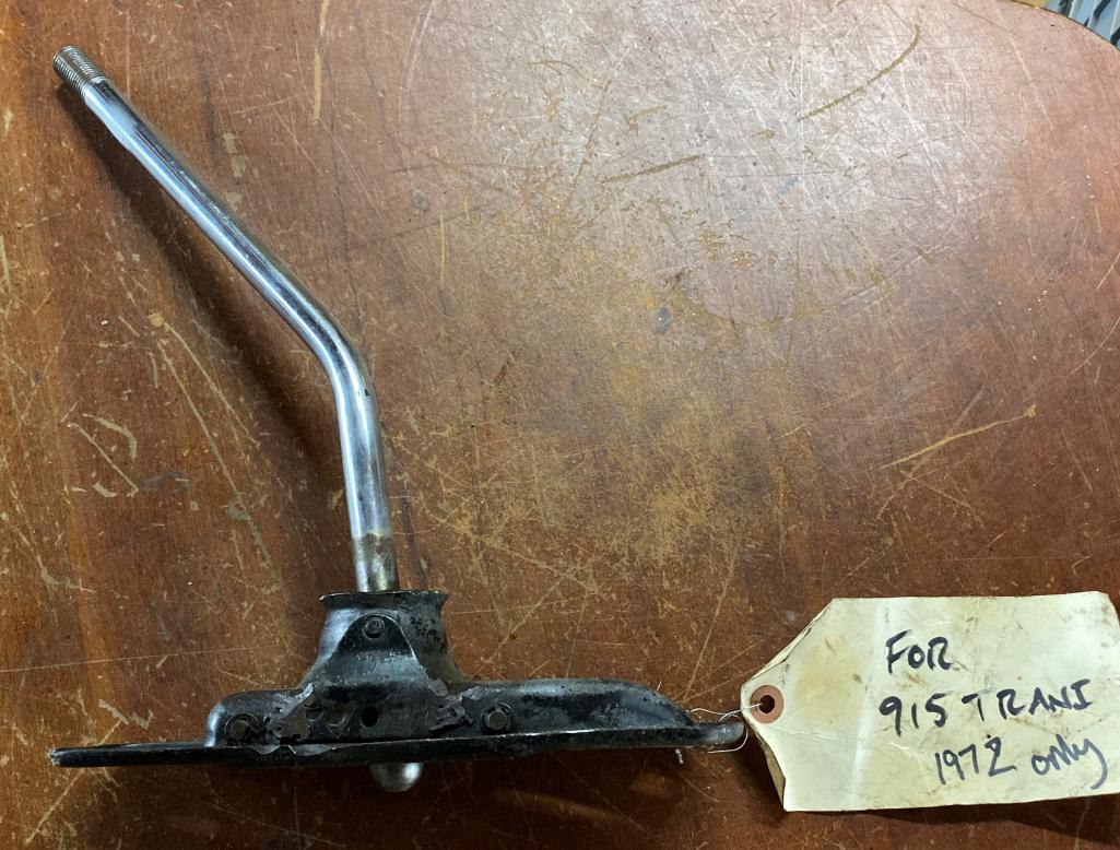

OH MY! Last post June 9th, I wish I could say I have my 915 trans installed but life has gotten in the way and unfortunately it is not! (IMG:style_emoticons/default/sad.gif)
A small bit of headway in the form of purchasing a 1972 911 shifer off Pelican is about as far as I've gotten. BTW that selection is thanks to Steve as he had been trying to sort out his shifting problem and came about the 1972 shifter as the answer. Apparently it has a wider neutral needed for this set up and is one year only part. So I will happily follow his lead.
And I should say I owe Steve a huge thank you for his consistent plentiful advice and occasional prodding I need. Thanks @steve (IMG:style_emoticons/default/beerchug.gif)

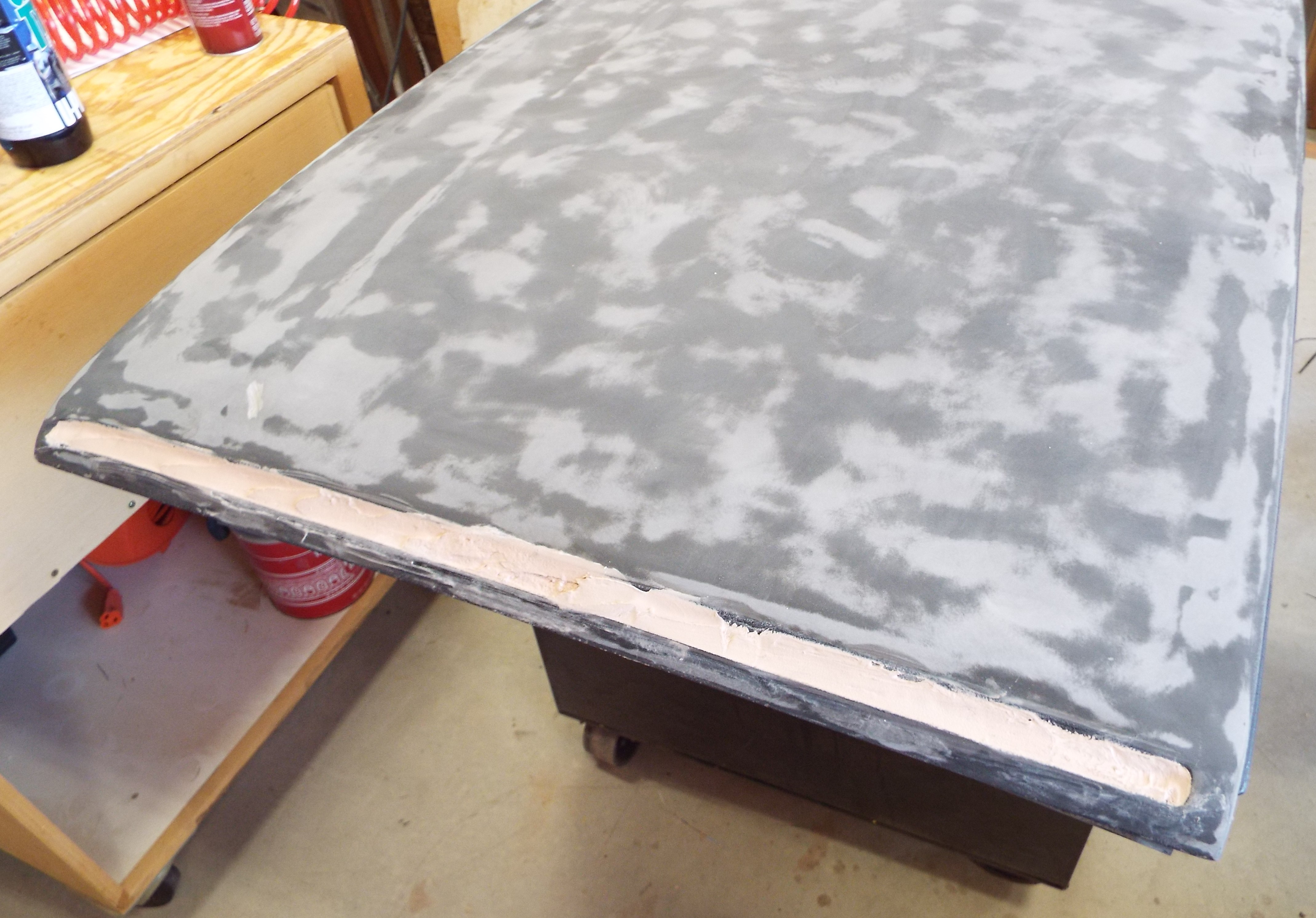

I saw in Eric's thread he had tackled his roof, texture and all, and it came out great! That reminded me I had bought a spare roof at one of Bruces swap meets because I wanted a smooth roof like I had seen at Luft 6 that I just could not get out of my mind. I did not want to commit my roof so now I have choices.

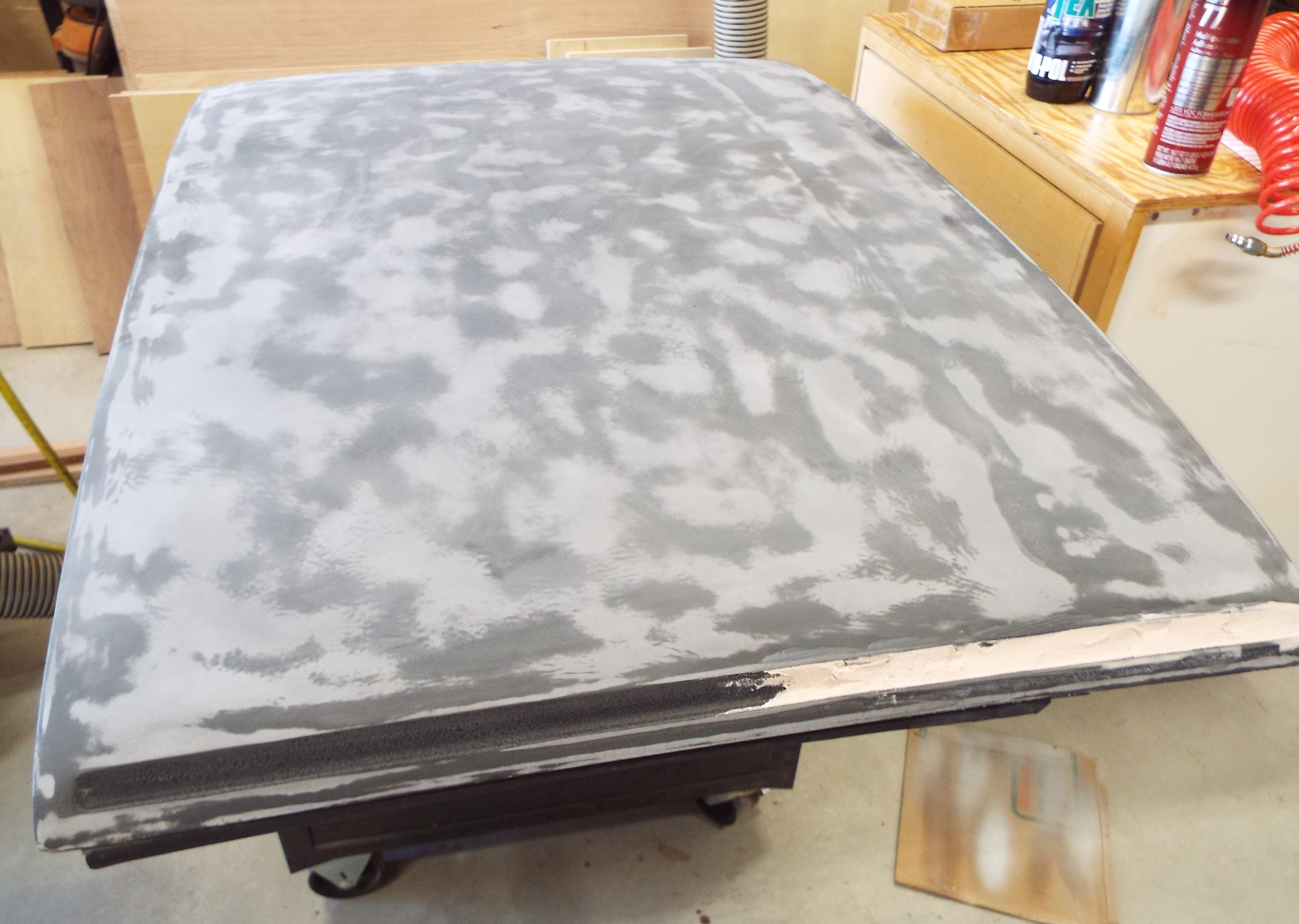

So in Mar 2020 I started by filling the rain troughs sanding it down to primer while avoiding getting into the fiberglass.
These are the only pictures I can find so far and I guess I will have to take a picture of the finished product and post tomorrow! All I remember is there was a lot of wet sanding and re-primering.
I know, filling the troughs with Bondo may not be the recommended method but it worked fairly well. More pictures to follow.

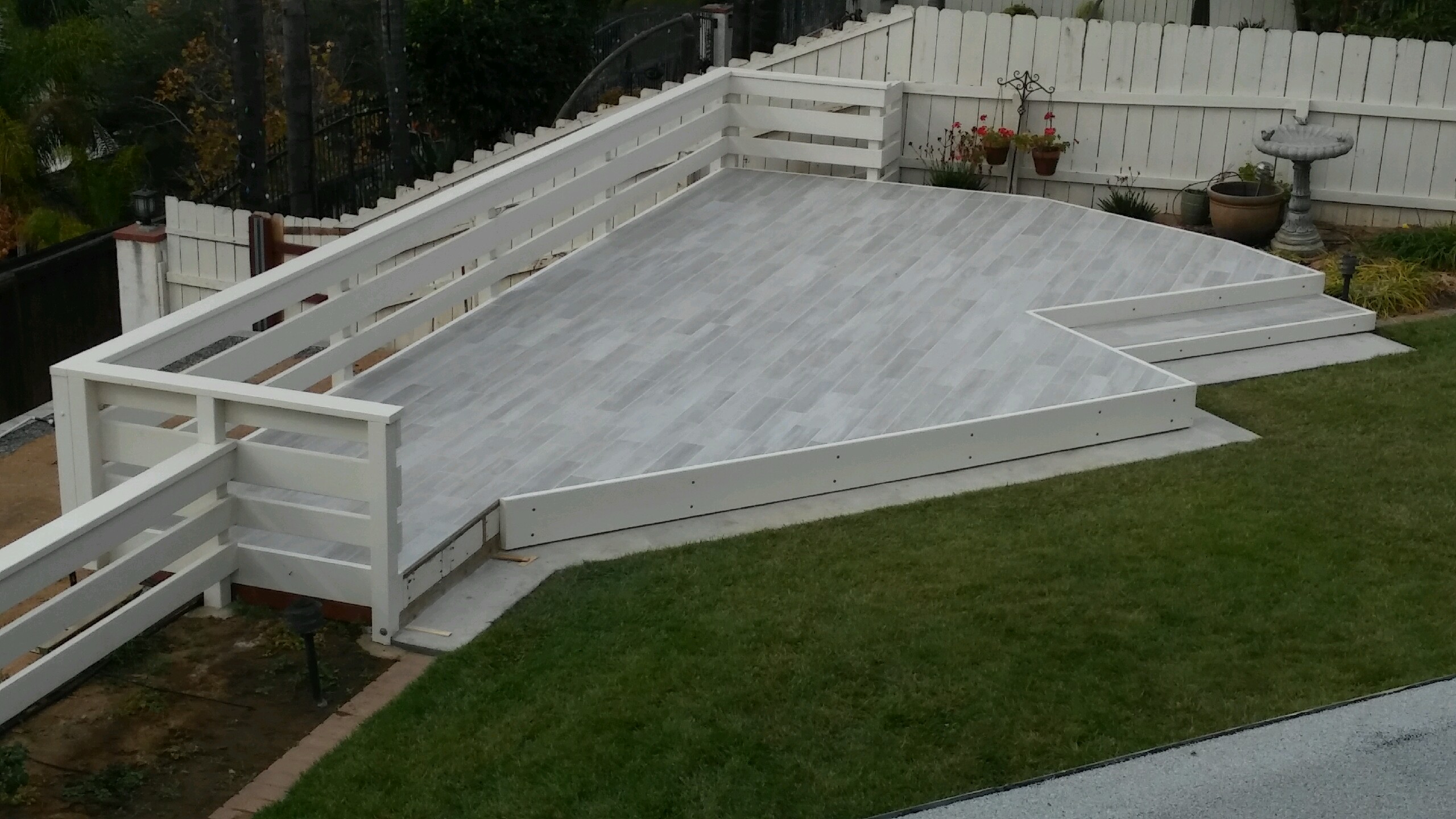

We called this the "Covid Project" which was my wife and I completely rebuilding this deck I had originally built in 1988. It was tired and rotting and of course had a few termites. Worst of all it had "occupants" under it from time to time over the years attracted by my neighbors fruit and nut trees. Lots of clean up of nut shells.
It is 28 ft long. We started in April 2020 and it took 6 months to finish working pretty steady. What you can't see is under that deck is all cement to the tune of about 160 90# bags of Redicrete which we used a mixer to mix and wheel barrow in. I doubled the 2 X 6 and some 4 X6 stringers spaced to every 12 inches and redid all the footings to support 3/4' Exterior Plywood with thin set Hardiboard laid in herringbone pattern and then thin set 6" X 24" tile. Lost count of how many decking screws I put in. Should be there long after I'm gone! I won't bore you with all the in process but suffice it to say it is now designed so no varmints can get under it. I see now that I posted it the last facer board was not installed yet.

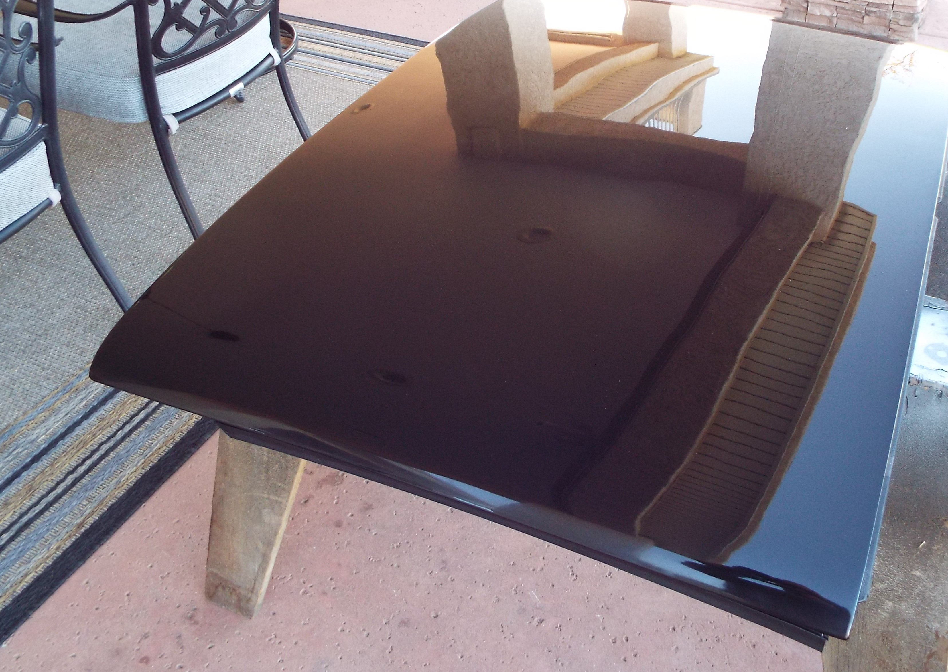

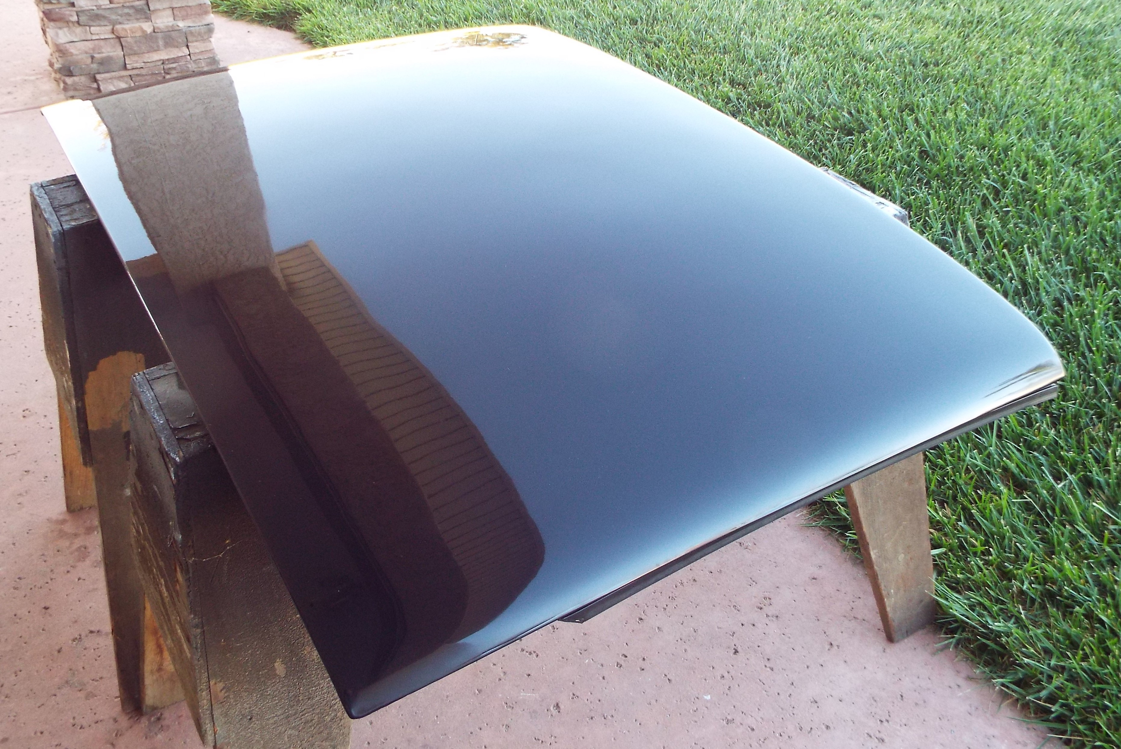

Pictures shot this morning of the smooth gloss black Targa Top I refinished as a spare. It was way, way, way more work than I anticipated. Many primer coats and wet sand, plus many paint coats and wet sand to achieve this finish. I'm not one to give up!
Reflection of the ceiling of my patio cover!
Love the slick top look and it will never see rain, at least that's the plan.
That blemish looking thing in the upper right corner is actually a reflection of a tree out in the yard. (IMG:style_emoticons/default/biggrin.gif)

Very nice. Looks like black glass. (IMG:style_emoticons/default/beerchug.gif)

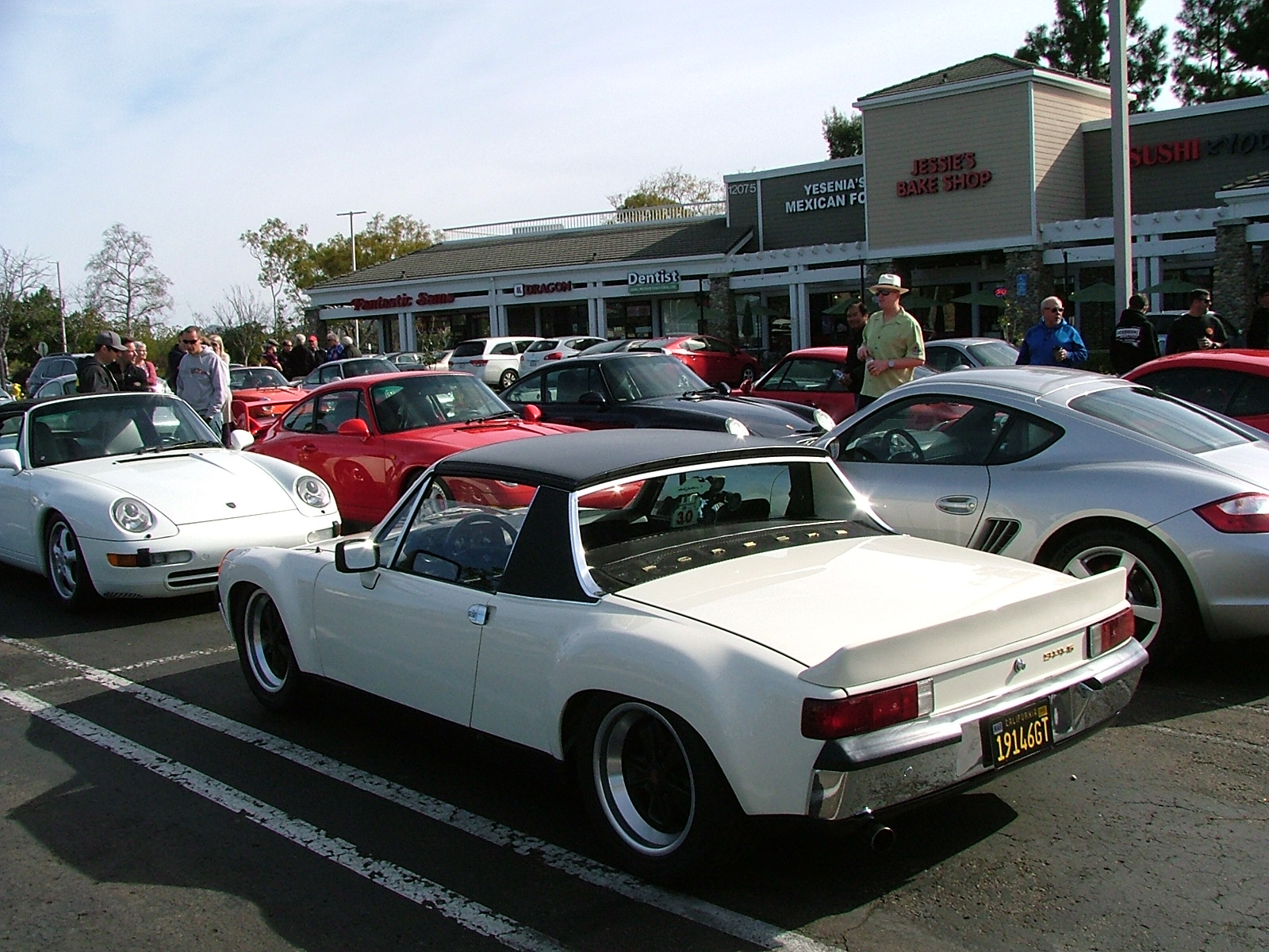

I am realizing I neglected to post some things that happened before Covid hit so in late Jan 2020 I was able to participate in the Local Dealer Porsche 70th Anniversary Cars & Coffee. Billed at the time as the "Inaugural Annual Dealer Cars & Coffee", sadly the follow on second was not to materialize earlier this year with everything getting pushed out or cancelled.
How about this red carpet treatment. It was a highly attended event and done up right Dealer style. I think there were 2 other 914's there.

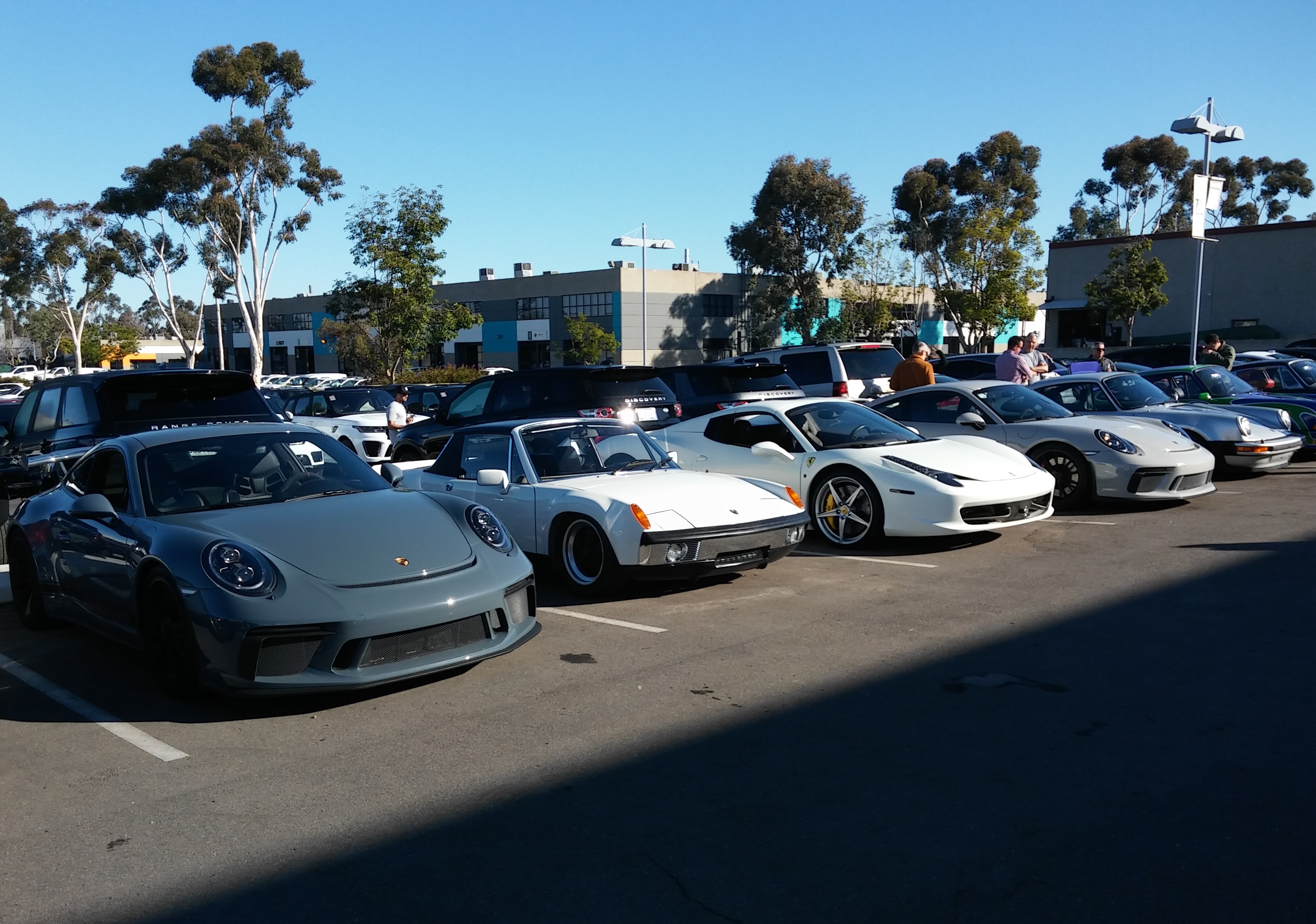

In March 2020 I was extremely fortunate to attend Amelia Island Concours and Werks Reunion and I have to say that this all wasn't cancelled was a miracle!
While on my way up from my daughters to Amelia, the Brumos exhibit had not been open too long and I got a ticket to that. If you get the chance, when things open up more it is truly great. The Brumos 914 was not there at the time as it was at the Concours but the cars there you can walk right up to, no ropes. My God a 550 Spyder and a 917 it was like Porsche heaven at least for me.
