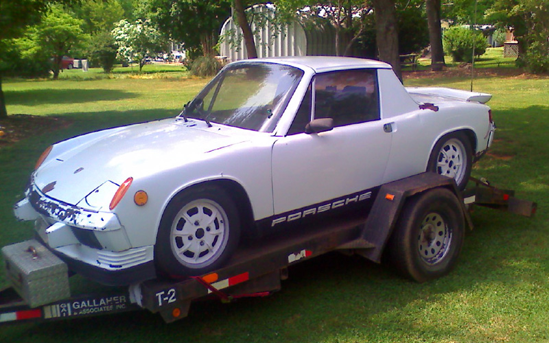

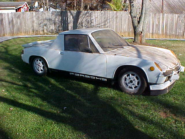

Advertised on the Asheville area Craigslist, the pictures of this '74 914 were extremely low res and blurry. I emailed the seller asking for more info and clearer photos. He never responded with anything useful except for the VIN which fell in the range of Can Am production. Hard to tell any details but I could see it was a white car (more on that later) with no sail vinyl. Hmmm... could it be?
I had a '75 2.0 with an interested buyer. Better than that, he procurred both a tow vehicle AND a trailer and volunteered to drive me the 3+ hours to view the '74. The deal was... if I bought the '74, he would buy my '75.
We headed to the northwest section of North Carolina and met the seller. At this point the 914 was stored in a metal outbuilding. After removing boxes and other stuff, we rolled the dusty, dirty car out into the lawn. I did a quick check and my suspicions were correct... a possible LE! I spied bits of orange hiding behind the white on the wheels and the bumpers. A quick check under the front end showed the air dam mounting tabs. OK, time to deal!

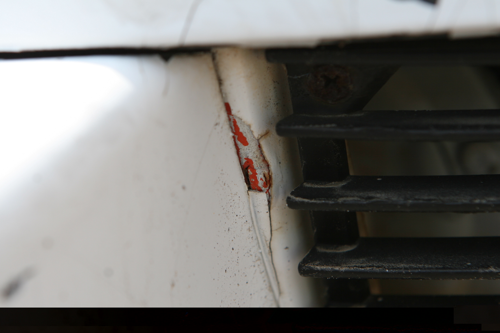

The 914 had definitely seen better days. The engine had a mismatch of FI parts, the longs (and elsewhere) were rusty, the entire car had been painted white (bumpers, wheels, trim, etc). To top it off, a custom wing fabricated from a Trans Am unit had been mounted to the rear deck lid. All this had been done nearly 20 years earlier when the owner was 17 years old. He parked it when he and his friends realized it just wasn't big enough for everyone to cruise around in.
My offer was his absolute minimum so the deal was made. The 914 was loaded up and we headed back to Tennessee. Once home, the '74 was unloaded and the '75 loaded onto the trailer. I actually made a little money on this deal but went from a running 914 to a non-runner in need of a lot of work. But... I now owned a Creamsicle!

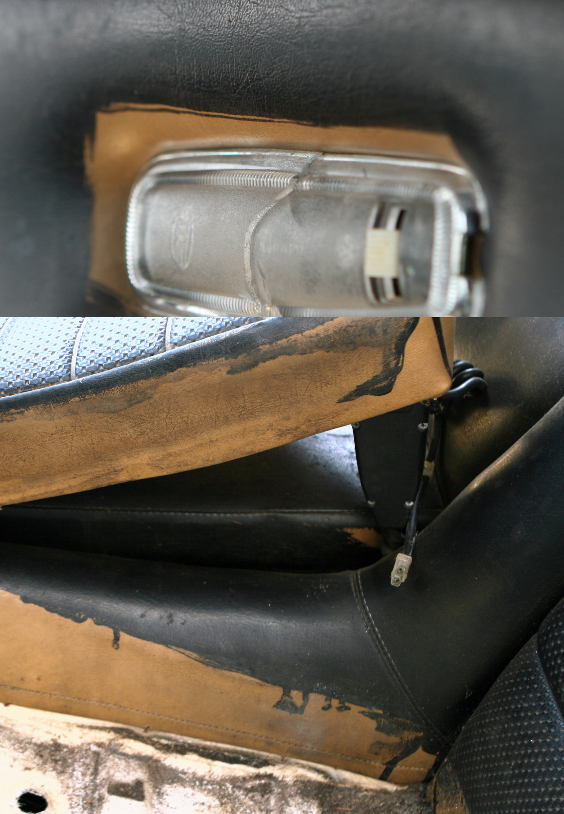

YEAR ONE: Found out my interior was originally cinnamon but dyed black (IMG:style_emoticons/default/blink.gif)

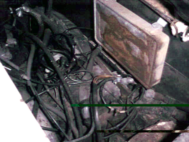

2. Before I install the new engine, I need to do some rust/paint work in the engine bay. The hell hole needs attention for sure. Figure I might as well take care of the rear trunk area while I am at it.

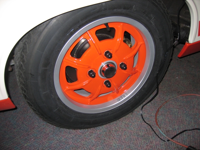

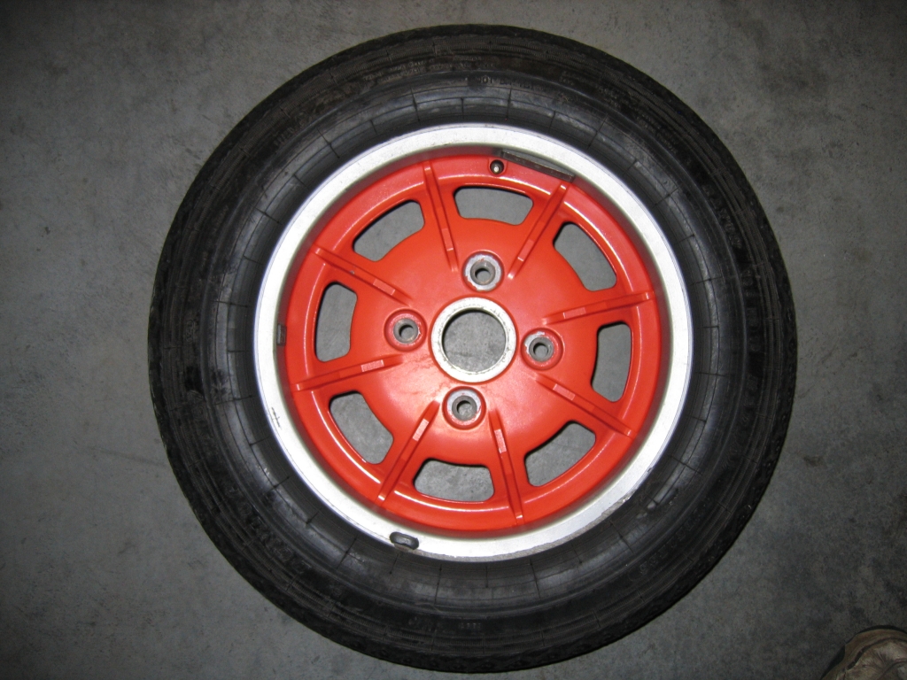

5. Wheels - need to be stripped and painted Phoenix Red

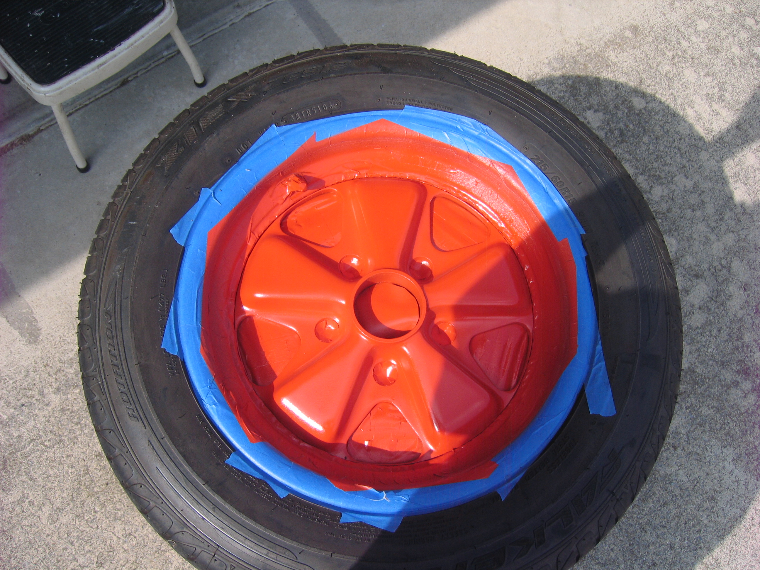

Steve- unless you do the wheels yourself plan on spending @ least $2K refinishing the wheels alone. (IMG:style_emoticons/default/sad.gif) If you are looking to save money remember this: phoenix red = Chevy hugger orange or Chevy engine block orange, color wise. Below is a pic of my unrestored, unmolested spare w/ an original OEM Dunlop SP for reference-

QUOTE(Johny Blackstain @ Oct 2 2015, 12:22 AM) *
Thanks, Al.
Will do them myself. I have found Rustoleum Lobster Red is a perfect match as well (IMG:style_emoticons/default/smile.gif)

QUOTE(poorsche914 @ Oct 2 2015, 08:17 AM) *
Thanks, Al.
When I did the wheels on my six, I used a rope for a nice, clean, round seam along the outside painted border w/ the polished lip. I also taped off the lug holes to prevent future flaking when you go about messing w/ the lugs. It's a boatload of prep work per wheel. (IMG:style_emoticons/default/sad.gif)

The car is much simpler to shoot compared to the wheels. Remove the bumpers, rockers, spoiler & rear valence & shoot them phoenix red. Shoot the whole car in ivory white- done.
The wheels have to have all the holes blocked off from behind, lug holes perfectly taped off, center cap hole painted silver & round, the outside rim painted silver & round. This has to be done to all 5 rims. I have 2 complete sets of rims, one w/ skinny tires for show & one w/ fat tires for driving; this is how I know so damned much about creamsicle wheels (IMG:style_emoticons/default/chair.gif) (IMG:style_emoticons/default/wacko.gif) (IMG:style_emoticons/default/blink.gif)

<snip>YEAR ONE: Found out my interior was originally cinnamon but dyed black (IMG:style_emoticons/default/blink.gif)<snip>
Curious, How did you find out , COA?
As it relates to the motor, if you did get the COA was the motor original to the car?

The case to the original motor that was in the car when I bought it is no longer usable so COA proof is moot at this point. Jake described the damage as a "collapsed main" and said it could not be used for the rebuild. I found a good 1.8 case to be used for the build.
No COA yet to verify but no reason to think the interior had been swapped. The dye job was amateur, to say the least...
If anyone knows of a way to remove the dye without harming the vinyl, let me know (IMG:style_emoticons/default/idea.gif) The original seats are actually in pretty decent shape.

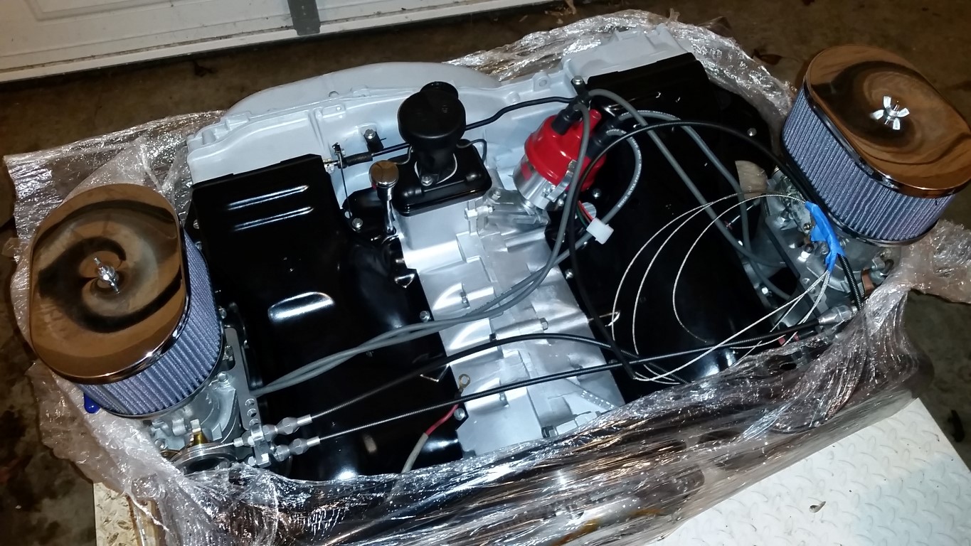

Nothing major has happened with my project until today... my Raby 2056 has arrived!

Whoooo, the primo engine! (IMG:style_emoticons/default/first.gif)
You will have fun driving with that!

That engine looks like pure fun!

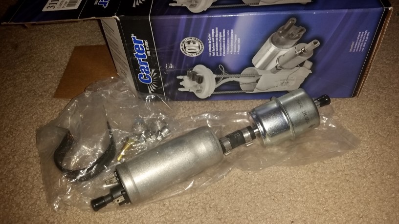

Gathering up the items needed to install my 2056.
Carter Fuel Pump (ebay purchase) arrived today.
Engine install to take place Saturday, March 5 if you would like to join the fun (IMG:style_emoticons/default/happy11.gif)
