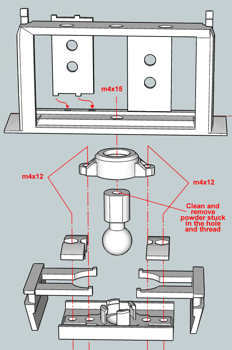

I just finished and tested the first prototype of the 3D printed cell phone / smartphone mount. The mount replaces the ashtray.
This is available as a kit. You will have to order the 3D parts directly from the printer. The 3D printing is made with Polyamide. Its a white, very fine, granular powder. The result is a strong, somewhat flexible material that can take impacts and resist pressure while being bent. The surface has a sandy, granular look, and is slightly porous. The material can be painted.
To complete the kit you will also have to source or order
4x M4x12 screws and nuts
1x M4x15 screw
2x 5x70mm rubberbands
2x small pieces of 10x3mm rubber windows seal
(see ordering post below)
- Fits most phones from the small I-Phone to the large Galaxy from 6 to 8 cm wide (2.3/8 to 3.1/4)

ASSEMBLY INSTRUCTIONS
1- With a small plier, cut and remove all the parts that are shown in red.
Wear safety goggles as parts will jump all over the place.
2- Use a cutter to remove all the excess material.
3- Clean the parts as powder may stick on the surface and in the holes.
You can paint the parts but be carefull to not put too much paint on contact surface of the moving parts.
4- Assemble the parts as shown using 4x m4x12 and 1x m4x15 screws and nuts. Tight the screws gently. Overtighting will bend the parts and damage the plastic thread in the ball joint.
5- Glue the black joints
6- wrap a rubberband as shown on the pictures. A second rubberband is provided as a spare. The two rubberbands can be monted together if clamping force is not enough to maintain small phones.
IMPORTANT: One of the clamps always travels free, the other has to be set up to fit the size of the phone then tightened with the screw.
