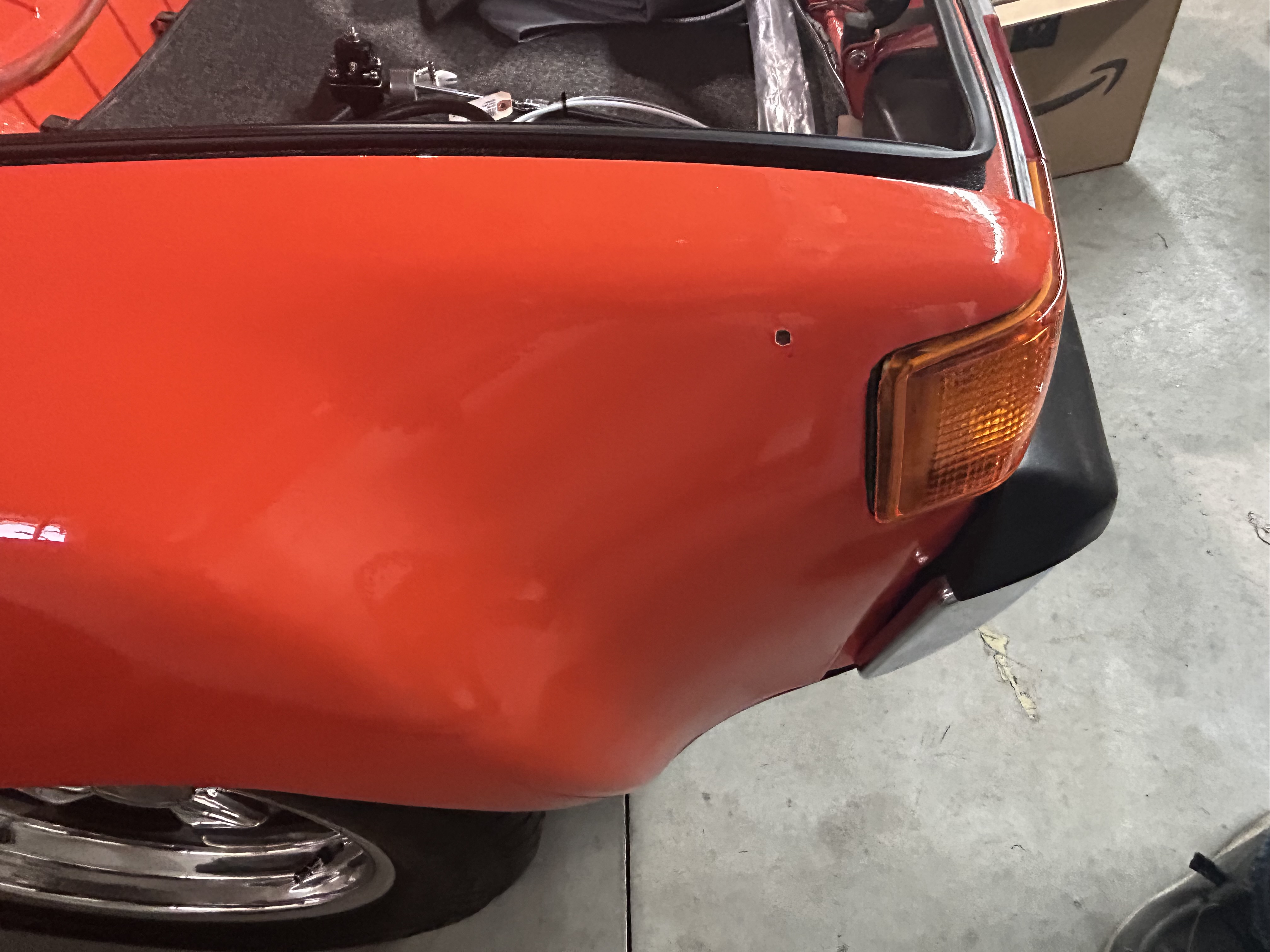

Well to continue on with my EFI project but first to fix the foam rust problem. Attached Image

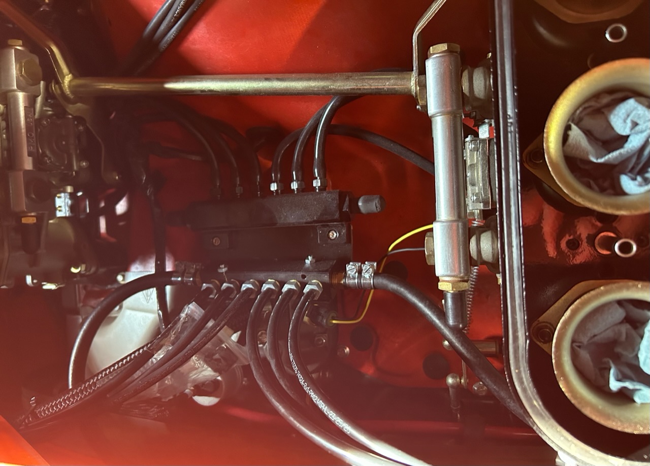

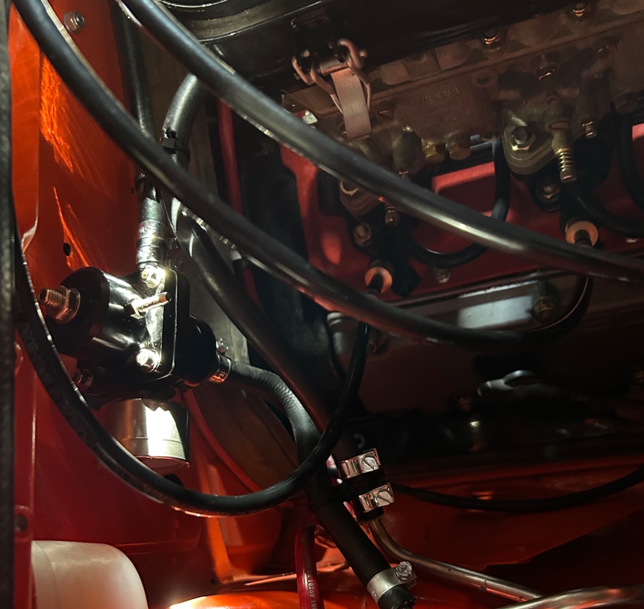

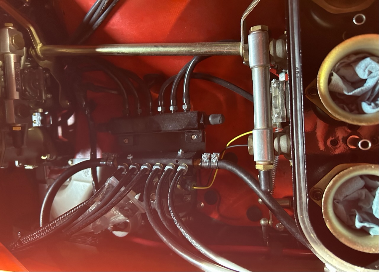

Side tracked again. Wanting to get the EFI plumbing done so I can check if to ensure it’s sealed up before the bitter cold sets in and can’t have the doors open.

I really enjoy this car. I absolutely hate carbs and the way the car runs so different with changes in temp and humidity. Fuel injection will be really nice to deal with

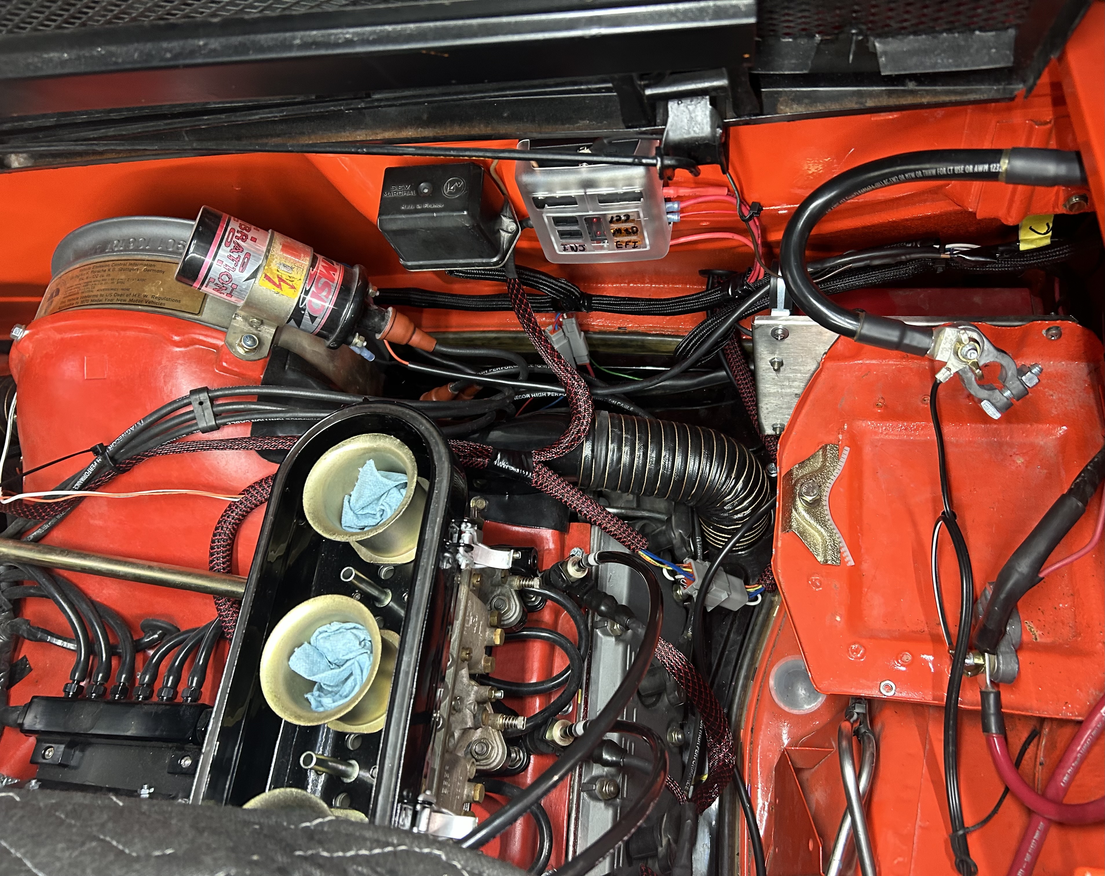

EFI wiring is doneAttached Image

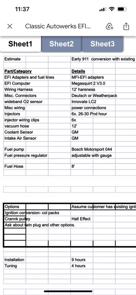

QUOTE(mb911 @ Dec 3 2023, 12:35 PM) *
@mb911 Ben, I am inspired by your fuel injection using weber carbs. Could you please share the fuel injection parts list and custom fabricated parts. I have a good set of Zenith and want to do something similar.
Thanks, Matt
mb911
post Dec 9 2023, 11:39 AM
Post #1351
Posts: 7,539
Joined: 2-January 09
From: Burlington wi
Member No.: 9,892
Matt here is a quick spreadsheet . You do need MFI heads for a similar setup to what I have or drill your heads like thisAttached Image
mb911
post Dec 9 2023, 11:55 AM
Post #1352
Posts: 7,539
From: Burlington wi
Member No.: 9,892
@jpnovak is whom you source most of the parts from over on pelican and I think here as well

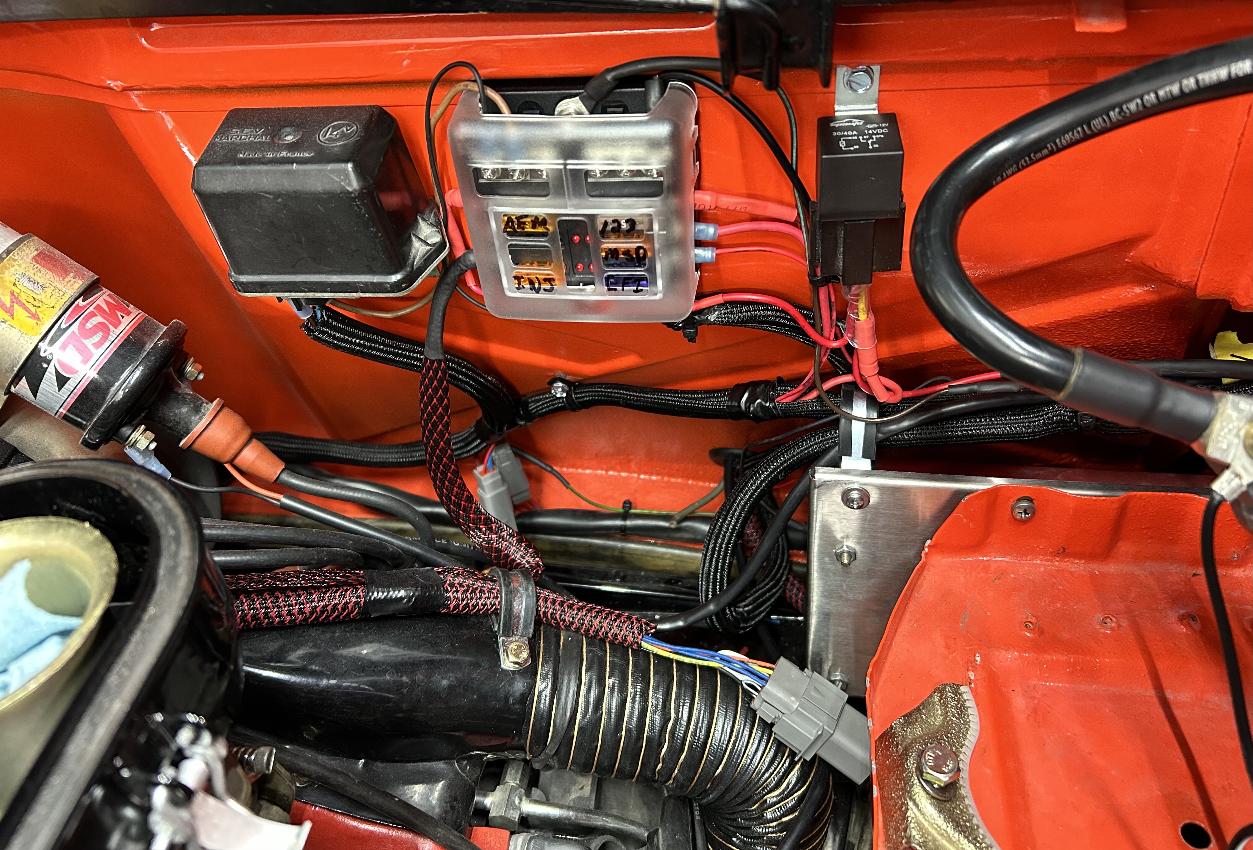

I added a relay to the system. I felt the fuse block was powering to many things to pull off of the ignition switch even though it was all 3 and 5 amp fuses. I did the best I could to keep that area clean with wiring but lots to fit in a small space. Also got a a cool new toy. Attached Image

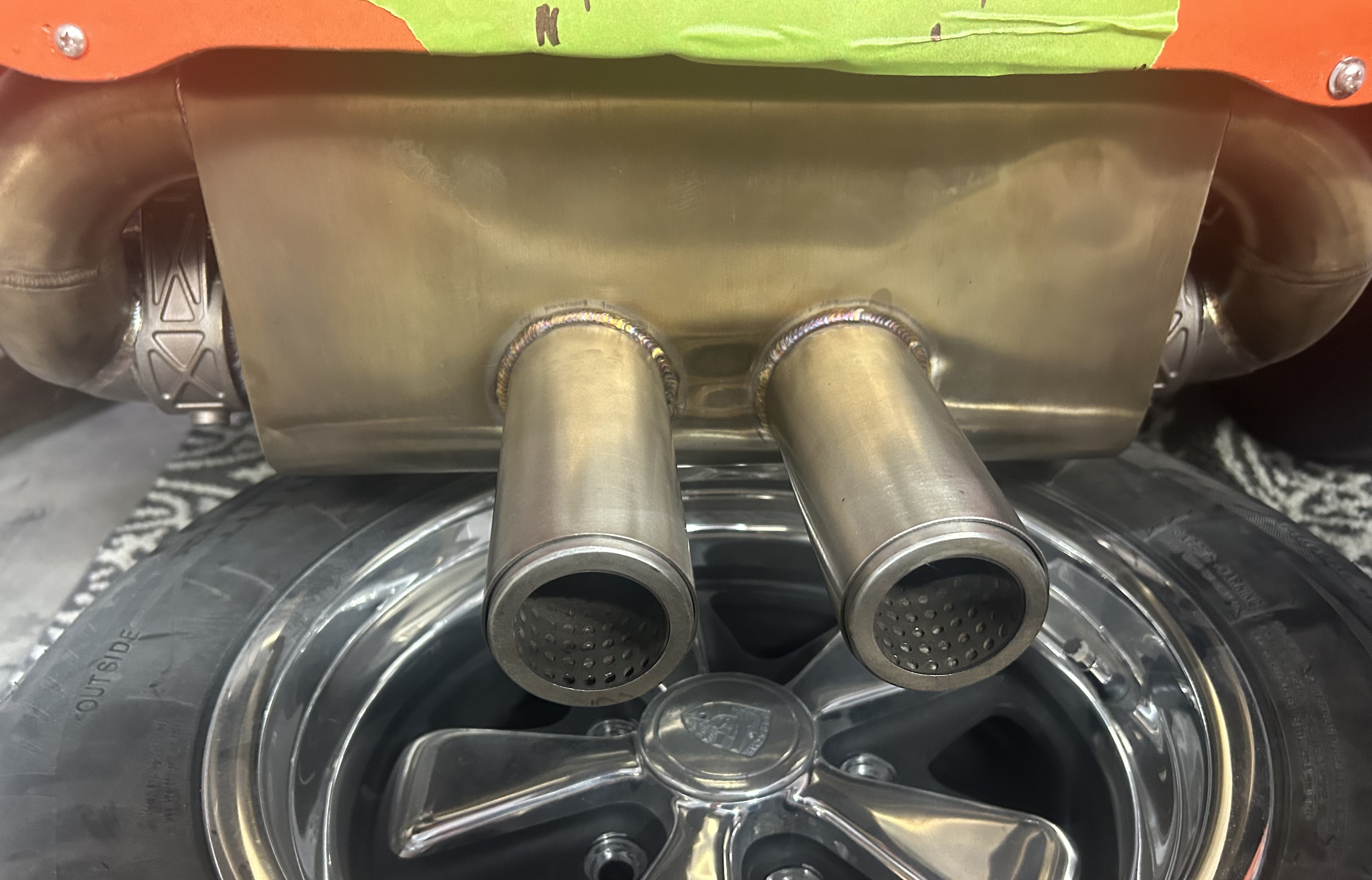

New exhaust very impressed and excited to try it.Attached Image
