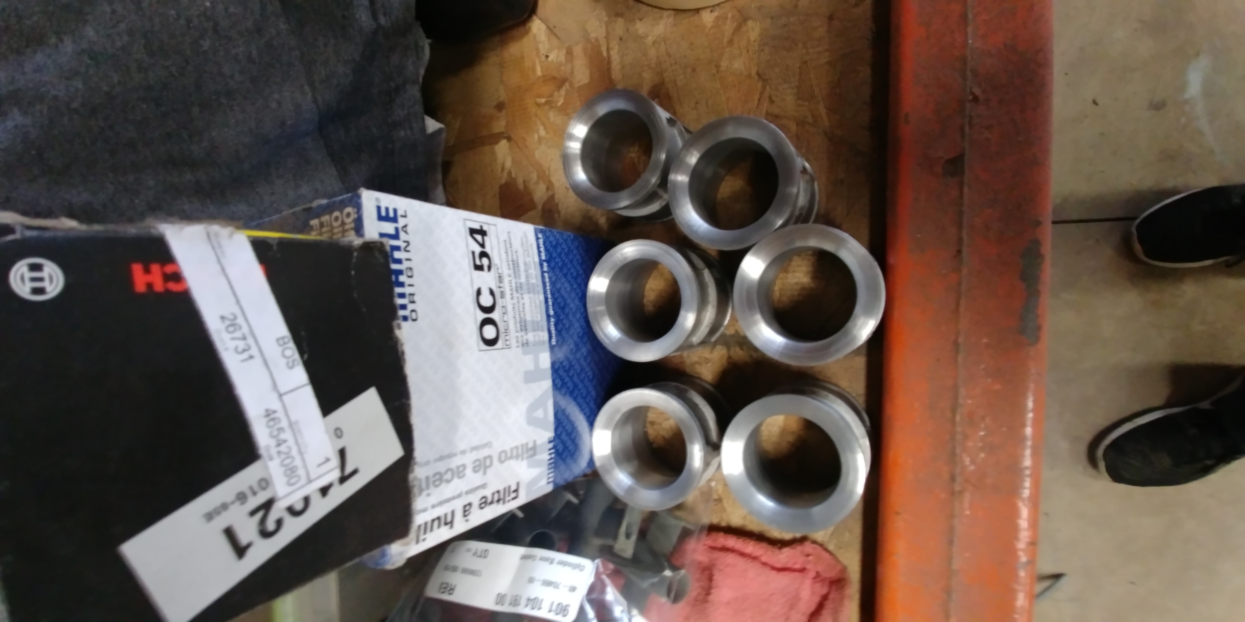

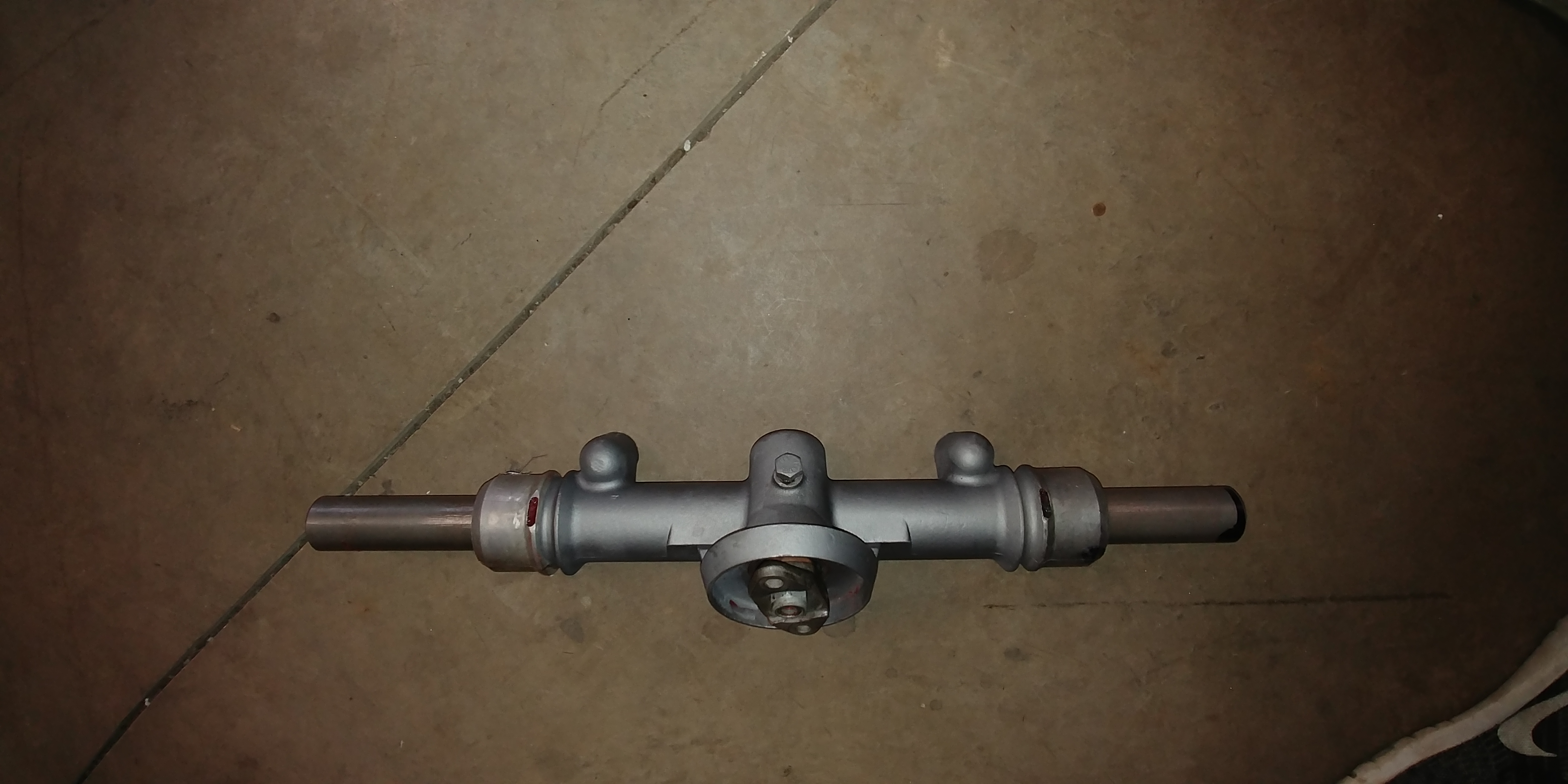

My oldest installed the 914 rubber seat adjuster handles onto the seats today. I machined the venturies yesterday and assembled the steering rack which I am not 100% happy with. Not as smooth as I think it should be .. Might come back apart..Attached Image

What did you do to the steering rack? Did you use replacement parts from a kit?

Followed all the rebuild threads out there. There really isn't much that needs to be rebuilt. There are 2 bearings in there but I didn't replace them as they were smoth. Gonna take it apart again as I don't like it yet.

Order some new bearings for the steering rack as I was not happy.

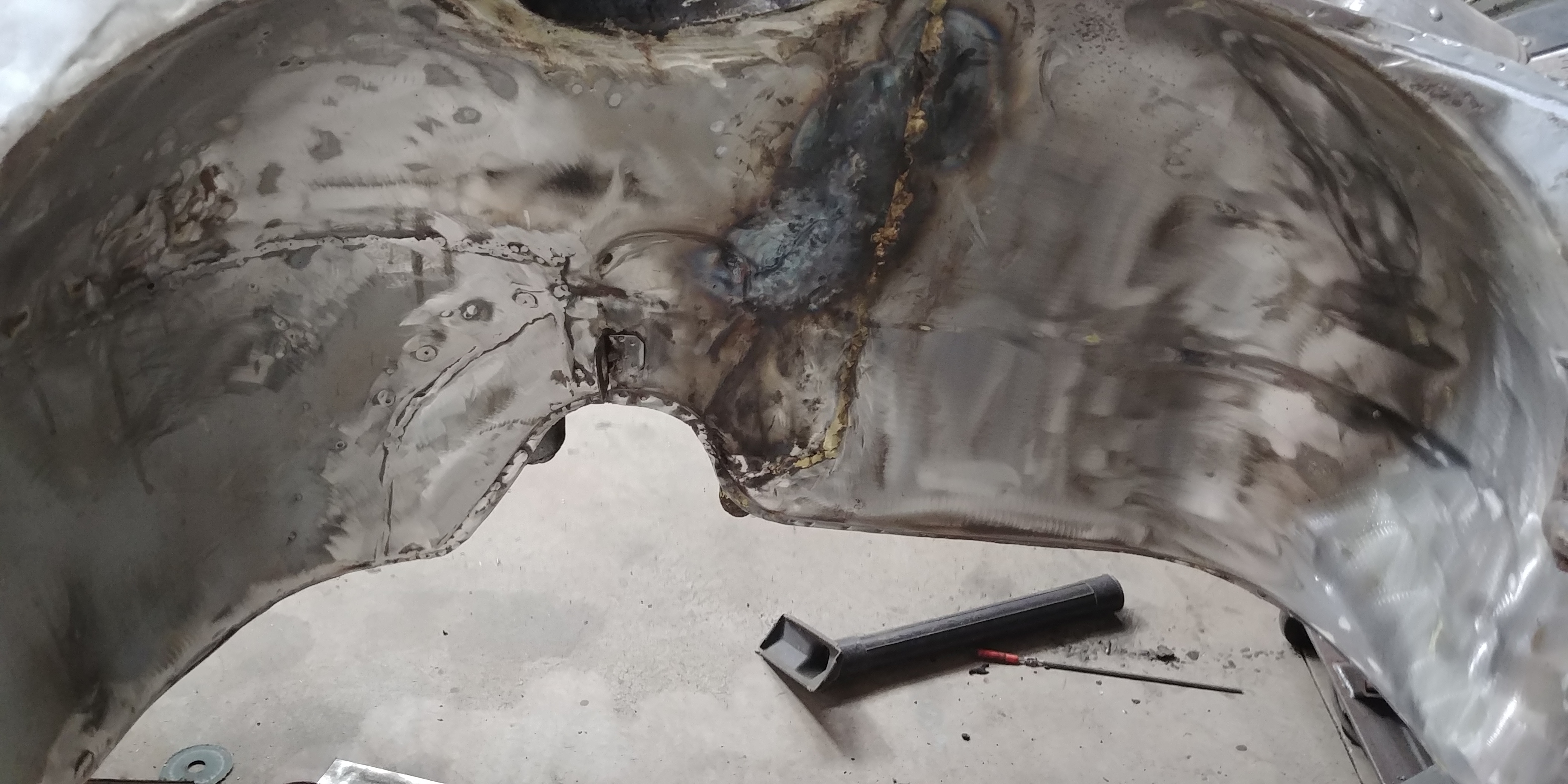

So been picking away on things.. Started reworking a p.o. repair in the front passenger side front wheel well. Made some patch panels. Hammered a bunch out.. Now to deal with the brazed area from that previous repair...

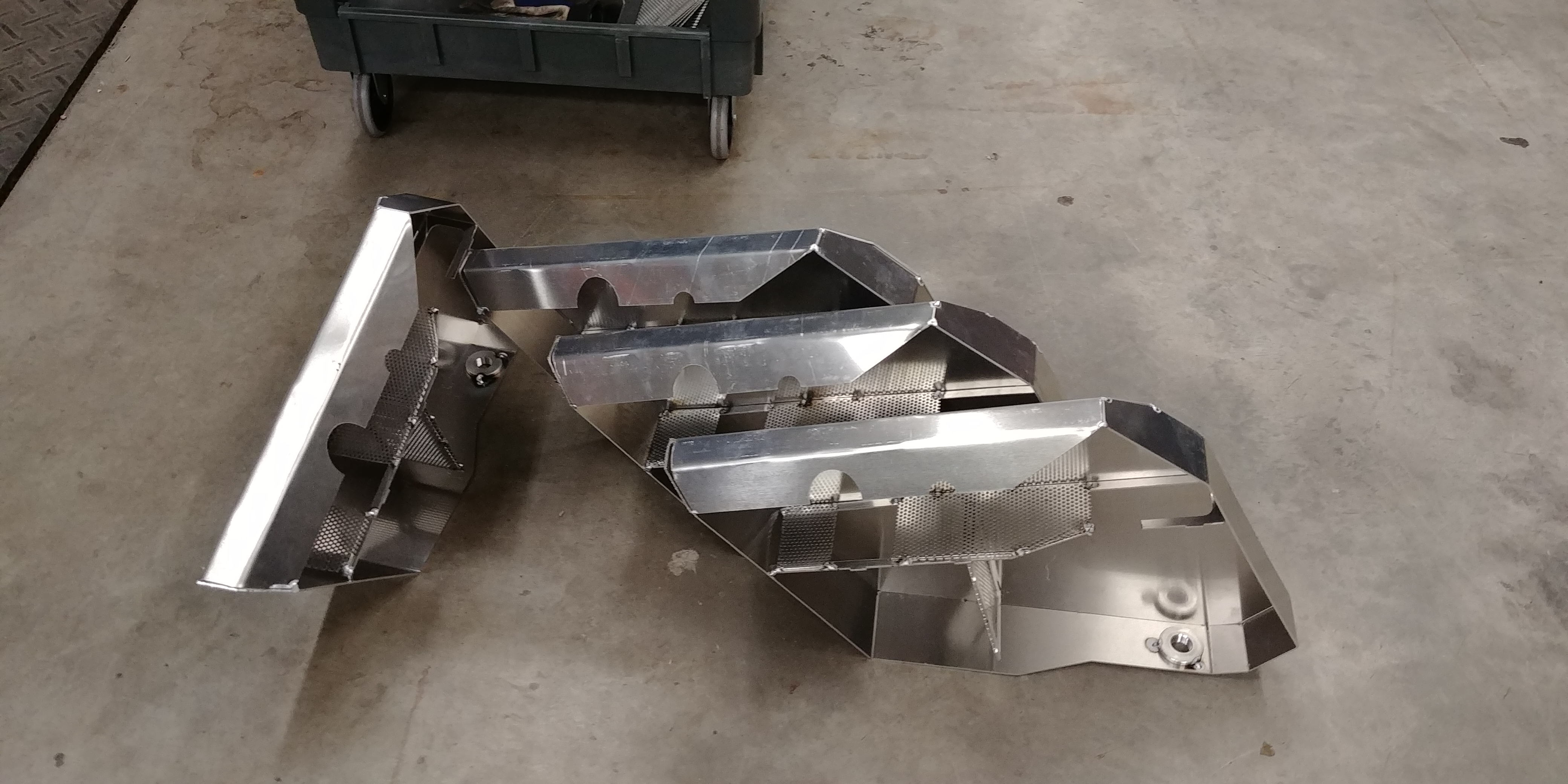

Also a time out to make some tanks.Attached Image

I know this doesn't look pretty yet.. You can see where previous owner repaired bu brazing a new section in.. I tried to make the 2 patches to the left out of 1 piece and to many compound bends.. The patches are blended pretty nice but need a bit more work.. Then hammer and dolly the brazed area.. Thought about cutting that area out and rewelding that but not conviced I can get all the brass out.

What would have been the reason it was brazed instead of welded by the PO?

QUOTE(GeorgeRud @ Dec 22 2017, 08:05 AM) *
My guess is it was a repair in the early 80s and this was still a semi normal repair..

I've got several brazed patches from a PO that I'll be repairing in the near future. Had to have been done in late 70s/early 80s. Your brazes look nice compared with mine. On mine, they just slapped sheet metal over rust holes, brazed them into place, then slathered bondo to hide the lapped edges. Needless to say, they rusted out again.

QUOTE(bbrock @ Dec 22 2017, 09:32 AM) *
So my thought is to use a cut off wheel to cut the brass out and will create a 1/16" square groove and then weld it up.. What do you think?
