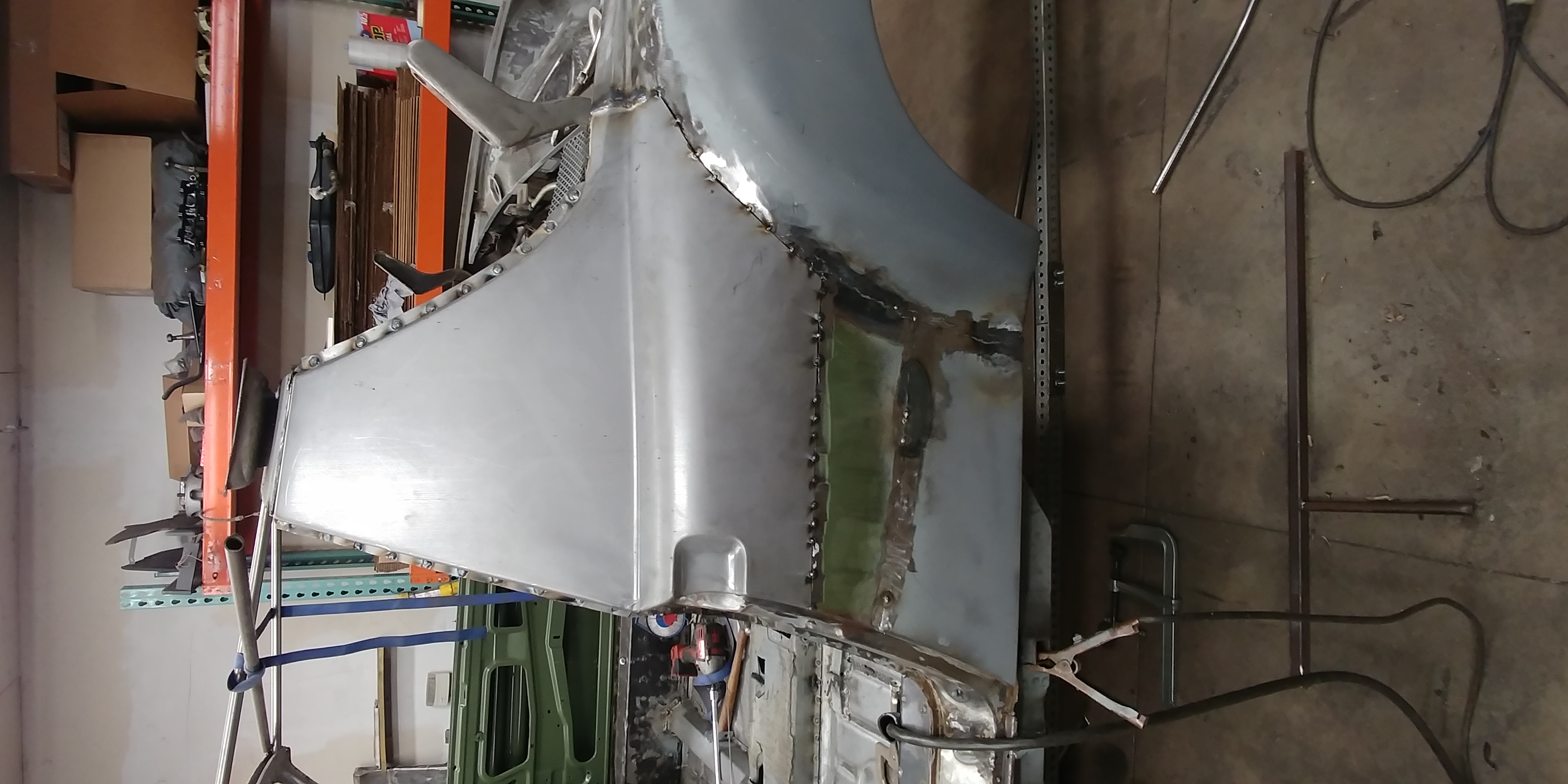

I put the other sail on today. Gotta finish weld but fit was perfect.. Great parts.. Attached Image

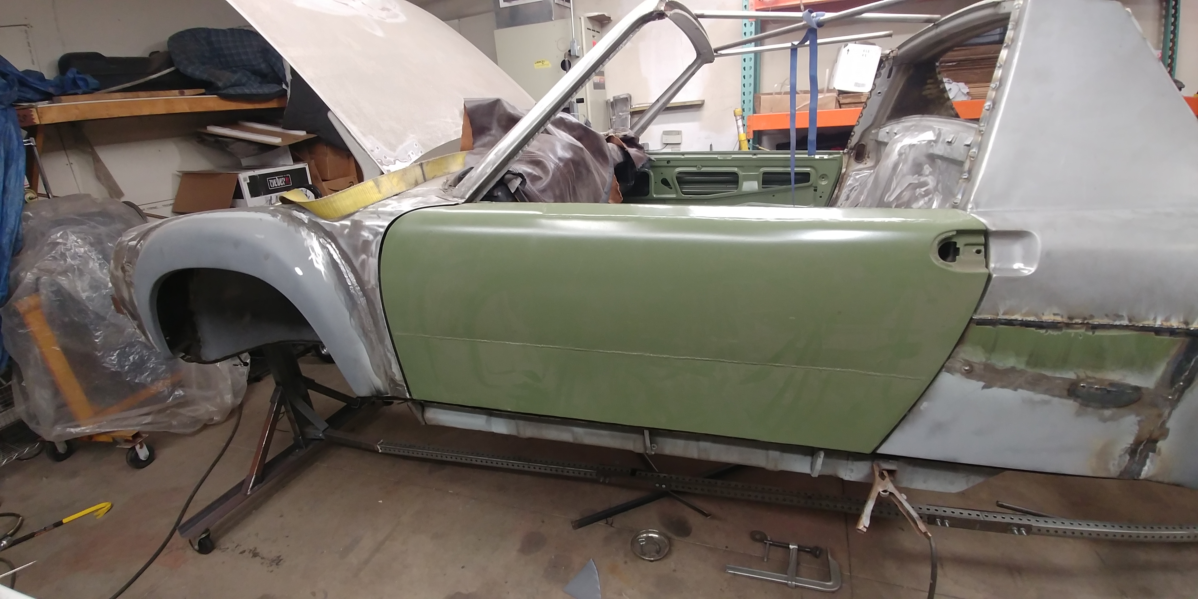

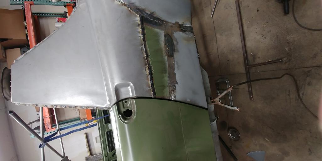

Was able to finish the welding on the sale today.. Now to hammer and dolly then grind flush. Also hung the door quickly. Gaps are pretty good. The front though is a bit far and from memory I remember it big so I need to address that.. Attached Image

It looks like there won’t be much original metal left when you’re done! Should be nice and solid however with good metal everywhere. Keep going!
mb911
post Feb 22 2018, 12:30 PM
Post #388
Posts: 7,544
Joined: 2-January 09
From: Burlington wi
Member No.: 9,892
QUOTE(GeorgeRud @ Feb 22 2018, 07:39 AM) *
That is for sure..

Hey Ben - the angle of that photo makes it look (to me) like the door is "stretched" about 6" longer than stock. I know it is not BTW. (IMG:style_emoticons/default/beerchug.gif)
post Feb 25 2018, 10:38 AM
Post #391
914-6 GT in waiting
Posts: 19,842
Joined: 19-September 09
Member No.: 10,825
QUOTE(Cairo94507 @ Feb 25 2018, 10:58 AM) *
Ben is building the 2+2 version.
mb911
post Feb 25 2018, 02:42 PM
Post #392
Posts: 7,544
From: Burlington wi
Member No.: 9,892
QUOTE(Cairo94507 @ Feb 25 2018, 07:58 AM) *
Lol.. Funny isn't it..
Yes 2+2

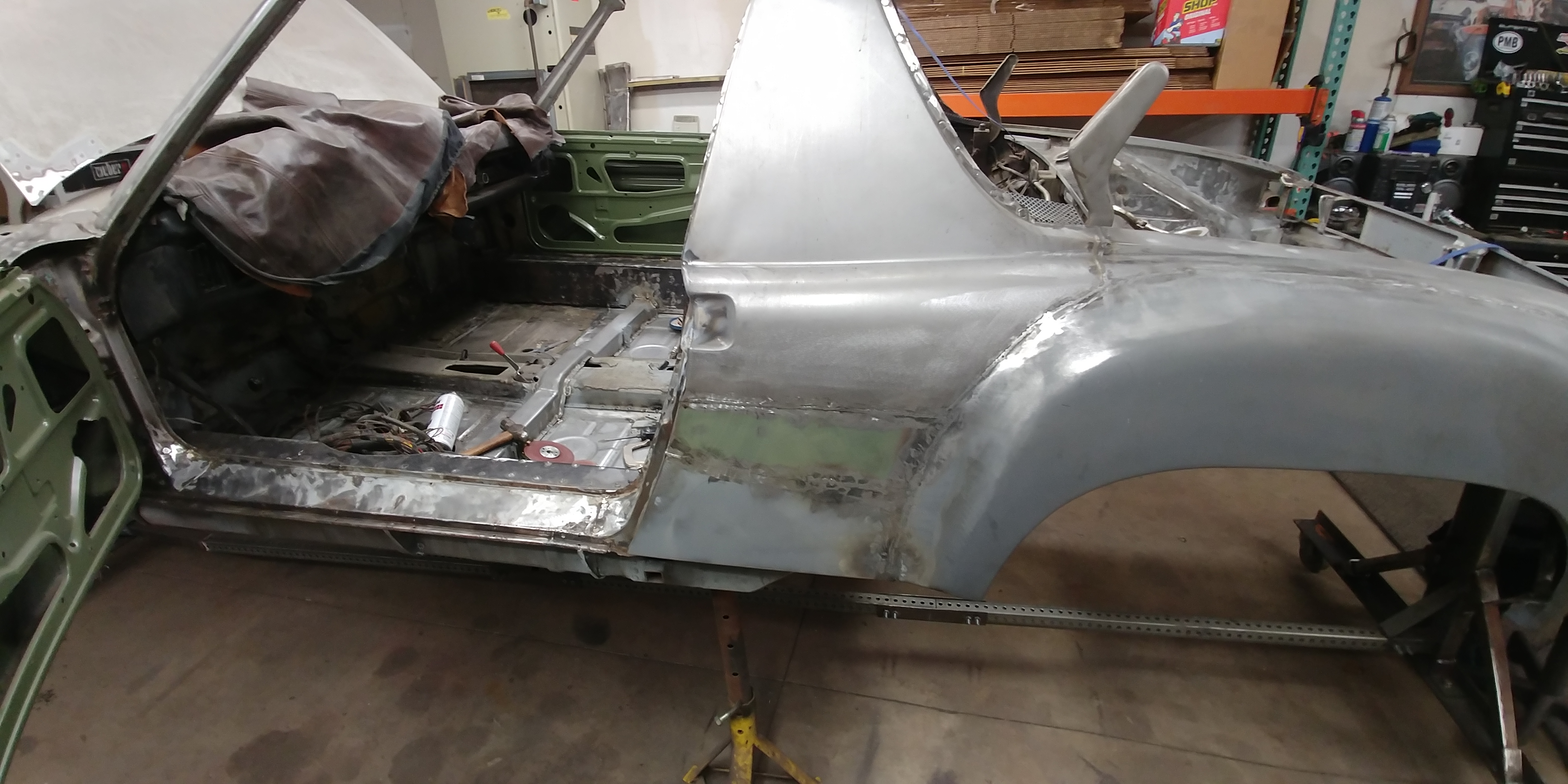

This morning finished removing all of the braces and ground/blended/sanded. Still need to do more but if you see how I operate I try to do it in stages as to take my time.. I will next hammer straight the weld areas so I can further blendAttached Image

Can you talk more about hammering the welds? I know this is standard practice, but just guessing as to why. Sinking the metal down so that not as much needs to be ground off to make it flush?
mb911
post Feb 27 2018, 08:58 AM
Post #399
Posts: 7,544
From: Burlington wi
Member No.: 9,892
QUOTE(mbseto @ Feb 27 2018, 06:03 AM) *
Basically what you are doing is stress relieving the heat affected zone allowing the parent material to be shaped as it should be then grind the high spots of the weld so a good blend can happen.. My concern always with a blend is that the parent material can get really thin very easily and possibly crack later this is why I typically don't go flush and will use a small amount of filler..
