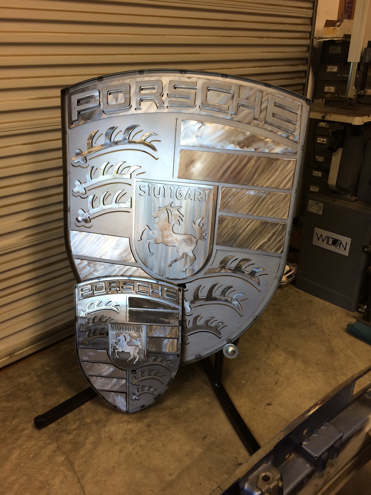

Lol no.. Now I have to clean and tack weld all the pieces in place. Then paint it not sure with what yet.

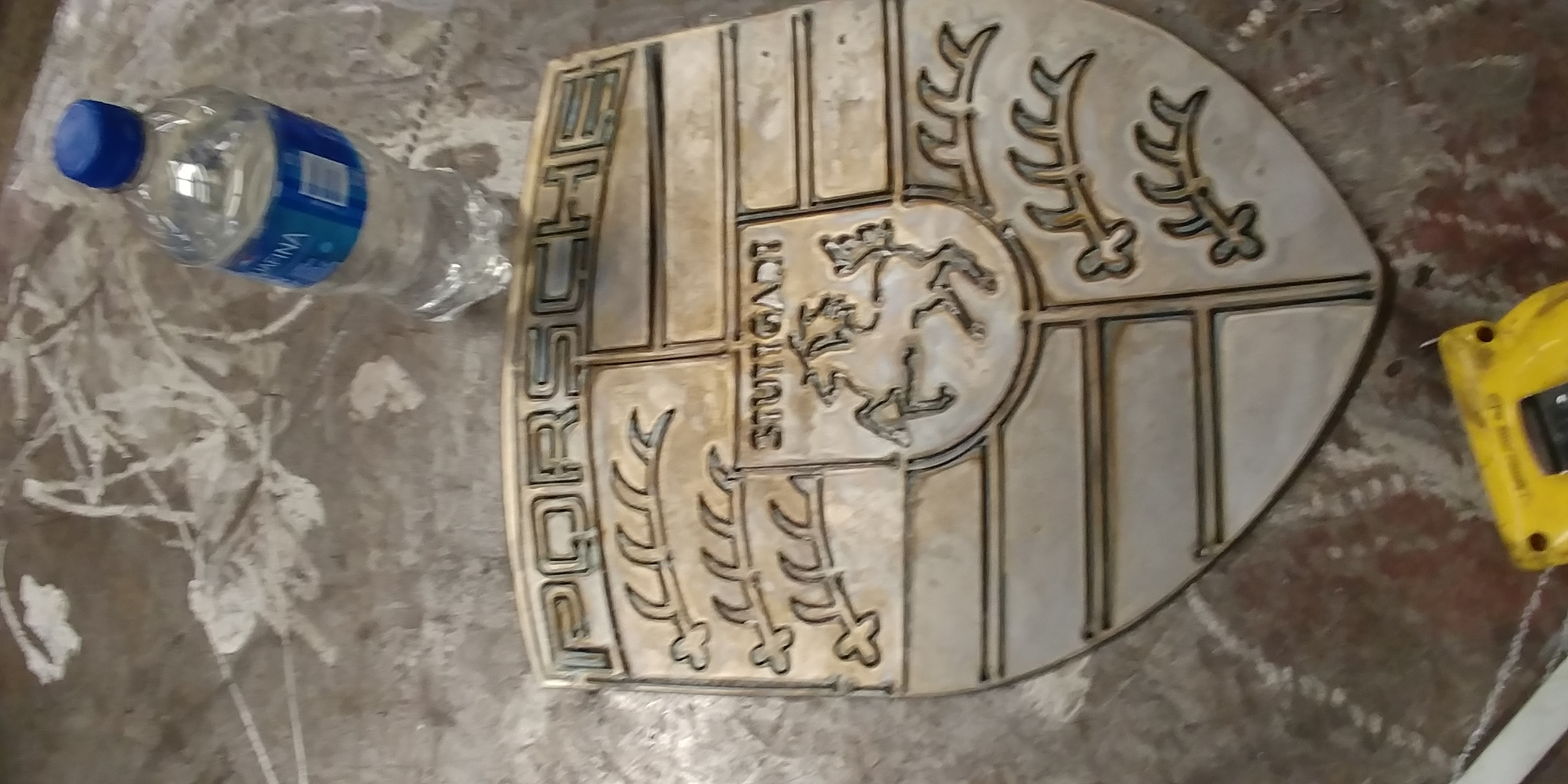

Ben - don't mean to hijack but what are the dimensions of yours? I did a couple of 4 footers and a "little" 2 footer.
I'd be interested in what you tweaked on the file, too. I see you eliminated the "shadow" lines under the spars. Did you make other changes?
I know I found some opportunities to improve some of the shapes but haven't been back to working on the art stuff for a while.
mb911
post Mar 27 2018, 04:15 PM
Post #443
Posts: 7,544
Joined: 2-January 09
From: Burlington wi
Member No.: 9,892
Some of the lead ins and lead outs got changed, scaled it down to 16 inches .. Its very cool.. Its a great way to high light our welding program at school as we just integrated some new fab equipment this gets the students really excited..

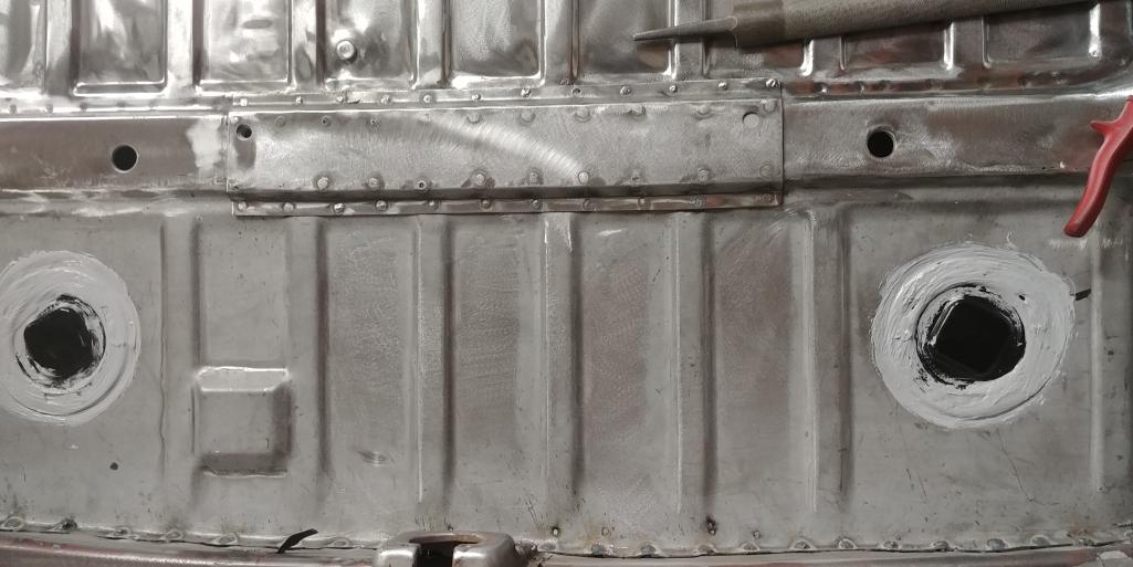

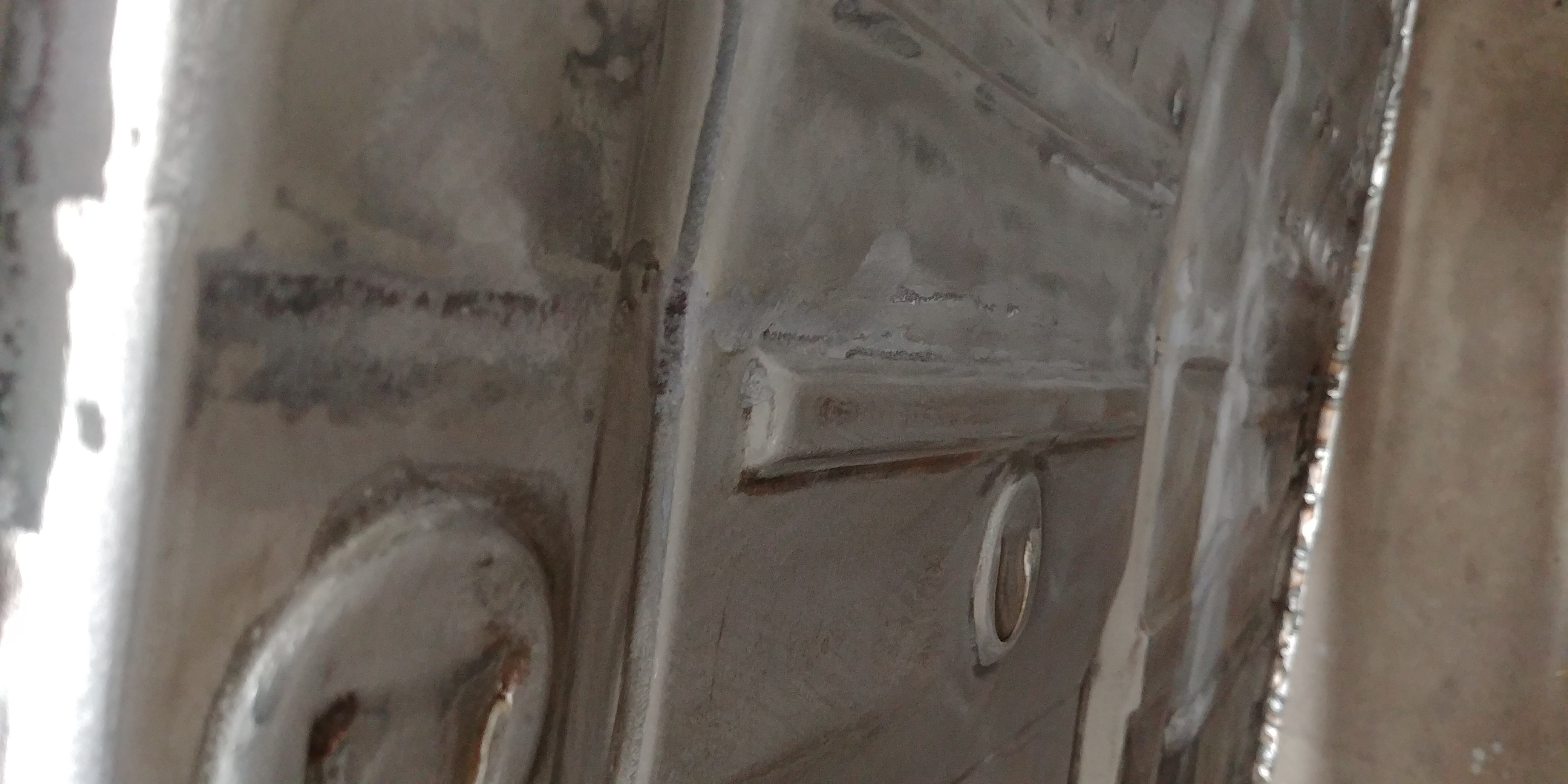

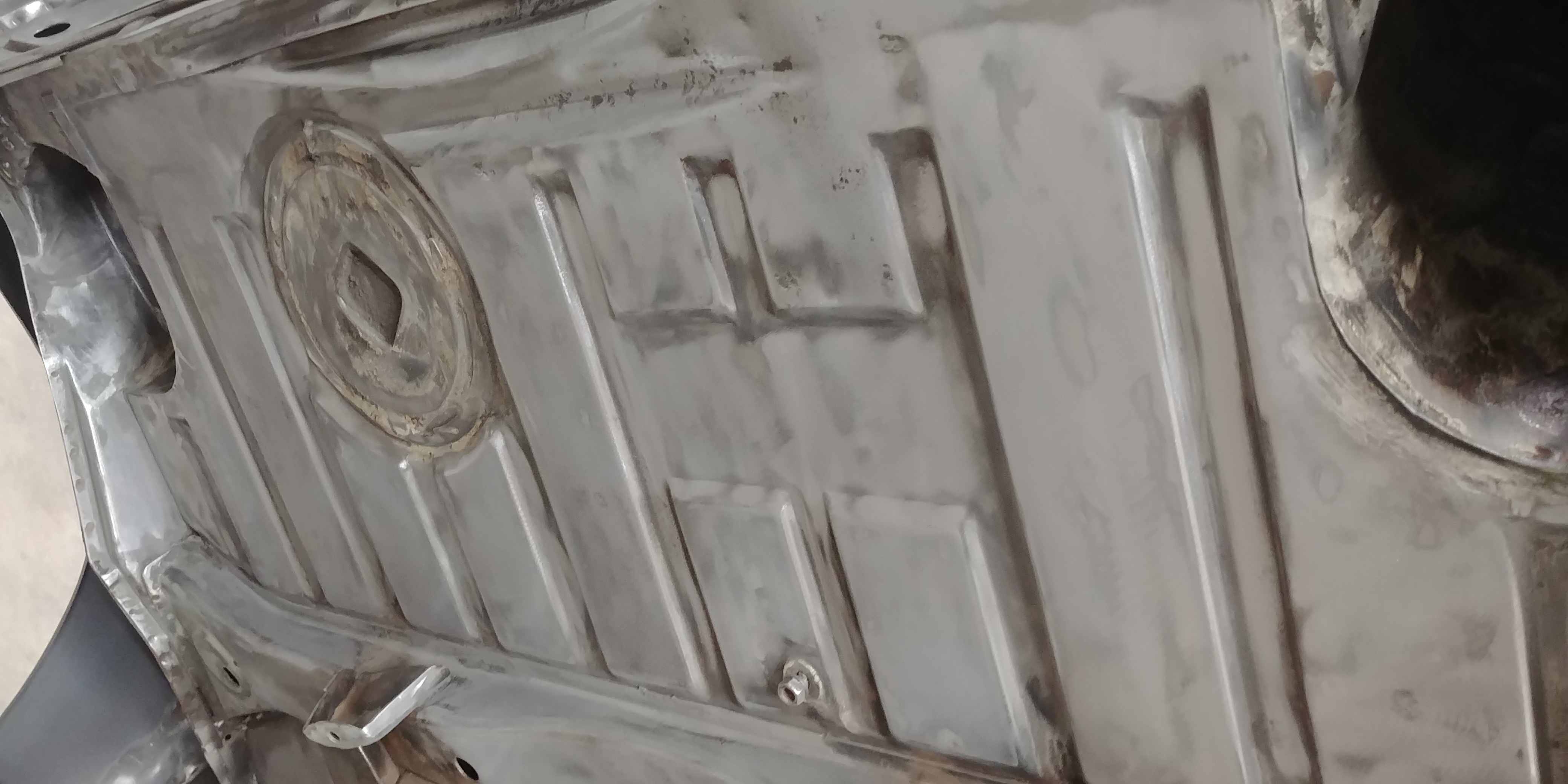

Sanded 3/4 of the pan and trunk is almost done. Just have to rotate the car the other way to sand and grind the other side.. I know I keep saying primer soon and it is but prep takes along time.Attached Image

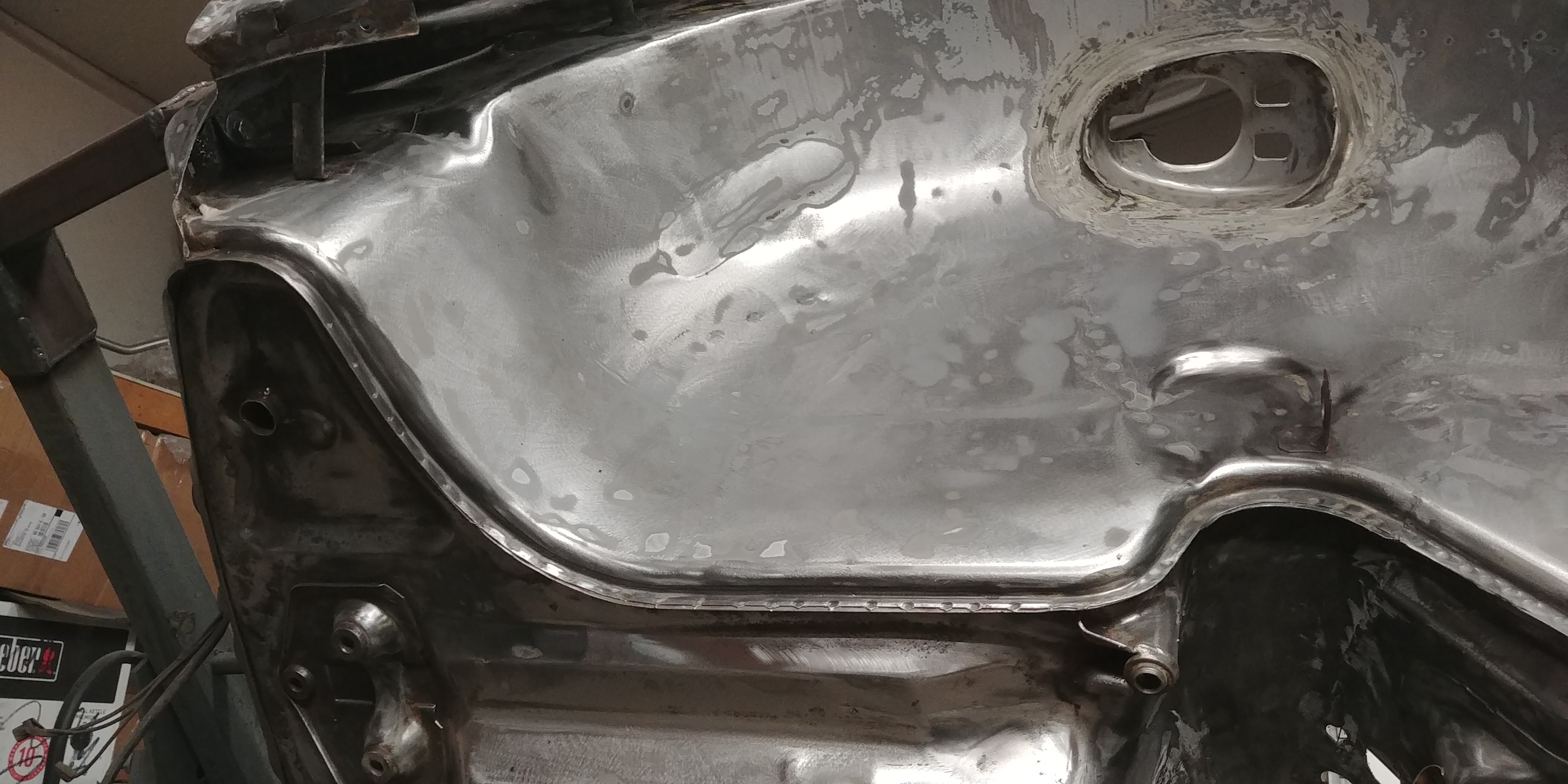

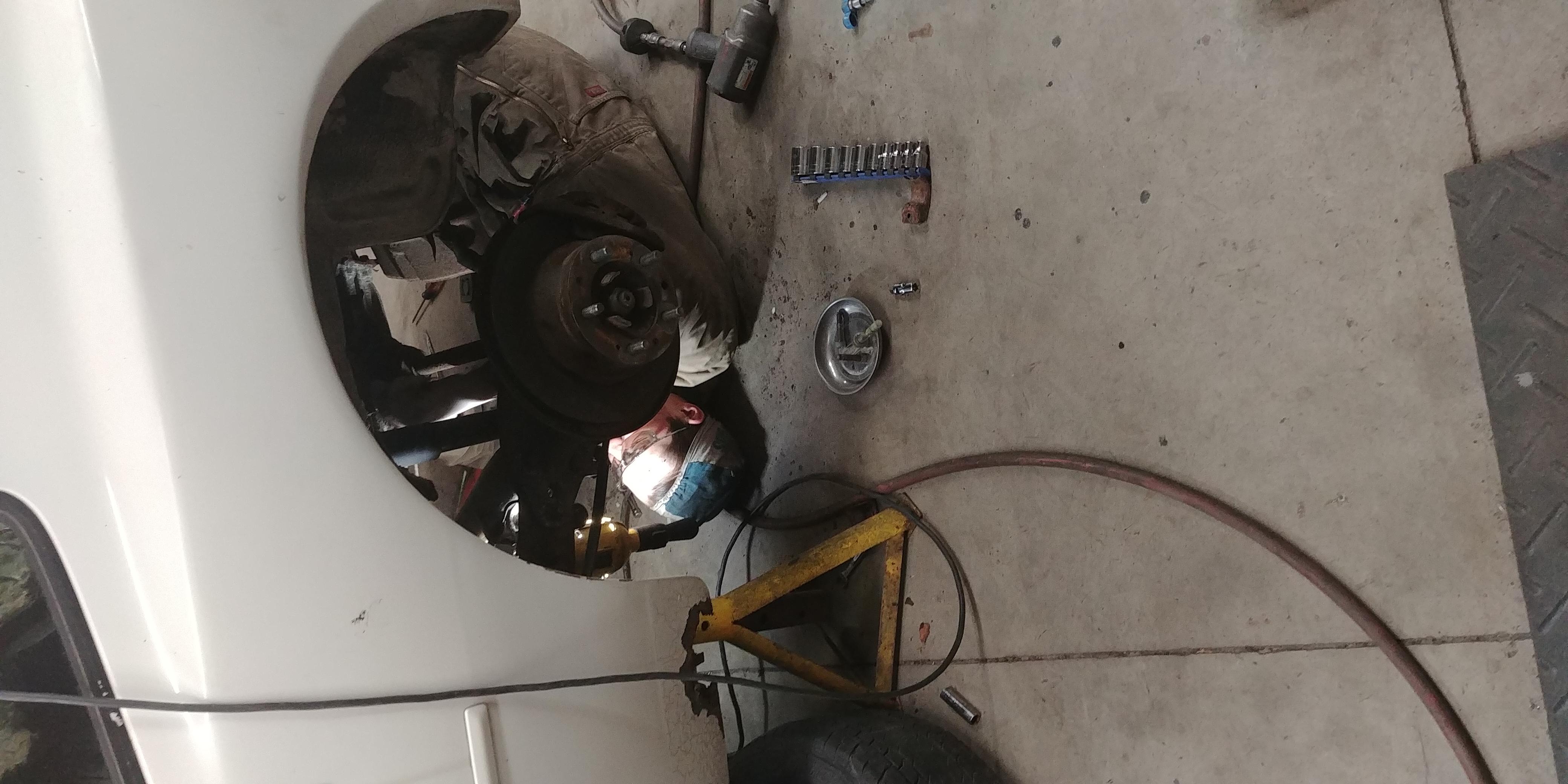

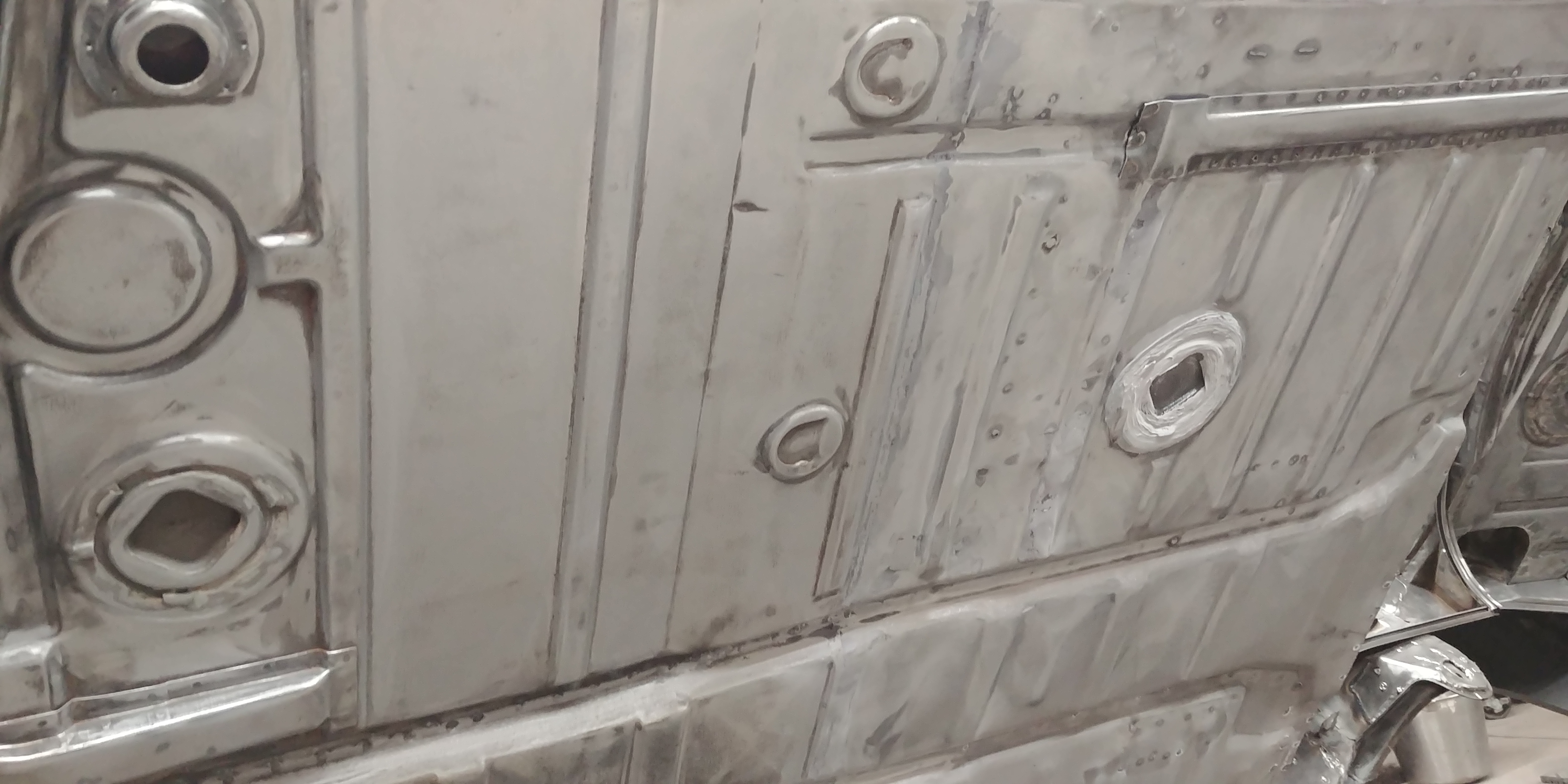

Spent a few minutes today drilling and fitting the plugs in the floor pan while my son was dropping the trans in the 944 for a fuel tank removal under my guidence. He says I am more of Ant and he Mike from wheeler dealer .. I laughed.Attached Image

Spent 2 hours last night grinding and blending and removing old paint from wheel wells , and above where the rack is located. Installed 3 more of the plugs into the floor pans. I am missing 1 and need to find that one some where in my stash.
My son and I pulled the trans and gas tank on the 944 Saturday. Those cars are much easier to work on then I expected..
Sorry no primer yet but its coming. Removing all the "overburden" is always more time consuming then you expect.

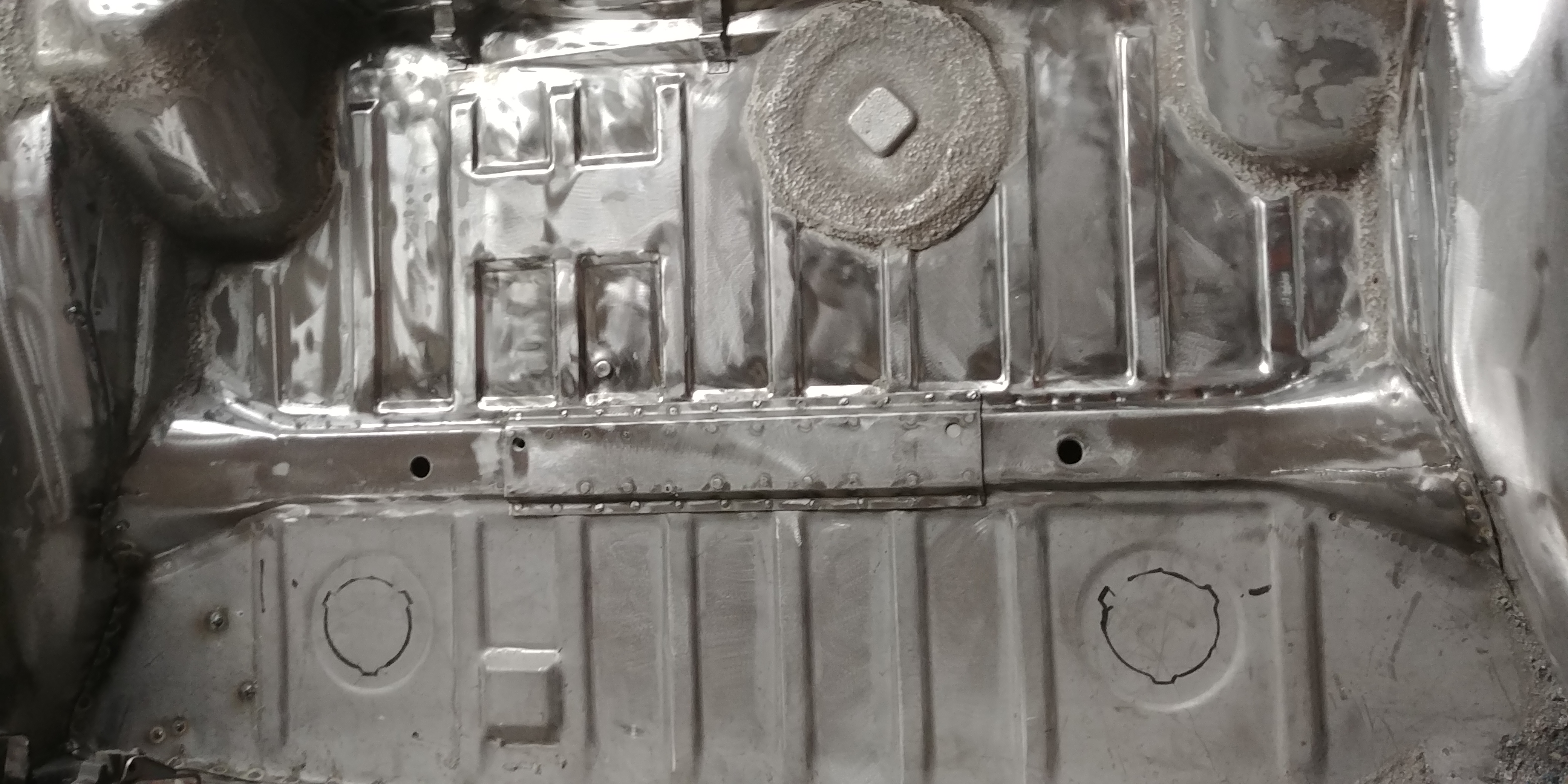

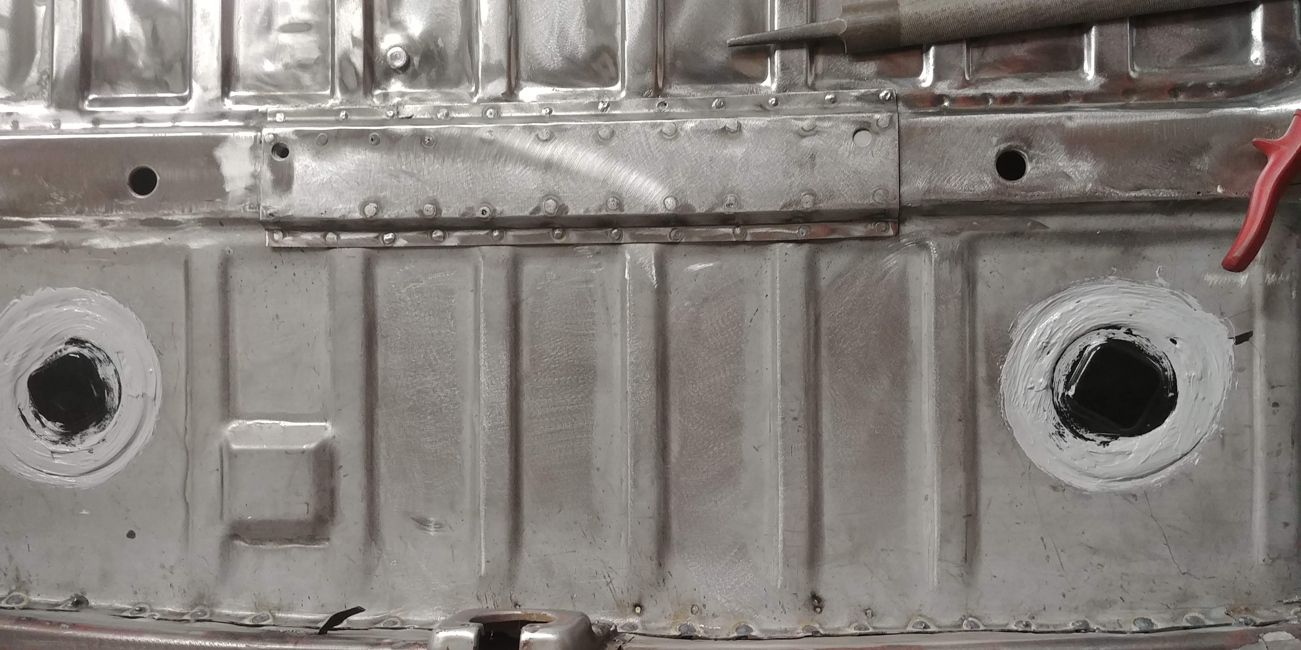

Well cleaned/sanded/ ground more on the entire driver side of the floor this week and its ready for primer. Next week return to the passenger side and finish that side of the floor up.Attached Image
