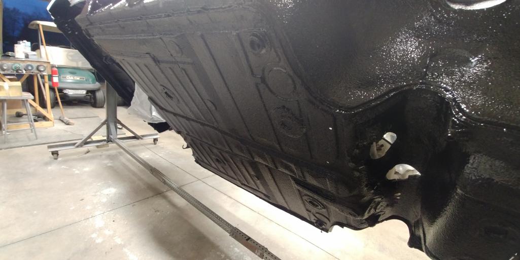

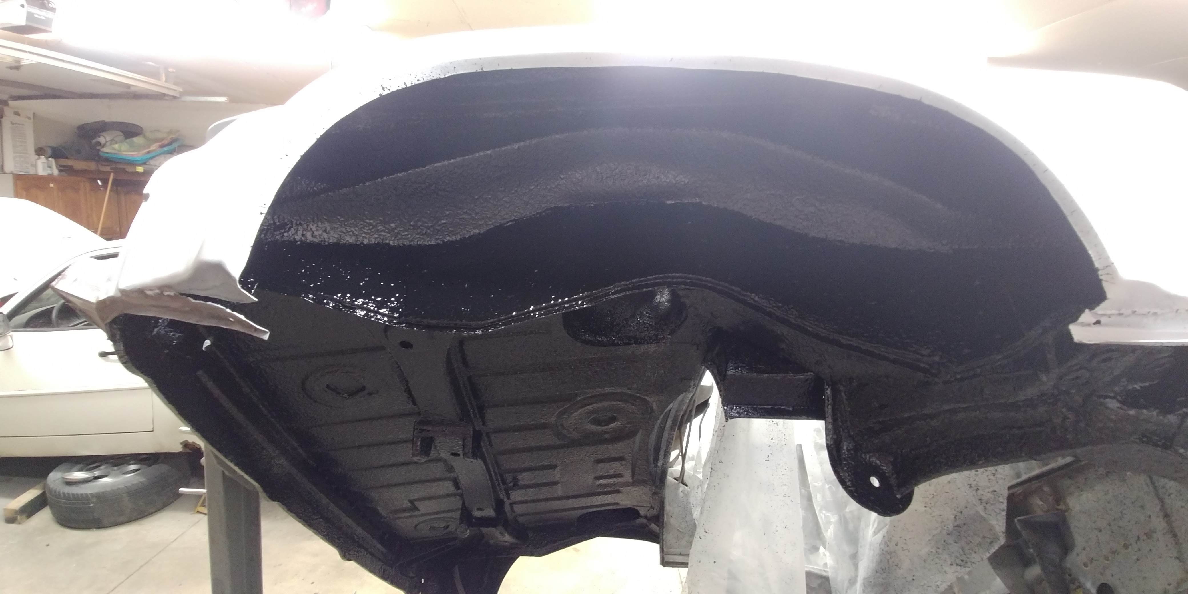

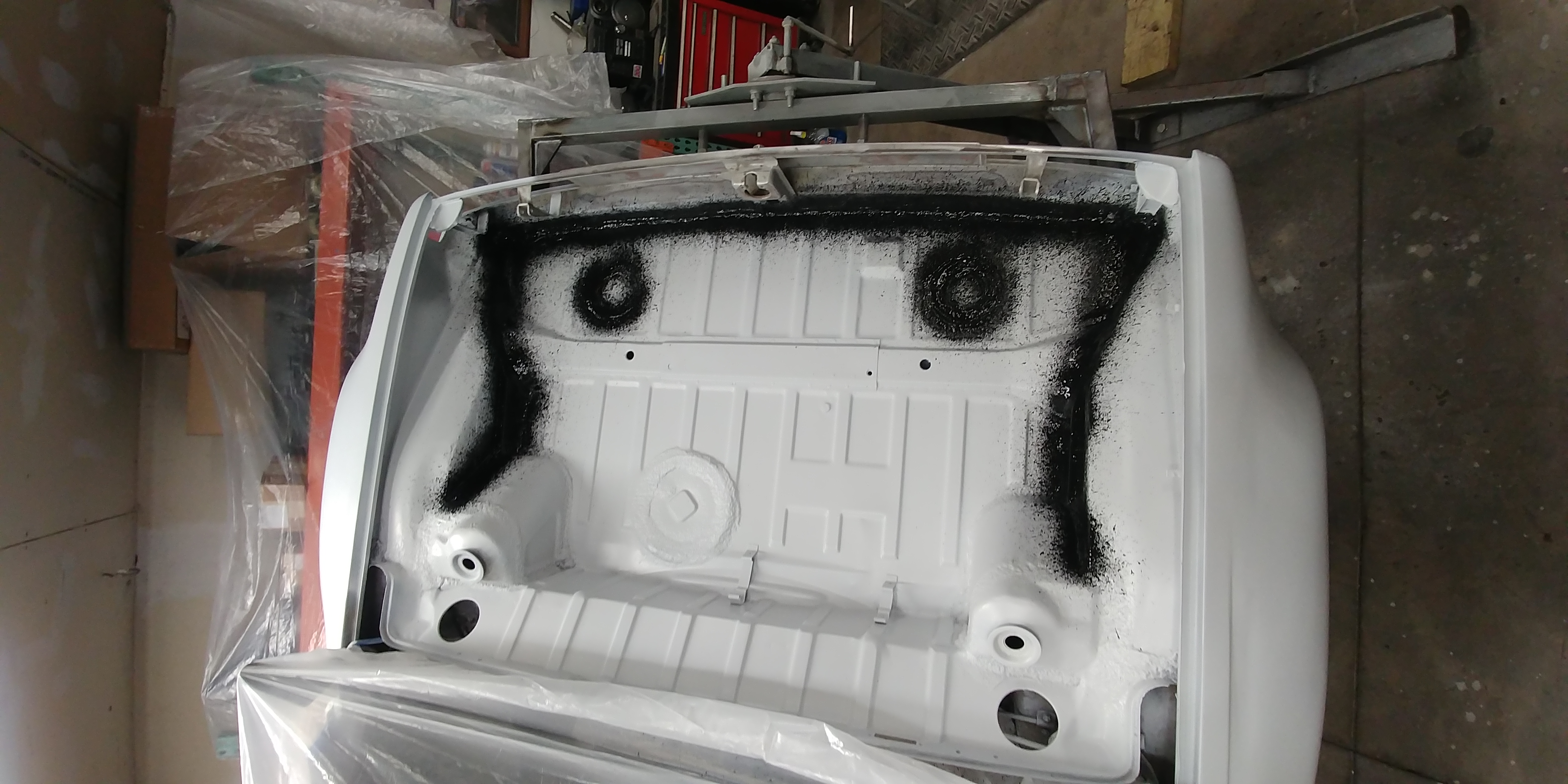

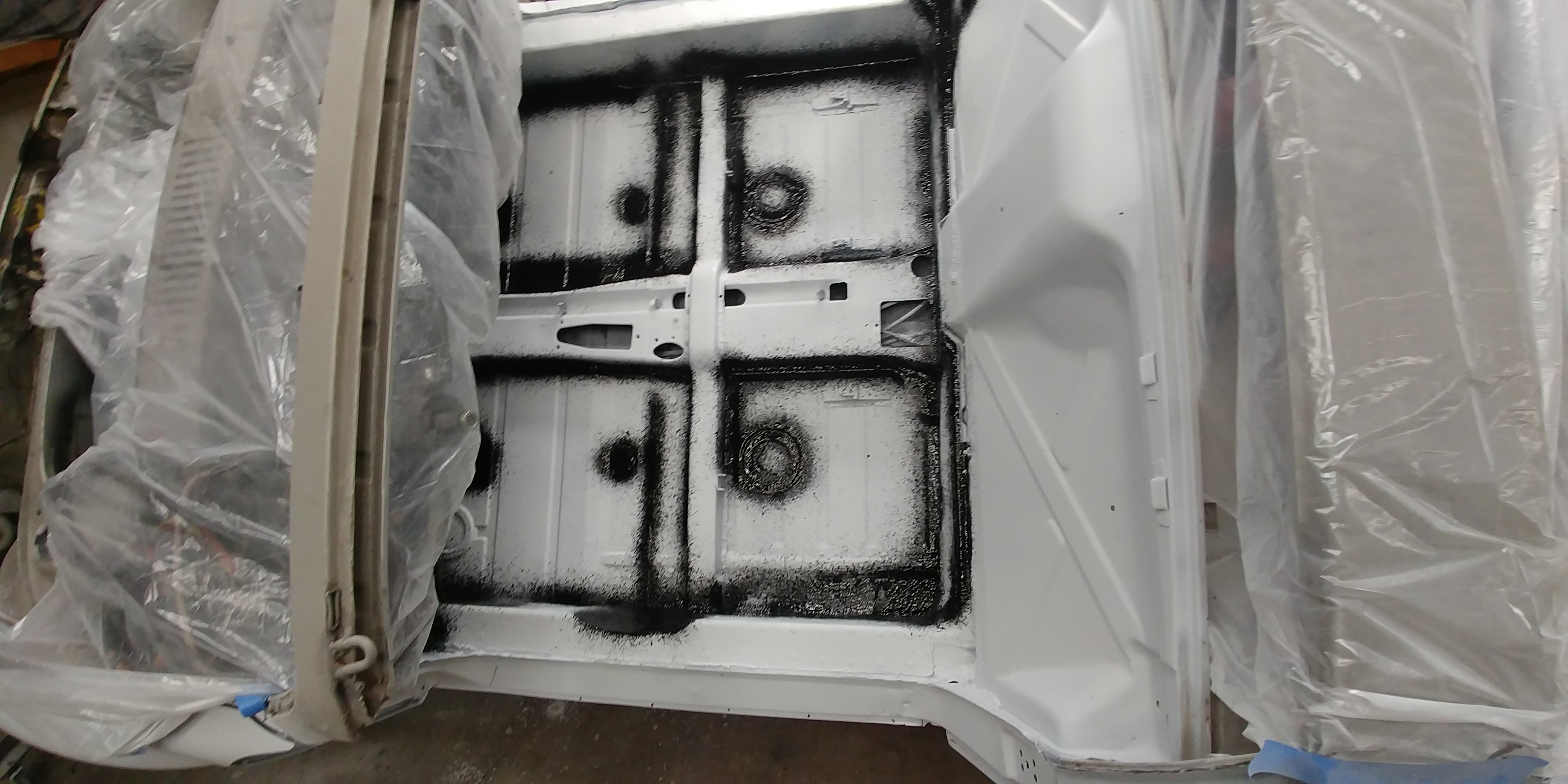

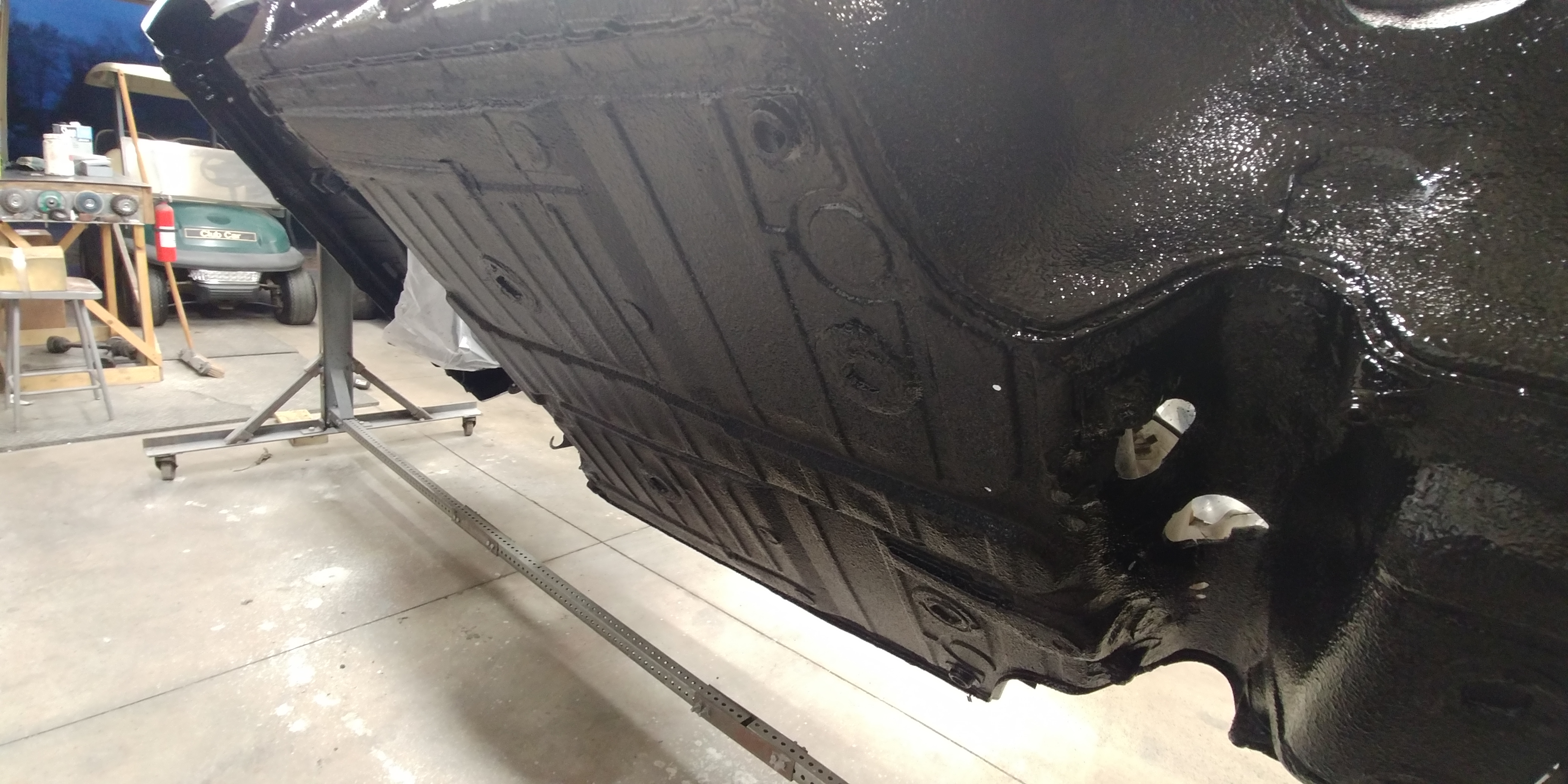

Sprayed bed liner today super easy .. Went after all the seams and repair areas 1st then a second coat on everything and then ran out.. Gotta order more.. Ugh..
Turned out way better in person... Very happy with it.. Attached Image

Wow! That has to feel good. (IMG:style_emoticons/default/piratenanner.gif)
I'm assuming that is bedliner you are spraying as seam sealer. How are you liking that?

QUOTE(bbrock @ May 6 2018, 07:59 PM) *
Yes.. I did put down the seam sealer from sem 1st let it cure in the regular spots then went and sprayed this over..
This stuff is stinky so it really is a summer doors open type of product..

Thanks guys.. Still gotta wait on the quart I ordered to finish it..
This stuff still smells bad.. Wow..worse then paint IMHO.

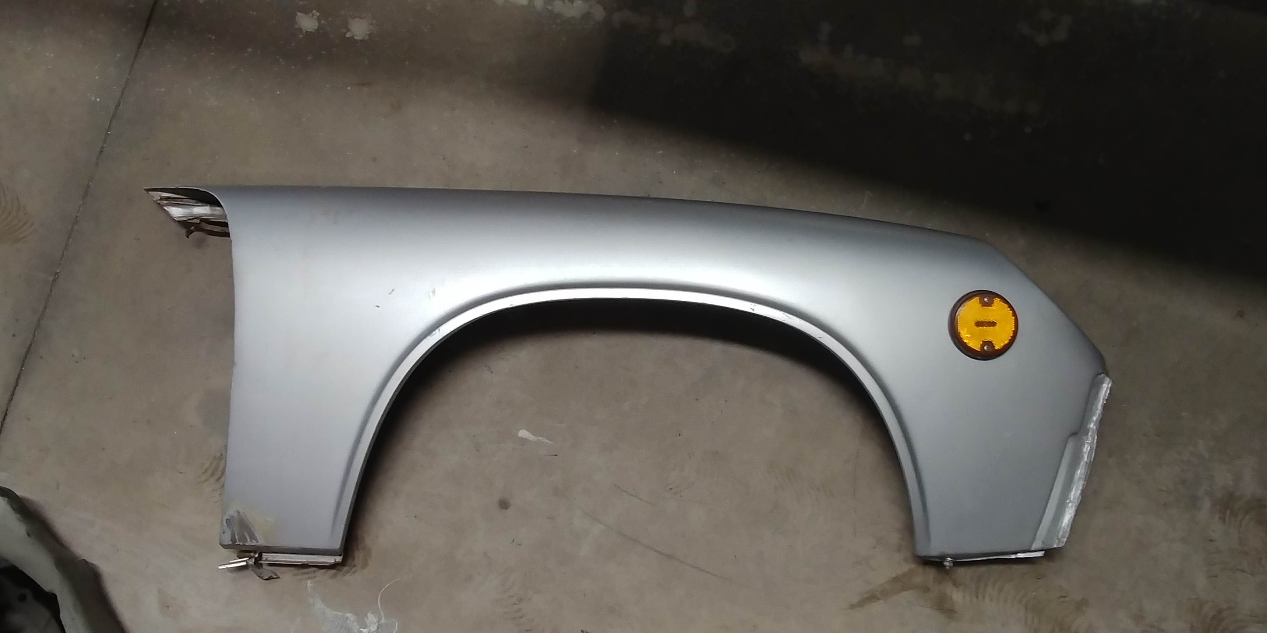

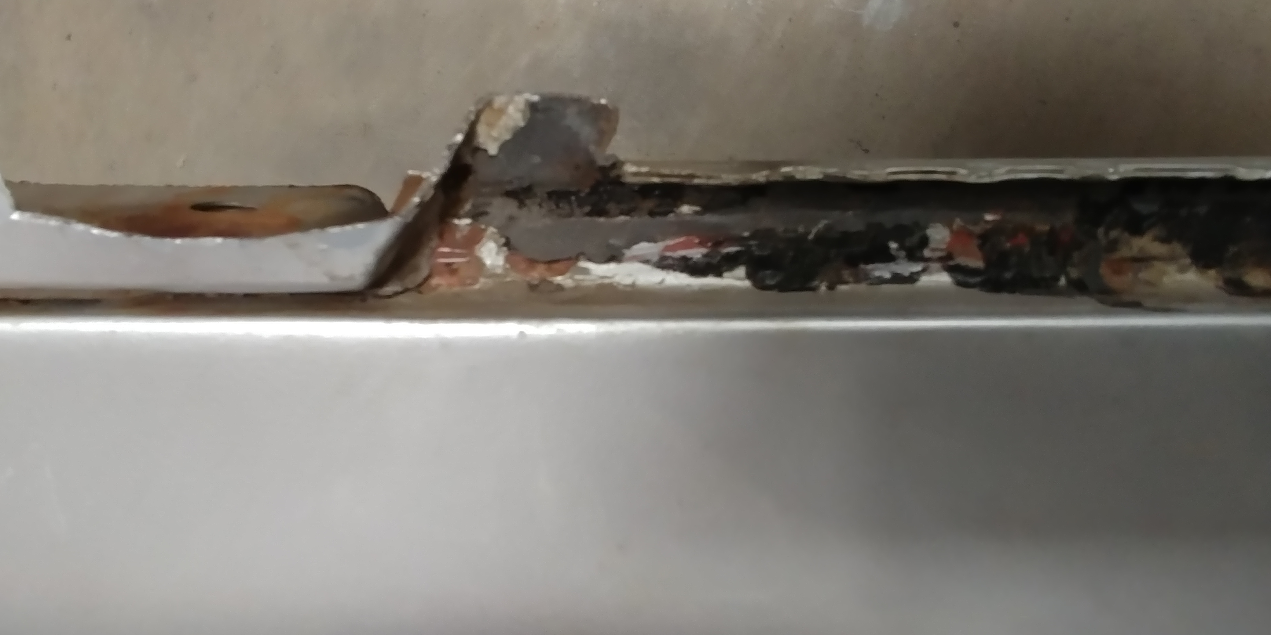

Spent the morning driving down to meet Glenn to look at his collection and to pick a previously NOS replacement right front fender that he and Garold cut off a car for me.. Thanks so much guys..
The best part it I dont think I need to bare metal this fender.. Attached Image Attached Image
Notice the red primer.. Its not rust..

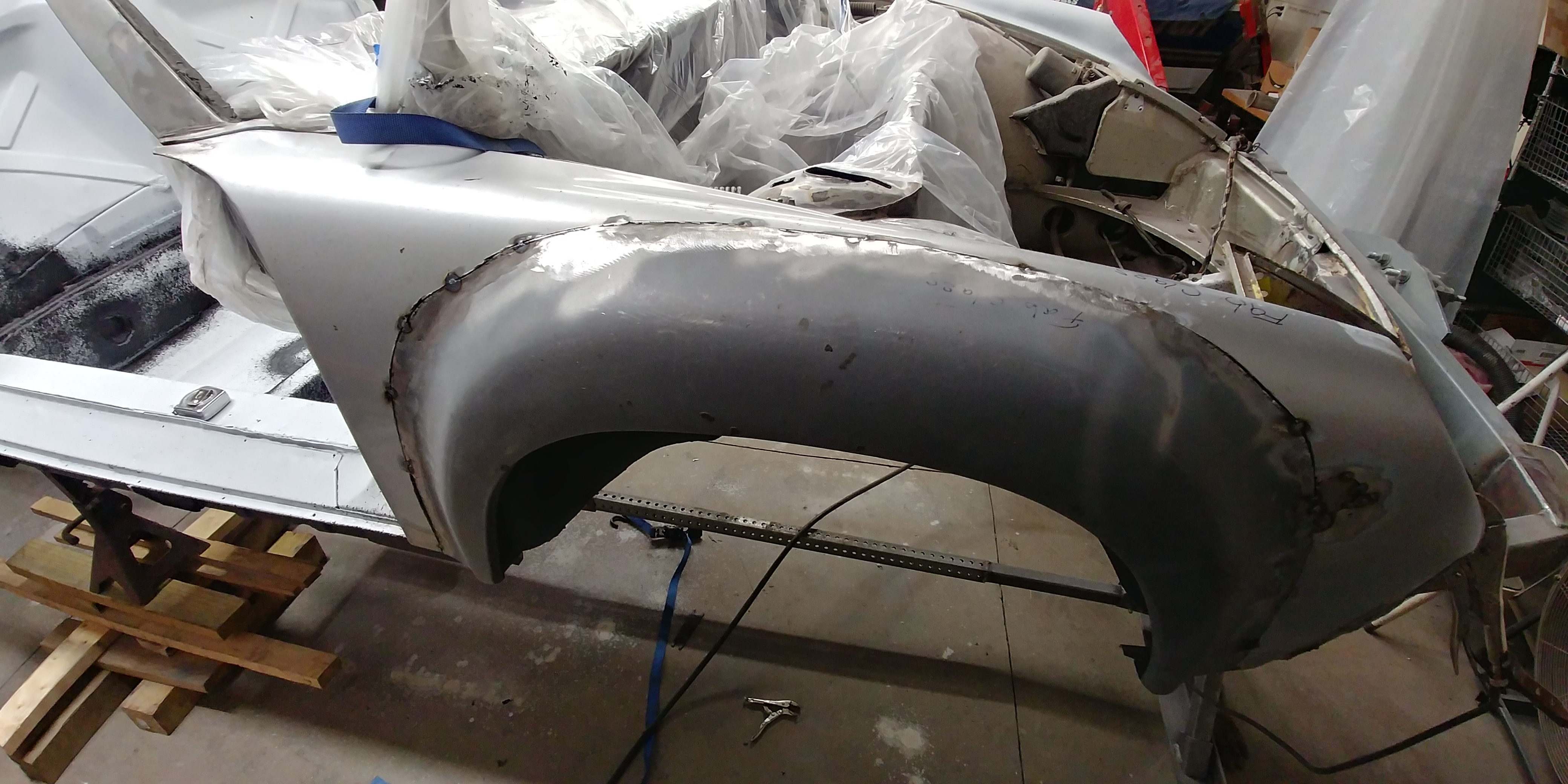

Front fender tacked on .. Door was installed for fitting.. Getting closer to ready for suspension install.. Attached Image

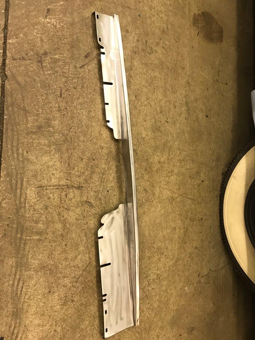

I TIG welded the flare on this morning.. My opinion vs MIG is that the weld bead is just smaller so easier to shape etc. If you look back several pages you will see my son MIG welding and that was the point.

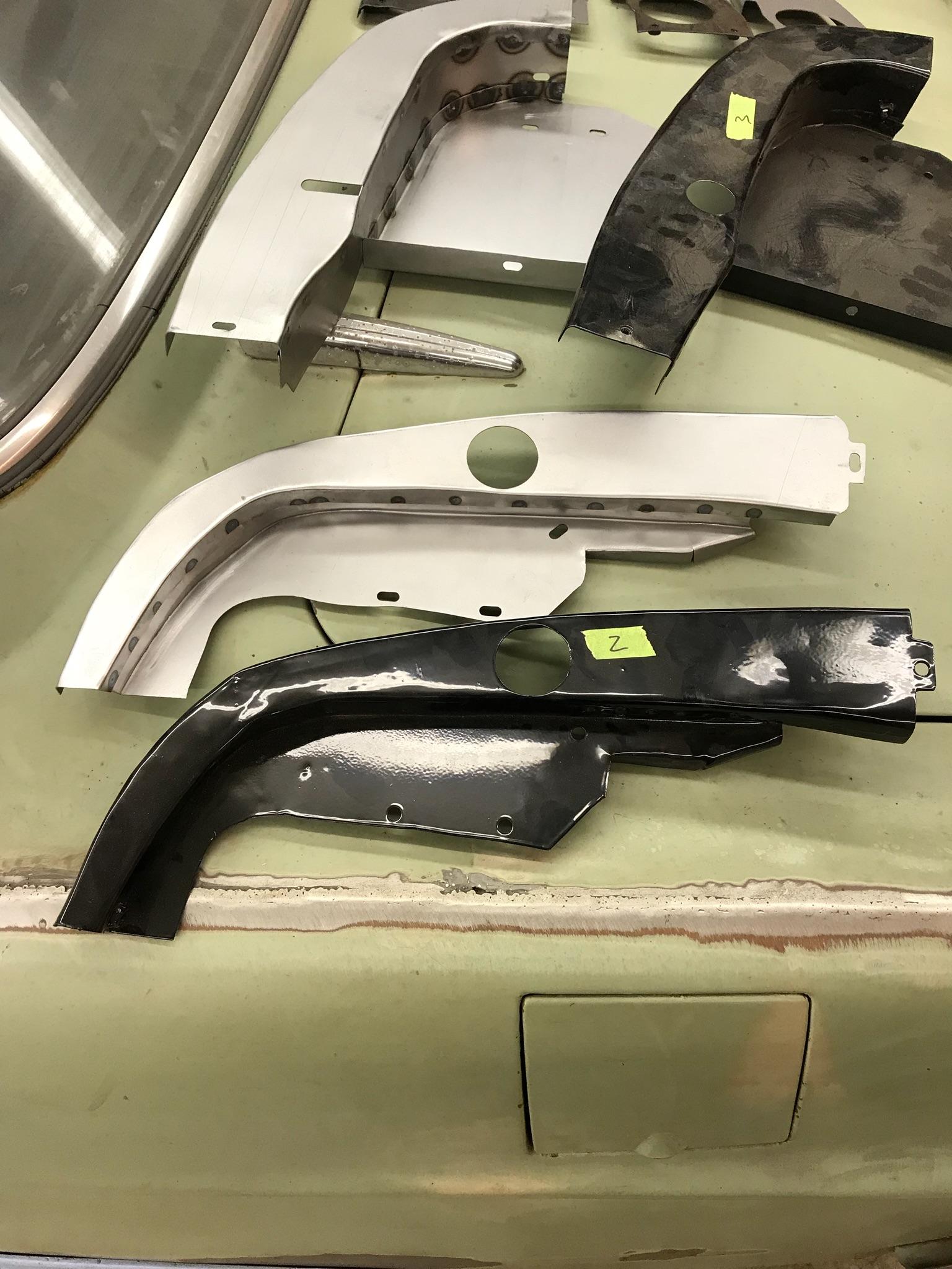

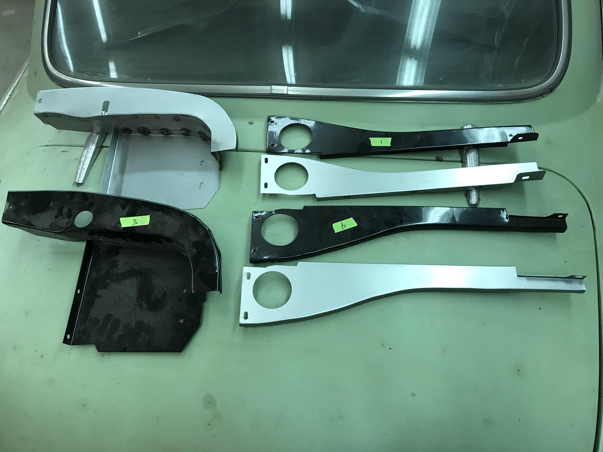

Then we worked on engine sheet metal samples..Attached Image Attached ImageAttached Image
mb911

Front fender is completely ground, and now a thin coat of filler.. Seam sealed. Making head way..

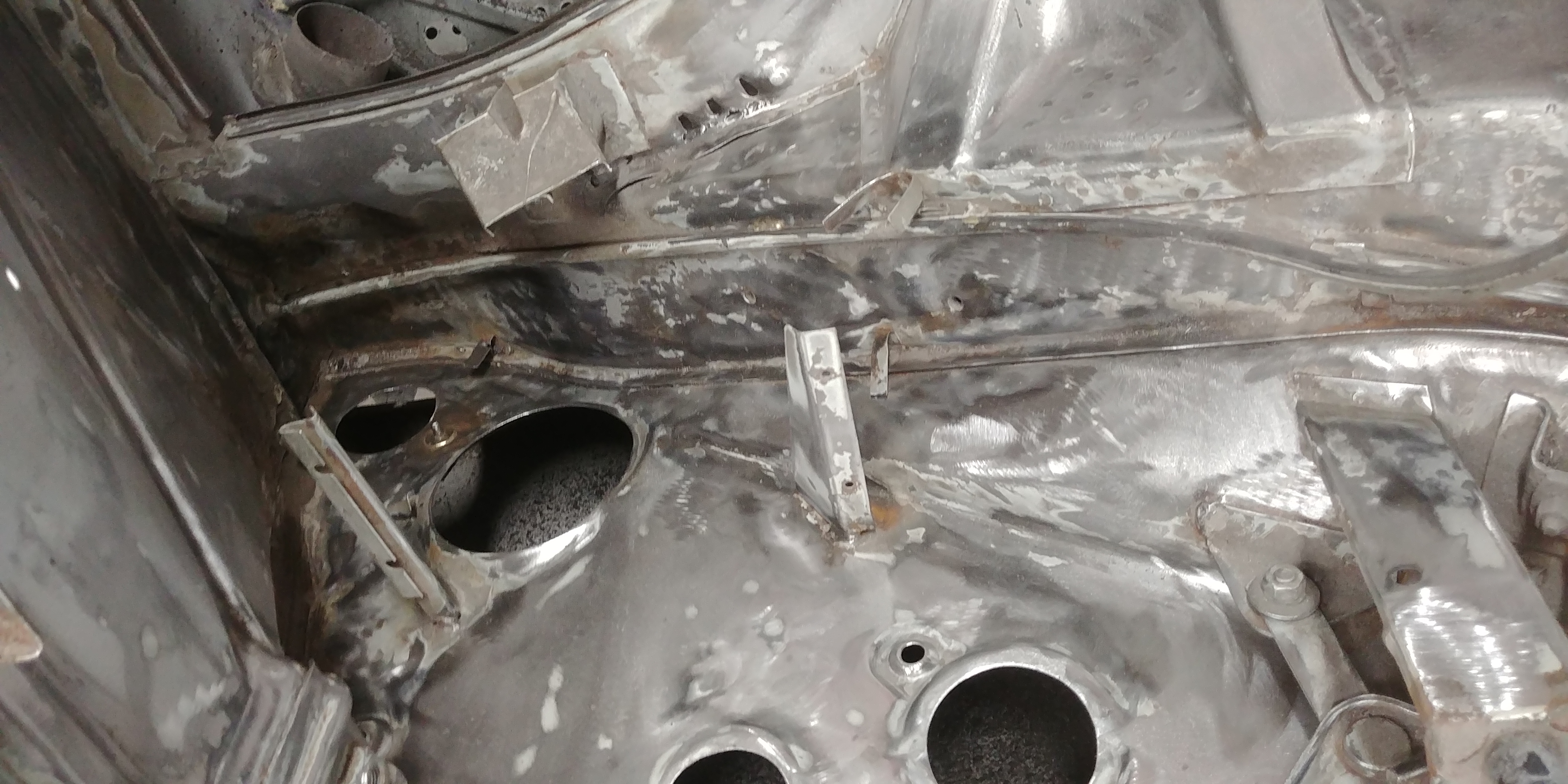

Started prepping engine compartment for paint. A few small weld repairs to do and remove the fan stand off. Takes a ton of time in this area to prep.. Attached Image

Are you using the relay board?

QUOTE(mepstein @ May 21 2018, 03:50 PM) *
I don't have the relay board so I cut those brackets off.
Also for a /6 you need to cut the heat booster fan bracket off.
Relay board is a PITA for the oil filter and the bottom tank fitting. I made my engine harness with the correct connector, so it plugs into the main harness no board.
Booster fan won't fit with a /6.

I am undecided on relay board.. The fuel pump relay is my only concern.. Any thoughts on that? Mark what did you do for a fuel pump relay set up?
Re the booster fan yes the bracket is coming off.. I called it the fan stand off in my post.
