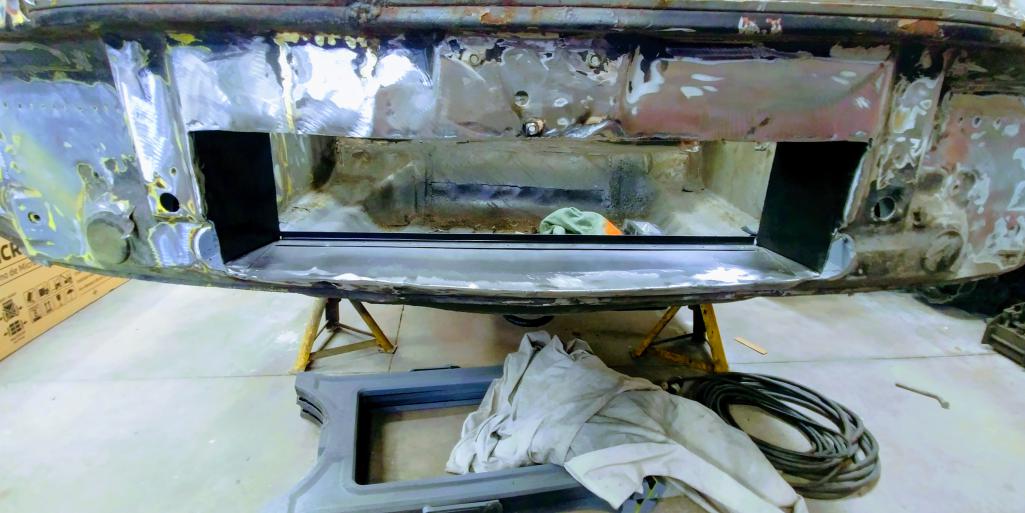

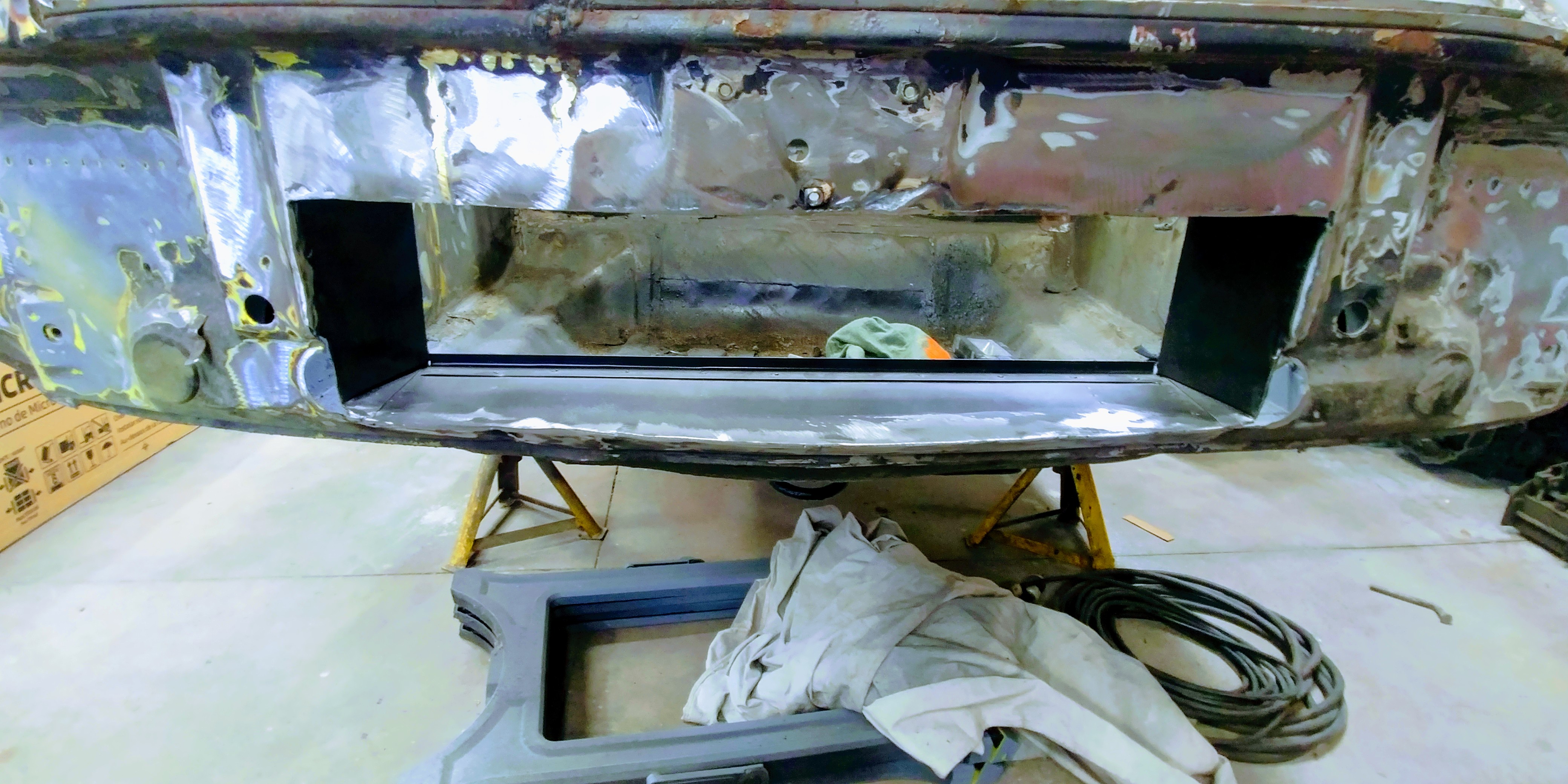

Front oil cooler mounting is welded in. Needs a bit of finishing but another step forward.. Also note see the braze repair probably dating back to the late 70s or early 80s.. I wrestled with repairing that or leaving as is.. I may someday find a front clip or just the front panel to correct it.. I just felt for my semi race car /GT tribute it just was not worth it.. If the right parts come along that maybe something to do in the future.
Anyhow I TIG welded this in only because I was out of Argon /co2 for the MIG. Attached Image

QUOTE(Travis Neff @ Aug 21 2018, 06:52 PM) *
That cooler duct looks great!
Its a pretty simple design. I made a couple of them based off of my oil cooler which I am very impressed with the quality of. Much nicer then a setrab not that there is anything wrong with setrab just the cooler I have is built to supercar quality.

QUOTE(mb911 @ Aug 22 2018, 05:05 PM) *
Do you think the front needs reinforcement now that there are two big openings in the nose and front pan.

QUOTE(mepstein @ Aug 22 2018, 01:54 PM) *
I am not sure. With the duct welded all around along with the louvered floor welded the same I would think its pretty strong.. I think some just bolt them on the front opening and I think that is not strong enough..

QUOTE(mb911 @ Aug 22 2018, 02:05 PM) *
I have the setrab unit from PMS and the replica GT ducting. Your design definately has all the air going through the cooler, while the replica setup will need a little work I think. Also has to add some strength back to the front end.

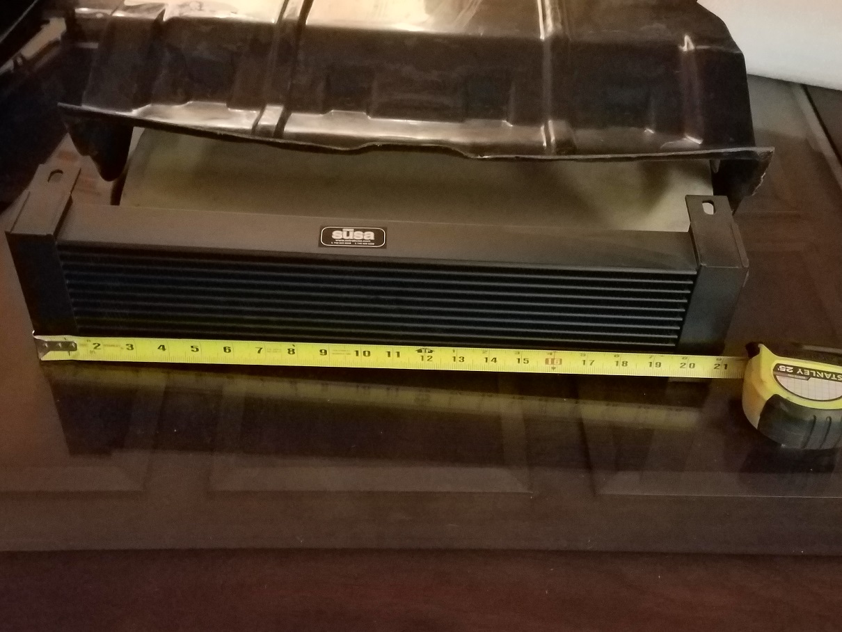

Yes never seen the PMS one in person. Do you know the dimensions of it (cooler opening)?

Dimensions of the cooler or the shroud? Gimme a few minutes and I will measure and take pics

Here is the cooler 21x4.5

Thanks that is helpful to know. Mine is 24x6 so the factory style shroud wouldn't work.. I am going to make one from scratch it seems.

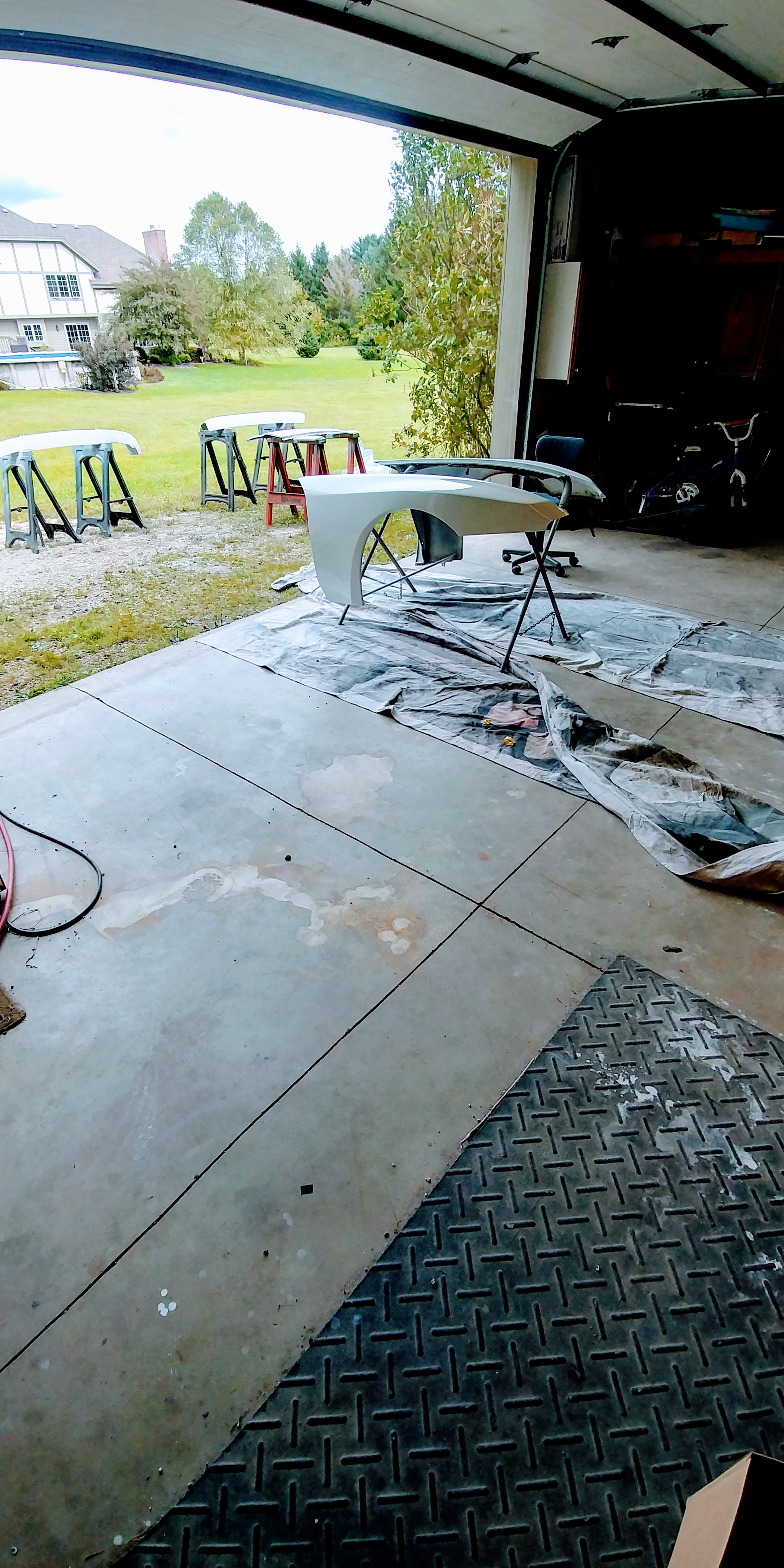

Update:
Been doing allot of sanding and paint removal as of late both on my car and my sons 944. I stripped the hood for my car and removed all the headlights and wiring and started removing the undercoating that someone sprayed in the front trunk. Most of the nasty paint is gone. I sanded the rest.. I have a small section of the front bulkhead needs to be repaired.. The plan is to fix this area and get ready for epoxy over the next few weeks.

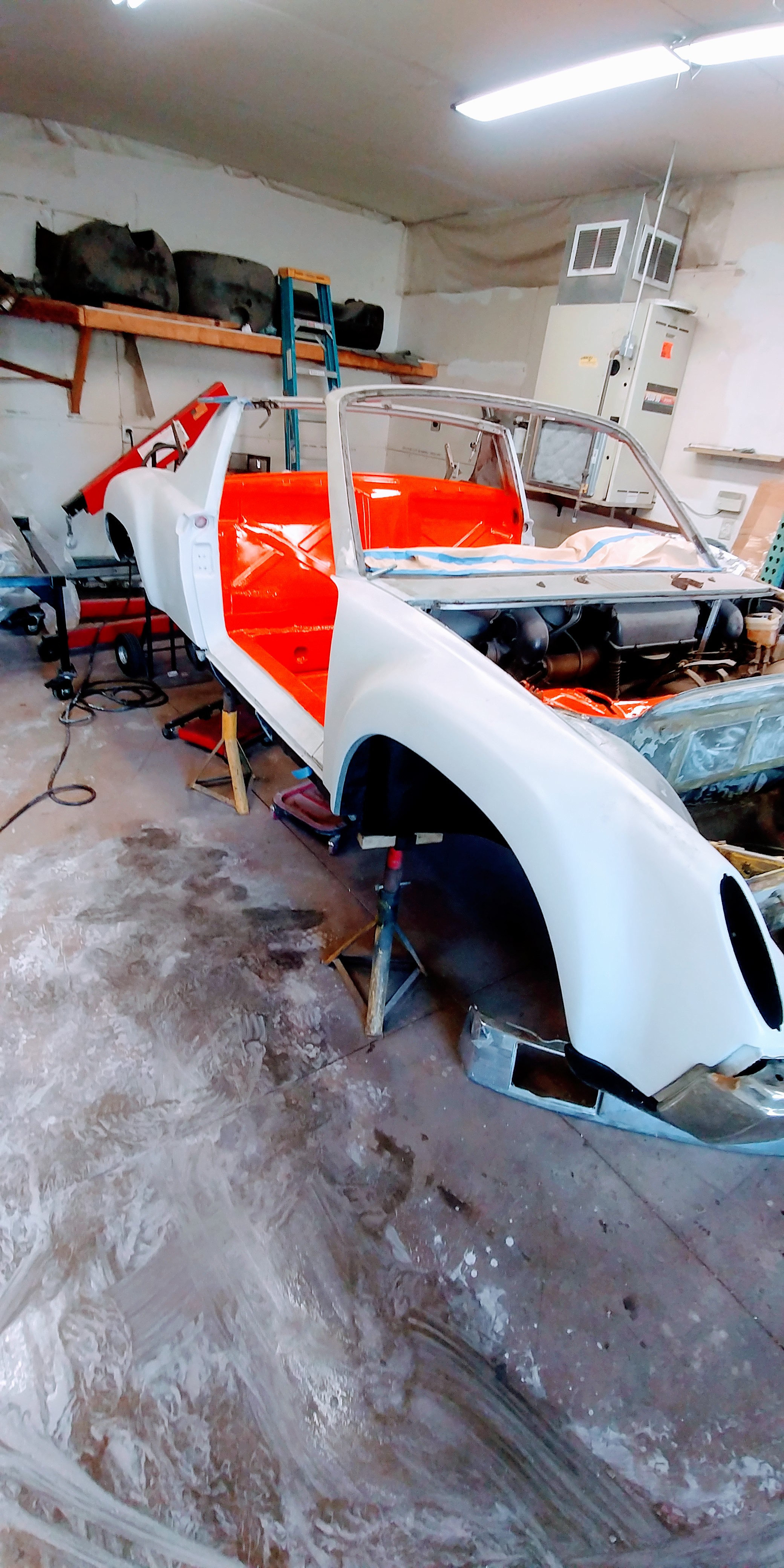

Spent some time painting the cabin then the shock mounting areas so that I can actually roll the car around.. The color is saturn red which is the same color as my last conversion car.. I think I like it. Please note this is not typical order of things but nees to get the car more complete for spring. We (wife) keeps thinking of selling our country property in favor of moving to something with a smaller yard.
