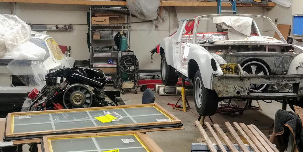

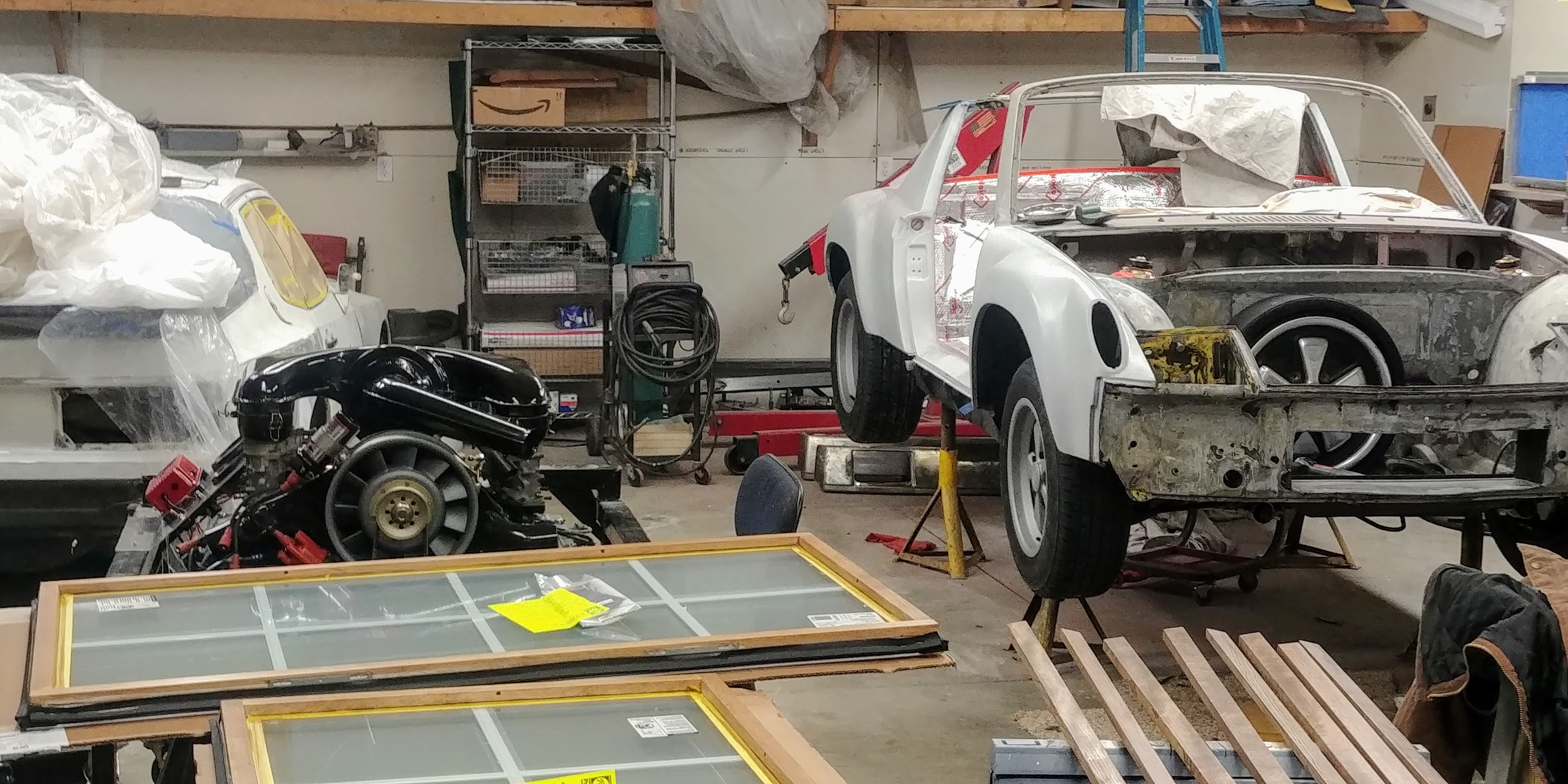

Everything is packed in for winter.. Pretty full .. Still room to work on multiple projects though. Attached Image

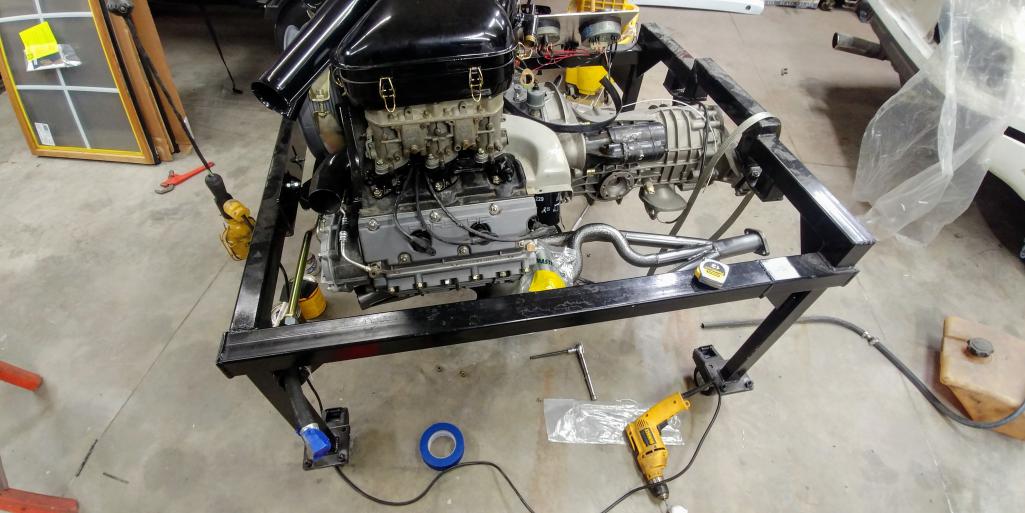

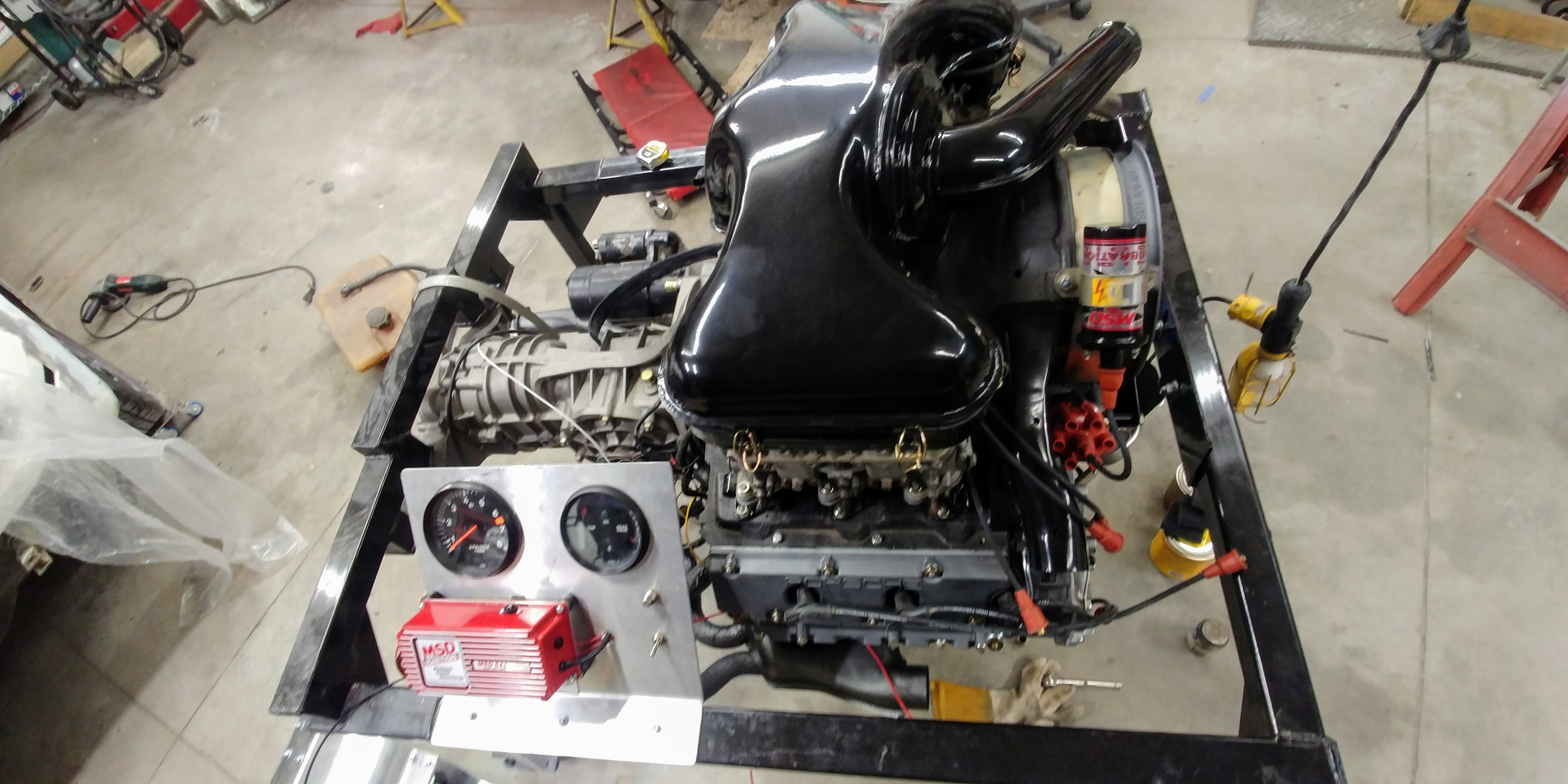

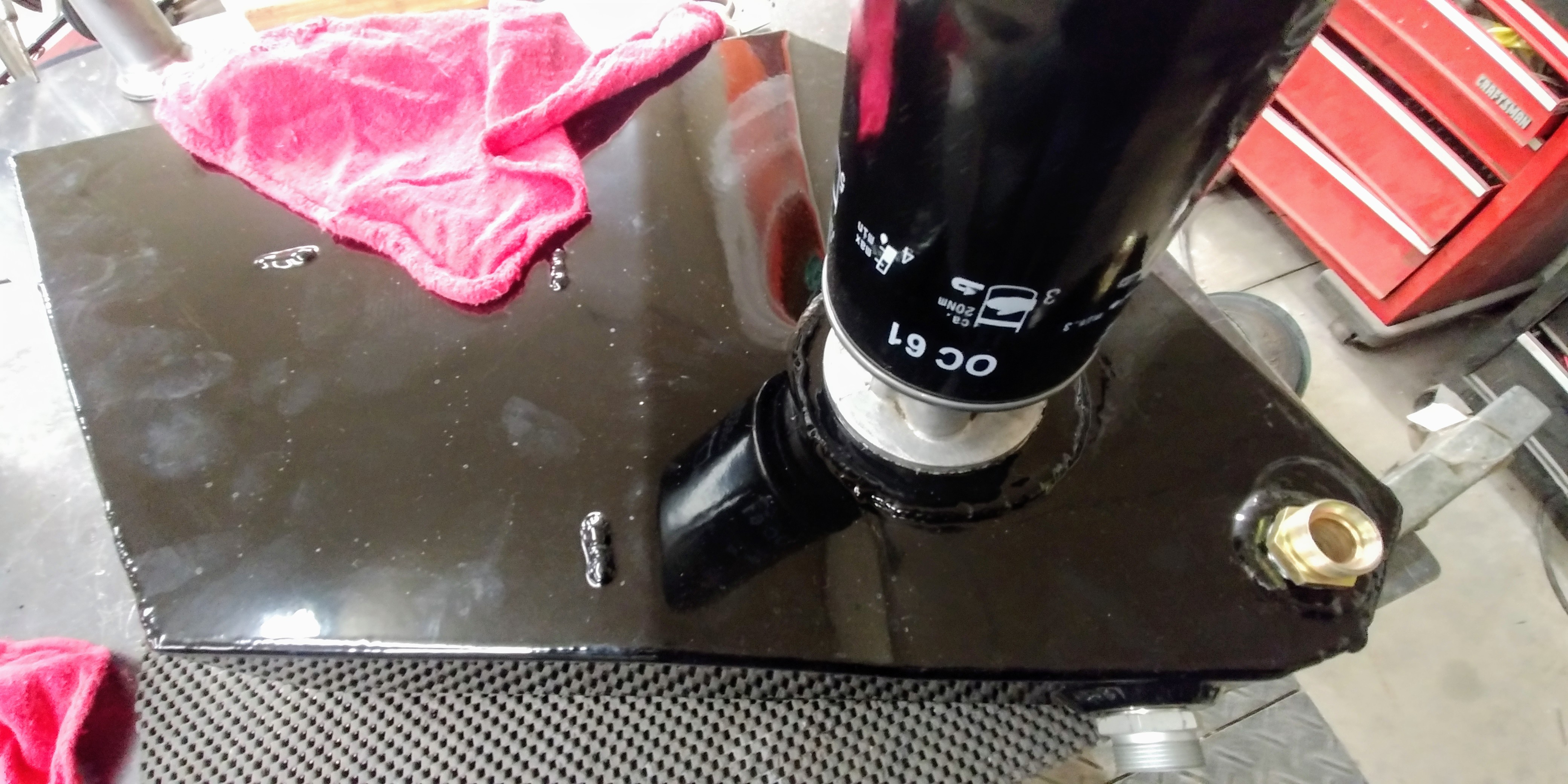

Made some progress yesterday . keep ordering small item's like the Harrell nuts, wire, connectors, ashlock tach adapter, etc.. Tank is an old design with incorrect locations so I modified for my own use and cleaned and powdercoated.. Drilled a hole in the gussett for the oil line and installed the heat exchangers loosely. Will be running soon.. Still waiting on my steering rack.. Starting to get irritated on that but it is what it is.. Attached Image Attached Image

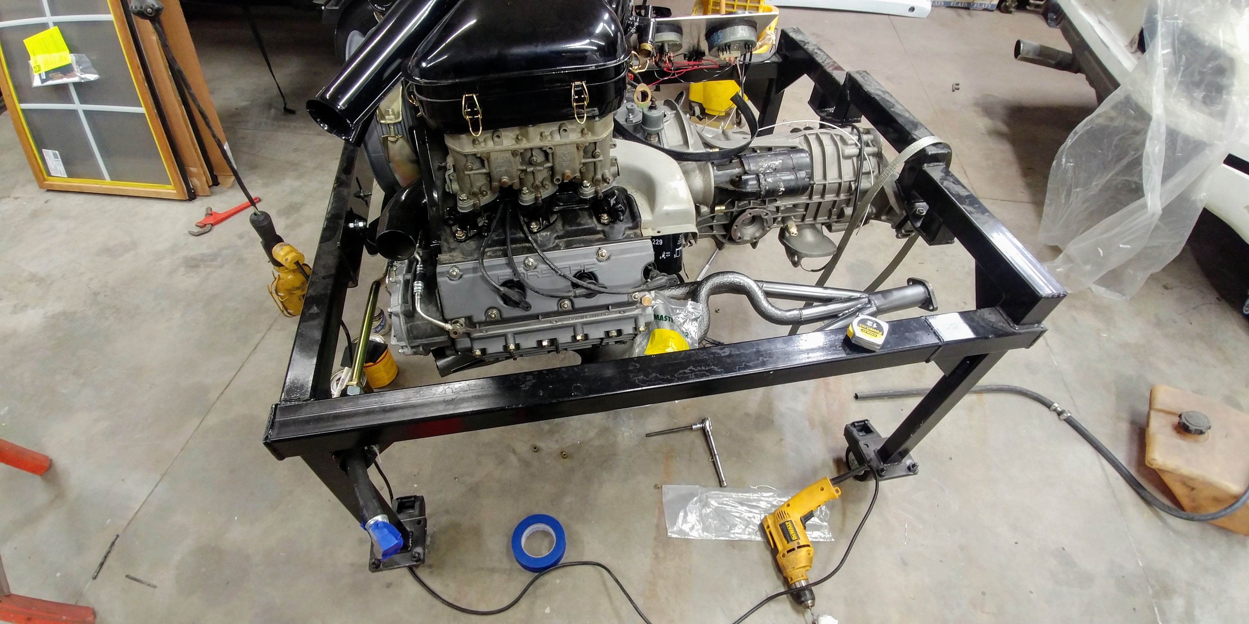

Turned engine over tonight with no ignition on to build oil pressure.. Exciting.. Now finish more wiring. Attached Image

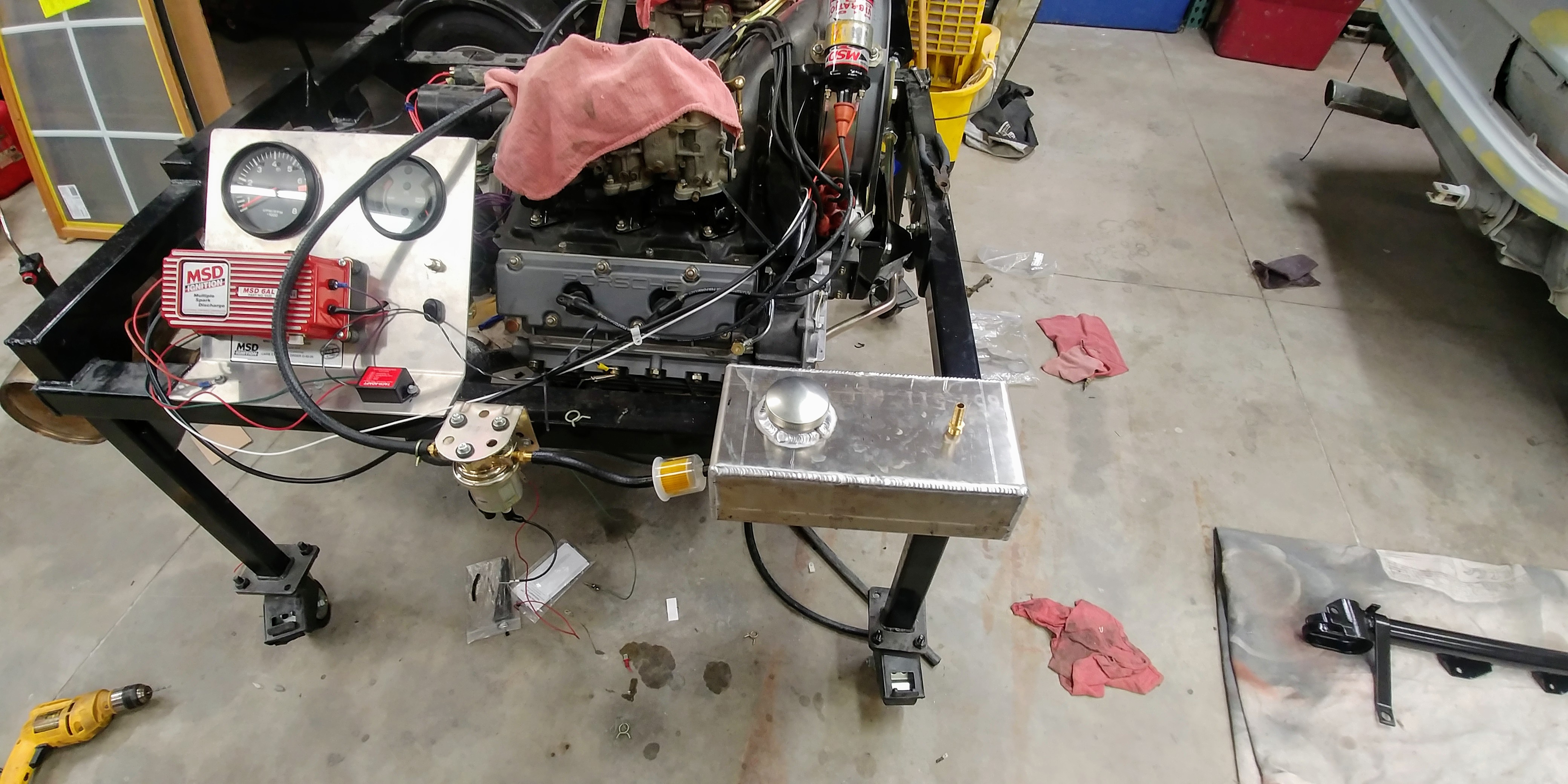

Not allot to report.. Had the engine running very shortly, changed some sensors to jive with the gauges, built a small fuel tank.. Gotta make a tool to tighten the the pressure sensor and then give it another go.. Attached Image

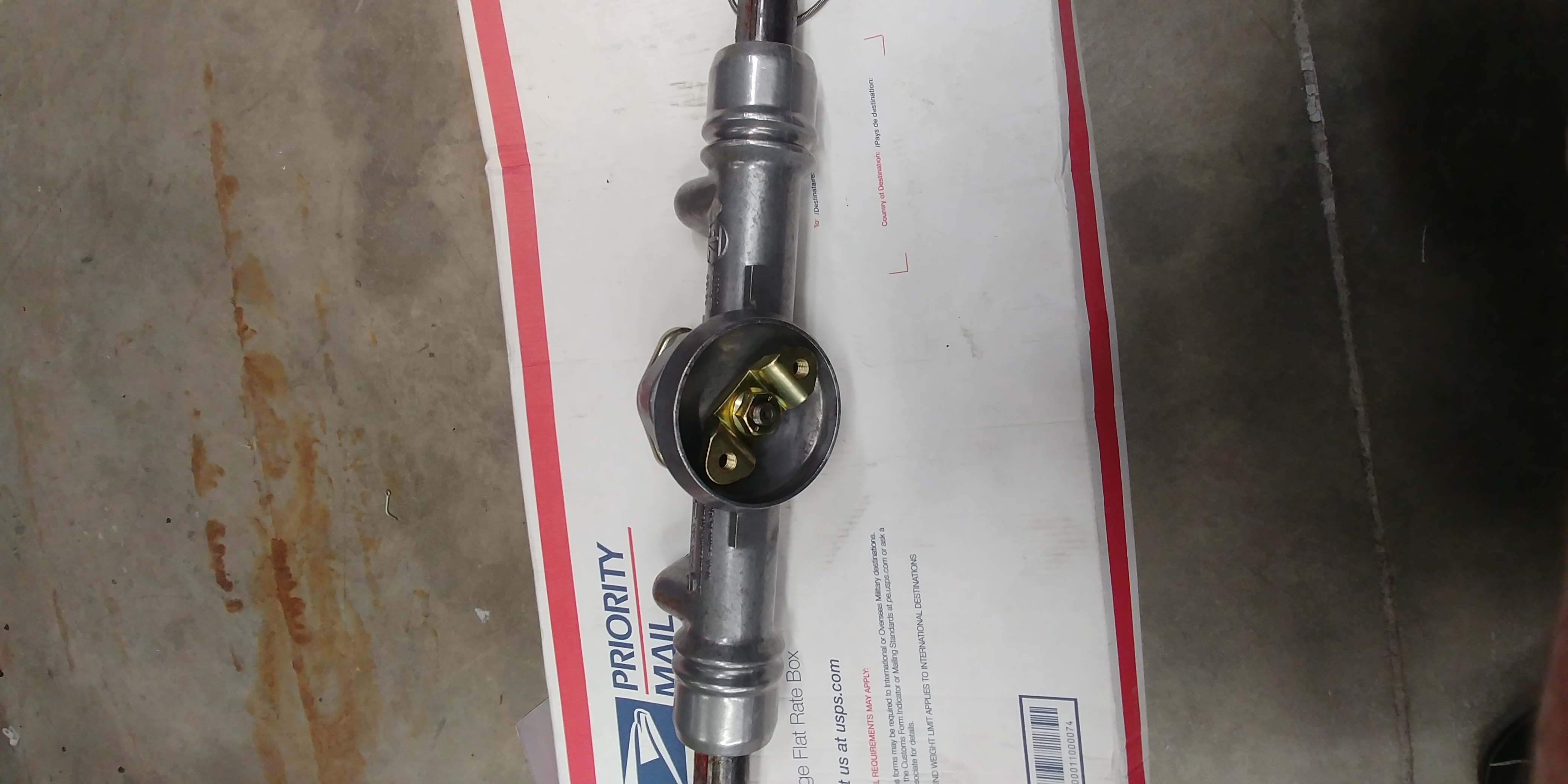

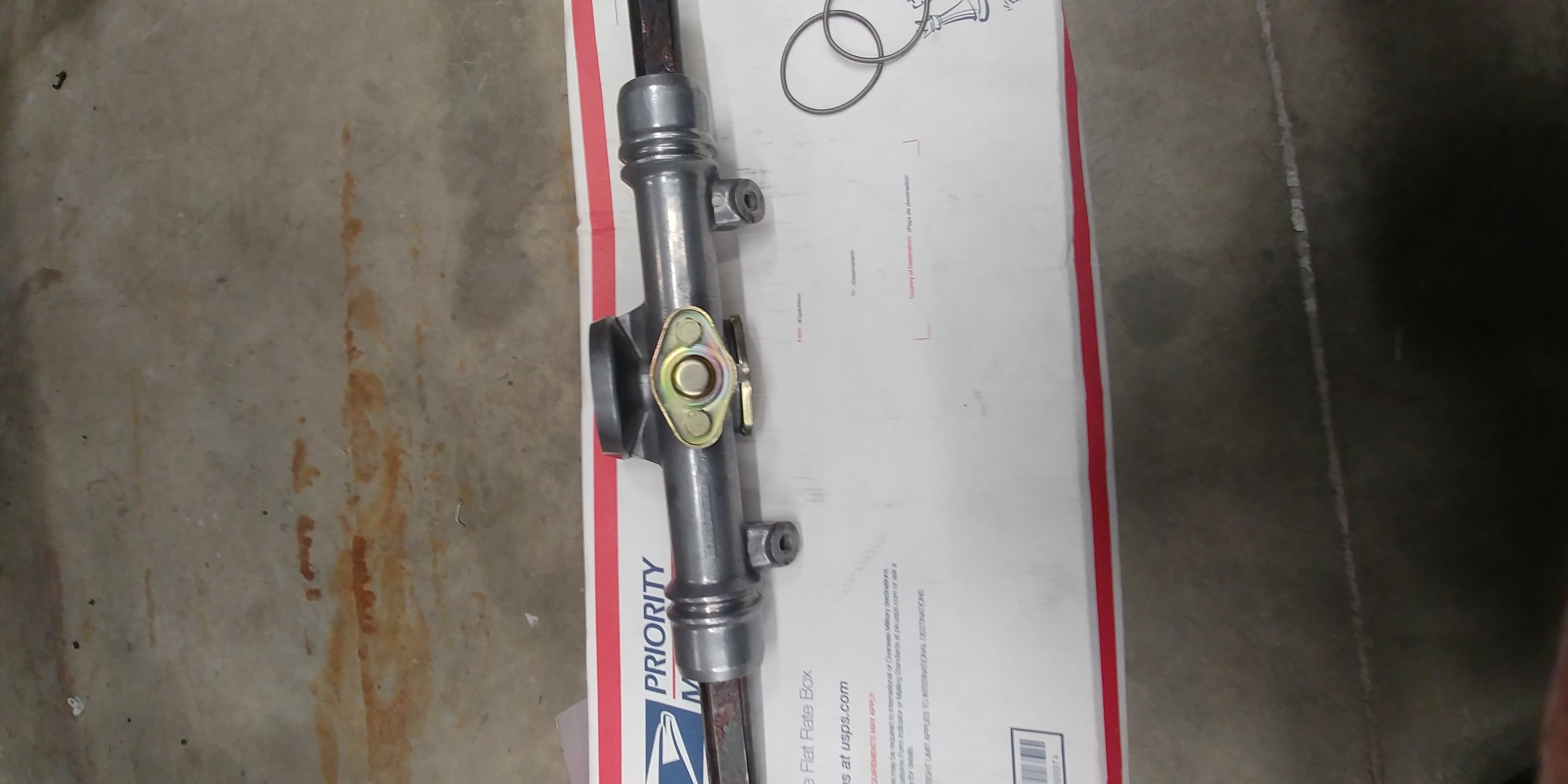

Today I got this beautifully restored ZF steering rack from Shaun @tru-6.. This was to replace the rack that I had previous that just would not run smoothly no matter how much I worked through it..
Shaun and I have known eachother for years and we did a little bartering on this.. It's as new.. This will get installed over Christmas break. Attached Image Attached Image

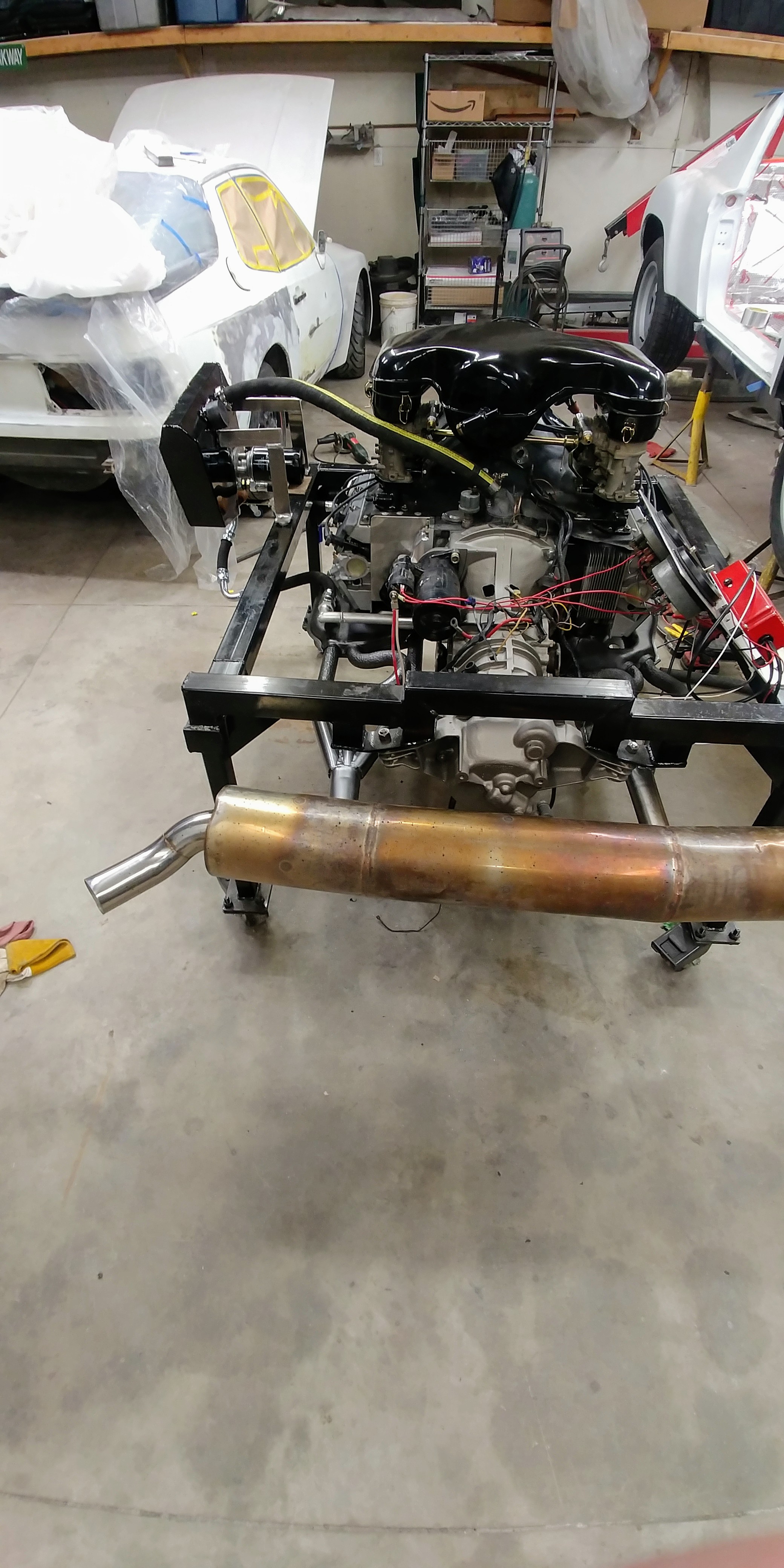

Got the engine running tonight though not well.. Great oil pressure so that's good.. Seems like I have the firing order off.. I am thinking recheck valve's, or plug wires on the wrong plug. Getting there.. Watching packers game so done for the night.. Made my fuel pump/spare tire mount.. Attached Image
Hope you put in a fuel pressure regulator,even pumps sold as X amount of pressure deliver more than needed,mostly this is a real issue.
Valve clearances are rather odd IMO set mine motor out of car then checked after full rotation and they were out,reset and all great.
Plug leads are easy enough not telling you anything ,go well with your build.
