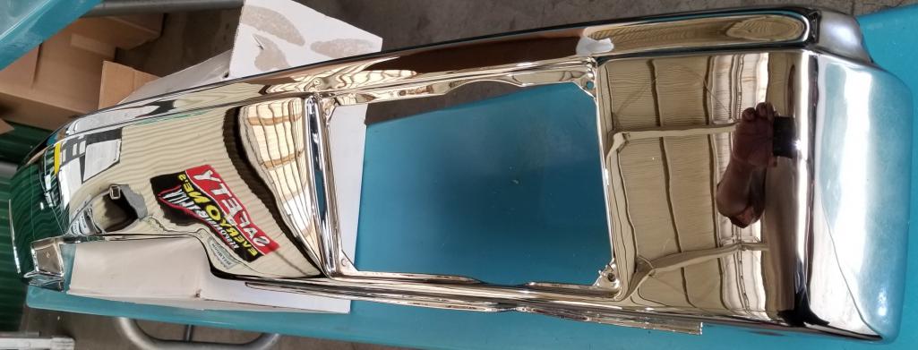

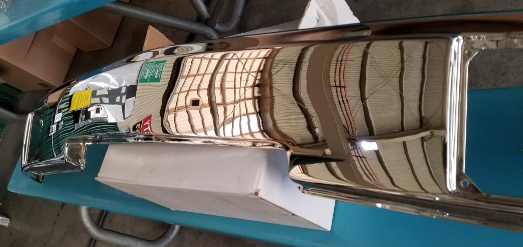

On a side note.. Check out my bumper I had Oscar chrome it thanks Attached Image Attached Image

Bumpers look fantastic.

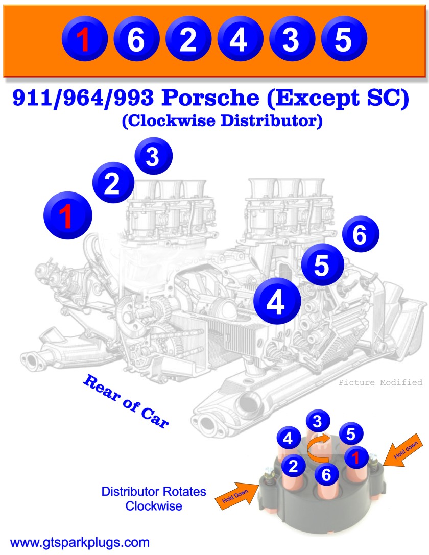

post Nov 16 2018, 07:02 PM

mb911
post Nov 16 2018, 07:23 PM

QUOTE(mb911 @ Nov 16 2018, 05:23 PM) *
Perfect ! I remember these pics, lost my bookmarks for them. (IMG:style_emoticons/default/beerchug.gif)
Thanks

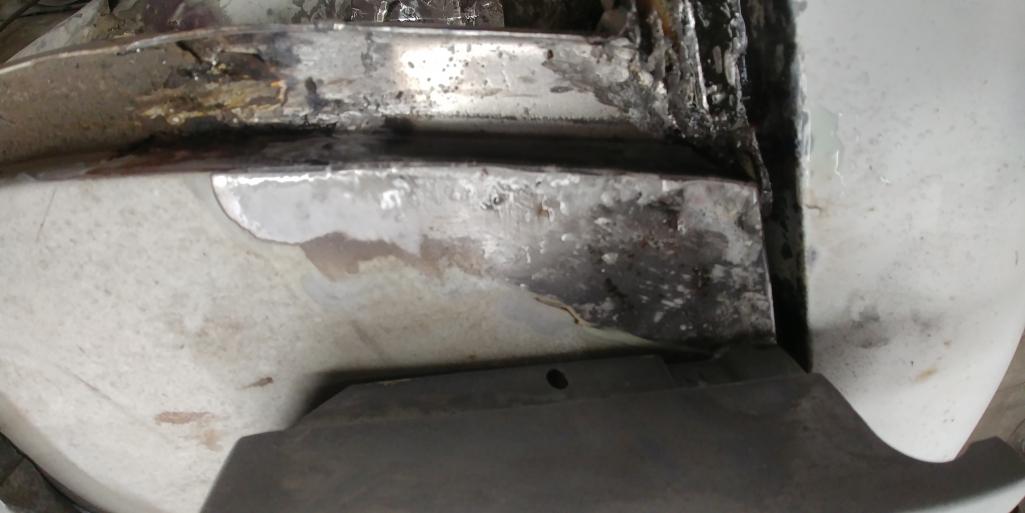

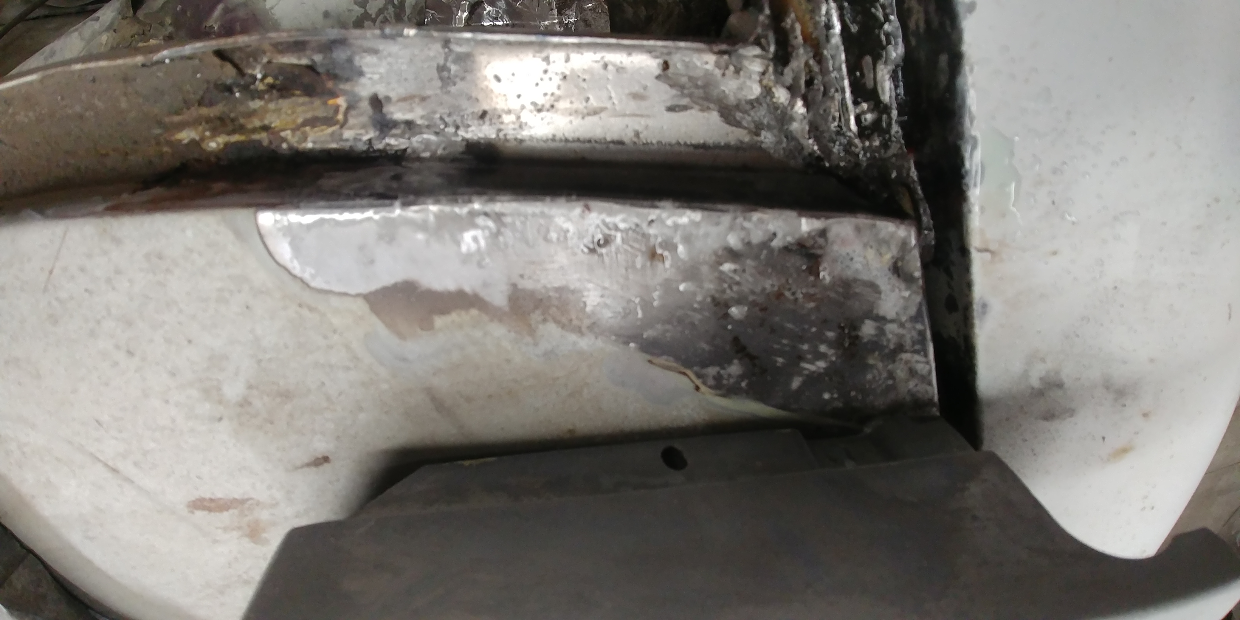

Finished the corners of the trunk channel. I was going to buy the AA reproduction parts but they were $95 each side and I fabbed up the area in about 10 minutes and didn't need as much material as aim may.. Sprayed it with @bbrock s secret rust conversion from home depot. The front trunk is now my focus for the next phase. This allows me to paint and then put steering rack in so can finally get it rolling. Attached Image

Picture might be a bit too close to see detail but your just seeing the conversion turning to a black liquid like crust. Also not not cleaned up.
