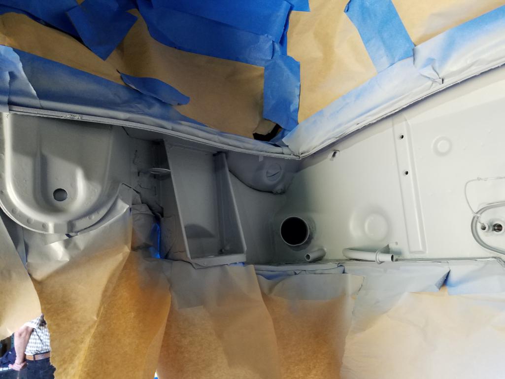

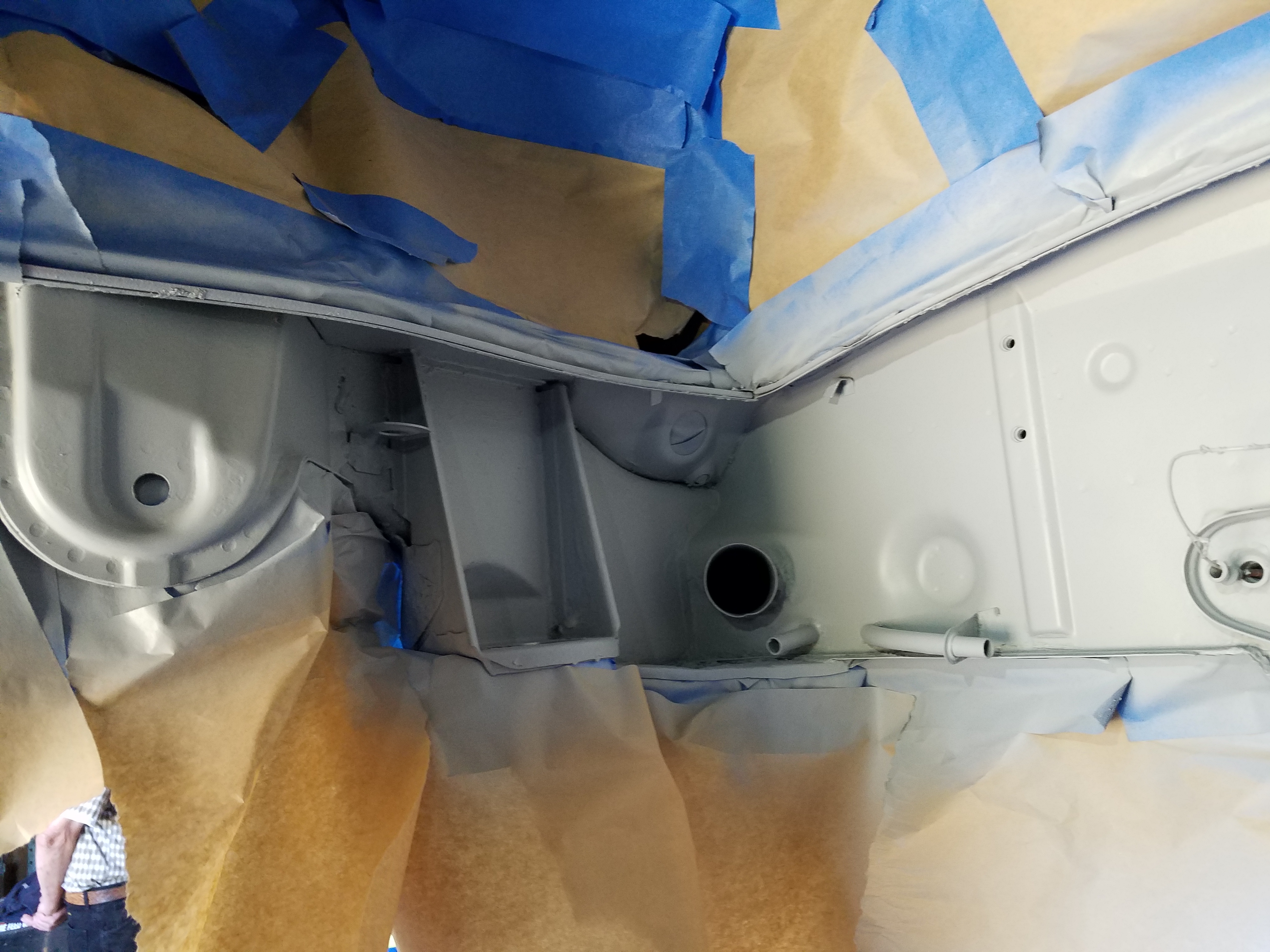

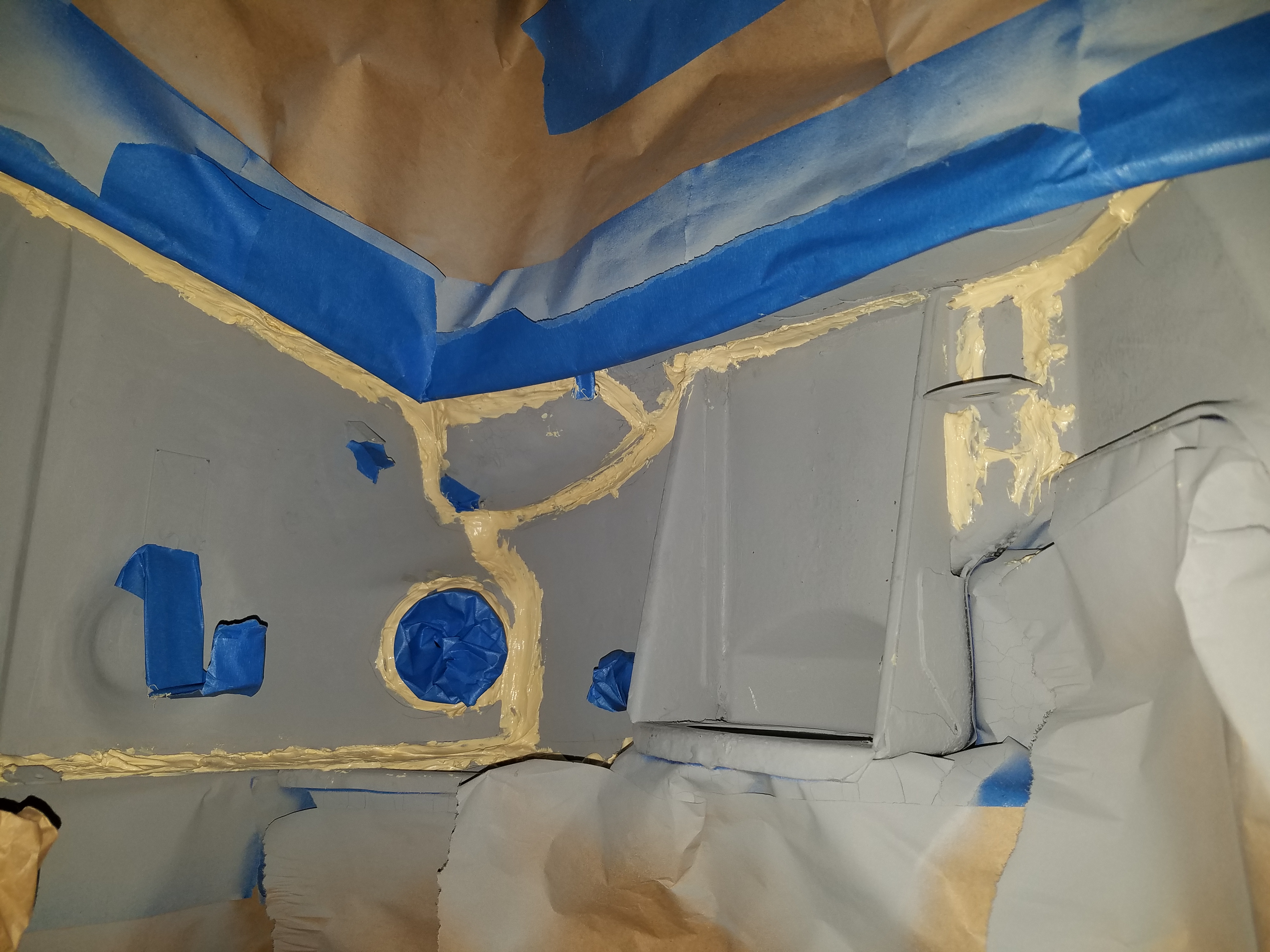

Took the engine bay back down to metal and got it primed today. Etching primer followed by sandable primer and sanded with 320 between coats. Drying until Tuesday then we will get seam sealer back on from a calling gun and then sprayer before laying down color and clear.

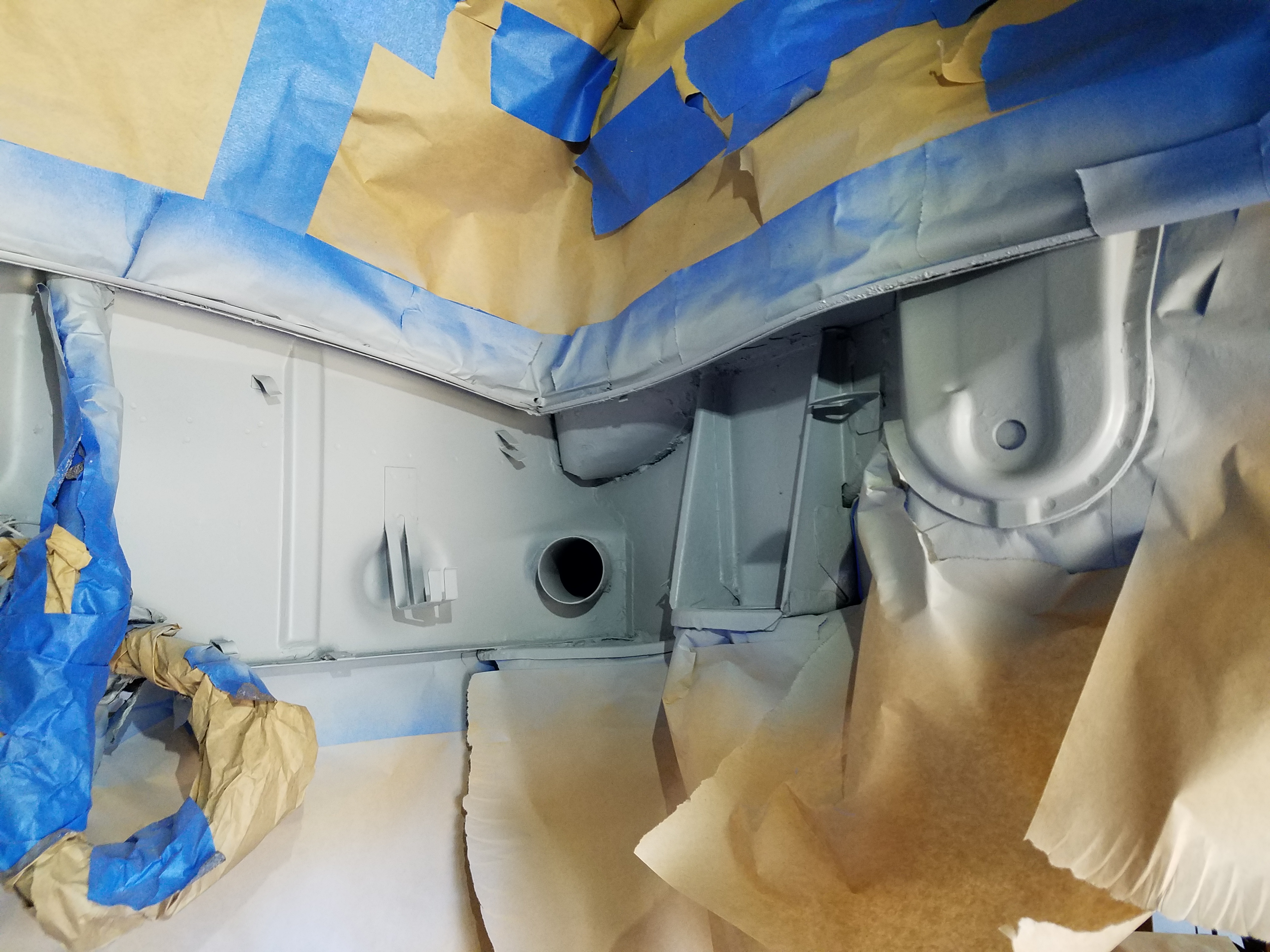

Another angle.

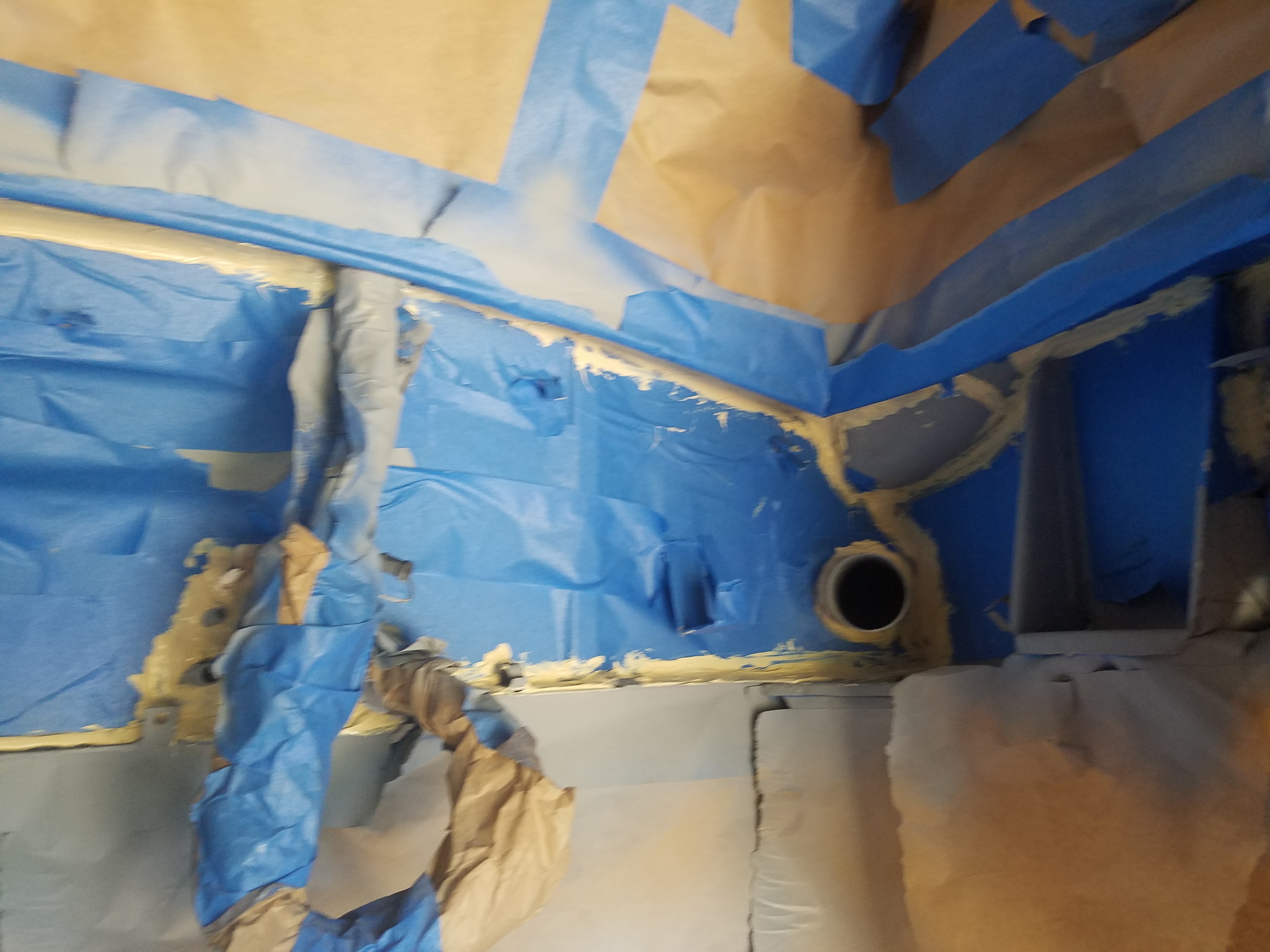

Much happier with this attempt.
Matty900
post Jul 5 2017, 01:19 AM
Post #186
Posts: 1,291
Joined: 21-February 15
From: Oregon
Member No.: 18,454
This will cure until Thursday and then we'll hit the corners at least with Wurth.

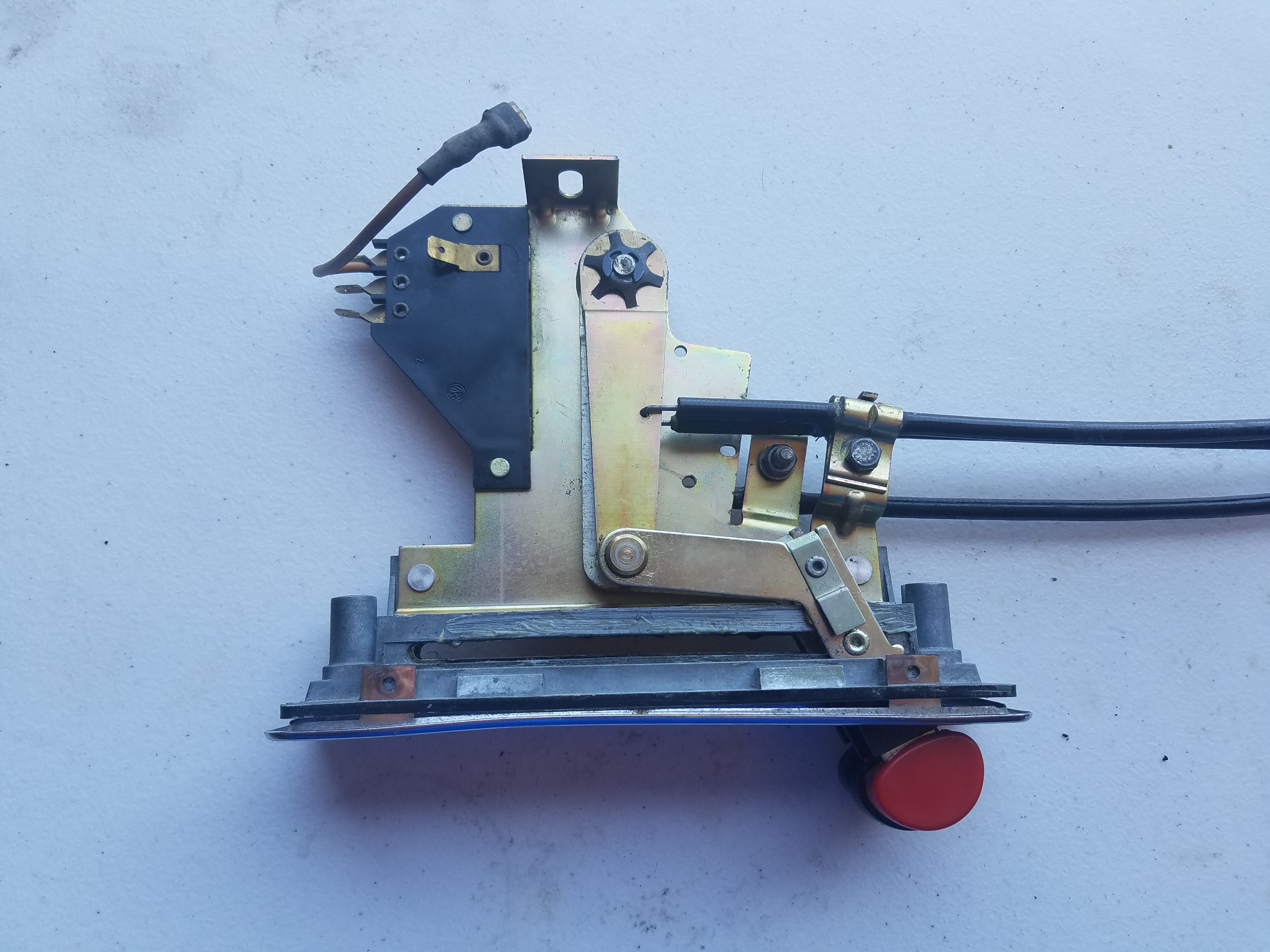

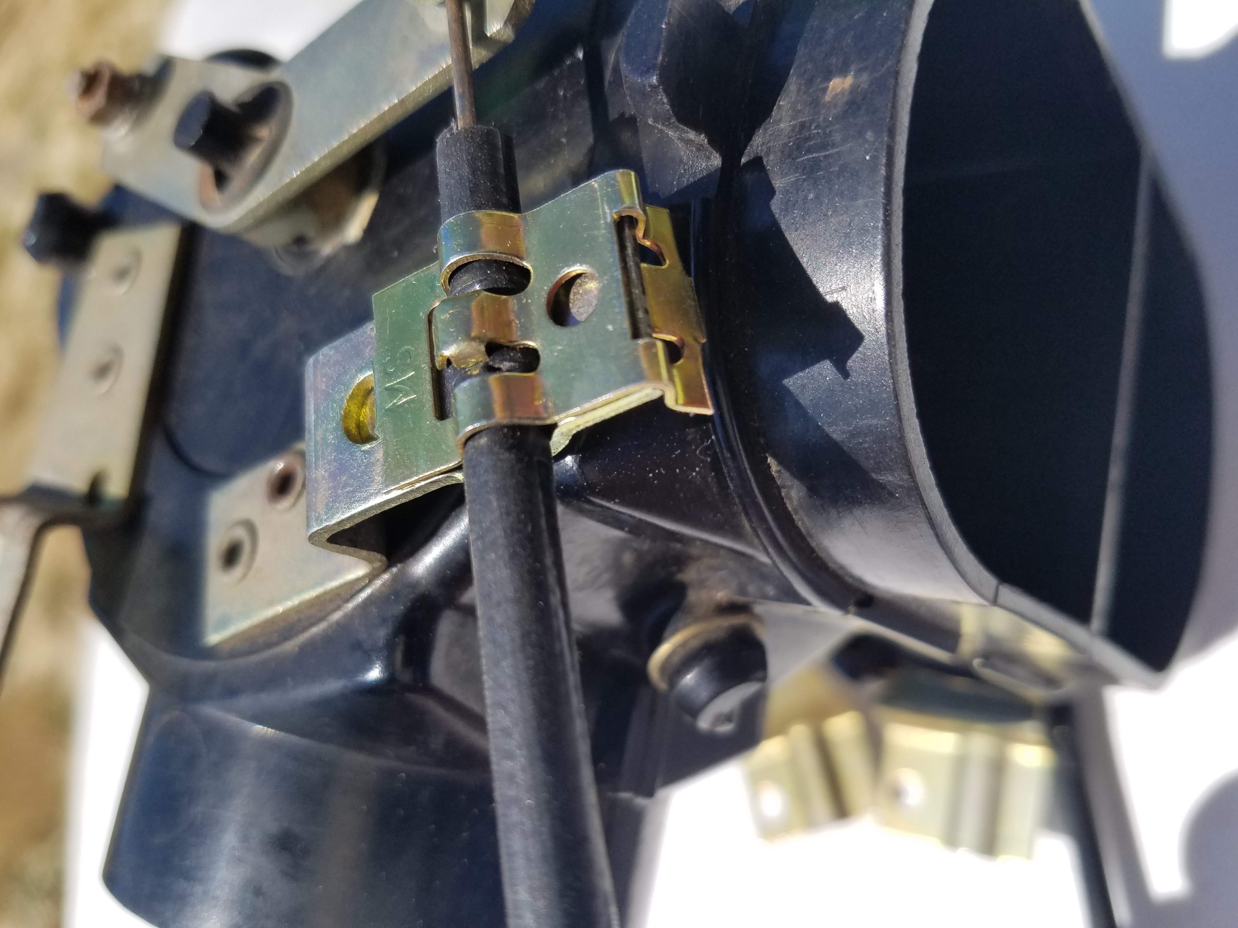

Took apart the airbox controls, cleaned and reassembled.

Cleaned up the defrost vents and control boxes. Hope to install all of this Thursday.

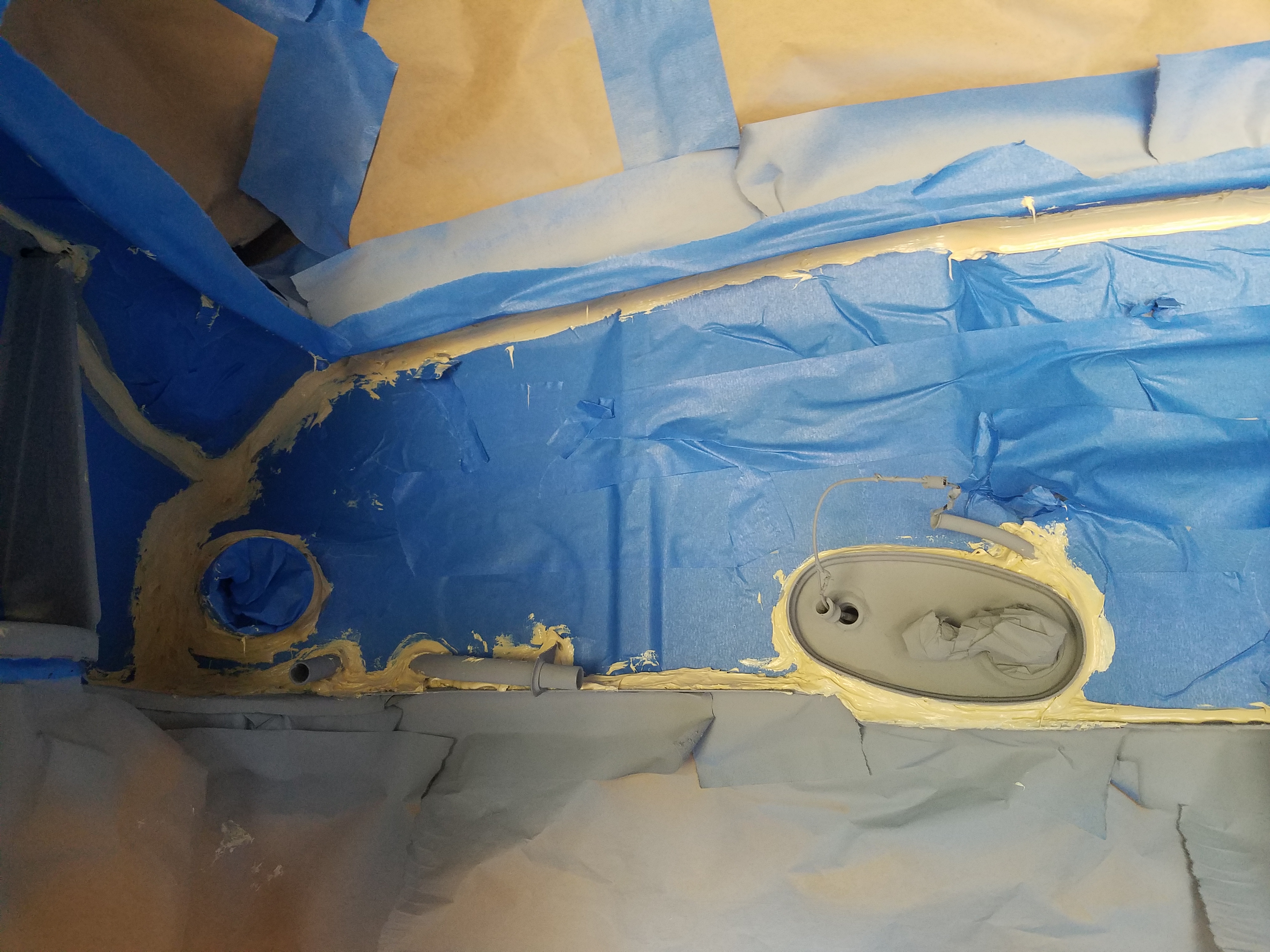

Reapplied seam sealer from gun. Much better result

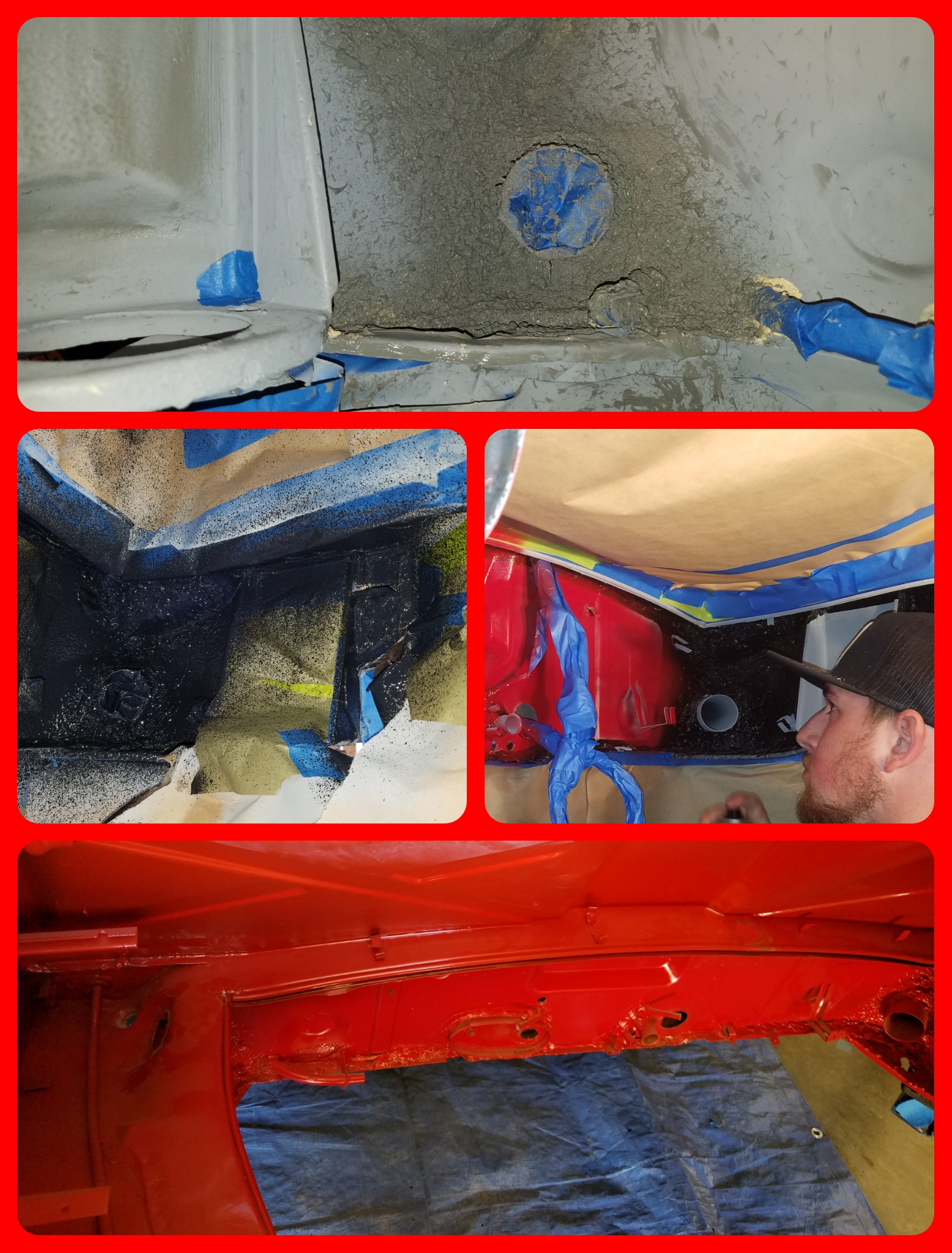

Haven't uploaded any progress for a while so here's a few more photos. We got the spray in seam sealer, wurth undercoat and paint in the engine bay.

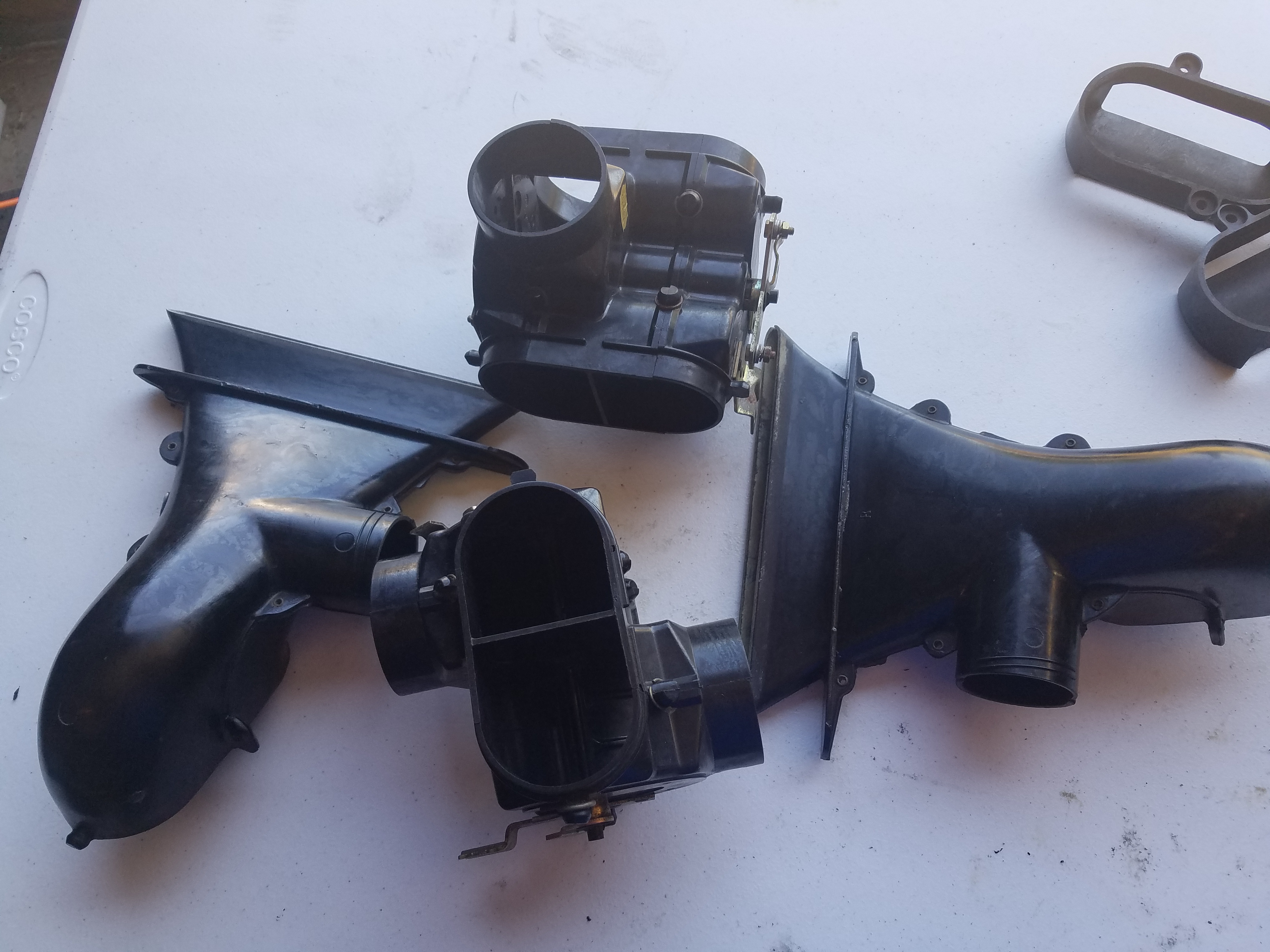

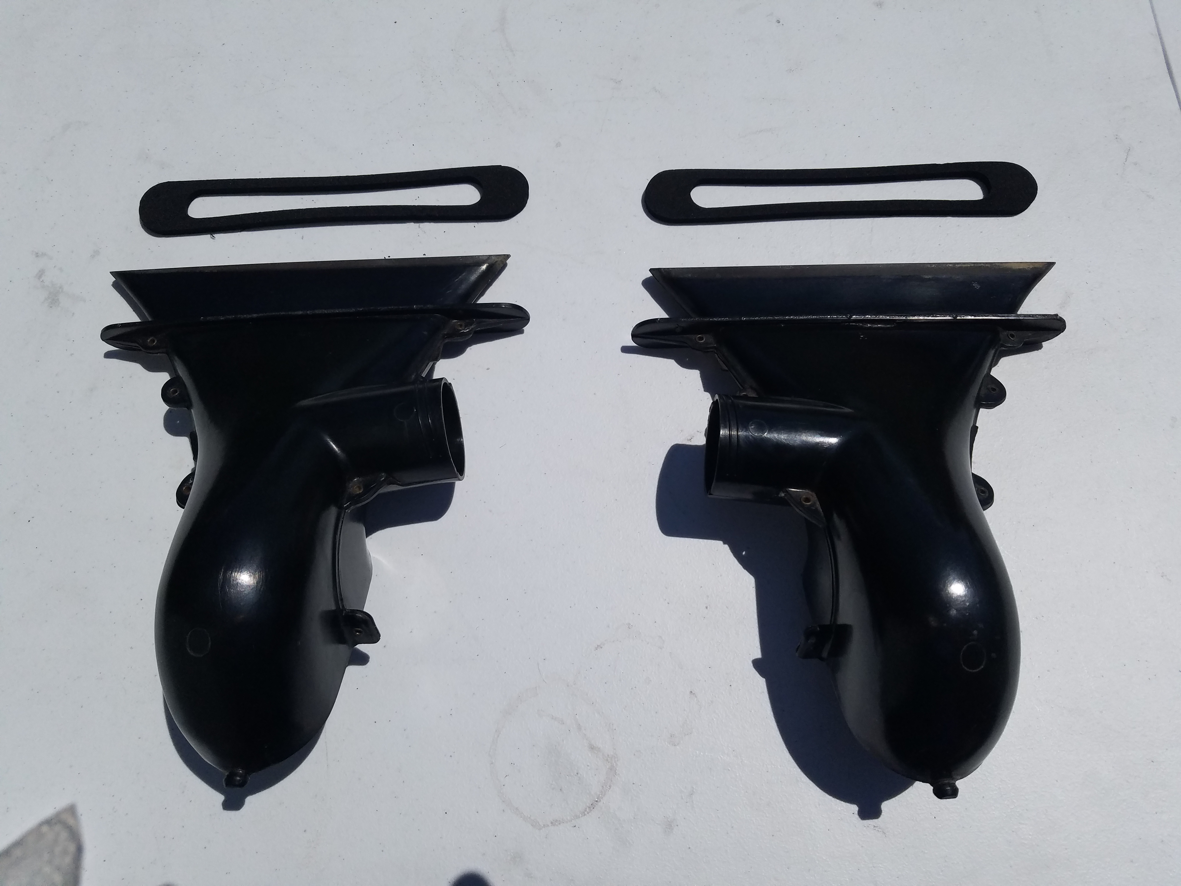

Cleaned up the mixing boxes and put on re plated clips
Matty900
post Jul 23 2017, 12:13 AM
Post #194
Posts: 1,291
From: Oregon
Member No.: 18,454
Cleaned up the defroster vents and replaced the seals. The old ones had degraded in to a sticky mess.

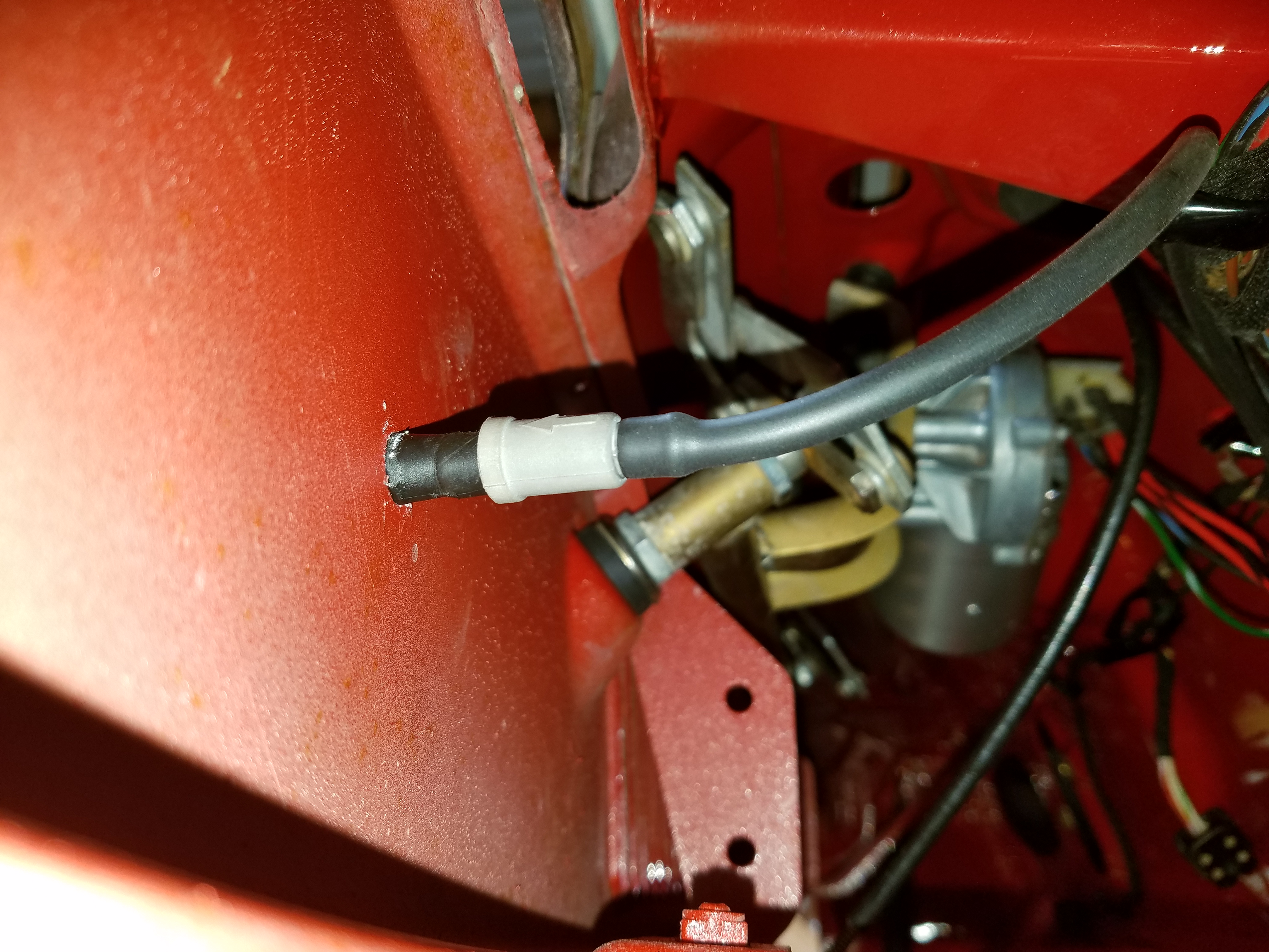

Installed new washers, check valves and lines.

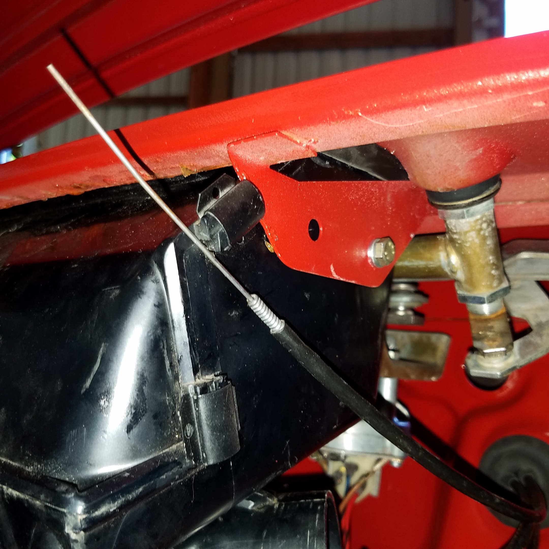

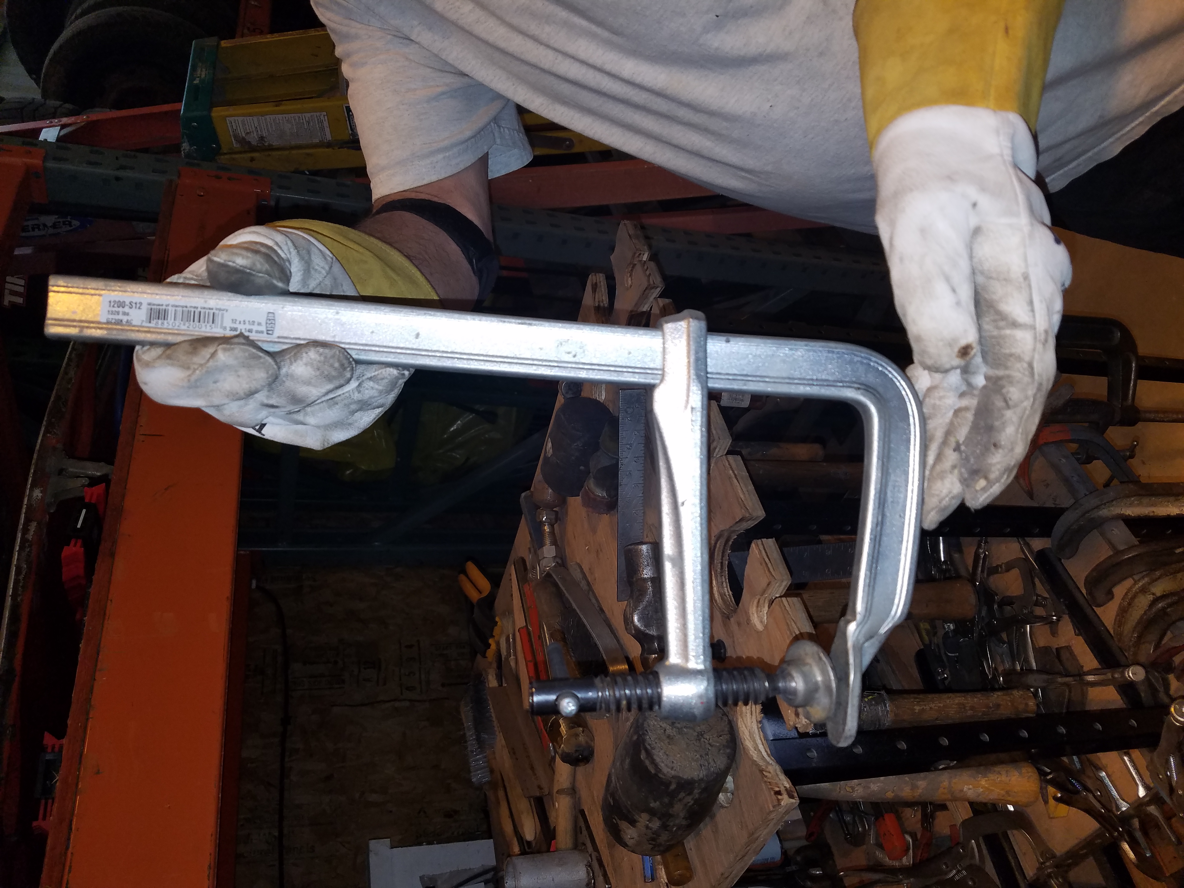

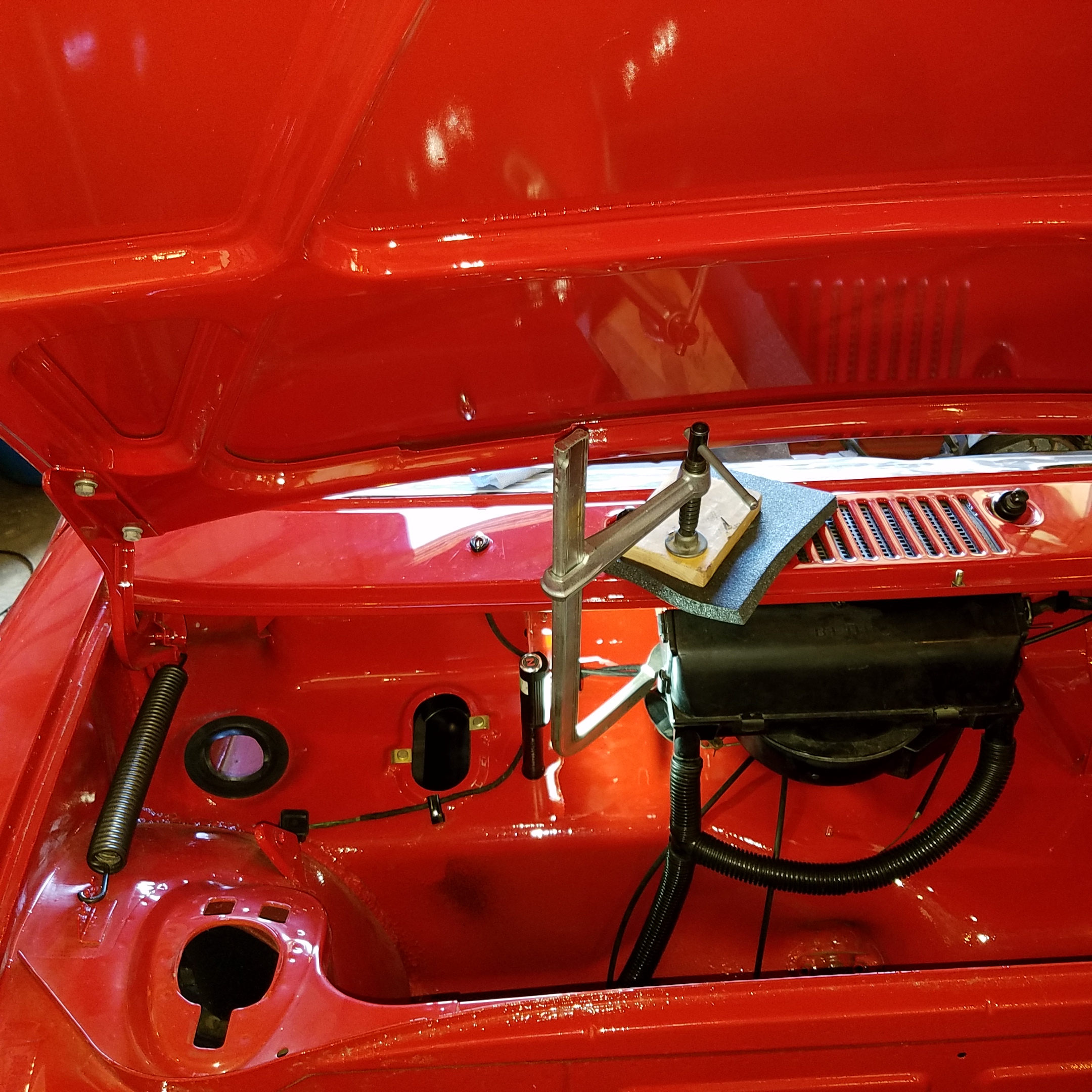

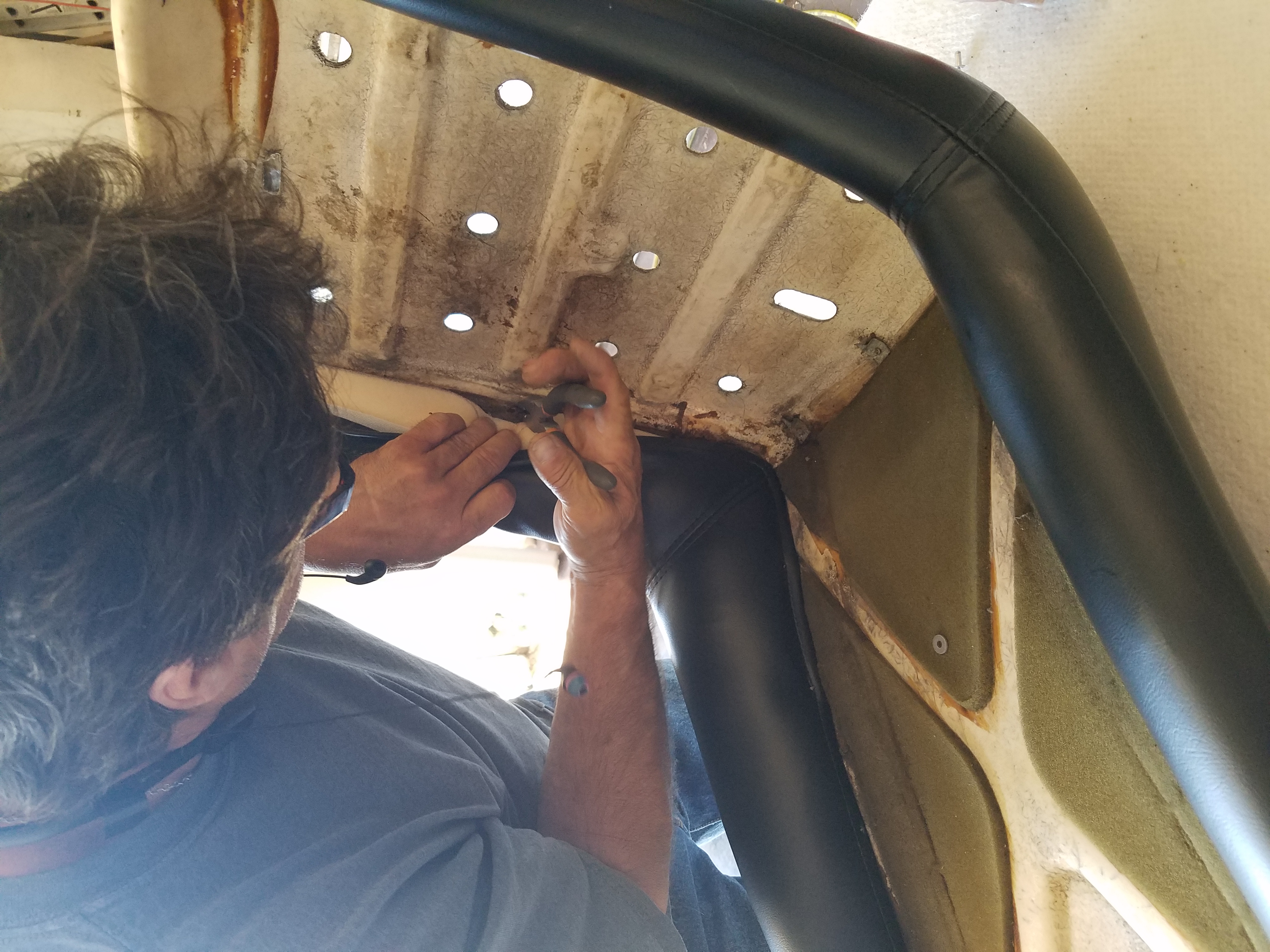

Cary figured out the best way to install the fresh air mixing box in the car.
Matty900
post Jul 23 2017, 12:27 AM
Post #197
Posts: 1,291
From: Oregon
Member No.: 18,454
This makes the installation easier.

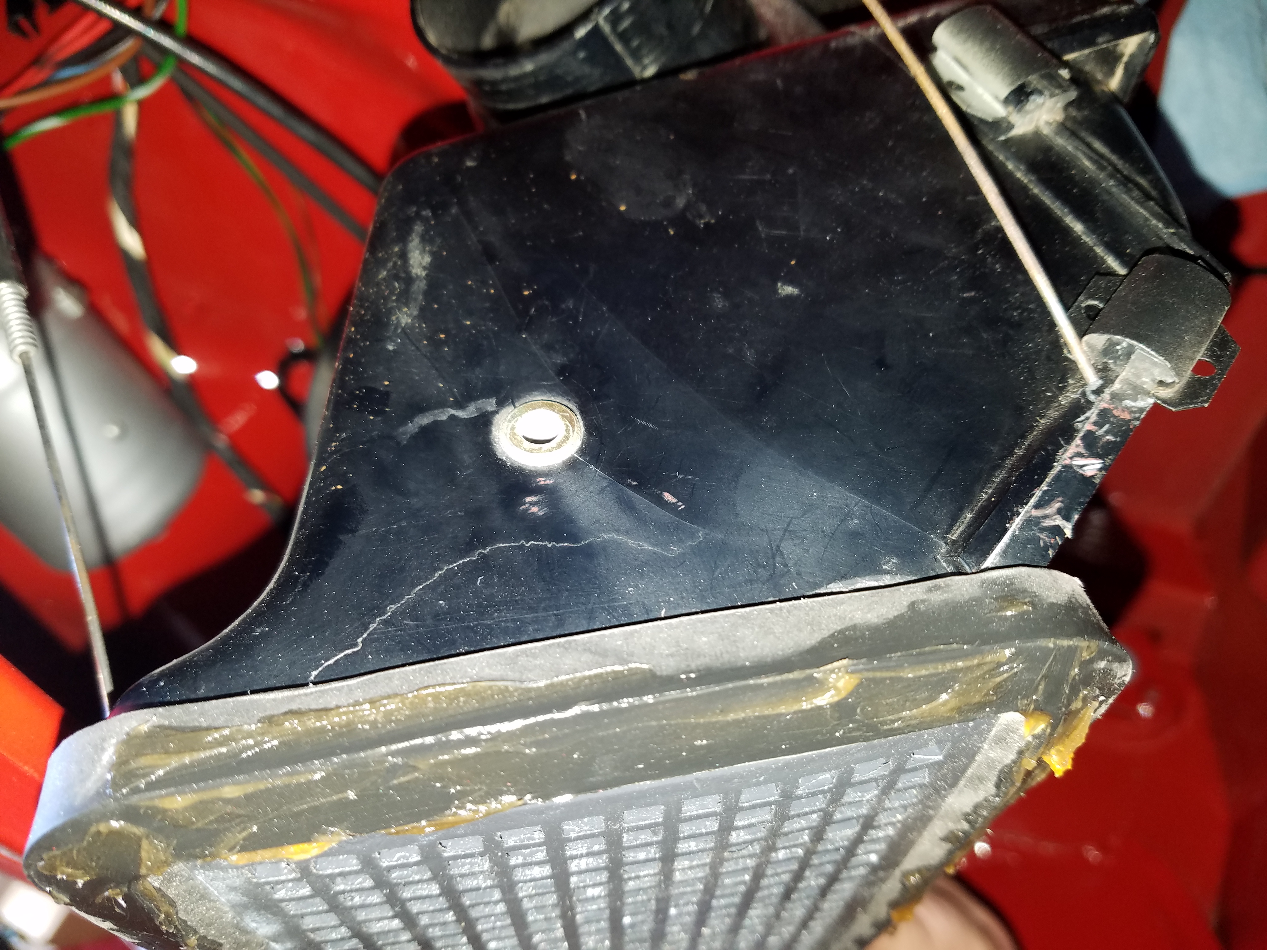

I upgraded to the late style grill and seal for the air box. The key to this is superglue and patience. The factory seals were glued to the grills. I superglued the grill into the seal and let it set up for the night. Then I glued the sill to the Box halfway around and let it set. Then I came back and glued it to the other side so that it was completely glued to the Box. When I went to install I used the Sil Glide liberally all the way around so that the new rubber didn't stick to the new paint and make it come off the Box.

This is Carys magic wand for installing the fresh air mixing box (IMG:style_emoticons/default/smilie_pokal.gif)

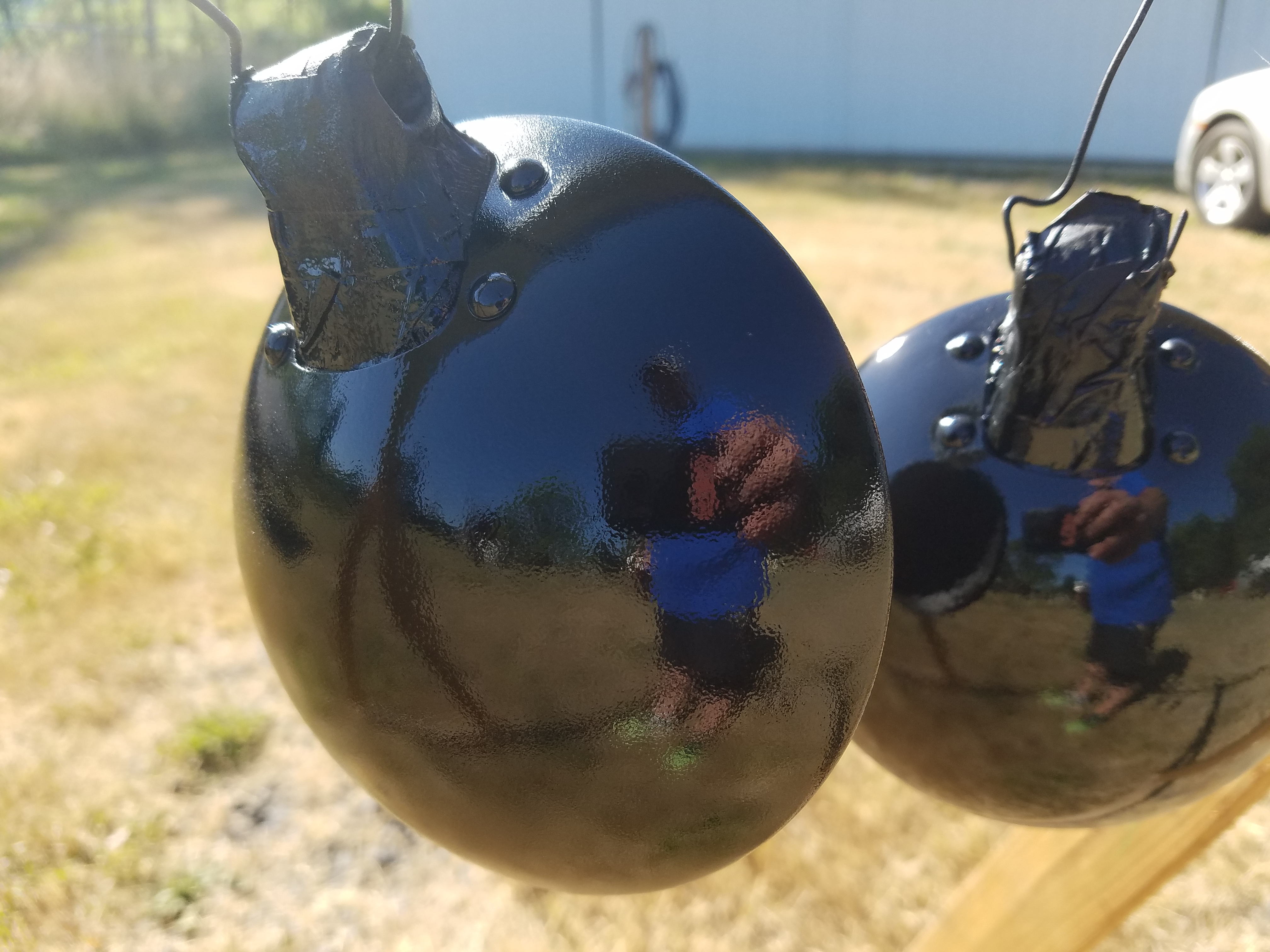

Stripped and repainted the fog light housings
