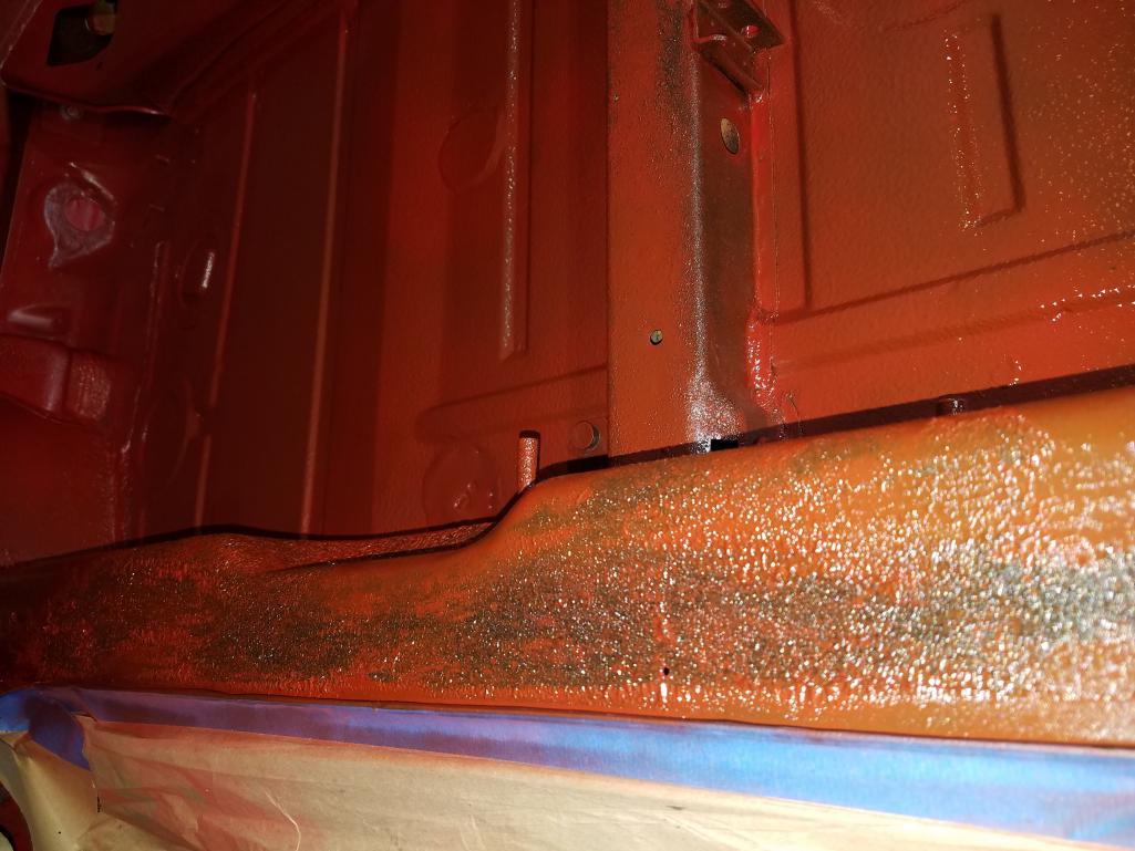

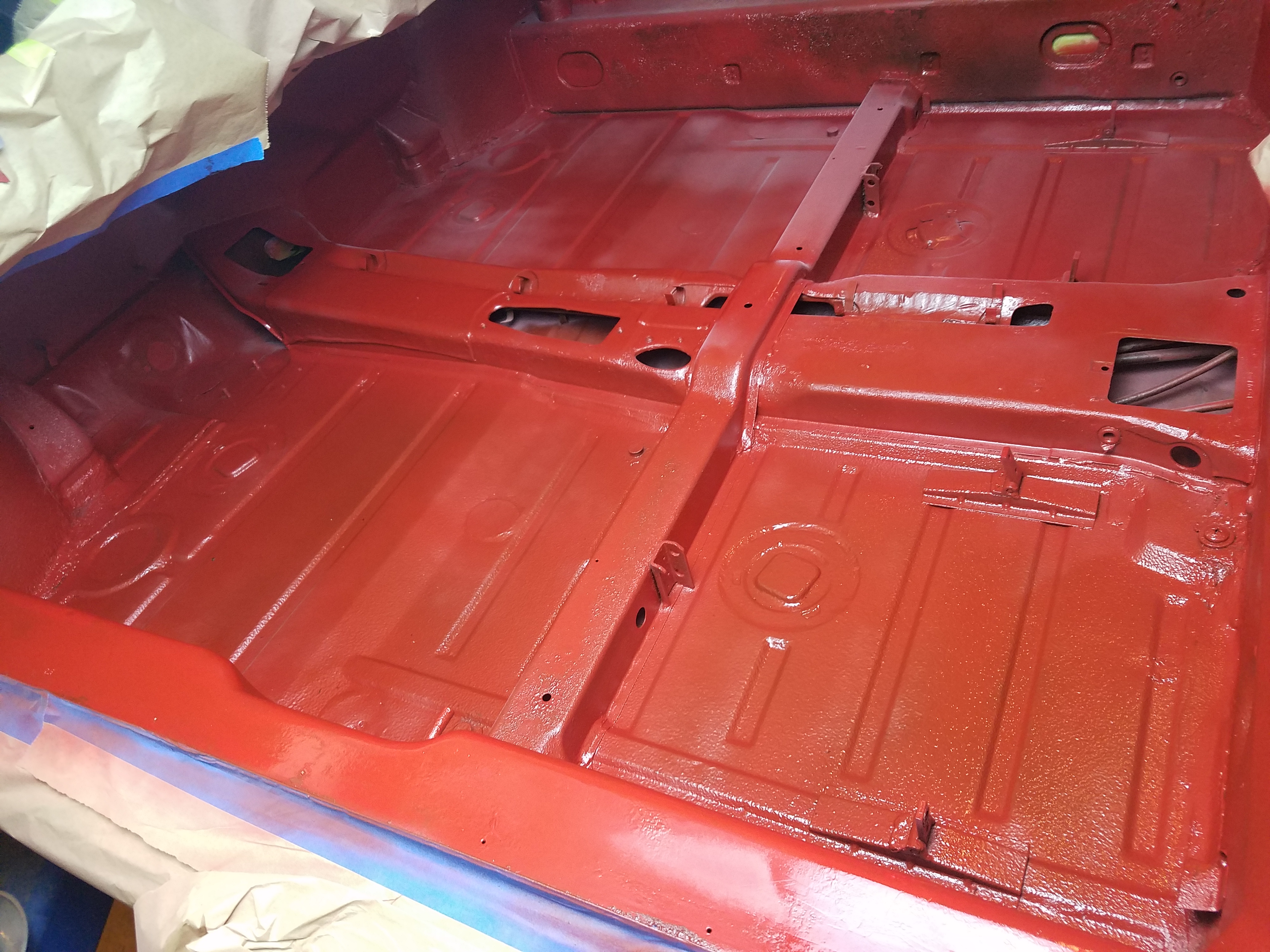

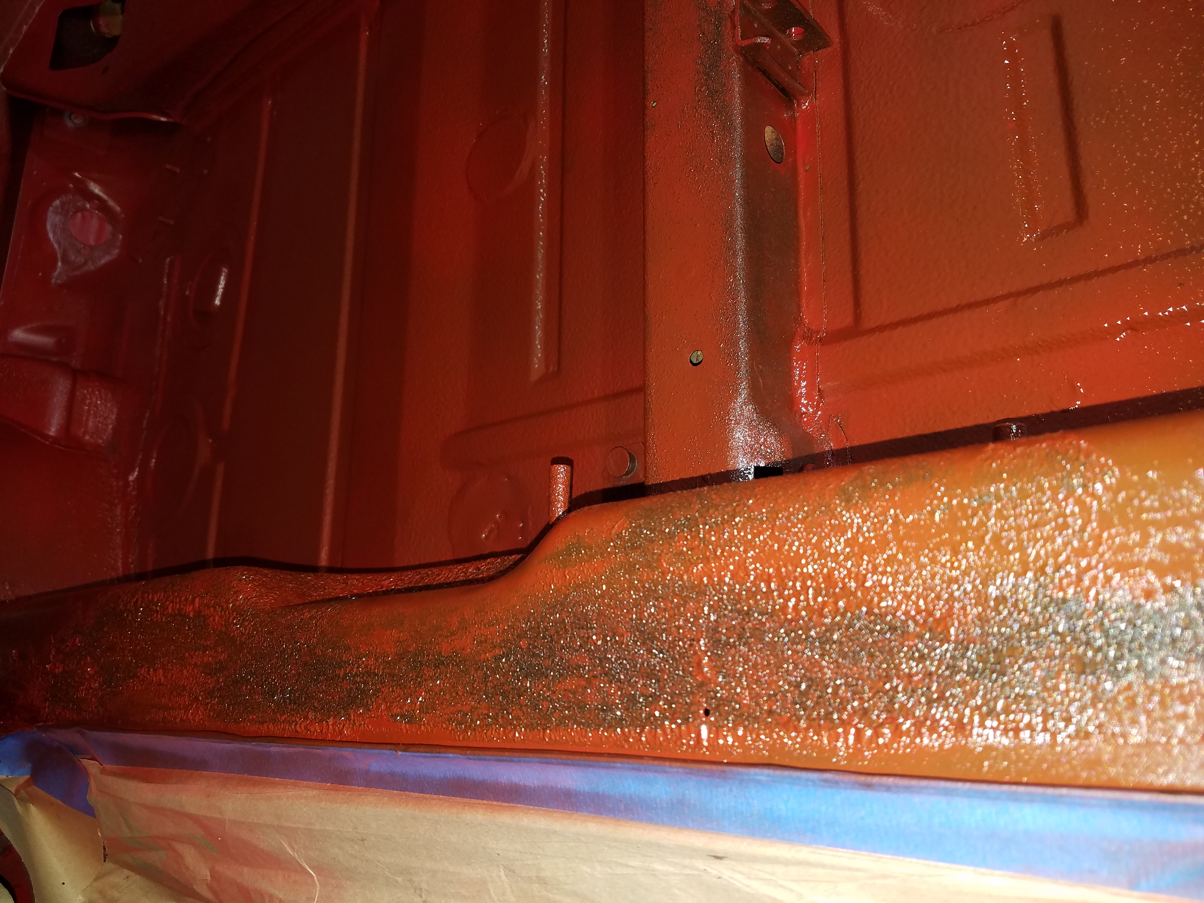

I just want to work on it every day. Lots of time working on things and then re doing them when it's not quite right. Like the paint reacting with residue from the undercoating that I accidentally put in and had to take back out frustrating but satisfying when it's done.

I know this will all be under the carpet and it won't really matter, but I want it right.

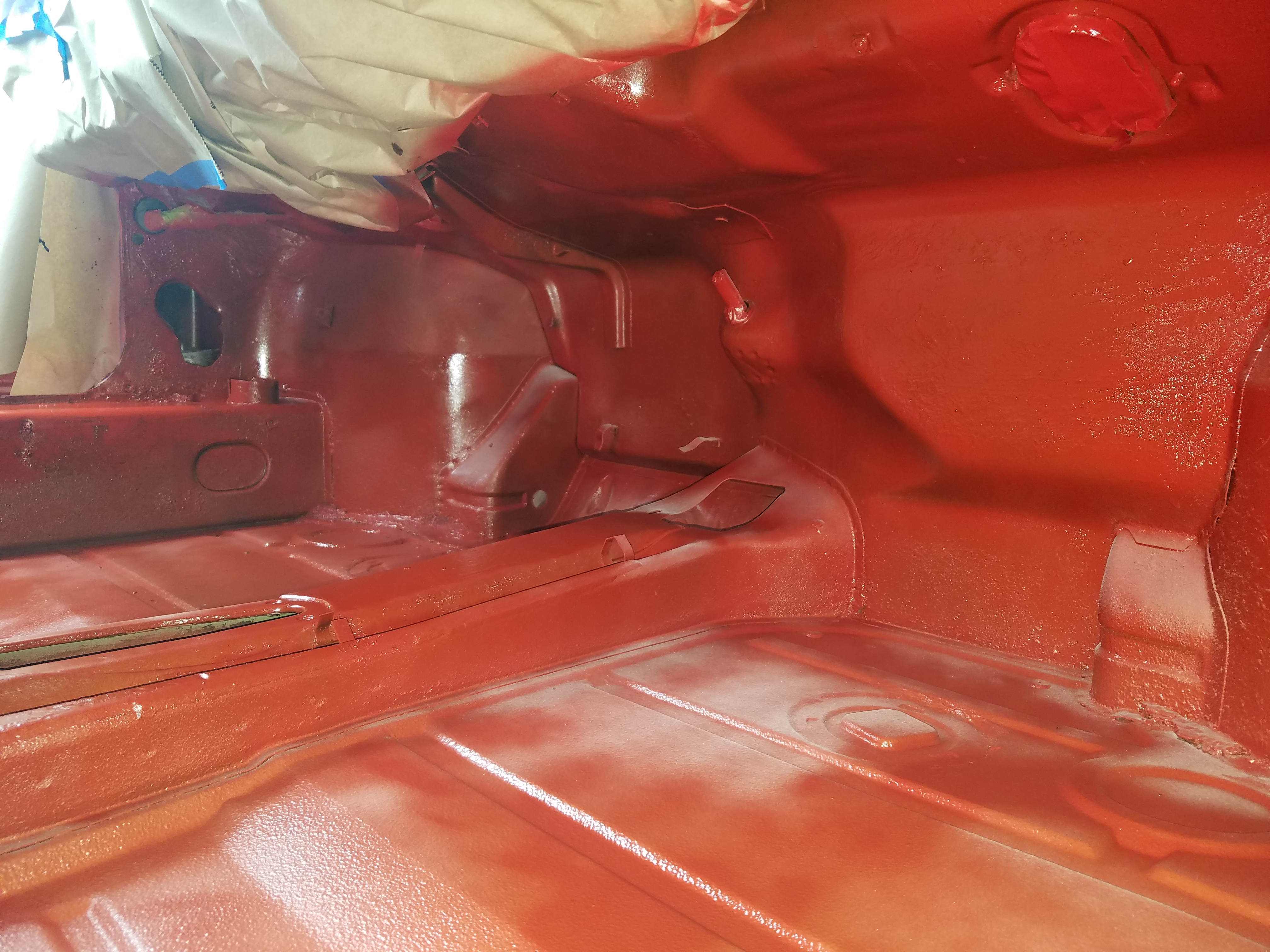

More of the color

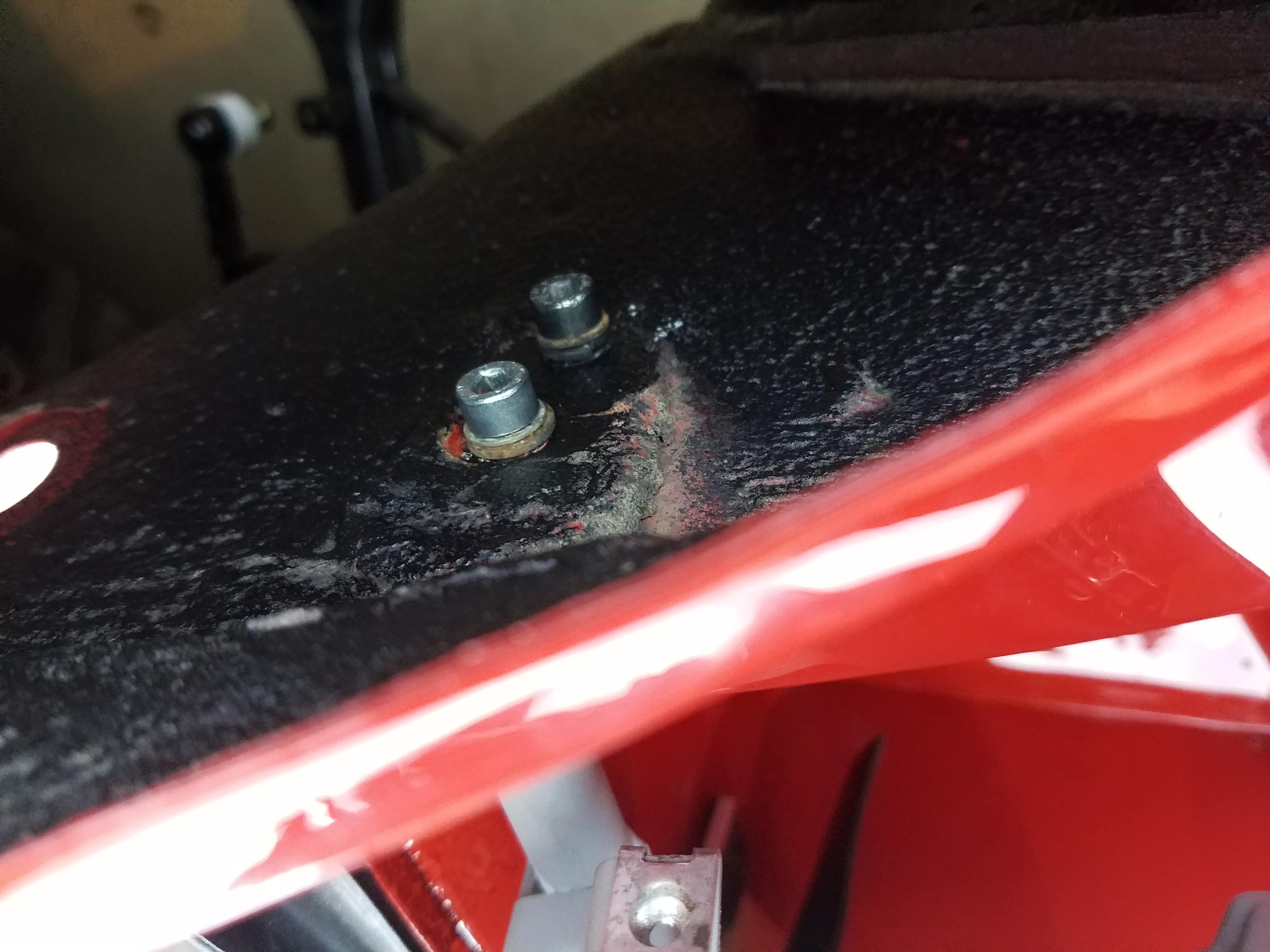

Shiny parts and new bushings

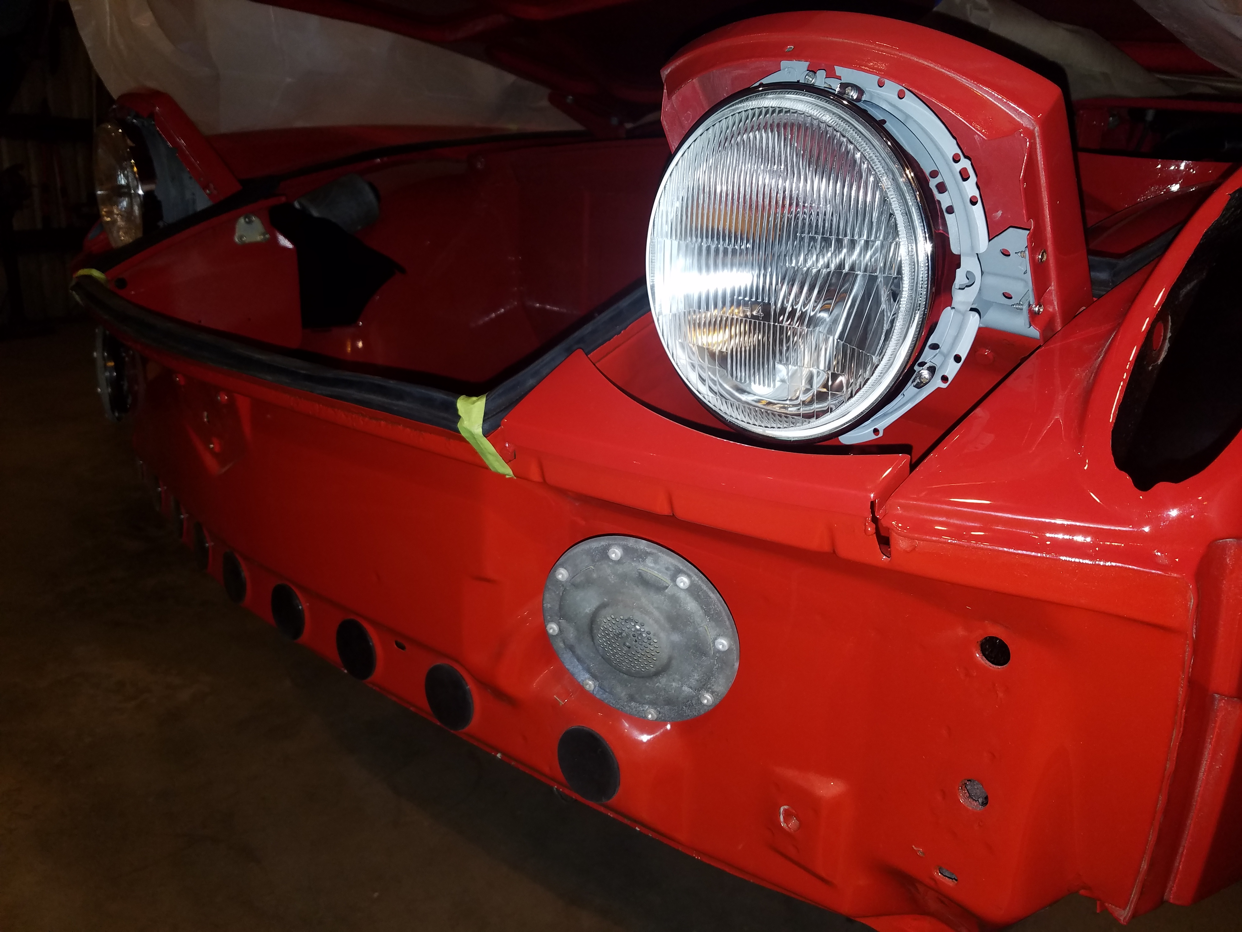

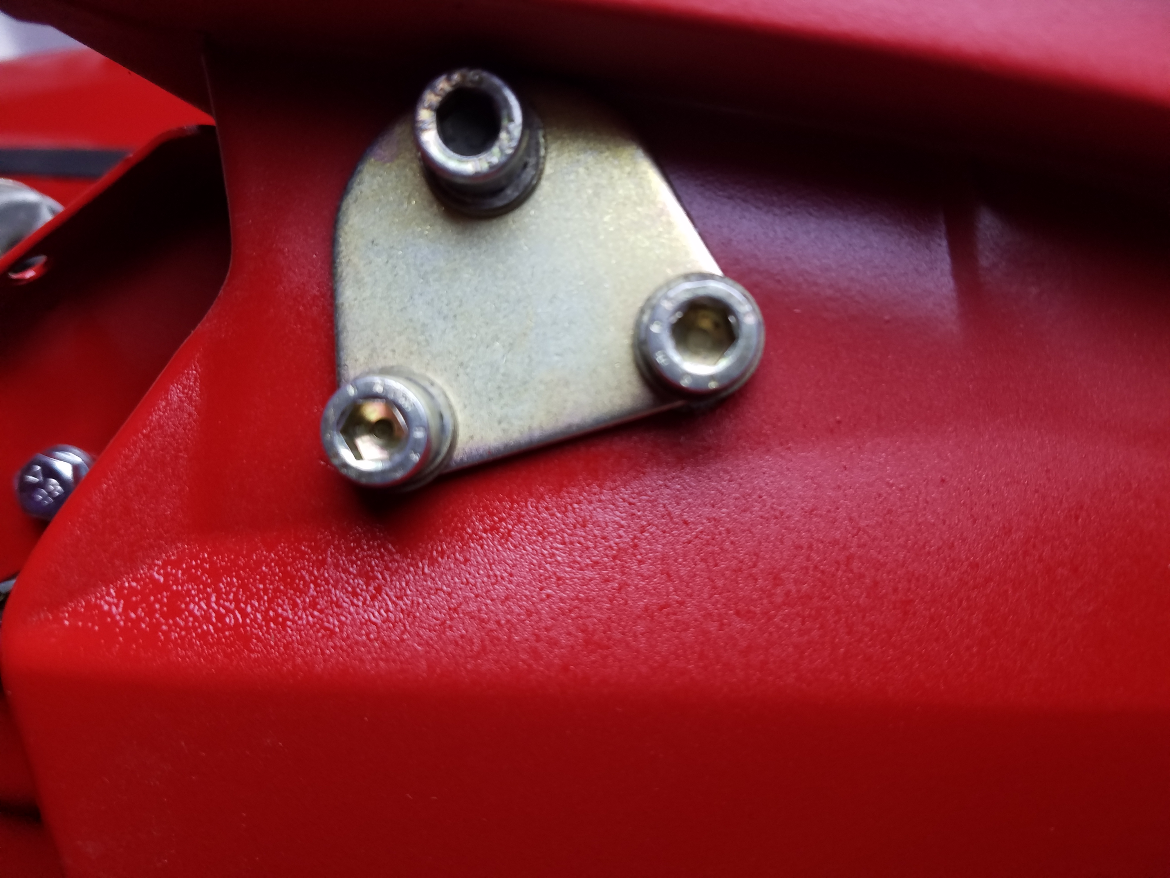

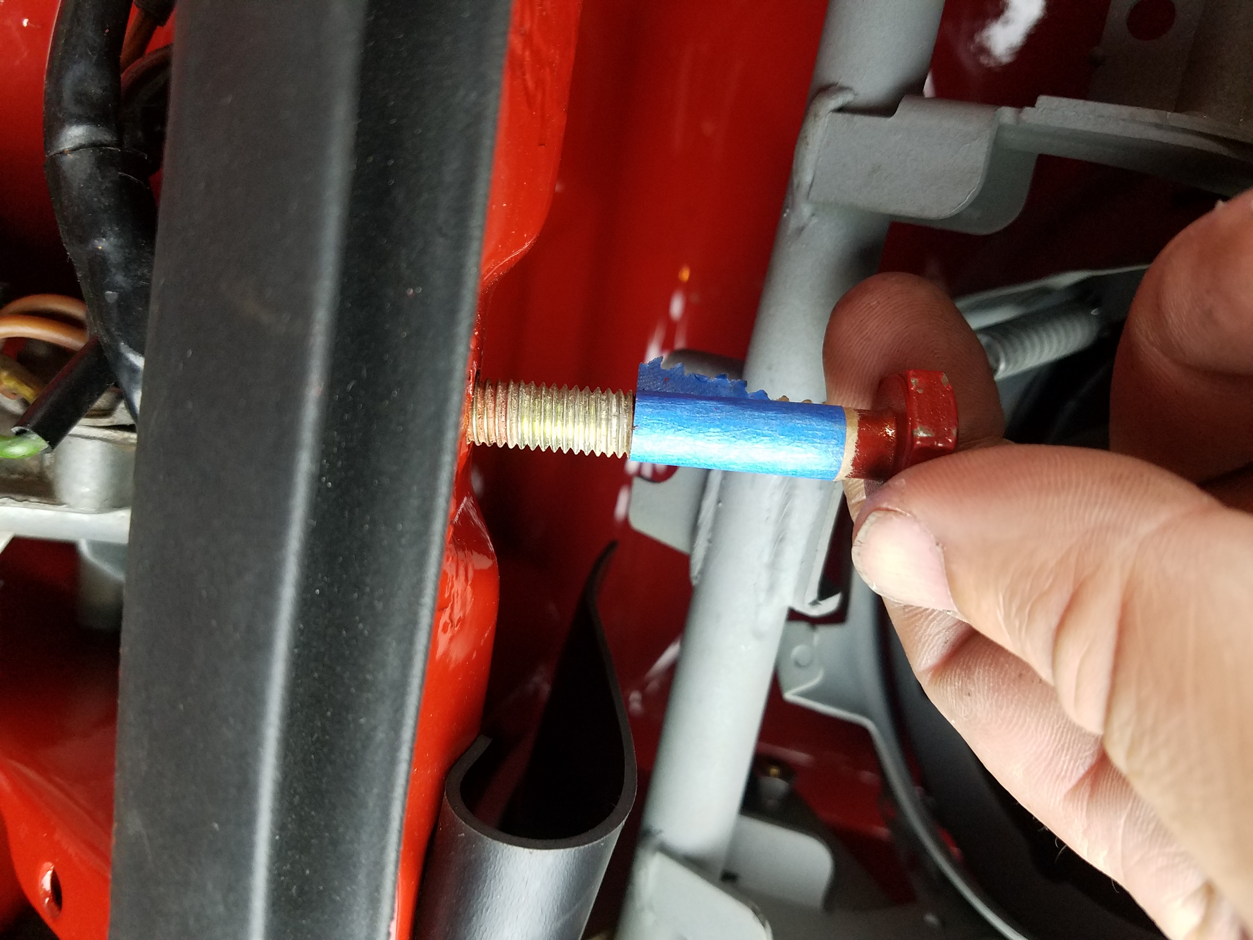

Took the painted headlight covers off and then removed the stop/ adjuster bolt
Matty900
post Aug 18 2017, 12:43 AM
Post #289
Posts: 1,291
Joined: 21-February 15
From: Oregon
Member No.: 18,454

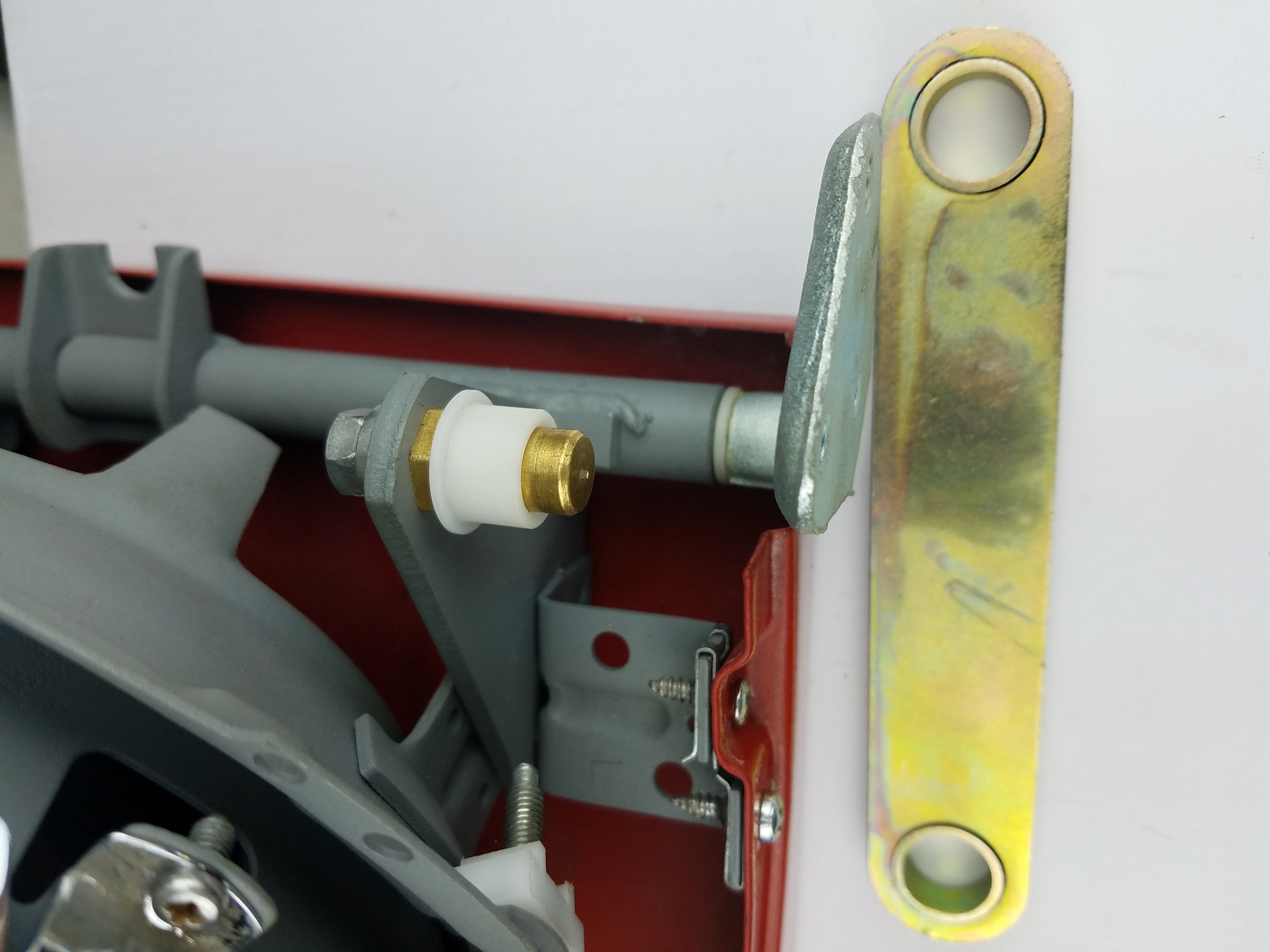

Then attached the pivots
Matty900
post Aug 18 2017, 12:45 AM
Post #290
Posts: 1,291
From: Oregon
Member No.: 18,454

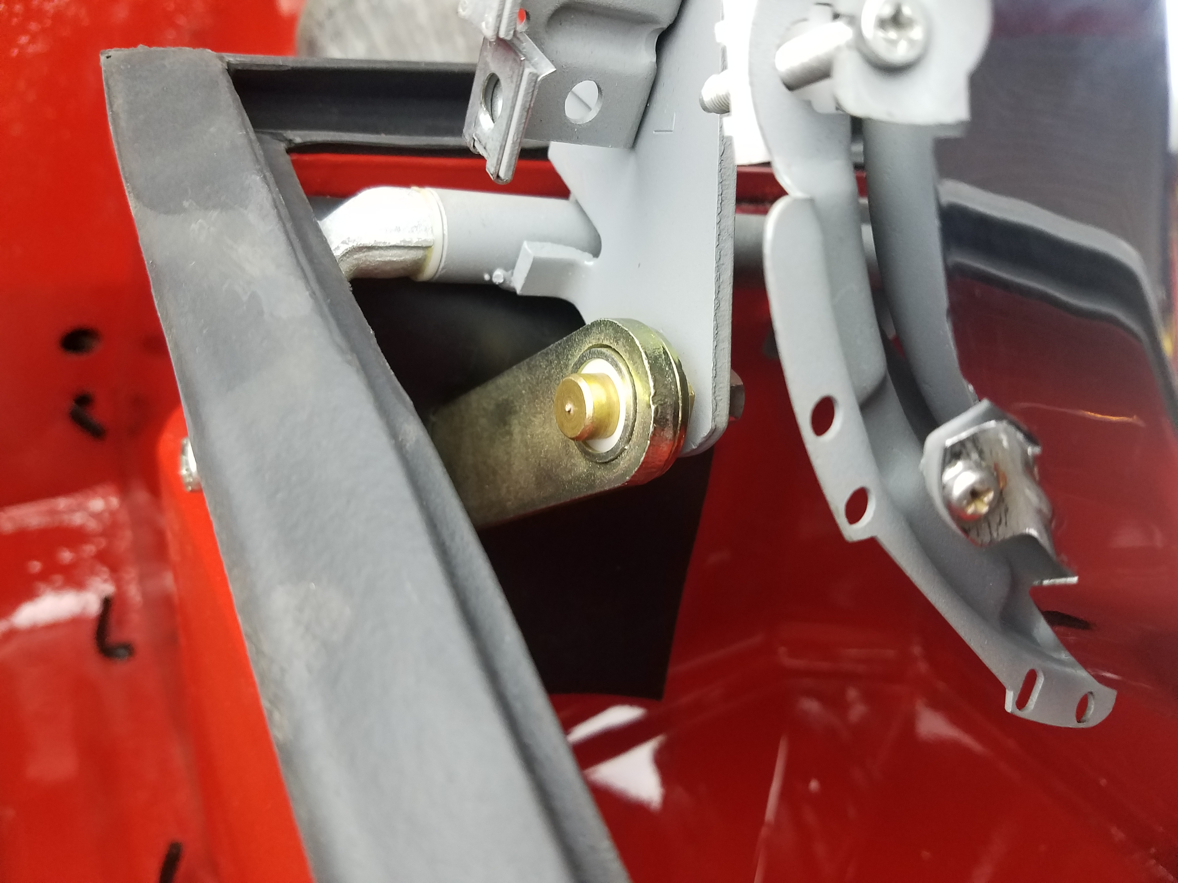

In the fender well
Matty900
post Aug 18 2017, 12:47 AM
Post #291
Posts: 1,291
From: Oregon
Member No.: 18,454
Then replaced the adjustment stop bolt after running a thread cleaner over it and through the nut.

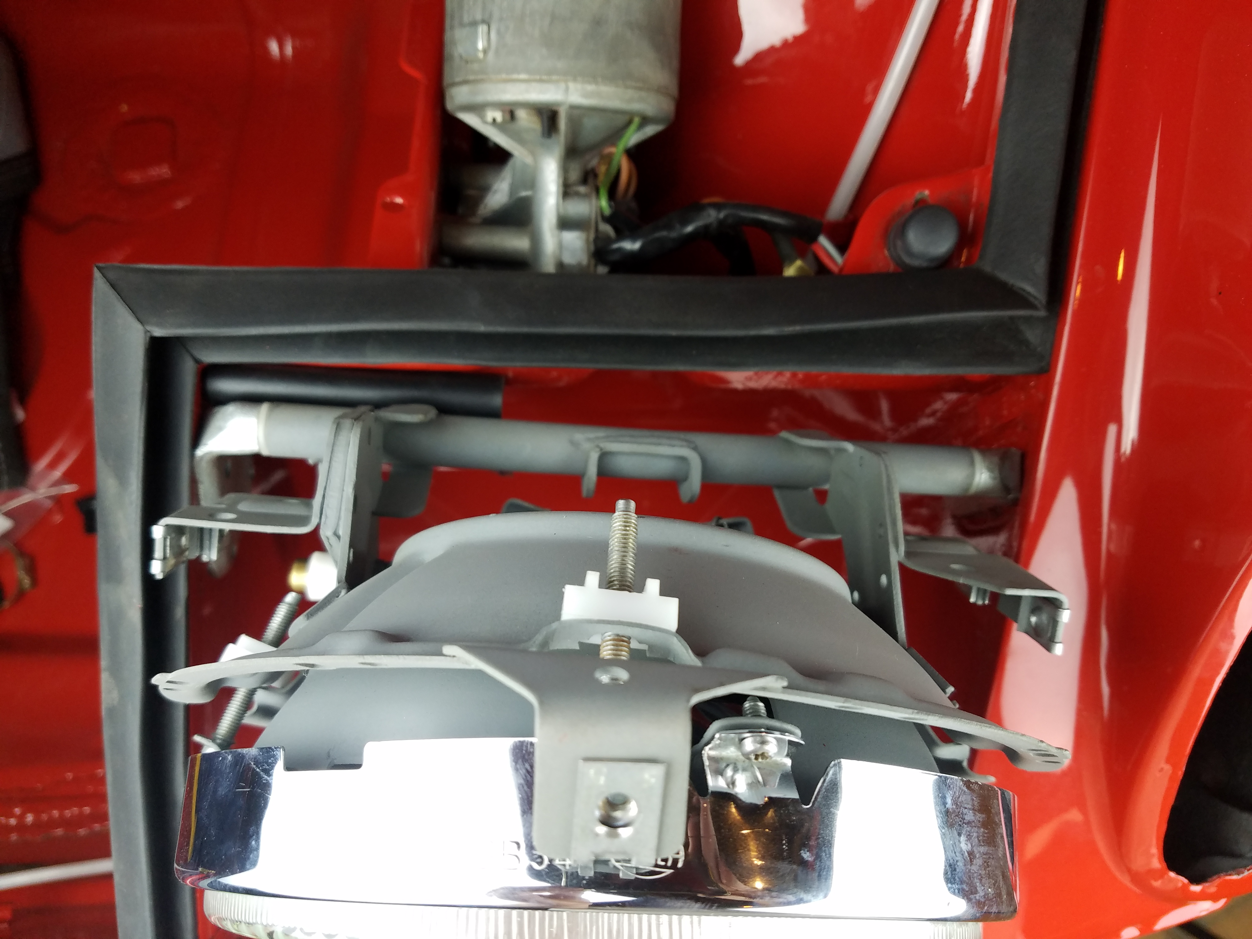

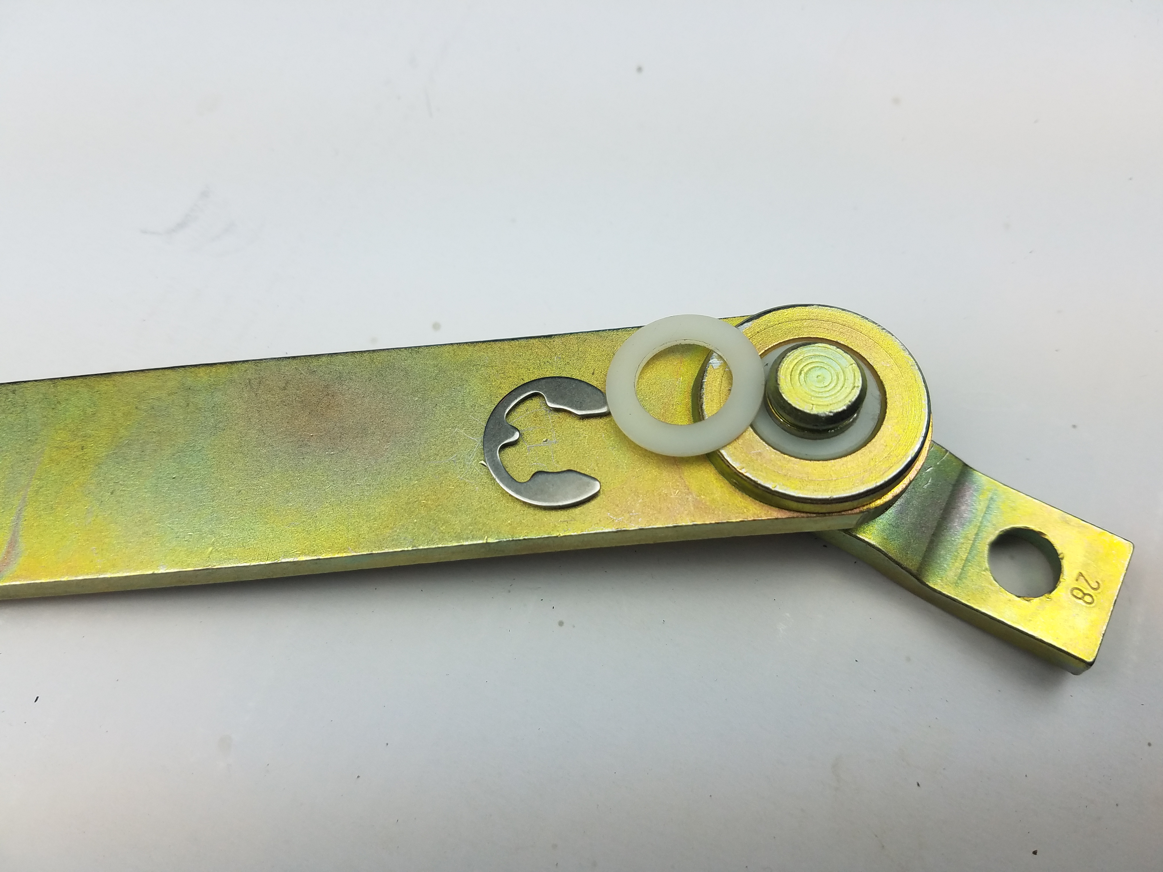

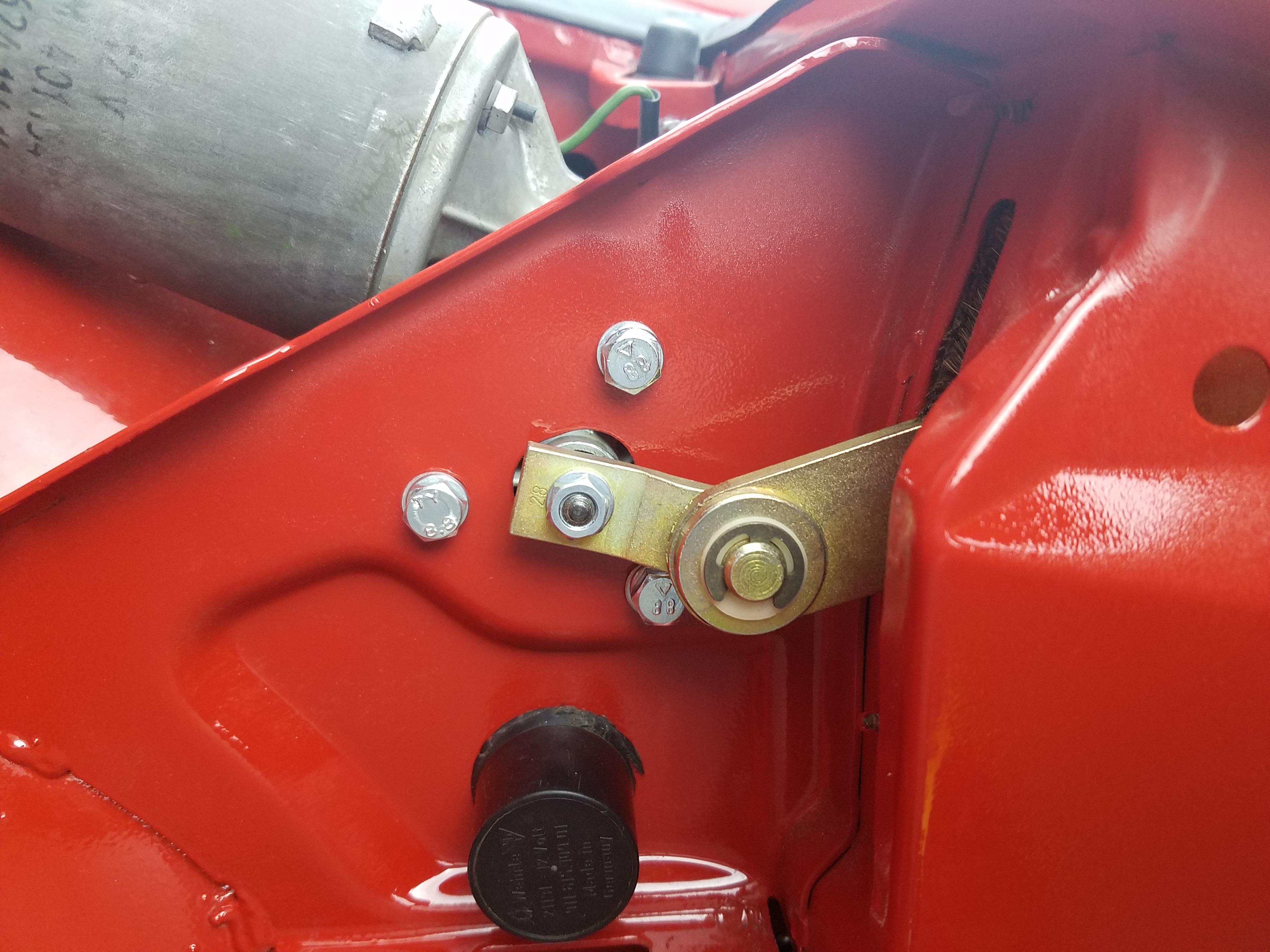

Attached the push arm to the armature and the armature to the motor. Kept everything loose to give me wiggle room to get everything connected.
Matty900
post Aug 18 2017, 12:54 AM
Post #293
Posts: 1,291
From: Oregon
Member No.: 18,454

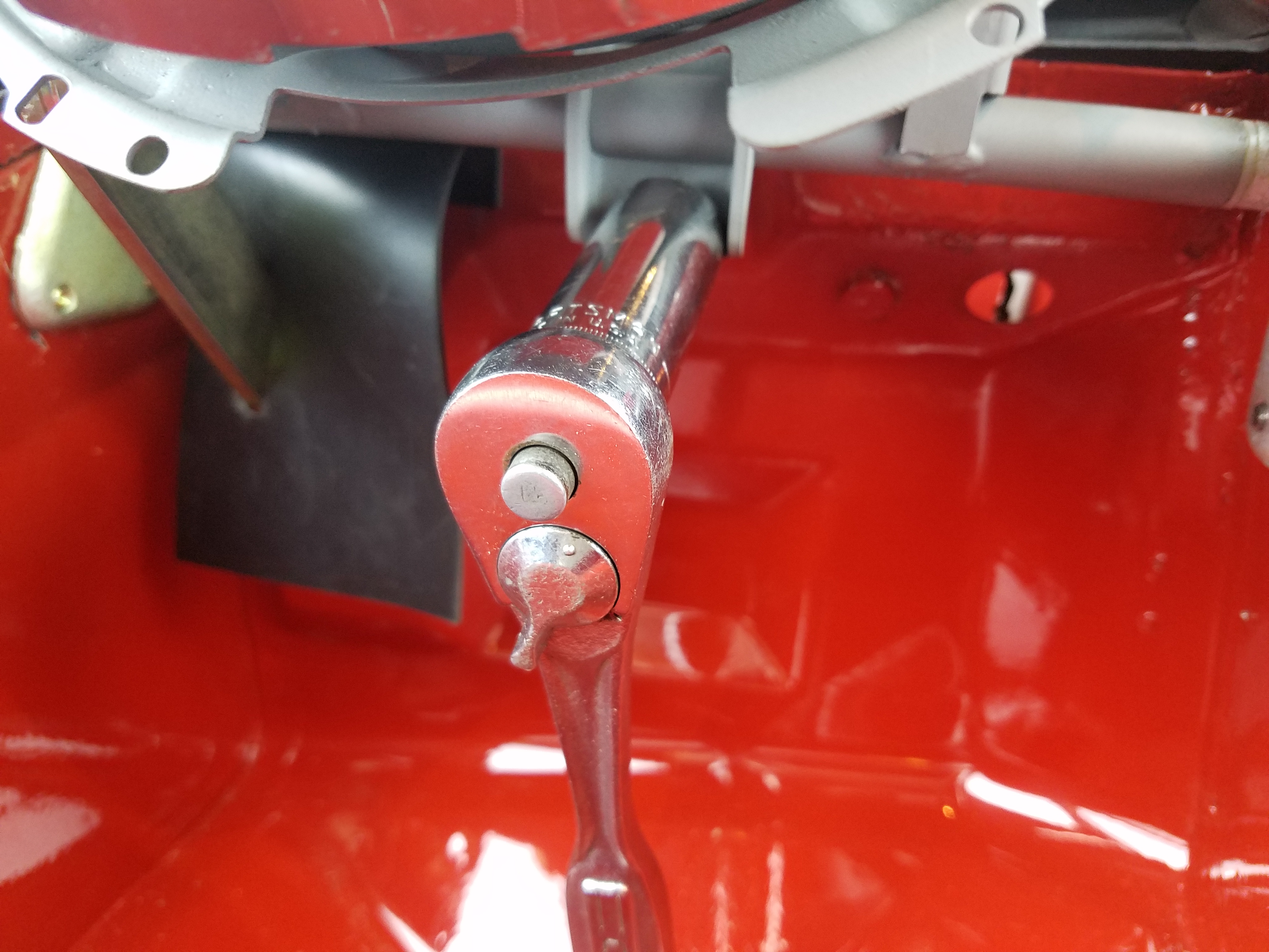

Attached the push arm to the housing assembly. Then tightened up everything.

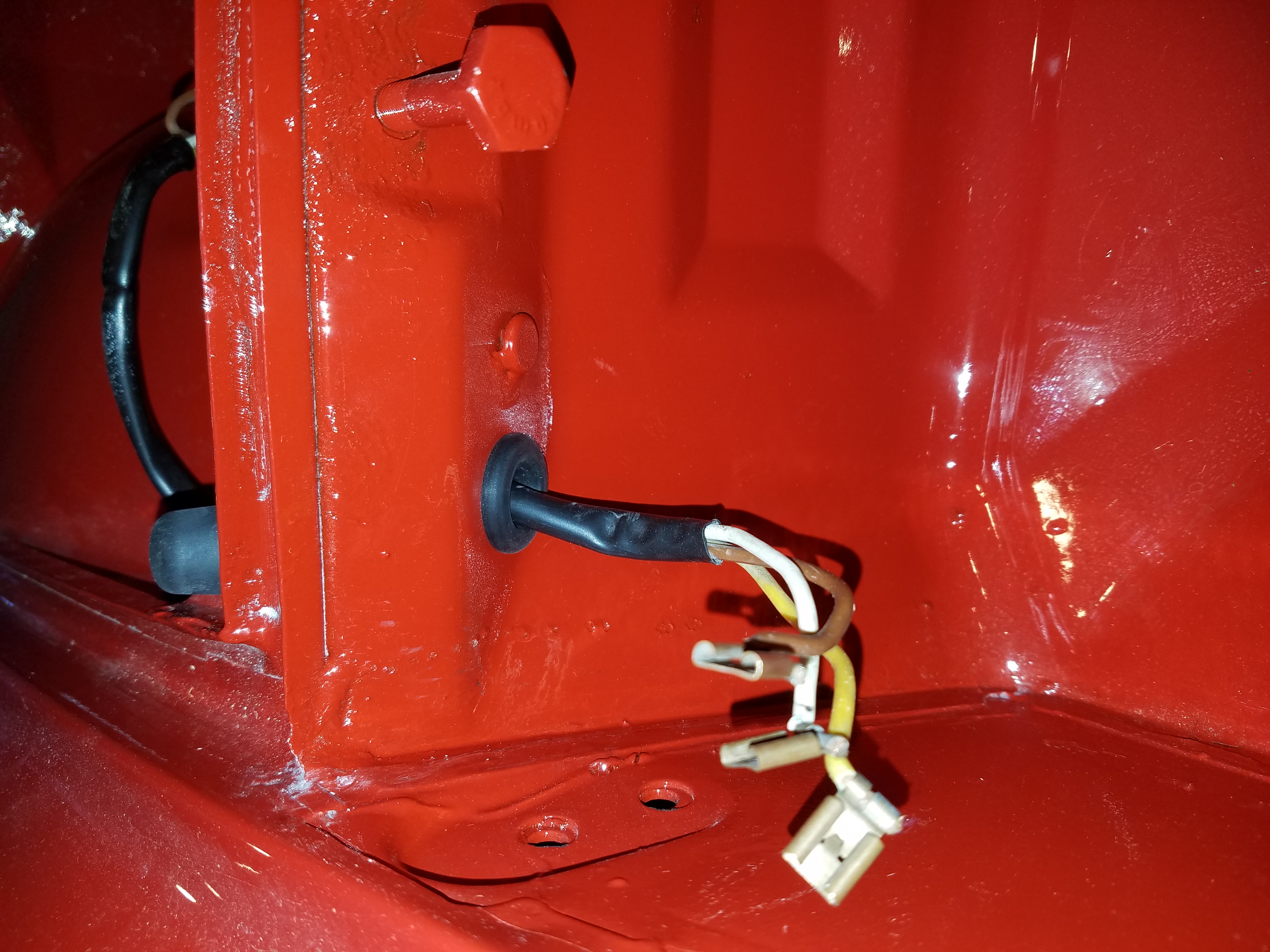

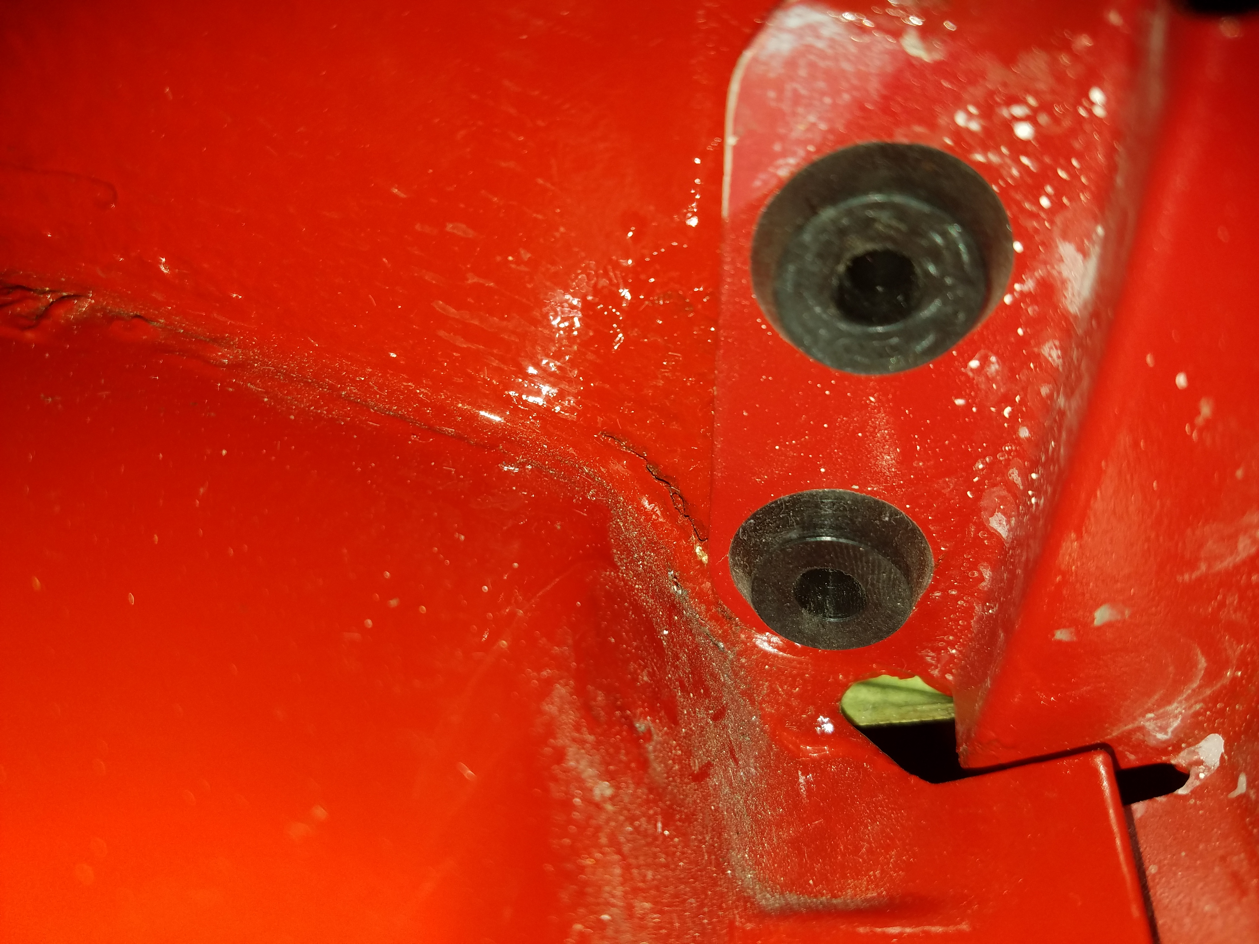

This is when the wires and new grommets should be in place

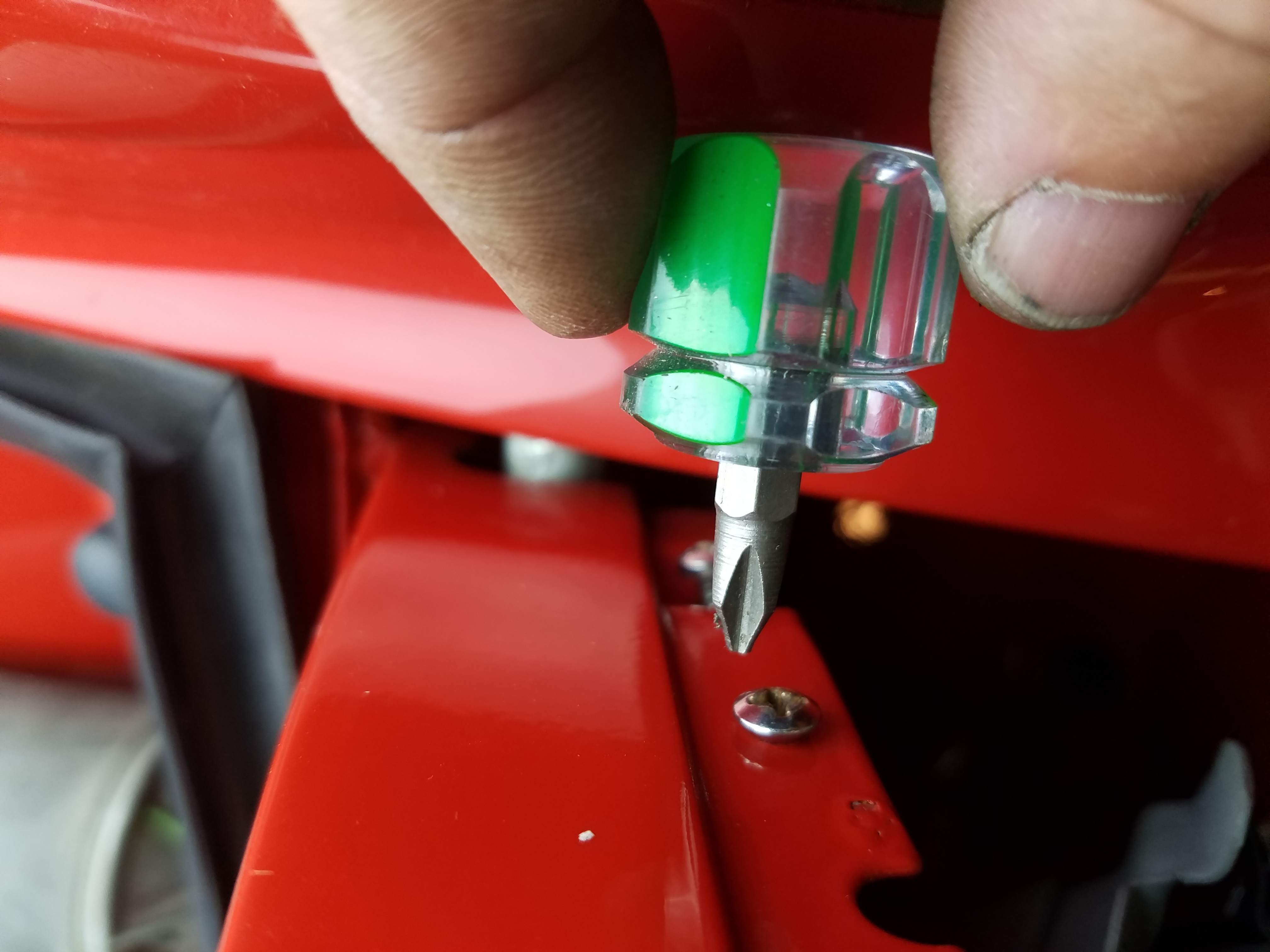

Screw on cover. (Photo is showing the wrong screw location. It is actually the ones be hind this that are recessed. Screws do go in this location, but go through the cover 1st.

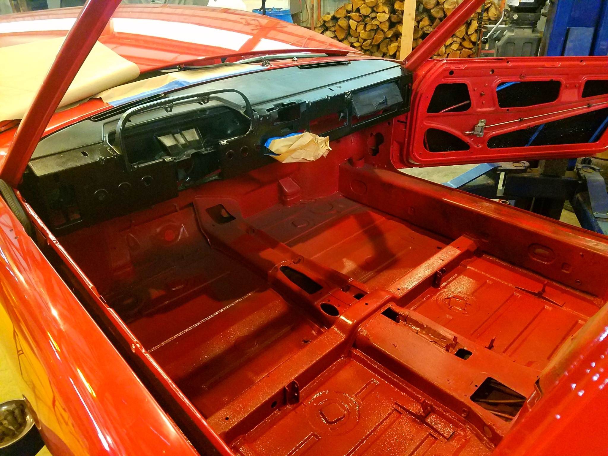

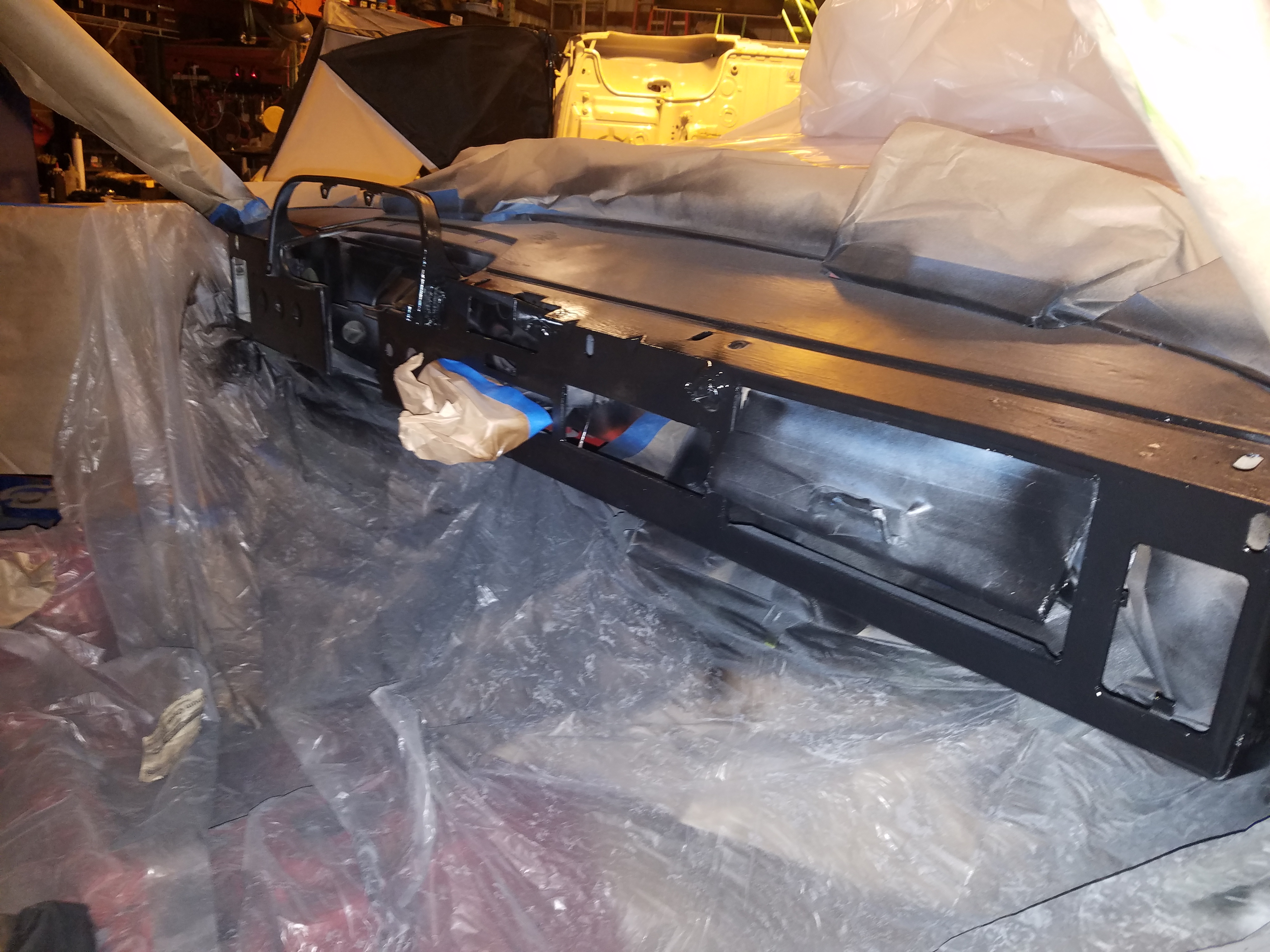

Painted the dash
Matty900
post Aug 18 2017, 01:14 AM
Post #299
Posts: 1,291
From: Oregon
Member No.: 18,454
Ready for parts!
