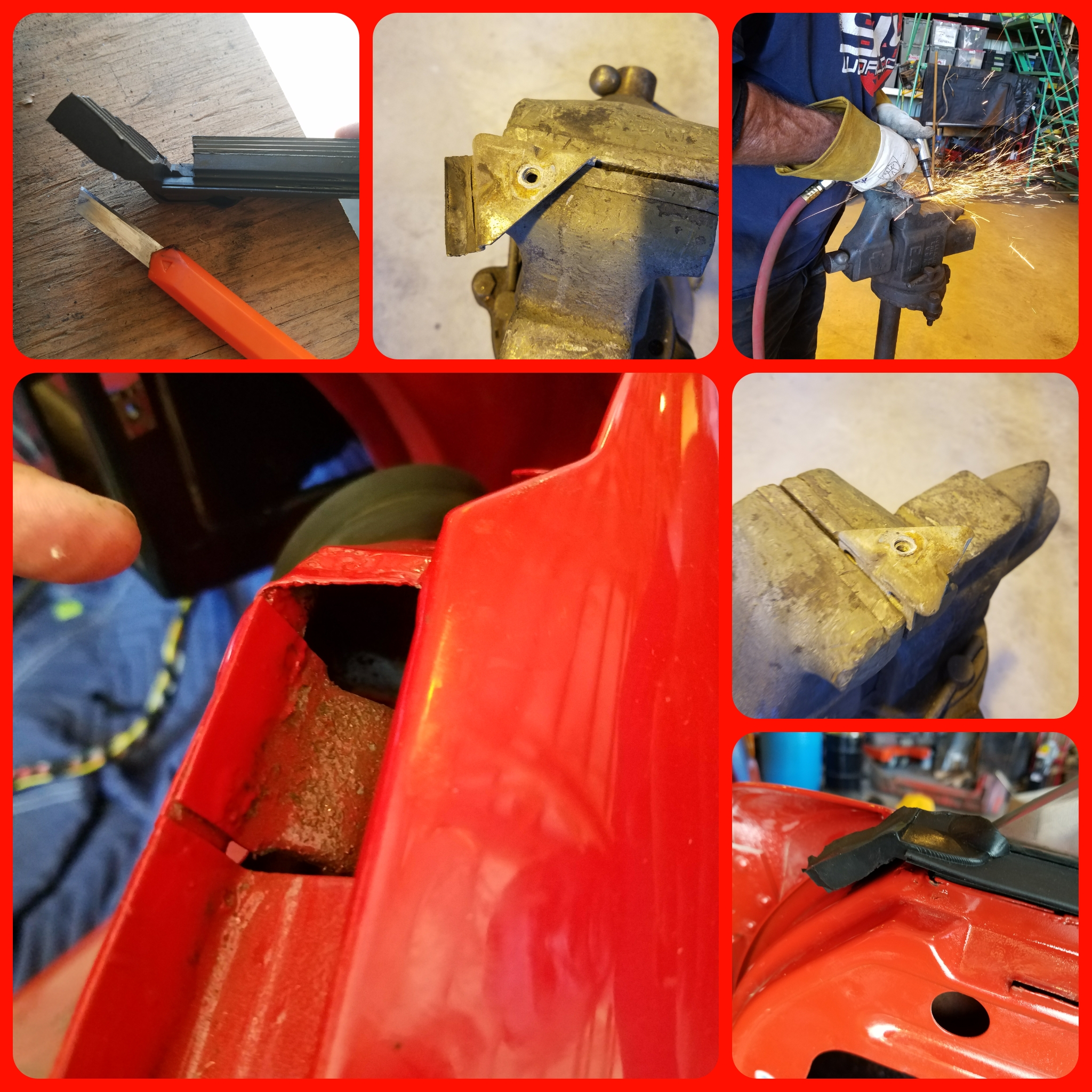

Got a Little Help from 914rubber boys yesterday. My brother Mark, shop manager Scott and interior artiste Justice came out for the day to try and help me get some things done.

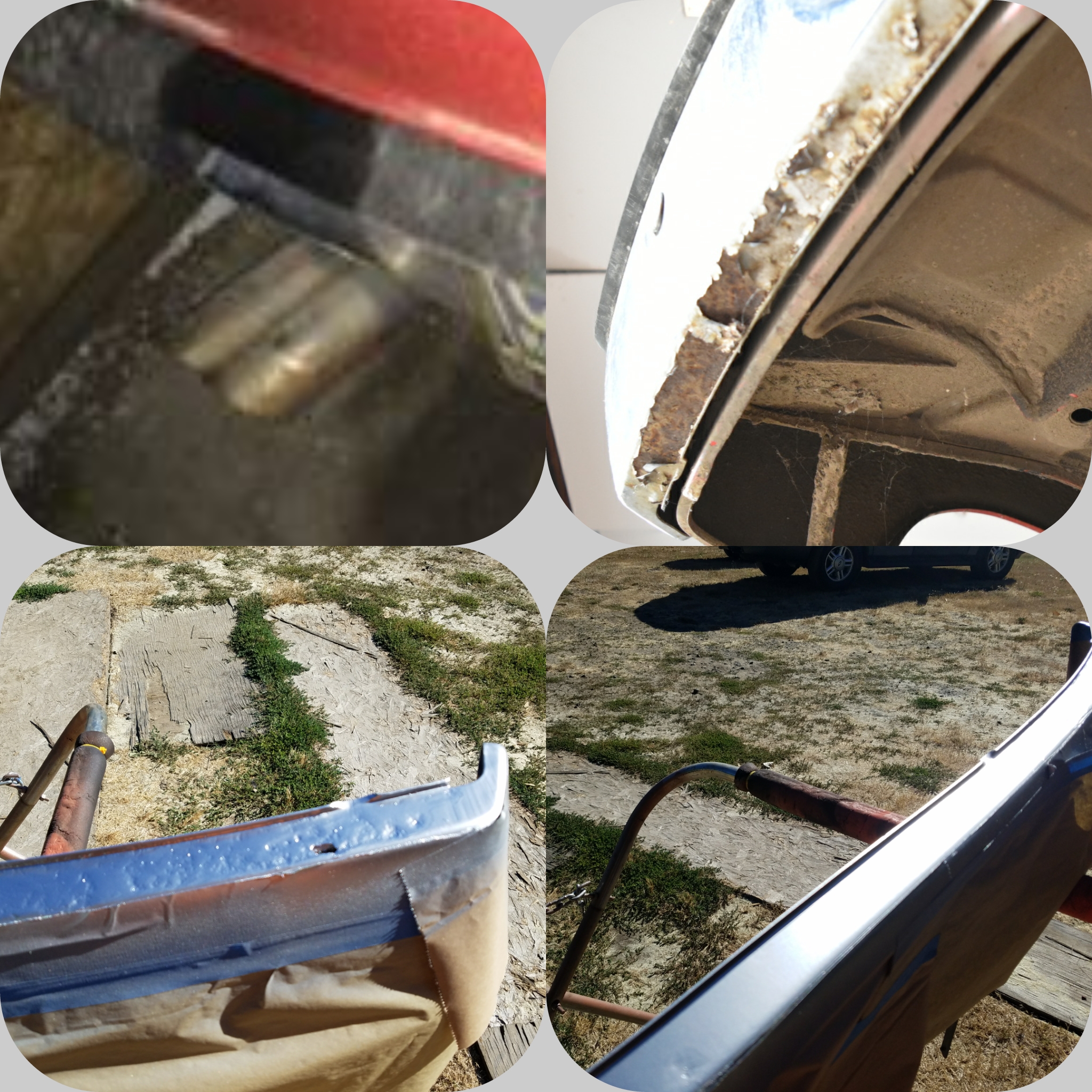

Previous owner thought dual exhaust would look better. So he removed the stock lower Valance and put a dual tip exhaust on the car. The heat from that destroyed the Chrome on the bottom lip of the bumper. Scott took a sander and a die grinder tipped off in Edge and knock down all of the flaking Chrome. Then primed it with acid etch primer, lots of filler primer, sealer, high temp chrome paint, High reflective mirror chrome paint, and clear. Turned out pretty decent compared to what it was.

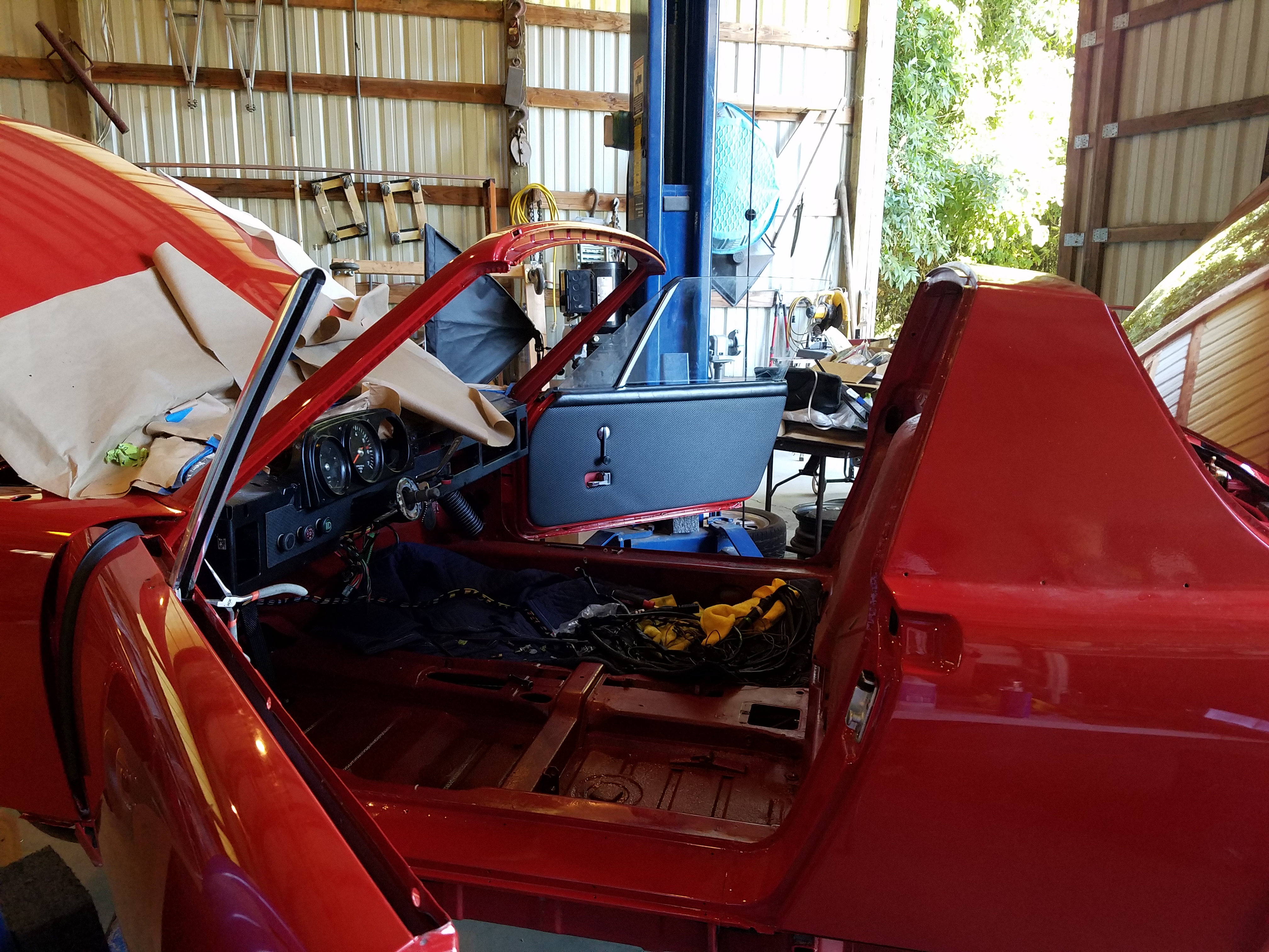

Justice helped with the door and reinstalled the steering column. Within realized that the new Dash face metal was in the way and had to take it back off to get the column on first (IMG:style_emoticons/default/headbang.gif)

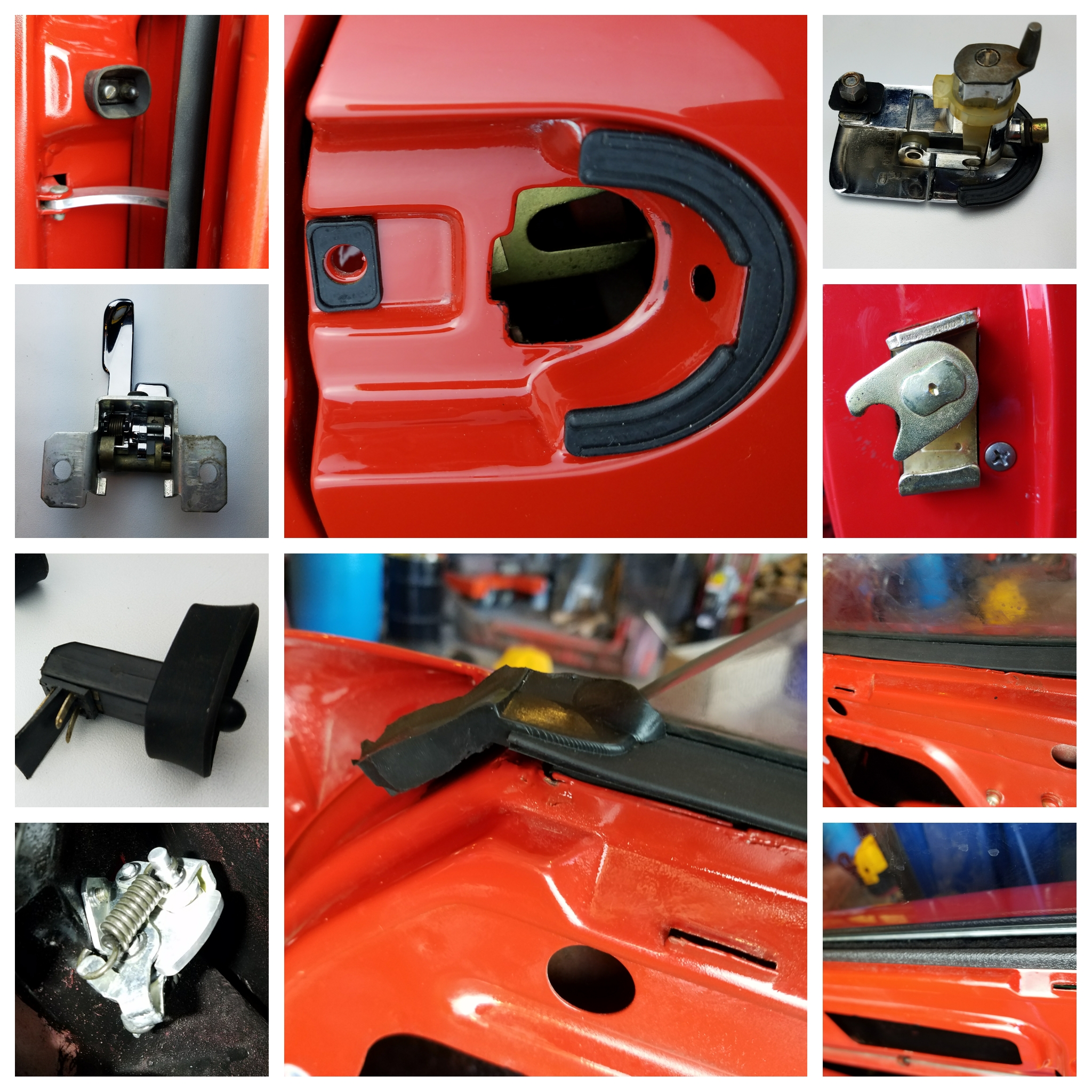

Mark (Mikey914) did the passenger door For me and found some variations to the early door that adjustments needed to be made tou the parts going on the car, that I would have not figured out. (IMG:style_emoticons/default/aktion035.gif) you rock thank you for the help Big Brother

All new 914rubber parts on the door. Door stays rebuilt, the door handle didn't need to be rebuilt but I put new rubber seals in. Cleaned up the door switch and put on a new rubber piece. New door card clips and plugs. New triangle window seal, new aluminum track with fuzzy and outer scraper new inner fuzzy ..... (IMG:style_emoticons/default/dead horse.gif) you get the idea. Zinc plated the door mechanism

One door down one to go

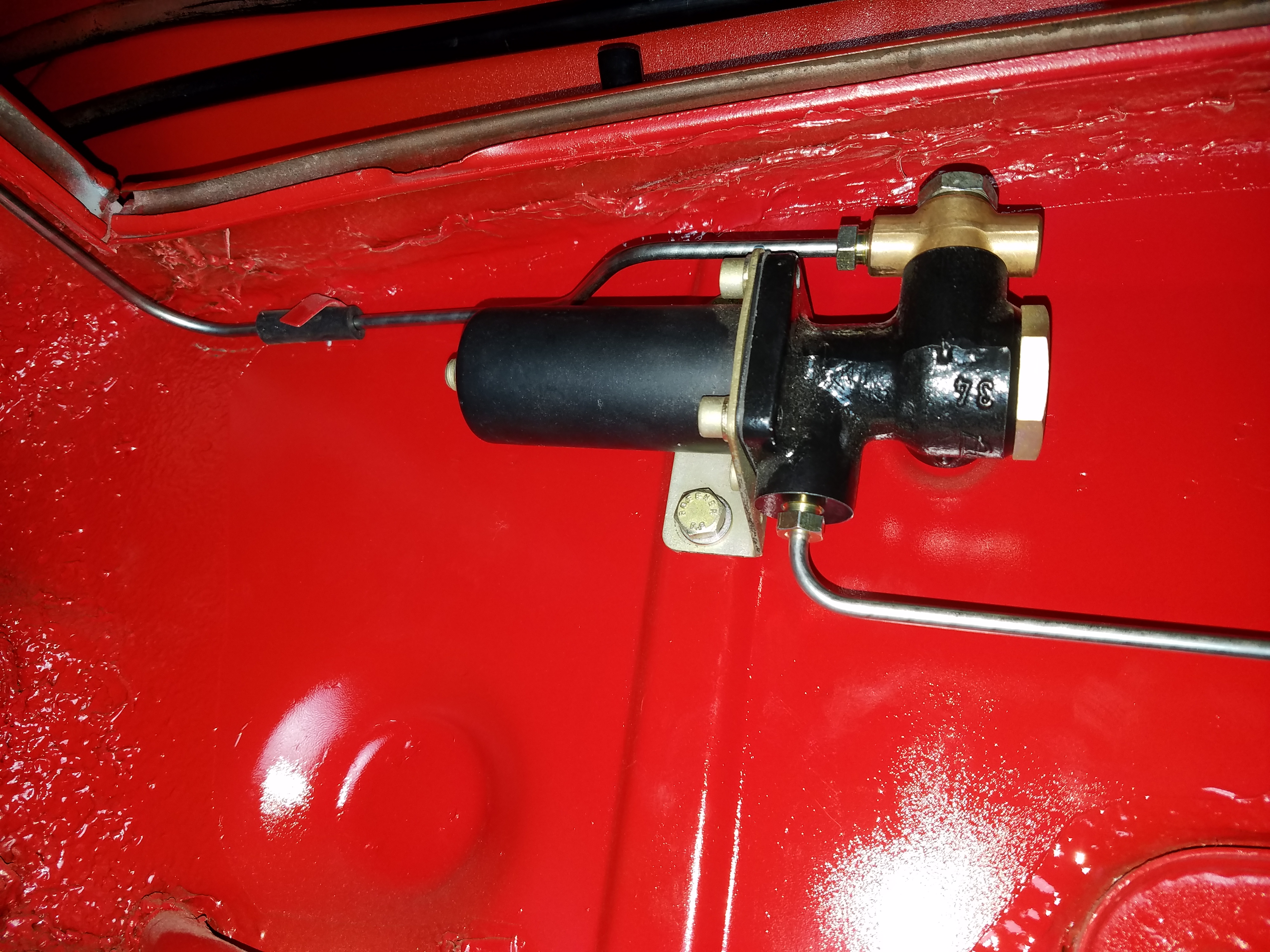

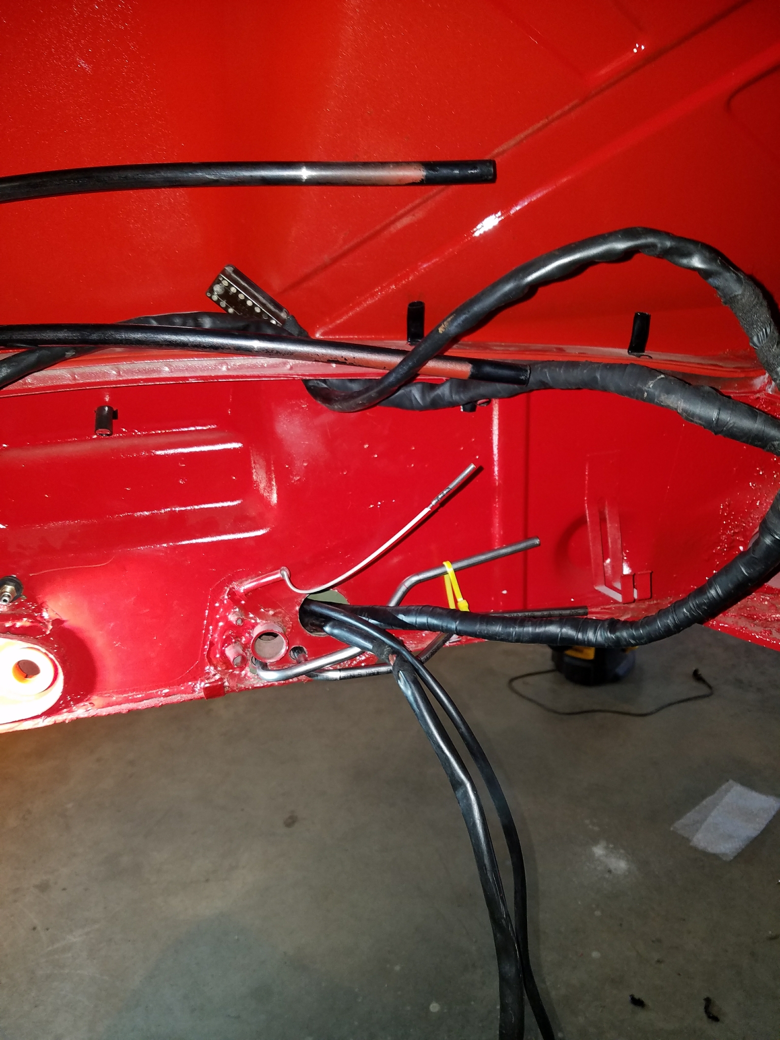

Eric at PMB, rebuilt my brake balancer. Got that on last night at about 2 in the morning with some of the brake lines before I finally called it quits

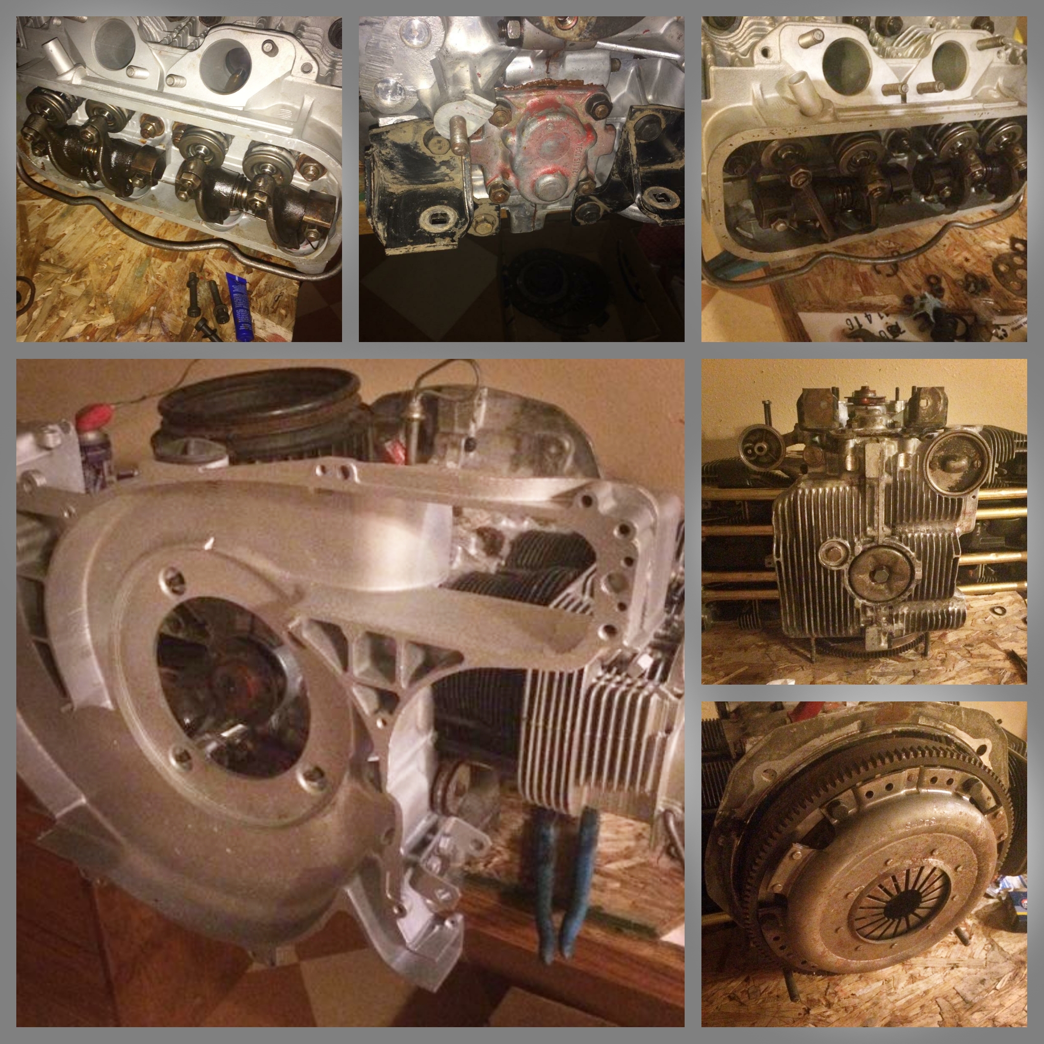

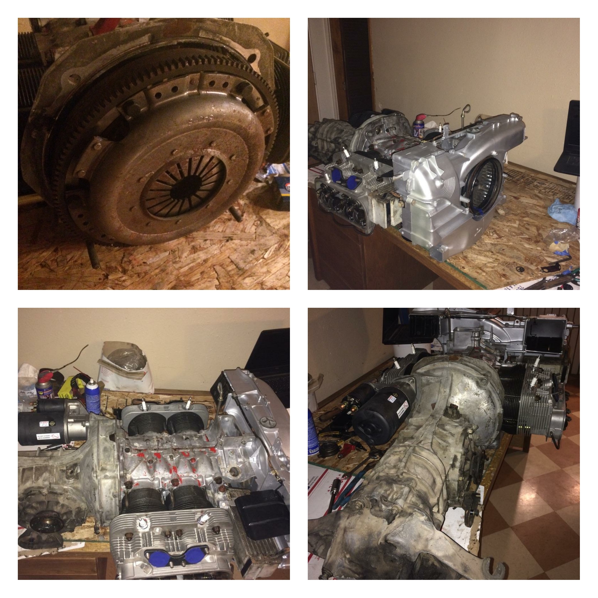

Engine should be done on Saturday. Carb still need to be rebuilt working on transmission swap to the side shift now and mating it it to the engine block

OK....I'll bite.
What "adjustments" needed to be made to what parts for your door assembly?
Is there a difference in this between early and late cars?
Also did you test your door contact switch (the one with the 4 small male prongs) to see if it works?
On mine, both door contact switches were shot.
If they don't work, they are a "bear" to find in working condition.
I finally found a couple of old VW bus switches to do the job.
These 4 contact switches are only needed if you want the buzzer to sound if you've left your keys in the ignition switch with the door open.
Otherwise, a simpler and easier to find 2 prong door switch will work....plus some studying of the wiring harness to see which wires aren't needed anymore and can be taped up.

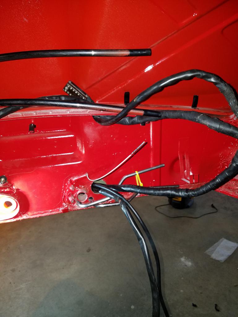

Another very late night. Today we got the wiring harness all back in place.

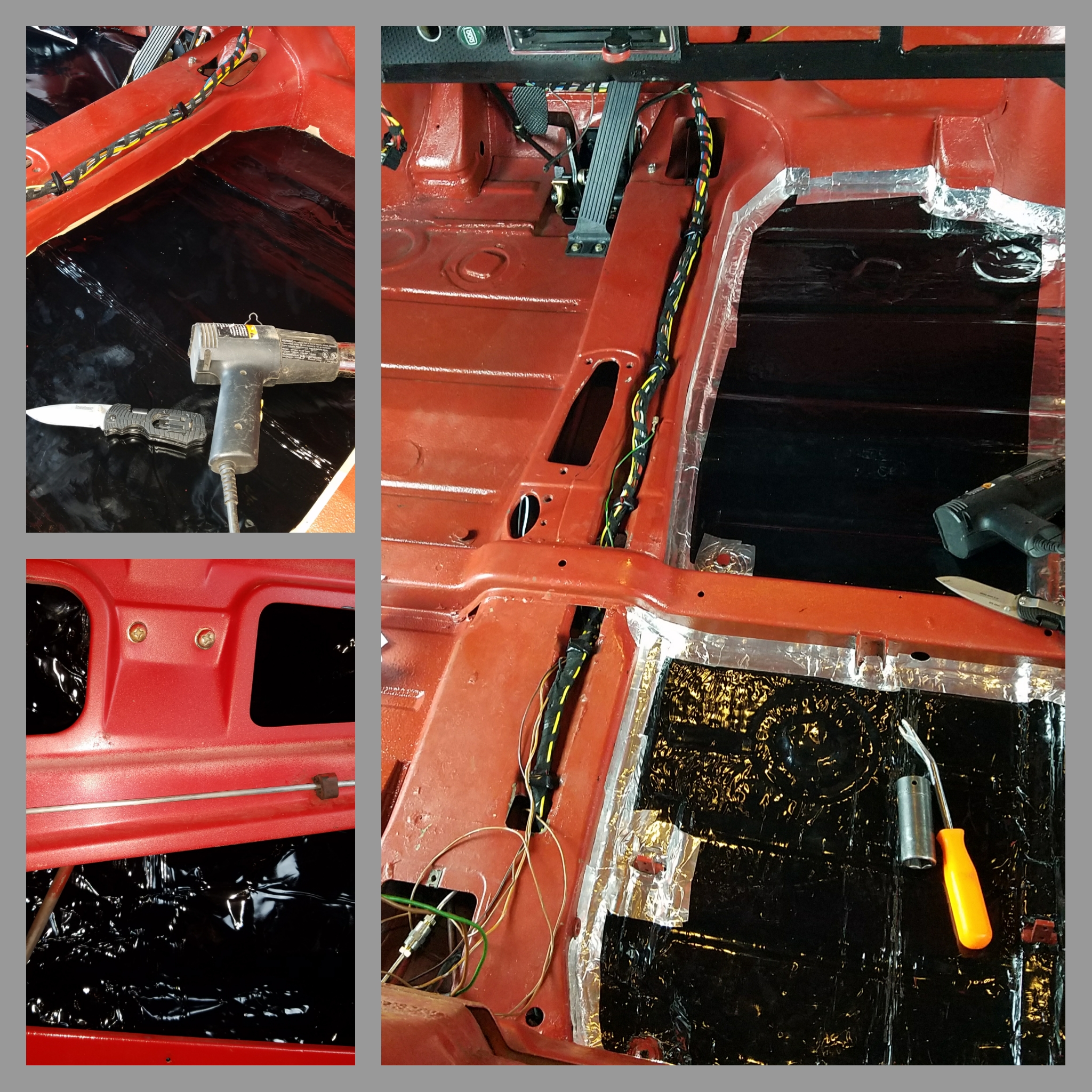

A buddy of mine was able to get me some hushmat at the last minute. So today I went and pick that up head got it installed in the passenger door and the passenger floor pan. It takes a little time but it goes in nice. I'll be interested to see if I can tell the difference between noise and this car and others.

They done well do it right up on it to explain it more but basically there's an extra tab of metal internally that needs to be shaved off and the front of the window channel has metal protruding into it that is not there in later doors so the triangle window seals that are the superseded part need to be knocked out to accommodate that piece of metal
As far as the door switches go I got them very clean and added a new Rubber seal to them and that's as far as I got. The car was maintained and stored so well I'm hoping they will work just fine.

Motor is now almost completely built and mounted to a 73 side shift transmission. Not enough time to clean it up at this point I'll have to come back out and get rebuilt later. They are ready for me to pick it up in the morning which is now only a few hours away so I better get to sleep (IMG:style_emoticons/default/yellowsleep[1].gif)
