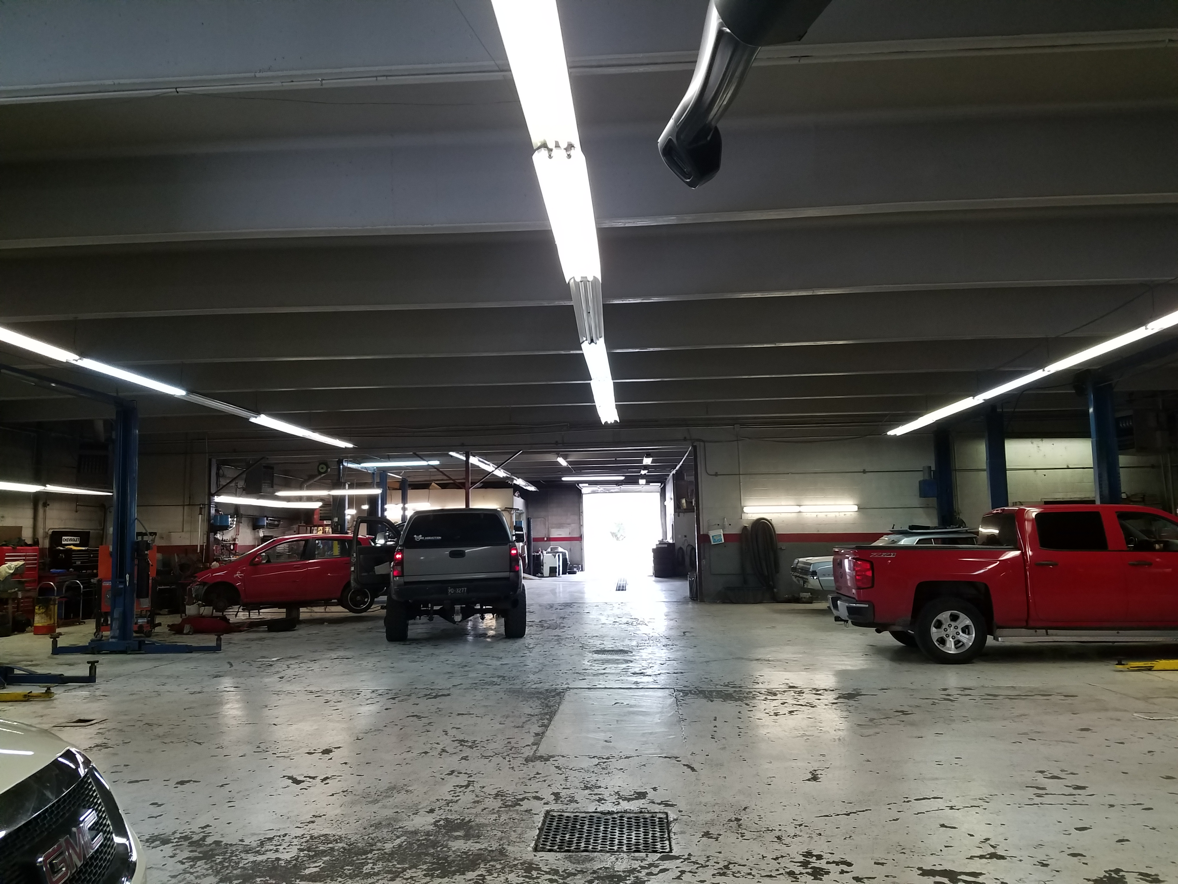

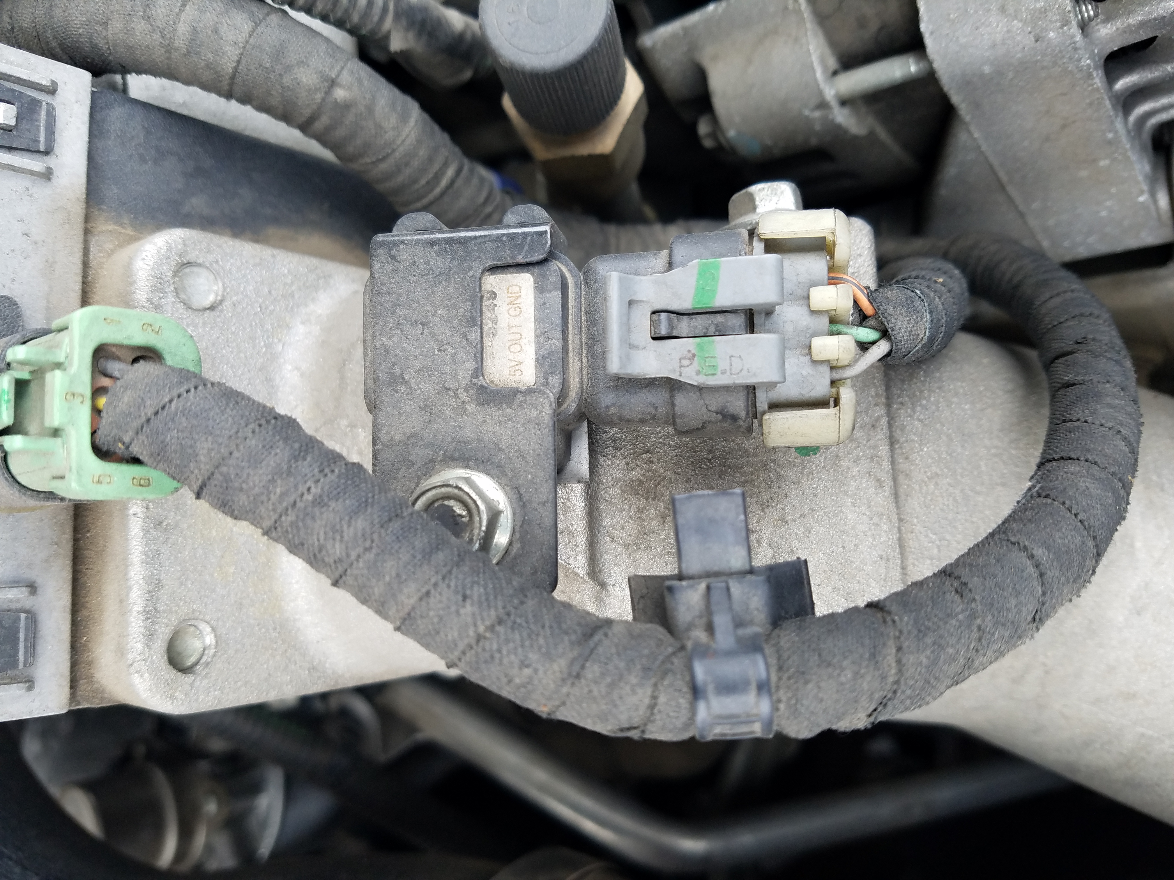

Made it in to Utah and had and engine light come on in the truck and started loosing power. Limped into an auto parts store and pulled the codes. I replaced the Map sensor and the Mass Airflow sensor and reset the codes. Pulled out, still dogging out. Turned around and went to a dealership to have them check it out. (IMG:style_emoticons/default/huh.gif)
Matty900
post Sep 14 2017, 03:05 PM
Post #463
Posts: 1,291
Joined: 21-February 15
From: Oregon
Member No.: 18,454
Dealership ran Diagnostics found that the map sensor I just bought from O'Reilly was bad. Put the original one back in it reset all the codes and went and drove it out runs fine (IMG:style_emoticons/default/WTF.gif) now to hook the trailer back up and get the Colorado

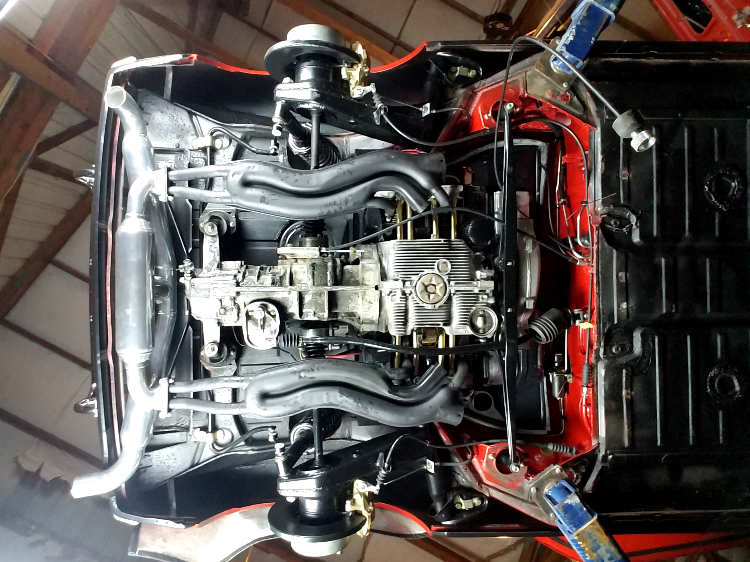

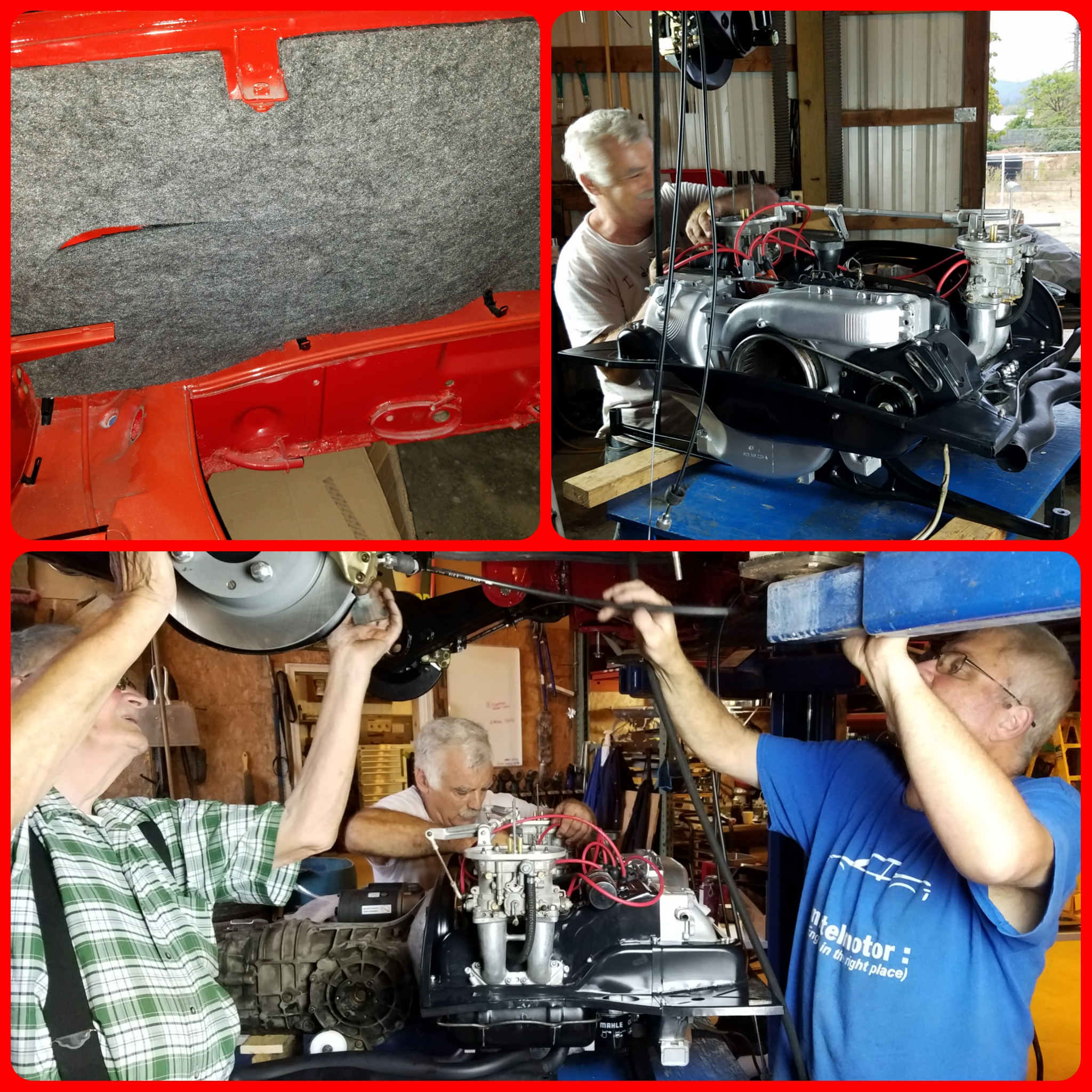

So now that I have had a chance to make it back in town and get caught up on a few things I'll go ahead and get some of my backlog of postings on this build out of the way. But towards the end it got pretty crazy and a lot of things happened. So the first big thing was the engine. The engine builder got it set up with dual dellorto carbs.
But when we went to start it we still had some Gremlins to work out and he was not able to be there for the initial start.

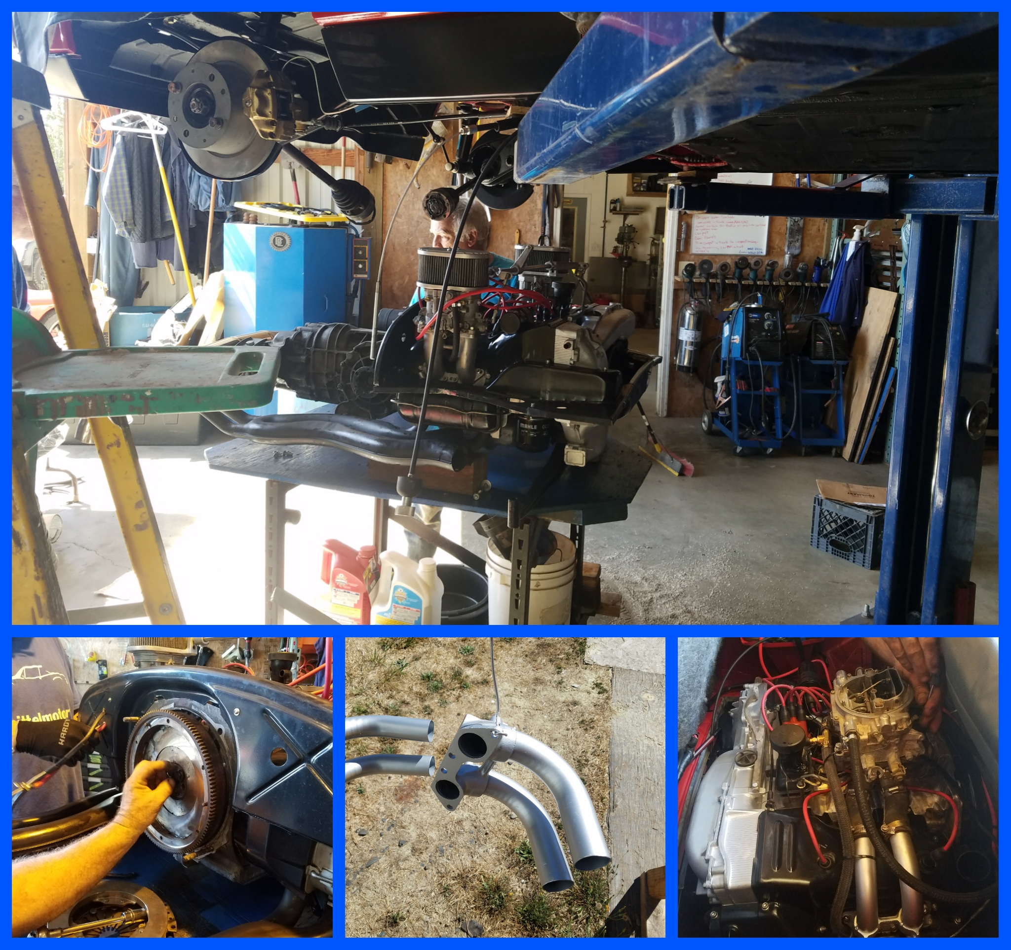

Thankfully we got the fire out in seconds and there was no damage done to the shop or the car. We were able to get everything secure and get the engine running for breaking it in. Granite for about a half an hour at over 2,000 RPM. At idle it had a mechanical noise we didn't like. So we call the engine builder and had him, come back up to sort it out. At this point we were still trying to get it running for making it to Okteenerfest.

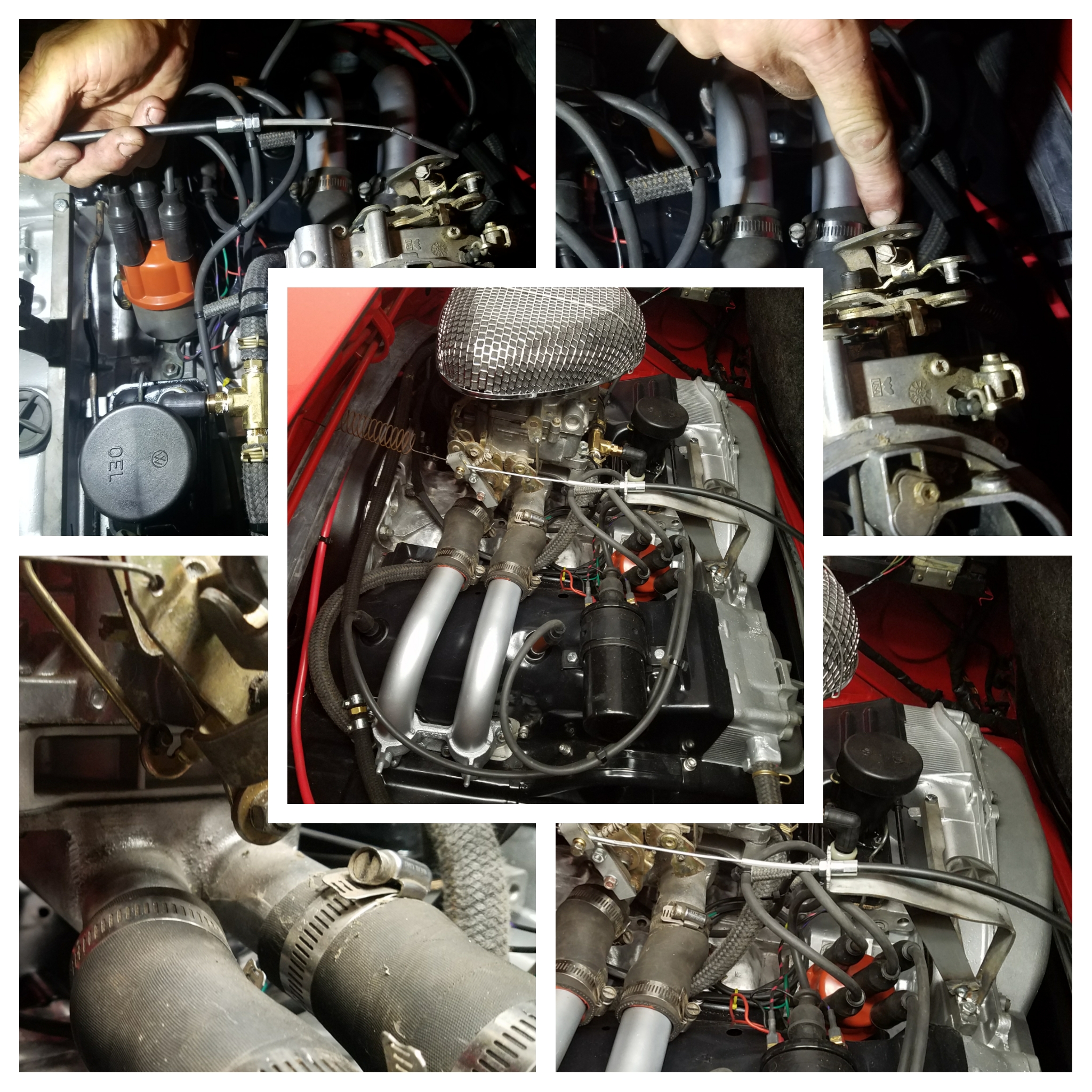

Next morning we pulled the engine. Cary had it out in record time like 32 minutes. And they went to work operating on it trying to figure out what the noise was. They quickly figured out that only one of the flywheel bolts had been tightened. So they went to work operating on it. Given the time we had to try and have the car running he brought a backup option for induction. We pulled off the dellortos and put on his favorite option when running on sand rails. A Corvair face to mix and a large Holley 4-barrel carb.
Matty900

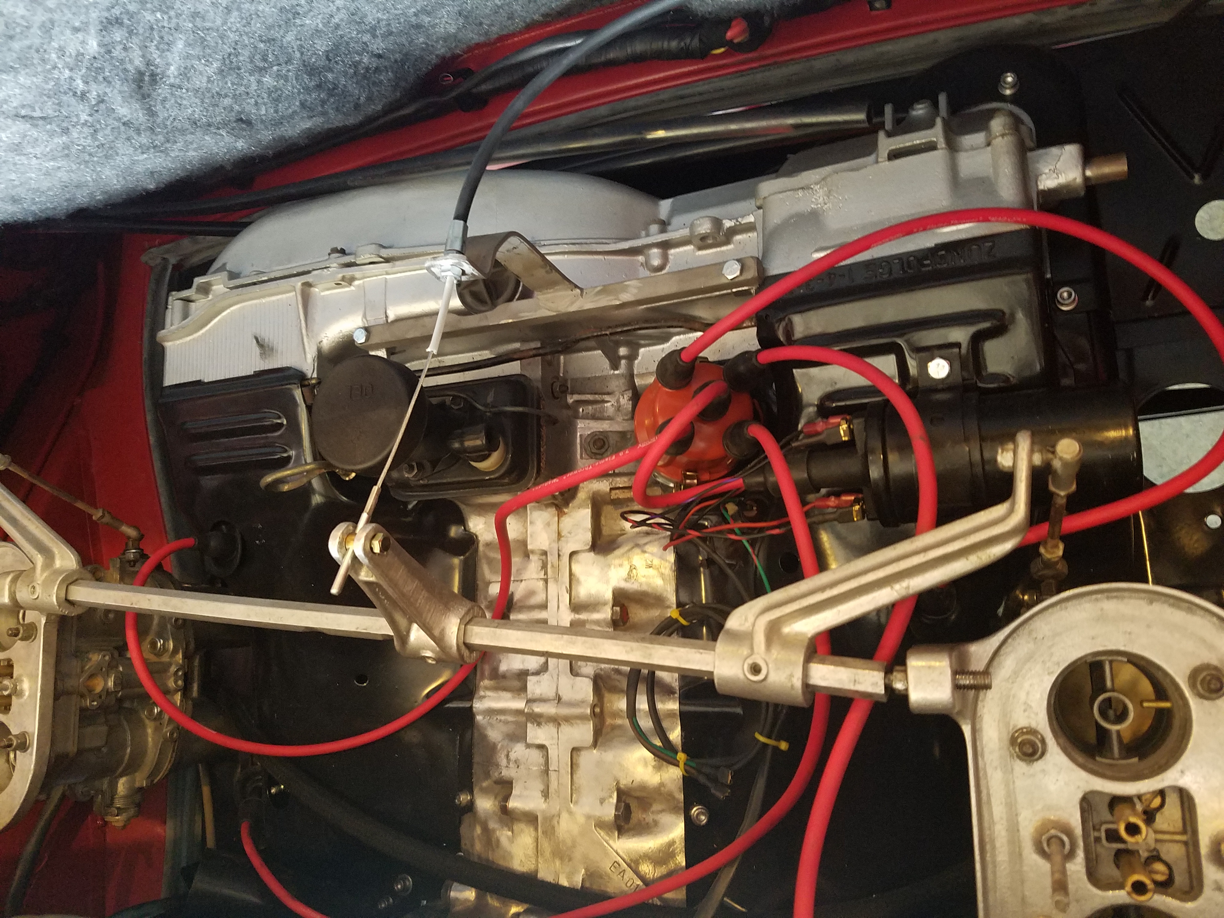

Member No.: 18,454
With the new carb setup I still needed to have linkage that would work correctly. Like Cary mentioned earlier in this thread

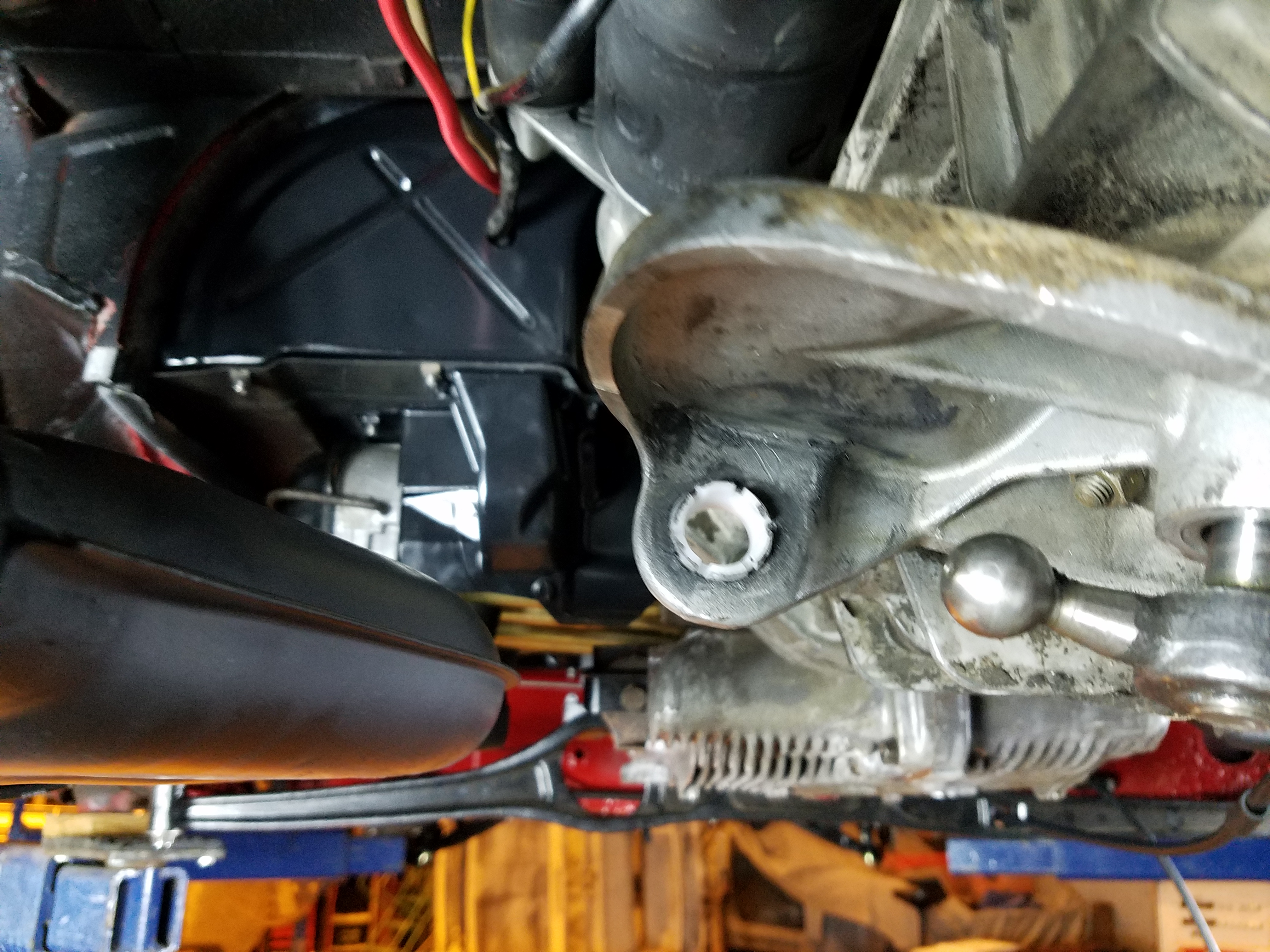

Installed new bushings and shifter ball cup for the side shift transmission.

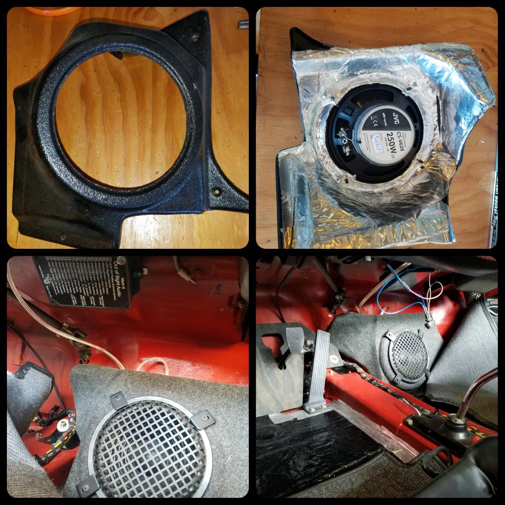

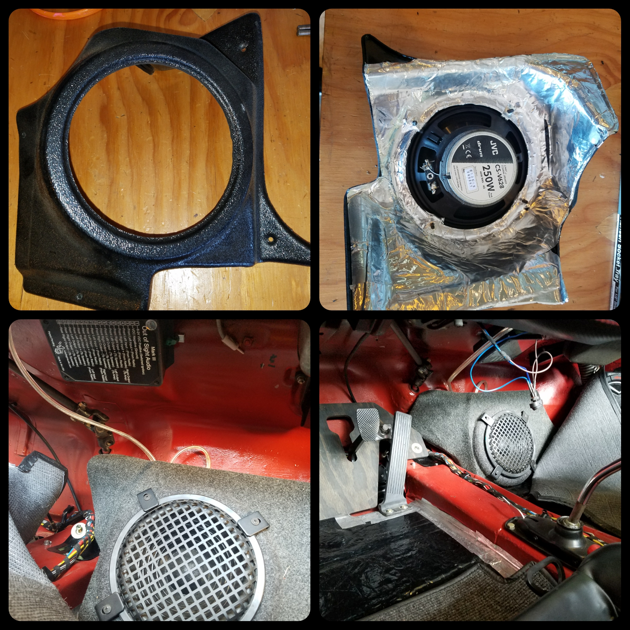

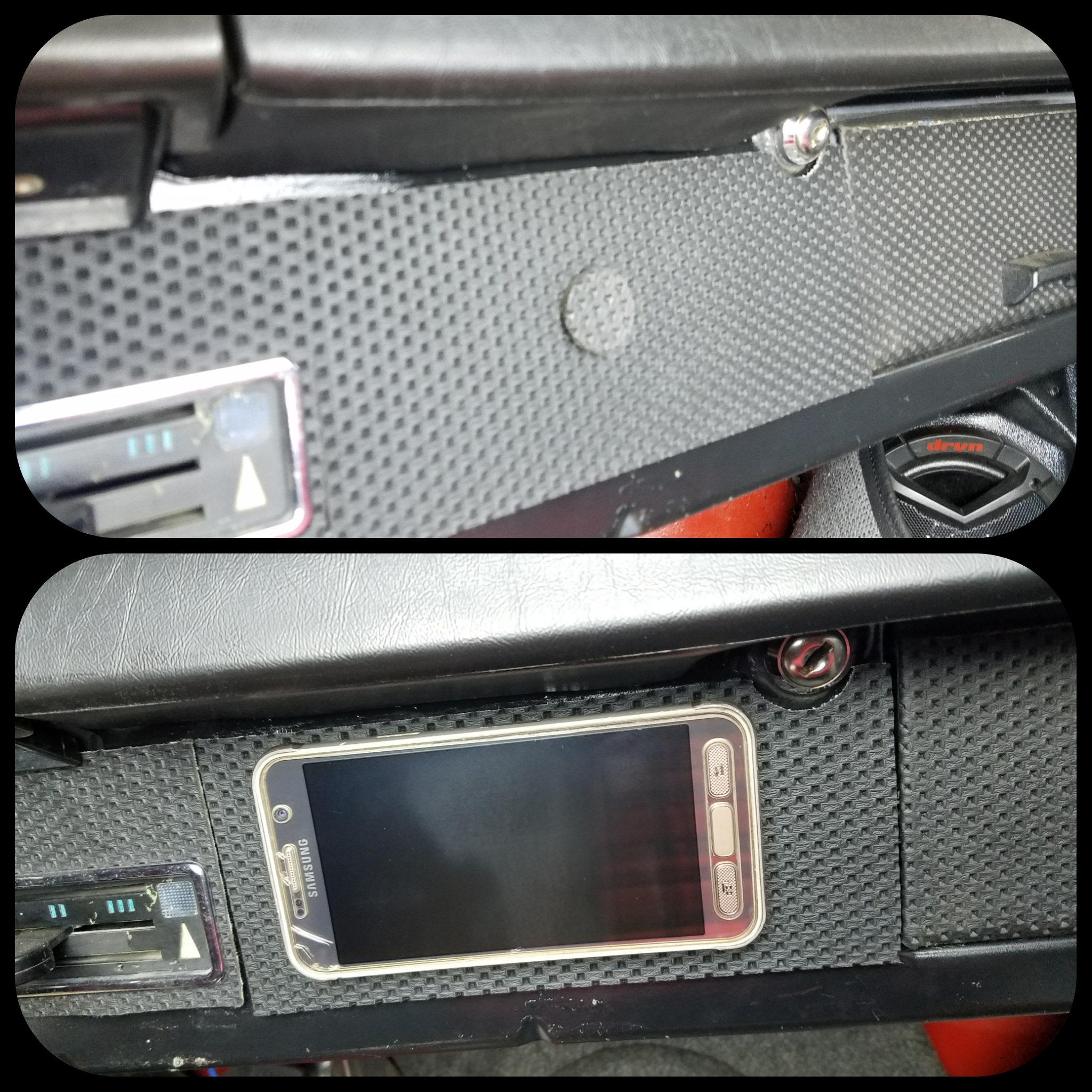

Installed an out of sight Bluetooth recover/amp 75 watts per channel. Used leftover hushmat to line the speaker pods for Better Sound. Installed a radio delete plate with a strong magnet for holding the phone and put some remaining Dash face vinyl on it to hide it from first glance so you don't notice it at first and it can be removed.

Magnet for the phone? That may have some unwanted side-effects. I don't know how it will affect the phone's circuitry and memory, for instance, and a friend of mine found that putting her phone down upside-down on an external phone battery caused it to register a bunch of "phantom taps". She believes it's due to the EMI from the battery.
So use caution when putting phones on large magnets.

Thanks Dave. The set up I am using involves a metal plate that I placed inside of the case for the phone. So the magnet is attaching to it and not the phone. It is similar to the one I use in my truck and other car for the past year with no problems.

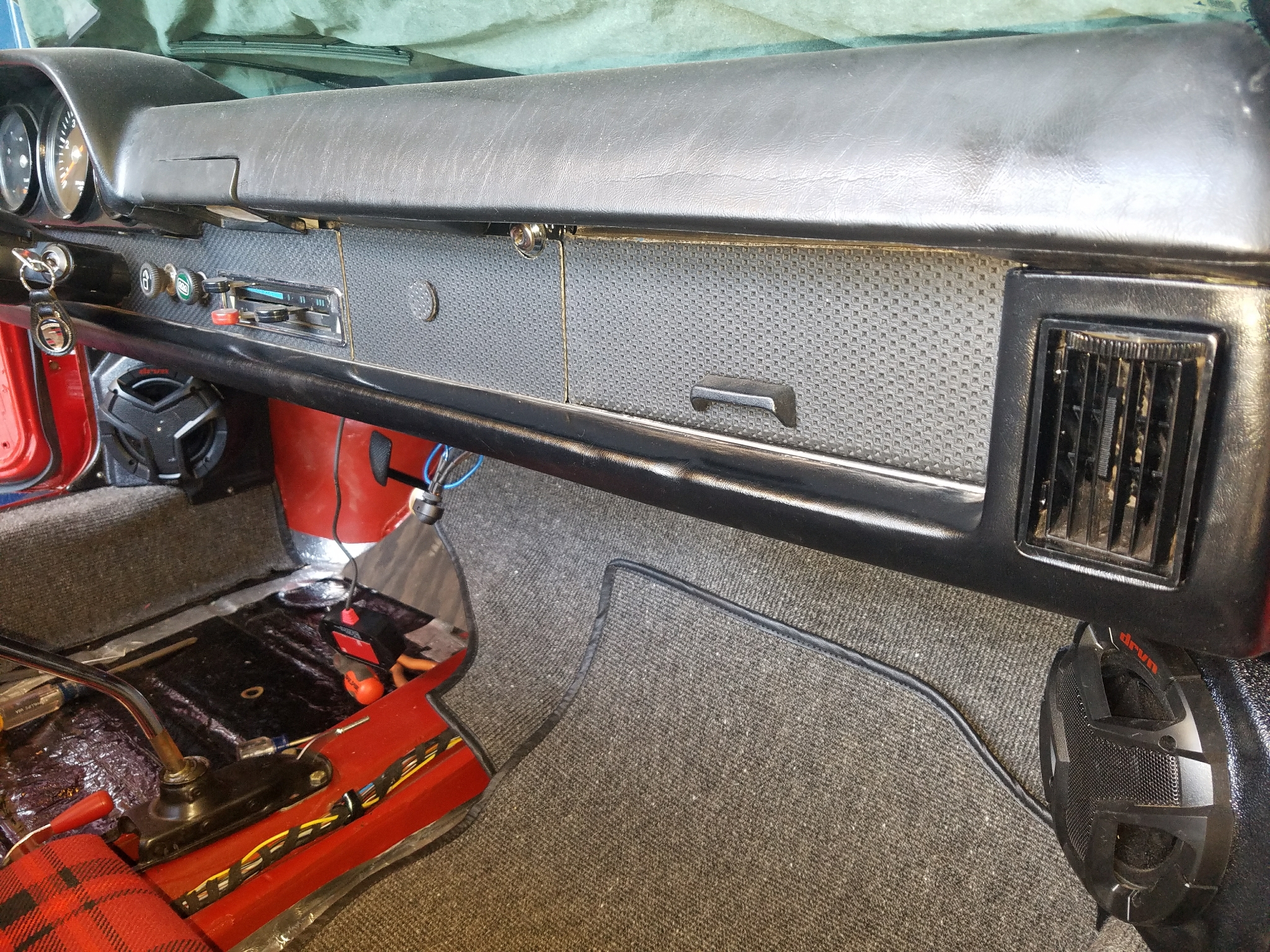

post Sep 29 2017, 12:21 AM
Post #480
Posts: 1,291
From: Oregon
Member No.: 18,454
Got the lower dash and vents back on today
